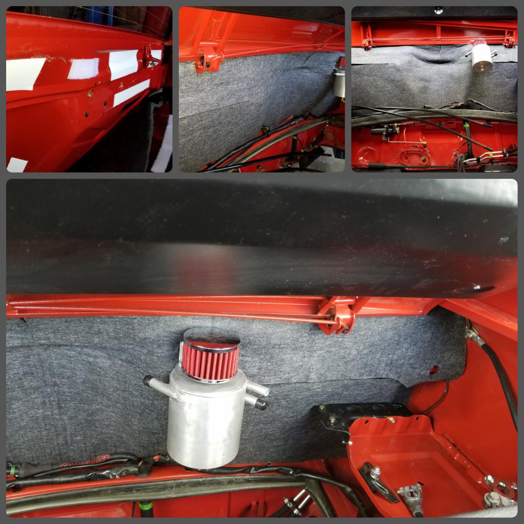

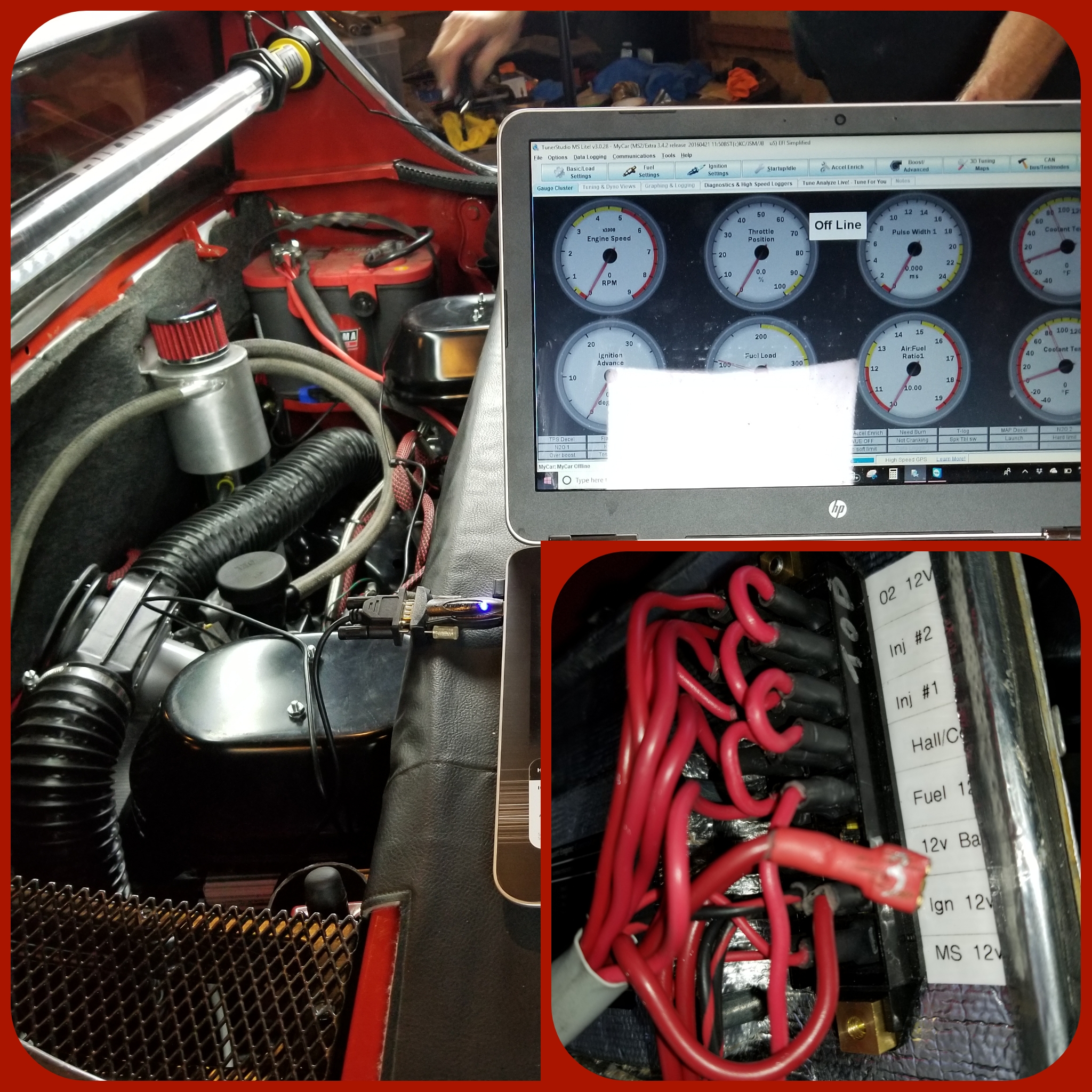

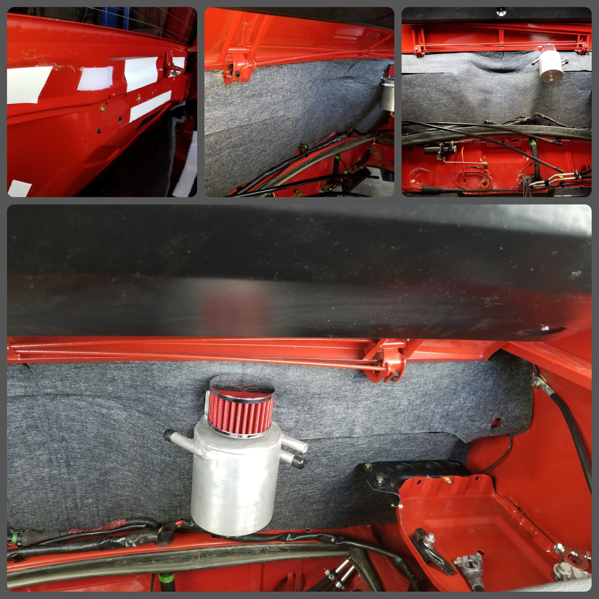

Replaced the firewall pad with a rubber backed one. I had installed the other one backwards and after the little fire on the first start last September, it was not looking as good as it could have.
Also got a catch can from Tangerine Racing and installed it on the firewall. Cary put nut zerts in so we can remove it if needed in the future.

Final connection checks and communication with the microsquirt before reinstalling the engine for the final time. Had a few issues with confusing info and the set up. We had to change the power routing to some of the relays but Mario walked us through it and remoted into my computer to help get the initial setup done and get things calibrated.

2 steps forward 1 step backwards. Got everything in place, but lost power in part of the relay box. Putting everything in the original ECU box sounded like a cool idea to start with. Now it is not so cool. Big PITA to get to it when needed and when we closed it back up, on of the power jumpers came loose.

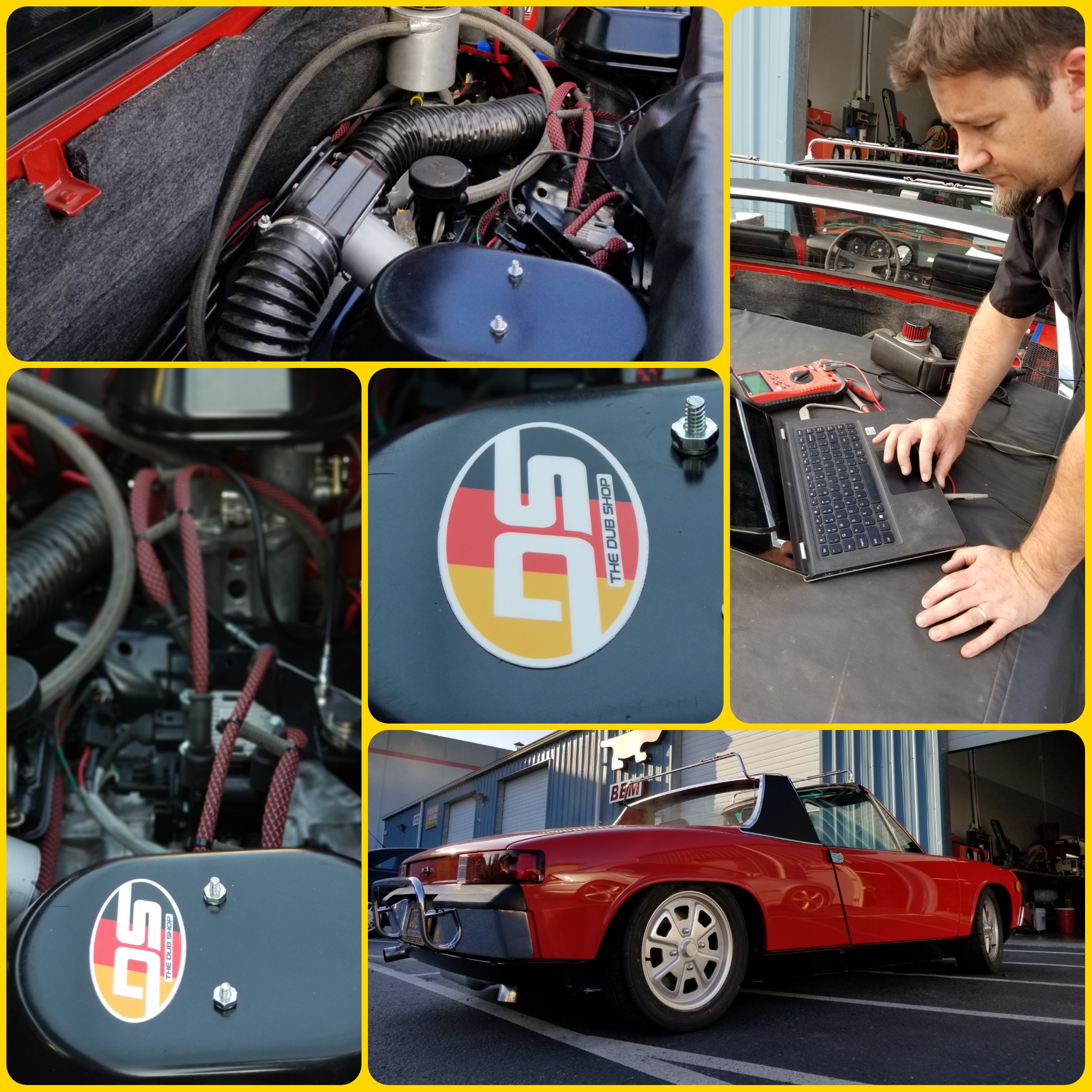

Got to Mario's shop at about 8AM and got to work. He started with getting the innovate controller calibrated and then we closed up the ECU box and hung it back on the battery tray.

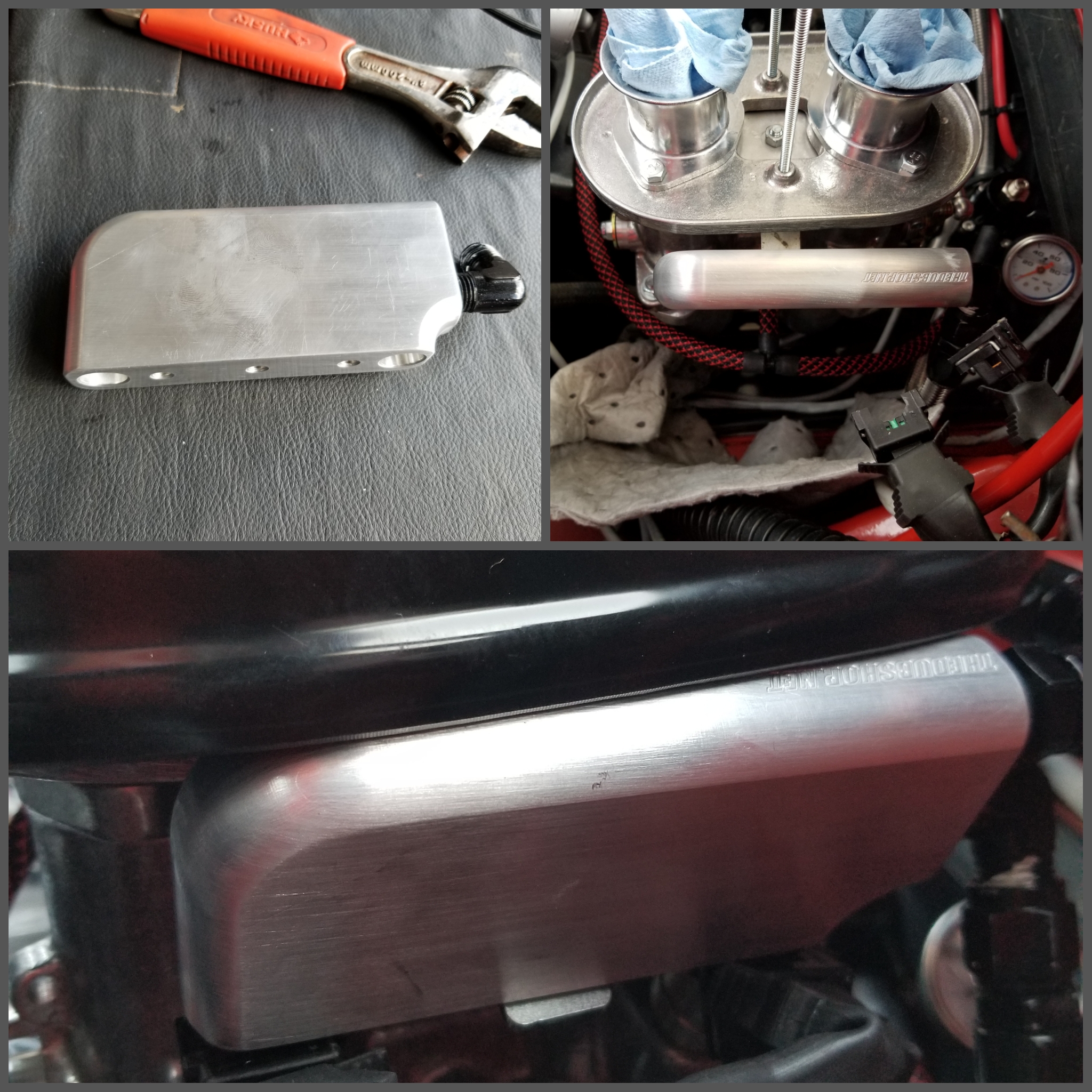

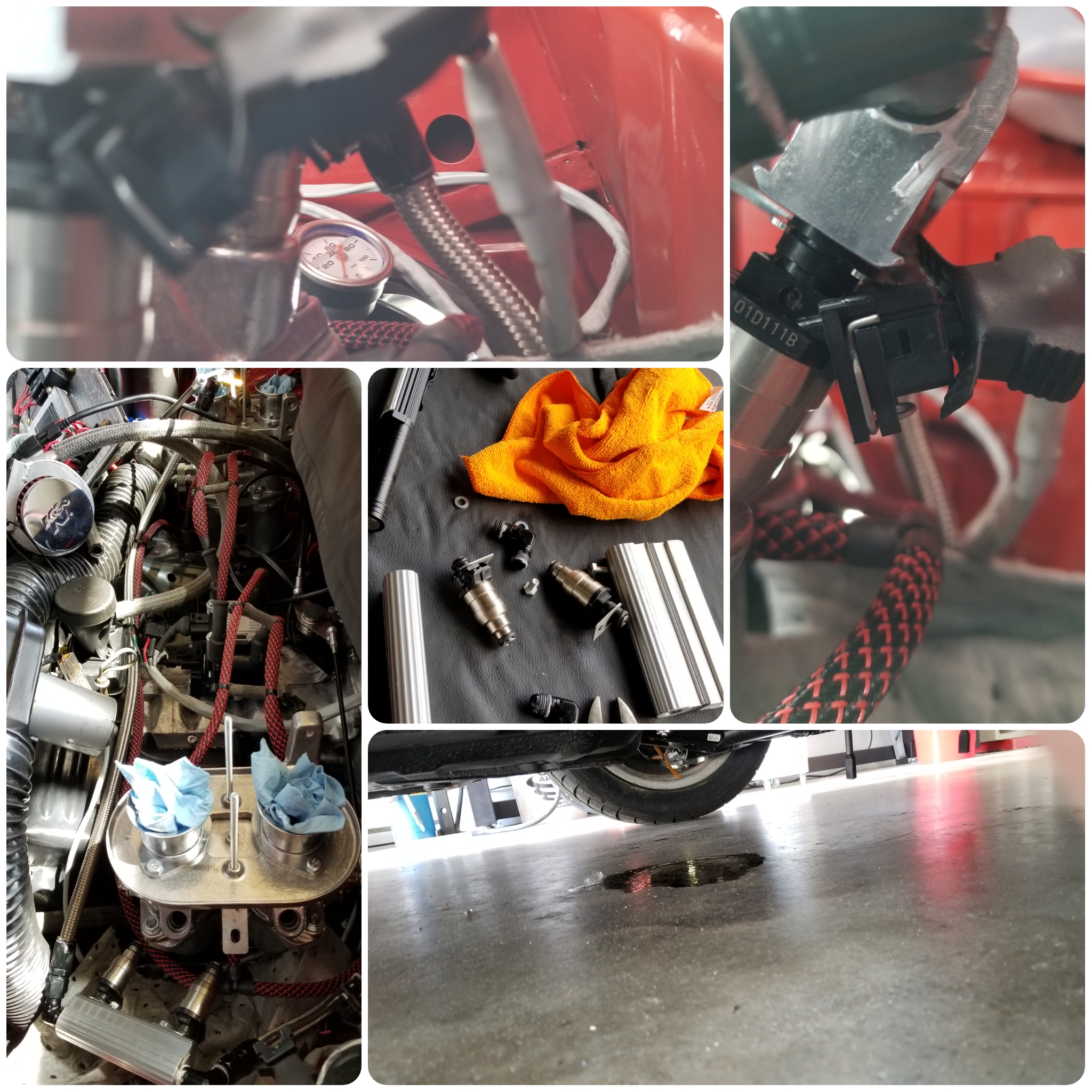

Once everything was communicating properly and in place, we started pressure testing the fuel system. Pressure on the gauge was reading about 70 PSI and we had a little leak on one of the fuel rails. Got the pressure on the regulator turned down got pulled off the fuel rail to see what the issue was. The fuel injectors had a change on them where the groove that the retaining plate holds onto does not go all the way around them so is keeping them for him being able to seat all the way. We fixed that issue and they were still leaking.
Matty900
post Jun 13 2018, 09:57 PM
Post #607
Posts: 1,291
Joined: 21-February 15
From: Oregon
Member No.: 18,454
To make a long story short we spent the next few hours sorting out fuel leaks and ended up replacing the fuel rail with one that Mario makes himself instead of the resold ones. His is way cooler and puts the fuel lines on the same side, making the engine bay tidy

Time for the 1st start. (IMG:style_emoticons/default/piratenanner.gif)
This is how cool it was. The throttle cables was not even hooked up, but the car started and idled on the base tube that he had loaded!!! (IMG:style_emoticons/default/016.gif)
We did a few road tests and tunes and got the car doing well enough to be road worthy for West Coast Rally (IMG:style_emoticons/default/piratenanner.gif) (IMG:style_emoticons/default/piratenanner.gif) (IMG:style_emoticons/default/piratenanner.gif) (IMG:style_emoticons/default/driving.gif)

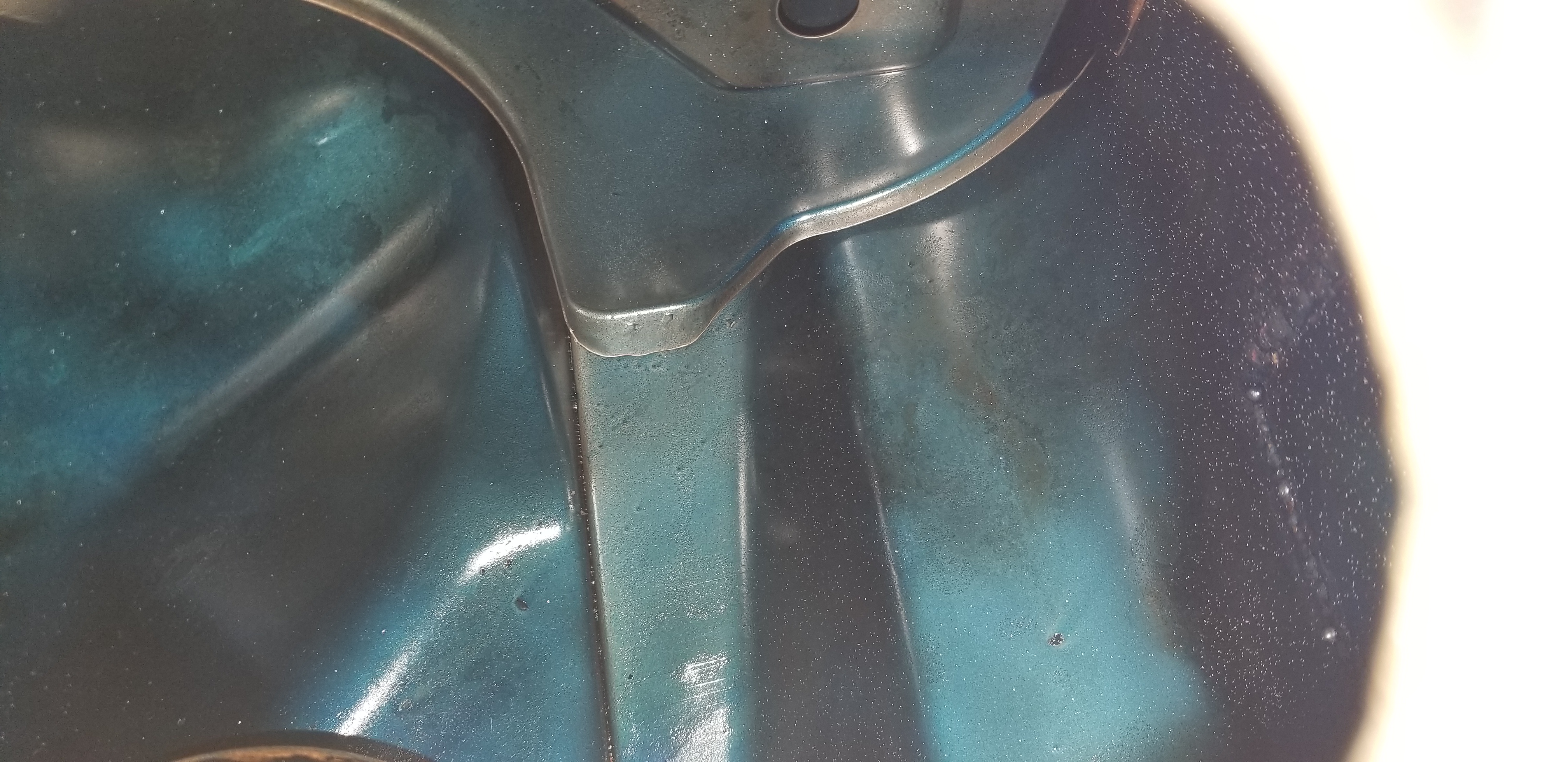

We pulled the tank and had it opened and re lined.
