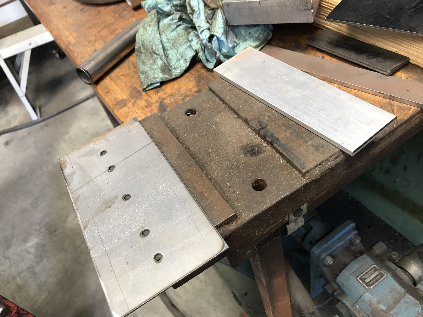

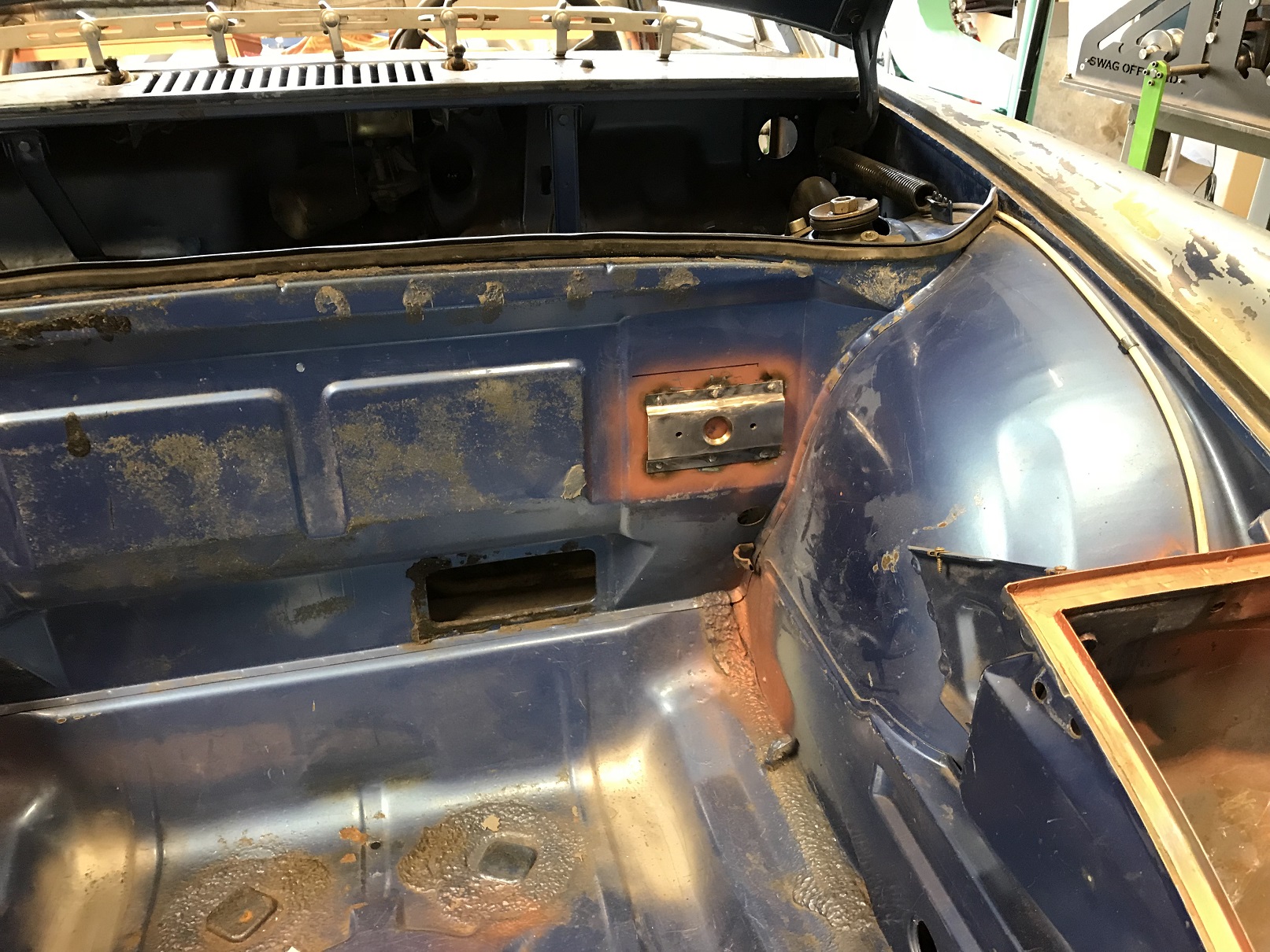

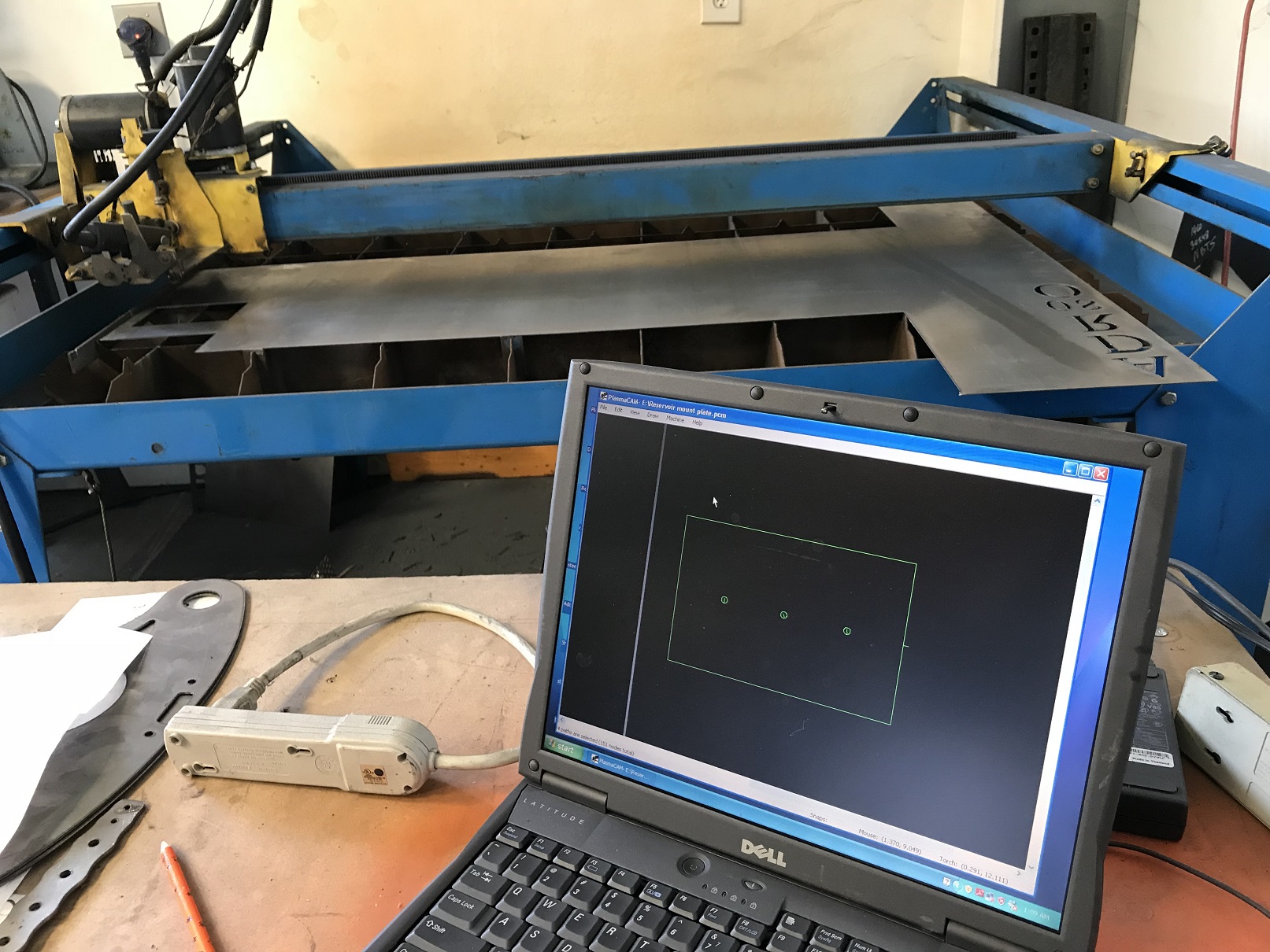

Today's progress: Started on the plasma table.

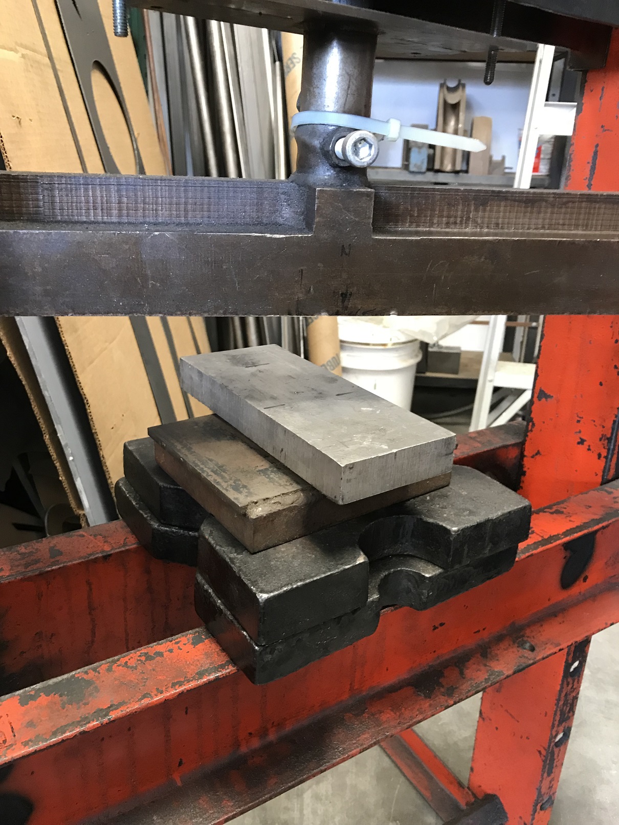

The part needs to be stepped up in the middle and I was able to find what turned out to be the perfect press set up. What are the odds?

Carefully set the piece in the press with the appropriate sized "helper" pieces.

The press is a beast and makes quick work of this sort of thing.

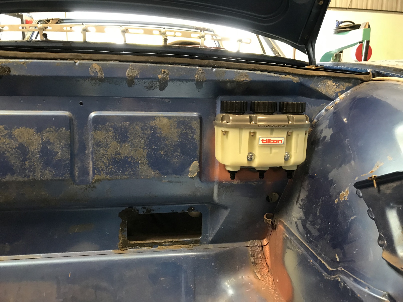

Reservoir in place. I like the way it turned out.

^strange place to have your bottle opener (IMG:style_emoticons/default/smile.gif)

tygaboy
post Aug 25 2018, 08:59 PM
Post #1178
Posts: 5,550
Joined: 6-October 15
From: Petaluma, CA
Member No.: 19,241
QUOTE(Andyrew @ Aug 25 2018, 06:10 PM) *
That 16ga? What kind of press do you have? Piece looks great!
Thanks Andrew!
I used 18 ga. The press is the one that was sitting next to the bender we used on your cage bars. The pump that powers the bender has dry break connectors that also hook to the press so in about 10 seconds, I have a giant powered press!
Let me know if you need anything squashed! (IMG:style_emoticons/default/smash.gif)

QUOTE(tygaboy @ Aug 25 2018, 08:01 PM) *
See you been spying on my thread again (IMG:style_emoticons/default/shades.gif) I like the mount why did you choose that location? I am just wondering, as I put mine closer to the stock area, so the over filled fluid can run done the fresh paint and start the 914 conversion to rust process all over again. (IMG:style_emoticons/default/huh.gif)
