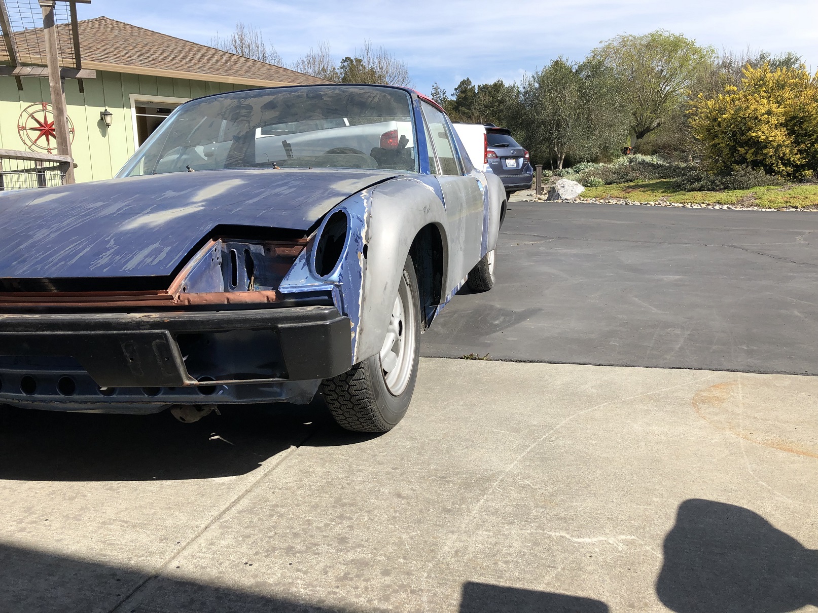

That's the fronts tacked on.

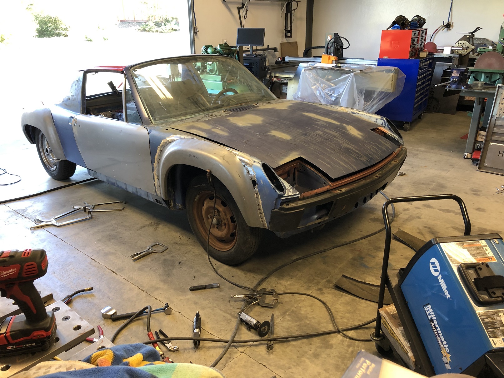

And now, a couple artsy-fartsy shots.

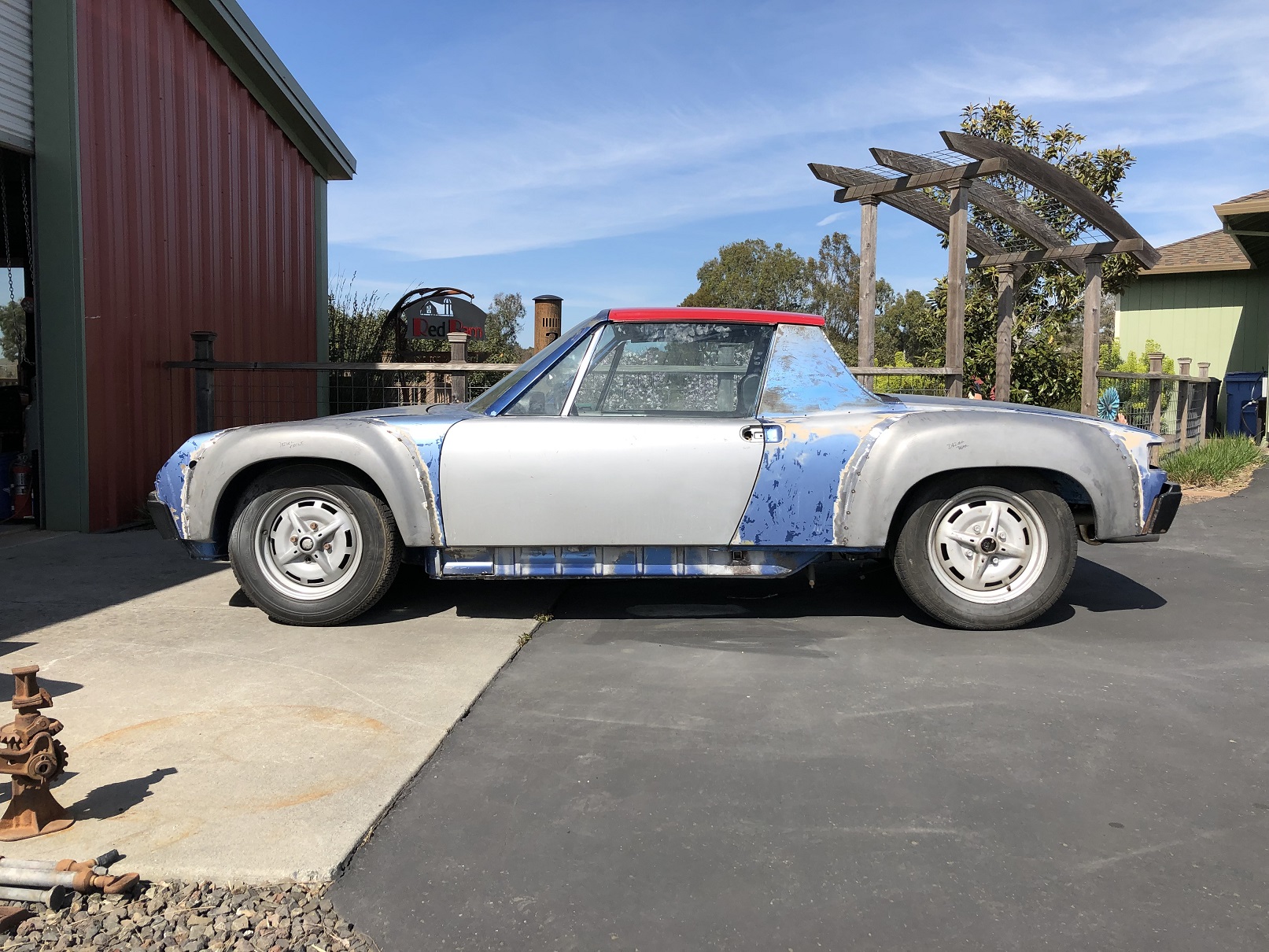

Today I got the driver's rear tacked on. Having worked on the car all this time in narrow body format, it's amazing what the flares do to the vibe of the car.
It's like its voice suddenly dropped an octave.
I'm digging the new "tough guy" look.

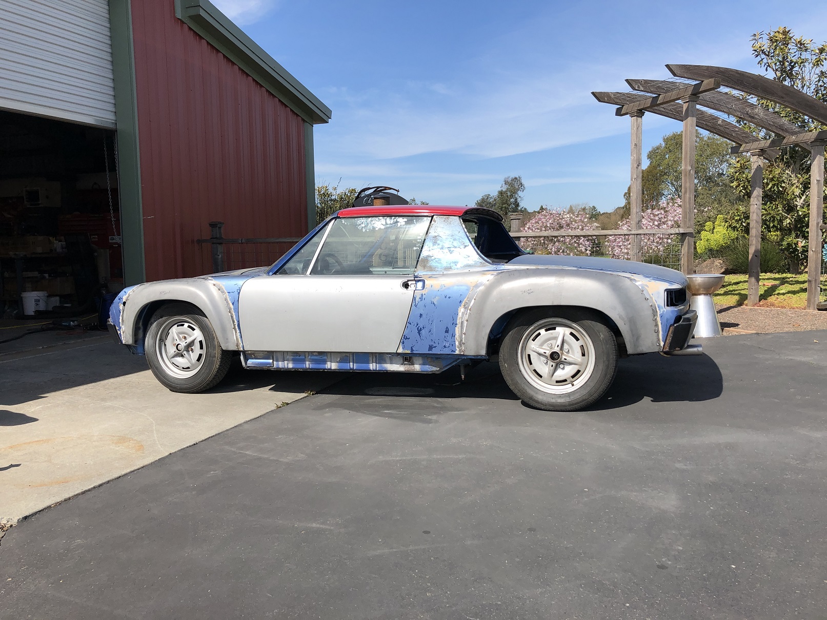

I aligned the flare opening with the stock fender openings but it's funny how where you stand when you take the pics makes the flares look too far forward or back.
Here's one where I stood dead center to the rear wheel opening.

QUOTE(tygaboy @ Mar 17 2019, 02:30 PM) *
@tygaboy did you notice that the flares only really fit on one way? Once you figure the height of the arch per George @AA's instructions it's pretty straight forward.

QUOTE(mb911 @ Mar 17 2019, 04:54 PM) *
True-ish, but there was more front/back movement than I would have expected. Maybe I'm just paranoid. (IMG:style_emoticons/default/laugh.gif)
