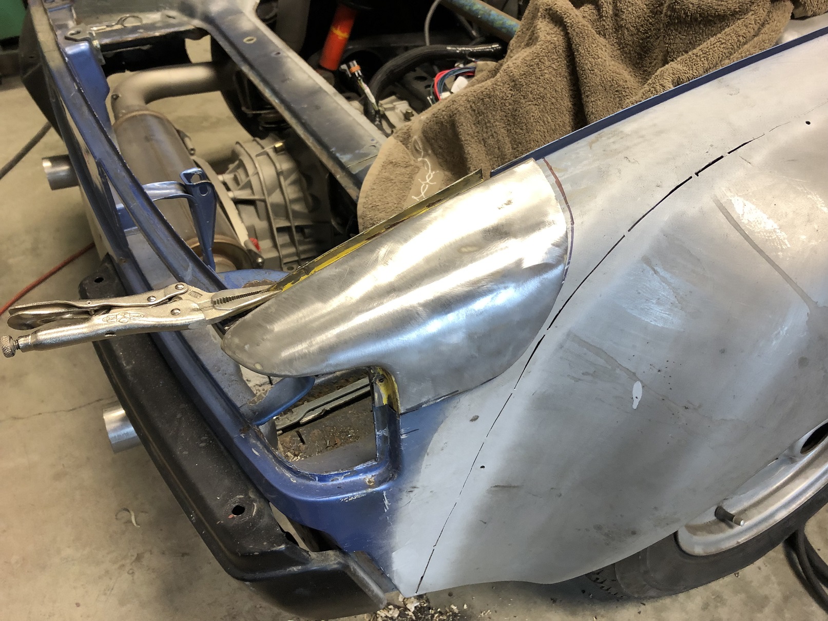

With all 4 flares tacked on, I can't possibly be the first but I just had to:
I like big butts!

Last one on. Now the tedious task of welding and finishing those joints and adjusting the lower ends to match up w/the original shape of the lower panels.

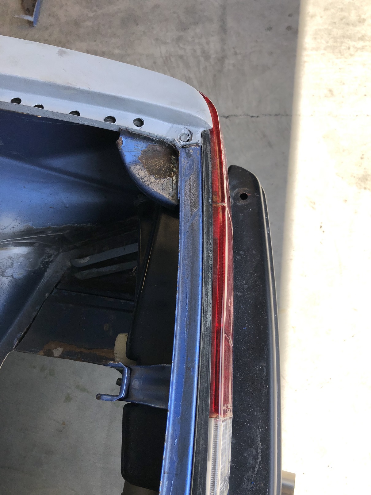

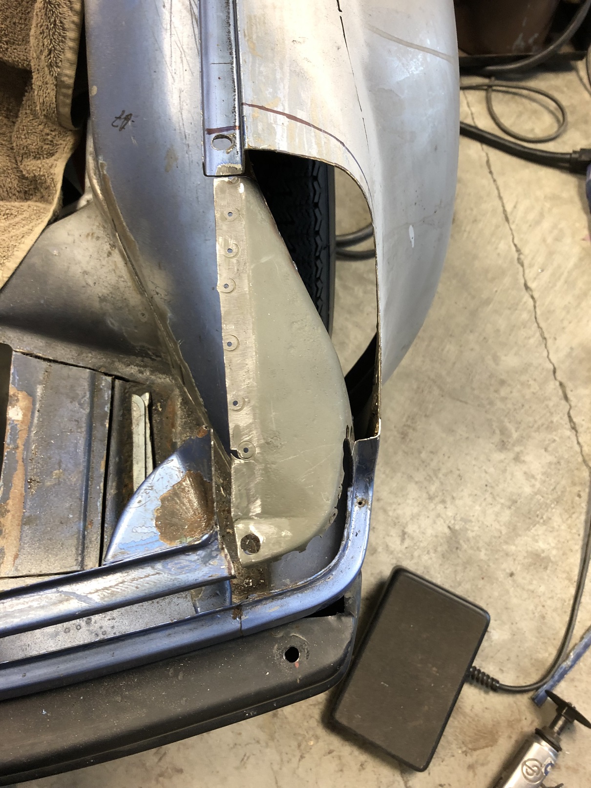

Time to do some of the boring but necessary stuff. Today was starting the repair on the rust caused by the dreaded "foam in the rear fender".
In my case, both the inner panel that makes up part of the trunk and the outer needed repair.
Lots and lots of figuring out where to splice in the repairs, lots of "test fit, tweak, test fit again.
I got what looks to be a good fit on the inner panel and here it is temporarily tacked in place.
Yes, the outer panel/trunk gutter is proud to the inside of this inner piece. Looks odd at this point but it's in the correct location.
tygaboy
post Mar 22 2019, 06:21 PM
Post #1451
Posts: 5,551
Joined: 6-October 15
From: Petaluma, CA
Member No.: 19,241
Early in the "test fit/tweak" process with the outer panel.

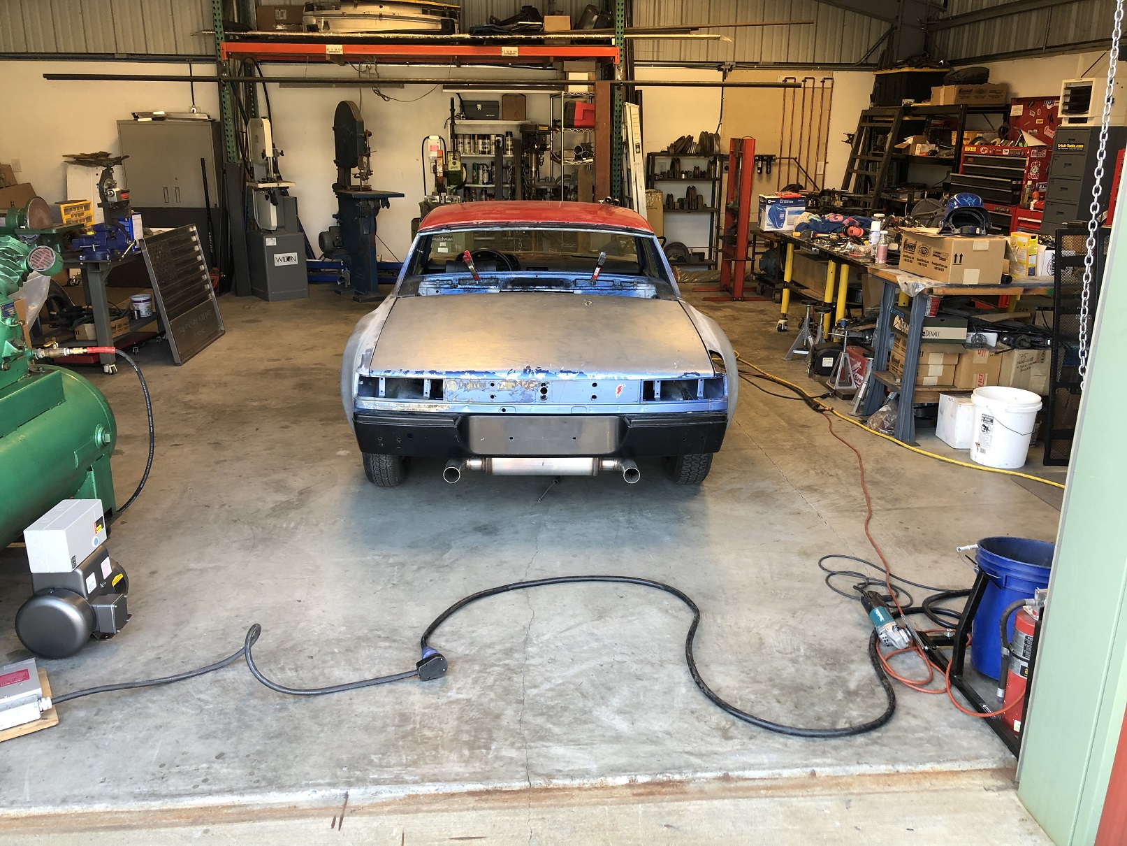

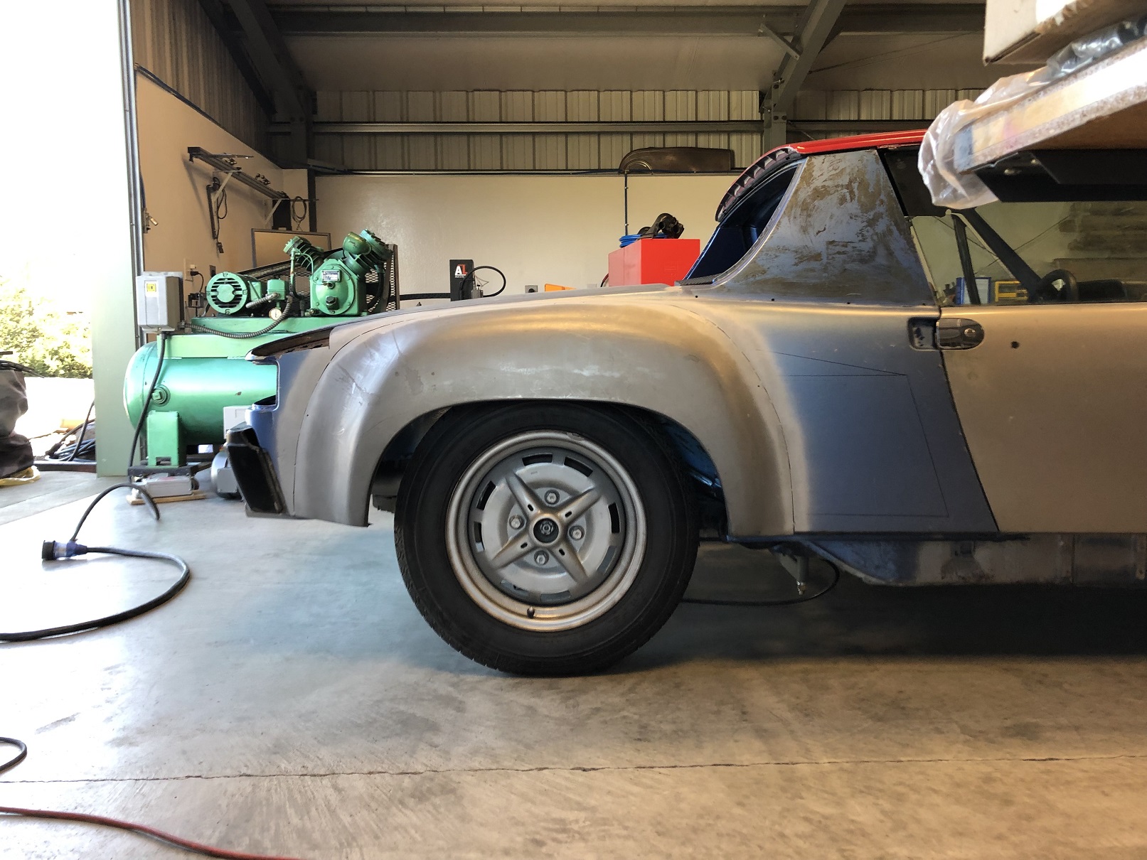

Test fitting is getting there. Gaps are looking good.

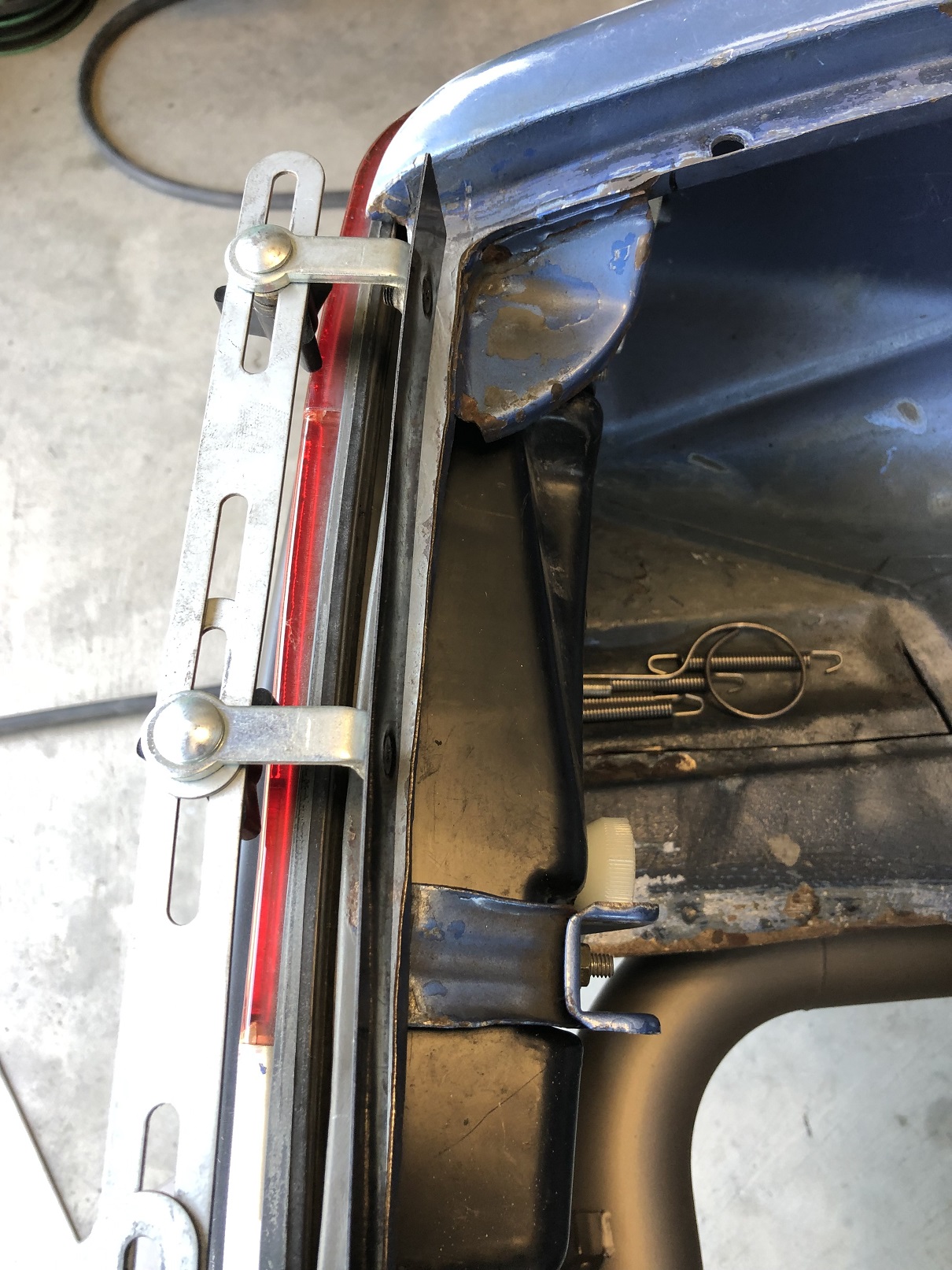

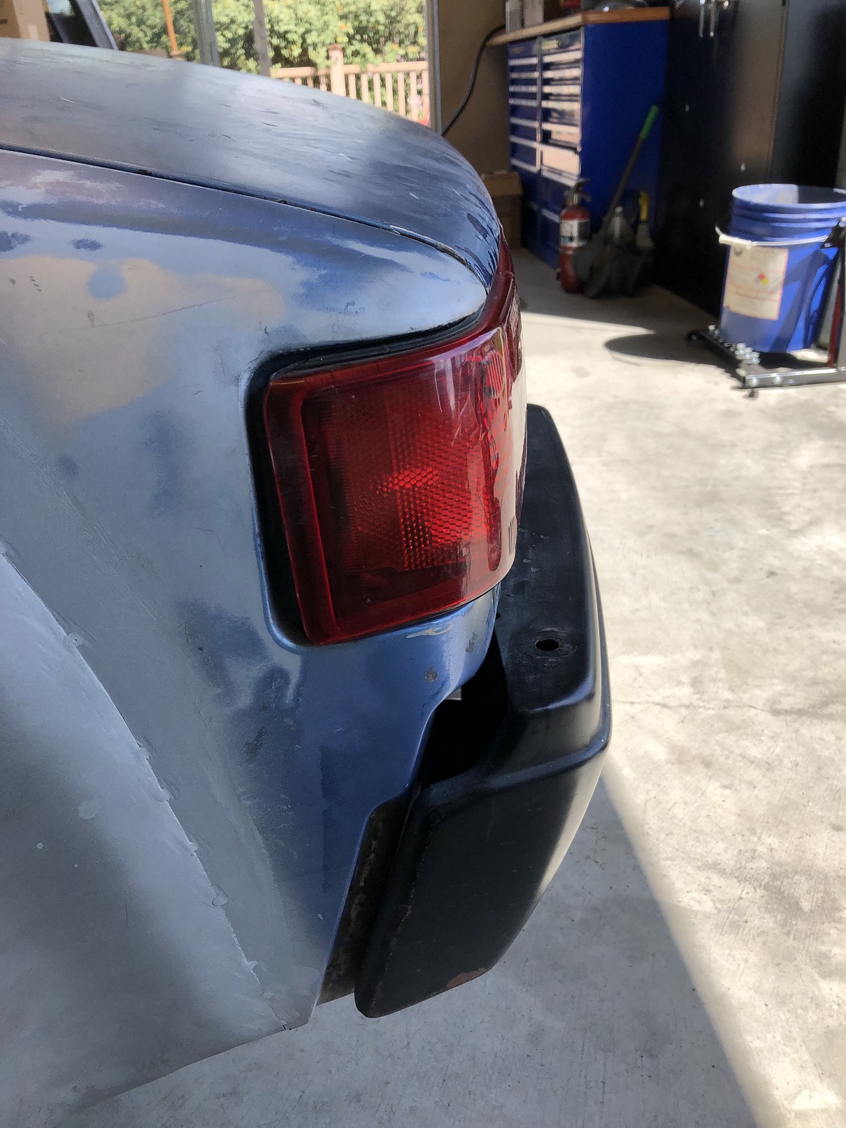

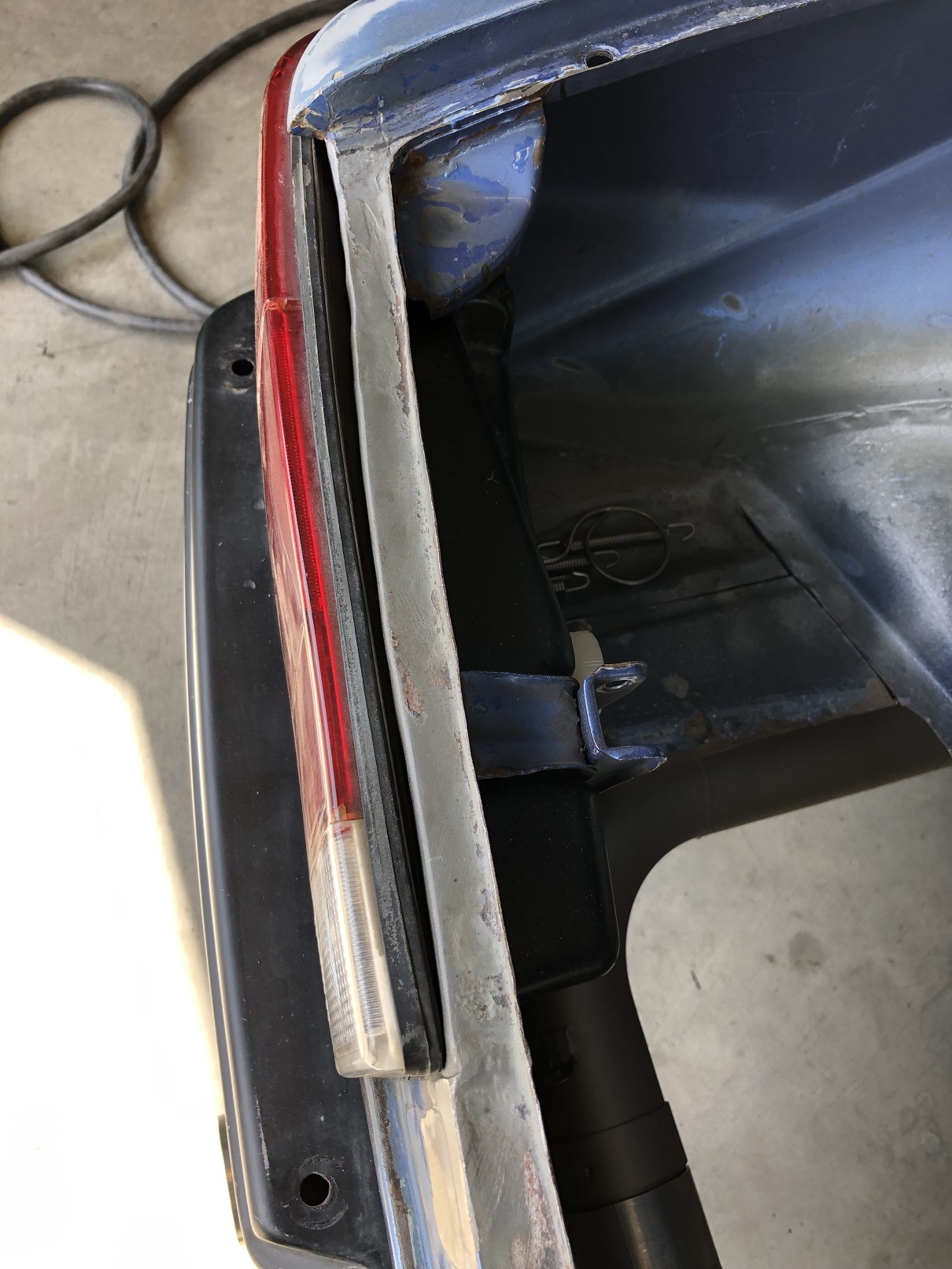

Now on the driver side, not looking so good. I knew this was going to need to be addressed and here you can see just how much of a crap repair someone did.
Any questions about how water got into the trunk?
I can't claim I'm the greatest metal worker but, come one. This isn't even close.

From: Petaluma, CA
Member No.: 19,241

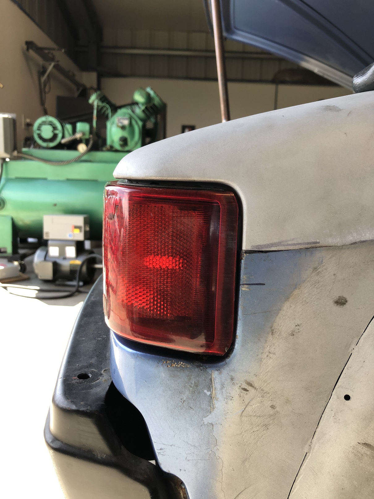

And the crap repair also meant the tail light housings can't sit where they're supposed to so we have this lovely misalignment to deal with.

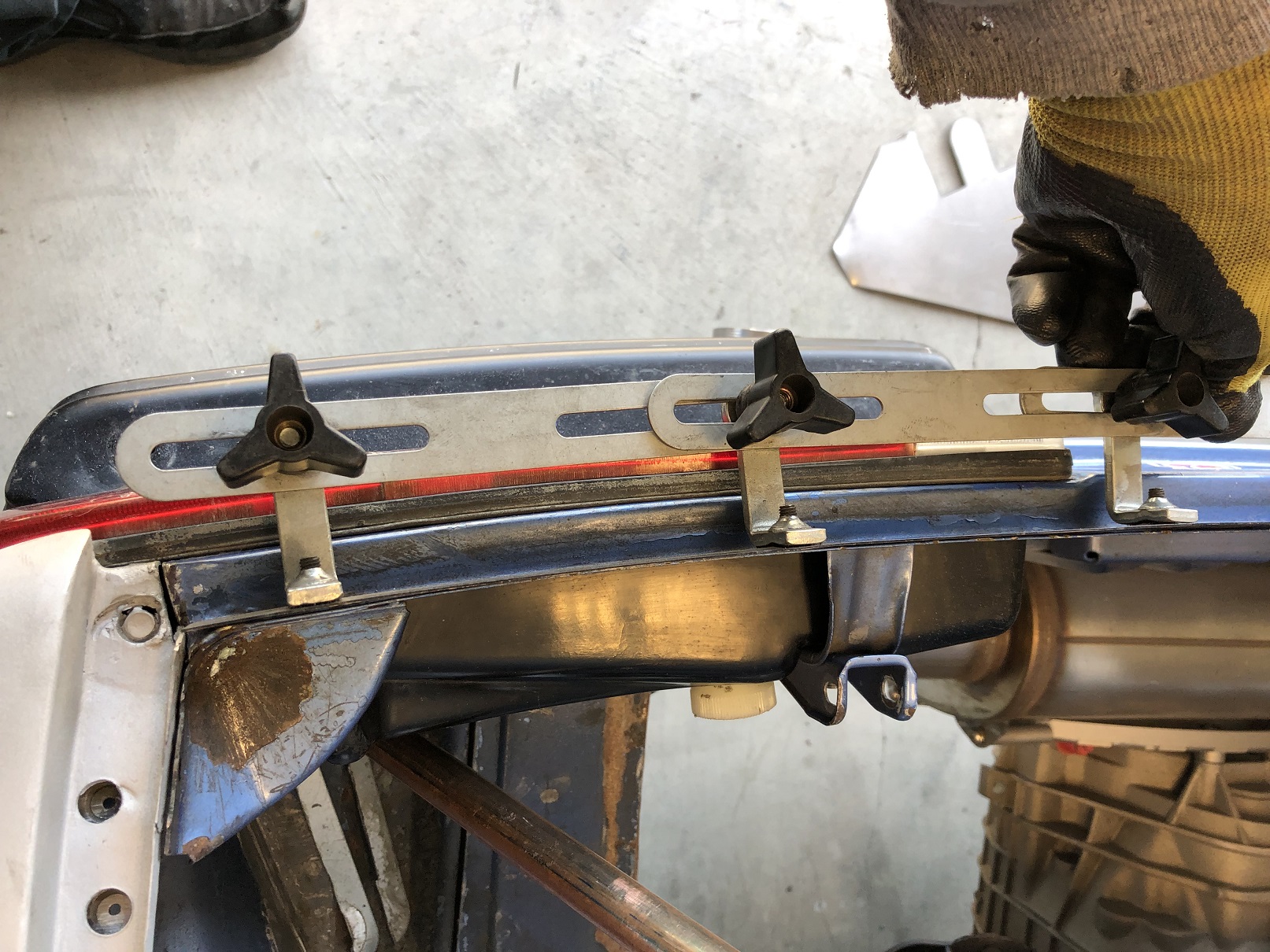

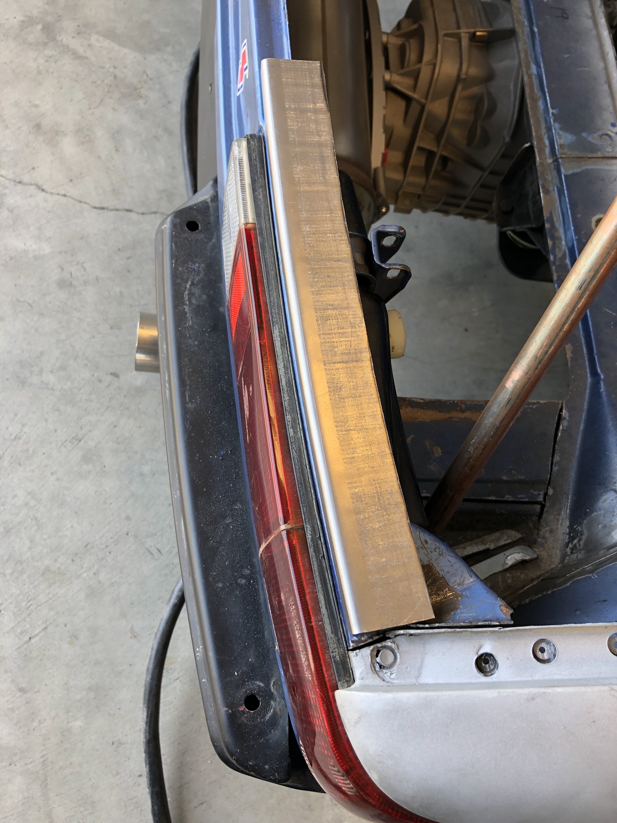

Curvey template tool to the rescue!
Capture the shape from the good side, flip it, and...see how bad the bad side is.
tygaboy
post Mar 23 2019, 06:13 PM
Post #1460
Posts: 5,551
From: Petaluma, CA
Member No.: 19,241

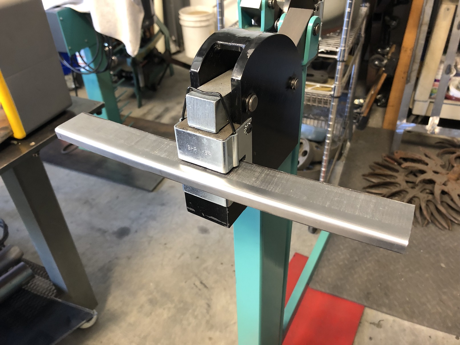

Cut some 18ga, measure and bend the flange, then it's into the shrinker to get the needed curve.
Then test fit/compare to the good side.
