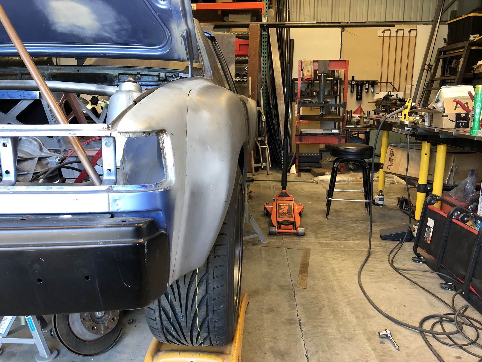

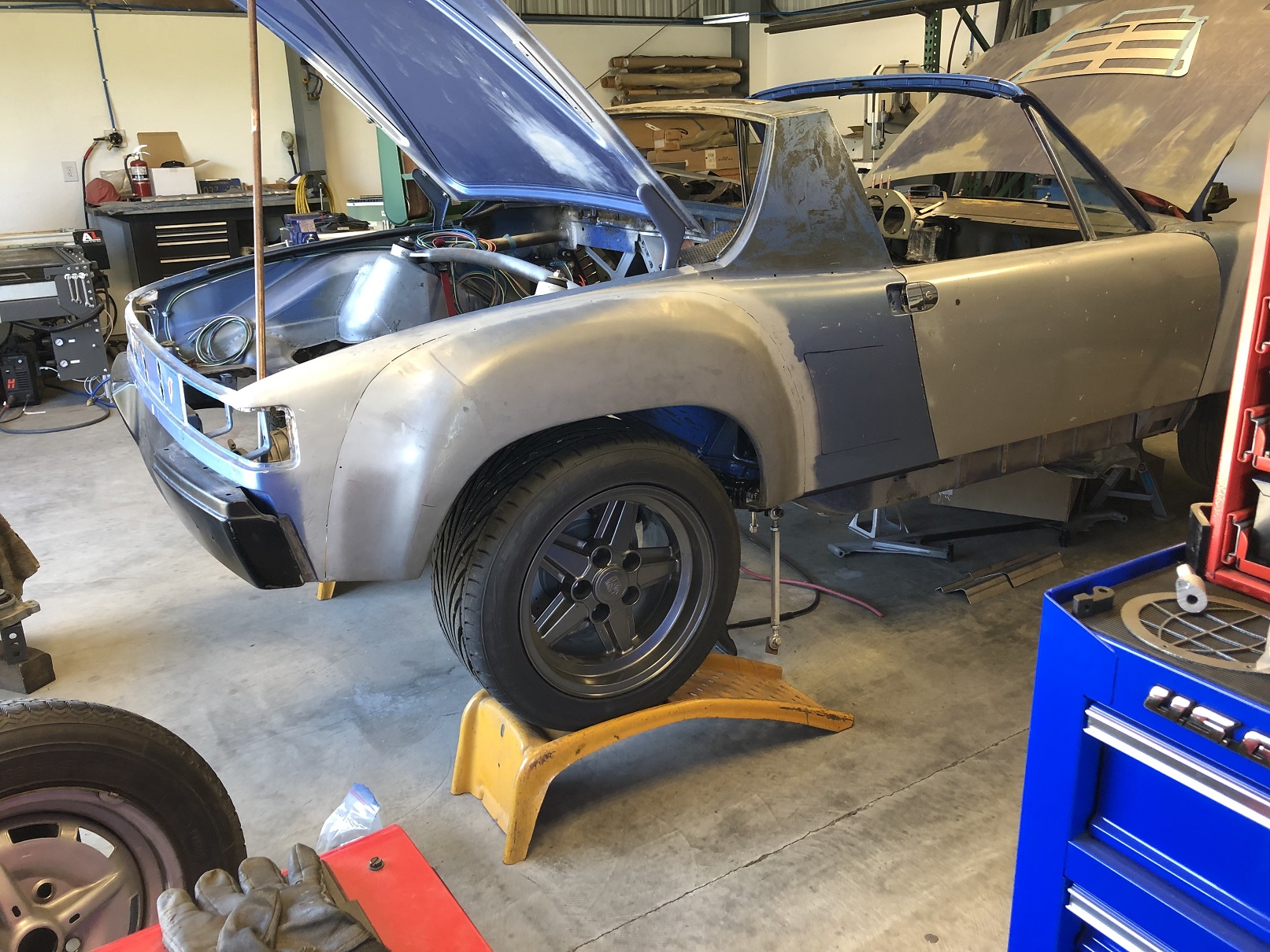

tygaboy
post Aug 14 2019, 10:37 AM
Post #1805
Posts: 5,552
Joined: 6-October 15
From: Petaluma, CA
Member No.: 19,241

tygaboy
post Aug 14 2019, 02:38 PM
Post #1808
Posts: 5,552
From: Petaluma, CA
Member No.: 19,241
Well that makes a bit of a difference, eh? A bit of envisioning it with paint but I'm really happy with how these are going to look on the car.
tygaboy
post Aug 14 2019, 02:43 PM
Post #1809
Posts: 5,552
From: Petaluma, CA
Member No.: 19,241
And credit where credit is due: @BuddyV has Ronals on his car and I loved the look.
A major attraction is that these do a really nice job of filling out the flares with no spacers! So it's standard length studs, too.
Andyrew
post Aug 14 2019, 03:27 PM
Post #1810
Spooling.... Please wait
Posts: 13,377
Joined: 20-January 03
From: Riverbank, Ca
Member No.: 172
QUOTE(tygaboy @ Aug 14 2019, 01:43 PM) *
They'll tuck a good half inch as the suspension drops to ride height as well.
Very nice fitment!

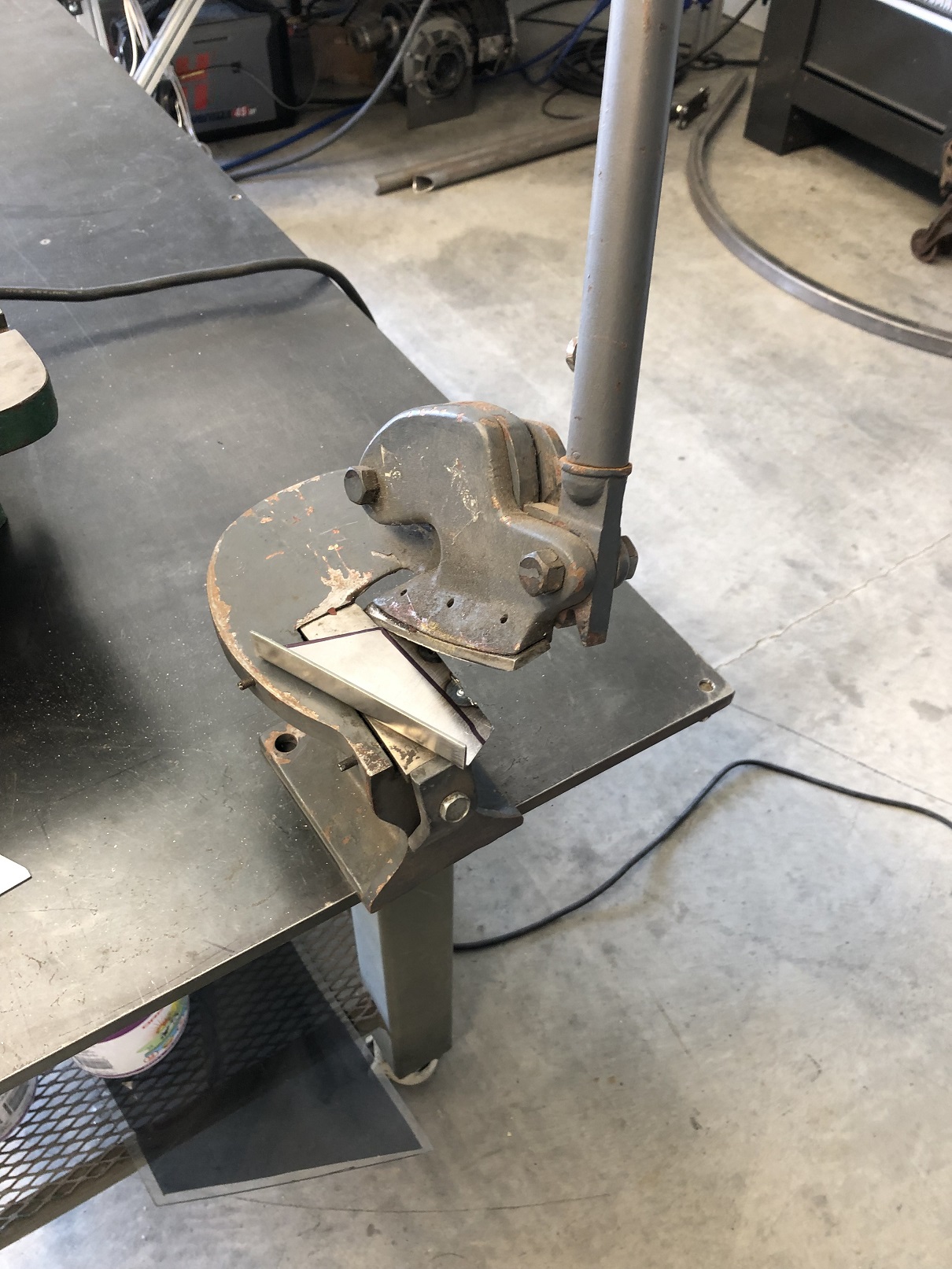

Today was working on the radiator install. And given the earlier questions about tools, I thought this might be interesting to some:
This is an inexpensive copy of a Beverly shear.
The real deal items are around $600. Copies can be had for ~ $160 at Harbor Freight.
Remember, you get what you pay for and a genuine Beverly is a joy. These aren't bad, though.
Anyway, it makes quick, clean (and quiet!) work of cutting sheet metal. The throatless design lets you turn the piece and cut essentially any shape. Plus, it's a shear so no kerf to factor in, if that's of concern.
In all, a very handy and cost effective tool.
Here, I'm just trimming a support piece that sits under the radiator frame.

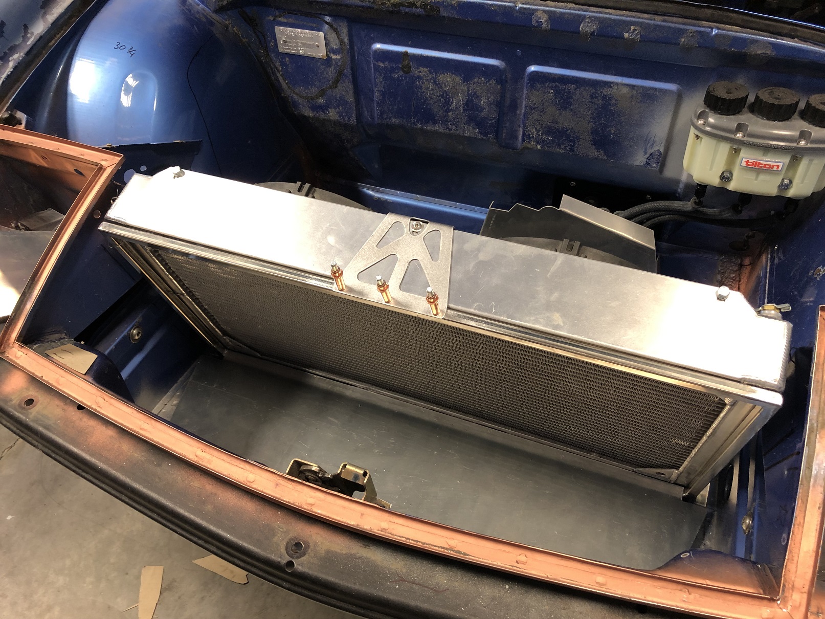

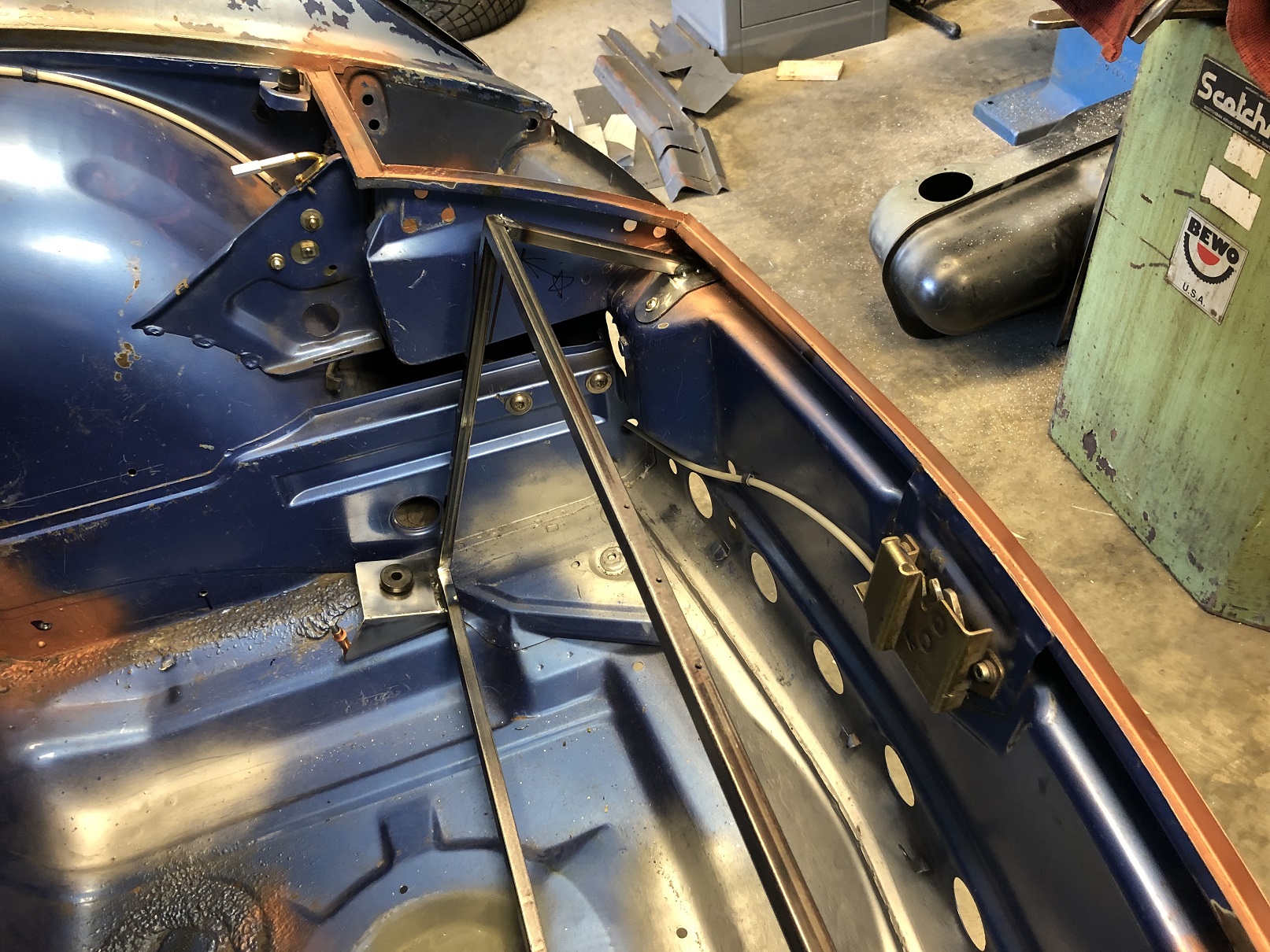

tygaboy
post Aug 15 2019, 05:35 PM
Post #1813
Posts: 5,552
From: Petaluma, CA
Member No.: 19,241

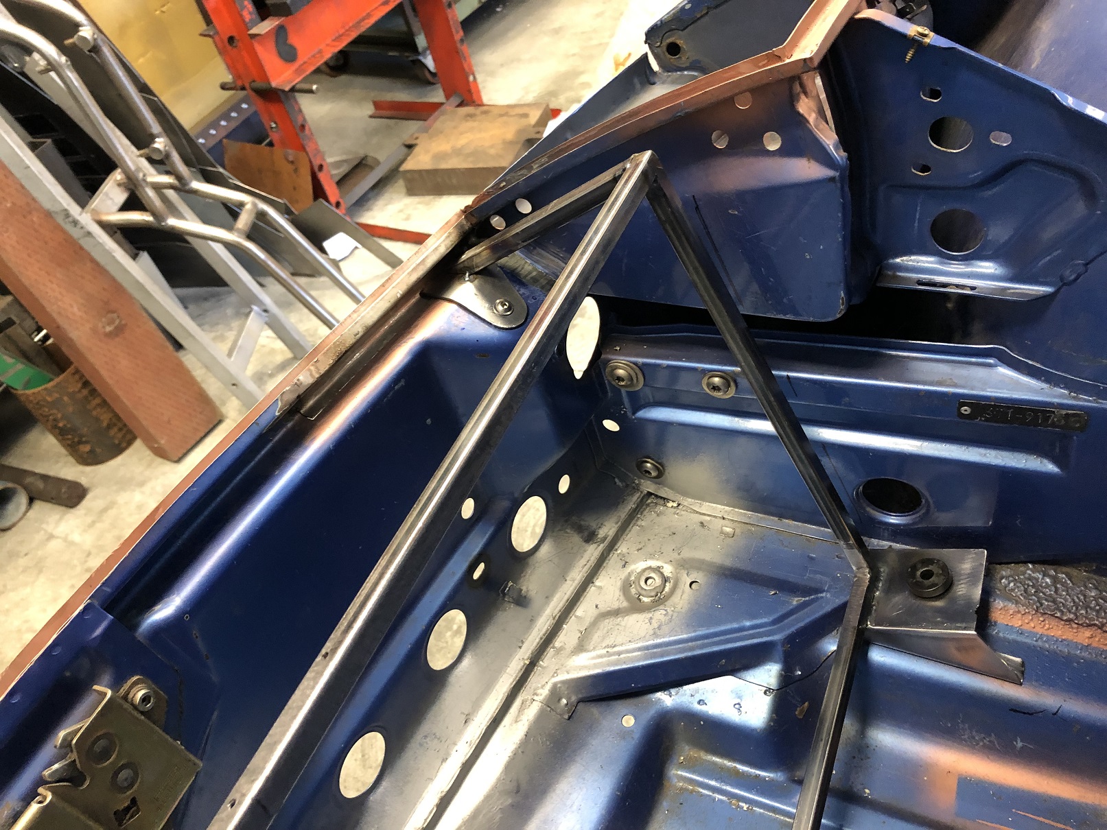

Main frame fabricated, support brackets installed and floor shroud rough fit.
I still have to add some supports to the upper, outer corners that tie forward to the chassis. Then it's add the side and top shrouding and cut the front panel.
tygaboy
post Aug 16 2019, 02:12 PM
Post #1814
Posts: 5,552
From: Petaluma, CA
Member No.: 19,241
Radiator frame upper supports nearly complete.

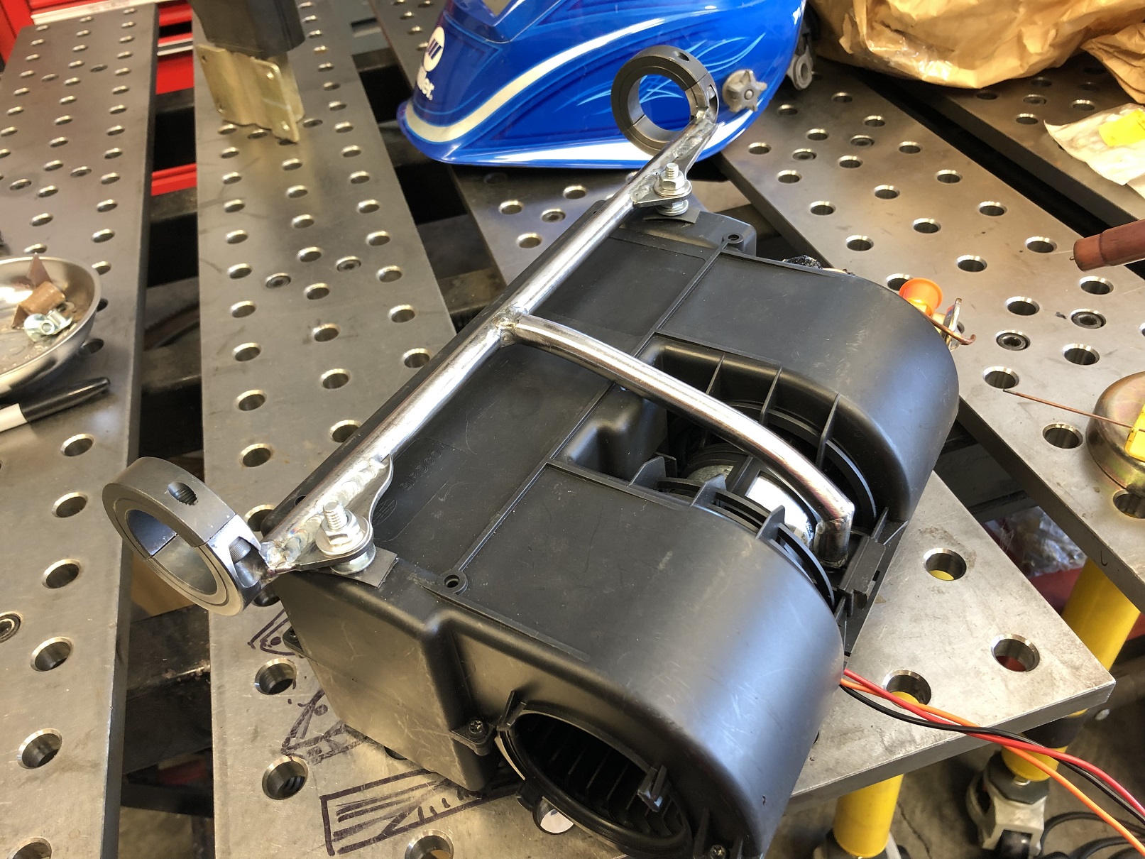

tygaboy
post Aug 17 2019, 01:42 PM
Post #1817
Posts: 5,552
From: Petaluma, CA
Member No.: 19,241

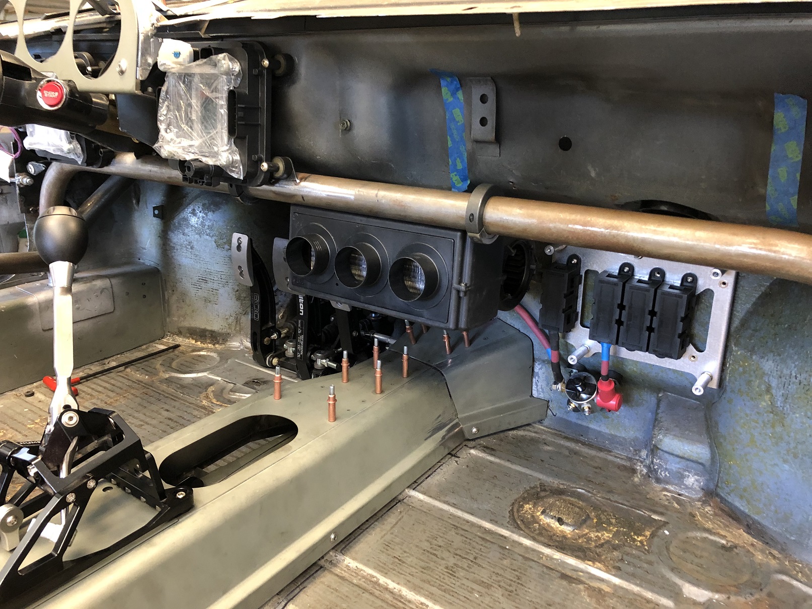

There are so many things to do and I'm all over the place, bouncing from one "to do" item to the next. I'm currently in process on probably 5-7 sub-projects.
What can I say? I'm easily distracted. Doing this seems to work for me in that it keeps things moving while simultaneously creating time for me to (re)consider the design/execution I've partially completed.
Today, it was working up a test mount for the A/C unit. After hours of trying to work out some super duper cool, stealth location, I decided I was overthinking it and opted to mount it where it'll likely work the best without me having to try and invent a completely new housing and fan set up. Of course I reserve the right to do that in the future. (IMG:style_emoticons/default/happy11.gif)
Again, this is a test mount that can be slid around on the front hoop to let me work out where the A/C unit will end up. I'm aware it isn't well engineered. Once I finalize the location, I'll probably add tabs and mounting points that eliminate this whole contraption. And if I do keep it, at the very least, I'll add a mount at the rear that ties to the chassis.
Andyrew
post Aug 17 2019, 02:41 PM
Post #1818
Posts: 13,377
From: Riverbank, Ca
Member No.: 172
Hows the footroom there?
Not a bad spot assuming you have ample foot room. Even would work as a decent foot rest.
Love the mount (IMG:style_emoticons/default/smile.gif)
tygaboy
post Aug 21 2019, 10:15 AM
Post #1819
Posts: 5,552
From: Petaluma, CA
Member No.: 19,241
QUOTE(Andyrew @ Aug 17 2019, 01:41 PM) *
@Andyrew - That picture isn't giving a good sense of how the unit fits. The good news is there's no problem re: foot room for either driver or passenger. Still some fiddling to do but it seems like it'll work just fine in this general position.

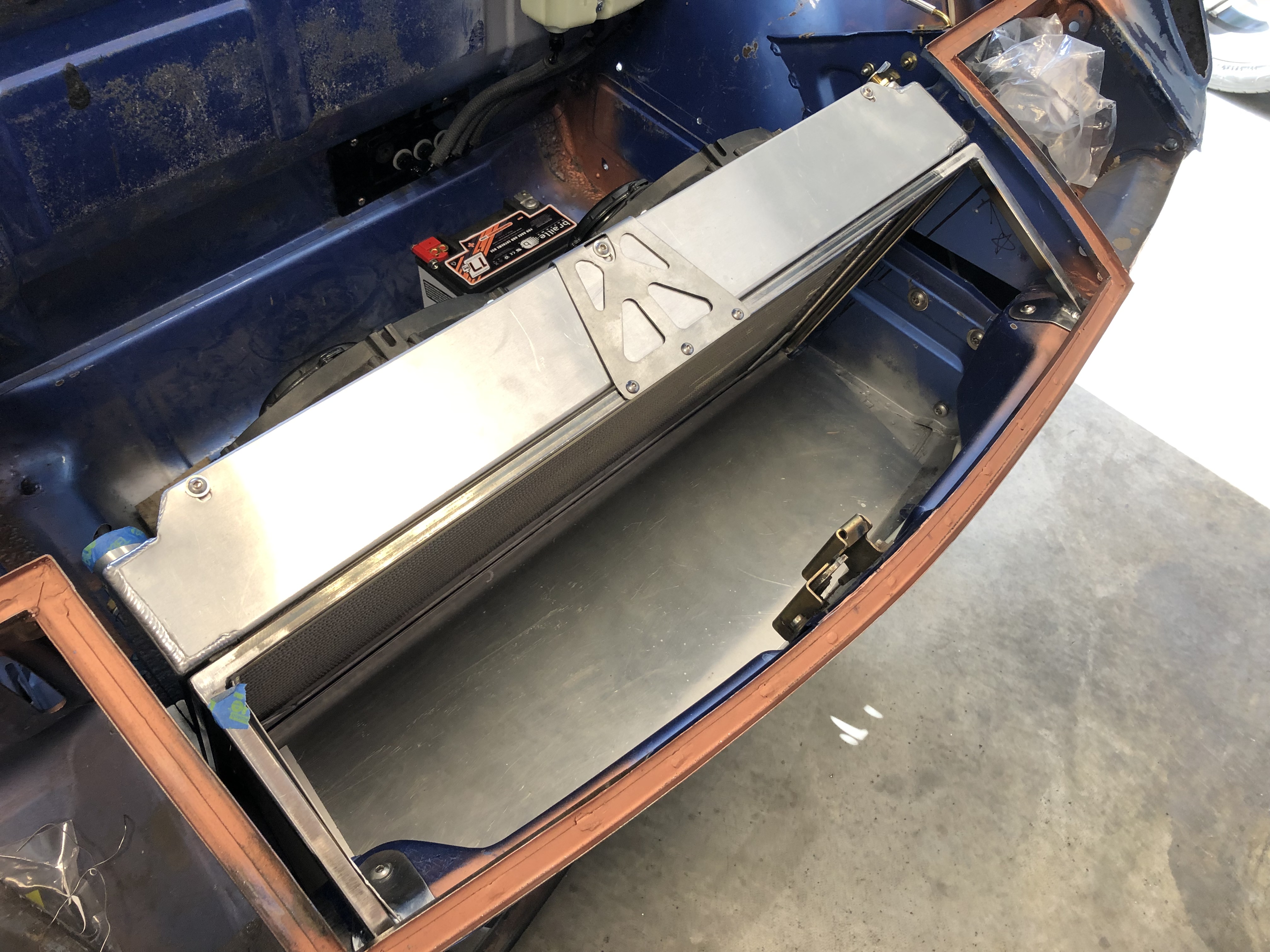

tygaboy
post Aug 21 2019, 10:17 AM
Post #1820
Posts: 5,552
From: Petaluma, CA
Member No.: 19,241
With the radiator support all done, I started on the shrouding.
First, it was working up a retaining plate. The rear face of the frame and the underside of this plate will get some rubber padding.
