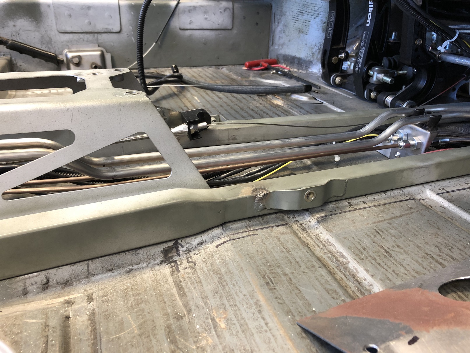

Note to self: Next time, remember to check that the cup holder clears the fuel lines before you get all excited that you got them done... (IMG:style_emoticons/default/shades.gif)
Yep, had to make new ones with a few fancy bends. We now have clearance, Clarence.

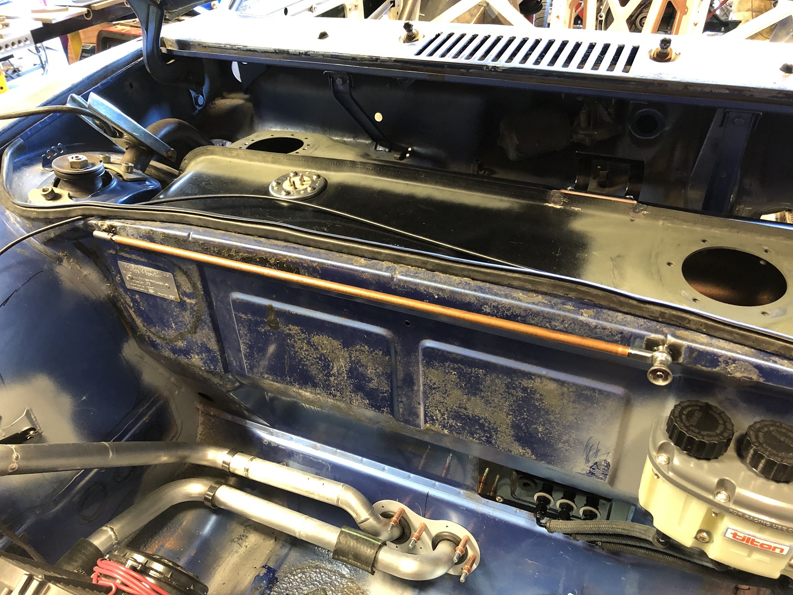

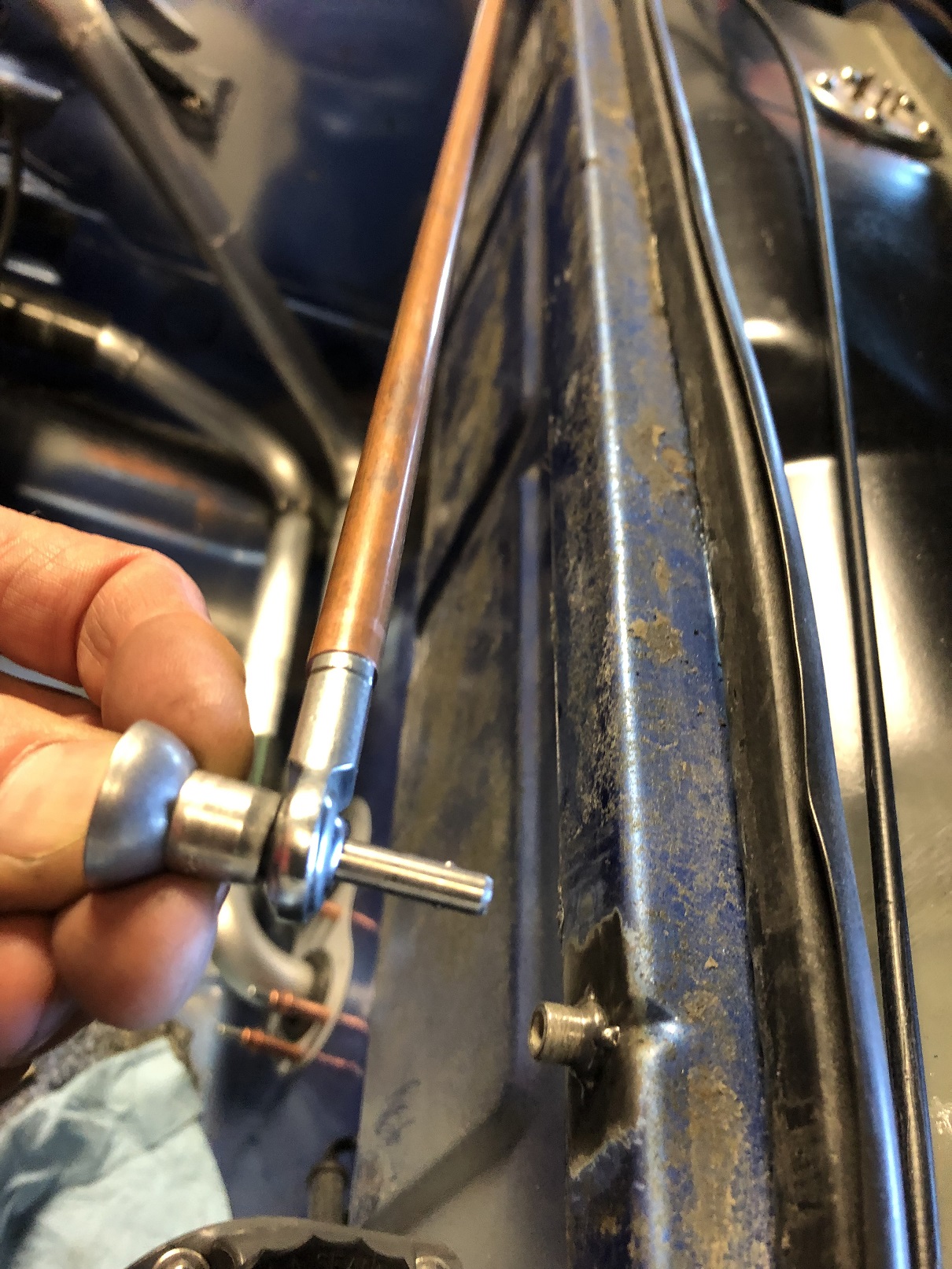

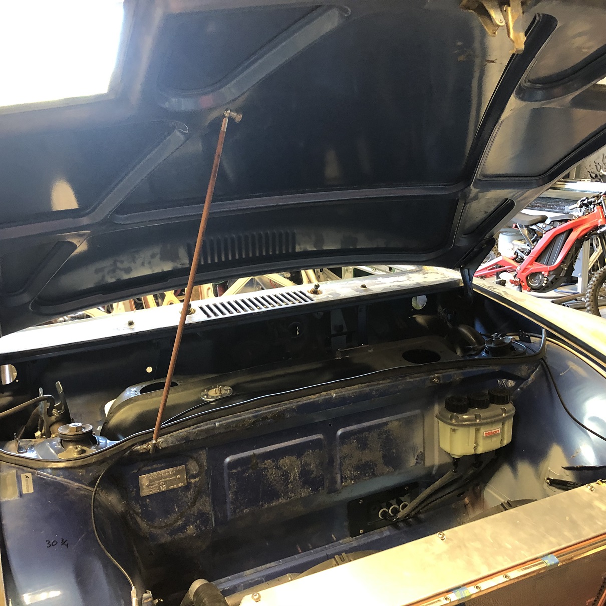

Member No.: 19,241

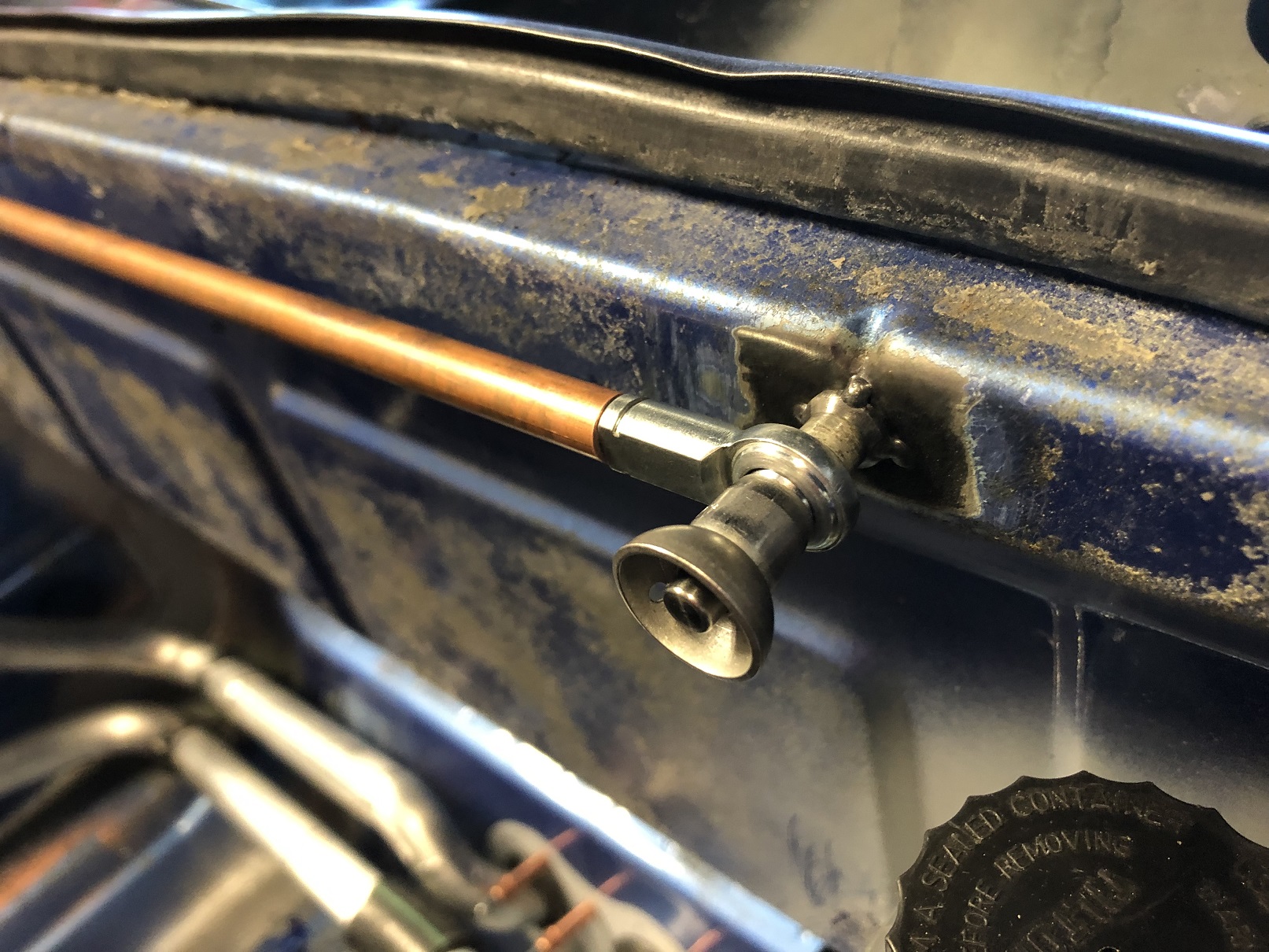

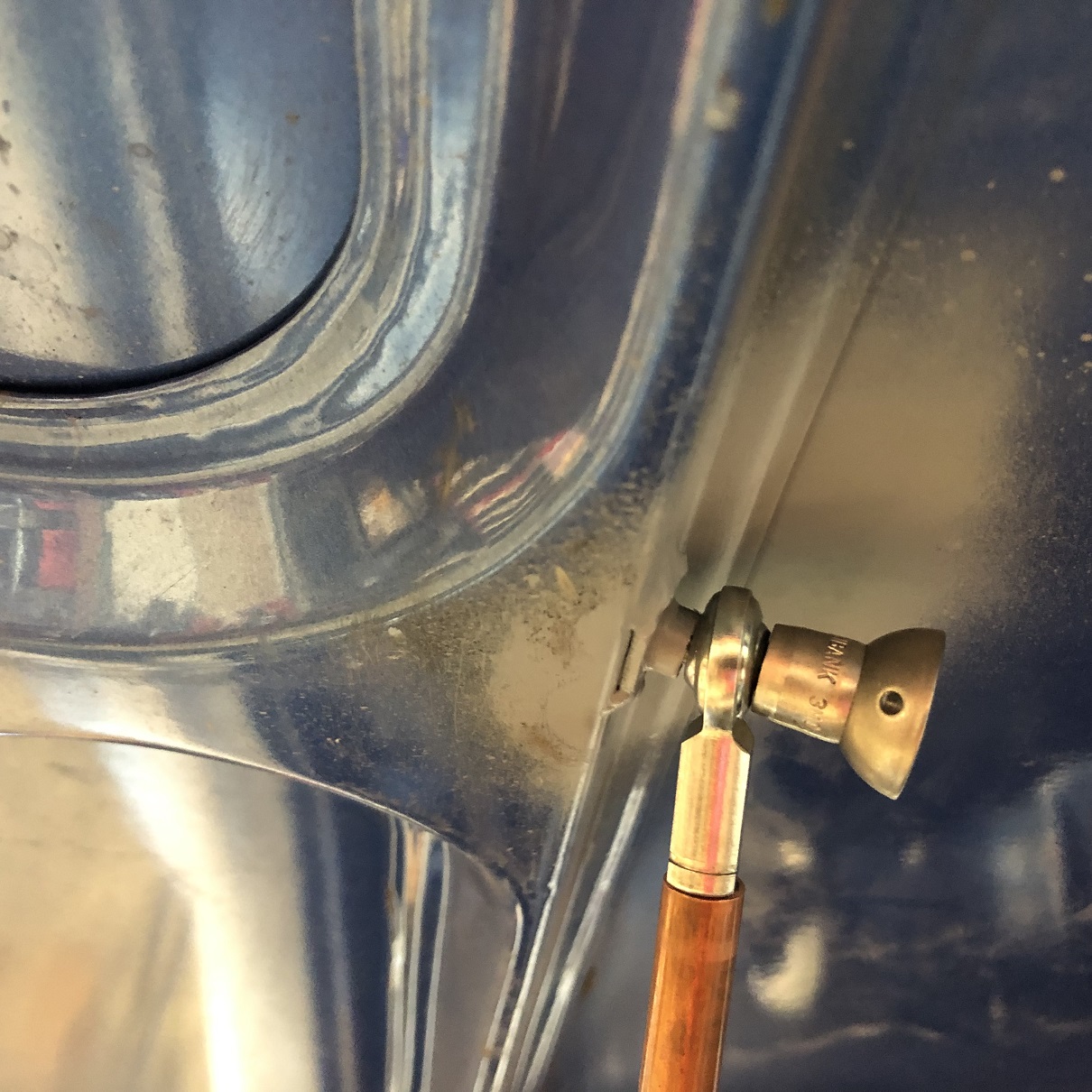

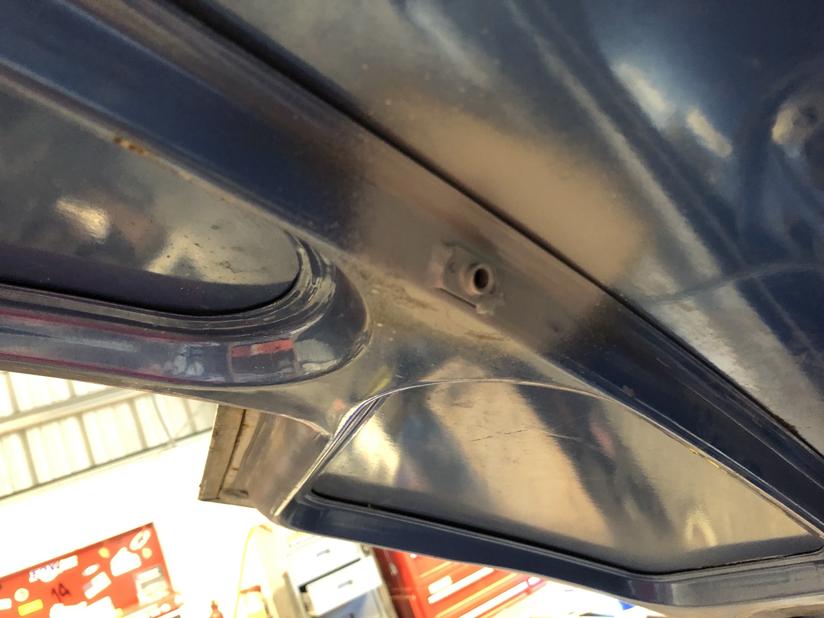

I wanted to do away with the hood springs so I needed to come up with a prop rod set up. In looking at what I've seen others do, I didn't like what seemed to be just a rod with a rubber nub on the end. Seems to me that if you were outside and a gust lifted the hood, the rod would fall, the hood would drop, etc.
So I came up with what I think is a neat solution:
I used a pit pin and welded an appropriately deep boss to the fire wall and one to the under hood bracing.
A quick press on the button and the pin pulls out. Swing the rod up and use the same pin to attach the prop rod to the hood.
Windy day at Cars and Coffee? Not a problem for me!
And that's a copper tube over 1/4" aluminum hex. It supports the stock hood with no flex. If I get a composite hood, I can remove the copper and just run the aluminum.

Ooh that's clever! The copper rod is going to get confused with wood pretty often. That's a nice looking piece!!

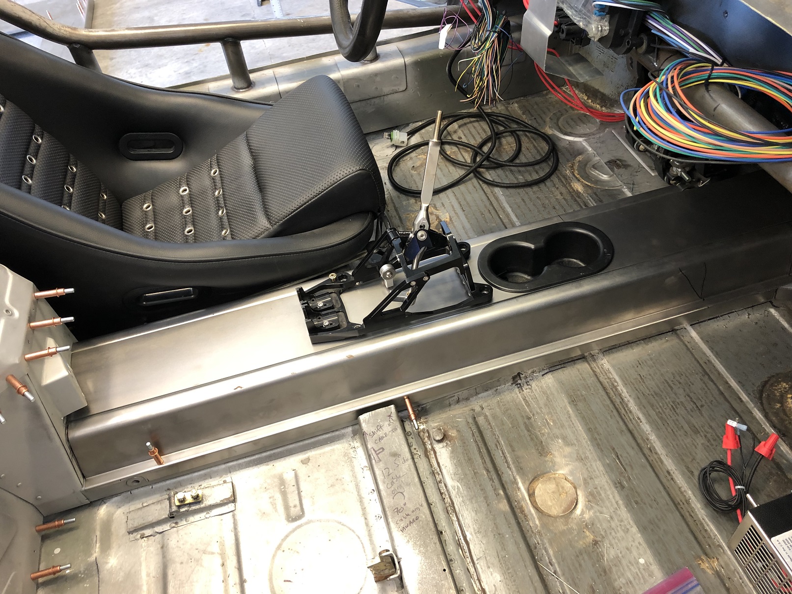

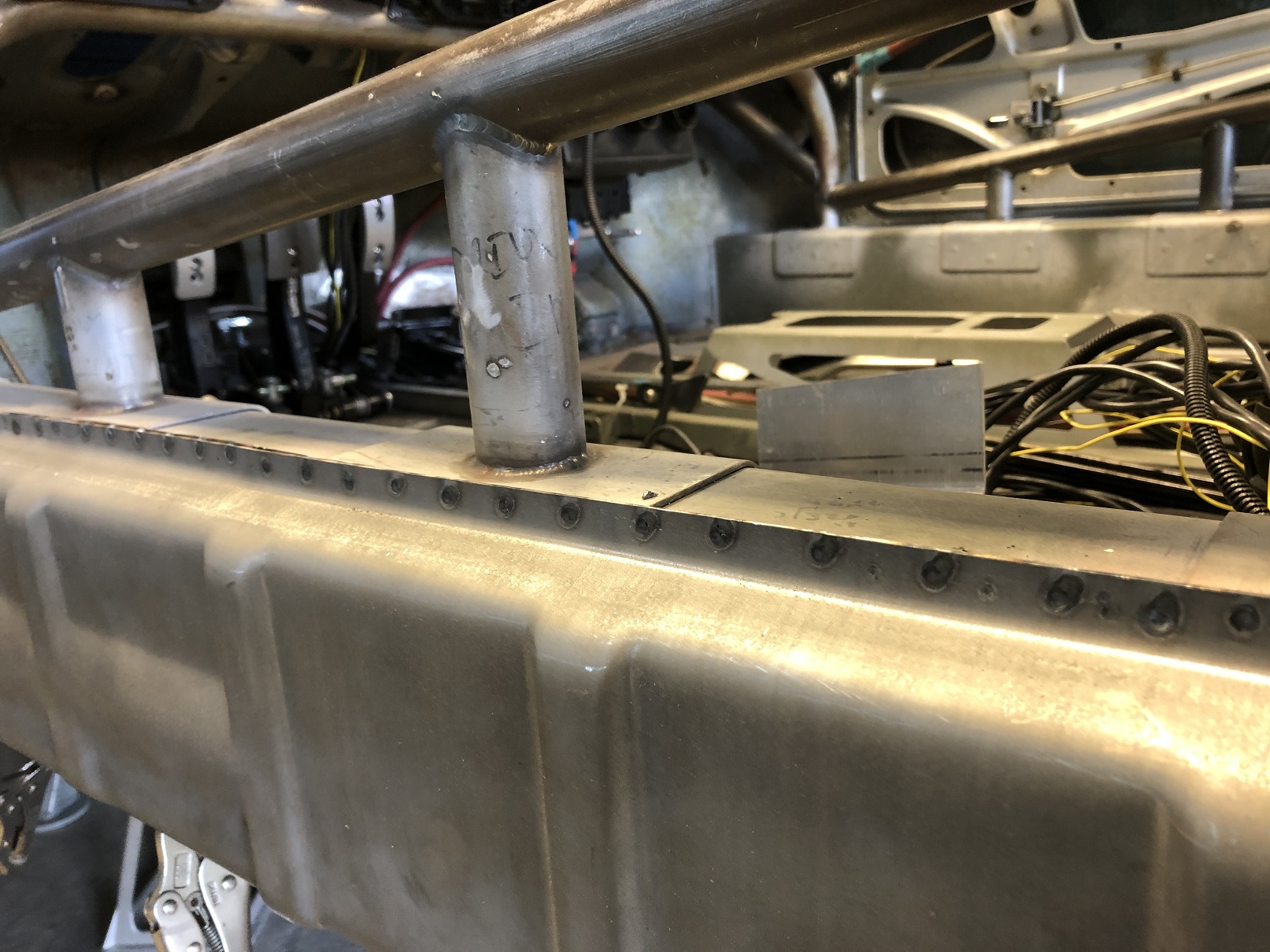

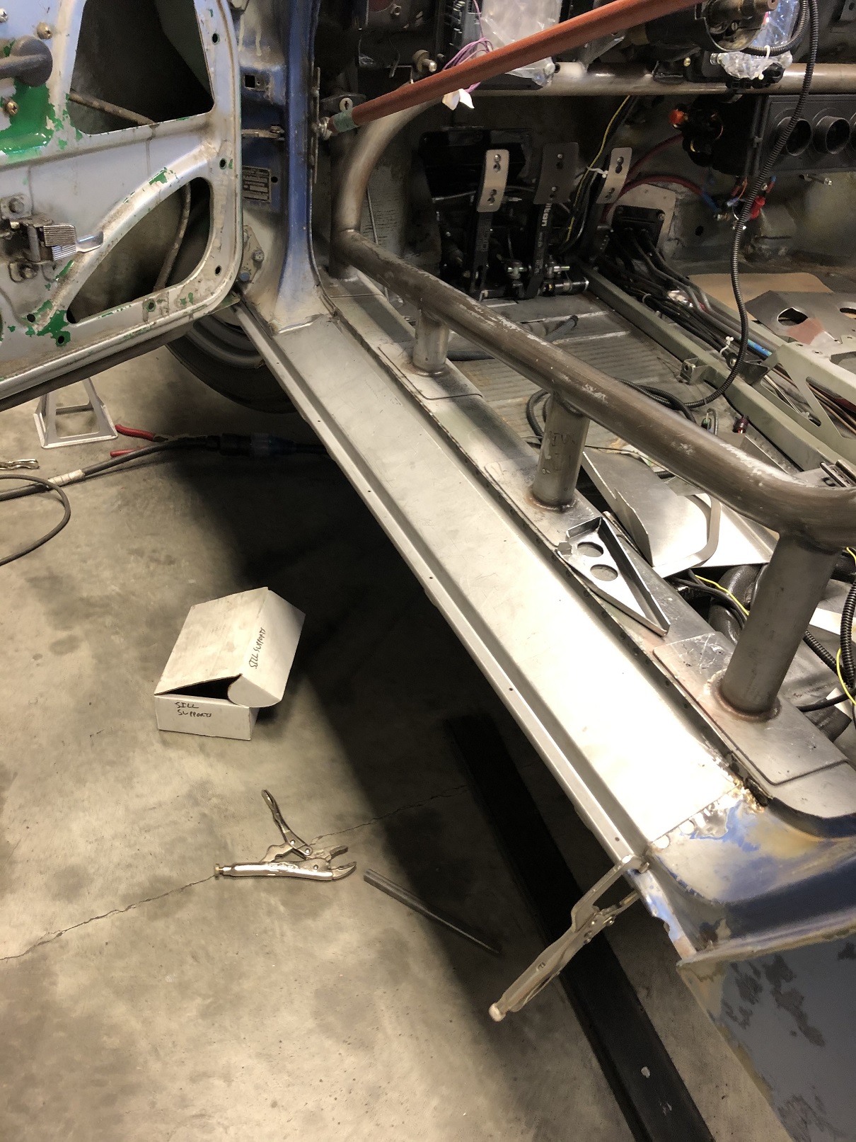

I decided to install the inner rockers. Mine had been cut up a bit so I figured now was as good a time as any.
Anyway, it gave me a chance to use the spot welder.
Holy Moley, is this WAAAAY better than drilling and plug welding! No spatter, no temptation to grind, etc. Almost looks factory.
@914forme , @Andyrew - You NEED one of these!
If anyone local to me is planning any repairs that could use this, do yourself a favor and borrow this thing! PM me if you're in need...

Nothing like new metal. This after many years of no sill plates. Major milestone!

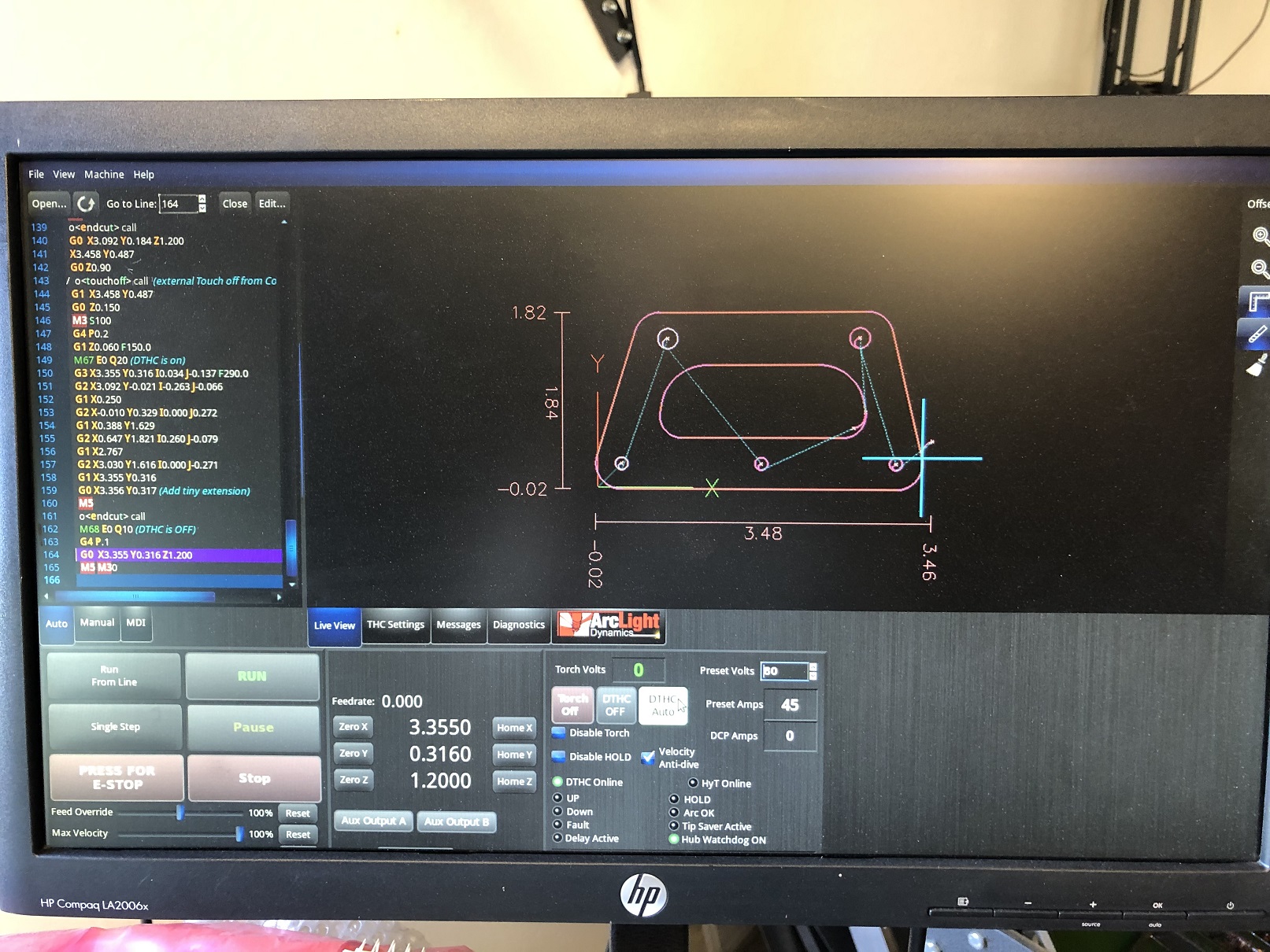

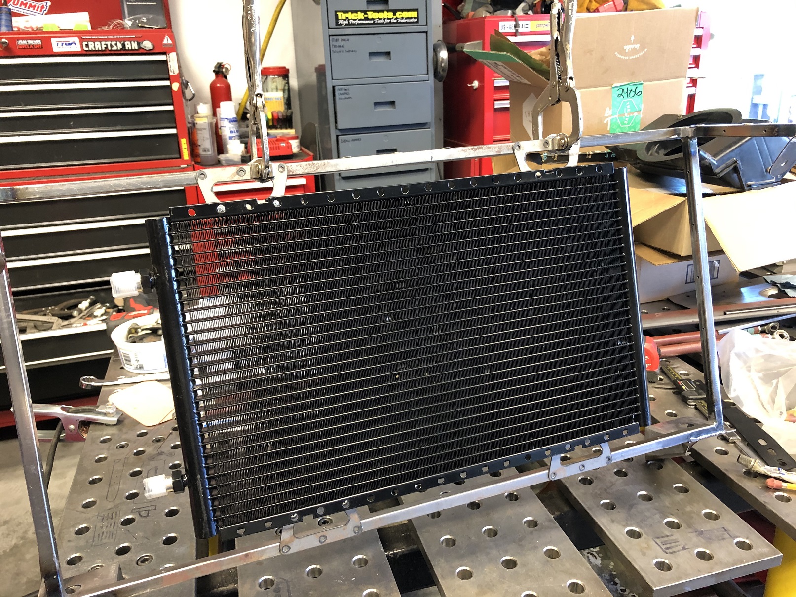

I was about to send a few pieces out to powder coat but, thankfully, remembered I needed to add brackets to the radiator support to attach the A/C condenser.
A few minutes designing and cutting and things are ready to weld.

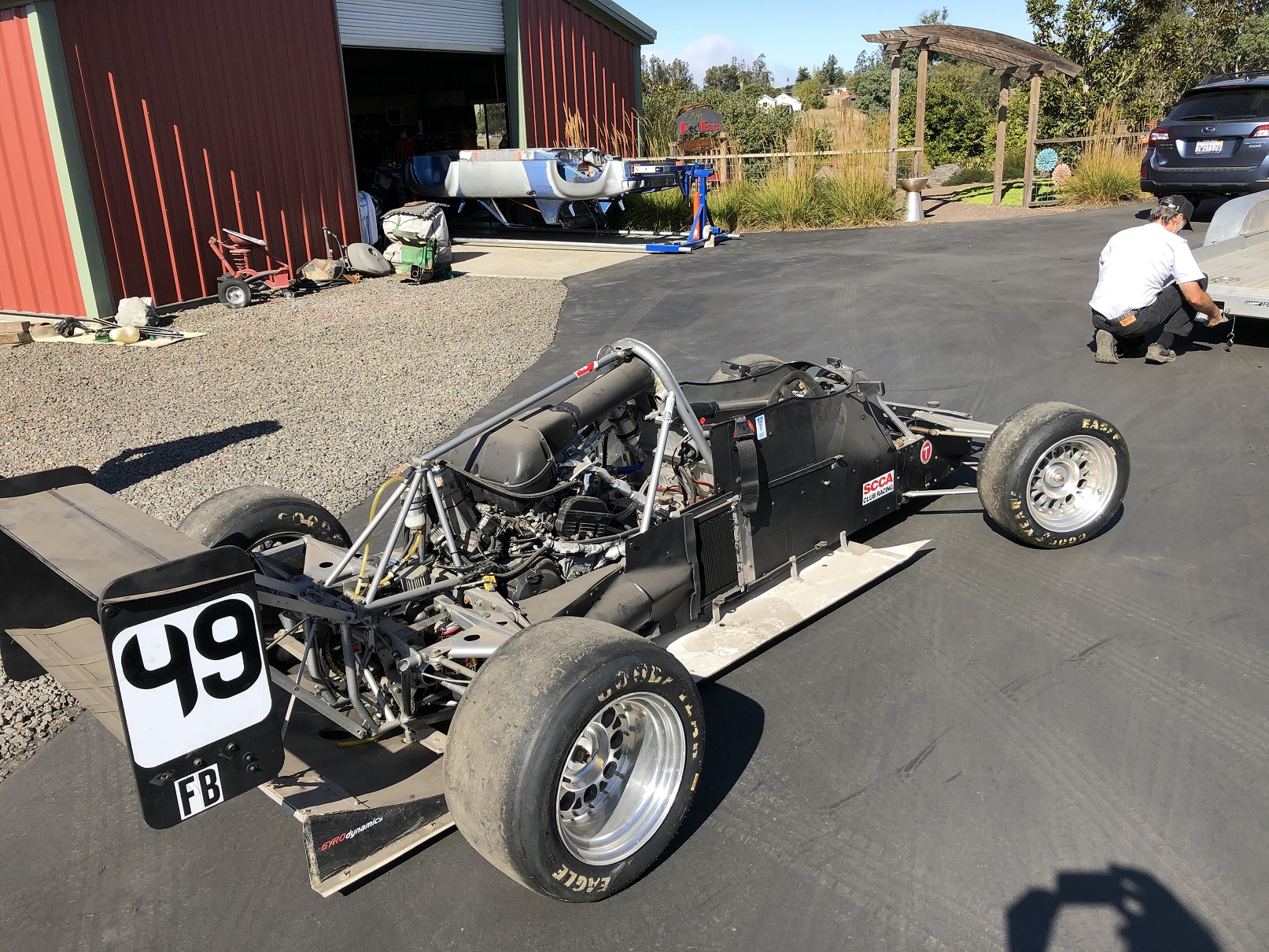

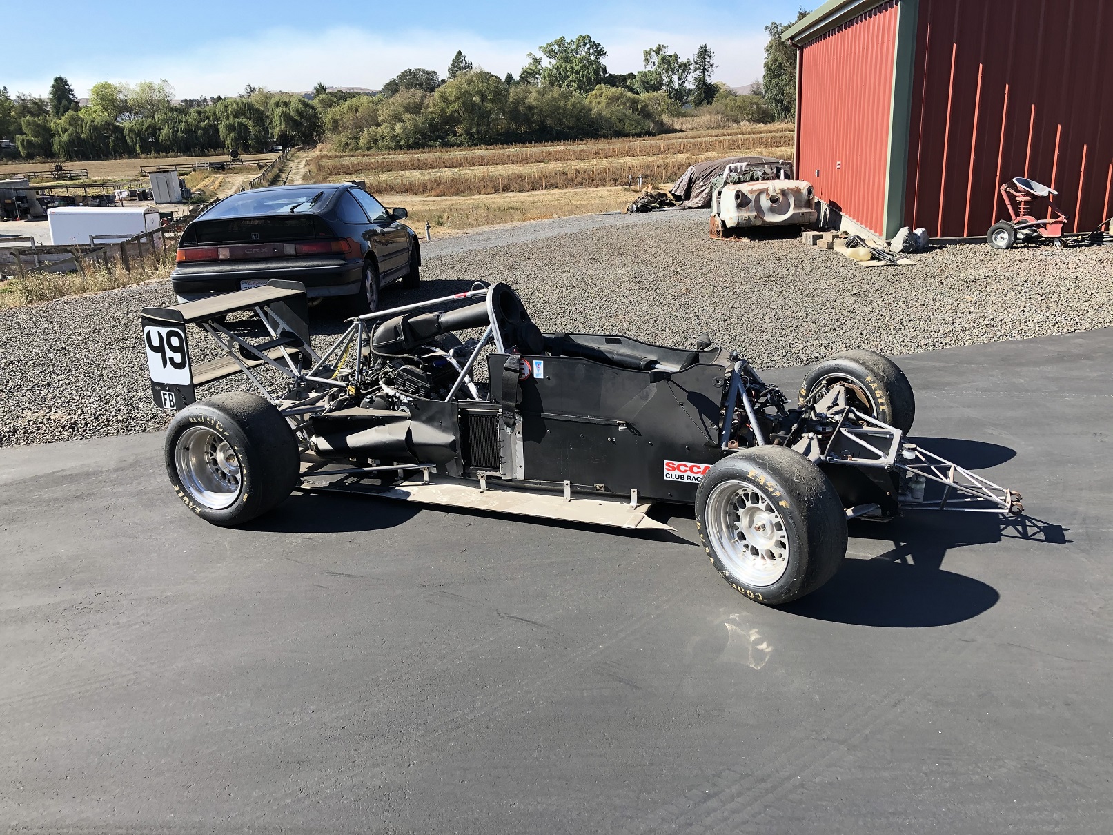

This is an '84 Reynard Formula Ford that was converted to DSR and then to Formula 1000. At this point, it's woefully less than competitive in any of these classes. I'll be helping convert it into something else... More on that as progress is made.
I am making solid headway on the 914. It's back on the rotisserie to ease completion of the rest of the chassis welding, flares, etc.
