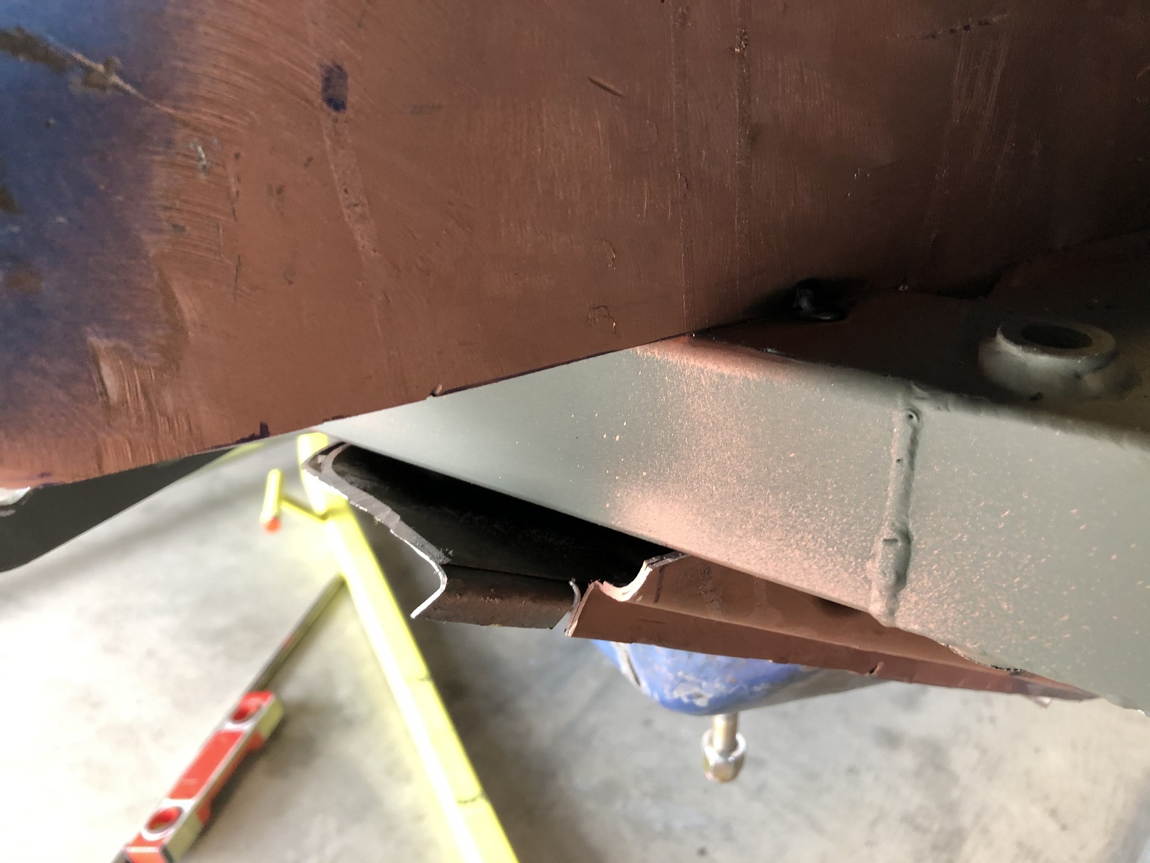

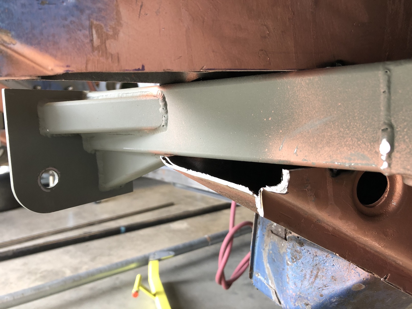

I fixtured the new mounts in position, got the measurements set and tacked them in.
But in order to get the trailing arms in, this overhang has to be removed. I kept wondering why the arm wouldn't go in...
What I had yet to cut:
post Nov 12 2019, 03:49 PM
Post #2002
Posts: 5,552
What it looks like after trimming. Essentially, just cut in plane with the rear face of the mount.

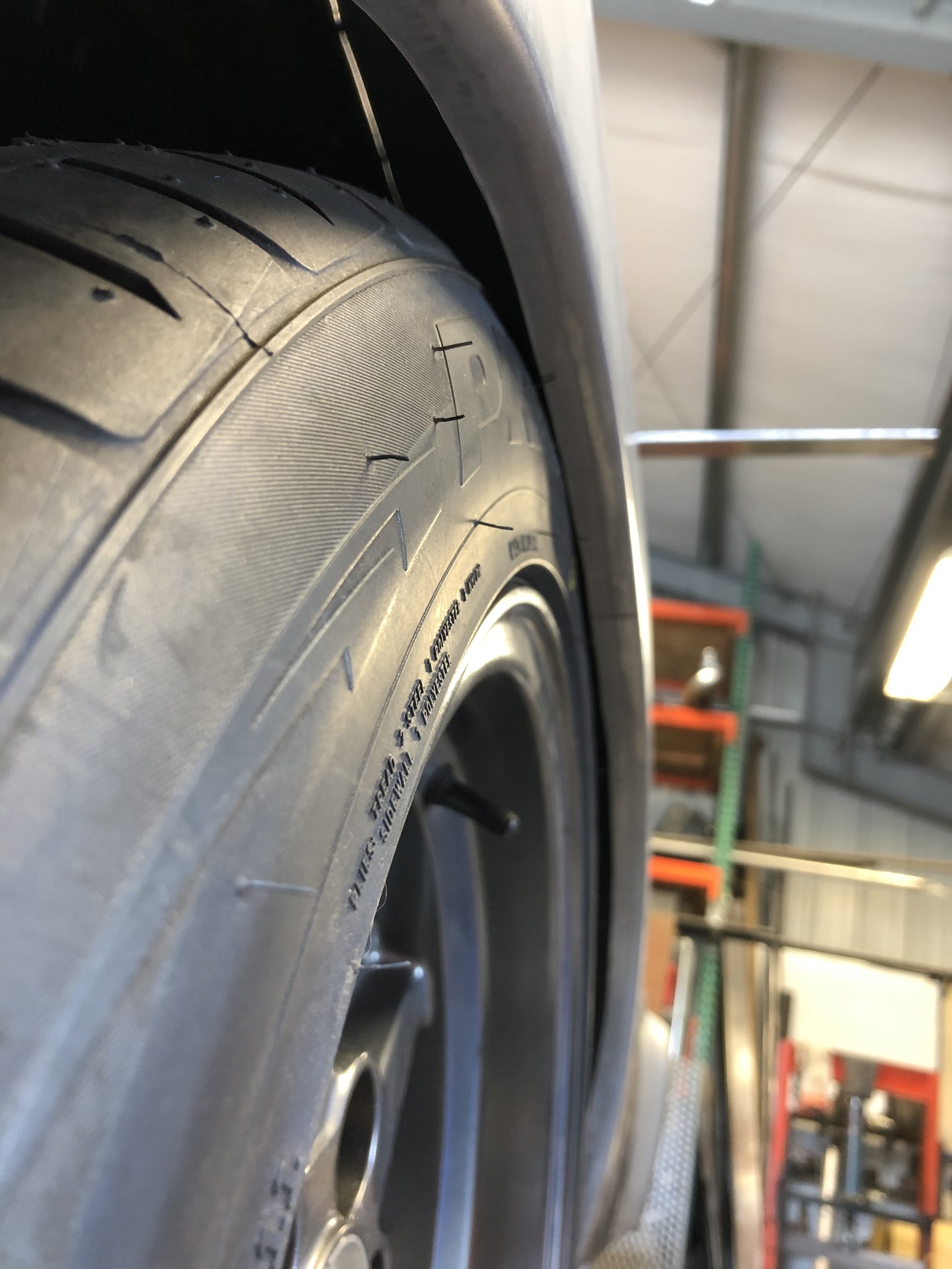

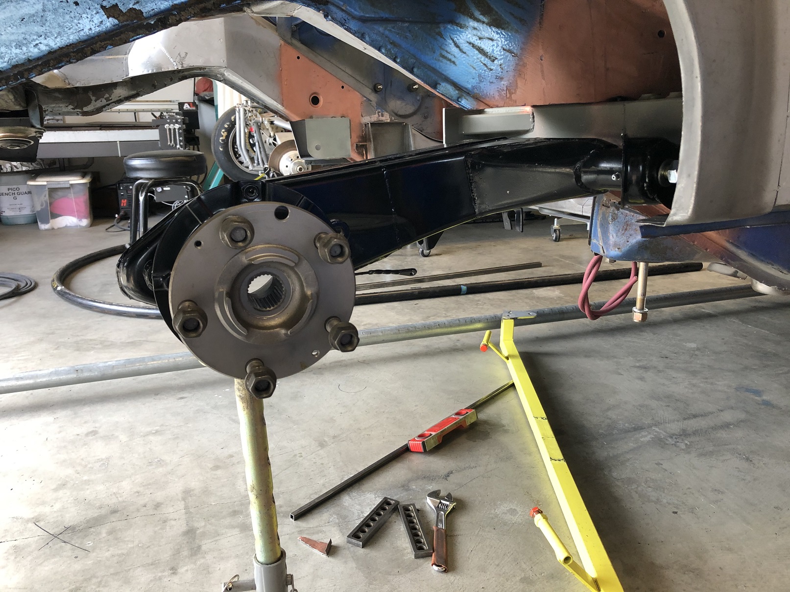

Arm fitting.
Lesson learned: if you're doing this mod, wait until it's complete BEFORE doing your flares.
I'm chasing getting the wheel centered in the flare... (IMG:style_emoticons/default/headbang.gif)
Another fun fact: The mounts get welded to the outside of the longs, where they taper in towards the back of the car. So as the mounts are moved fore and aft, the track width changes.
The good news is a rough measurement shows I have 2 degrees negative camber with no shims.

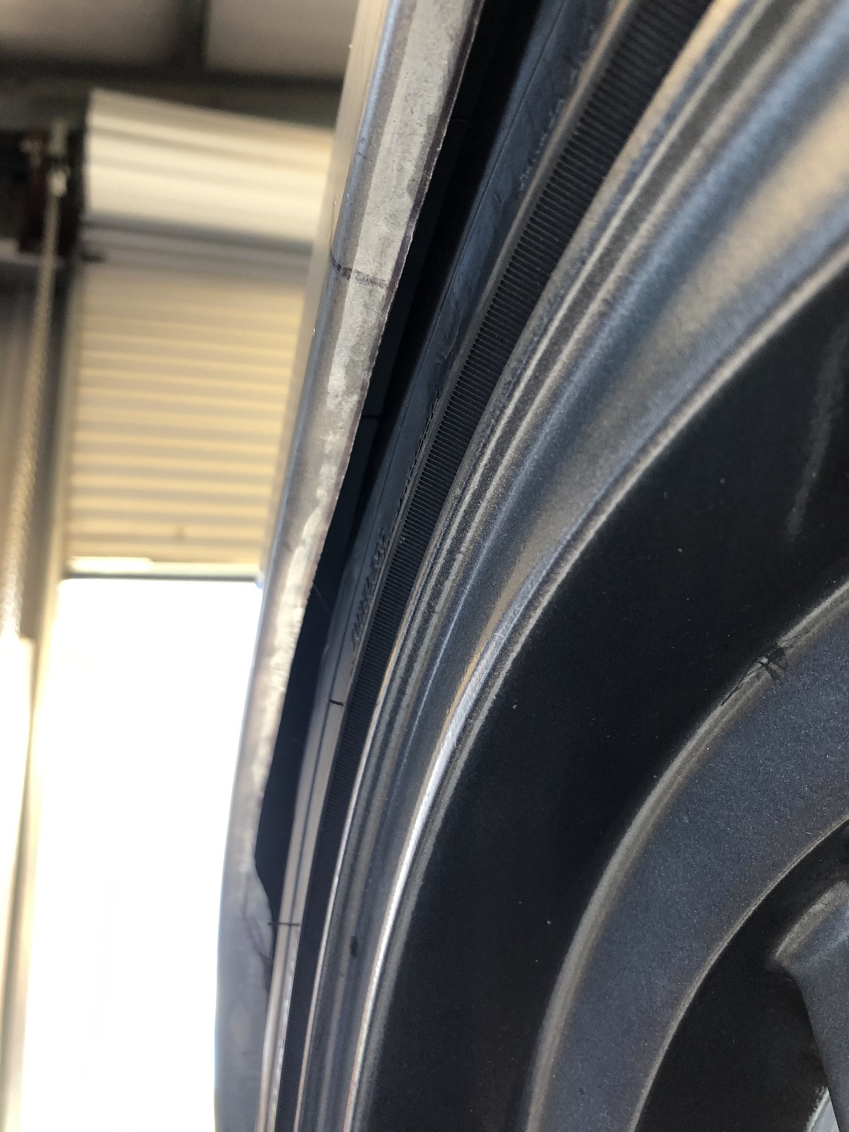

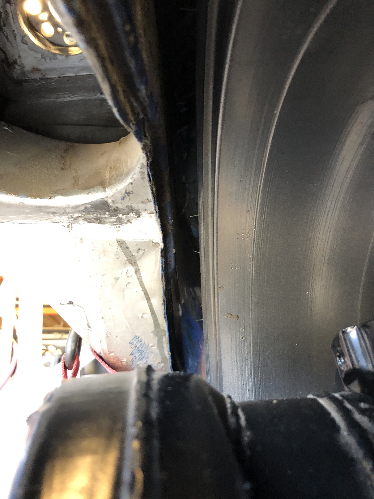

With my wheels (16x9 w/245s), the pic shows where I am at this point. The tire does clear, it's just REALLY close.
Plus, I need the wheels to move forward about .4 inch. I think I can make it work by trimming away about 1/2 the return on inside edge of the flare.
If not, I'll need to remove material from the inside of the pick up mount, where it meets the long. Or do both.
Either way, I'll make it work. Just means more time spent.

Trim the lip.

I think I would try to roll that part of the lip so you keep the material and strength. (IMG:style_emoticons/default/beerchug.gif)
Are those THE wheels? You could have 1/4" machined on the inside. I assume you have well over an inch on the inside for clearance? You pretty much need about 1/2" of room to allow the tire to flex. 1/4" with lower profile and stiff sidewalls.
Granted that inner lip on the fenders is a hair excessive. .
Pretty cool you got it this close on your first try (IMG:style_emoticons/default/smile.gif)

QUOTE(tygaboy @ Nov 12 2019, 03:02 PM) *

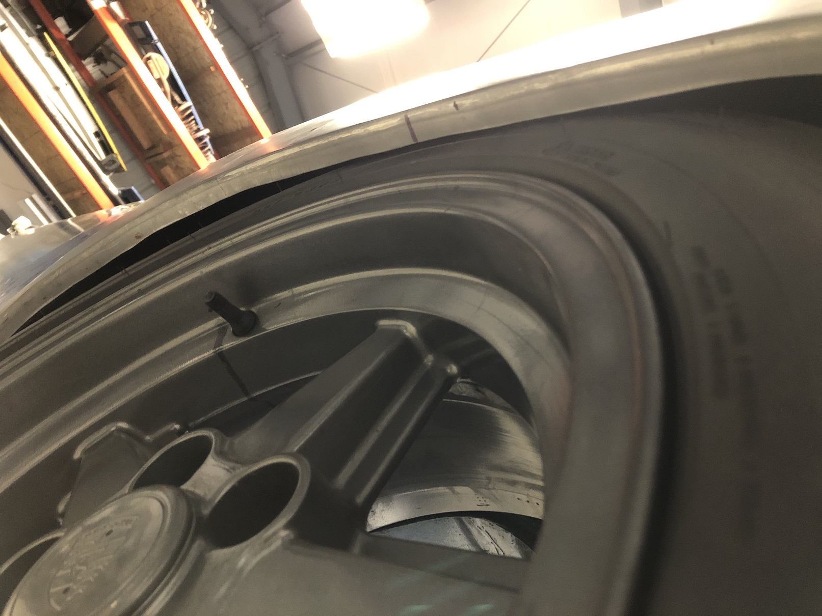

Is that the fit up with 2 degrees camber? At ride height?
My friend had a shop install his flares, and they rolled that inside lip around (I believe) a 1/4" rod, which yielded significantly more clearance.
Andys

What was I thinking? Of COURSE it was going to take me multiple attempts before I got it right! Why would this be different from any other part of this build? (IMG:style_emoticons/default/laugh.gif)
After the first couple tries, I'd built a fair bit of confidence in terms of how this all goes together, what and where the changes happen when the parts are moved around, etc.
Having established that the firewall lower cross member and tops of the engine mount plates always measured level to each other, I could use them as reference and simply work on the installation no matter what position the car was in on the rotisserie.
I just had to get a measure of either of those and use it as the target # when "leveling" the tangerine components and fixture in the chassis.
So after some careful measuring, a bit of math and remembering that 1/2 the time the car is upside down (wait, which side am I working on? (IMG:style_emoticons/default/blink.gif) ) I got attempt #3 positioned, leveled and tacked in.
I also trimmed the inner edge of the flare. I had my fingers crossed there'd be clearance - which made installing that wheel a little harder than normal. (IMG:style_emoticons/default/lol-2.gif)
Clearance is still tight-ish on the outside with about 3/4" on the inside. If needed, I can roll the remaining flare lip as @andys mentioned or as @Andyrew suggested, mill a bit off the inside of the wheel.
I also have the option of removing some material from the inside of the Tangerine pickup, where it butts up to the outside of the long.

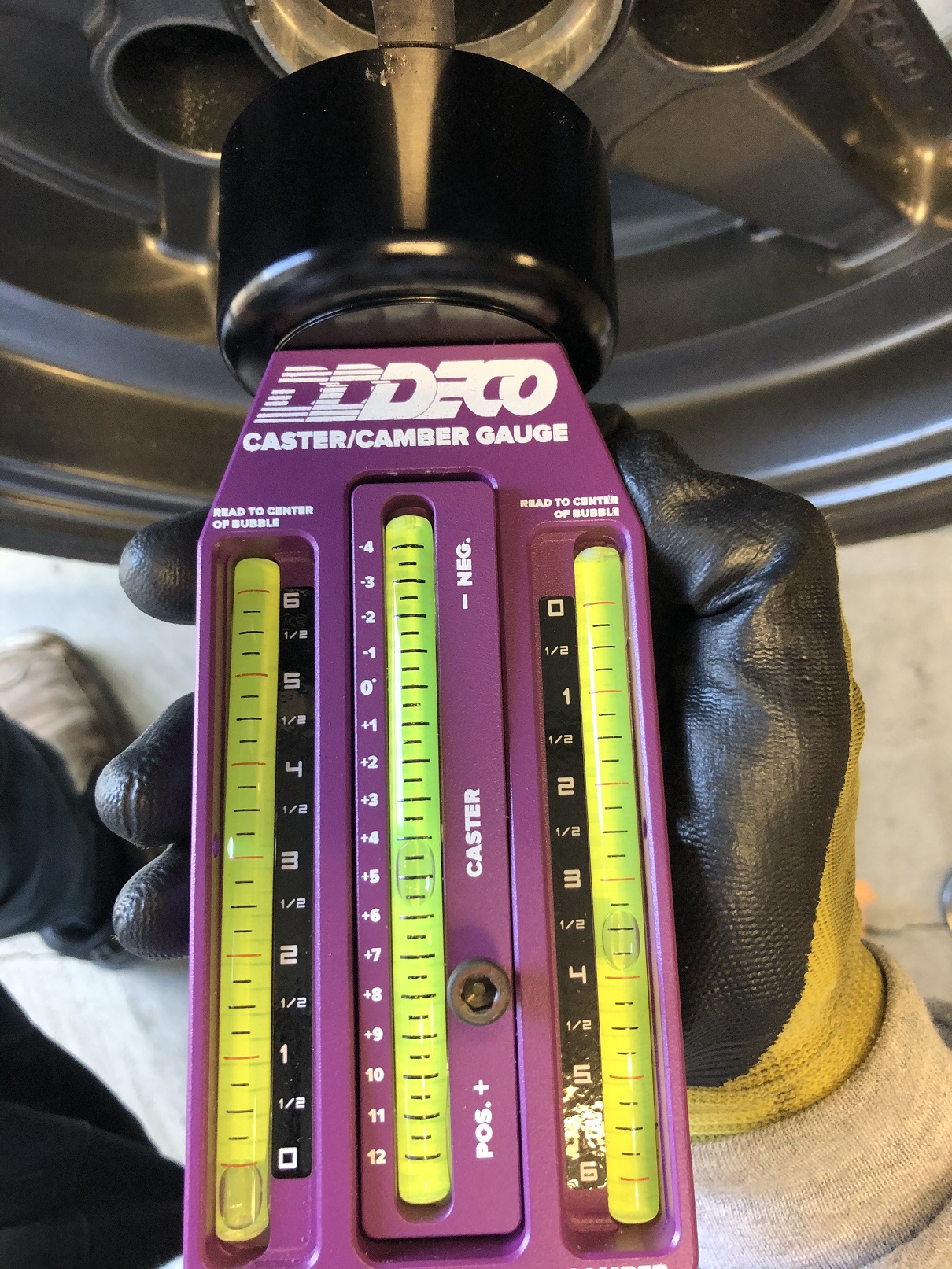

Don't overreact to that camber number. Remember, I don't always have the car at "0" level. At this point, it was at -2.1 degrees, putting my ride height camber with no shims at ~ -1.7

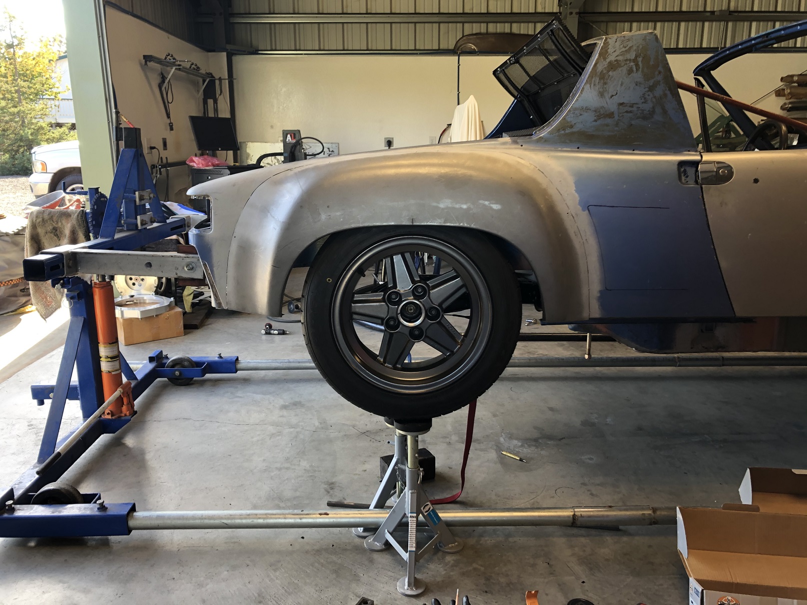

Post #2016
Posts: 5,552
And I'm happy with the wheel position in the flare opening. Wheelbase measurement spec be damned!
Actually, I don't have the front suspension on the car so can't even measure it yet. Once I do, I'll be interested to see where I ended up.
I have to say, I REALLY like these wheels on this car. (IMG:style_emoticons/default/wub.gif)
