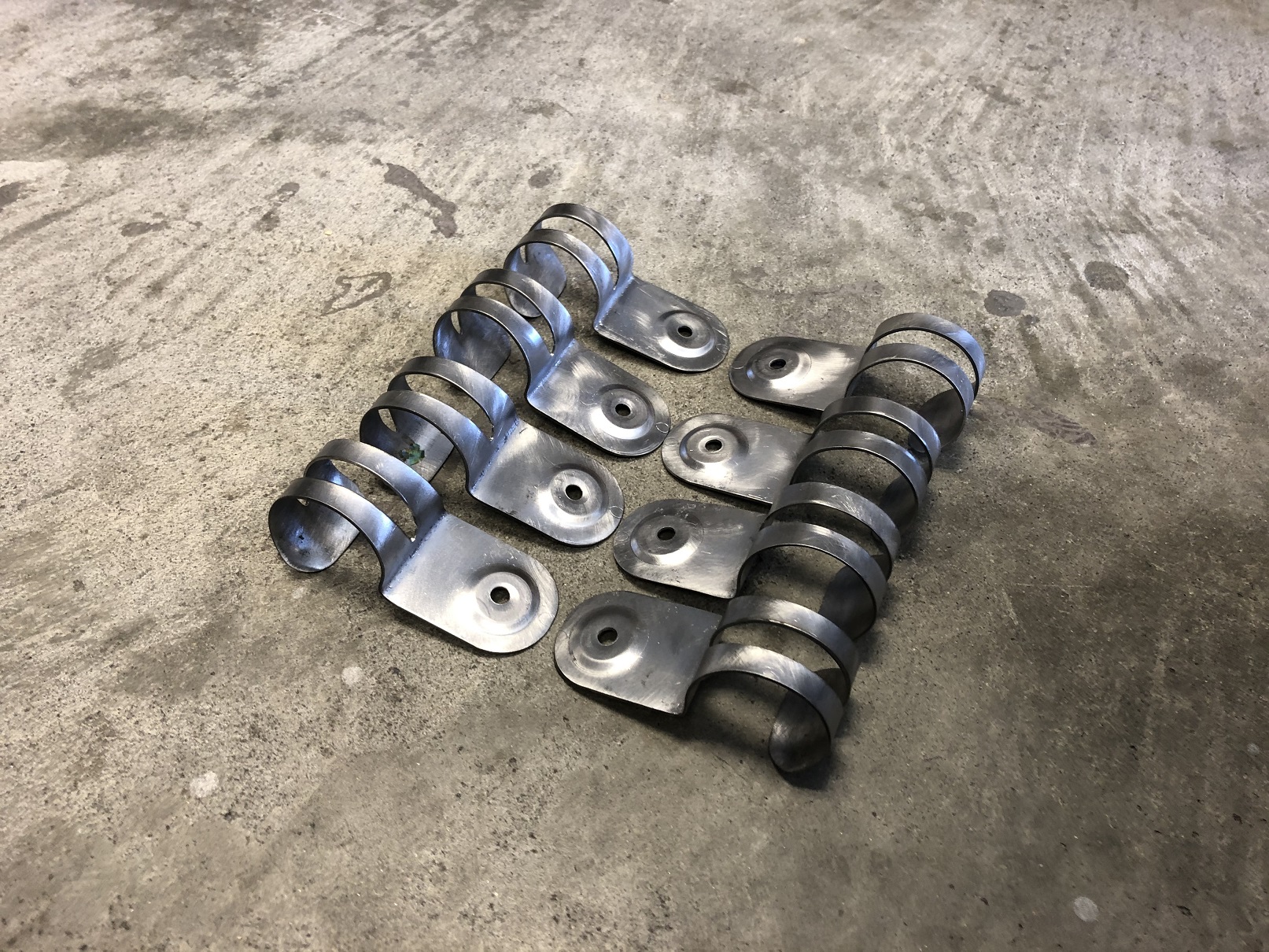

I cranked out a set of radiator hose clamps for Dwayne @djway .
Typical me; given these were the 9th - 16th time I've made these, they turned out better than the set on my car! (IMG:style_emoticons/default/laugh.gif)

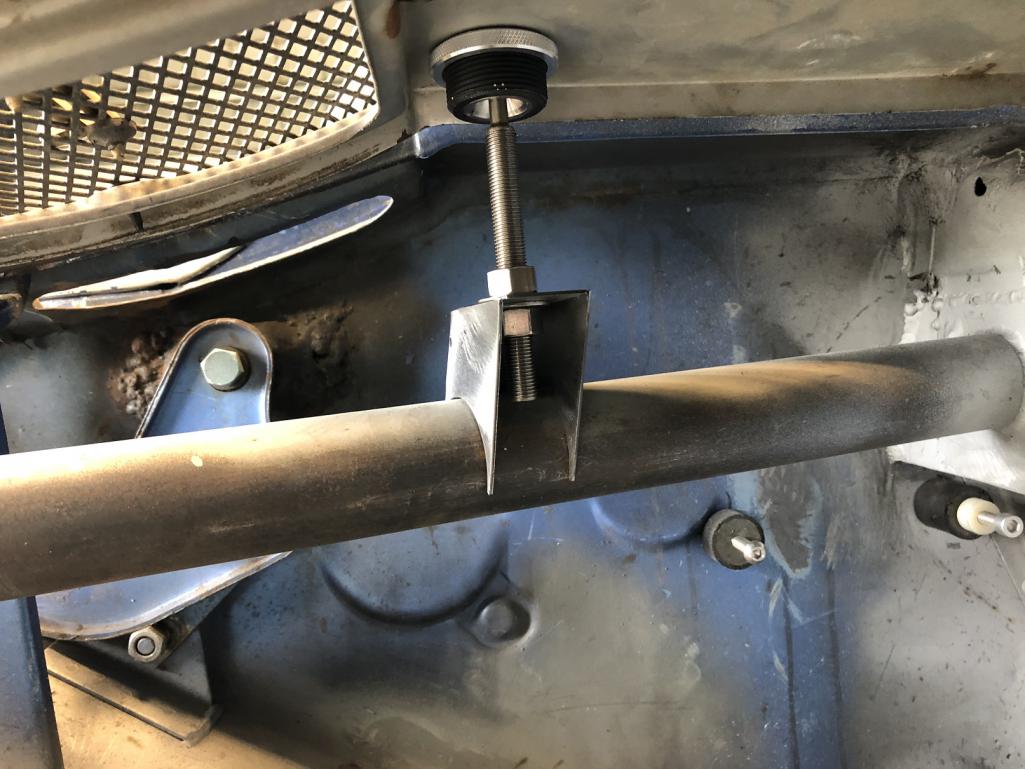

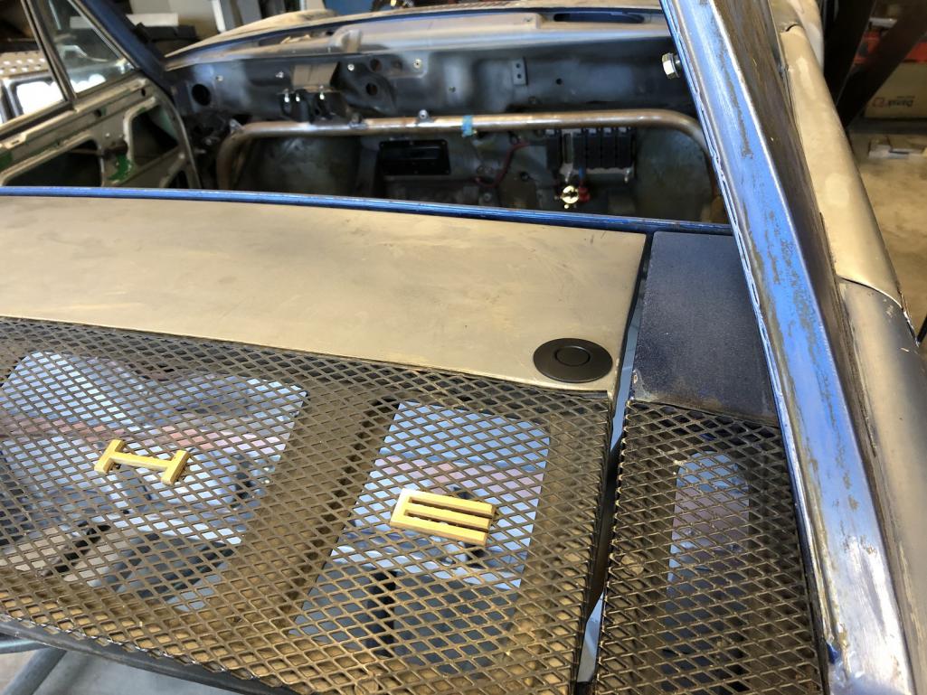

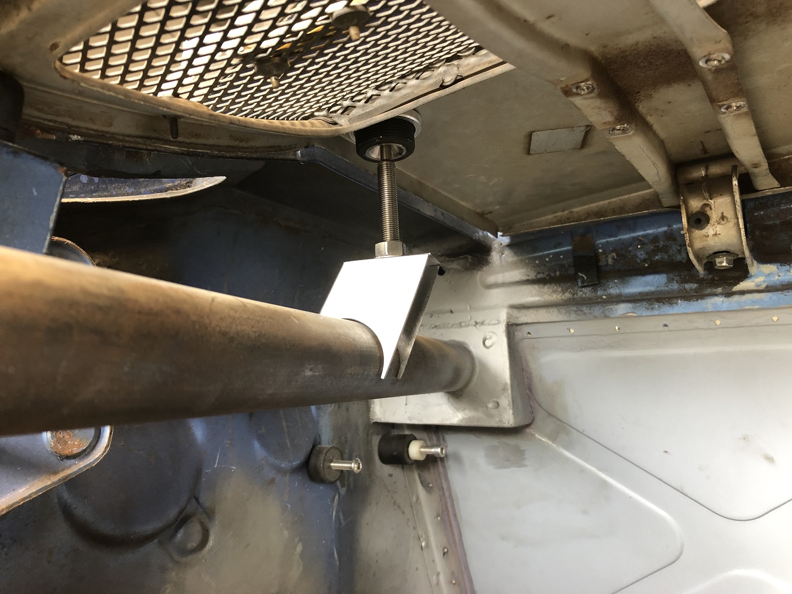

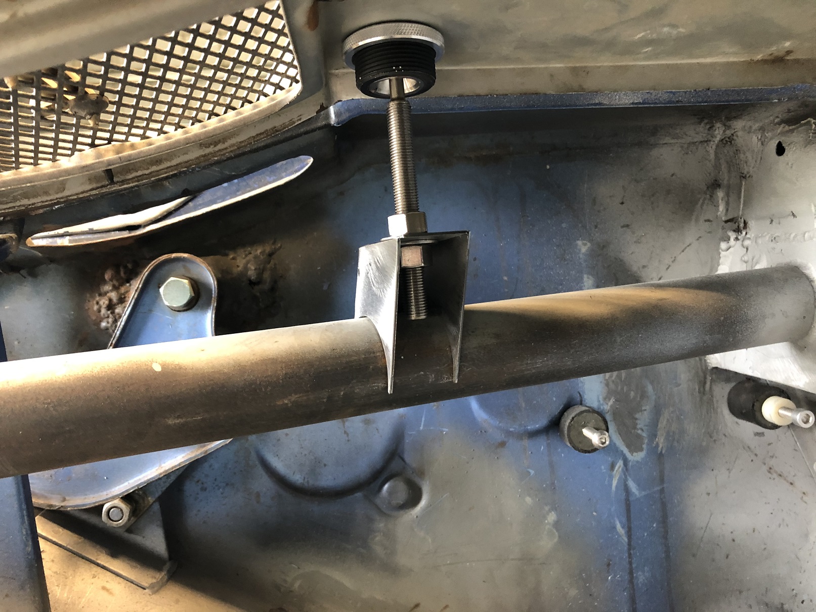

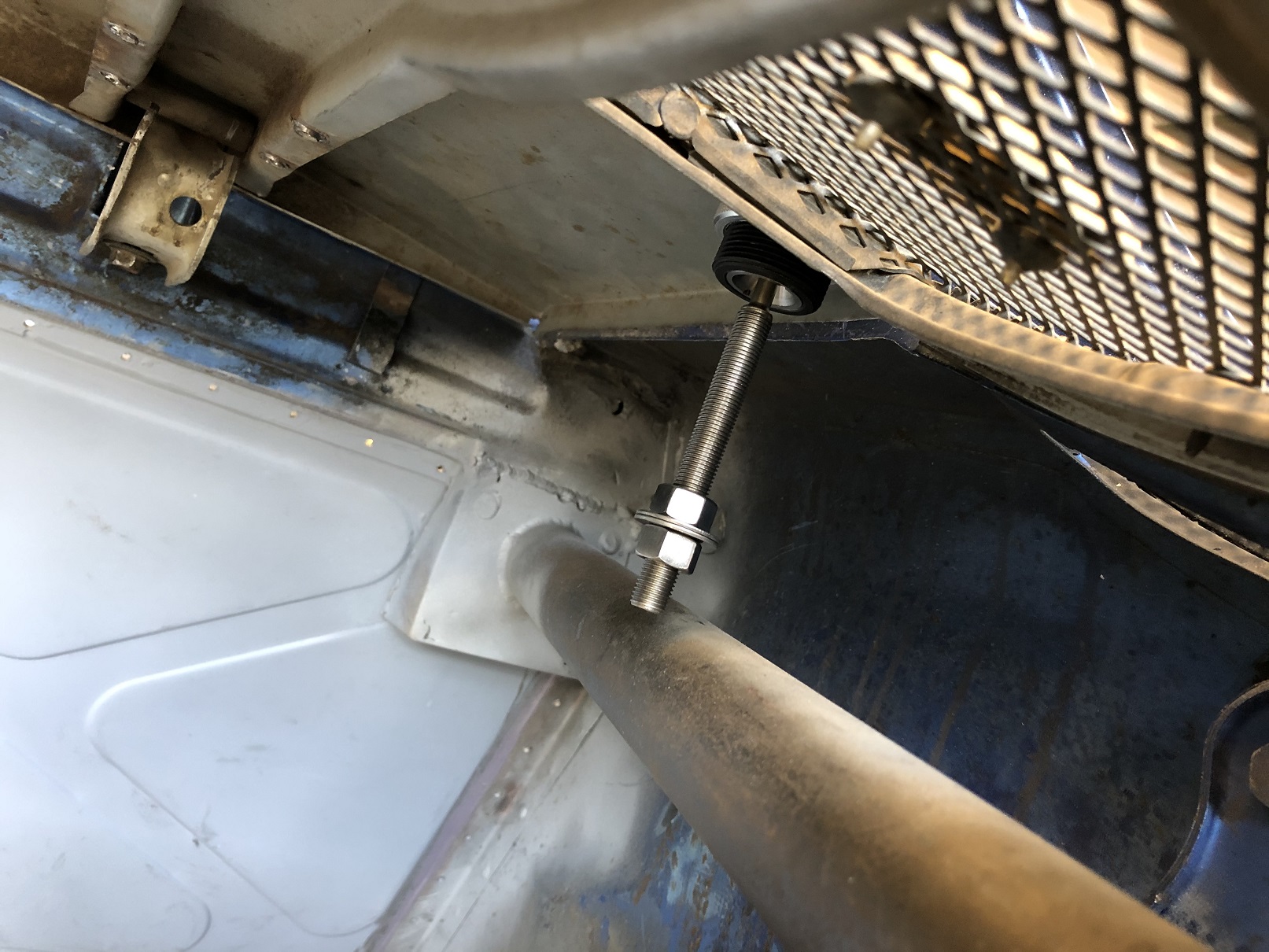

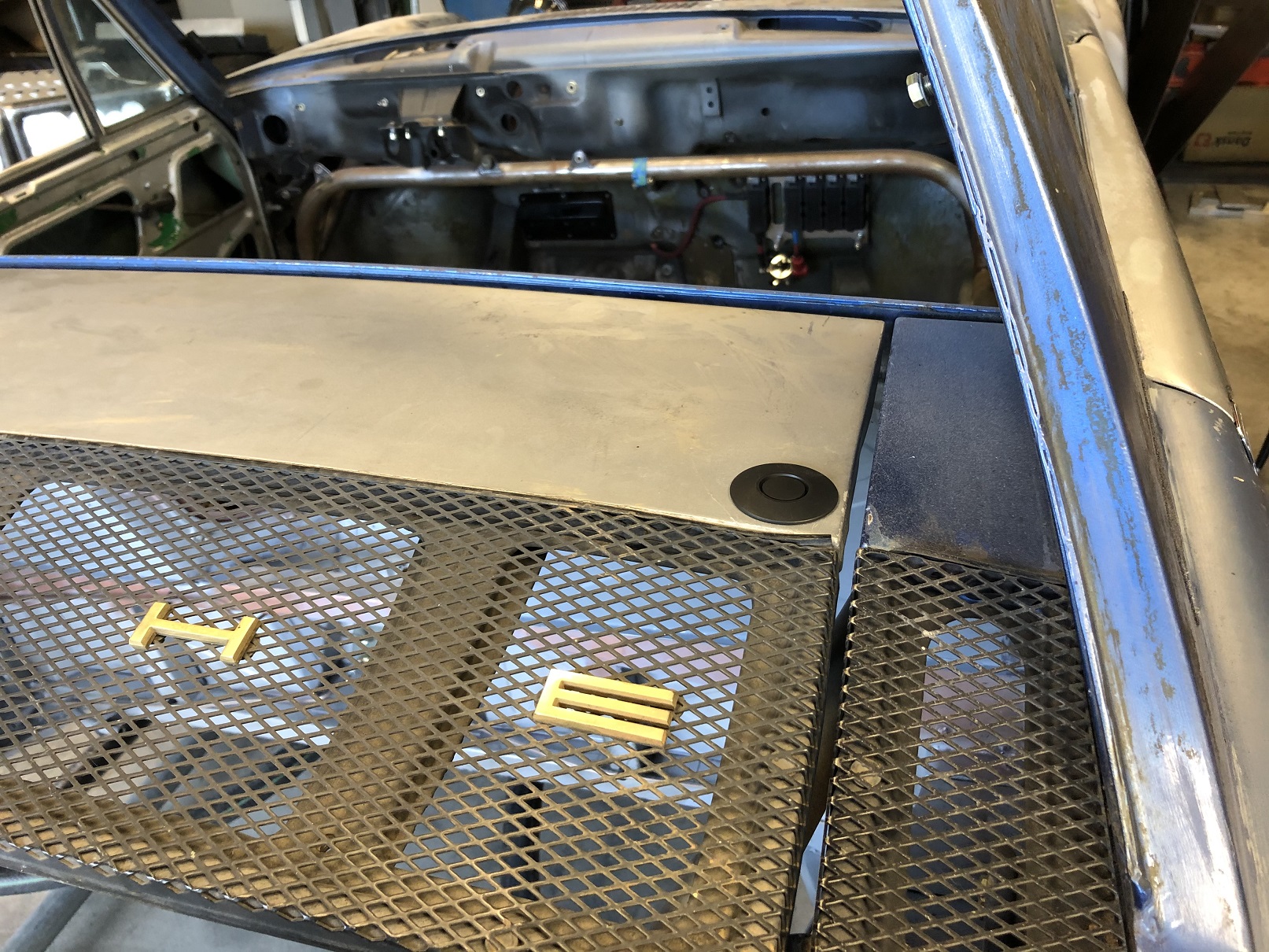

One of the joys of my build is when I start in on another area and realize, "Oh yeah. I totally forgot I'd have to figure something out to deal with this..." (IMG:style_emoticons/default/blink.gif)
Today it was the engine lid. Having cut away all the trunk sheet metal, I also lost the area where the engine lid latch goes.
I was tempted to fab a bracket that welded to the cross bar between the suspension towers but REALLY didn't want some wonky thing hanging out in space and, heaven forbid, spoiling the view of the induction system.
So... How about a Quik Latch on each side?
I have a few lids so I went ahead and gave it go. Location-wise, the cool thing is that all I need to do is add a suitable bracket for the attachment bolts on them there support bars, it should work just fine. And I'll run just one, or neither, of the lid springs so the latch location in the middle of the lid won't be an issue.
I'll likely add them to a GT lid and given everything will be black, these will all but disappear. Should be pretty tidy, IMHO.

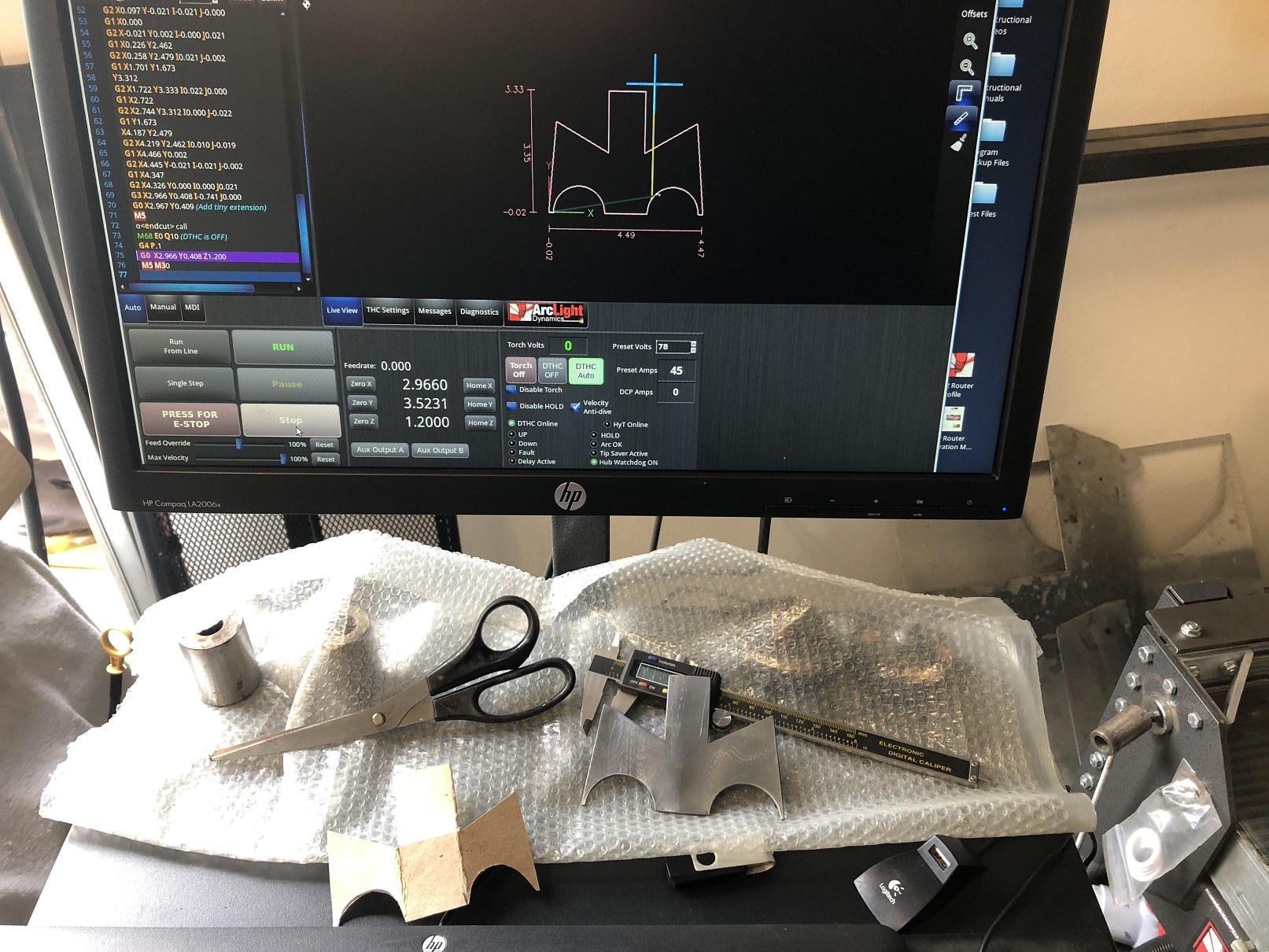

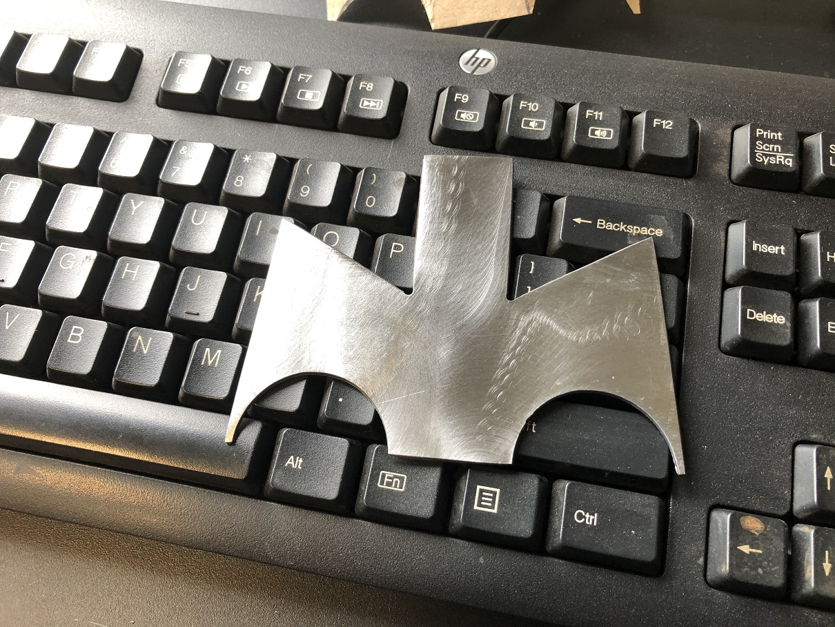

Cardboard template, measure and draw it up in CAD, CAD to plasma, plasma to part.
I've said it before and I'll say it again. This table makes it feel like I'm cheating.

Fold it up and see if it fits... Yep, that'll work! On to the other side.
And a test of these just holding the bracket in place suggests I'll need at least one of the lid springs. I'll tack them in and test tomorrow.
And, if I decided I needed the added security, I can replace these Quick Latch models with a locking version.

Hi @Dion - They're just latches. The regular spring set up will lift the lid. It is the case that I'll have to go to both sides of the car to open each one so that's not ideal.
I'll tack the brackets in and test it out before committing but assuming it works, this is what I'll run.

It took me two attempts but I got the brackets tacked in. The issue is that I didn't have every fastener cinched down enough and I ended up with enough misalignment that the latches didn't want to release without what I felt was too much force. I popped off the tacks and gave it another go. Par for my course... (IMG:style_emoticons/default/shades.gif)
You can see in the video that it does take a bit of effort, which I think is fine. Better that than popping open on their own!
So there you go, @Dion . (IMG:style_emoticons/default/happy11.gif)
