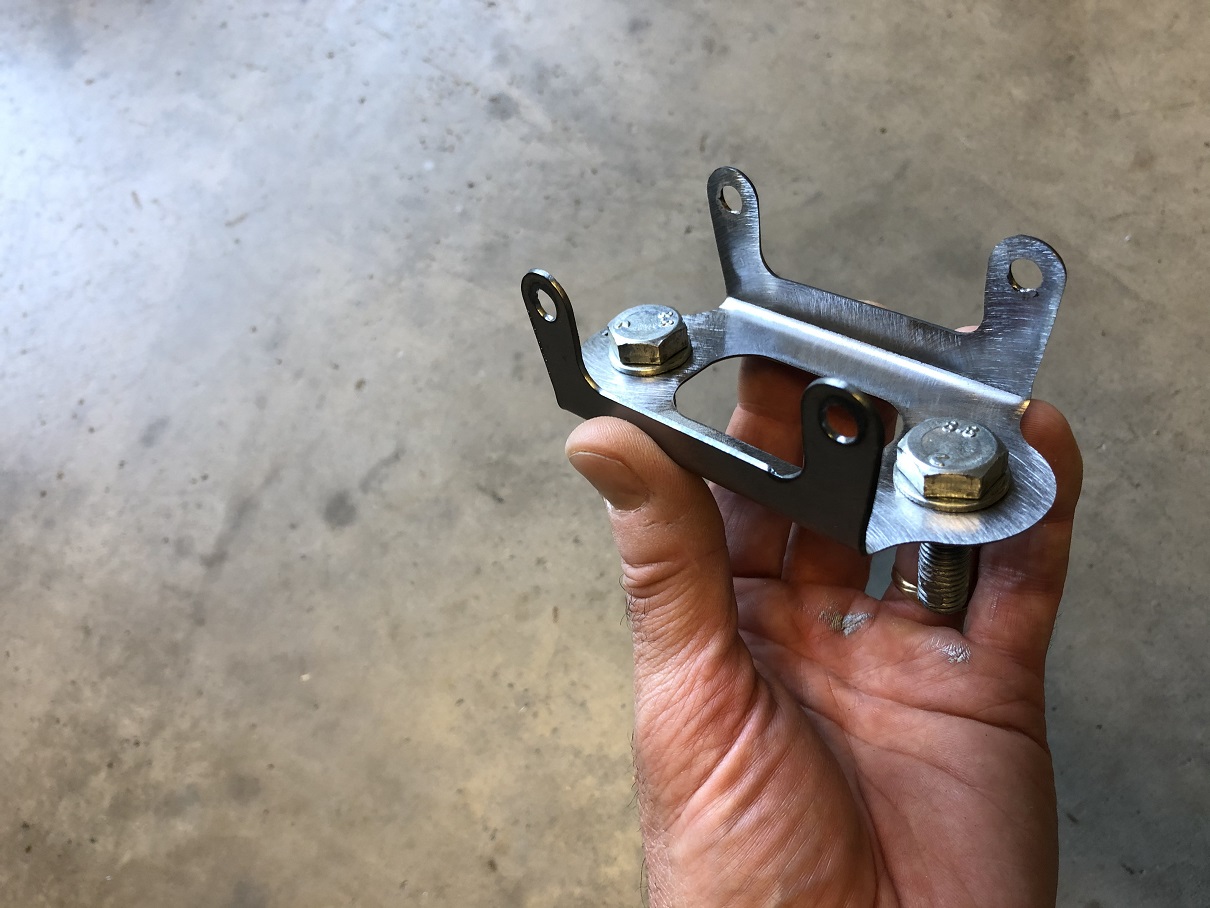

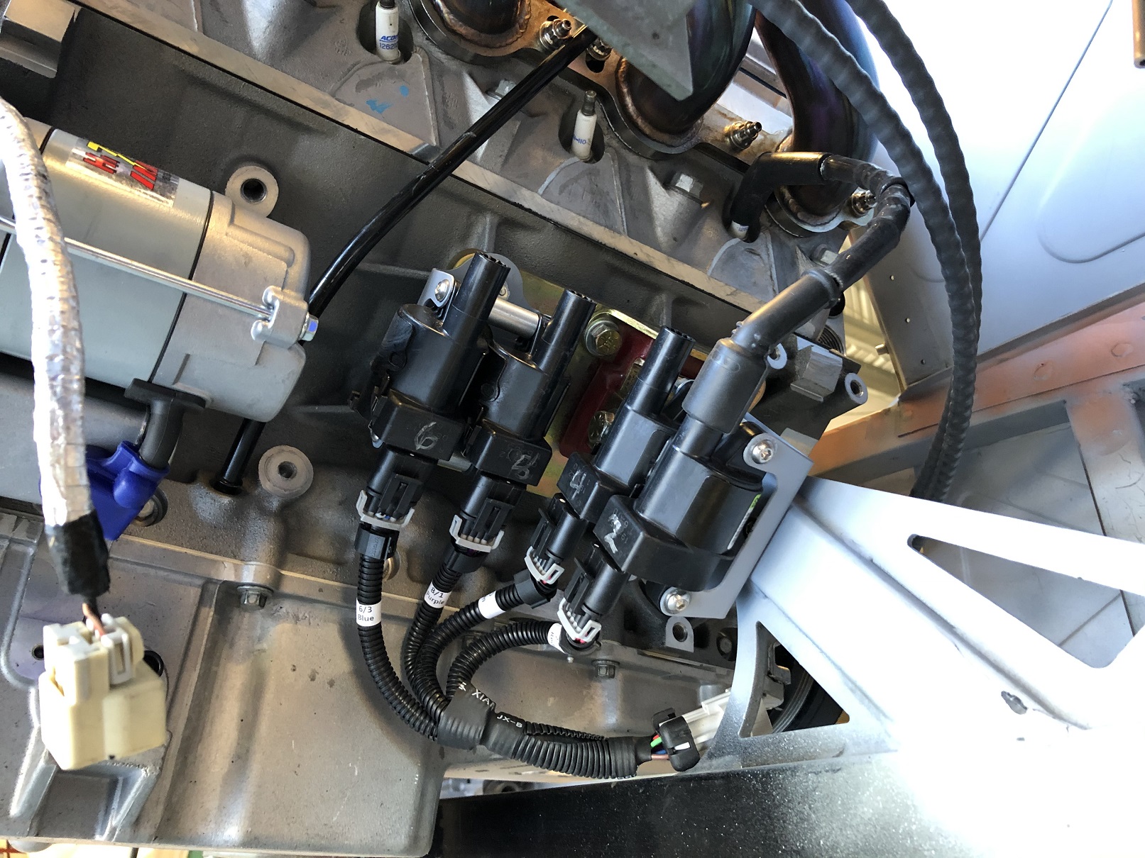

Once home, I fabbed up the driver side coil mount. The water pump is on this side so I opted to design a new mount that bolts to the block.
tygaboy
post May 22 2020, 06:16 PM
Post #2629
Posts: 5,552
Joined: 6-October 15
From: Petaluma, CA
Member No.: 19,241

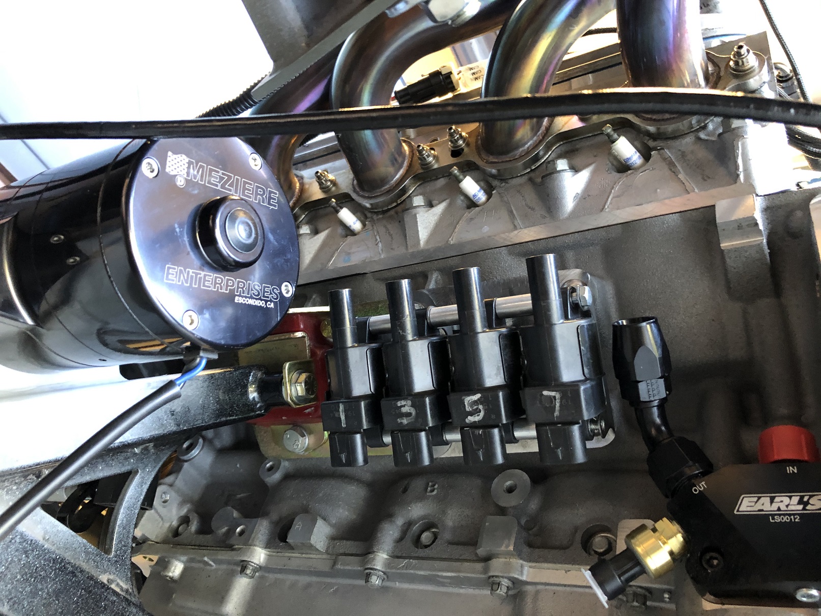

Then I made another mount for the remaining two coils that picks up four of the mounting bosses on the block and connects to the other mount. In the end, it's pretty tidy and totally hidden, which was just what I was after.

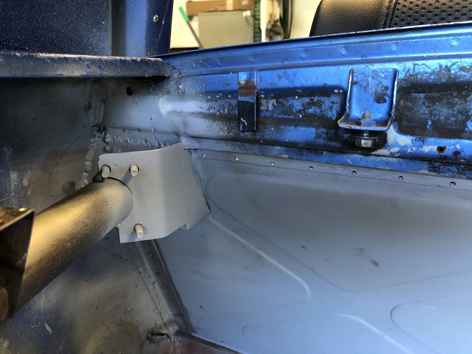

I really like the block mounted location for the coils so I cut and bent another one for the passenger side. With the starter in the way, I could mount only two on the block so I left the other pair on the engine cross bar. I'll redo the cross bar mount by welding in a threaded insert and close off the hole on the other side.
Next on the list is to make up the plug wires. One done here, seven to go.

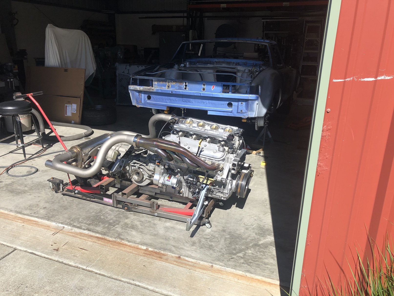

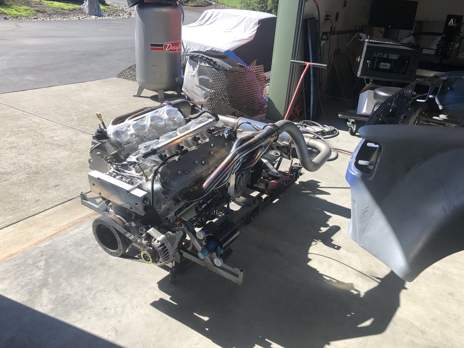

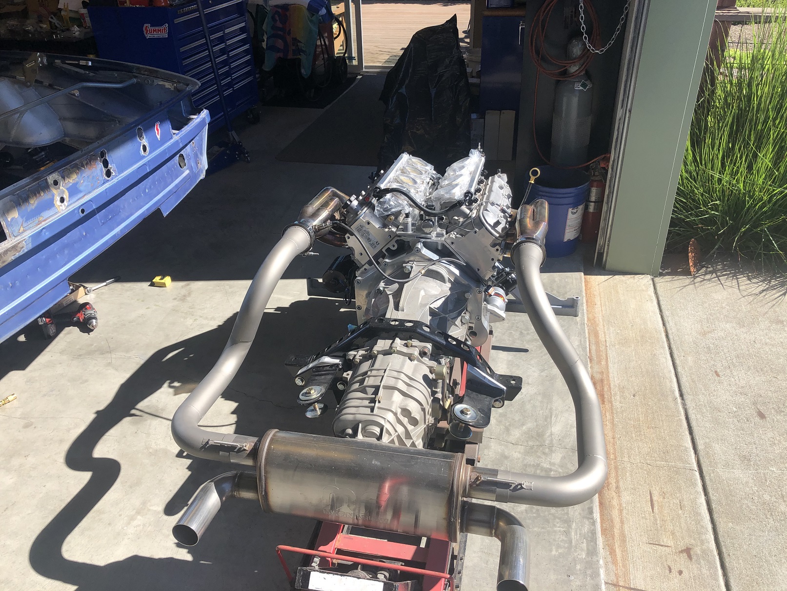

I have a few more fabrication and welding items to do in the engine bay, plus H20 system plumbing of the pump and engine, so I pulled the drive train for what I hope is the last time before this thing runs and drives.
With one small modification, I was able to remove this whole thing as an assembly!
I'd never seen it all together, out of the car and thought some of you would be interested to see it like this. If I didn't know, I'd bet there'd be no way it'd fit in a 914.

That engine is insane. Love the pipes, like a 60’s indy/F1. (IMG:style_emoticons/default/aktion035.gif)

Wow! Your right it does look like it wouldn't fit. What is that sled thing it's sitting on?
tygaboy
post May 25 2020, 04:22 PM
Post #2637
Posts: 5,552
From: Petaluma, CA
Member No.: 19,241
QUOTE(Krieger @ May 25 2020, 03:08 PM) *
@Krieger - Hi Andy! I took one of those ATV jacks and extended it, then added a U-channel at the front that cradles the engine mount/cross bar.
As you can see, it supports the assembled drive train and makes installation and removal a one-person job.

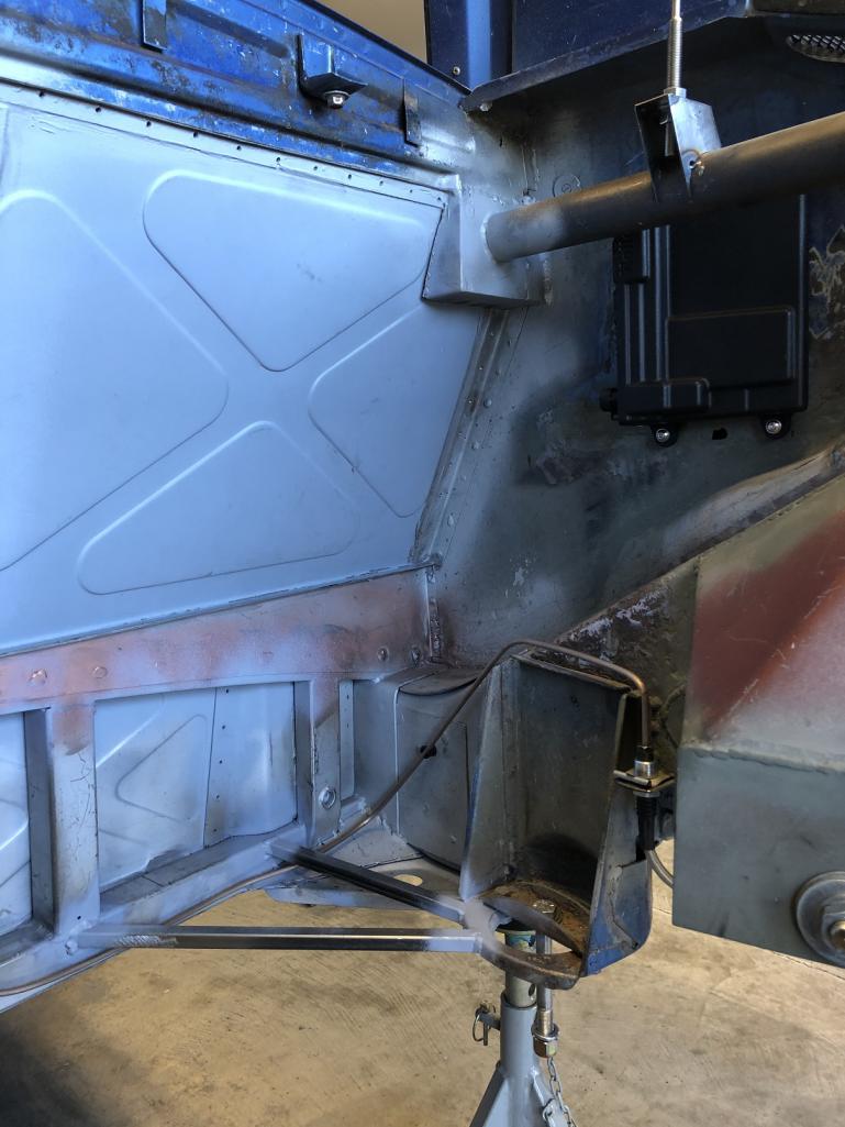

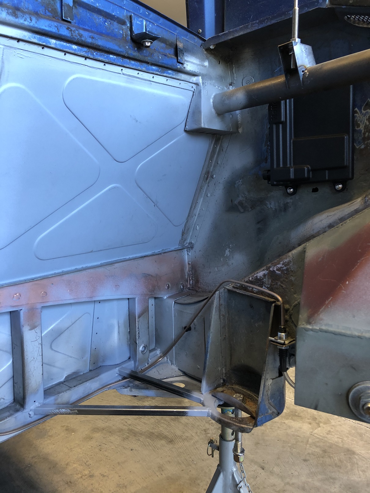

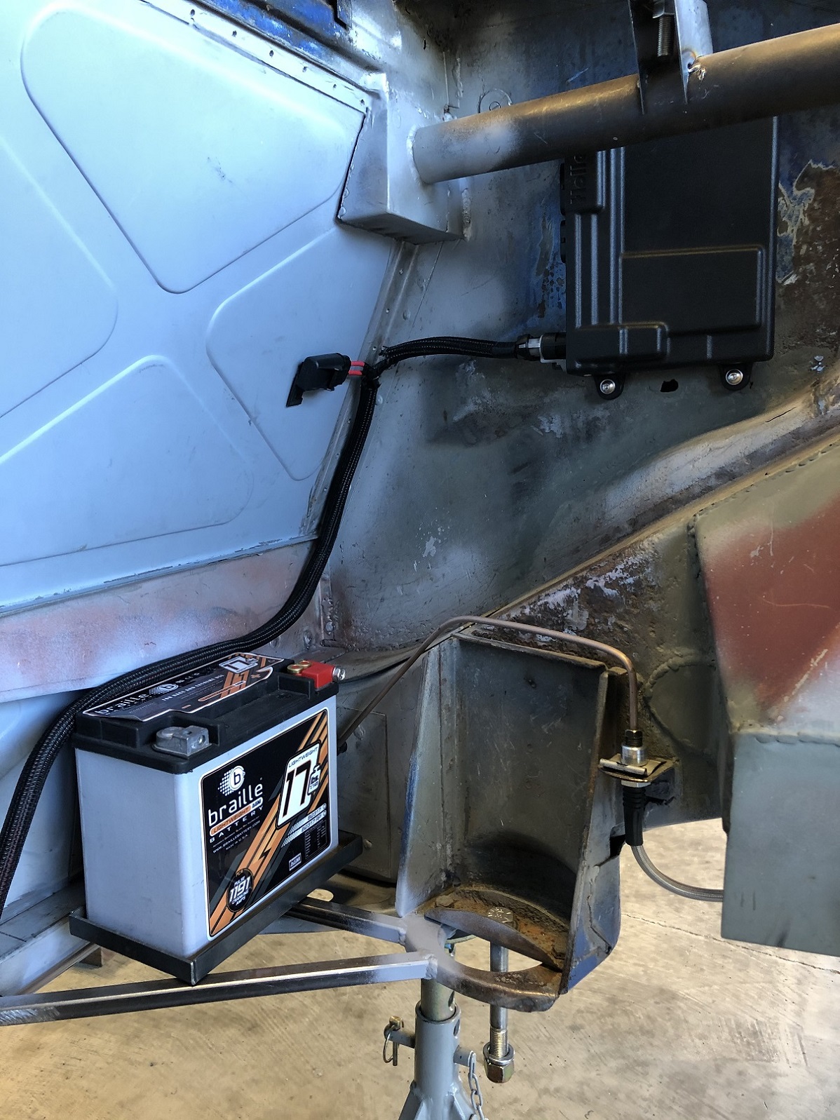

A couple more items off the to-do list:
I got the ECU mounted and started playing with wiring, then added a couple simple braces that will serve as the base for the battery mount.
I allowed for use of a larger battery, in the event this tiny one doesn't cut it.
And no, that's not the box for it, it's just something to set it on to test various locations and orientation.
@markhoward Mark Howard is running this battery in his Camaro and it works for him so I figured I'd give it a try, but again, with an insurance policy!

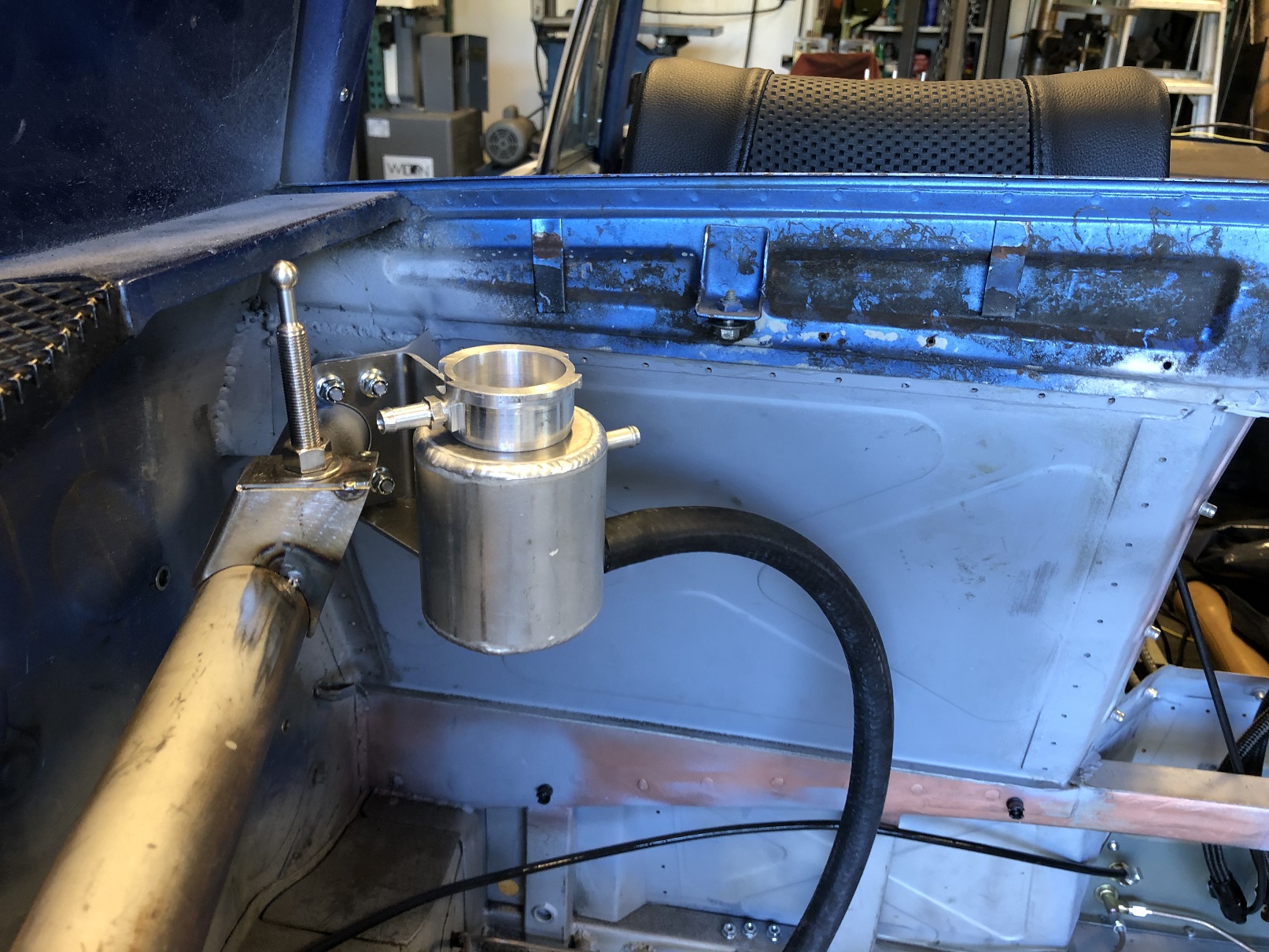

I fabbed a fancy "fit around the bar and sit at an angle" bracket for the radiator cap/tank.
This unit comes as part of the Renegade kit. It's a nice piece and it's generally mounted by bolting it to the fire wall.
Well, clearly, they didn't get the memo that there's no way I'm drilling holes in my firewall! (IMG:style_emoticons/default/happy11.gif)
I carved out a section of it so it'd wrap the bar, too. And yes, all the hoses clear everything.

Looks like to me there’s two sections of exhaust pipe that would fit some turbos in real nice. Can you post more pictures of your lift system. I was just thinking about that the other night how am I going to do this by myself.y
