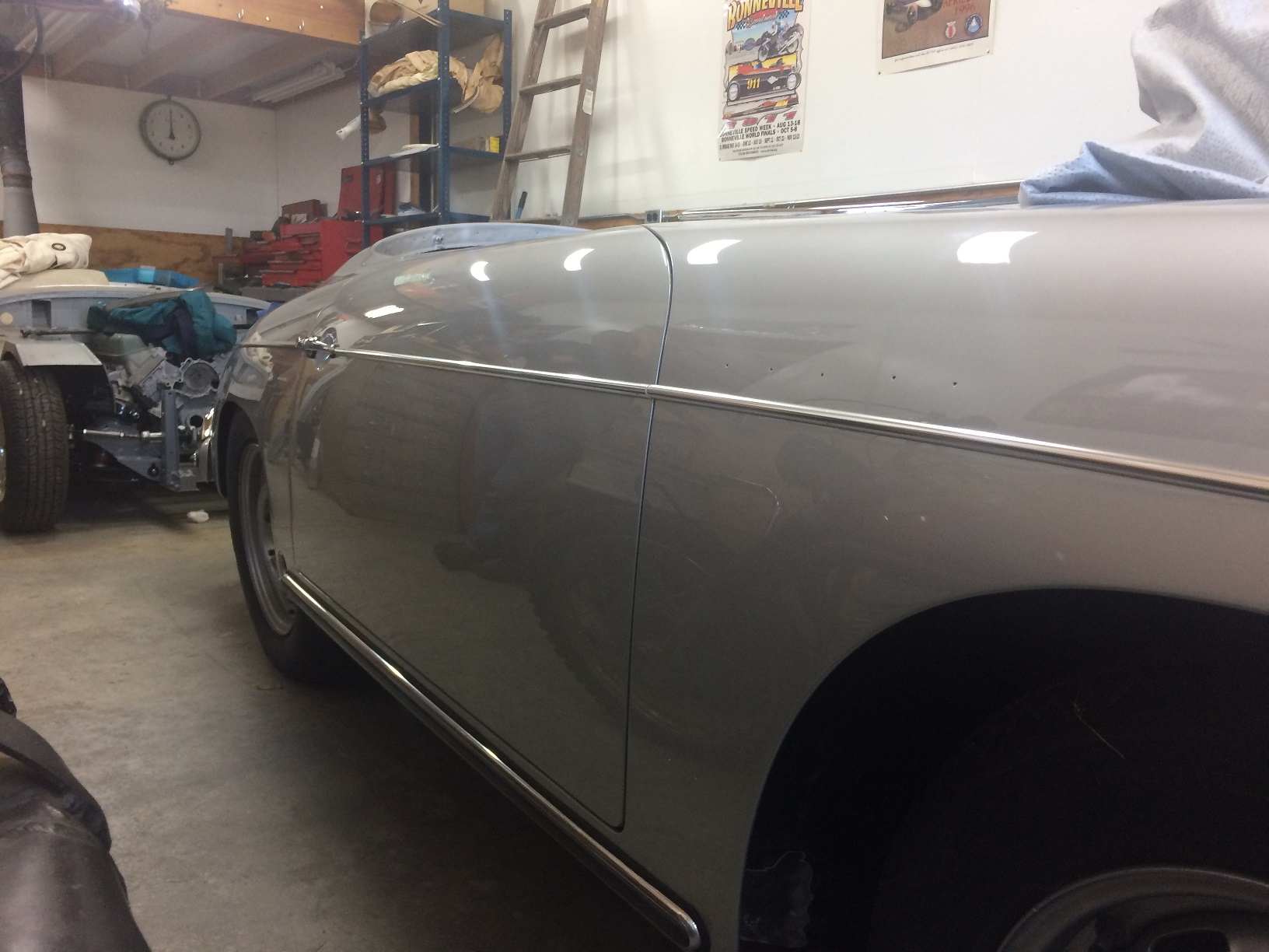

And for fun, here's my buddy's Speedster, painted by the shop I'm planning to use.
Note the consistency of the reflection as it crosses the door gap. I don't know if I'll choose to spend what it takes to get this level of result, but it's great to know the shop has the skill to do top quality work.

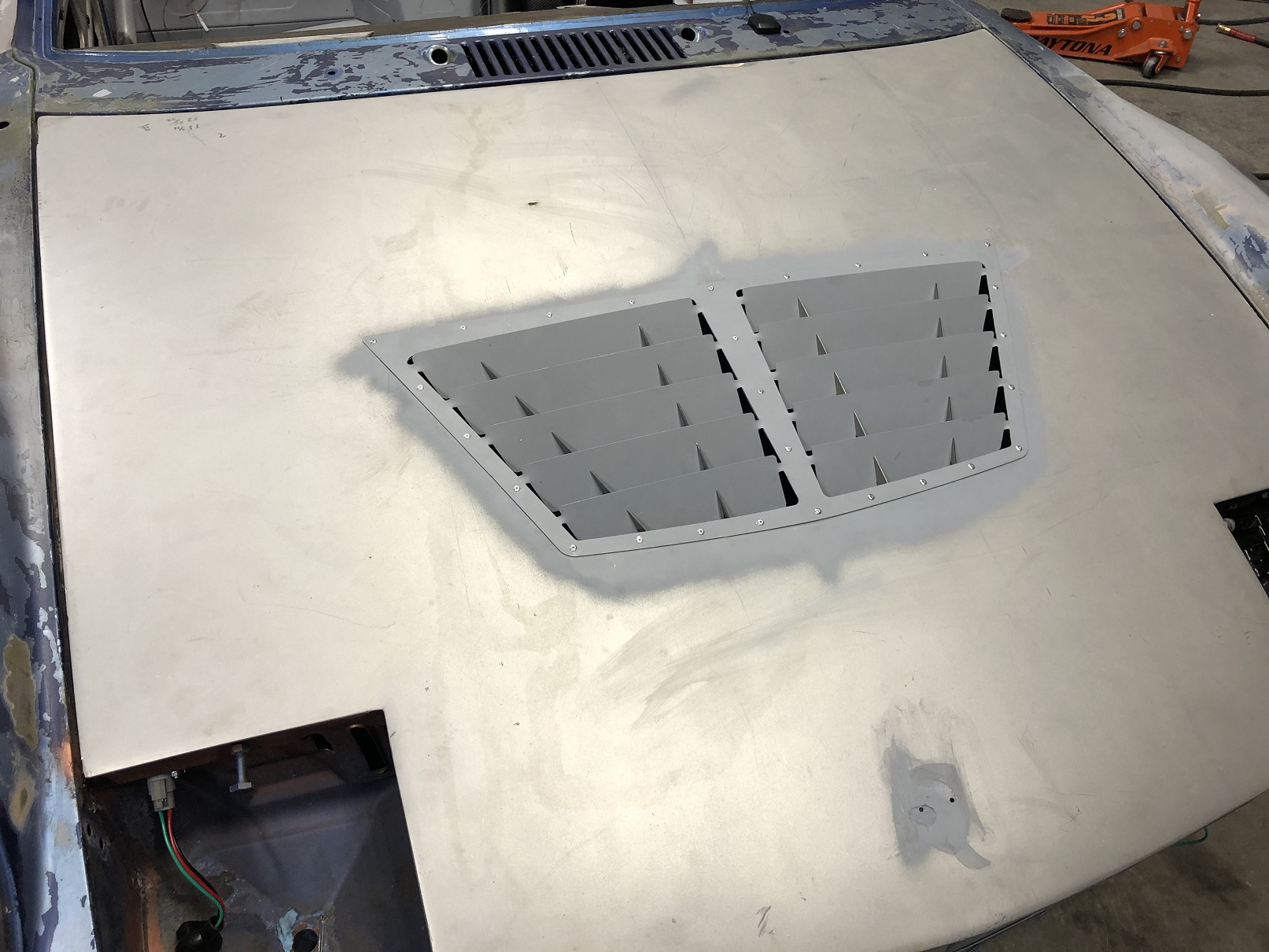

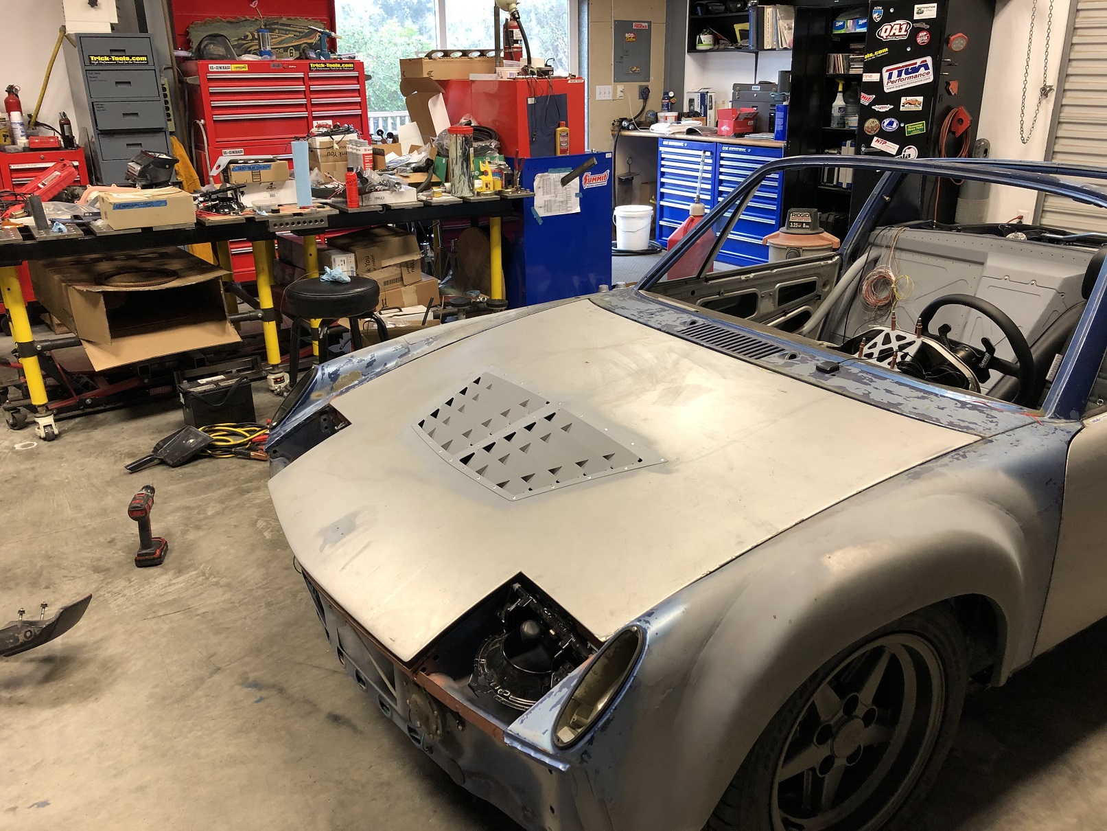

I'll be taking it in for alignment and corner balance so I decided I may as well bolt on everything needed to get close to final weight.
I figured I'd go ahead and see what the hood vent looks like riveted in from the top. Remember, this is the test hood and not necessarily the final version of the vent. Also, just standard pop rivets. But it gives me a good idea of this look.
I like it from some angles, from others, not as much. Still some work to do.

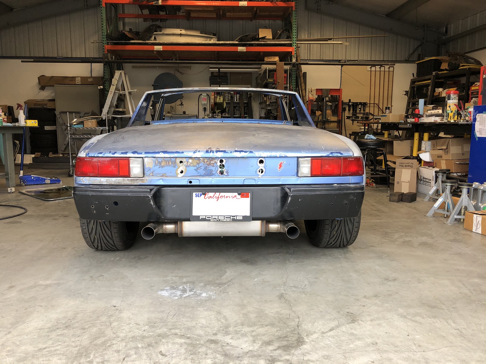

I will say, I really like how the muffler looks! It's starting to look like a 914 again.

QUOTE(tygaboy @ Sep 2 2020, 07:07 PM) *
That arse end - which is all that most people will see - is perfection.
I agree about the front vent - it looks good on its own but somehow doesn't quite go with lines of the car.

The outer rear corners of the vent look like they arch towards the front corners which may be an optical illusion but to fit the hood they should tail off towards the rear corners.

I'm thinking that to improve the visual of the hood vent, I'll work up a design that looks good on the car, then put vents where they fit and add "false" vents or maybe a cut-out or stamped area where vents can't go. A bit of form over function, but that's OK with me. Again, another item that's a work in progress where more noodling is needed.
Worst case, it's vent the fenders and leave the hood alone. But I'll admit, that just feels like giving up.

While I love everything about this build, that rear firewall is just artwork in my mind. It just has this crazy "x-wing" fighter aircraft quality look to it, if that makes any sense, but at the same time it's simple in a good way. I know you said the car was loud, but I hope you don't cover up that metal work! ....it would be criminal! (IMG:style_emoticons/default/beerchug.gif)
