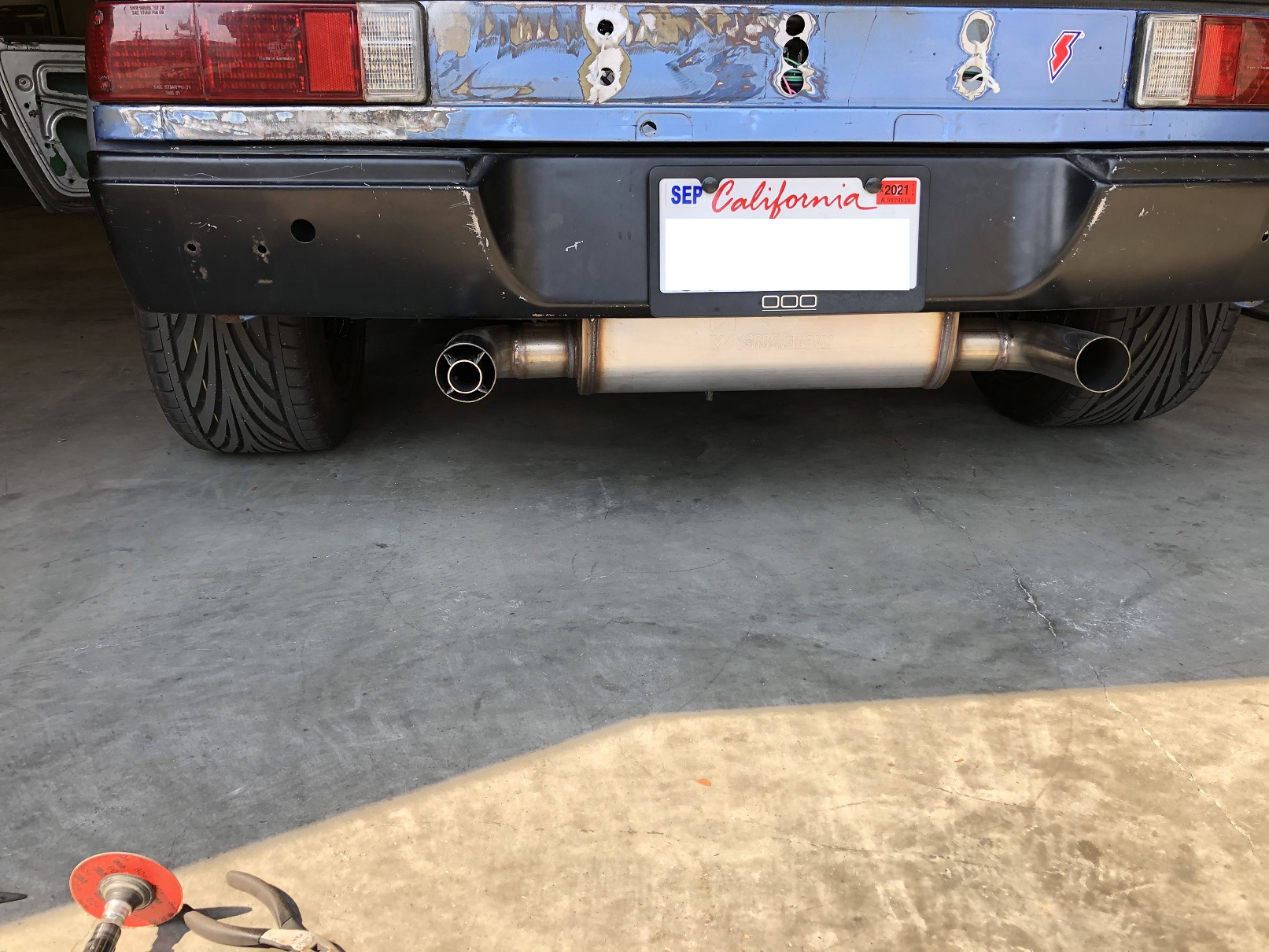

In any case, since I can't mess with things that require the car runs/drives, I have some unexpected free time... And you know what they say about "idle hands being the Devil's workshop". Time for some more style points.
So. Just because I can't afford a 935 doesn't mean I can't steal some of its design ques!
This is V1 and only part way done. I'm still noodling on the length of the extension and # of supports. 4 looks OK but maybe 5 to echo the look of the Ronal wheels? Or go with 8, like the 935?
I think I like 4 or 5. Regardless, I think it looks far better than "plain".

Suddenly I'm thinking "Bond, James Bond"
I would say 5. 8 may start being restrictive.

I'd like to see 5 myself. Al's what about making the tips bigger?

And on the exhaust, I'll mock up the other one with 5 supports as I, too, suspect I'll prefer that, what with nature abhorring even numbers and all that.

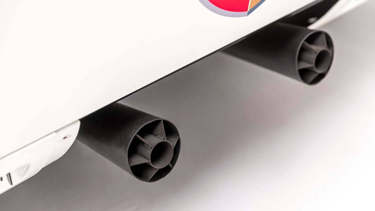

Chris - the cookie-cutter tips were used on earlier cars than the 935 too, like the 906 and (pictured here) the 910:
Traditionally 6 segments were used, but I like your idea of 5 to match the Ronal wheels,
- Tony

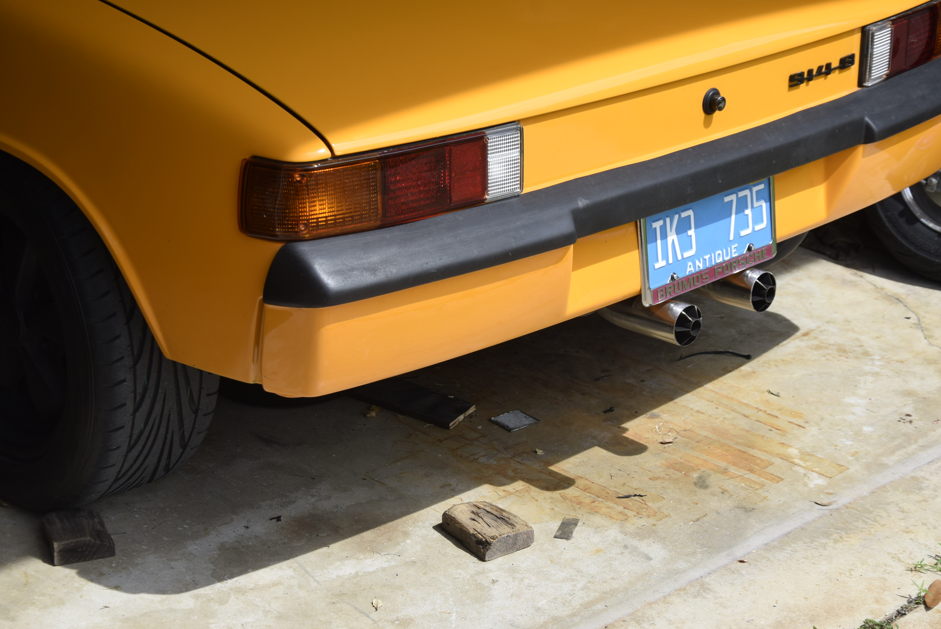

This is what I did for mine. BobAttached Image

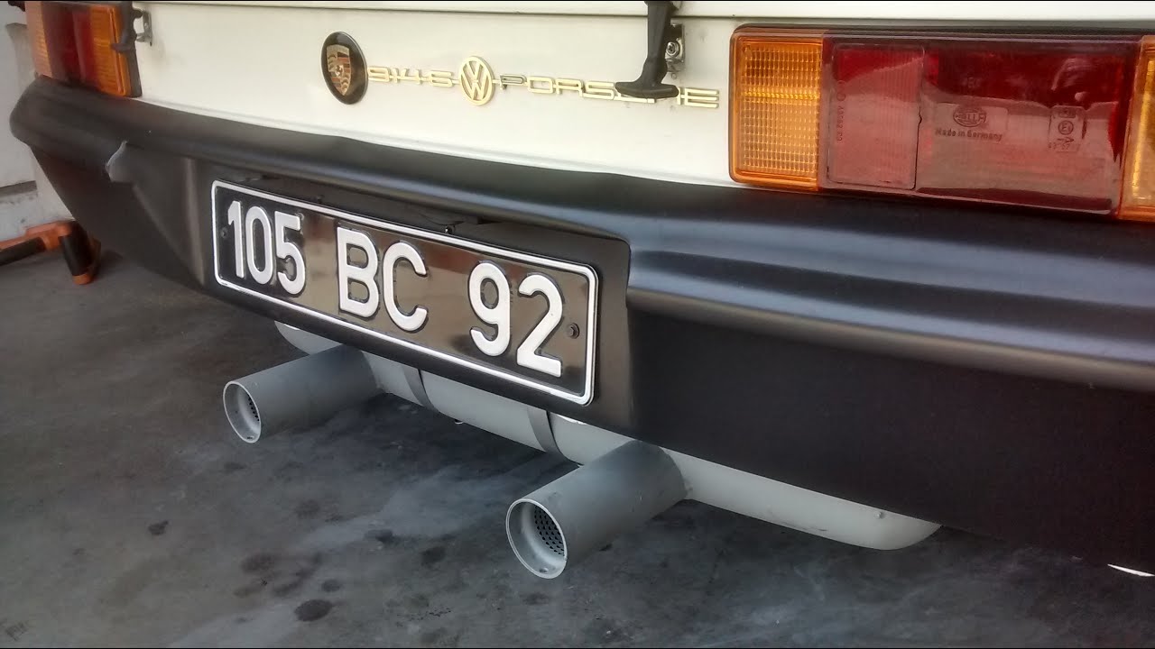

Dig the cutters, and particularly the five- or six-blade idea, but the baddest 914 muffler of all—in both aesthetics and noises—remains the one used to win Le Mans. A lot of the aftermarket sport mufflers out there (including the Dansk 57mm on my car) are close but no cigar when it comes to the detailing...

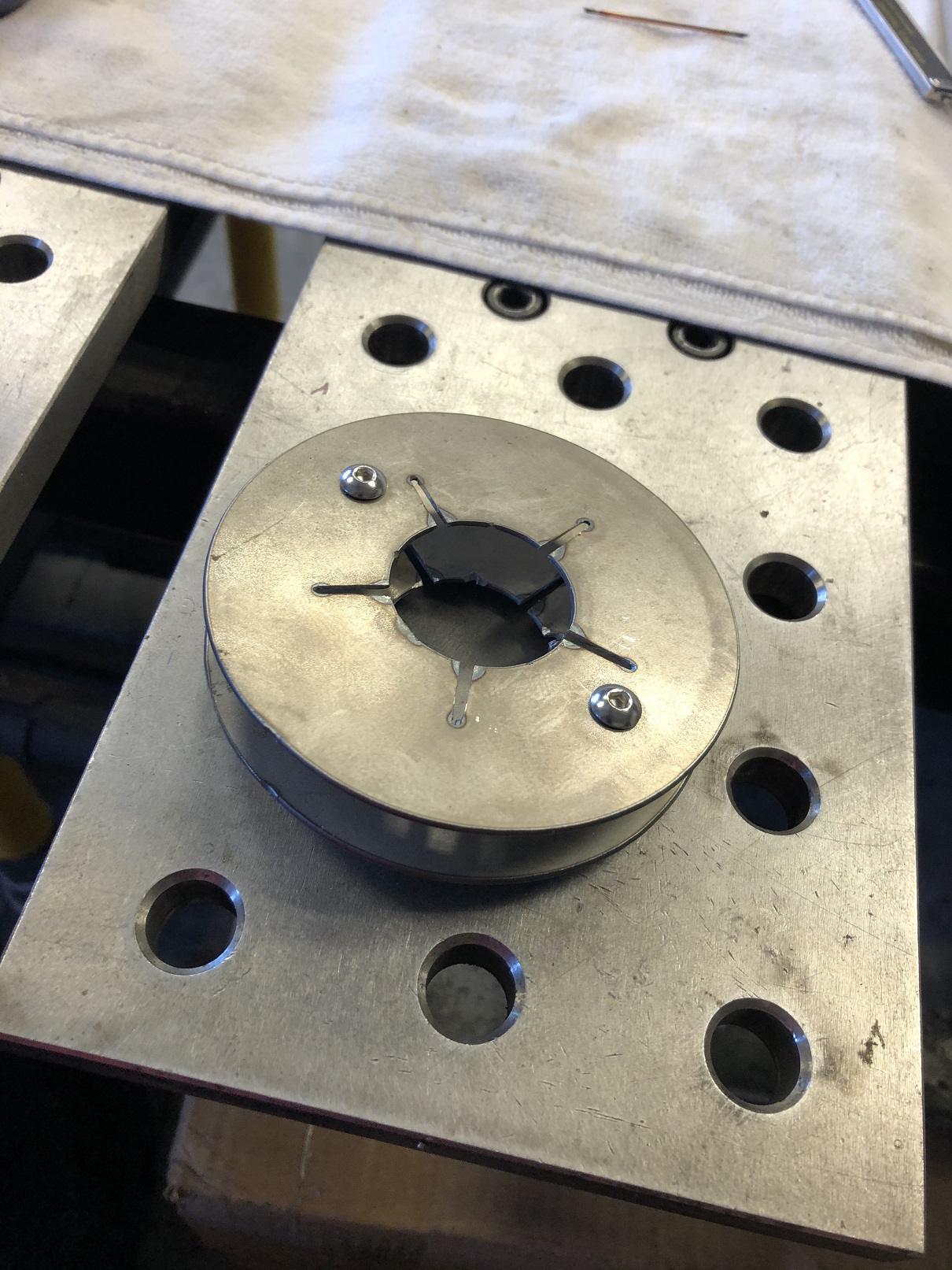

I worked out a little fixture for the exhaust inserts that makes it easy to accurately locate the 5 vanes.

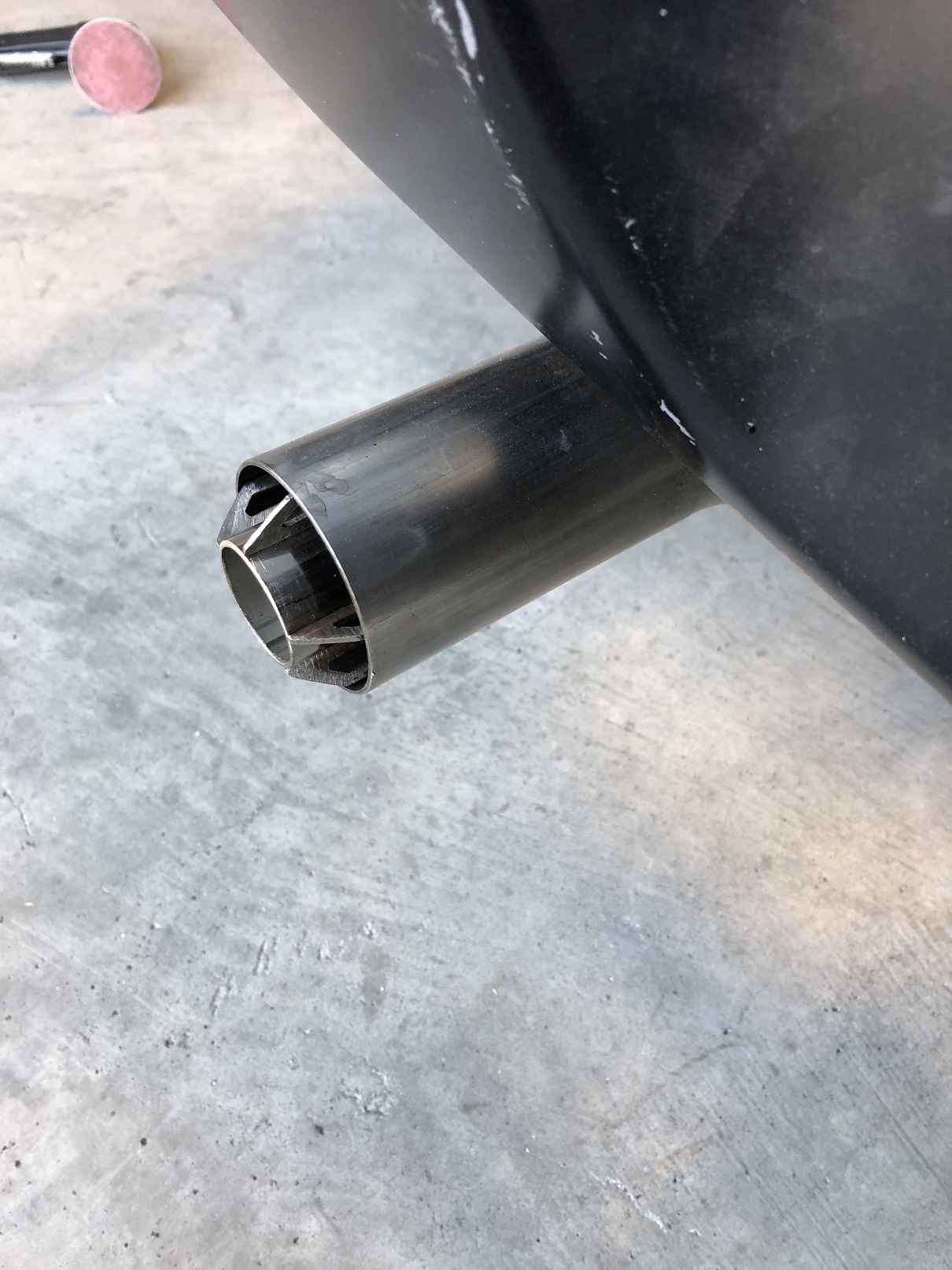

I may go with this look or may work up another version. Still noodling on it.
