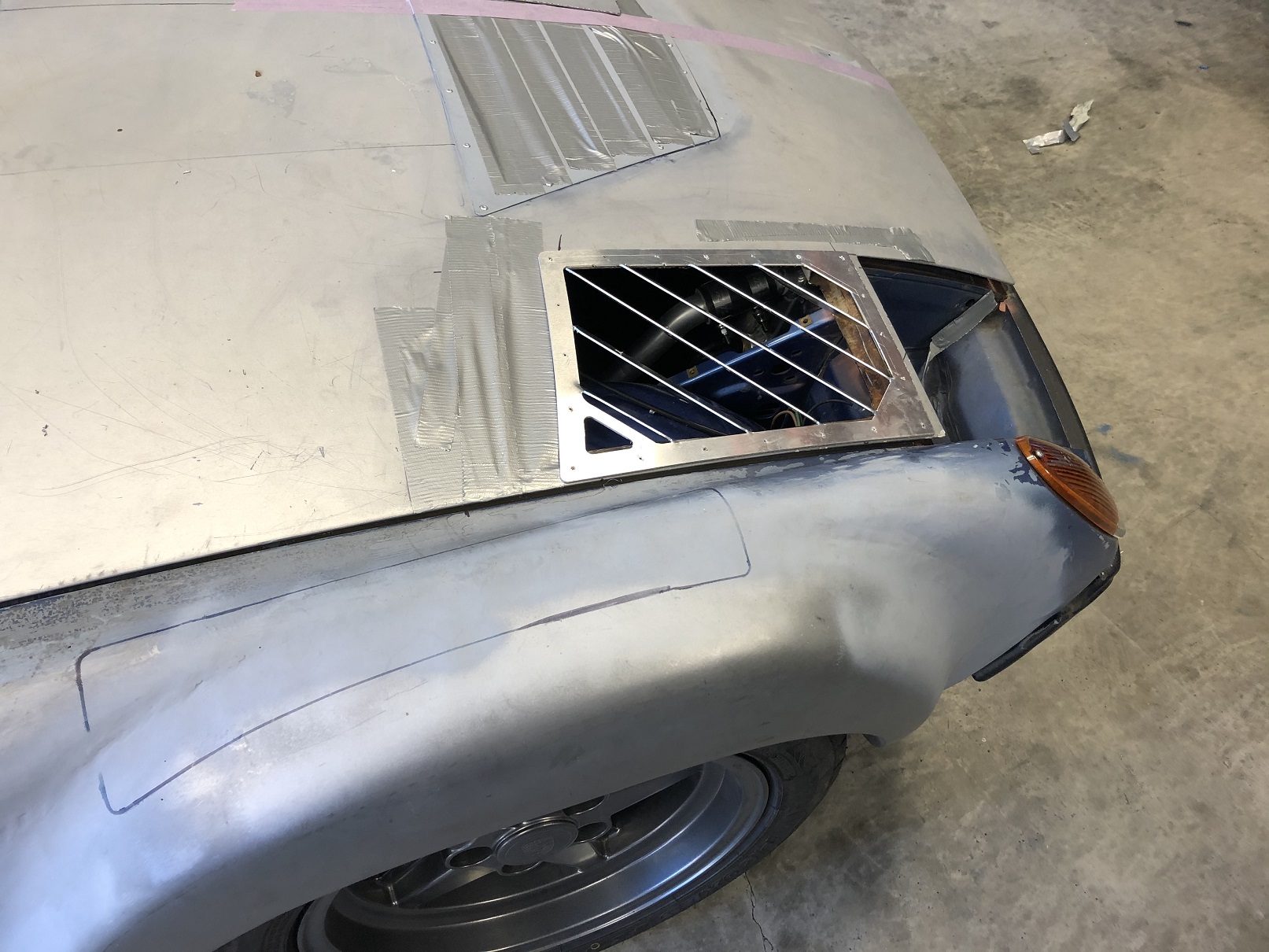

@Rand - sorta like on the left?
It was one of the minor design changes I mentioned I wanted to make... Great minds? (IMG:style_emoticons/default/shades.gif)

The average inbetween! (that's what I meant by average/variance with the front if it wasn't clear) We are all right / er, correct (IMG:style_emoticons/default/smile.gif)

@Rand @horizontally-opposed Maybe it's just me but "it looks different in real life".
The current version's upper and lower edges match the headlight cut outs. It looks pretty good (in real life) but depending on where you stand when you look at it, that top edge can feel too straight, regardless of its angle.
You're more than welcome to come by and give it a look-see.
Anyway, I'm sure there will be a few more test versions made before I make a final decision.
Plus, I got some actual yarn! So I'll do a "flow test" on this newest version in the next couple of days.

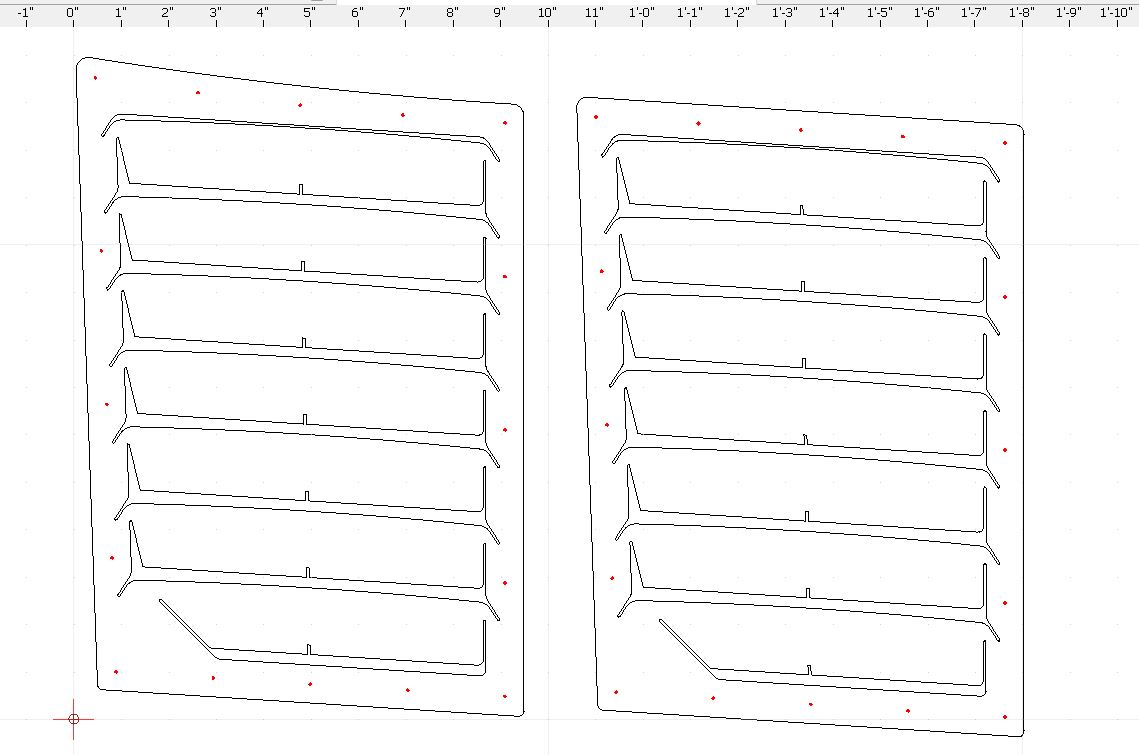

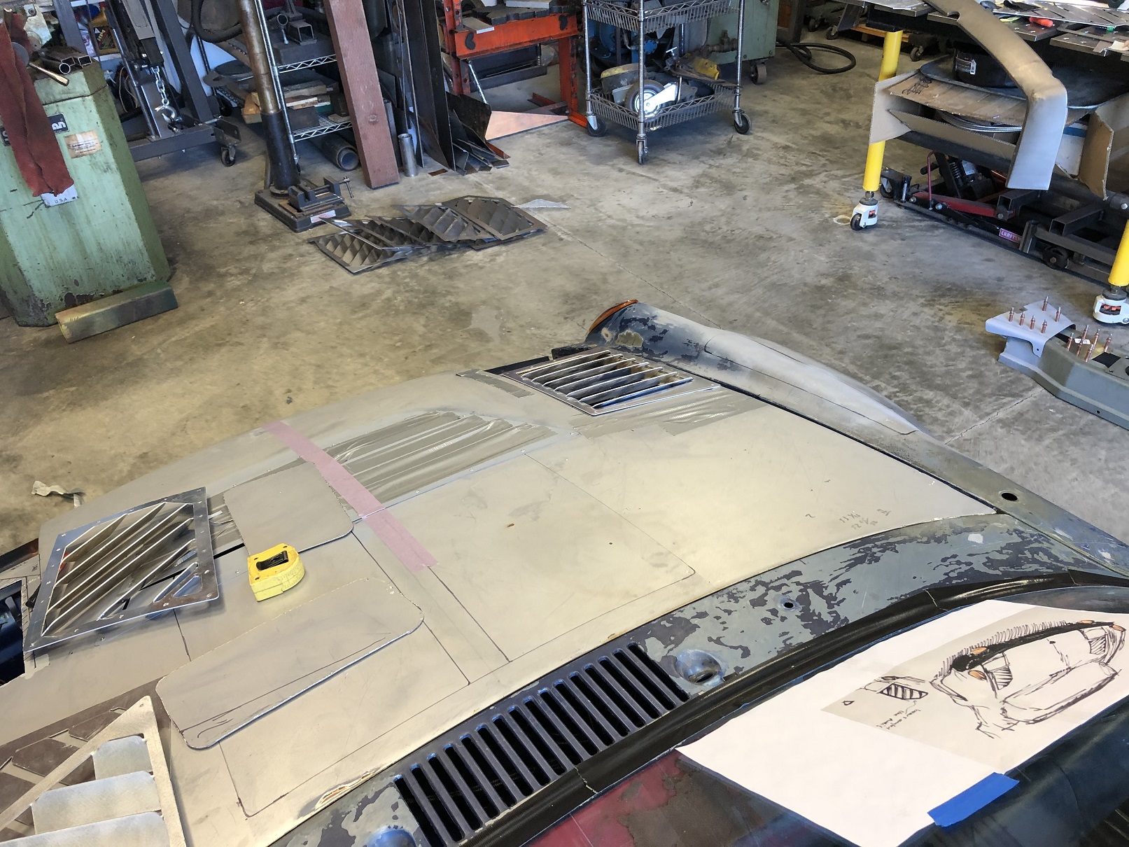

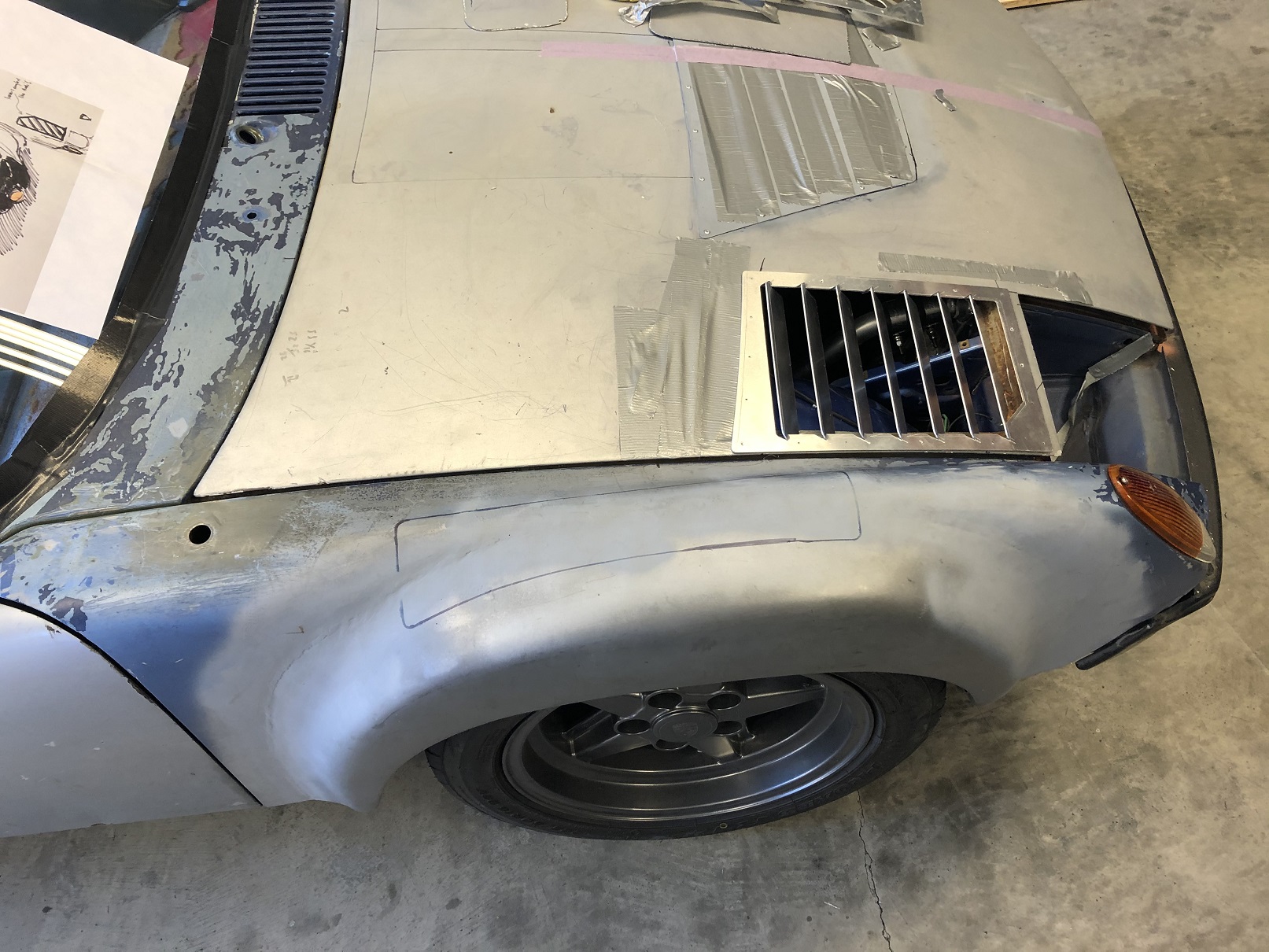

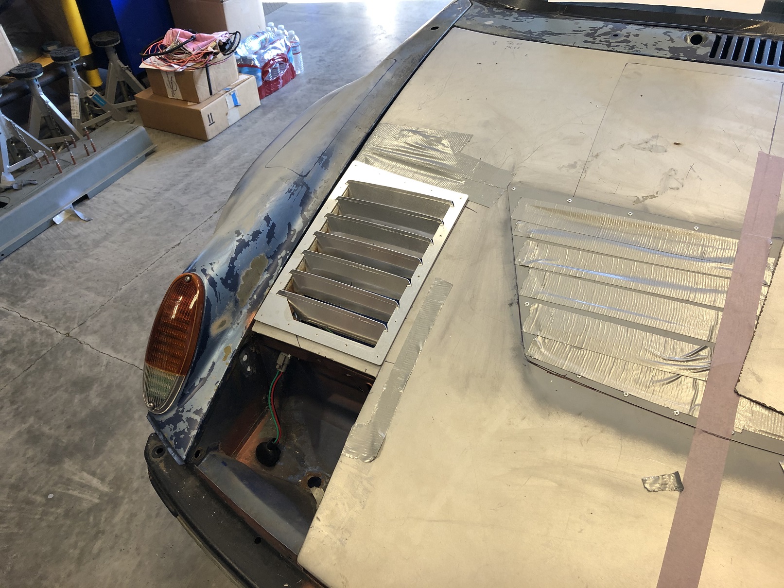

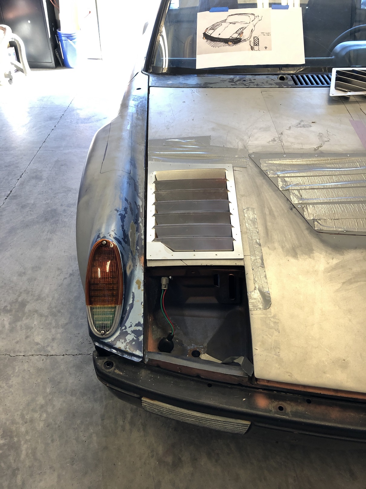

The latest updates:

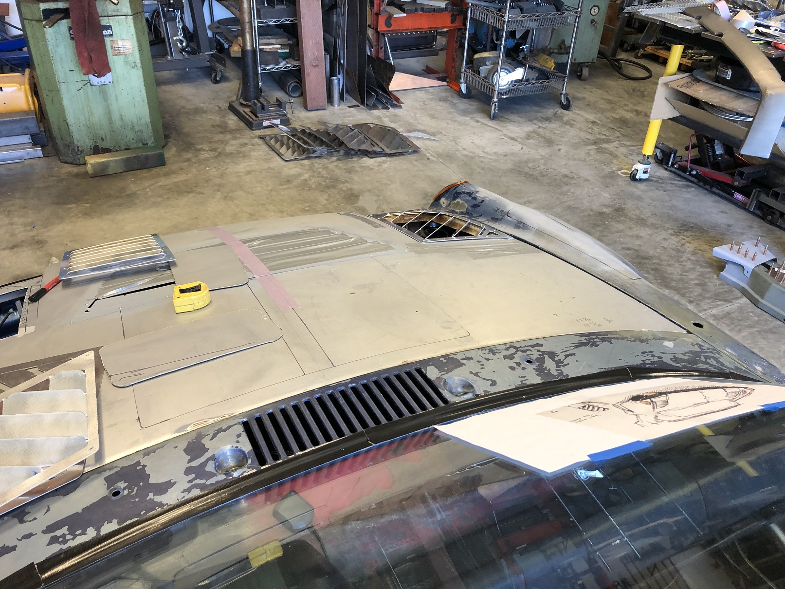

First is the "straight across with a curved top". If you compare this to that last CAD screen grab, you'll notice I ended up lengthening the outer vertical edge. I wanted to make the curve at the top more noticeable. BTW, the radius of that curve is? You guessed it: 91.4"! (IMG:style_emoticons/default/aktion035.gif)
I think if I allowed the top edge frame to grow wider as it curves (vs that straight edge) as it moves outward, it might look a little better. Something to play with, at least.
post Nov 29 2020, 06:50 PM
Post #3250
Posts: 5,551

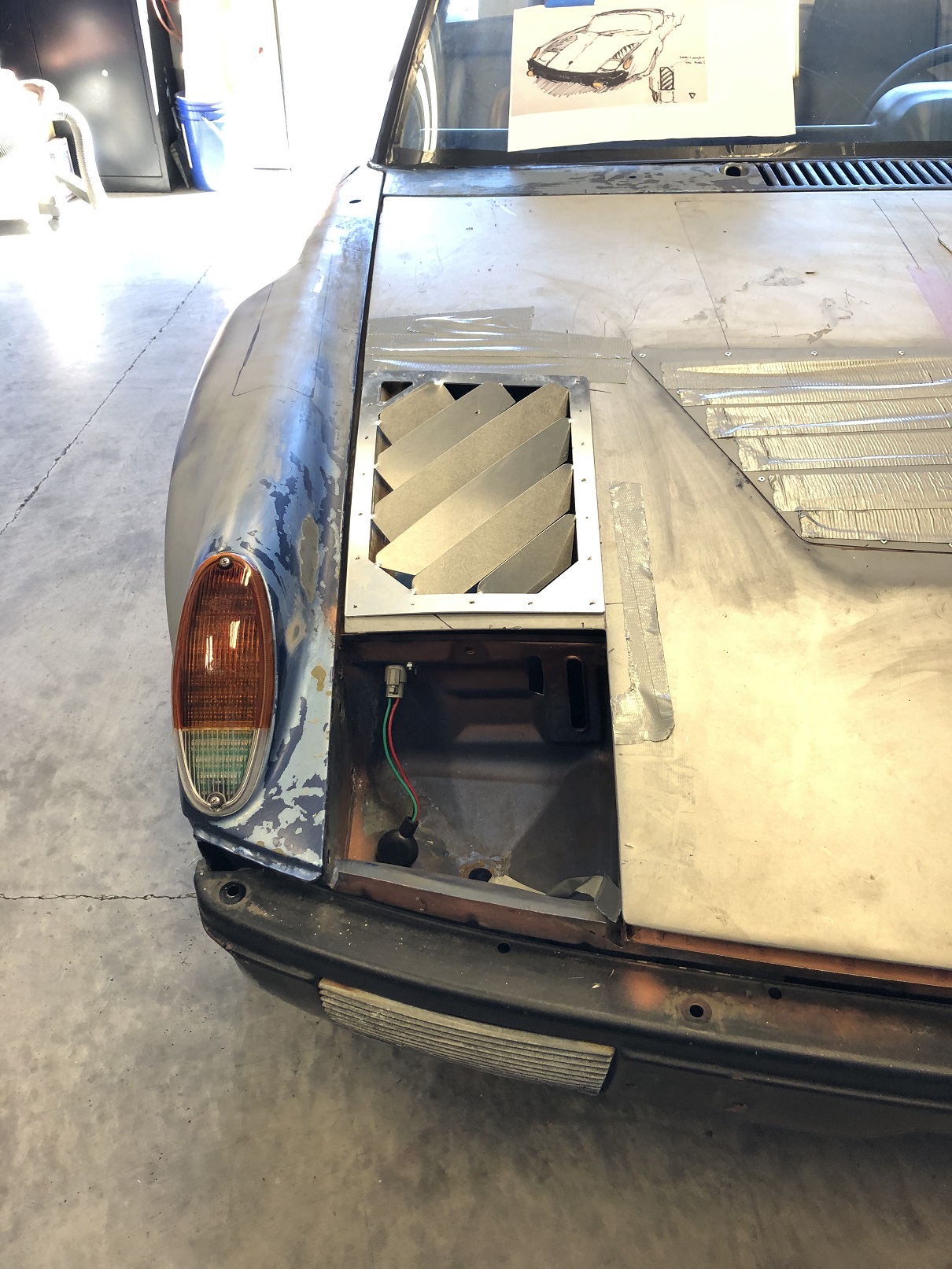

Then came the newest "Shortened 45 degree with curved top".
I made both versions then headed off to start celebrating my lovely wife's "BirthWeek"!
For sure that's far more important than any car stuff, but it means I didn't really look at either of them on the car, beyond taking these pics. I'll need some time with them before any next move but my initial reaction is that the straight one gives the car a more "refined" feel vs the 45s "tough guy" look.
I like them both and may just build two hoods and swap them onto the car to suit my mood. (IMG:style_emoticons/default/shades.gif)
This vent work continues to be a really fun effort. Forget "process of elimination". With me it seems to be "process of evolution", as evidenced by that pile of, oh, let's call them "trial vents" in the background of the last pic. Oh, plus the two randomly sitting on the hood, and some that aren't in the pic... (IMG:style_emoticons/default/blink.gif)
Whatever it is, I'm enjoying it and feel like I'm getting close. I will say that having tried to turn @Retroracer Tony's sketch into a real part? I now fully understand when there's some really cool design element on a show car and it's pointed out "well, that'll NEVER make it into production...", there's a REALLY good reason why! (IMG:style_emoticons/default/lol-2.gif)

I prefer the angled option.
the "straight" version looks a lot like something I see on an appliance . Or venting for a garage.

post Dec 1 2020, 10:32 AM
Post #3258
Posts: 5,551

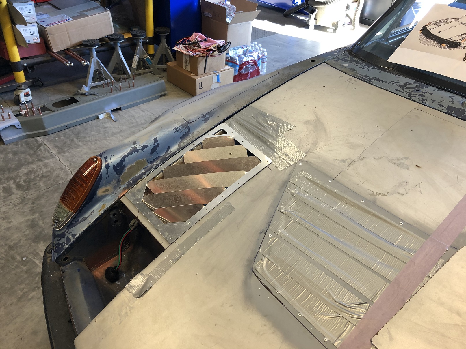

After seeing the straight across version, my immediate reaction was, like @Cairo94507 Michael's, that the angled version needs more vents. As bold as those larger vents look, they seem a bit out of scale on the car.
And as @buddyv Robert mentioned, the straights have a bit too much of a "home floor heater vent" look. Well, at least this current version does, IMO.
So, how to proceed? Well, I'm going all in on ANGLES! Frankly, it's important to me that I do all I can to honor @Retroracer Tony's original design. (IMG:style_emoticons/default/pray.gif) Plus, I think they fit the vibe of the build.
So, I spent a bit of time and worked up a new design. The key changes this time are:
- vents went from 45 to 60 degrees
- scaled the vents down to make room for a 7th vent (nature abhors even #s!)
- incorporated the "bend area" design from the straight version
IMO, this last point lends a more finished look to the final product. Compare the bend areas and you'll see that the current angle design is simply twisting a small area that I worry will crack at some point. The new approach leverages what I've seen on the commercially available vent products.
Not only does this seem a safer way to do the bend, it also means the upper edge of the vent moves outward, causing the top corner radii to finish proud of the inner edge of the frame. It just looks more "finished" to me.
Pics of the real one on the car in the next day or so. And if you're asking yourselves "when will this silliness end?", know that I'm wondering the same thing. (IMG:style_emoticons/default/happy11.gif)
