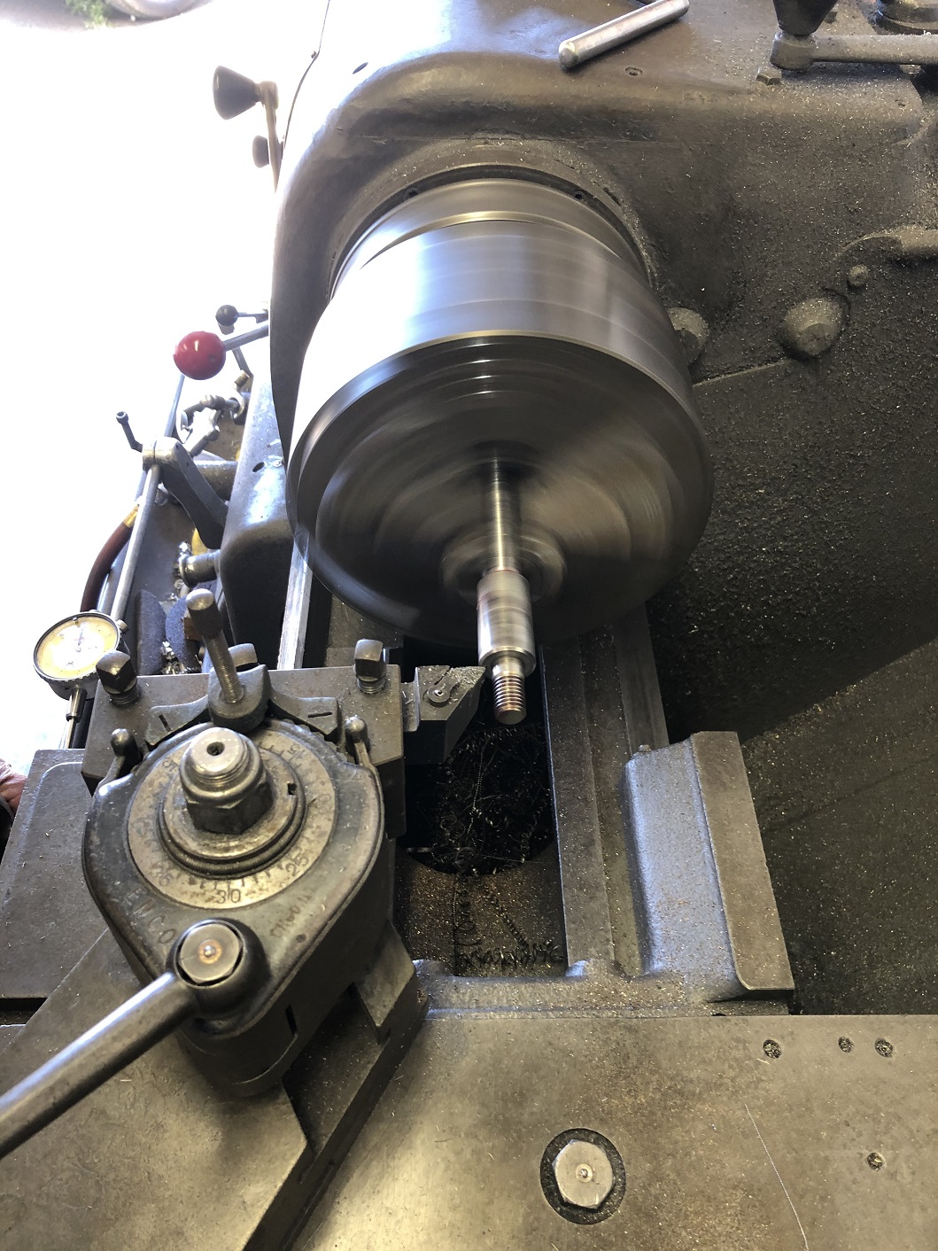

I jacked up the rear and gave the wheels a tug then a push. "Clunk, clunk". Hmmm.
Off came the trailing arms and here's what I found.
Anyone else running PolyBronze bearings have an issue like this? @Andyrew @conedodger
I have to believe there's enough variation in trailing arms that I can't be the only one.
Anyway, I'm planning to chuck the pivot shafts in the lathe and remove the appropriate amount needed to get the clearance into spec. Anyone see any issues with that?
https://www.youtube.com/watch?v=3Y3ijb5z9nY
I have a significant clunk in my RR trailing arm that I suspect is this. It sounds just like a bad CV. Suspension feels completely normal. I cant see it when I pry on things, but its a "CLUNK" audibly heard occasionally when driving.
At this point i've tuned it out as I suspect 100% its the same thing you have Chris. Someday i'll pull the suspension and refresh the bearings and address it..
Are you going to machine down the inner rod?

I'm happy with about .010" of end float and accept up to .020" before I feel a need to make alterations.
@ChrisFoley Chris - thanks for verifying what I remember hearing from you when I was first working on your rear pick up point install.

The "too much end float" issue has been resolved on both sides! (Did I really need to call out that I did both sides? (IMG:style_emoticons/default/blink.gif) )
So yes, @Andyrew Andrew, turning it is the way I opted to go - if only for the weight savings! (IMG:style_emoticons/default/av-943.gif)

Oh to have a lathe...
Oh to have room for a lathe...
Oh to have room!
I love the fact that your whittling away at this car making it better and better every week (IMG:style_emoticons/default/smile.gif)

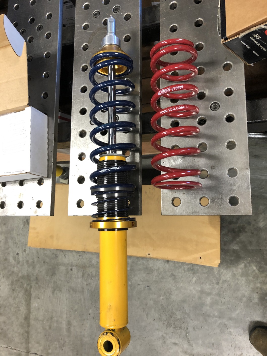

With the trailing arm end float issue addressed, I called S-Car-Go to get their thoughts on rear spring rates. They said move to 250lb. Thanks to @Krieger Andy, I could! Thanks for the springs, my friend... I owe you.
So out with the 225s (blue) and in with 250s (red, which I understand are faster!)

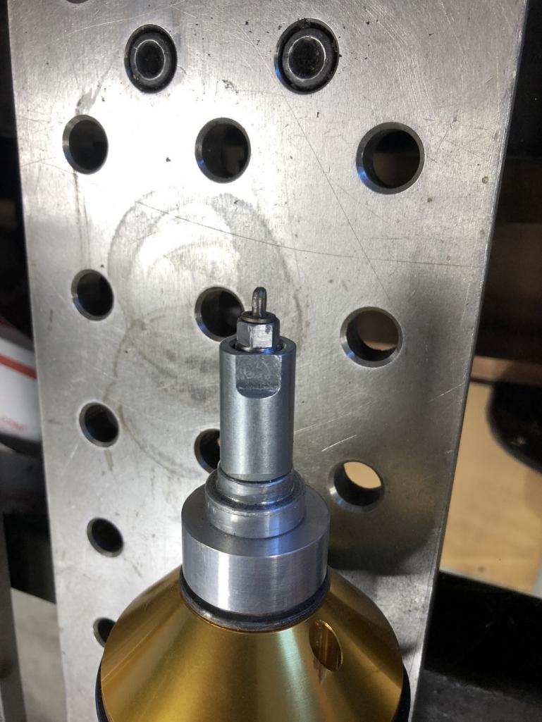

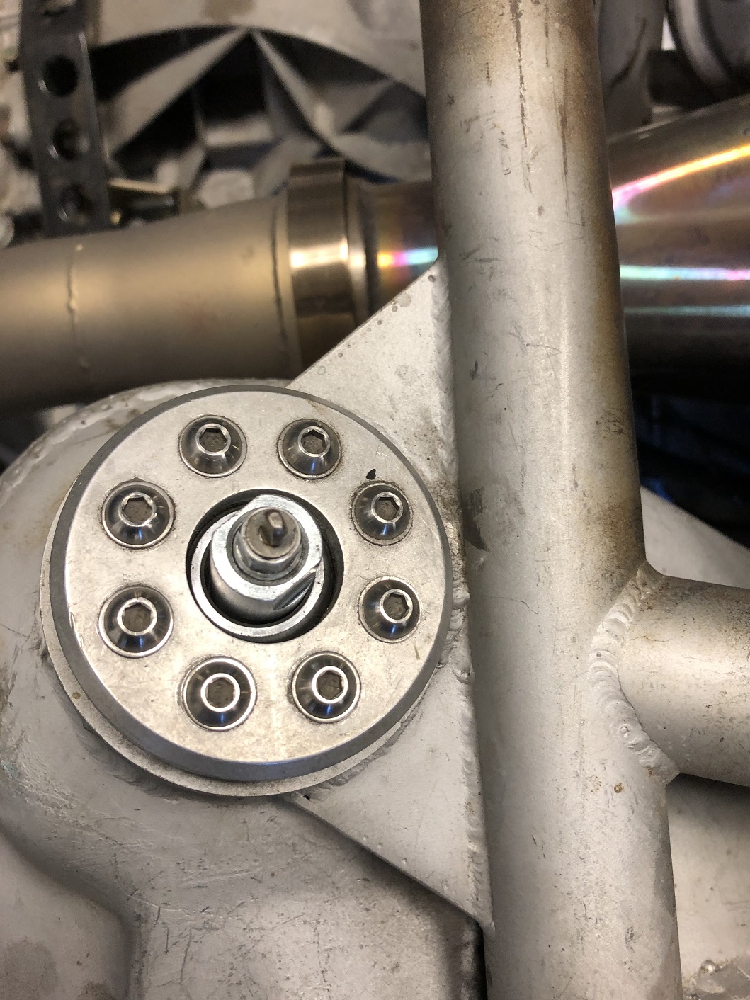

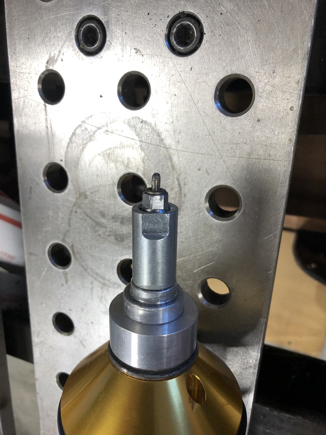

And here's one for the tool whores and any users of @ChrisFoley Tangerine Racing's upper rear shock mounts.
If you don't have this setup in your car, you likely won't understand, nor would you need to! If you do have it, and haven't come up with your own solution, you can buy me a coffee when/if we see each other:
The upper mounting bolt on the shaft can only be installed AFTER the shaft passes through the multi-piece spherical bearing. This means there's nothing holding the spring in place during install until you get everything fully seated in the upper mount. I found it a real treat (IMG:style_emoticons/default/headbang.gif) trying to get the shocks installed by myself until I noodled out this solution:
Take the stock top fastener, and cut off that flared part. Install the spring and use the now modified piece as the top bolt. It just happens to slide right through the Tangerine spherical bearing! Attach the shock to the trailing arm, jack it into place, remove your home-made top nut tool, install the upper spherical bearing spacer and shock top nut. Ta-da! The shock is in place with no muss, no fuss! Shock removal/installation is now an easy one person job.
You're welcome. (IMG:style_emoticons/default/shades.gif)

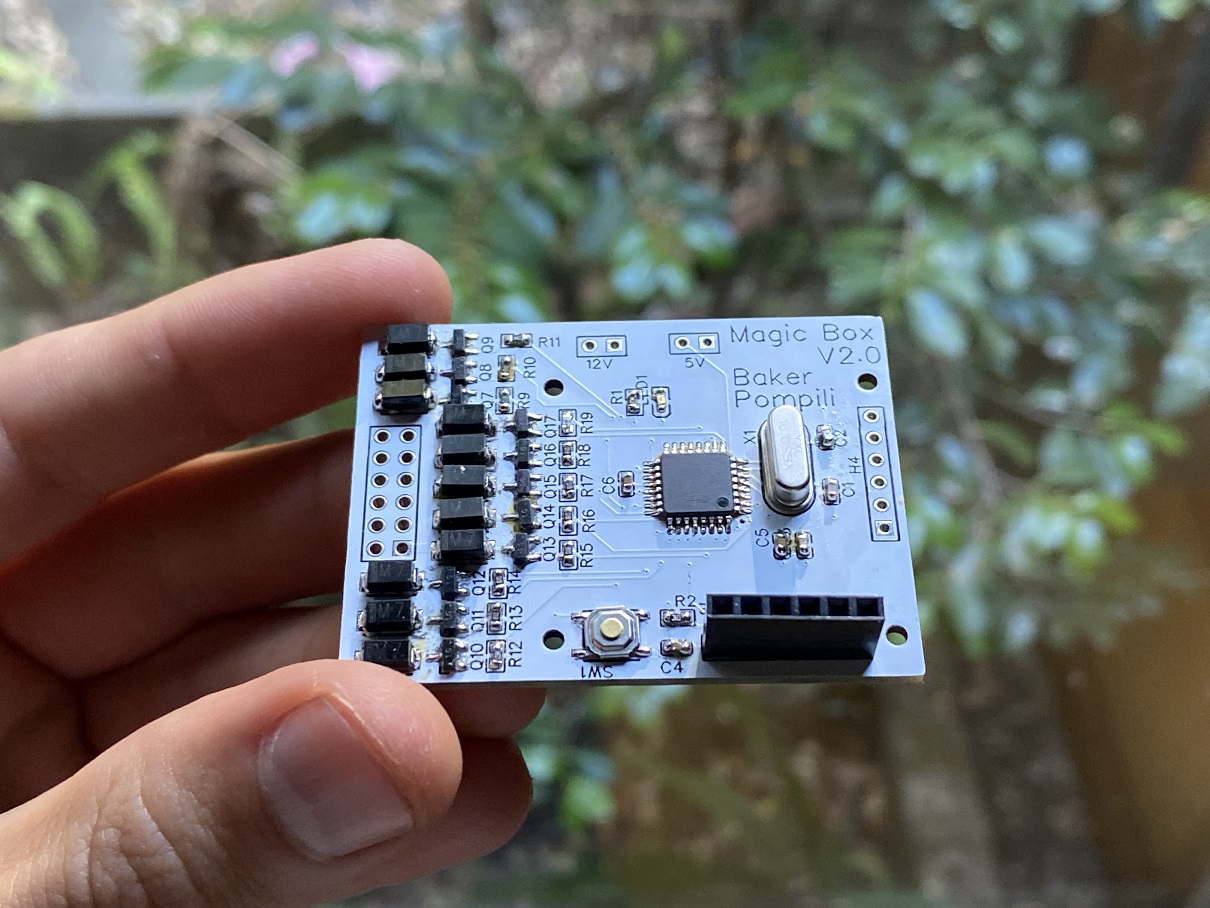

Progress on tidying up the wireless steering wheel button improvements.
At the very least, it gives you an idea of how small this contraption is going to be.

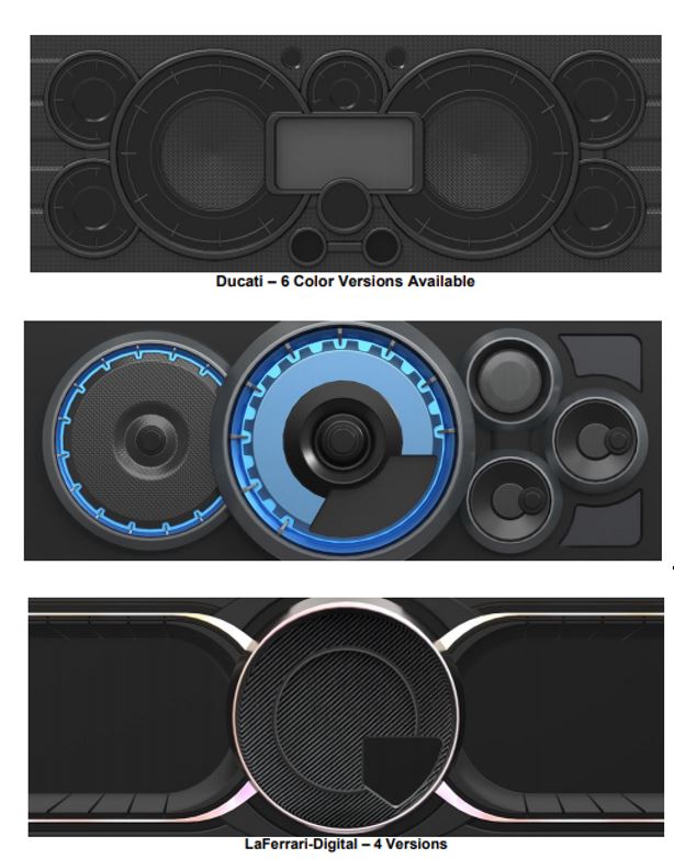

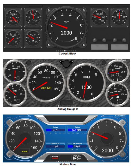

And as long as I'm replacing things, I decided I'd give the Holley digital dash a go, too.
I used the following to convince myself it's a great idea:
- It's plug & play with the Holley ECU - no extra sensors needed
- The dash reports what the ECU sees/does - lots of interesting data logging capabilities
- It eliminates all the SpeedHut gauge wiring: sensor wiring, for the dash lighting, etc. It tidies things up quite a bit.
- The dash is all sorts of configurable and touch screen controllable. The pics below are only a few of the standard backgrounds. Plus you can design and upload your own. Both gauges and digital switches can be added to the dash. If I need switches in addition to what I have on the wireless steering wheel panel, I can add them!
tygaboy

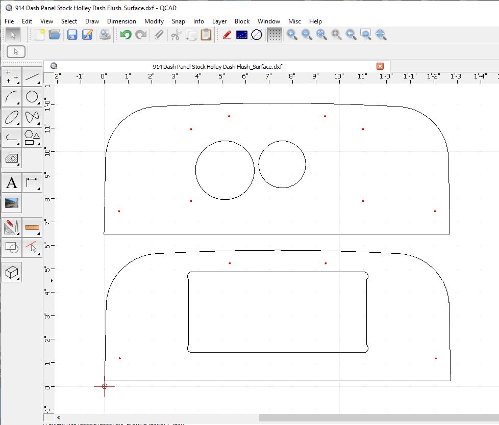

The Holley dash means I need to make a new gauge panel. I can surface mount it (the upper design) or flush mount it (the lower design).
I need to try both and see which I like best.
A little CAD and I'm ready for the plasma table. Hope to get them fitted tomorrow.
