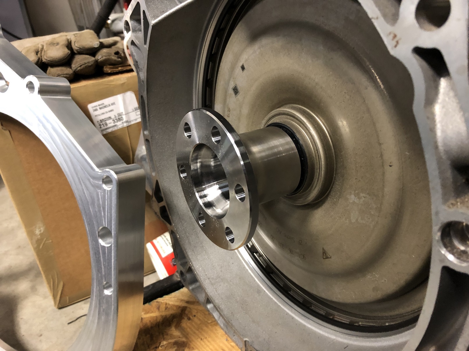

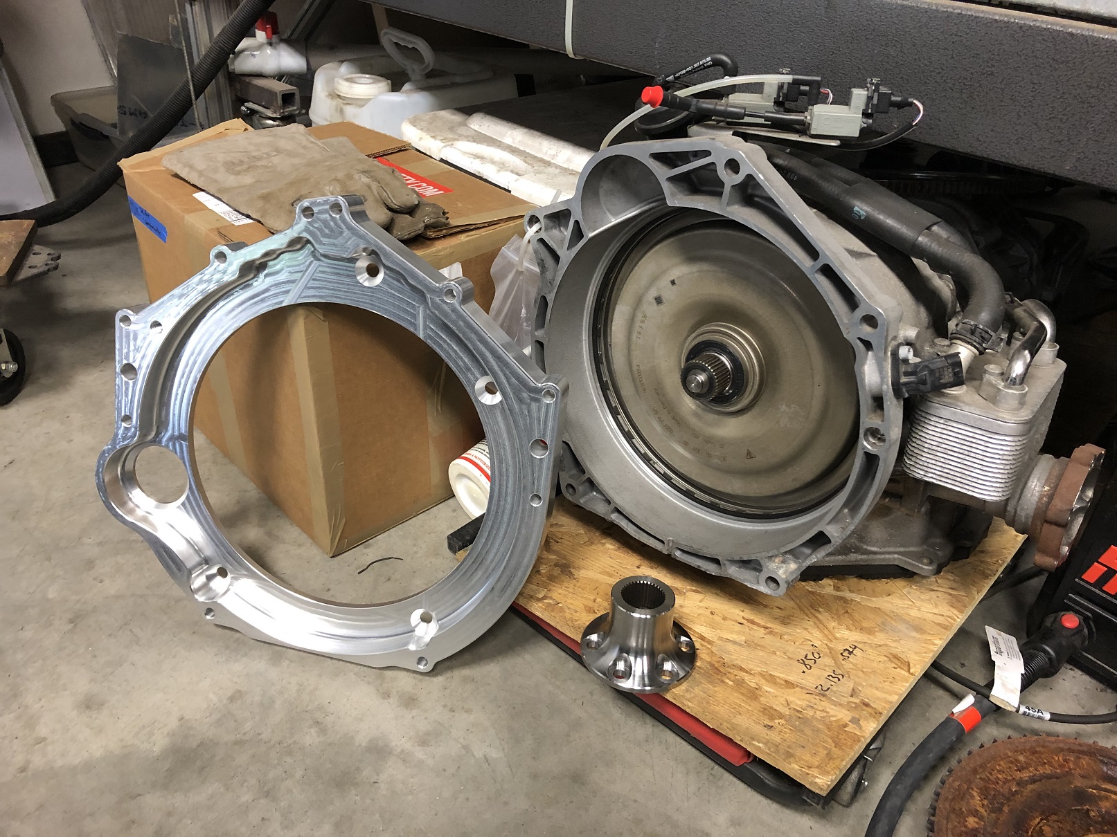

An LS is here, as you know.
A Cayman PDK is here. You can see it right there.
Today's news is that an LS-to-Cayman PDK adapter showed up. How it knew the other components were here, I have NO idea. (IMG:style_emoticons/default/happy11.gif)
There's a ton of work between what you see here and a car that can be made to operate utilizing these components. The TCU (trans control unit) I need to use is "getting there", in terms of real world readiness. So, this subproject is staying on the back burner, at least for a little while. But it's nice to know all the parts are here. And man, are they beautiful! (IMG:style_emoticons/default/wub.gif)
On a bit different note, look at how wide the PDK axle flanges are! I'm a bit concerned about axle length and CV angles, at least in a 914 running stock trailing arms. We'll see...

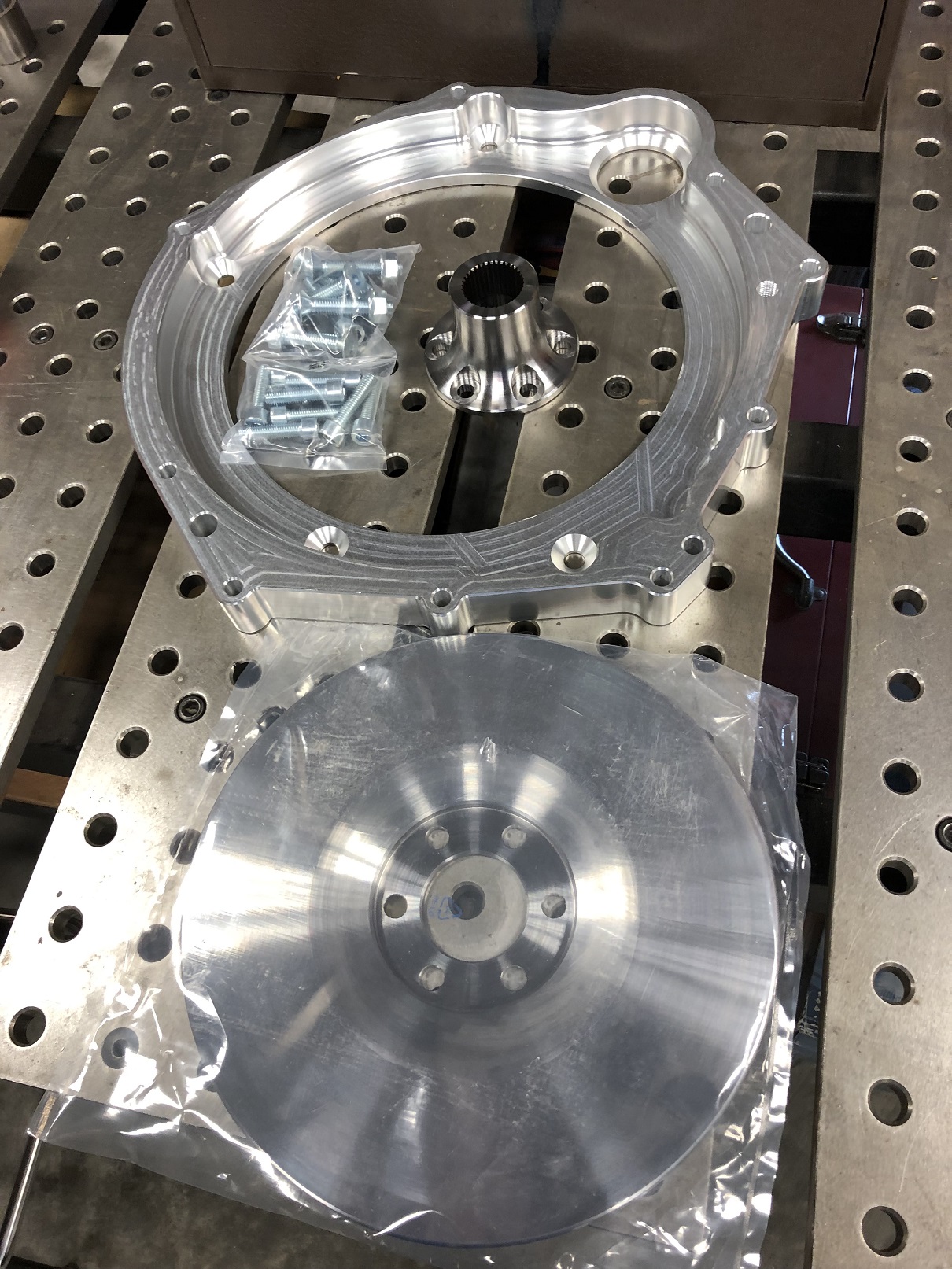

The other parts of the adapter kit. The PDK clutches stay attached to the trans. The plate you see here is the flywheel. A bit funny looking with no bolt holes other than for the coupler flange. An LS flex plate gets put in there, too, so there'll be a ring gear for the starter.

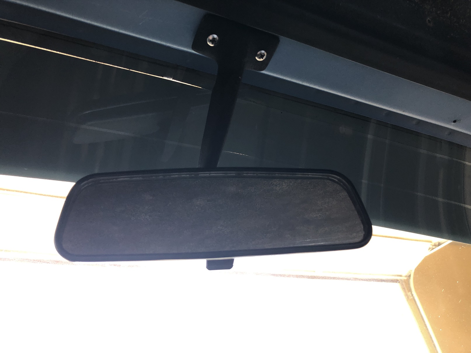

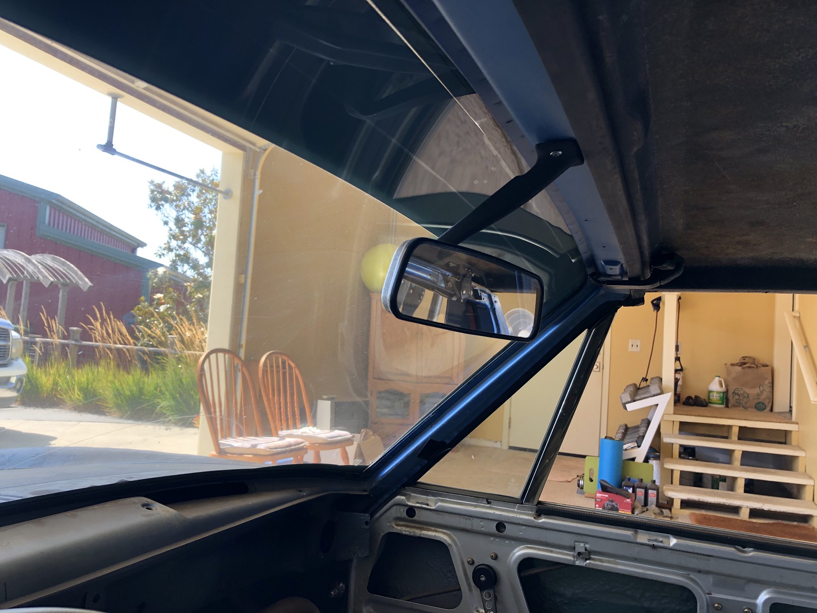

Finally, some actual 914 content! Wait. Actually, no.
This is a BMW 2002 mirror. Sorry, I gotta get better at this. (IMG:style_emoticons/default/laugh.gif)
For those of you interested, this is a super cool update. You do have to carefully drill and countersink for the mounting screws and cut/grind a small bump on the mirror's mounting surface. That's all pretty easily done. And once it is?
No more "mirror stuck (or not!) on the windshield". I haven't yet drilled this for the visor mounts because I think I'm going to run a largish shade band instead. What you see on there now is Gorilla tape, because Tygaboy. Hey, it let's me quickly test how big a band I want, what works while still allowing me to see traffic lights, etc.

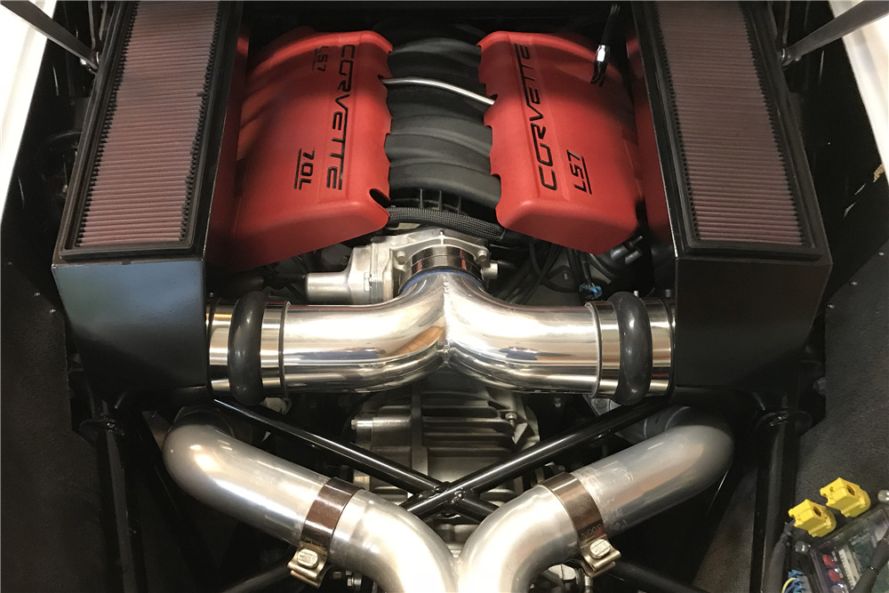

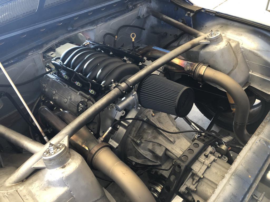

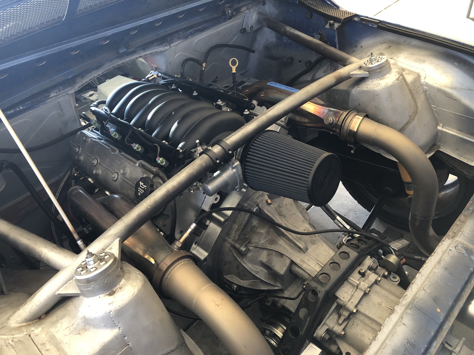

And right back to non-914 stuff! Again, not ITBs but still pretty cool looking. The Holley EFI systems are speed density systems so I don't need the traditional MAF sensor ahead of the throttle body. With a MAF sensor, I'd need some amount of intake tube between the air cleaner and throttle body. Not with the Holley stuff. I can just do this!
Yes, this is essentially the exact opposite of a cold air intake set up but it gets me running again. I have a couple ideas for isolating the air cleaner from heat. @Retroracer Tony, you know what I'm talking about...! (IMG:style_emoticons/default/happy11.gif)

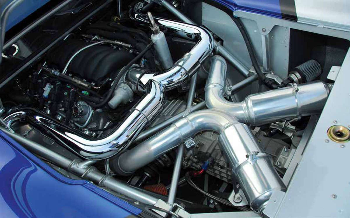

Speaking of air cleaner ideas, I have no issues with an "imitation is the sincerest from of flattery" approach and I stumbled onto the Factory Five GTM intake set ups. I think I can leverage some of these ideas and still keep the current headers. If not? I've always wanted to build my own headers...
How about like that top picture with the intakes being fed by vent's in the fenders? Like @OptimusGlen Glen's rendered versions? (IMG:style_emoticons/default/drooley.gif)

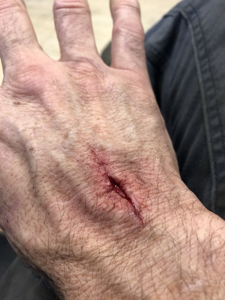

POTENTIAL GORY PIC ALERT!!!
On the other hand (literally! (IMG:style_emoticons/default/lol-2.gif) ), you all forgot to wish me well on not being injured!
This was RacerBenz related. As I was working away on it, one of the "in-place but not yet tacked in" roll cage tubes fell out of position and the wonderfully mitered (read "sharp") end landed smack on my hand.
The fun part was when I moved my fingers, all of which thankfully still work, I could see one of the tendons moving back and forth. That's when I decided I should sit down for a a bit before heading to the ER. Virtually no blood but man did I get light headed. In the end, it was a quick stitch job and I was back in the shop this afternoon.
Anyway, another reminder that we need to do all we can to be safety minded. So you all be careful out there in your shops!
