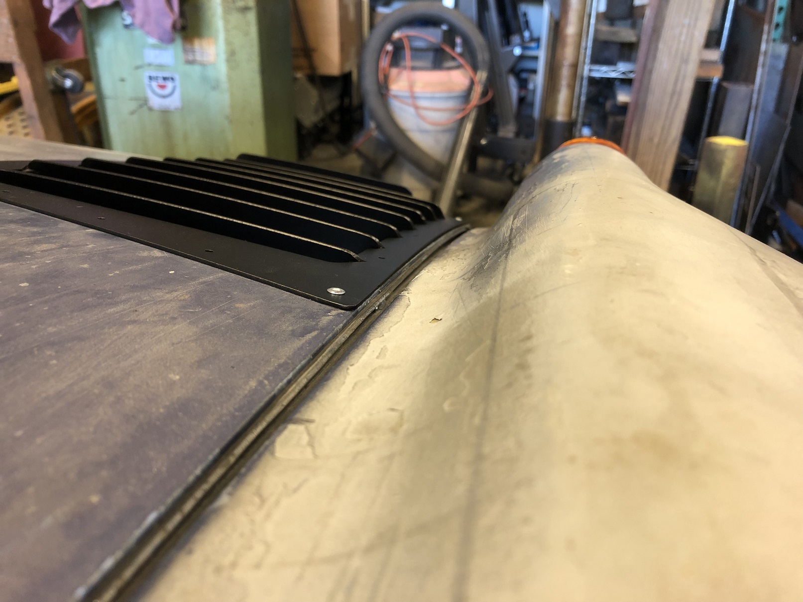

Another detail no one will notice: The hood vent vane height is graduated. Each is shorter by the same amount, moving front to back. This to echo the way the difference in height changes between the hood and fender as things move toward the back of the car.
Am I too into this sorta crap? (IMG:style_emoticons/default/idea.gif)
No, I don't think so. That's my story and I'm sticking to it. (IMG:style_emoticons/default/shades.gif)

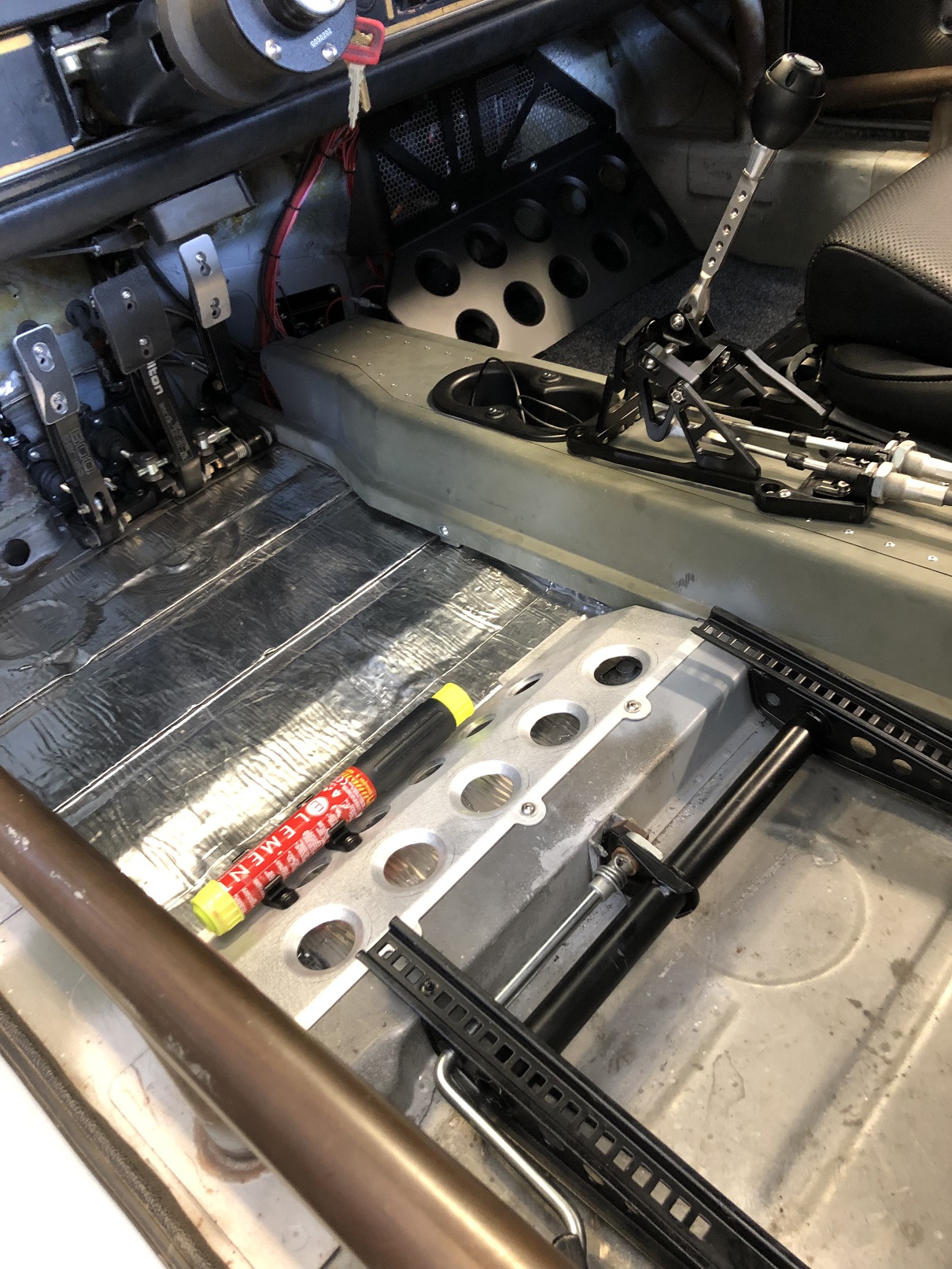

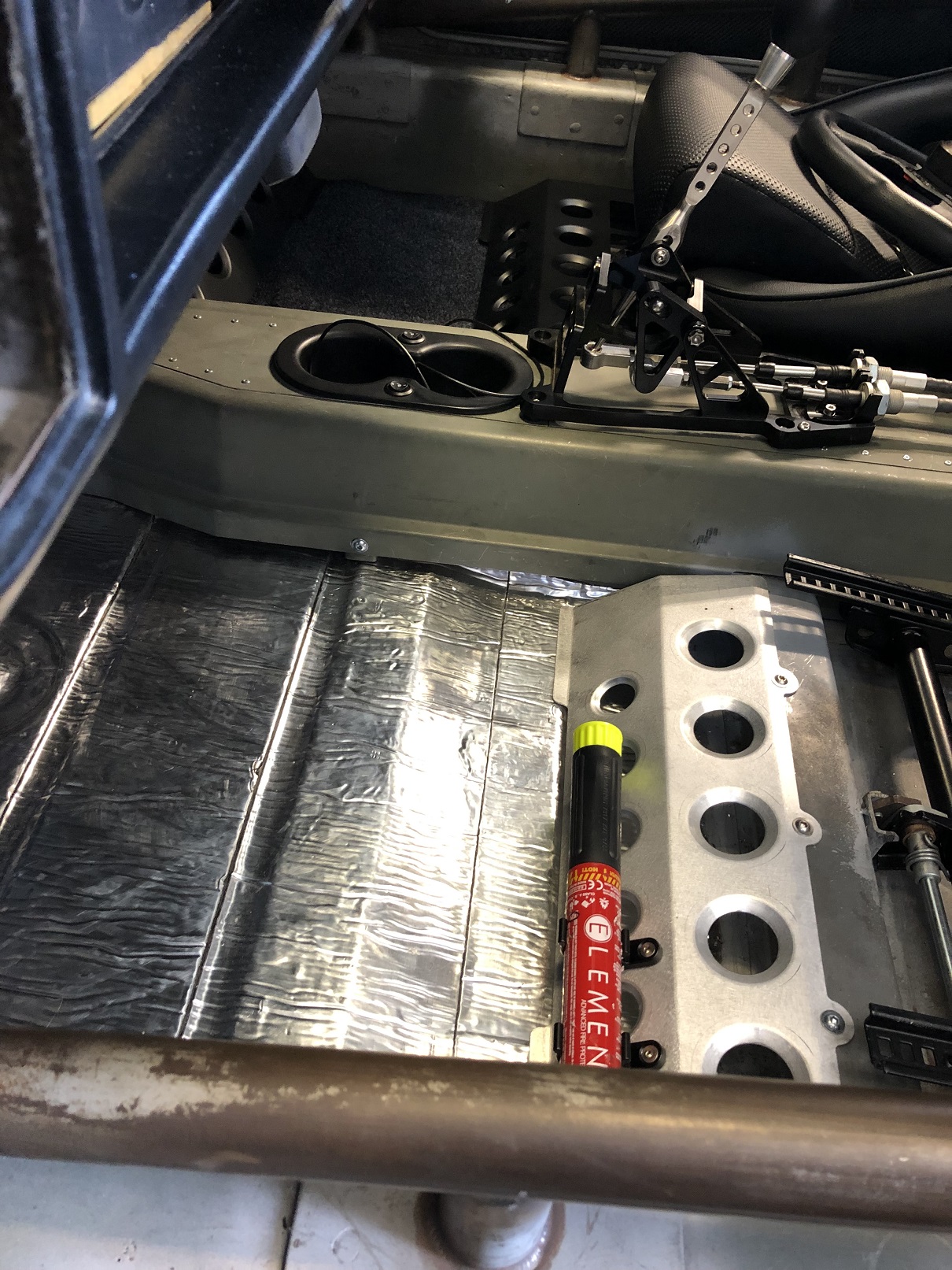

Today it was the fire extinguisher mount. You know me and matchy-match so it's utilizes the same design as the passenger side's ECU cover and passenger foot rest.
It, along with the tunnel console, now head off to get the same matte black powder coat as those other pieces. Re: the console, I'll drill out those temporary pop rivets before it's coated and once it's back, it'll get the fancy CherryMax rivets! Should look pretty good.

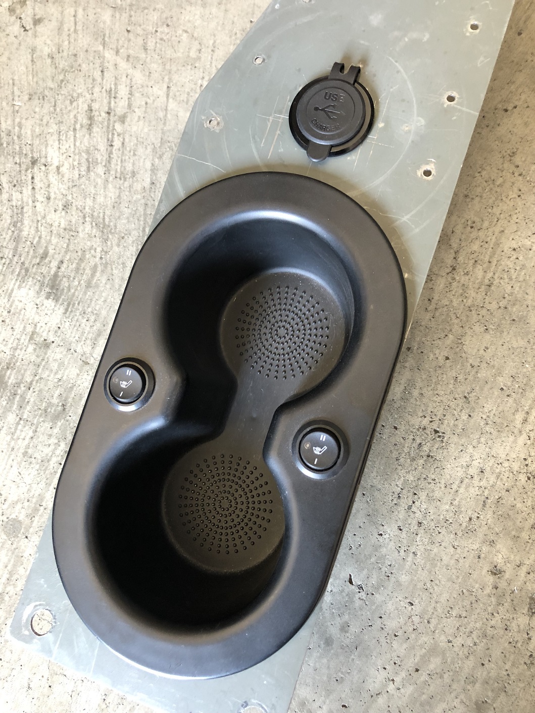

Ahead of getting the console powder coated, I decided to add another creature comfort by way of a dual USB port. I noodled on hiding it somewhere then figured it should be easy to find/use. Plus with the console going to be black and the cup holders there already, these items will sorta disappear in what @buddyv Robert calls the "shades of black" around the interior.

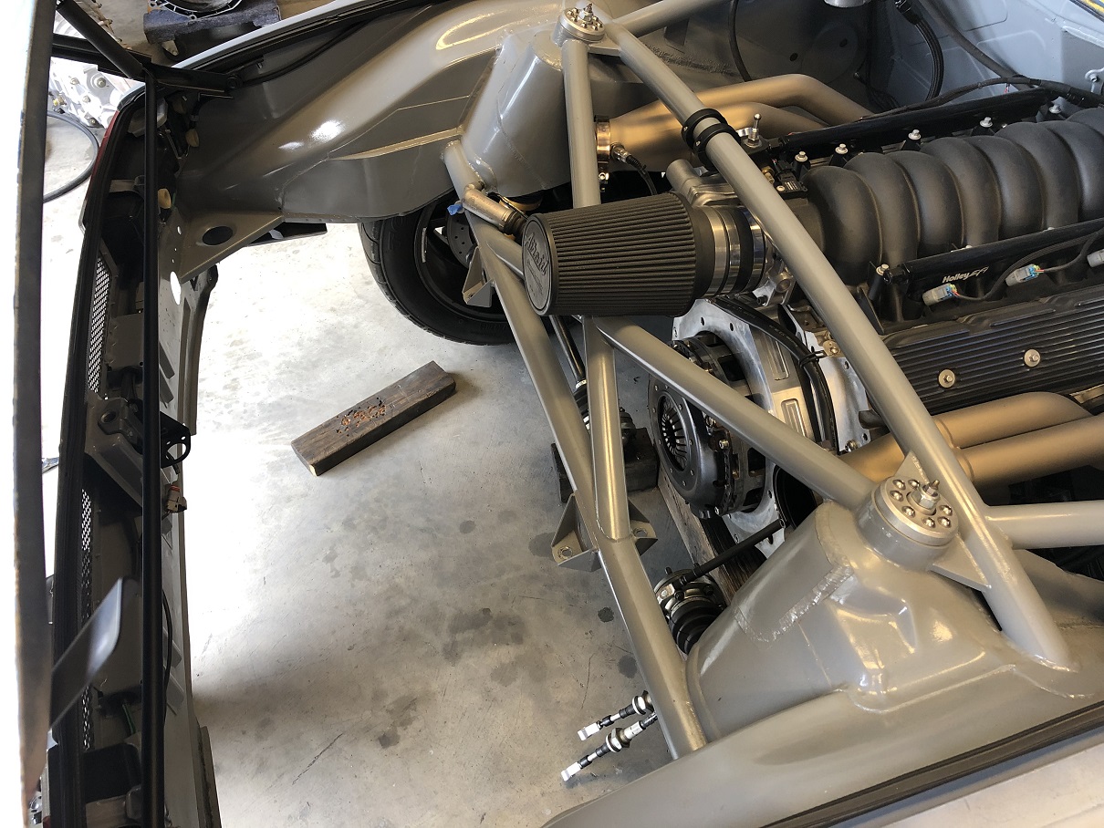

Oh, it's just as beautiful as I remembered. And I gave the "lane selector" a quick test - it's fixed! I'm so excited!
I bolted on the mounts.
Did I say how excited I was? Well, I was very excited!
I wrestle it under the car and with a bit of grunting and swearing, it's back in the car!
Man, am I excited!
So excited that I snap a few pics and text them to a @buddyV Robert, @Markhoward Mark, and a couple other buddies, bragging about how fast I am and that I should be a Le Mans mechanic. Boy, was I excited!!!
Then as I'm going to install the clutch slave cylinder, I look across the back of the car and see the throw-out bearing and actuator arm, sitting there on the fixturing table...
I was suddenly not as excited as I'd previously been. (IMG:style_emoticons/default/av-943.gif)
Out comes the trans, in goes the throw-out assembly and back in it all goes. And out the window goes my career as a Le Mans pit crew member.
