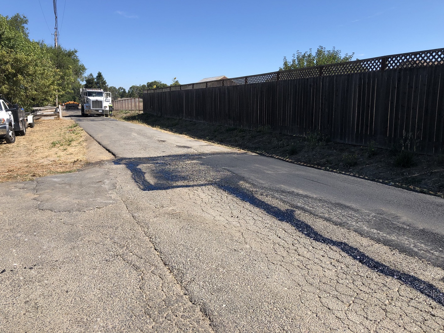

BIG NEWS! The giant potholes are filled and the speed bump has been removed! 22 years I've been driving over that thing. Crap, I'm going to miss it... literally! (IMG:style_emoticons/default/laugh.gif)

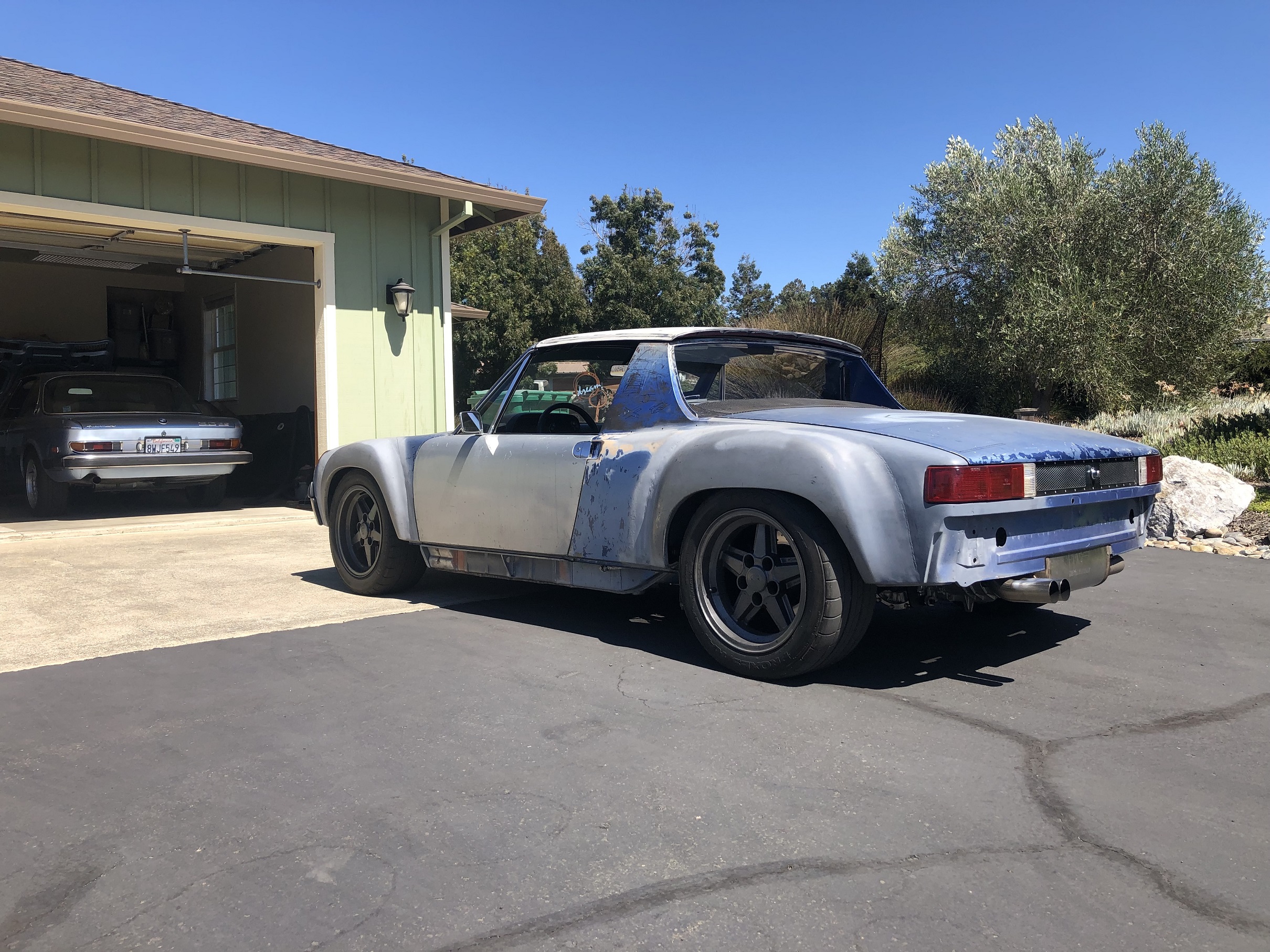

And after a few miles with the re-rebuilt trans? Best shifting trans ever? Well, top 5 anyway. Man, this is such a cool car. It's funny, I walk right past the E9 and hop in the 914 everytime...
And those of you who know me know what that means. Yep, the E9 is "available to buy". I'm not advertising it or putting it on BAT. I just put the word out to a couple folks that if the right price were offered... and, wouldn't you know it, I have a serious buyer coming to see it next week.
You're thinking "What? You just got it back with all the cool stuff done to it!"
Yep, that's true. But as I've said many times, I'm about the journey, not the destination and I can now add "E9" to my life experiences! And if the offer is what I expect it will be, I'll have a bit more room in my head and my garage! (IMG:style_emoticons/default/lol-2.gif)
If it doesn't sell, I'll keep chipping away at improving it. I'll keep you posted. In the meantime, if you need me, I'll be all over the Ferrari build!

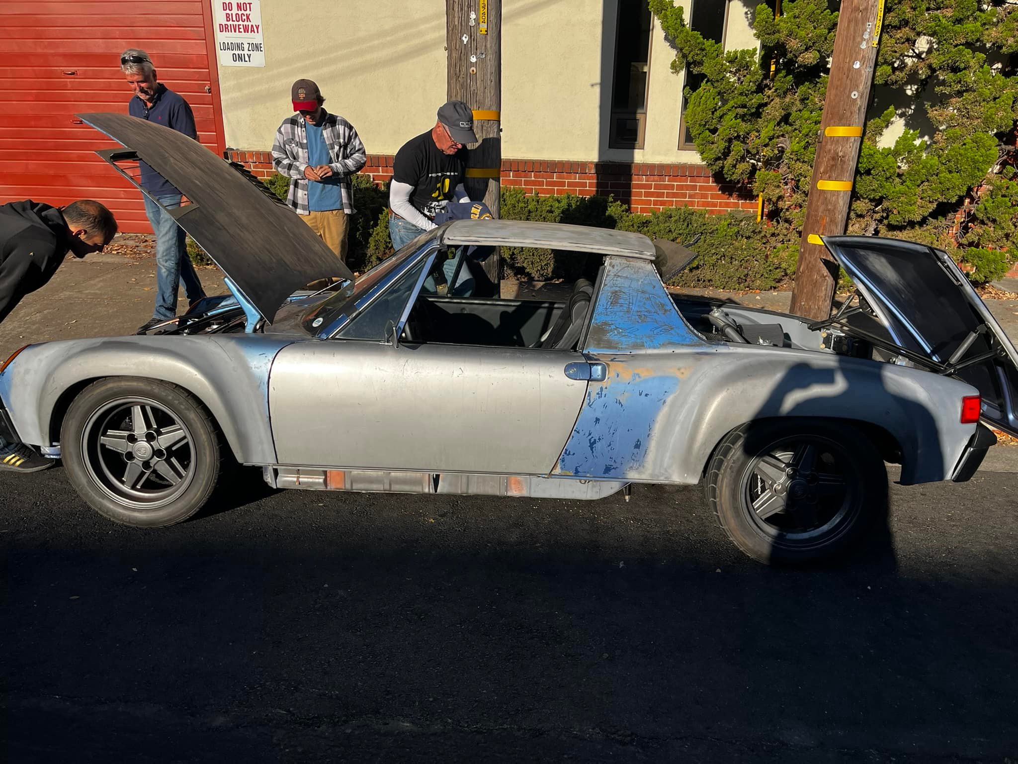

A fun morning at EASY. I met a bunch of new folks and the car got a fair bit of attention. This pic was posted on FaceBook before I even got home - so I swipped it.
Anyway, it's running really well and everything continues to work!
