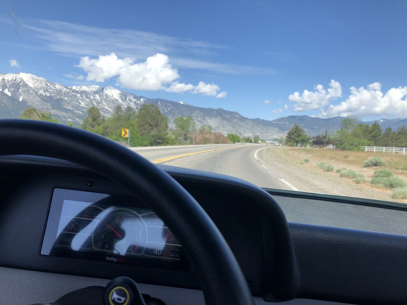

I stopped at my tuner's on the way up. AutoTrend EFI in Diamond Springs, CA. Dave Erlich is a great guy... I wanted to tweak the pedal action to slow down the off-idle response that I'd previously sped up. That took 2 seconds. Then we went out for some on-the-road tuning. I was mostly after any improvements he could make to driveability and, most importantly, fuel economy. I'd been getting like 12 mpg. Note the base maps in the Holley ECUs aren't set up to maximize economy. So after a bit of magic, the first time I checked, I got 20 mpg. So a big improvement. And overall, it's a much more pleasant driver.

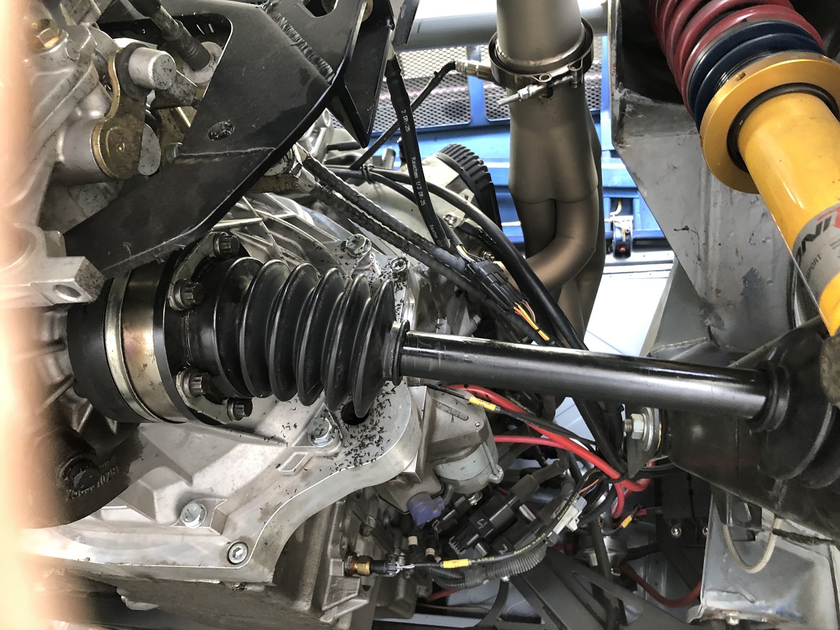

I suffered an inner CV boot failure. Interesting given the whole "moved the drive train forward to reduce axle angle..." But the failed boot didn't show any signs of abrasion and the one on the other side looks fine. Yes, I'll replace that side, too. Just not today!
In any case, I worked with McKenzie's Performance in SoCal and upgraded to a system that stands up to off-road abuse. The boot is totally different and seems more pliable than the factory item. Should be overkill for my use but when's that ever stopped me?
Anyway, here's the not-yet-failed factory set up:

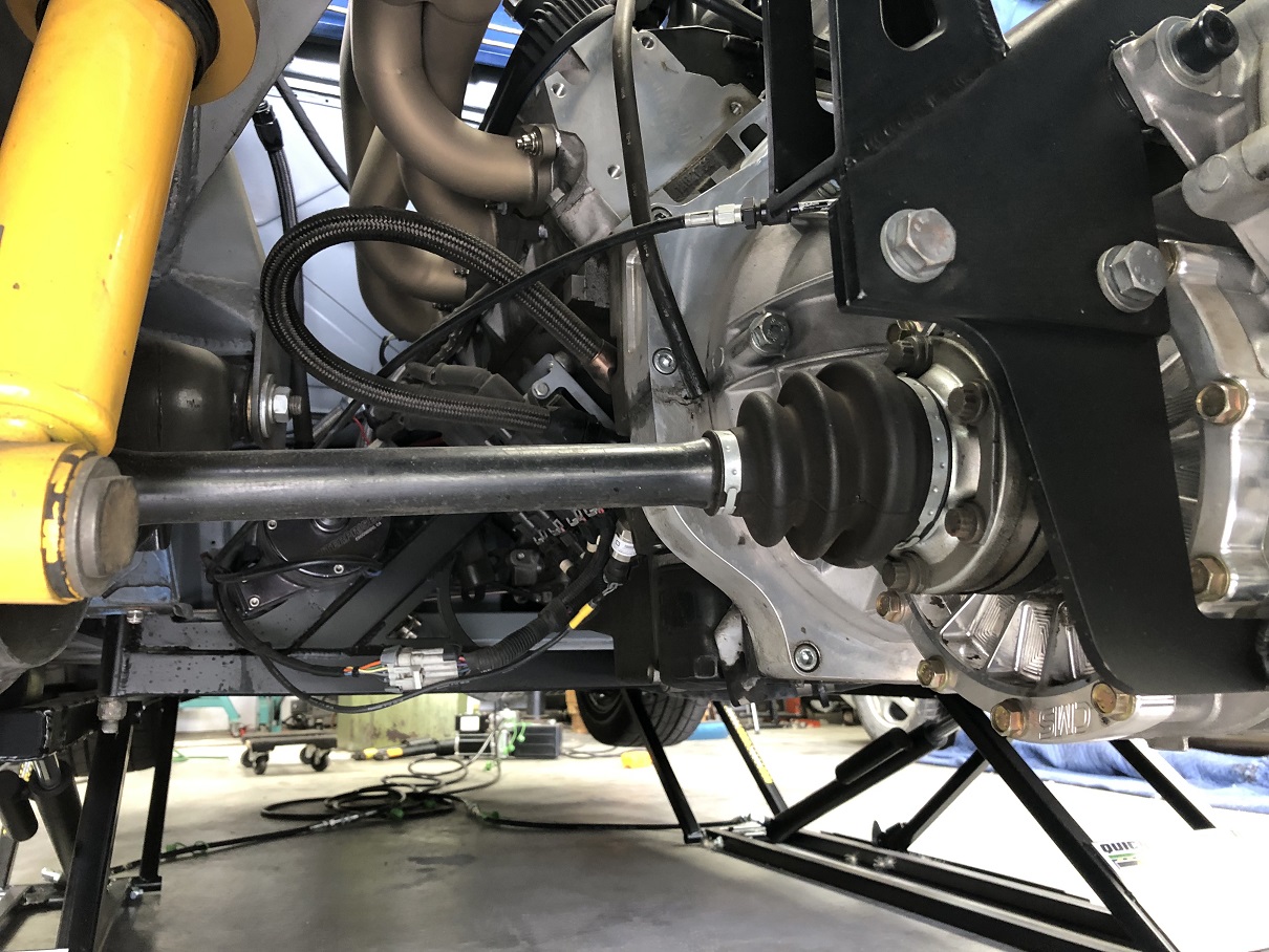

And the zippy, cool new set up. And no, I haven't yet cleaned up the spewed grease.
A couple things: The large side of the boot now slips over an upgraded CV flange plate that's a nice machined piece vs the factory stamped one.
And the recommendation is to leave the clamp/zip tie off the inner/small side so the boot can slip and slide as needed and not add stress to the boot. The parts look cool, too!

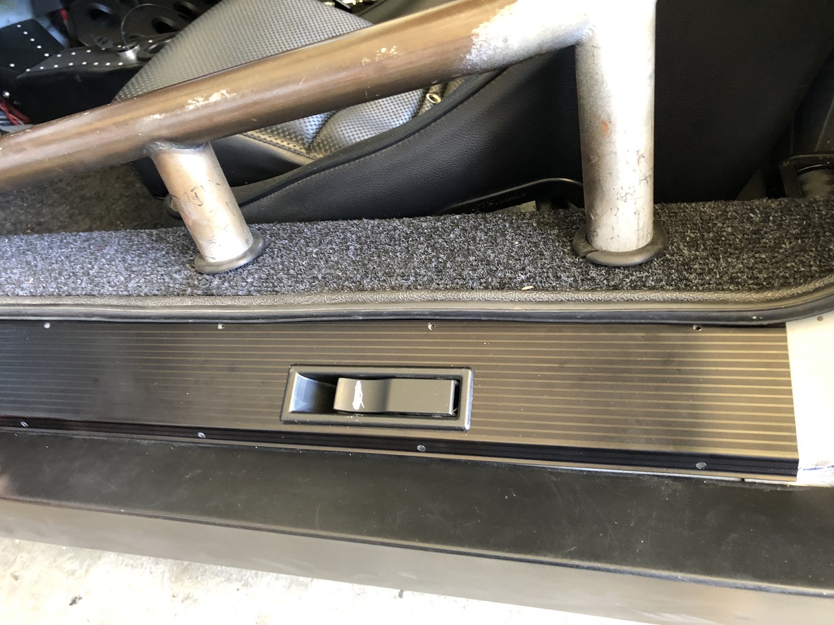

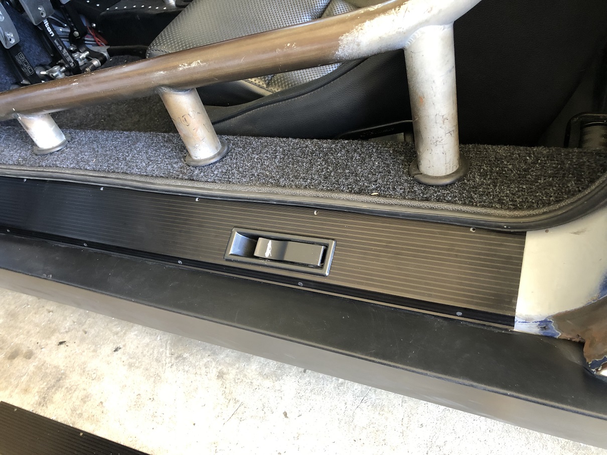

Ferrari meets 914, again! I decided I didn't like the trunk release button so started noodling on options. My car had a 911 reflector when I got it so I have the solenoid mount. I wouldn't be the first to work up a cable release, but - and I know you'll find this shocking - I wanted something unique in terms of a release system.
Ferrari 360 parts to the rescue!
A little head scratching about placement, a bit of clearance work and... one "in-the-door-sill" release latch!
Cool thing is with the door closed/locked, it's secure.
No, the cover isn't riveted on yet, just set in place.
Frosting on the cake will be I'll remove the Ferrari graphic and get one that's a 914 silhouette with the trunk opened in reverse, to match what my car actually does.

Chris - seems every new detail is my new FAVORITE detail!

I really like that trunk release! I have never seen that done before. Truely a one of a kind 914.

That looks awesome! You have a great eye my friend!

That is totally "Red Barned". Trying to come up with a phrase for something that has been so well thought out and executed we all go, "Why didn't the factory do that?". (IMG:style_emoticons/default/beerchug.gif)
