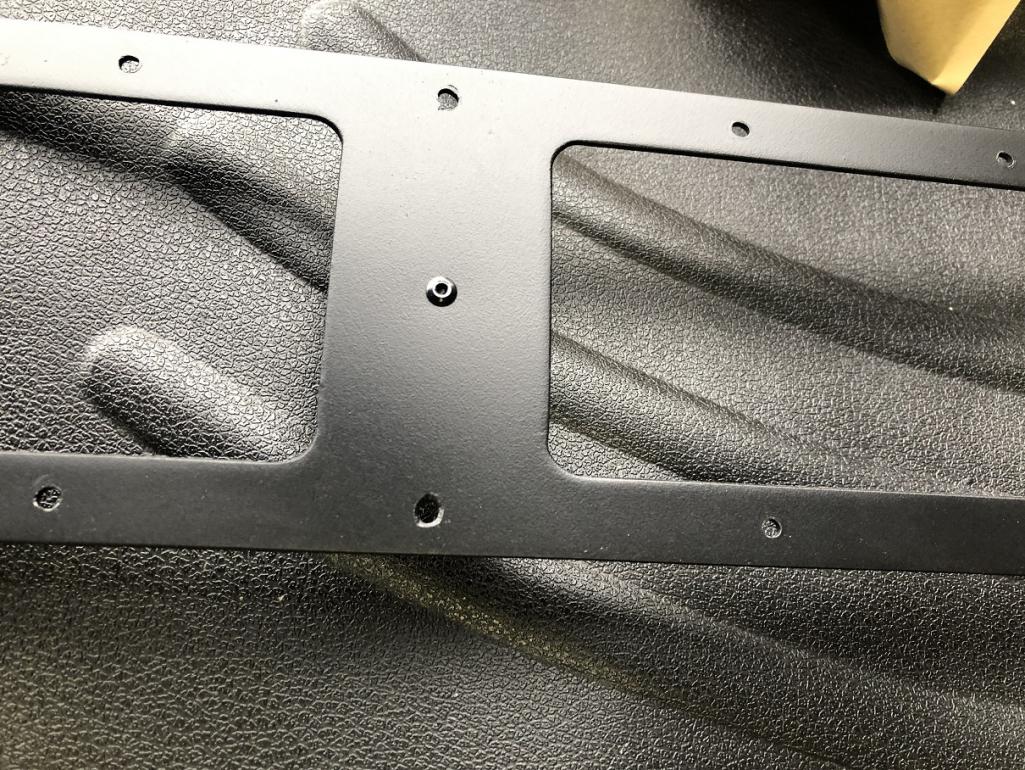

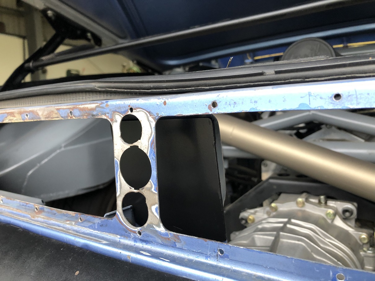

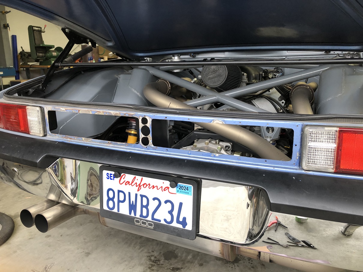

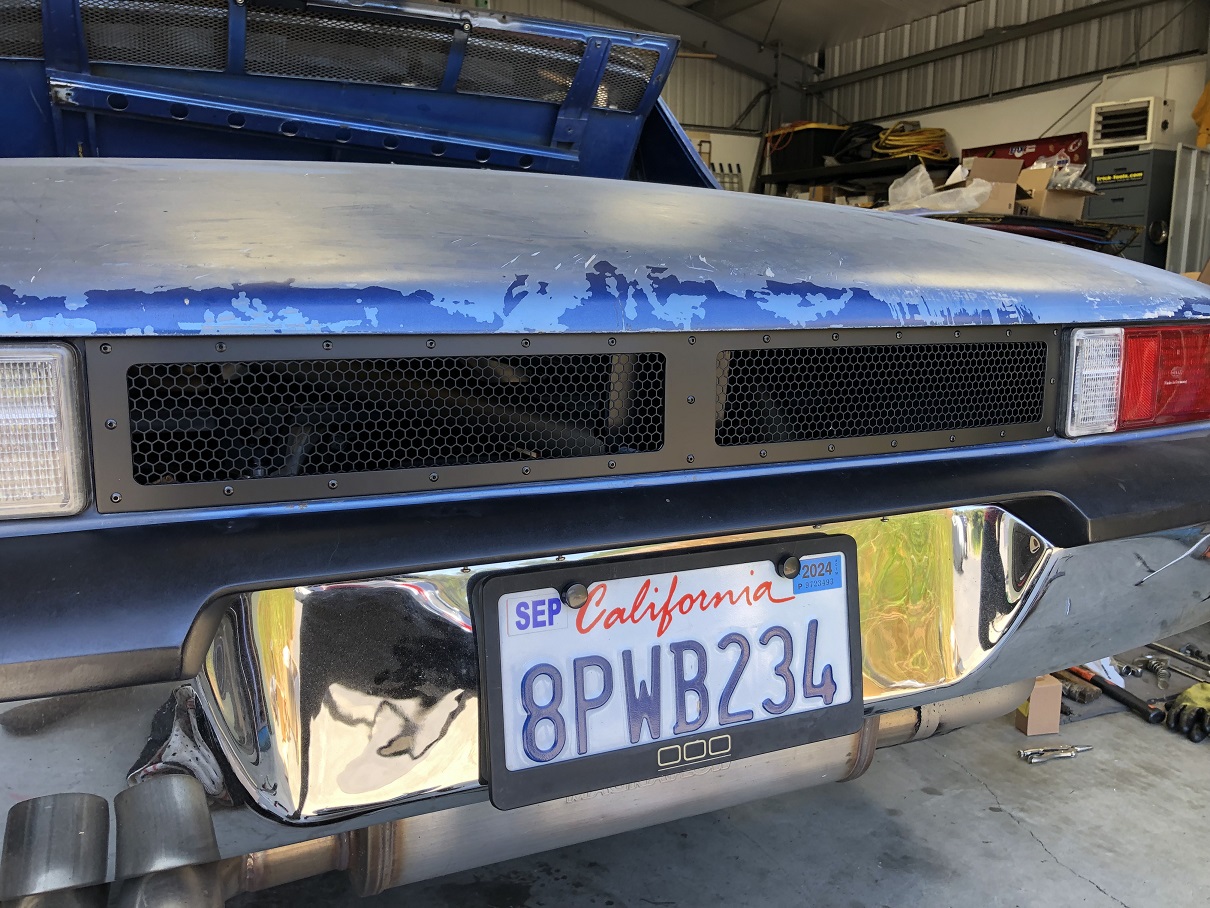

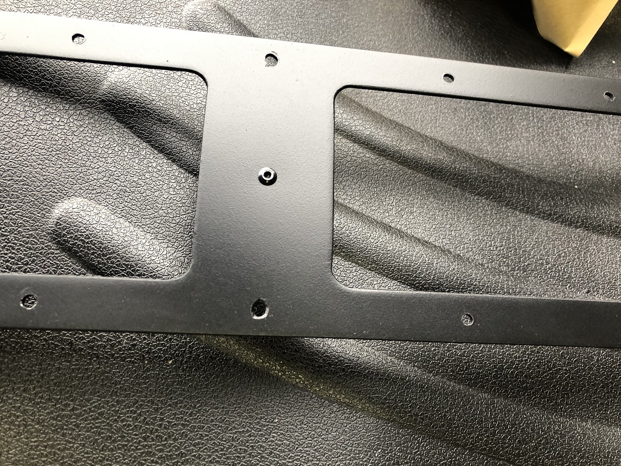

Well, that didn't last long. I needed to work up a block off panel so off things come. I made the panel and opted to use panel bond to install it. This meant I could fully finish and paint it and install it with no additional work required. Smooth and tidy install, no welds to dress, etc.
And it does what I wanted: helps hide the latch support and prevents anyone getting at the latch from outside the car.

@buddyv Robert saw the most recent version and essentially said "Cool, but those silver rivets..." They were always just temporary but when Robert (my style consultant) speaks, I simply have to take action! So black rivets it is. Yep, they're certainly a better fit for the vibe of the build.

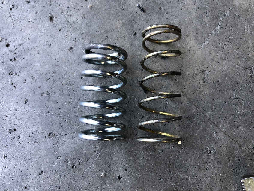

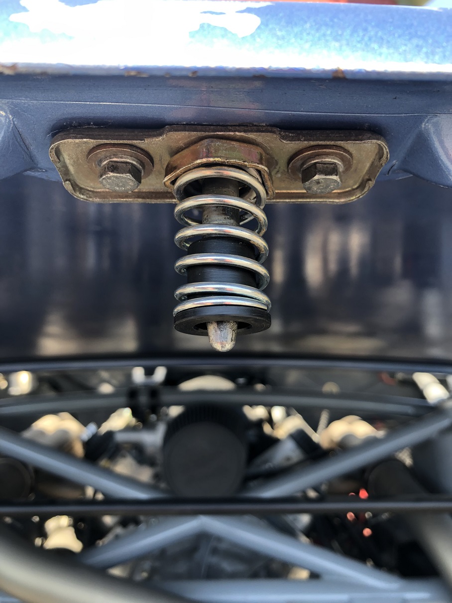

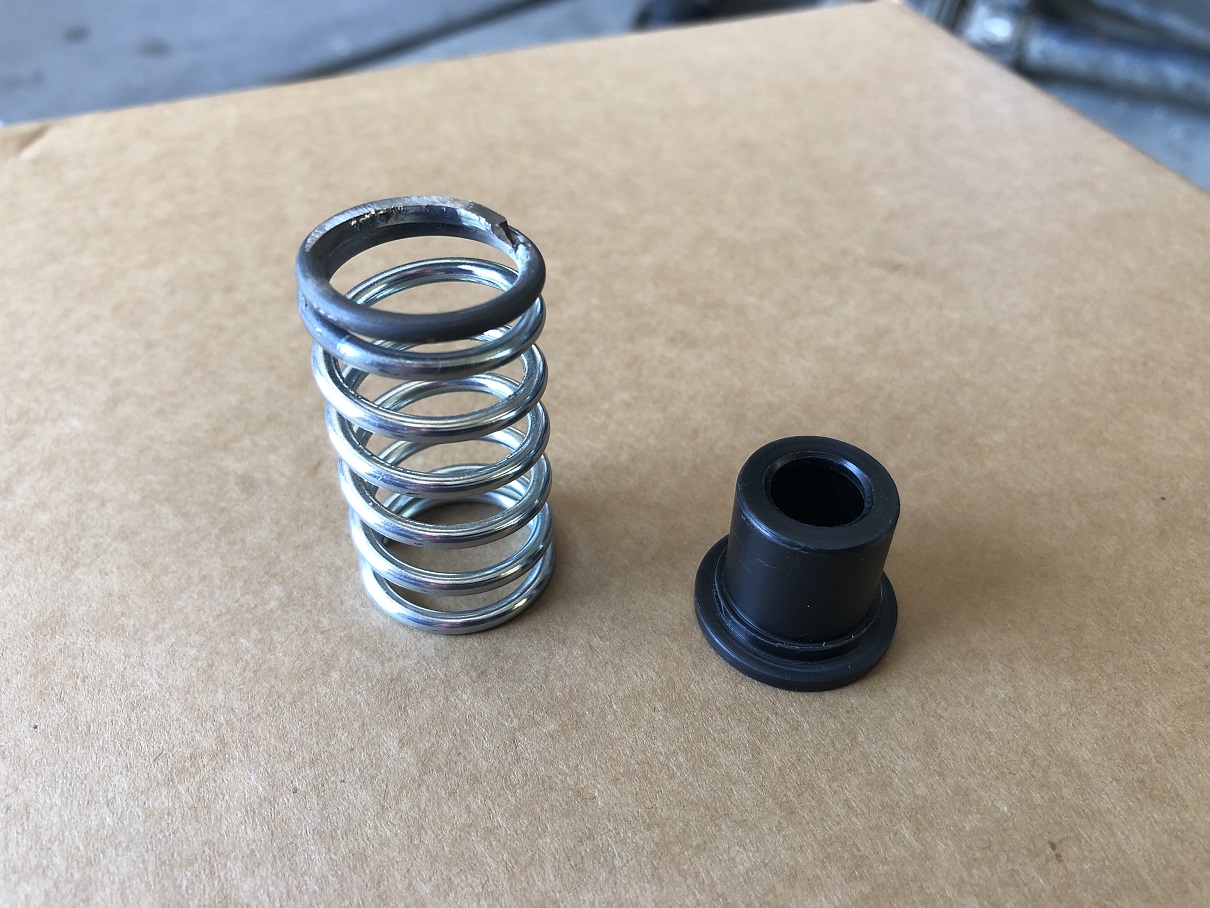

Having always used the trunk button and lifted the lid directly, I didn't notice that the geometry and/or friction introduced by the reverse-open lid catches is juuuuuuust different enough that the factory trunk release spring was occassionally not pushing the lid open enough - and I had to go back and pull the release again.
A quick measurement of the factory spring and an order with McMaster-Carr and I have a bit beefier spring. I did end up shortening it a couple coils and adding a bit of heat to get the new end to lay flat. But all's well now and the lid pops right up.

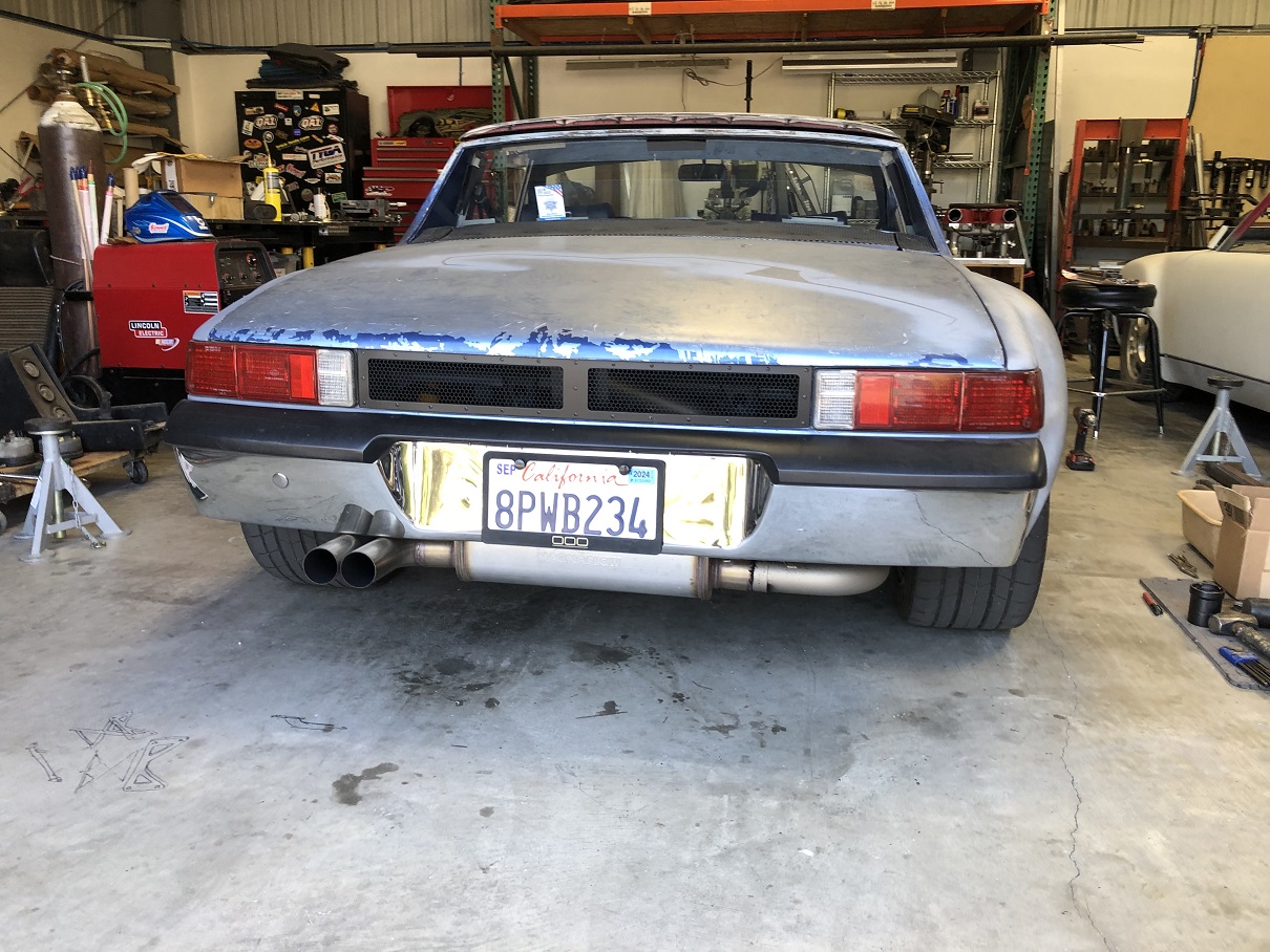

The blacked out block-off panel all but disappears and the black rivets look SO much better. A particular word popped into my head when I stepped back for a first look. I sent a pic to Robert and he replied with the same word:
"Sinister"
Perfect for the look I'm after.

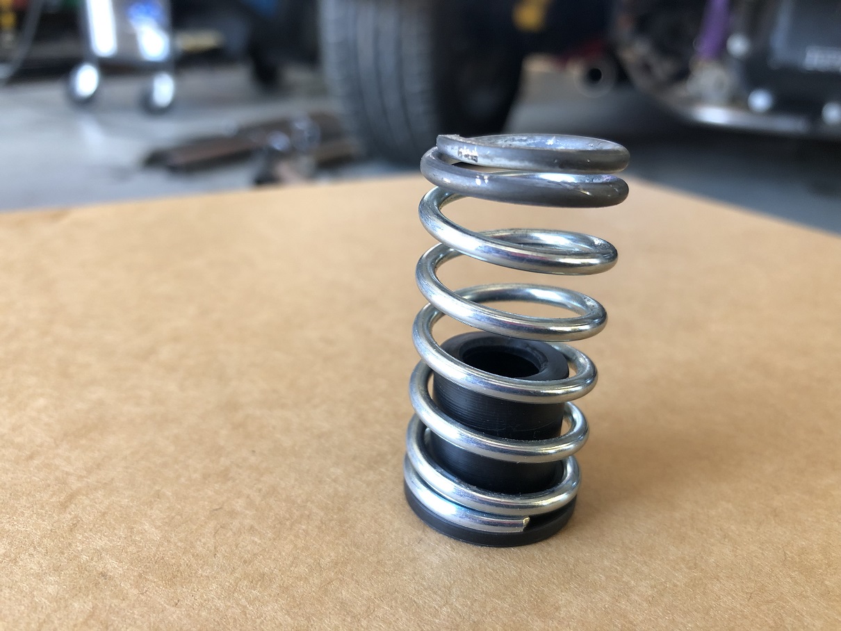

One final touch: The spring is a bit stiffer and I was worried the factory's plastic hat may not be happy about that, at least over the long haul. So, without a lathe handy, I asked Martin to whip up a beefier hat. This is in delrin so no galvanic reaction, no rust and no squeaking! It's a bit thicker in the areas that take the load but overall, retains the proper geometry and spacing for the latch spear.
Looks cool, too.
If anyone's interested in a stiffer spring and matching delrin hat, let me know. There may be a run of them, if there's enough interest. Note the hat works with the stock spring, too.

@Shivers - The spring I used comes in bags of 6 and Martin documented the spec for the hat. I just put together a spring/hat kit for a buddy who has the "weak spring/solenoid" issue. I suspect he'll get it installed and tested this week. I doubt there'll be any hiccups but let me verify my kit works on his car and I'll be back with a price.
