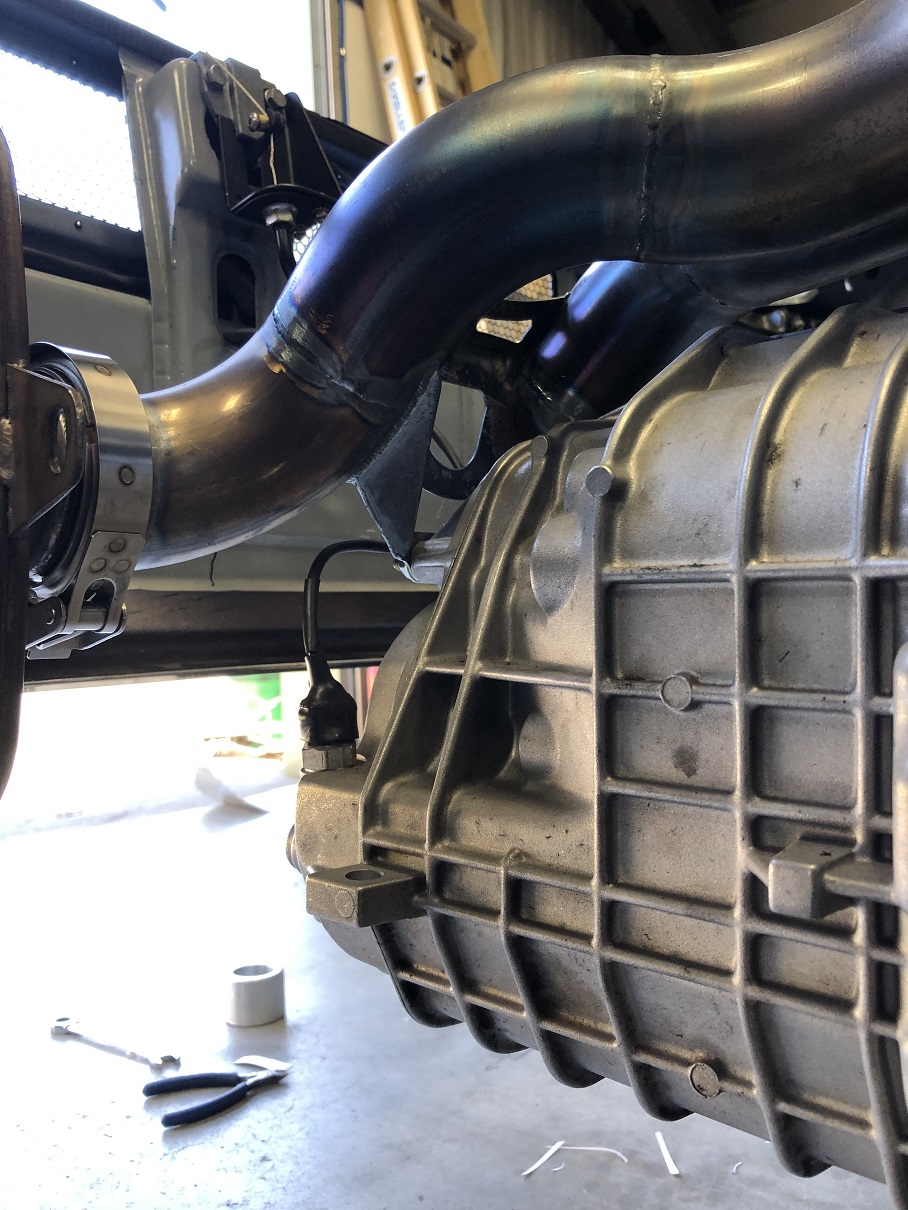

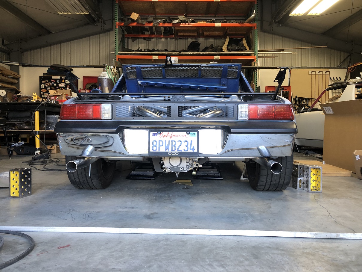

Martin was At The Red Barn today and we focused on getting the exhaust tips fitted and final welded.
They haven't been trimmed to length but I'm super happy with this new exhaust. It met the targeted goals:
- symmetry that pleases my eye? Check
- mufflers all but invisible? Check
- transmission totally visible? Check
I did want the center exit exhaust but this one has it's own sort of style points. Less elegant, more brutish, which certainly fits the build. It's not as "Porsche" as a center exit but it does a lot to add to the "that is a wide 914!" look.

I love the look and can't wait to see the finish length of the tips as well as hear it run. (IMG:style_emoticons/default/beerchug.gif)

You could add exhaust cut outs before the X and have the cut out exits in the center...
You've got plenty of room.
It would be LOUD!
Your mounts are very well designed. They look like they should work fine. Very tidy.
I'd add some type of expansion connection to both sides before the X section.
Might be as simple as slip tubes and springs or true flex sections on v-bands.
I think the temperature swings that the system will go through will over stress that x section and it will fail without some type of stress relief.
Sure looks pretty like it sits...
Edit: Love the new intake. On the LARGE size!
You need a built motor to go along with that!
13:1 with nearly 300 degrees of duration.
600+HP will be attainable through that intake.
You just don't have a car that can apply that power to the ground.
Car will need to weight 4K plus to make that work well.
You're designing a tire destroying apparatus...

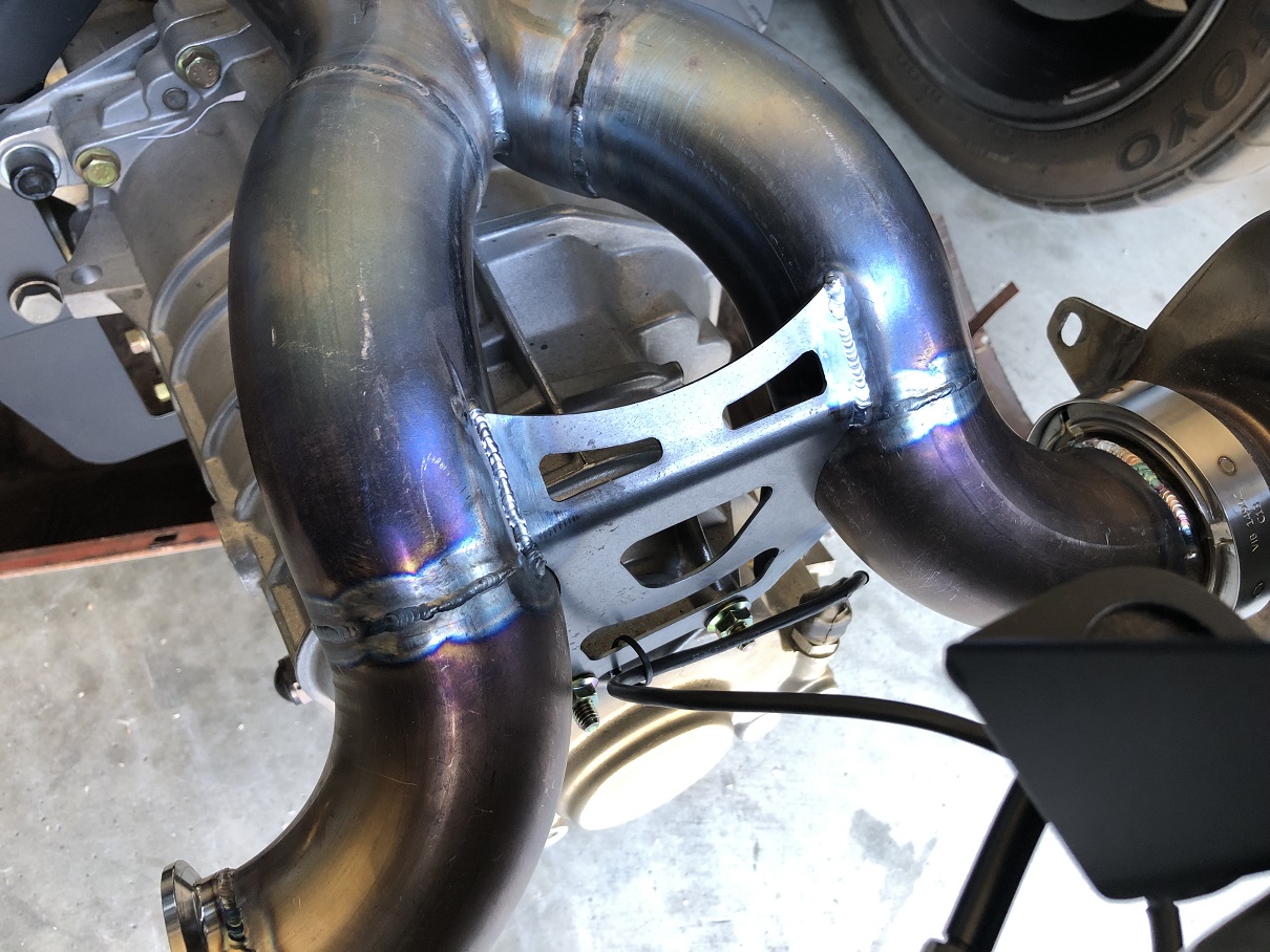

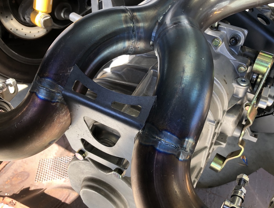

Speaking of which, @buddyV Robert stopped by yesterday and poo-poo'd my initial rear mount. Constructive critisism is great because if forces me back to the design board and (IMO) I invariably come up with something I like more. In this case, it's a folded sheet metal bracket that has WAY more style points. Me likee! Plus, I'll maybe back it up with some mesh, like on the rear panel.

Rear mount fully welded, including a set of underside gussets.

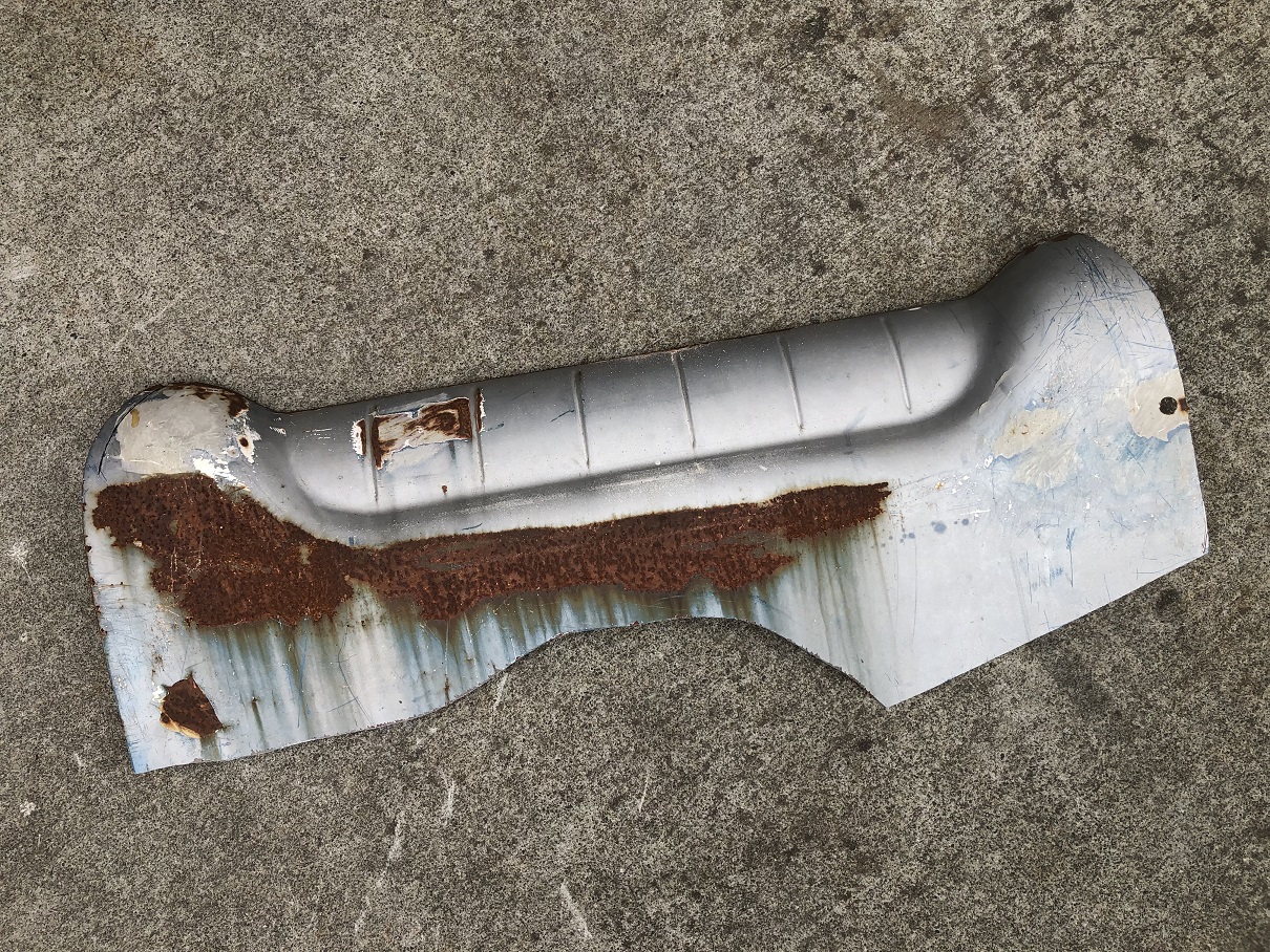

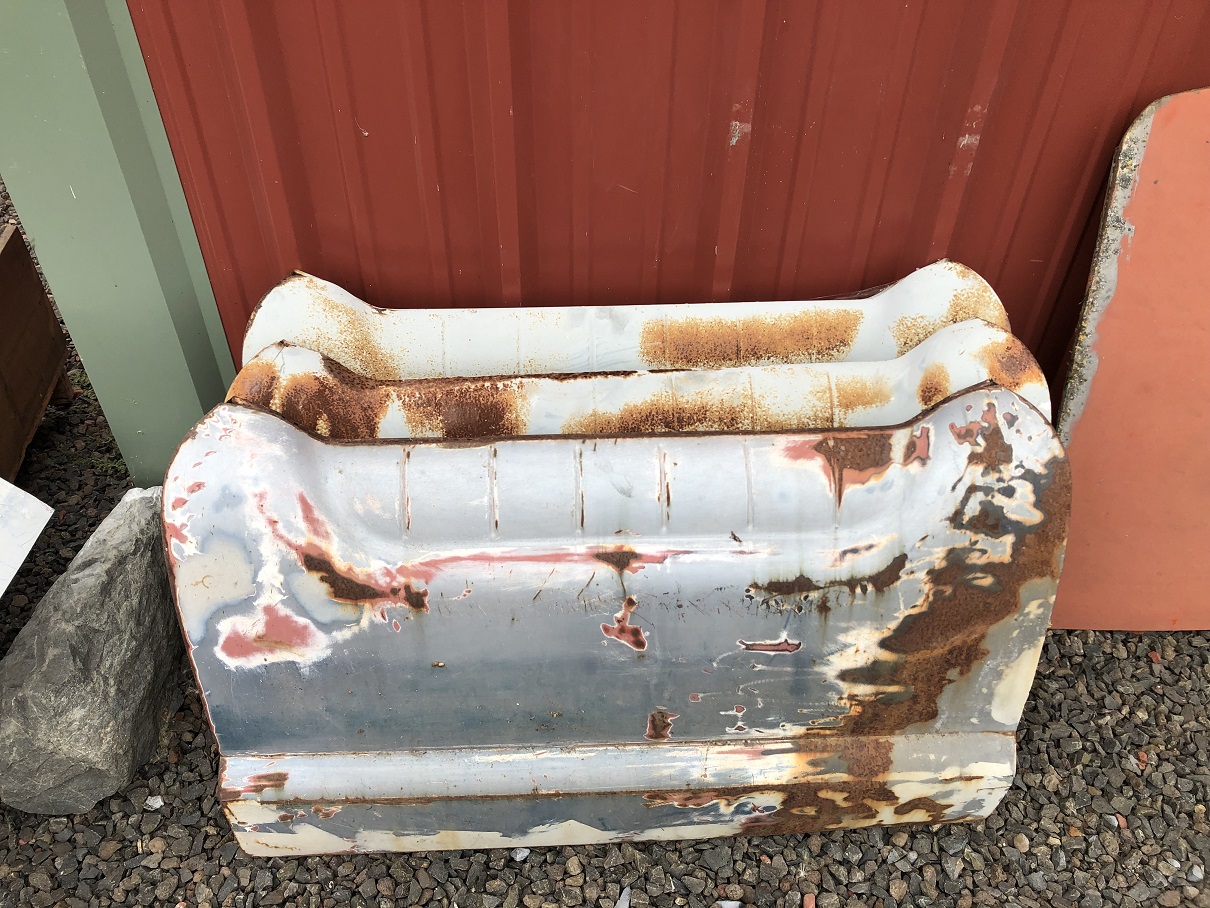

Embarking on another "I wonder if this will work" project. These are Nash Metropolitan doors, one of which I cut up. Will it work out? Place your bets now! (IMG:style_emoticons/default/happy11.gif)
tygaboy
post Sep 16 2023, 05:32 PM
Post #4539
Posts: 5,547
Joined: 6-October 15
From: Petaluma, CA
Member No.: 19,241

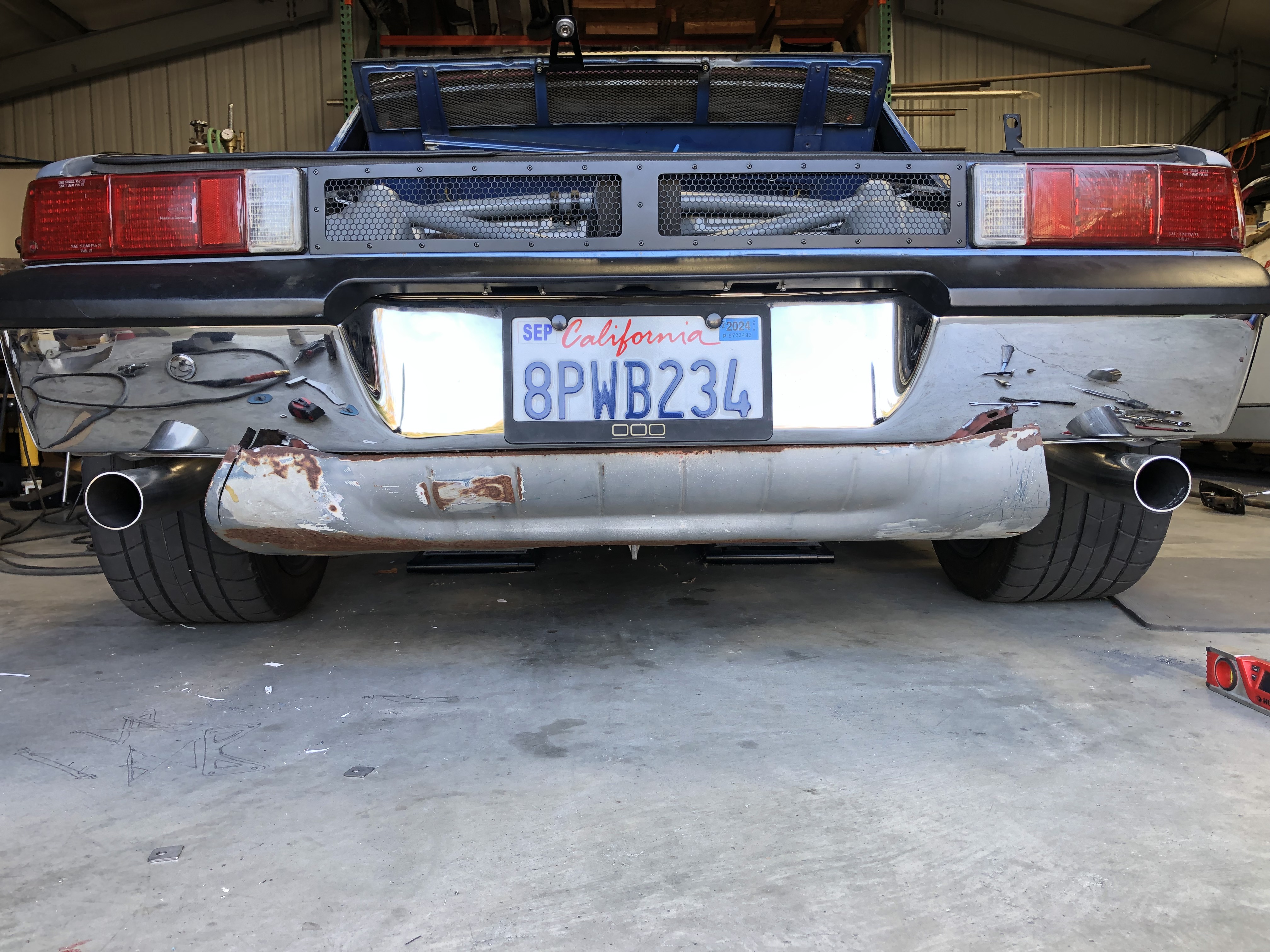

For whatever reason, as I was moving the doors, I noticed the shape and thought, "I wonder if I could use that as the center section of a rear valance?"
It'll take some work, but I think I can. Sort of diffuser-like and a pretty neat shape.
I'd love to be able to say I used part of a '59 Metro on my build. (IMG:style_emoticons/default/aktion035.gif)
We'll see how this goes.

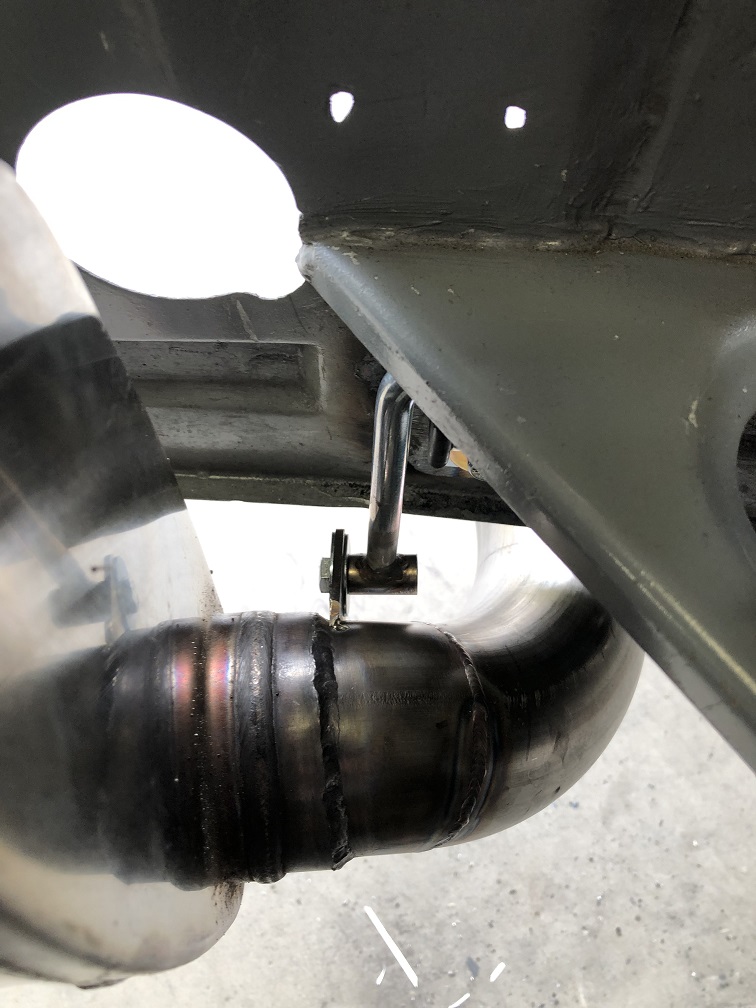

Back to necessary things. Here's the outboard muffler support in place. Not too noticable from the engine compartment side and totally invisible from the rear.
Yes, it's single-shear but the other end is mounted in pretty pliable rubber so I'm not worried.
