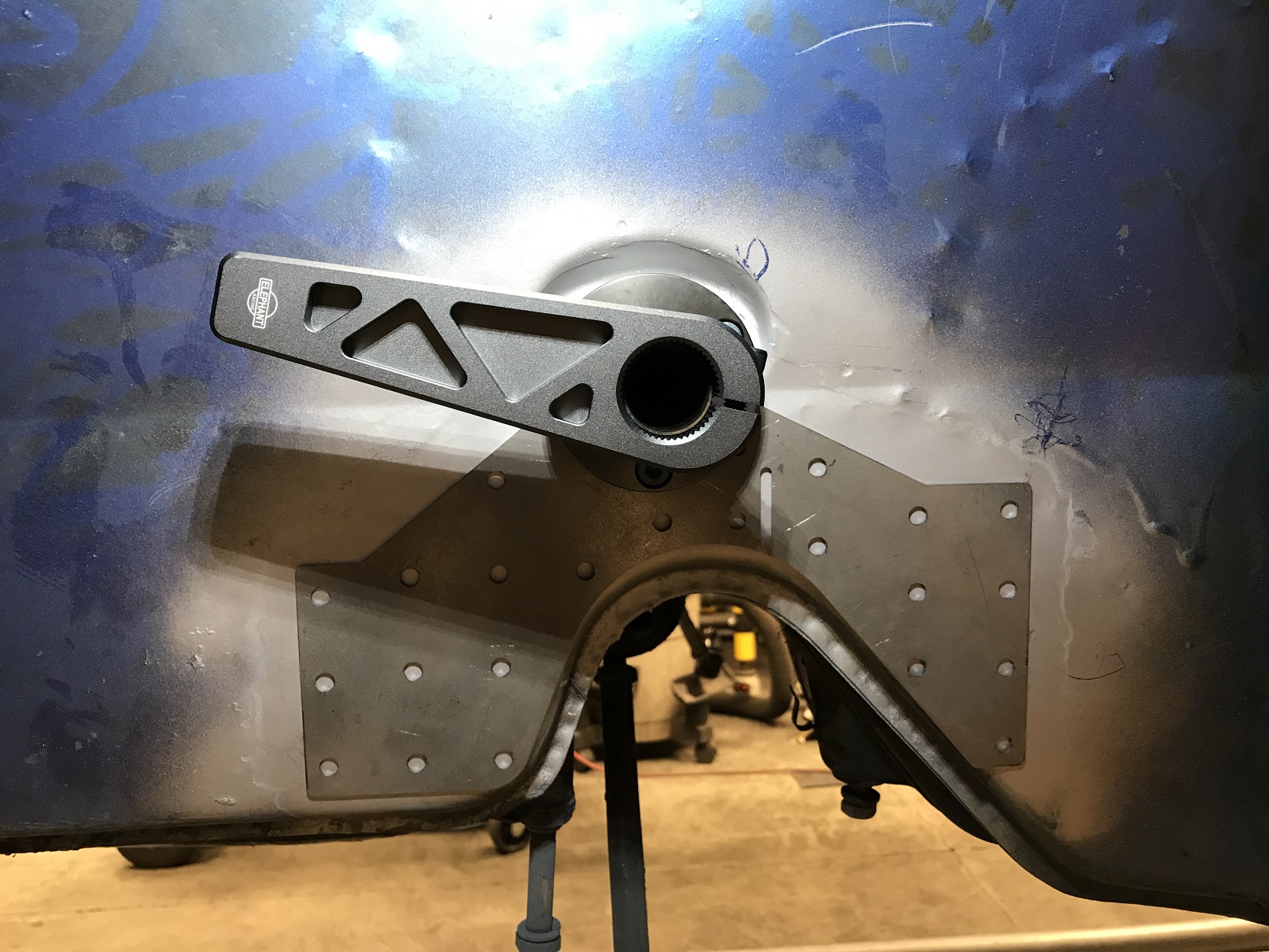

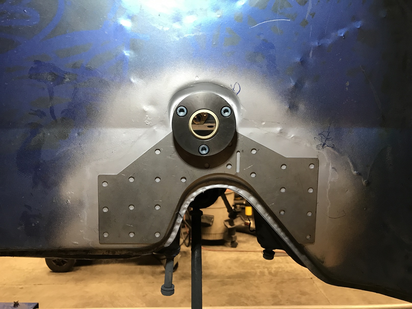

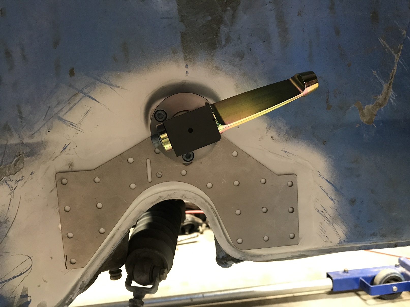

Sway bar reinforcement all mocked in and ready for welding.
I understand I'm not alone in needing to trim the MadDog reinforcement plate to get an optimal fit.
You can see it's a bit proud of the edge on the lower inside areas, front and rear.

And I couldn't resist putting the bar in. The Elephant products are SOOOOOO beautiful... (IMG:style_emoticons/default/wub.gif)
Click on the pic if you'd like to take a closer look.
This is the sort of part that makes the rest of the car look really tired. Granted, it's in need of blasting, etc. But seeing this sort of fancy/functional item in place helps keep me motivated.

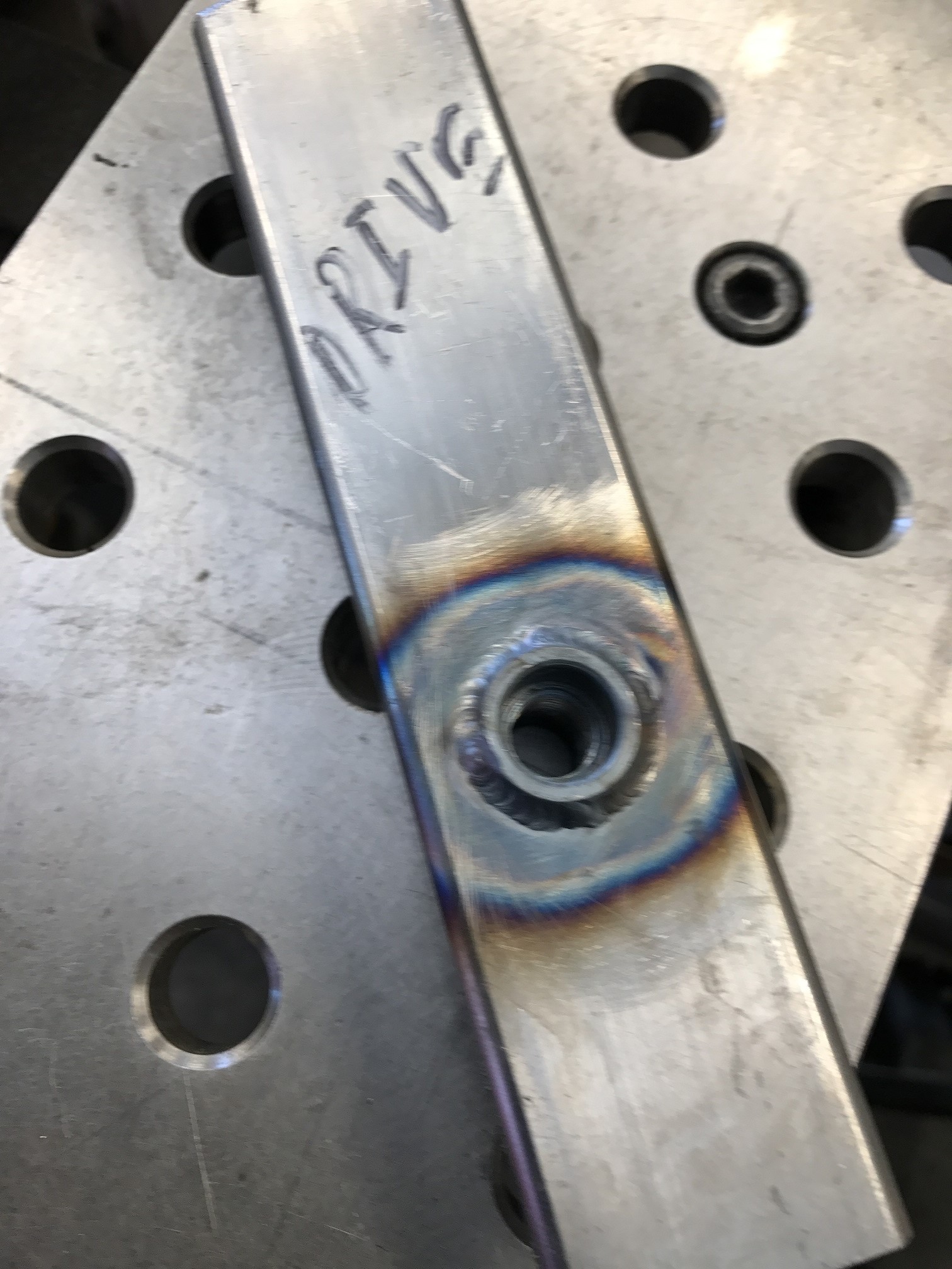

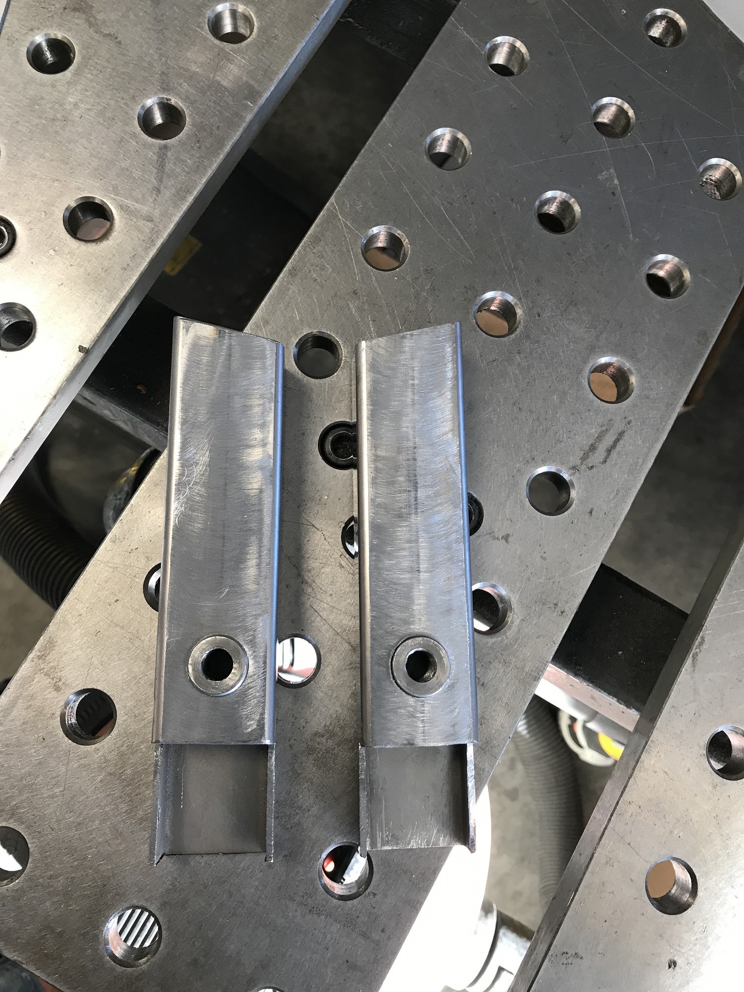

This morning started with me final fabricating, tapping and fitting the seat belt support bosses. All set for welding.

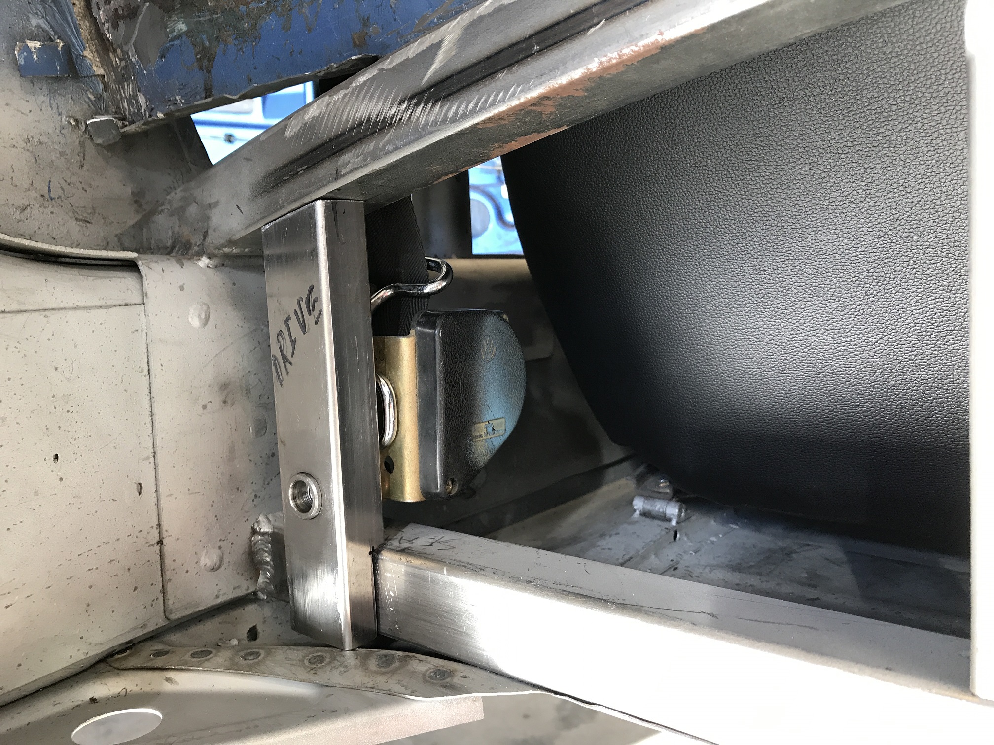

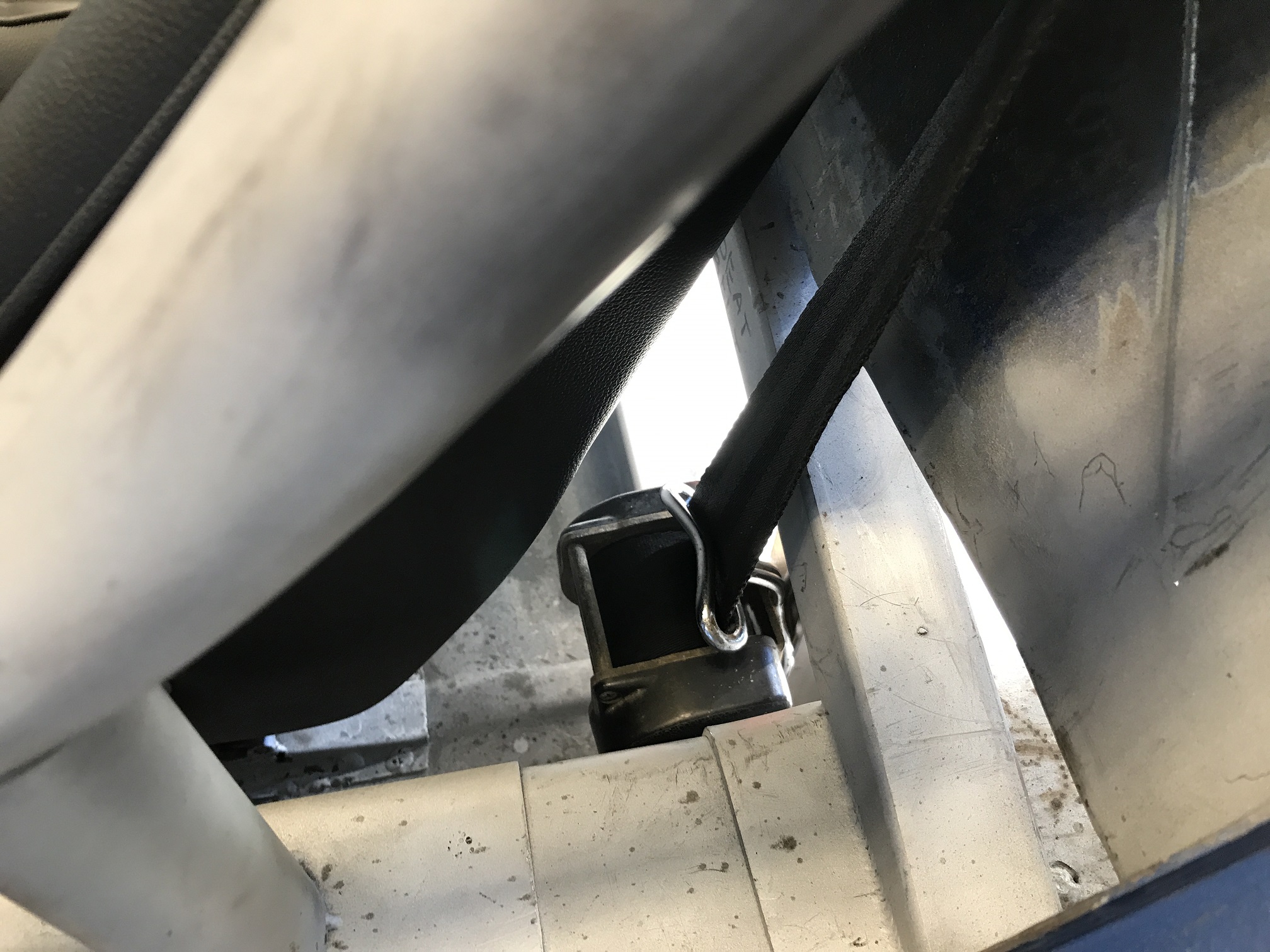

Let's mock it in with the seat in place, just to be sure everything fits...
(And yes, I'll close up the back side of the threaded boss.)
tygaboy
post Oct 21 2017, 10:50 AM
Post #693
Posts: 5,548
Joined: 6-October 15
From: Petaluma, CA
Member No.: 19,241
Slide the seat ALL the way back and...
We have clearance, Clarence!
You gotta love how the stock shape of the belt guide holds things forward and perfectly suits the retractor being recessed into the lower fire wall. (IMG:style_emoticons/default/wub.gif)
Neat little detail that no one will even notice...

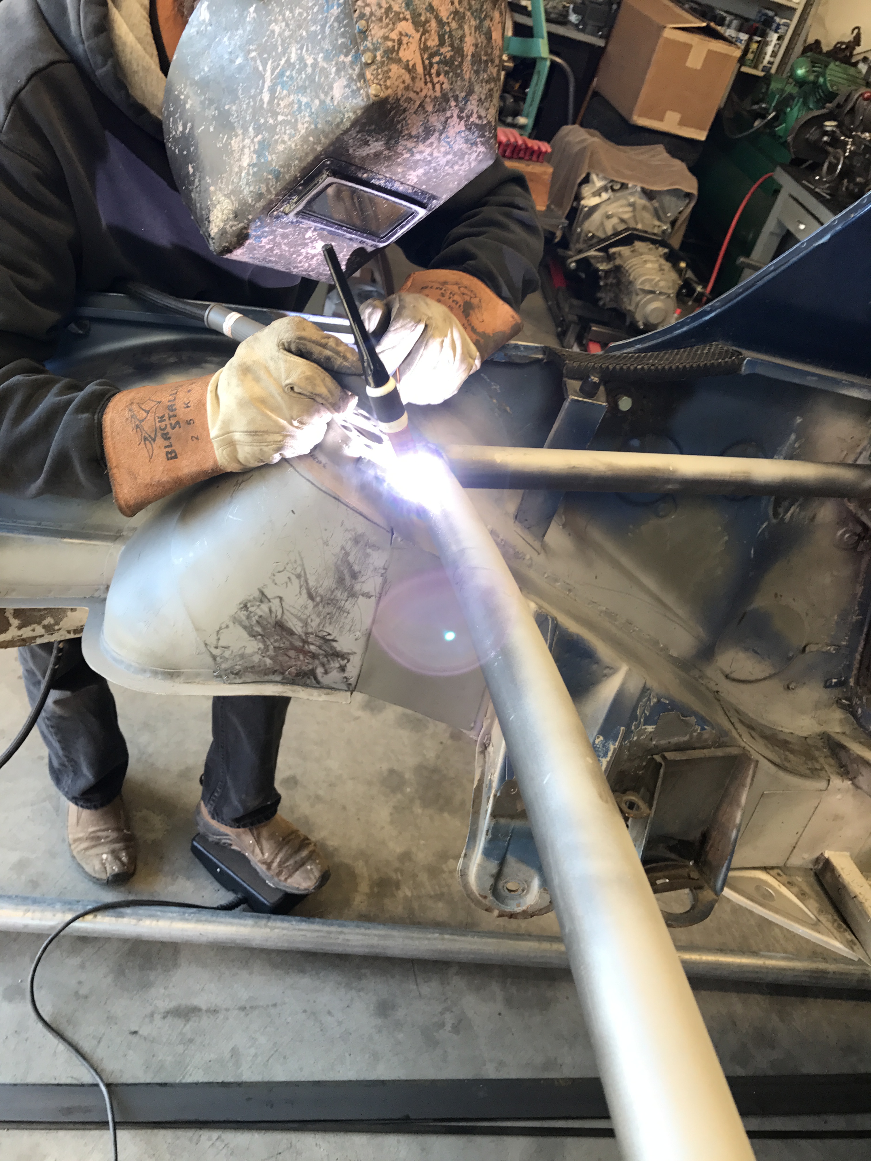

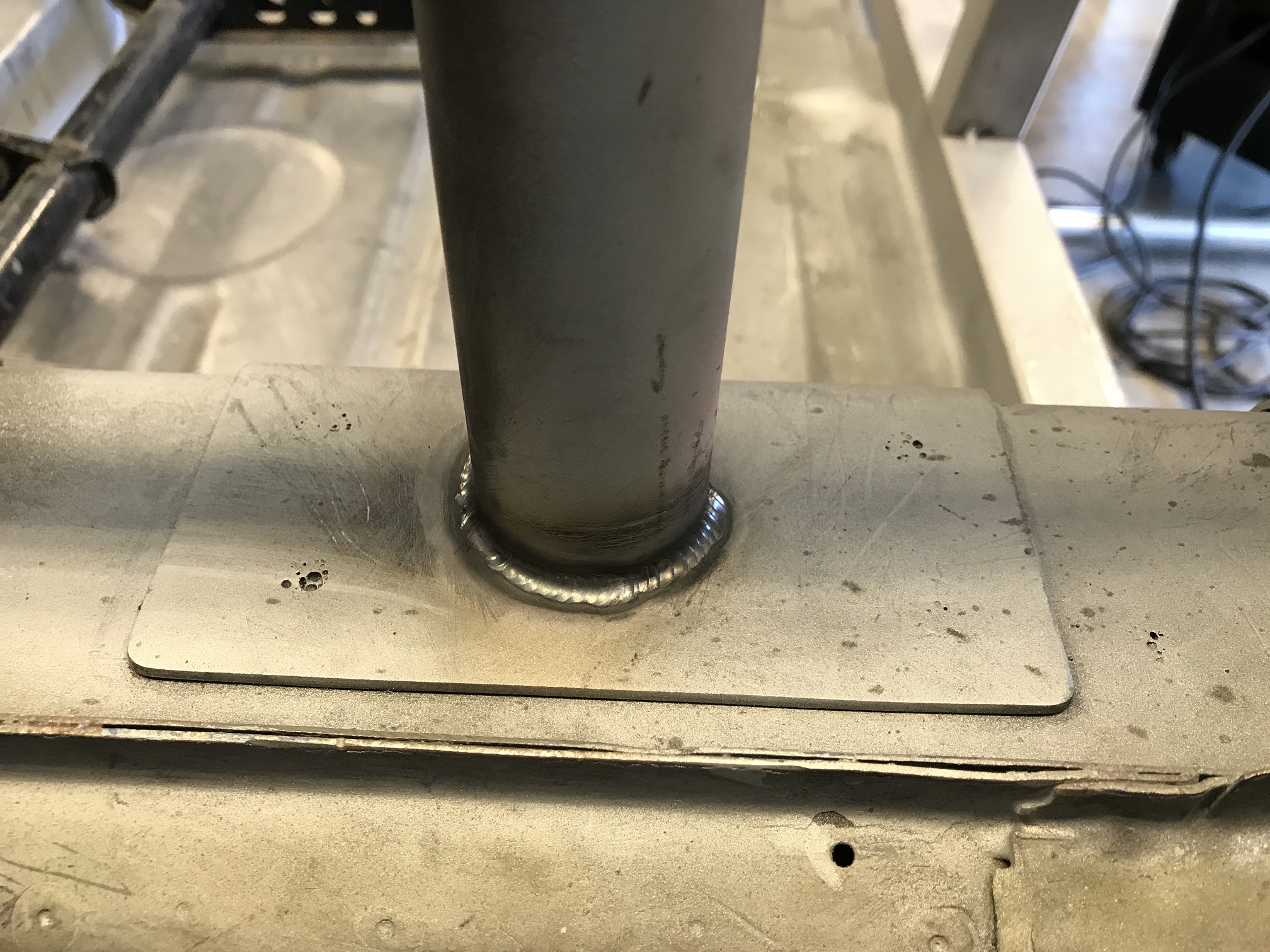

Martin made time to help me today. You know what that means:
Time for major welding porn!!!
Let's start with the seat belt mounts.
tygaboy
post Oct 21 2017, 02:37 PM
Post #697
Posts: 5,548
From: Petaluma, CA
Member No.: 19,241
And the door bar verticals... (IMG:style_emoticons/default/wub.gif) (IMG:style_emoticons/default/pray.gif) (IMG:style_emoticons/default/w00t.gif)

Martin in action (IMG:style_emoticons/default/cheer.gif) (IMG:style_emoticons/default/aktion035.gif)
