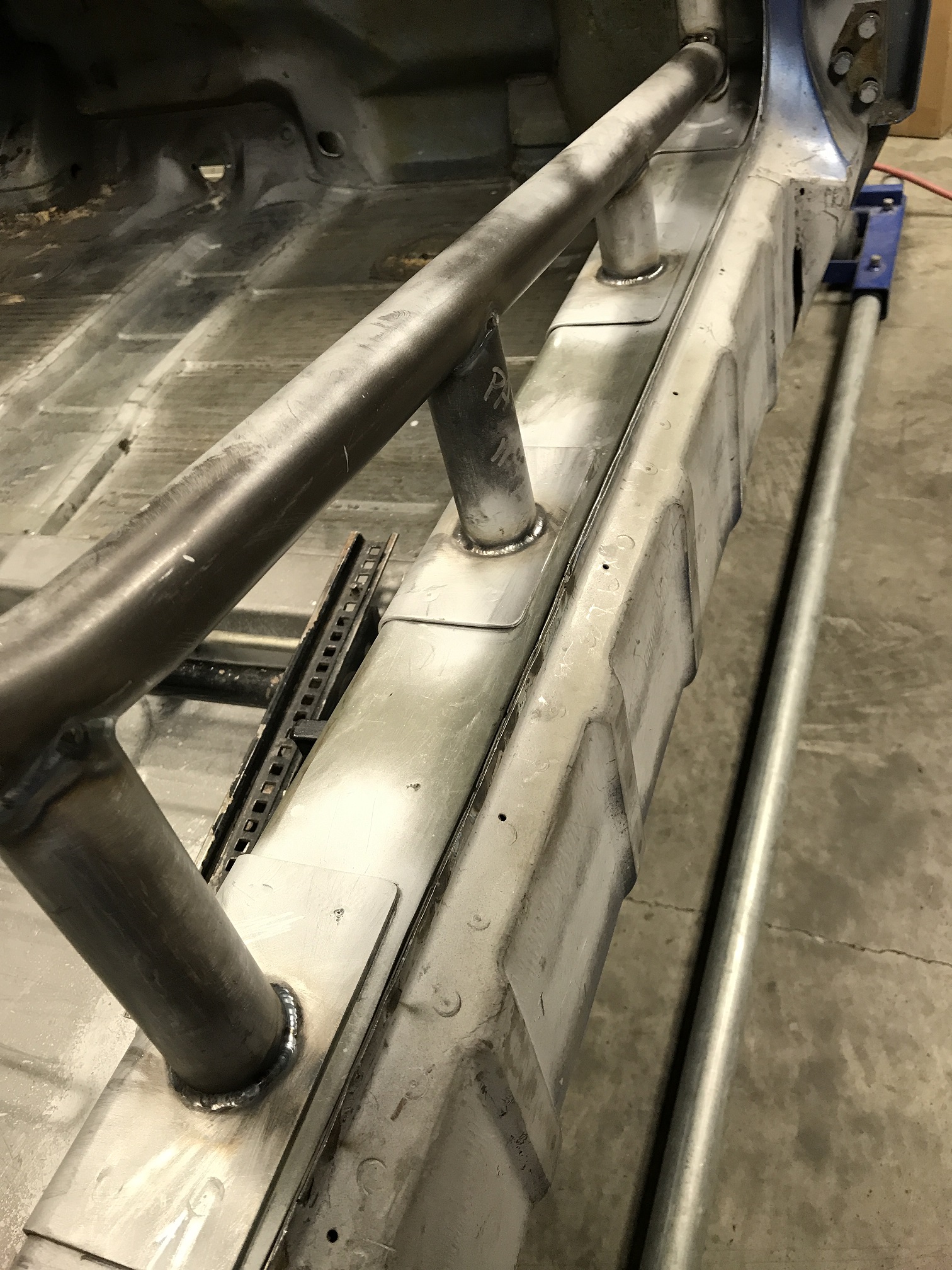

Driver side front suspension bar.

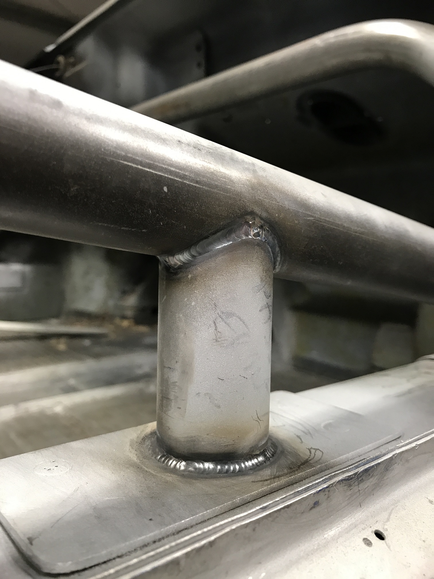

Another door bar vertical.

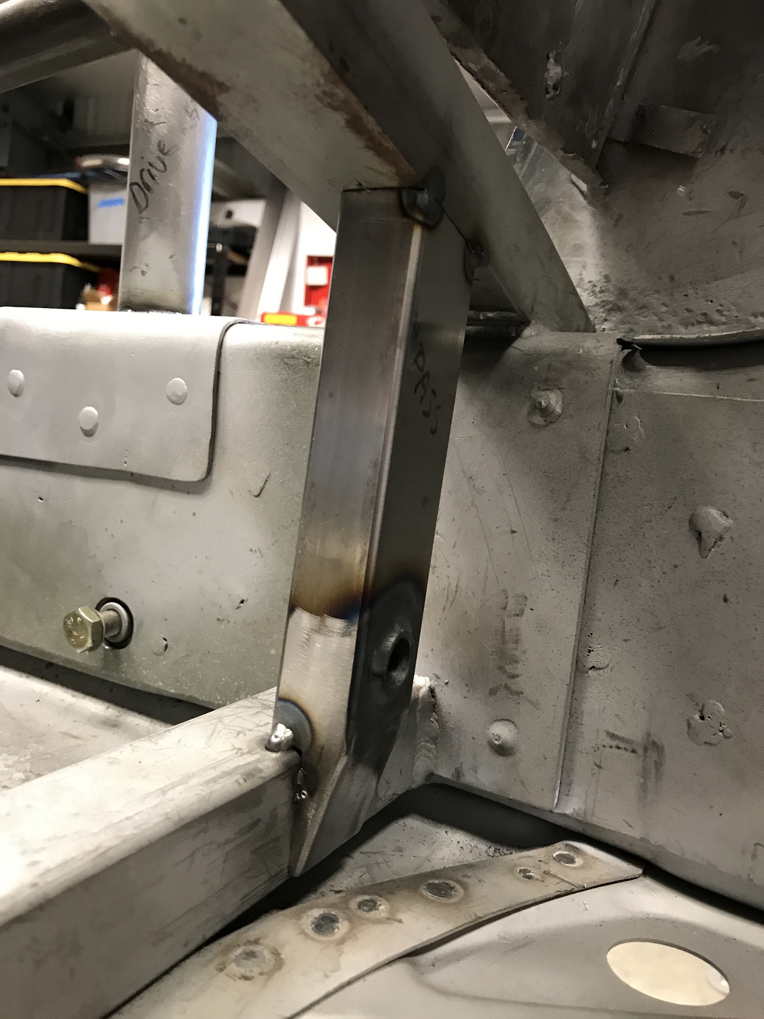

Back to the seat belt retractor mounts. I decided to reshape the lower section of the braces to close off any opening into the brace and to make it easier to get it fully welded to the lower cross bar.
The mods are all done and both braces are tacked in.

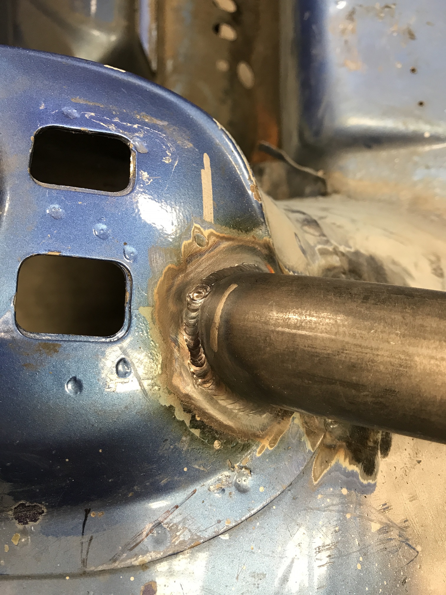

I got the passenger side sway bar reinforcement plate all welded in. Still need to dress the welds. It'll get seam sealed after primer is sprayed.
That was a long weekend of fabrication and welding. I feel like a lot got done.
And yet so much remains to be designed and built.

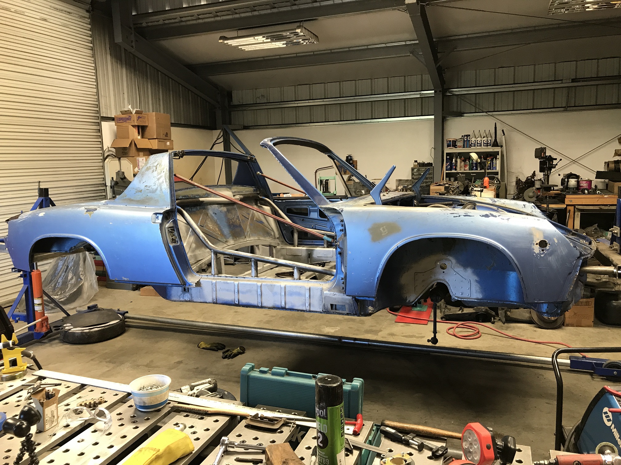

So I'll end this weekend with this pic and a comment:
Sometimes you just have to step back and look at the big picture.
Man, I'm loving how this car is shaping up...

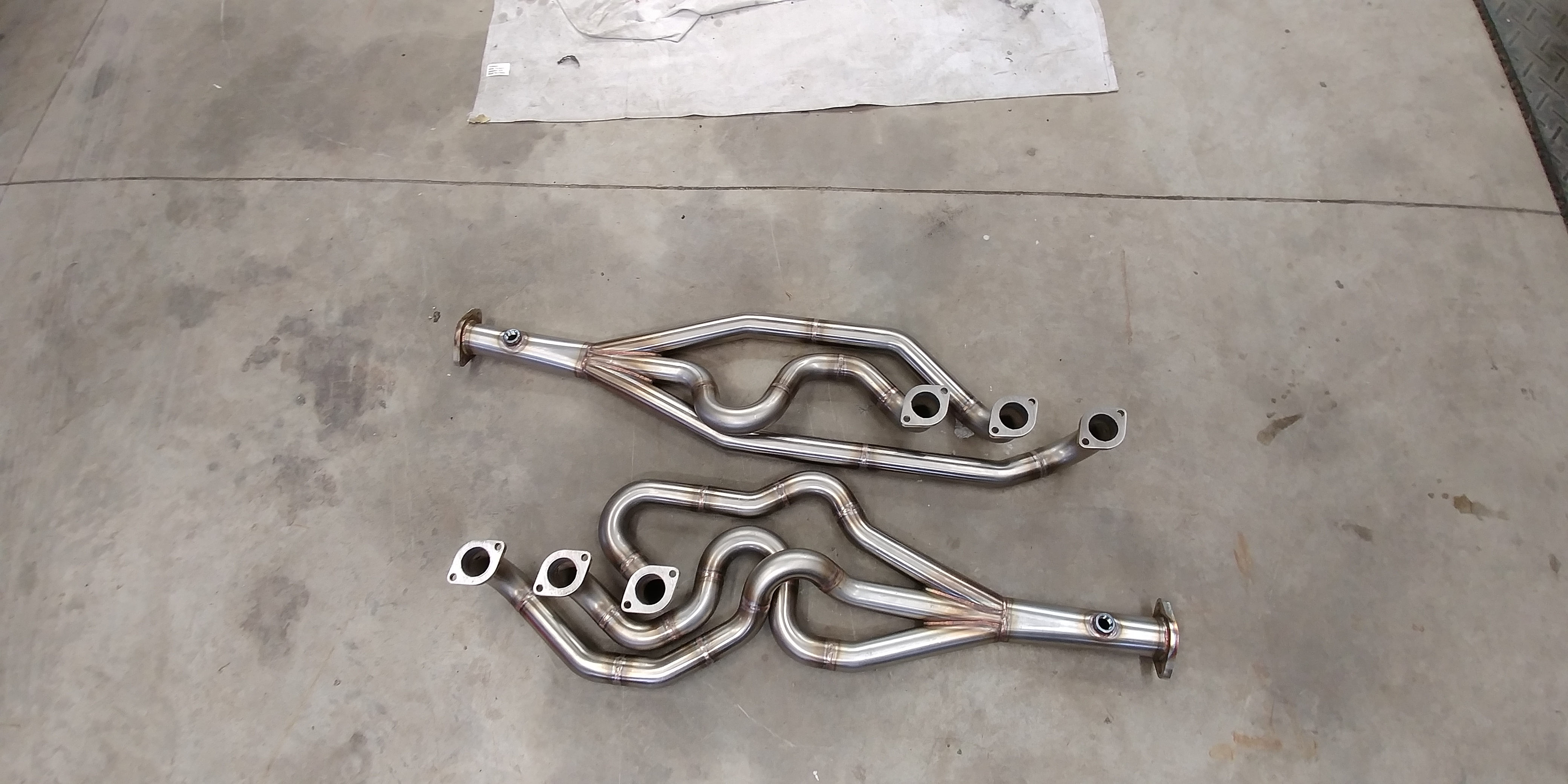

But what do I know only taught high level welding for the last 20 years (IMG:style_emoticons/default/biggrin.gif) Attached Image
These are headers I just finished up.. No grinding on this

Gotcha. Totally get it on the butt welds. Beautiful headers! Huge respect to the great welders.
The grinding comment just brought up the image of the "eagle crap" welds I've seen. (IMG:style_emoticons/default/biggrin.gif)
