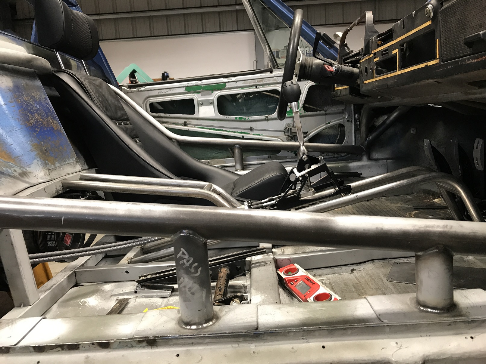

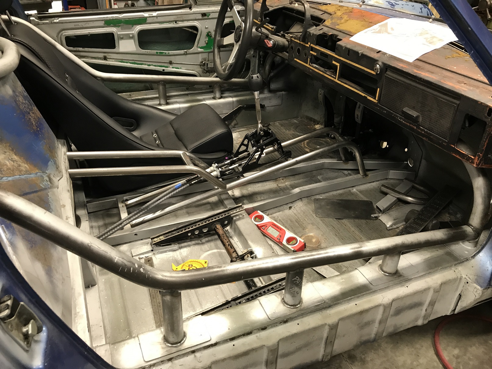

Playing with console layout ideas. I like this height for the shift tower. Now I need to determine if I want to tie it into the front hoop, as pictured, or flip the tubes and have the whole thing "stay low", more like the stock tunnel.
Either way, I'll have other tubes tie in higher up on the firewall.
Decisions, decisions...

Tie it into the hoop as pictured. Kinda gives it that modern Porsche look.

I agree that it's a more modern look and after thinking on it, I decided to go "low".

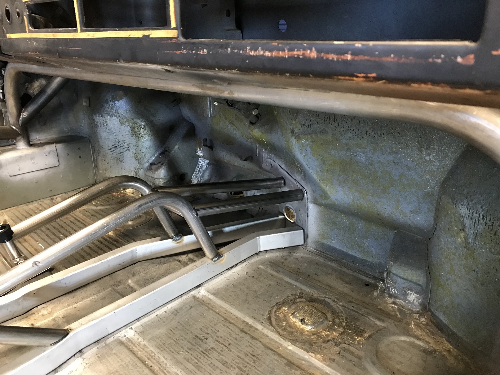

So, low it is. Here's the main top section. I still have to tie in the front to that plate that's rosetted to the front fire wall. I'm thinking two horizontals should do it.
Then I'll figure out something to tie in the rear fire wall. Still noodling on a couple different ideas.
Pics are out of time sequence. The 2nd one is pre having added the cross braces. It's the same height and all that...

Are you going to build it so it has any storage space? (What can I say, I've gotten spoiled driving newer vehicles with center console storage. (IMG:style_emoticons/default/smile.gif) )

Yep, I plan a small cubbie at the rear and cup holders ahead of the shift tower.

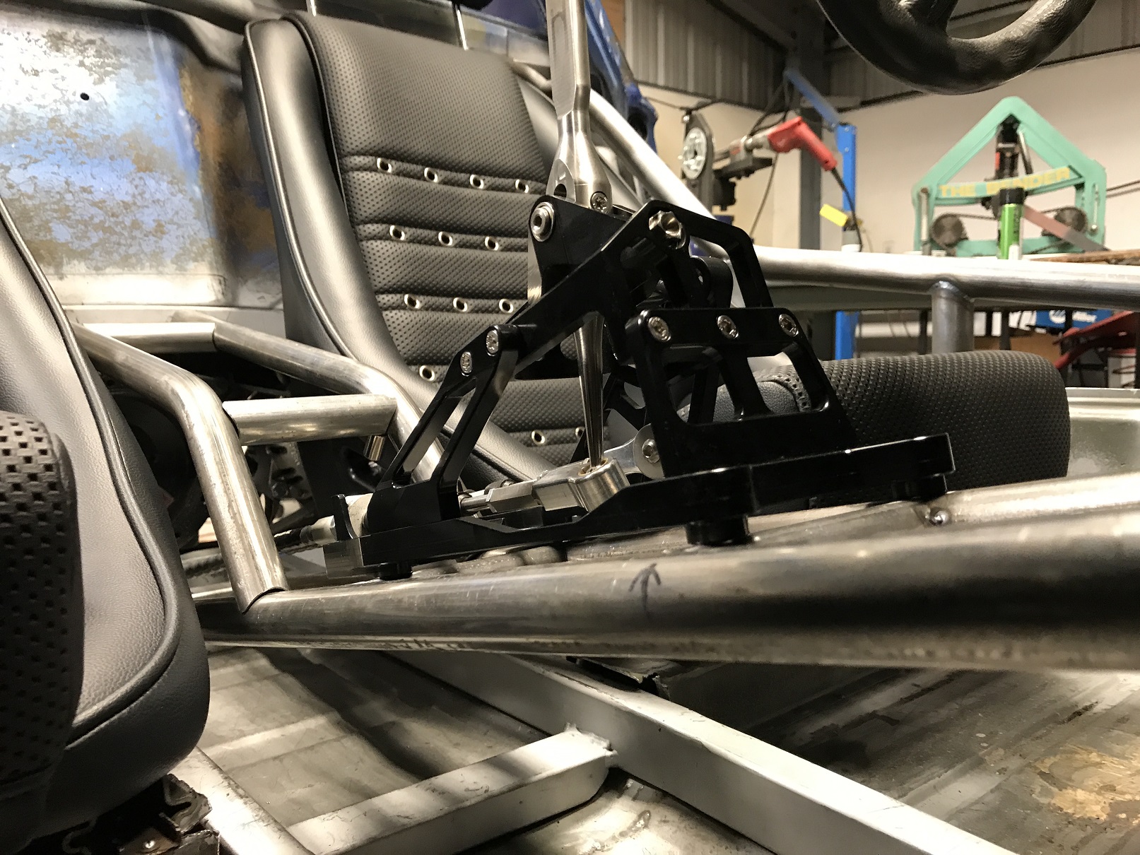

Mocked in the shifter mounting bosses and had to try in out.
The tunnel isn't welded in yet and the shift cable aren't adjusted so pardon the noises, but man, this thing is snick, snick and SOOOOO positive.

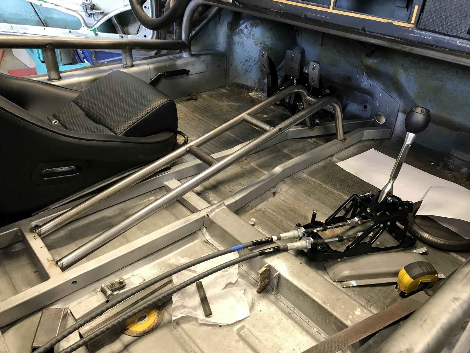

Continuing work on the console. The rear section will become the cubbie/storage area.

With all the time I've put into the chassis stiffening/roadster cage and now this console, I've decided to name this part of the build "Jail Time". Why?
I've spent a lot of time behind bars! (IMG:style_emoticons/default/lol-2.gif)
And yes, I spent time (IMG:style_emoticons/default/sawzall-smiley.gif) (IMG:style_emoticons/default/sawzall-smiley.gif) to get the angle of the rear part of the console to match the angle of the door bars. Details, details...

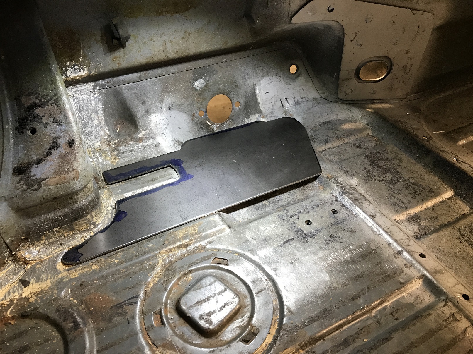

Finished today by getting started on the pedal mount. First step is to level out that area. This piece gets me started.

How ate you attaching the plate to the floor...or is there a second plate as well? If there is not, I believe you might find that is too small Chris.

Good point - that's the "filler plate" that gets me to level, then I plan a larger plate that'll give me a bit larger footprint, will tie into the console and further back toward the seat and closer to the driver long.

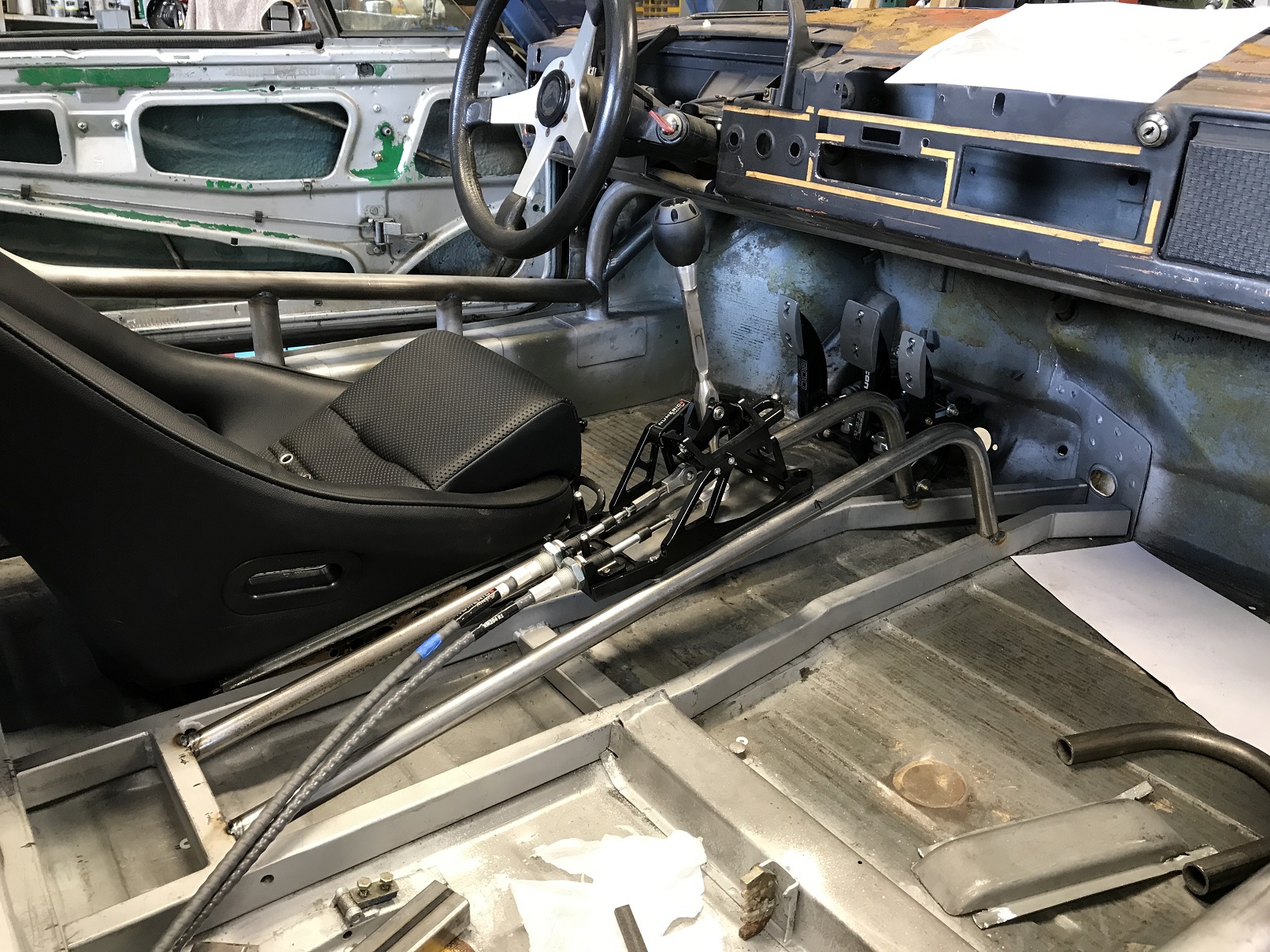

Fabbing the last few pieces of the console/tunnel. I'll probably triangulate down the passenger side but I have a neat little thing planned for the driver side...

I am a top supporter of your work. At some risk I can't help asking... Why the spaghetti? It's very noodley. I LOVE curves, mind you, I'm just feeling too much of them. WOW, now THAT's something I'd never hear myself saying.
Less metal for same function?
