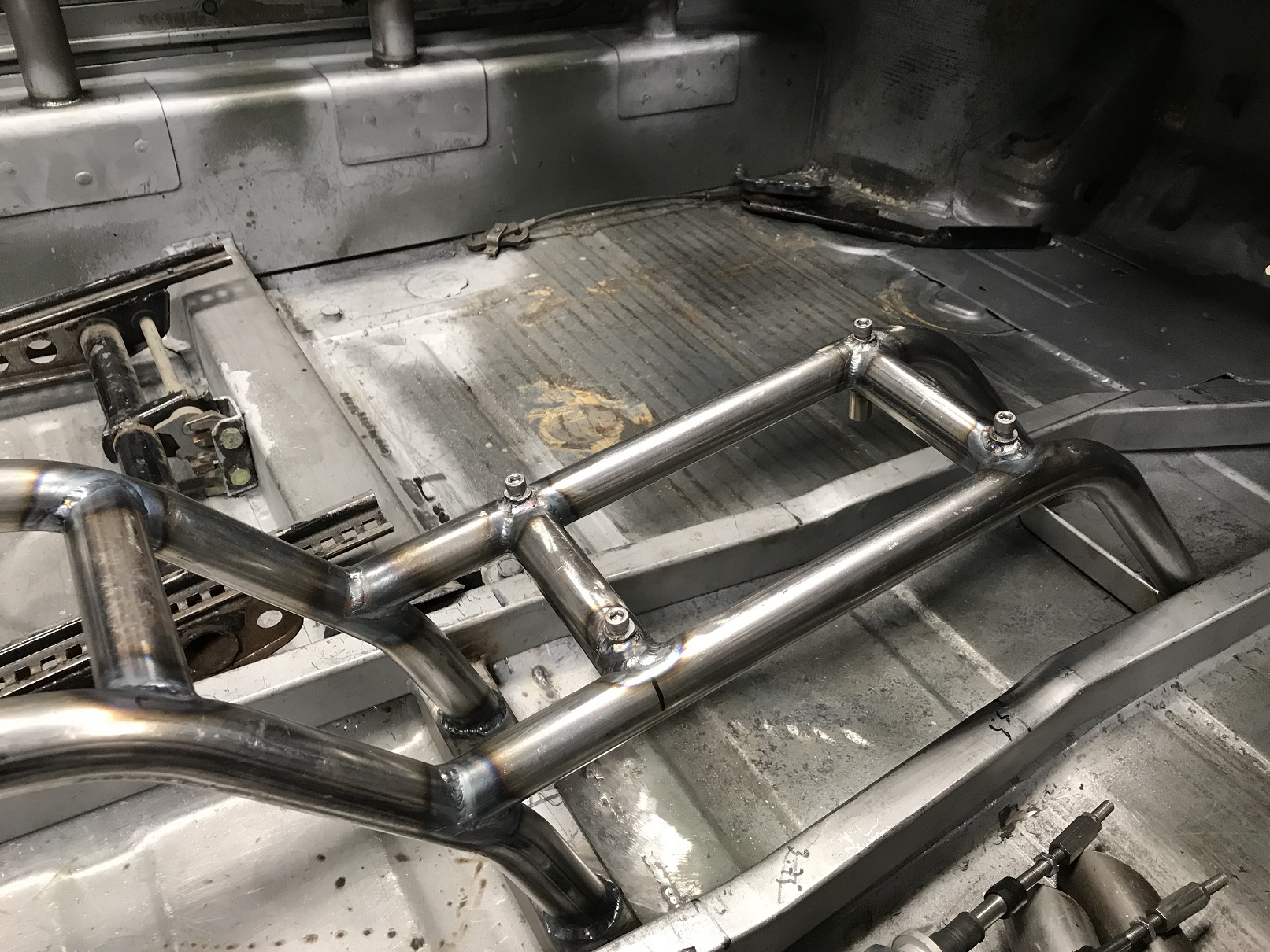

Console all welded. Looks like this is the design I'll be sticking with...

...well the shifter certainly won't break free! Looks really great Chris!

Beads of commitment.
I like it! (IMG:style_emoticons/default/biggrin.gif)

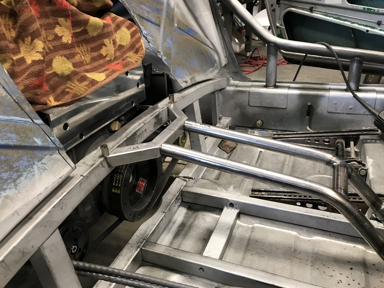

After thinking about how I want the access cover to work, and things like routing fuel lines into the engine compartment, I rethought the rear of the console.
- the 1" square frame will serve as the "landing zone" for the front base of the access cover (easier to seal against a flat surface)
- the space within it will be plated and serve as the mounting area for the bulkhead fittings for the fuel lines (and possibly the rear brake line and throttle cable) as they move from inside the console to inside the engine compartment. Should work nicely.
If only I had the entire plan in my head vs making it up as I go, I wonder how much farther along I'd be... Ah, well.

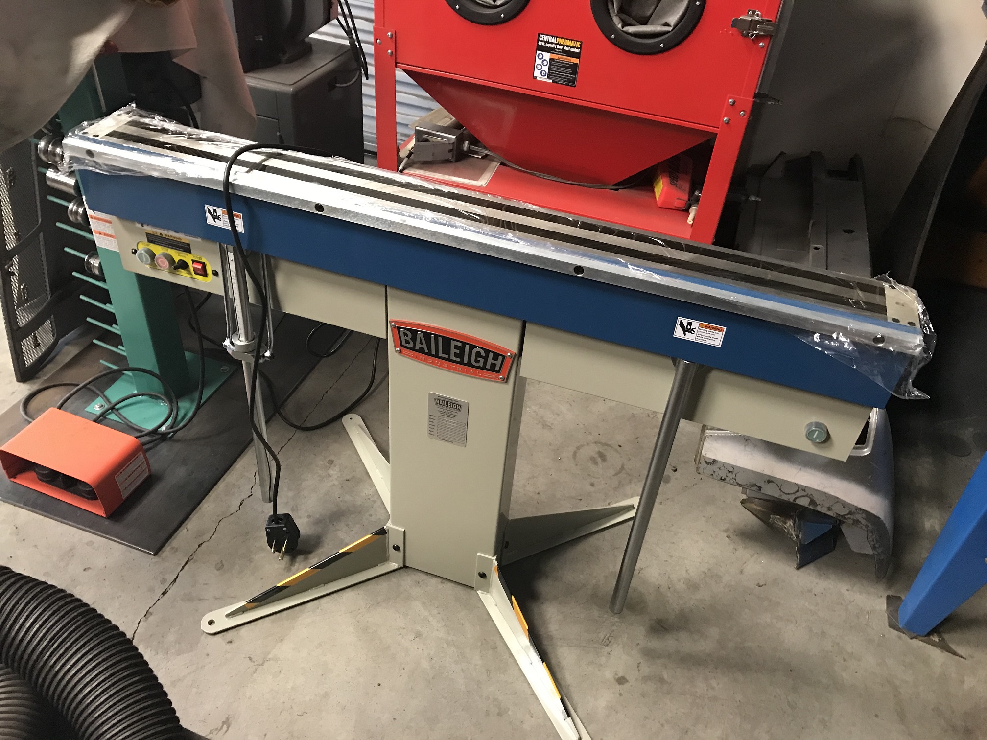

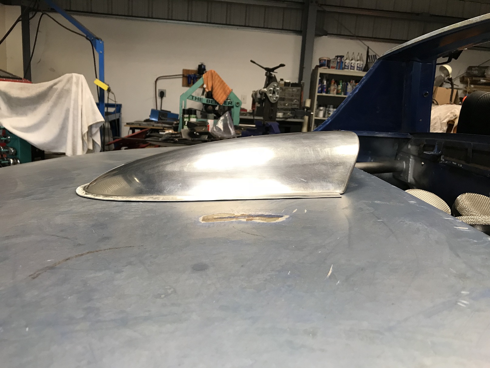

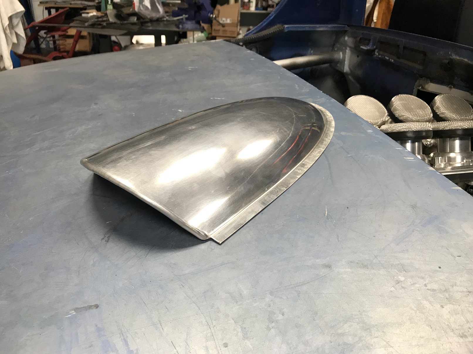

As I'm working to fabricate the fire wall access panel and looking at the other sheet metal work I have to do, I realized I don't yet have the skills I need to get the results at the level of quality I want.
So the project is going on a "sorta hold" while I practice. To help speed this along, I've signed up to take a 4-day coach building course from Wray Schelin (Pro Shaper) in MA.
http://www.proshaper.com/
In the meantime, here's a small hood scoop practice project I did. It turned out nicely but it just feels like much of it was luck. So, off to school I go...

tygaboy
post Jan 26 2018, 01:47 PM
Post #860
914 Guru
Group: Members
Posts: 5,452
Joined: 6-October 15
From: Petaluma, CA
Member No.: 19,241
Region Association: Northern California
Some of you know I do "yard art", decorative gates and the like, as another hobby/business. That makes it a little easier to justify some of the things I do. One upcoming project I have is to make a large, sheet metal fire place surround. Given that, and all the sheet metal stuff I want to do on the RaceRod, I treated myself to a magnetic brake.
Haven't even plugged it in but expect to road test it this weekend.
If any of you local guys need metal bent, please feel free to come on over!
