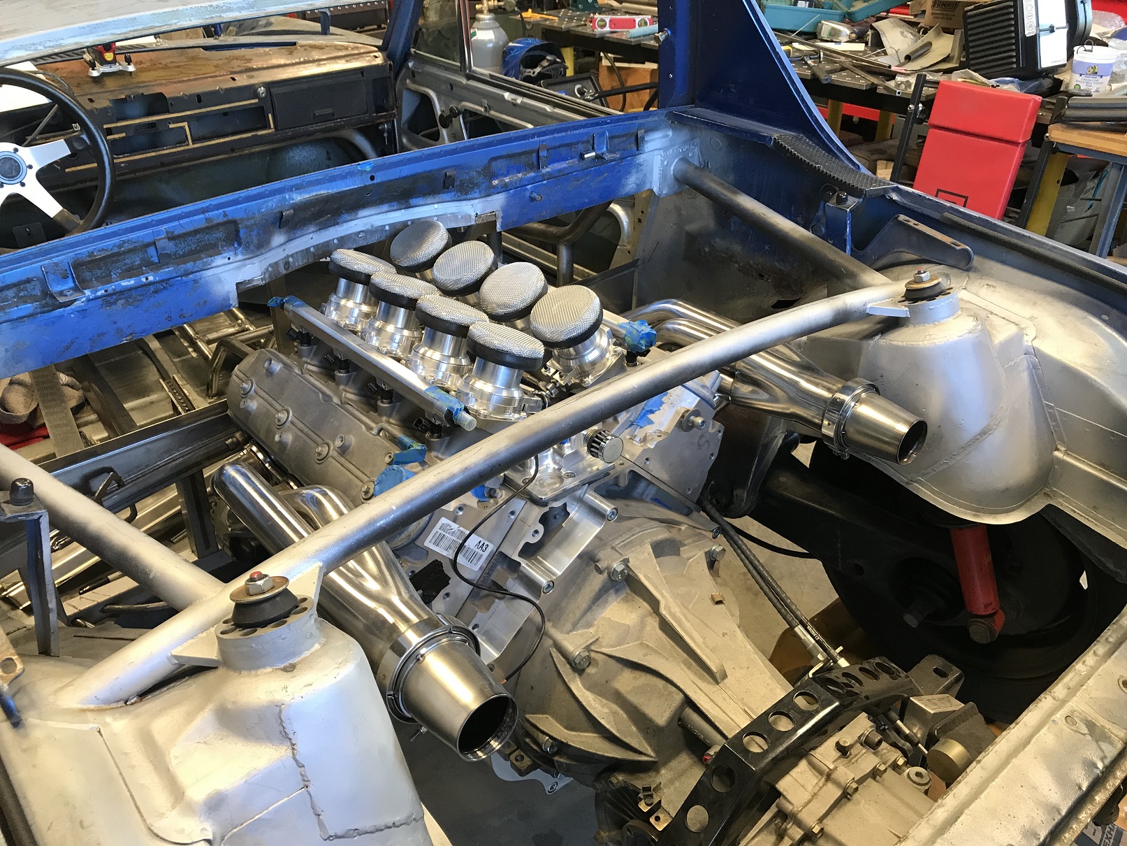

And to celebrate (?) getting to page 50, here's a gratuitous artsy-fartsy shot and a pic of (what I think is) one of the coolest looking engines. (IMG:style_emoticons/default/shades.gif) I never get tired of looking at this. But hey, it is my car...

Man that manifold looks killer!!!! You'll need to make a full GT engine lid or or something that will show off that engine!

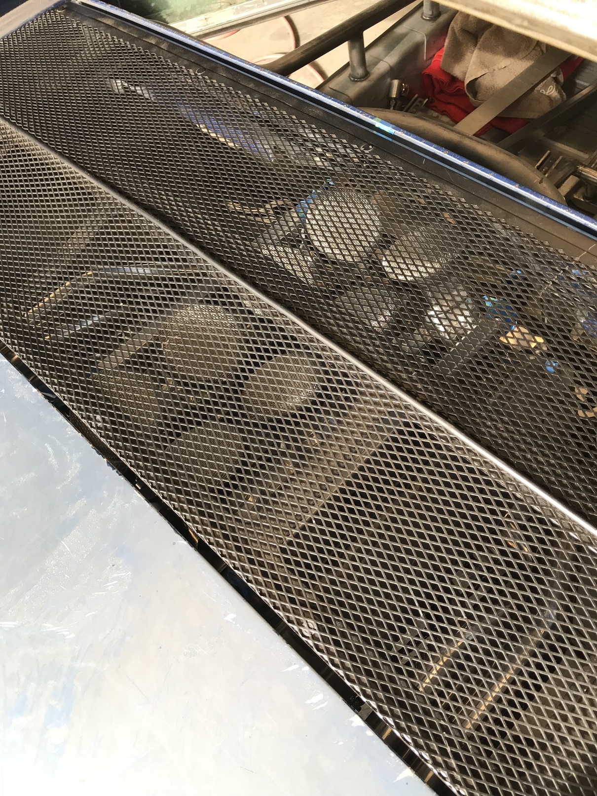

Maybe something like this? (IMG:style_emoticons/default/shades.gif)
I didn't make this one. Robert (BuddyV) was kind enough to drop it by...

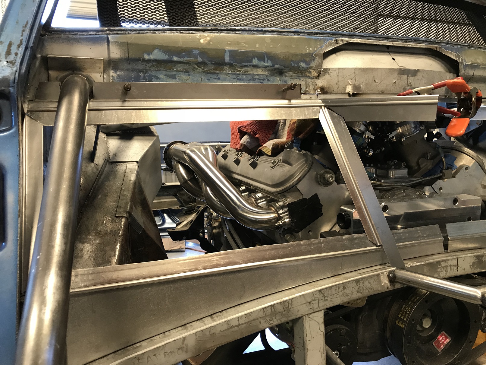

tygaboy
post Apr 14 2018, 04:51 PM
Post #991
Posts: 5,550
Joined: 6-October 15
From: Petaluma, CA
Member No.: 19,241

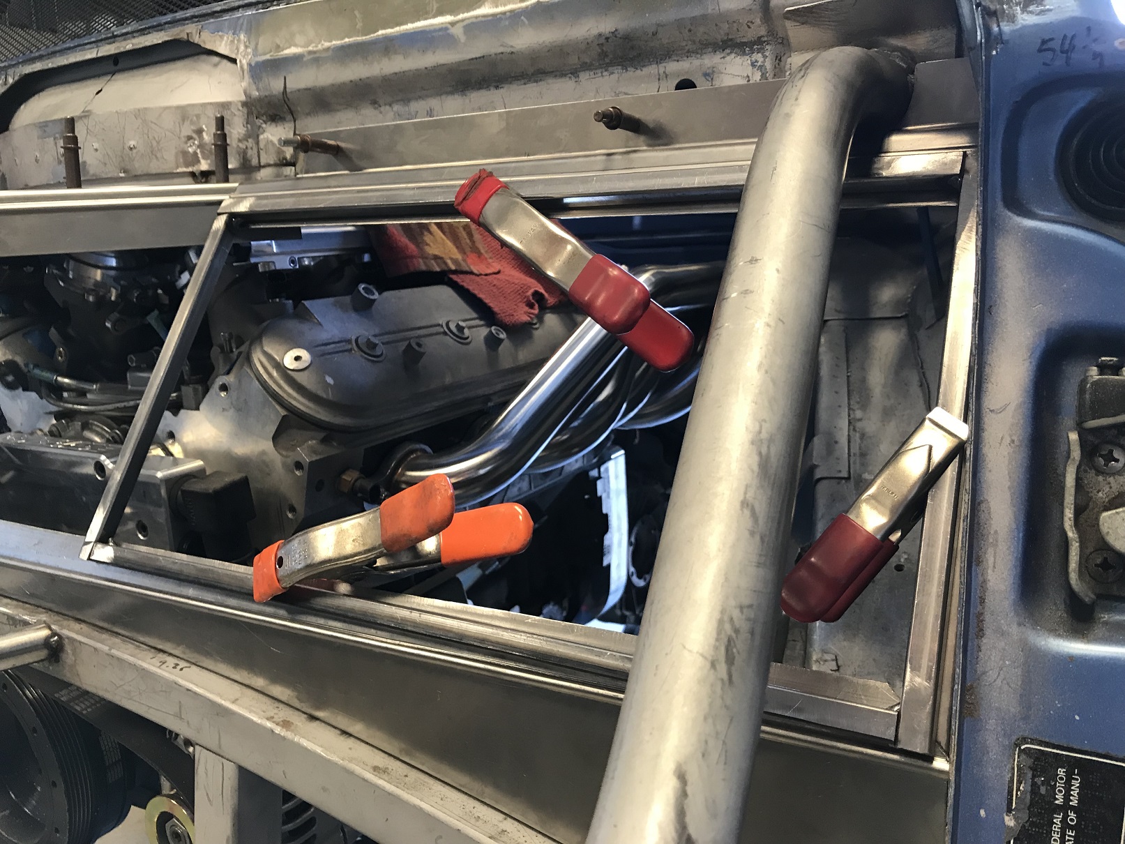

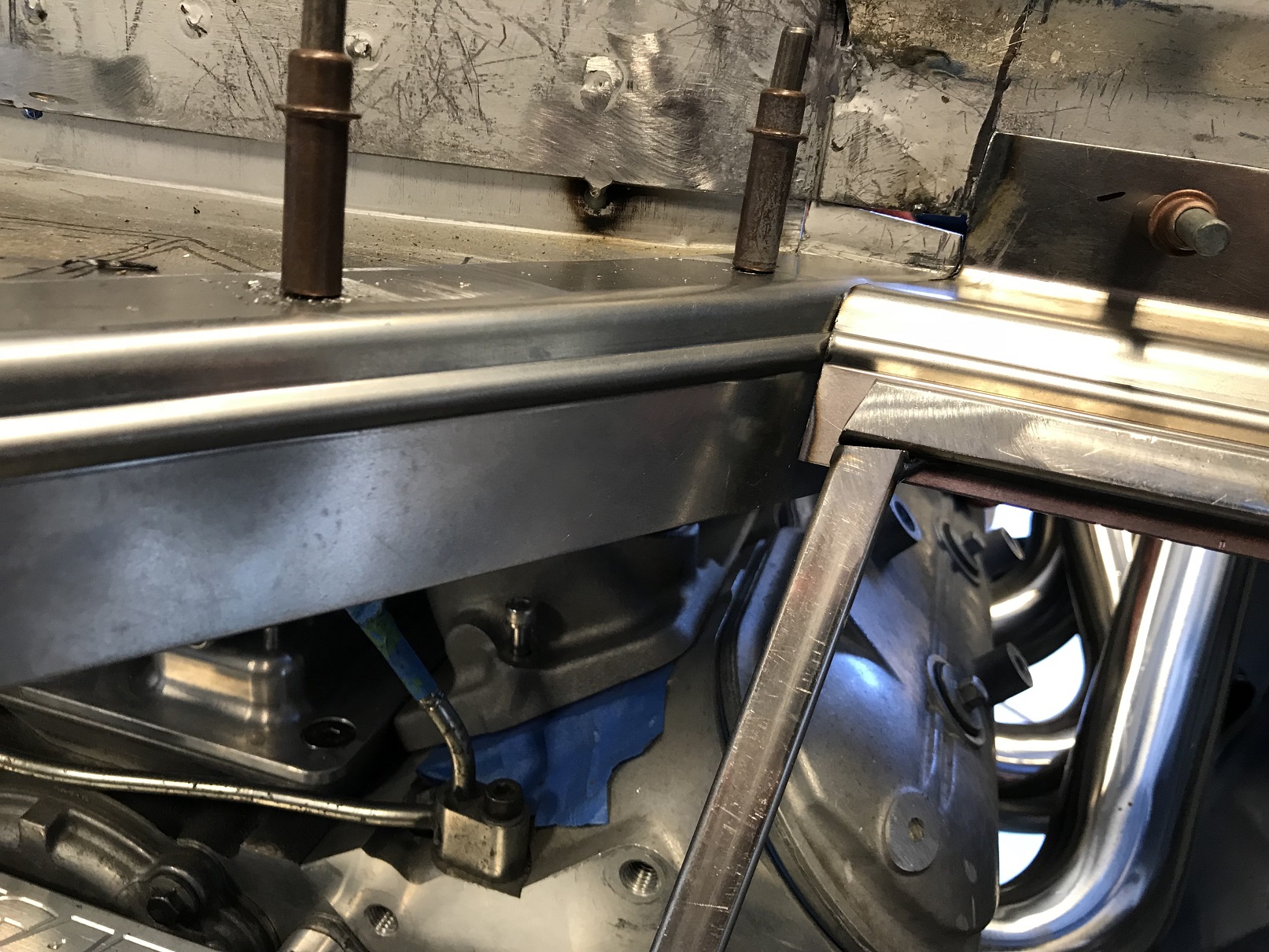

Home from the coach building class and time to get back to work. I think I've finally resolved all the details and landed on a design that I'll implement.
The beading fully surrounds and helps locate each sides main fire wall panel. I still have final trimming and fabrication of a couple more bits but I'm happy with how this is going.

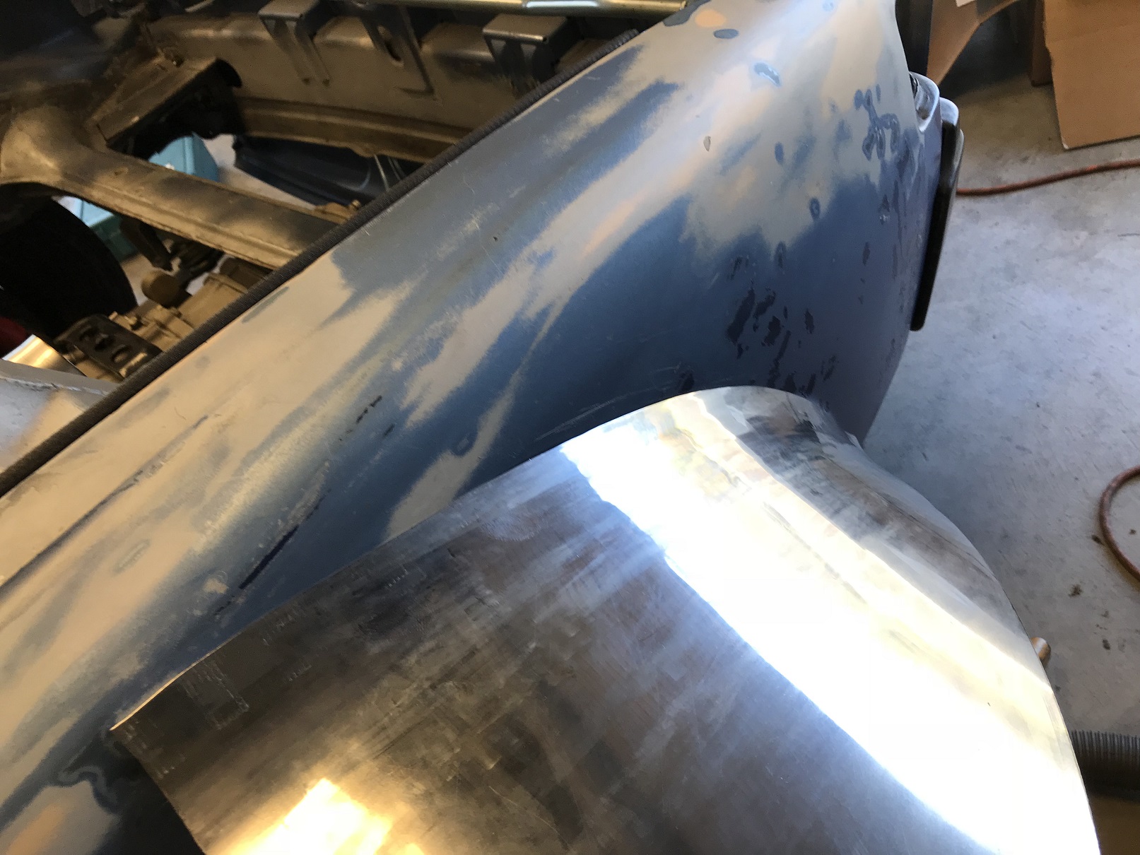

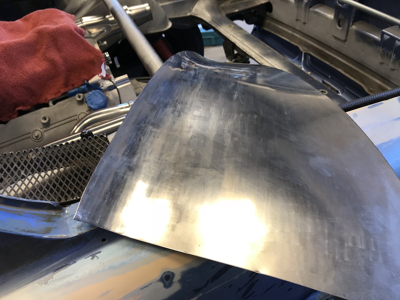

In the event I actually give a go to making my own flares, I wanted to start practicing the toughest part I'll have to deal with: the reverse curve.
I wasn't working to a pattern, just getting a feel for how to form these. IMO, it's the sexiest shape there is...

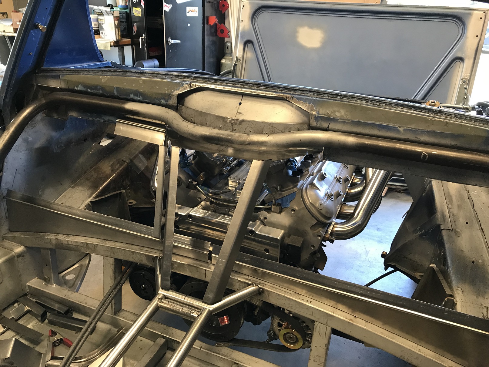

tygaboy
post Apr 22 2018, 03:47 PM
Post #993
Posts: 5,550
From: Petaluma, CA
Member No.: 19,241

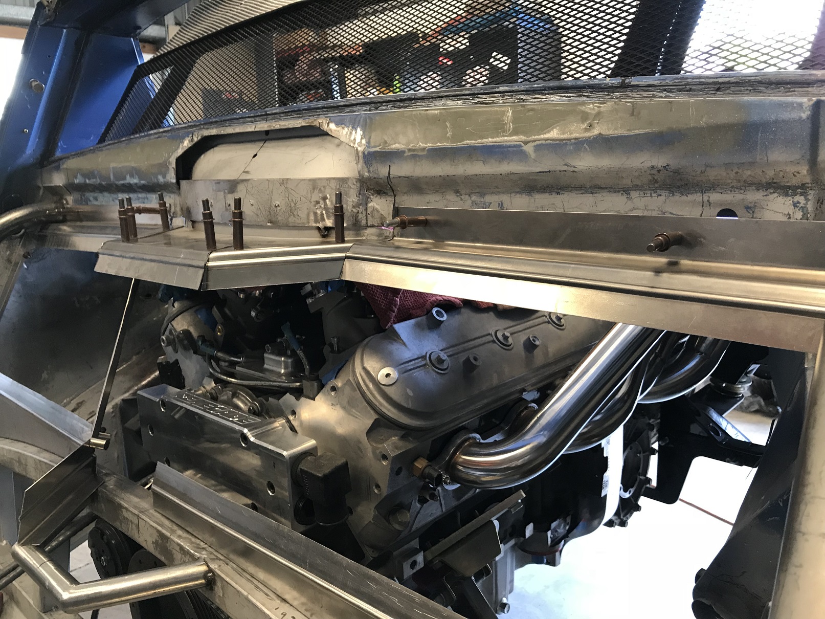

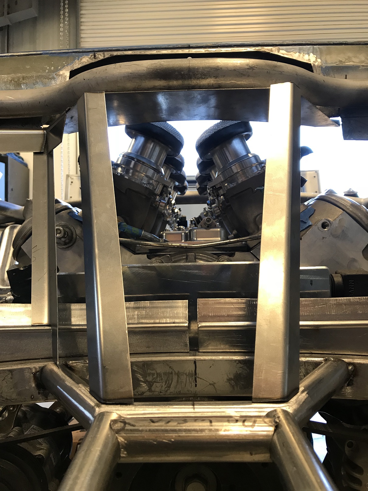

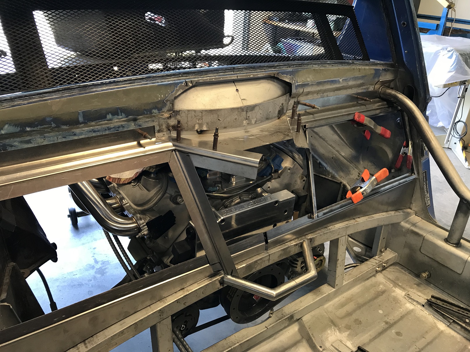

The fire wall is taking a LONG time... Very fiddly, lots of "just so" cuts and joints.
Today I fabricated the pieces and started framing in the driver side fire wall.
Fun, fun, fun because now all the parts have to be mirror image of the passenger side. Some careful measuring and everything matches nicely!
I'll even up all the corners so everything is matchy-matchy so clearly, some final trimming to do on most every piece.
I also built a quick "template frame" to ensure the entire perimeter of the main panel framing gets built in a nice, flat plane. Interesting how when I clamped everything in place, I turns out the lower pieces actually need to come forward a bit as they move toward the center of the car.
You can see the template frame in one of the pics.

post Apr 27 2018, 01:49 PM
Post #995
Posts: 5,550
From: Petaluma, CA
Member No.: 19,241

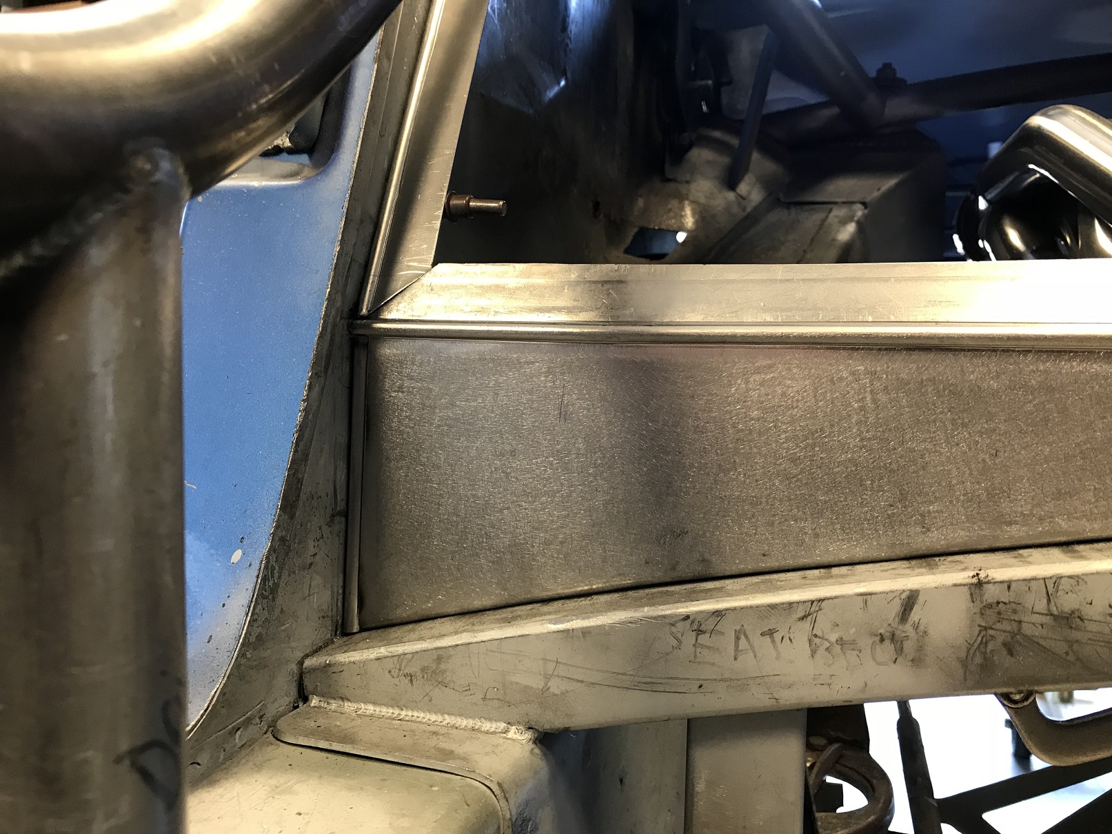

I took today off work today and got back on the fire wall. More of the fiddly fitment/multiple angle joints. It's REALLY slow going as each piece requires rough fitting then what seems like a couple dozen trips to the band saw and sander to tune each edge...
And I didn't like how the side supports for the removable panel were working out so I remade them. In the redo, I moved the bead to the center of the bend which will make for a symmetrical look where the main fire wall panels meet up to the removable panel.
Slow going, but I'm happy with how it's coming along.

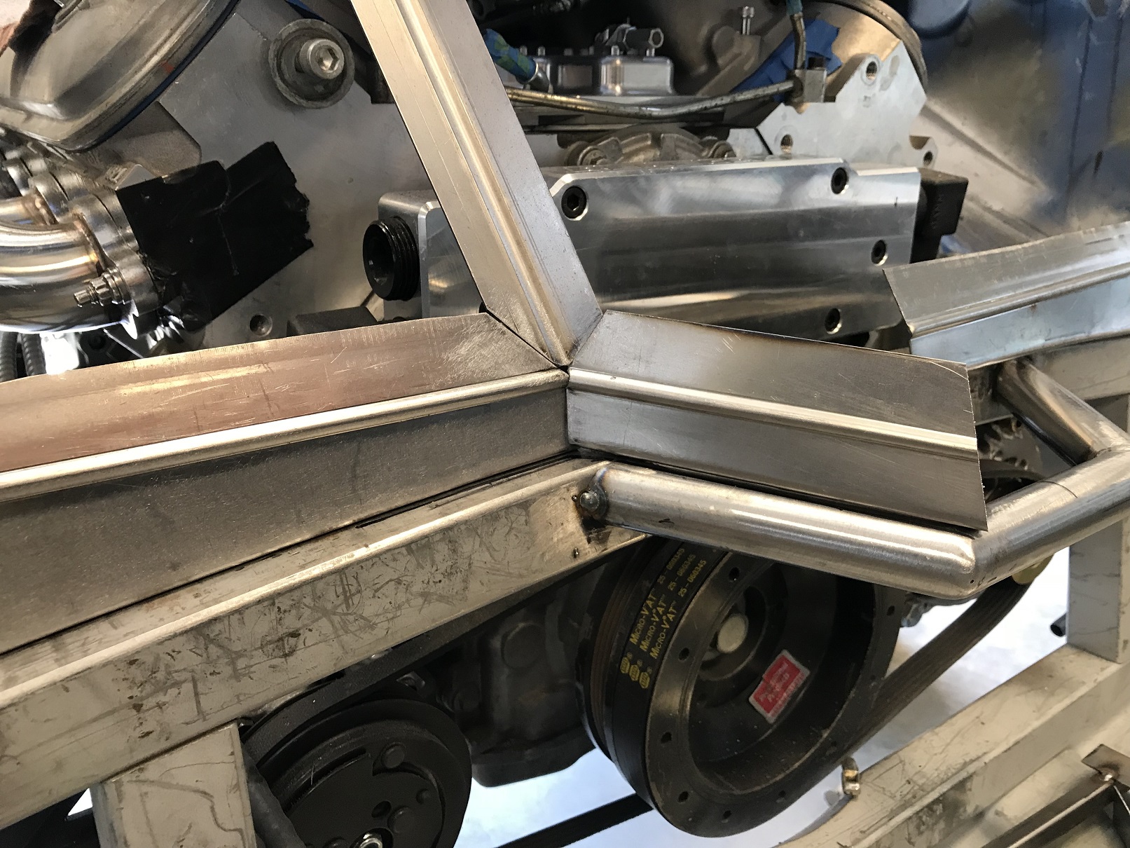

Top pieces completed and ready for welding! (IMG:style_emoticons/default/welder.gif)

Looking good! I'm thinking you should put Lexan panels in there so you can see everything! For safety, a fire suppression system.

(IMG:style_emoticons/default/idea.gif) Interesting...
(I was hoping to get some transparent aluminum but may have to settle for Lexan!)
