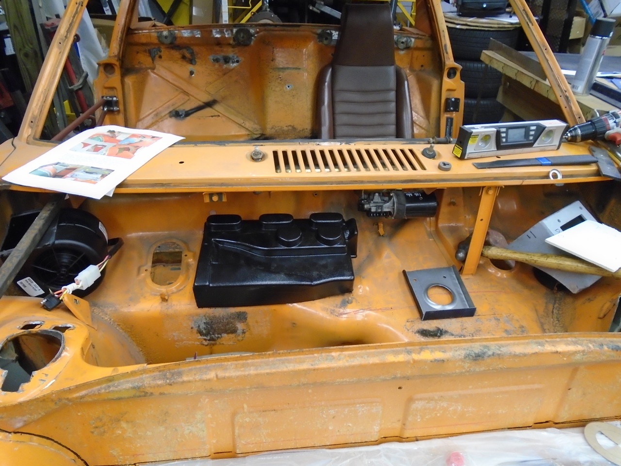

November Update:
Build thread: All the details and extras are here, part Duex starts on Post 263
ACCOMPLISHMENTS: - See build thread for the bonus details and photos!
1. Started working on the front spoiler
2. started working on front radiator mounts, fuel tank, and A/C installation.
3. Started fitting the front Tangerine Camber plates and mounts.
CHALLENGES
Trying not to rework everything several times. Seems like I am cursed by the goods. Instead of a boulder, I redo 914 fabrication. Truck keeps breaking down, have not made ti to the gas supplier to pick my welding gas cylinders. (IMG:style_emoticons/default/headbang.gif)
VENDORS
Nothing Purchased
Some pictures

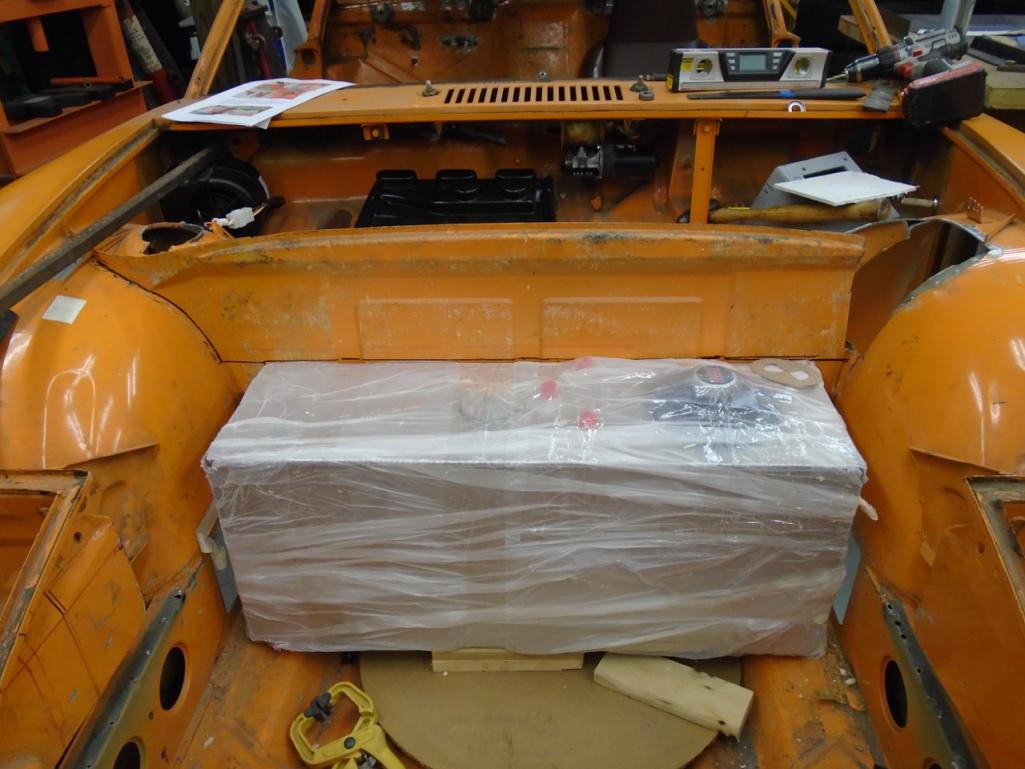

ACCOMPLISHMENTS - See build thread for the bonus details and photos!

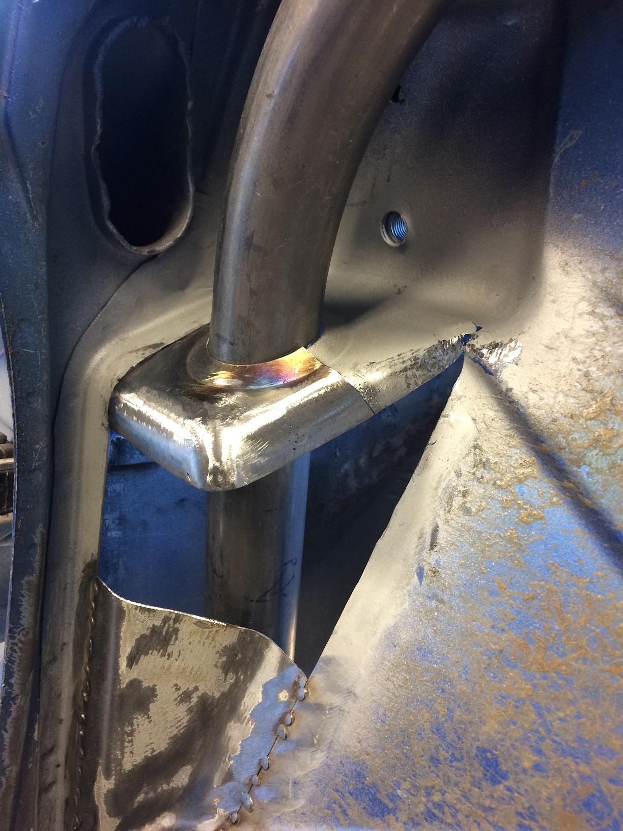

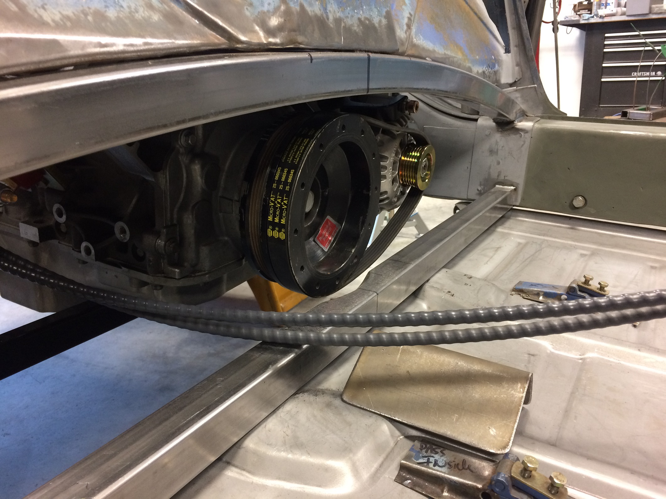

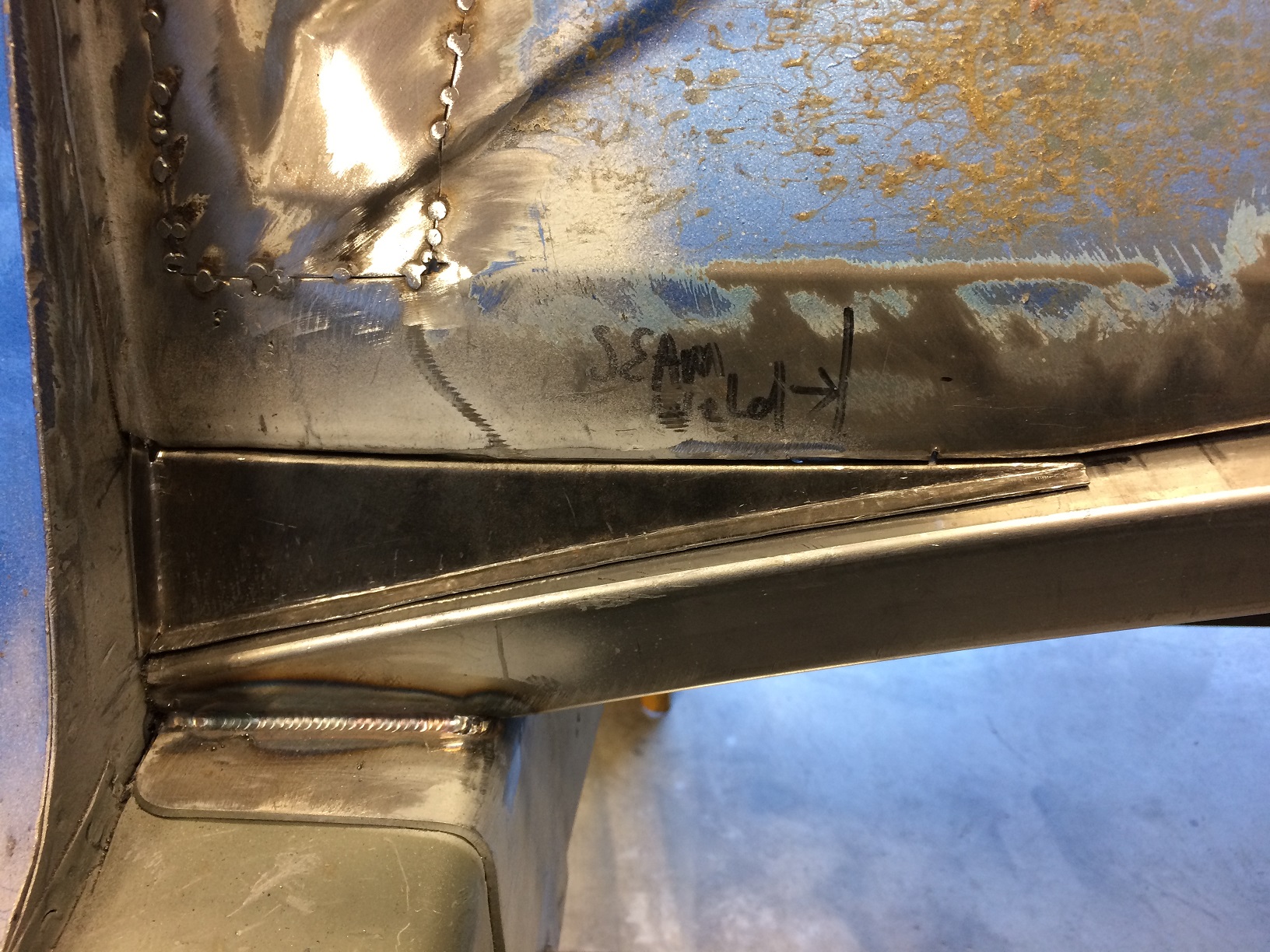

1. Closed all factory hole in the longs, filled e-brake cut out in prep for:

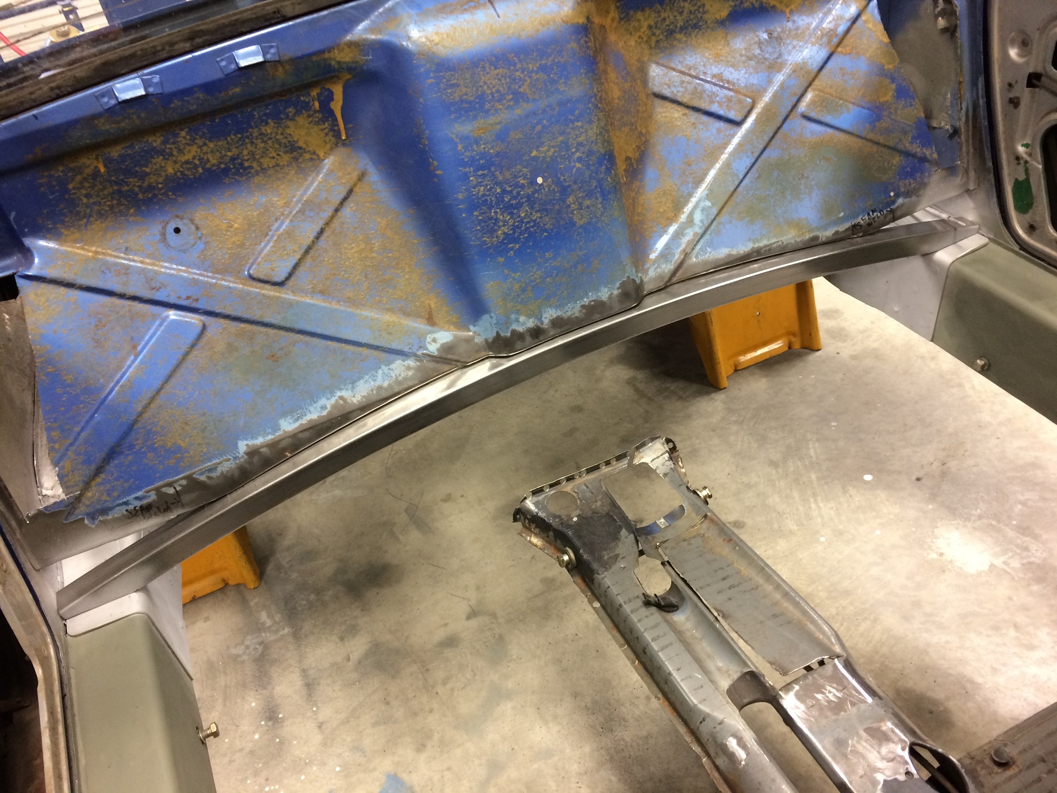

Custom long stiffeners installed!
2. Lower fire wall support pads fabbed and installed.

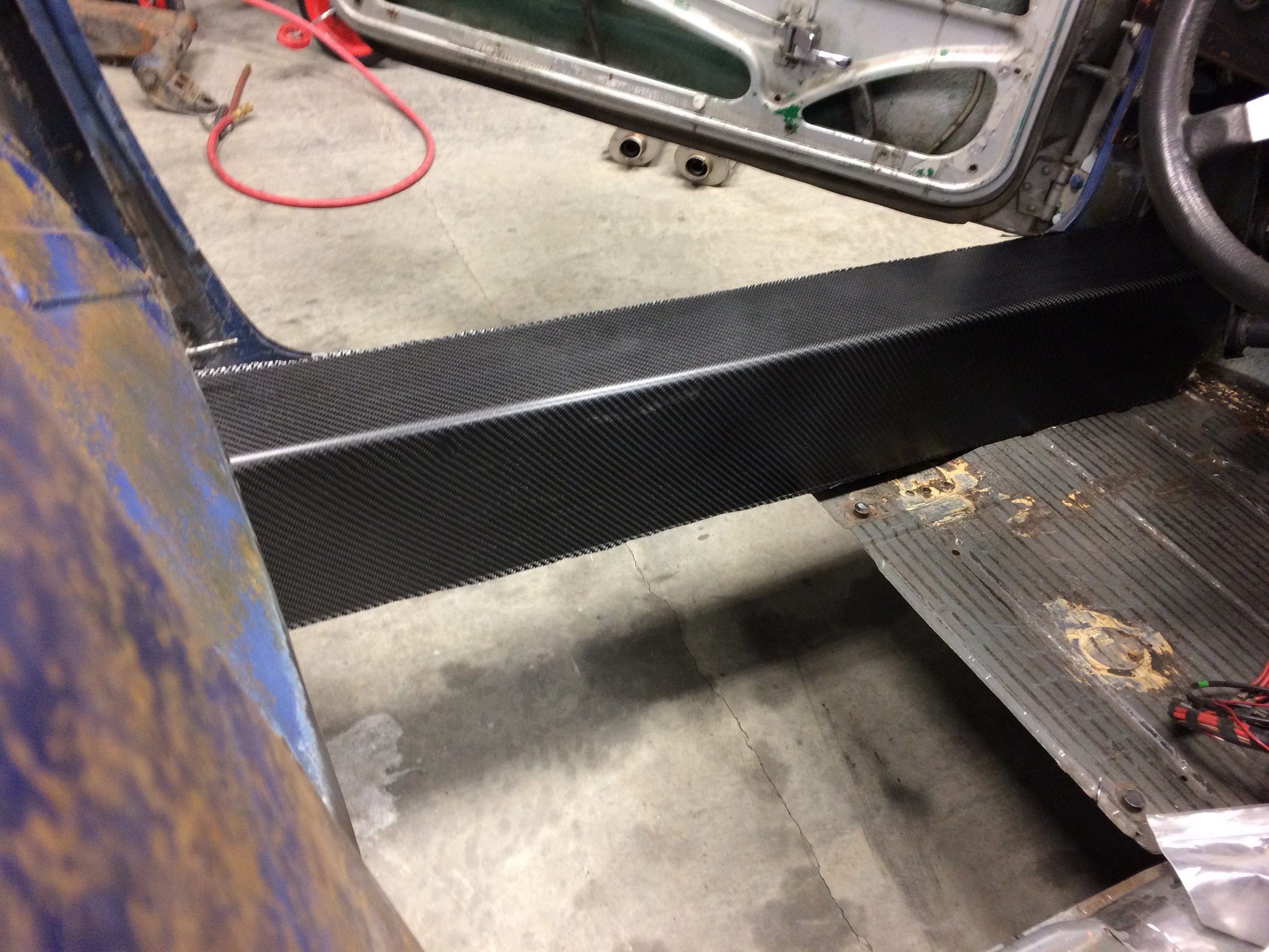

3. Carbon fiber long cover blanks fabbed
4. drive line test fit in prep to relocate it 1+ inch forward

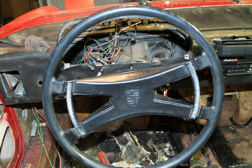

CAMshaft Build November Update
http://www.914world.com/bbs2/index.php?showtopic=297659
Accomplishments:

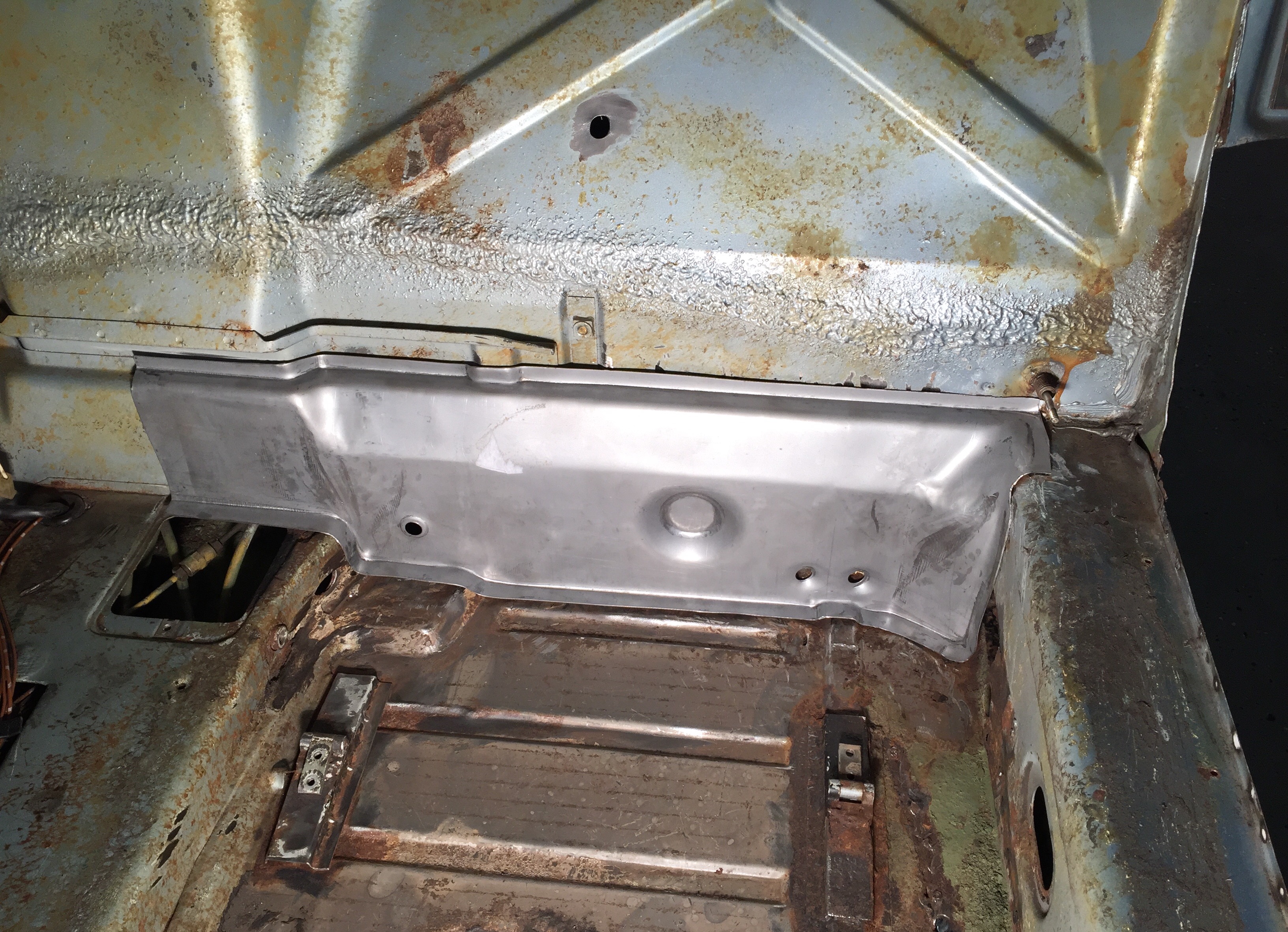

Remove front bumper and headlights
Remove glass, trim, seals and most of the instruments

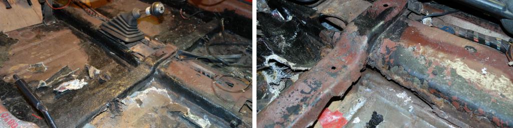

Begin to uncover the issues in the floor
Disassemble motor

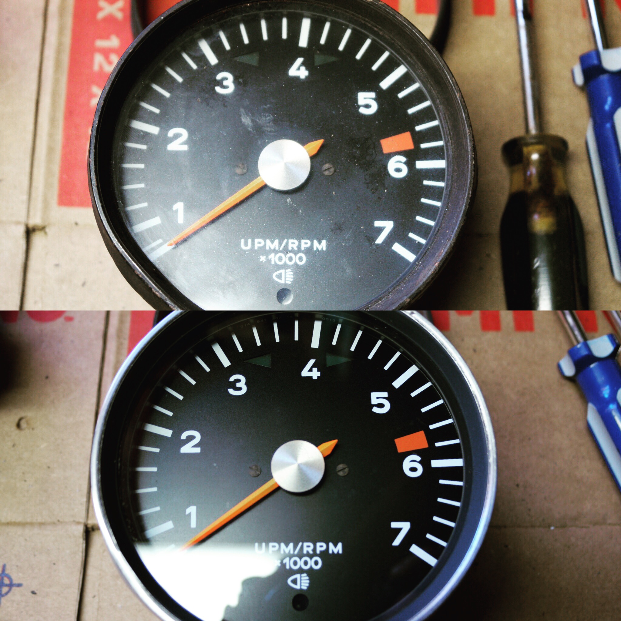

Gauge refurbish
Next steps:
Continue floor work
Remove remaining parts. Tank, rest of IP, rear bumper and lenses
Challenges:
Rust
Fiberglass
One broken bolt (e-brake) and two stripped trim screws
Lost sleep and emotional distress
Vendors:
Ace hardware

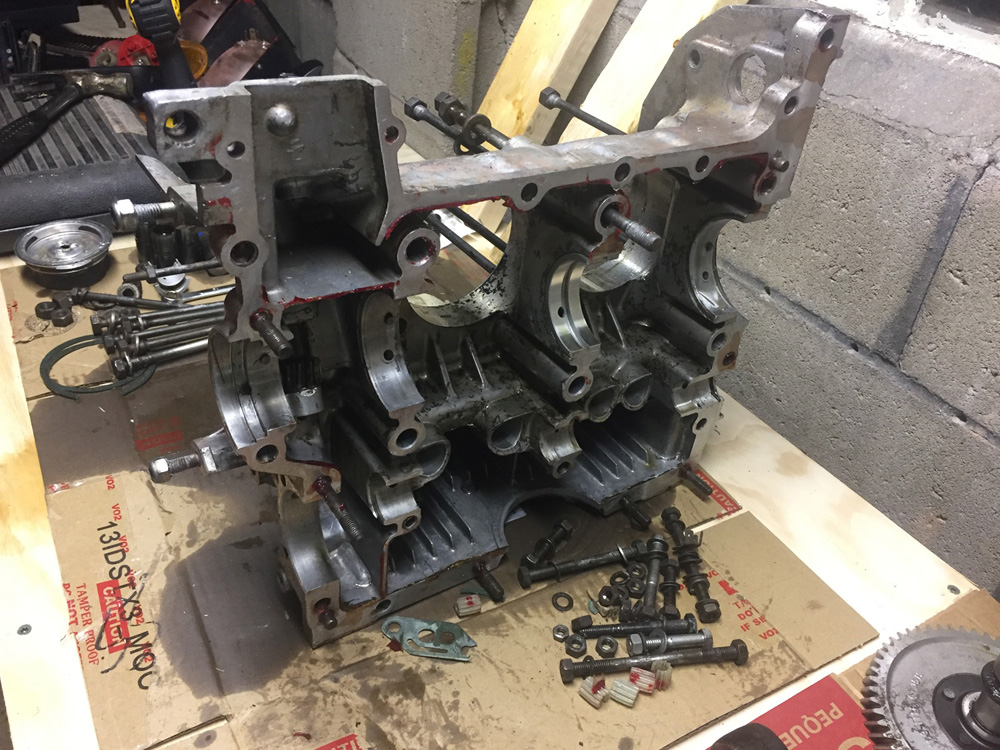

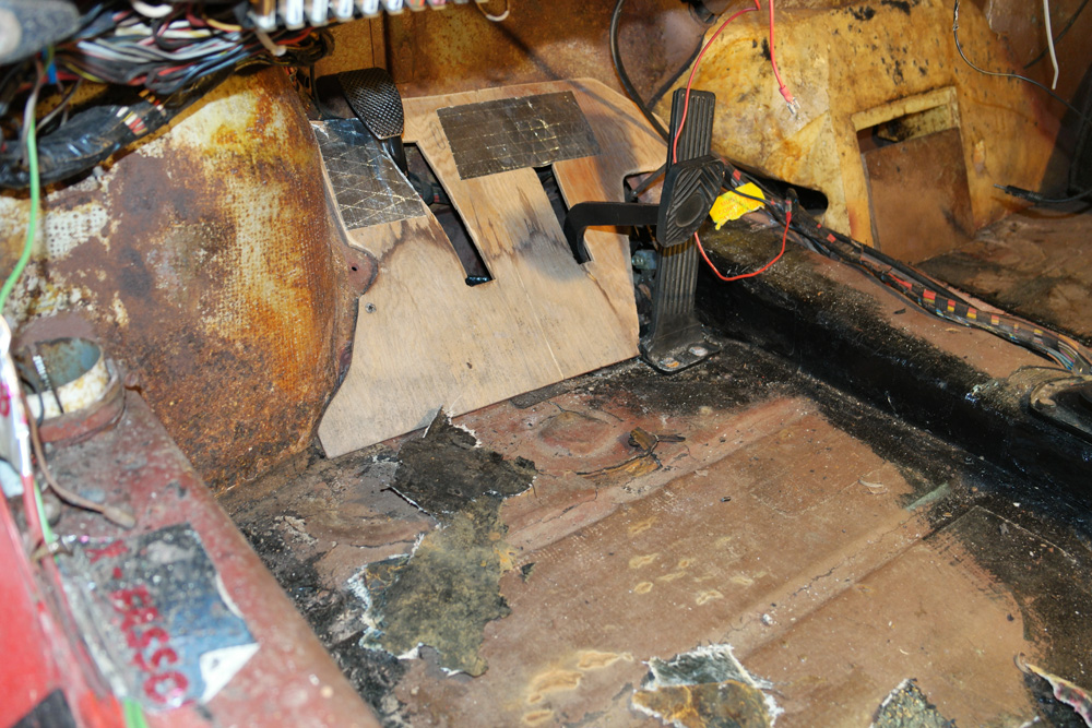

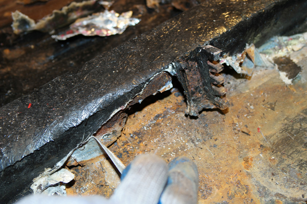

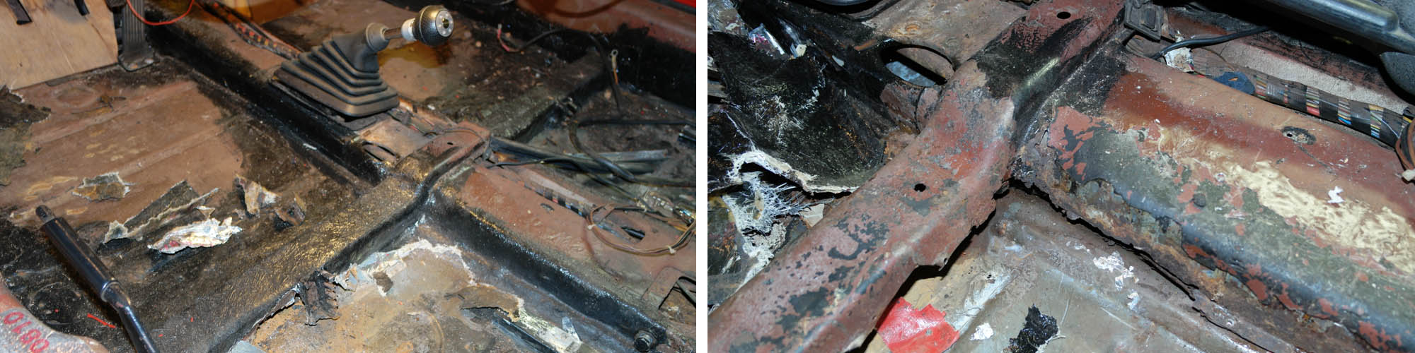

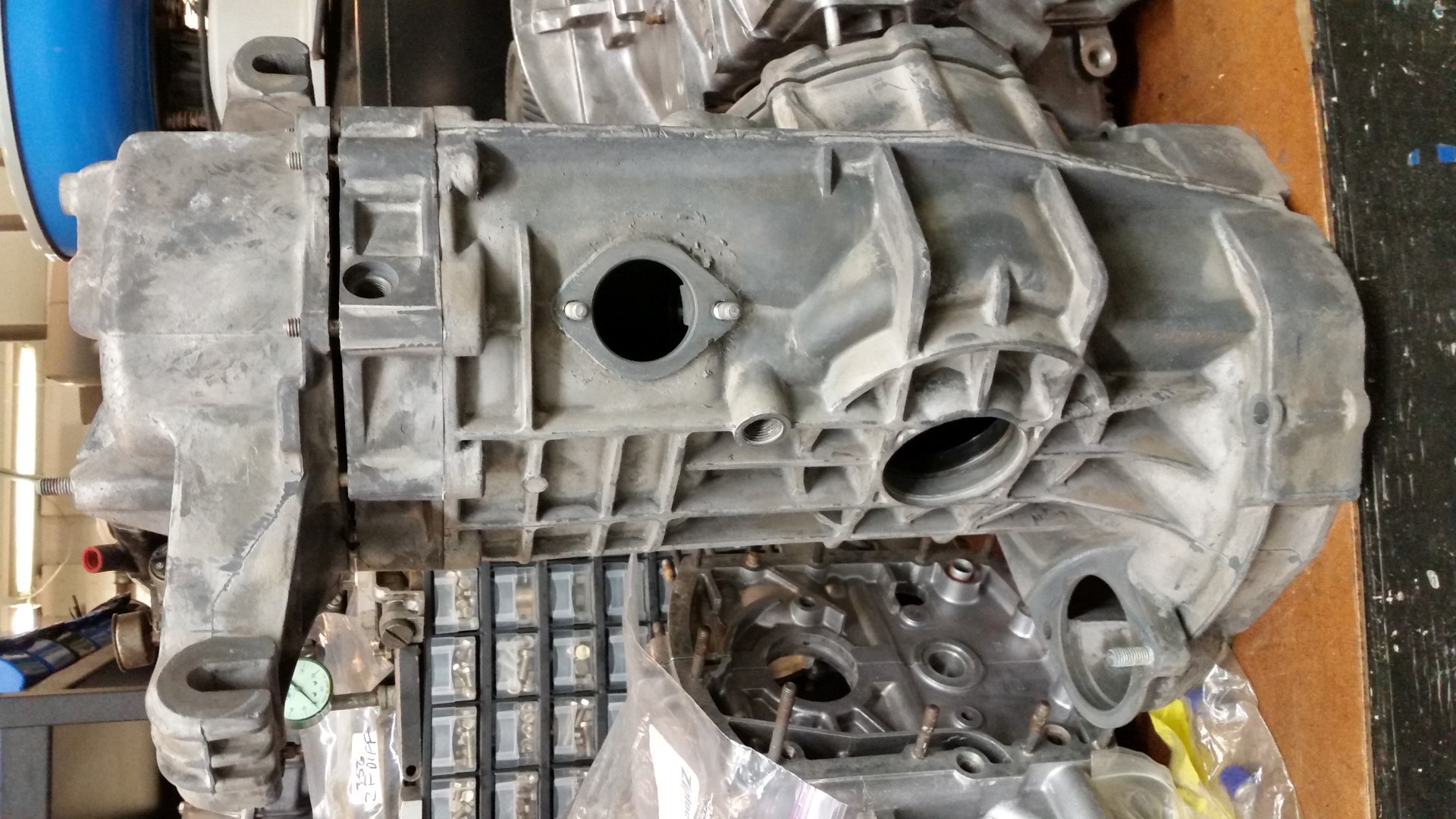

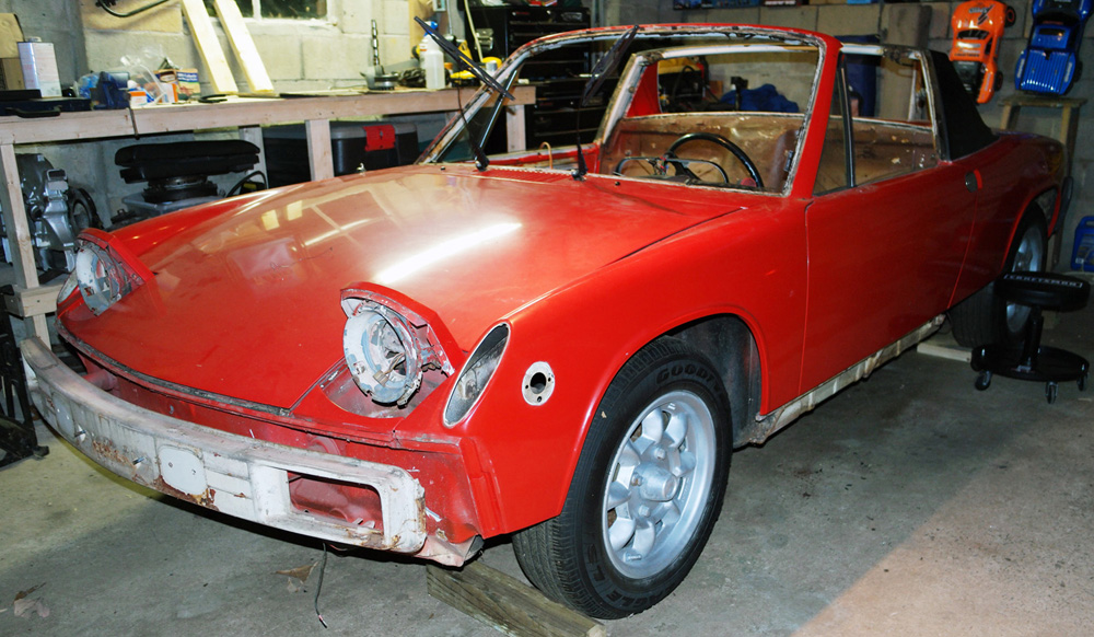

I got the case split to take inventory of what I have and create a list of what I need to get it built back up. One thing I found when I removed the brand new bearing that had been installed was that the hole for the dowel was elongated and will need to be addressed. I measured the bore on the case to make sure that it hadn't been bored but it appears to be factory spec.

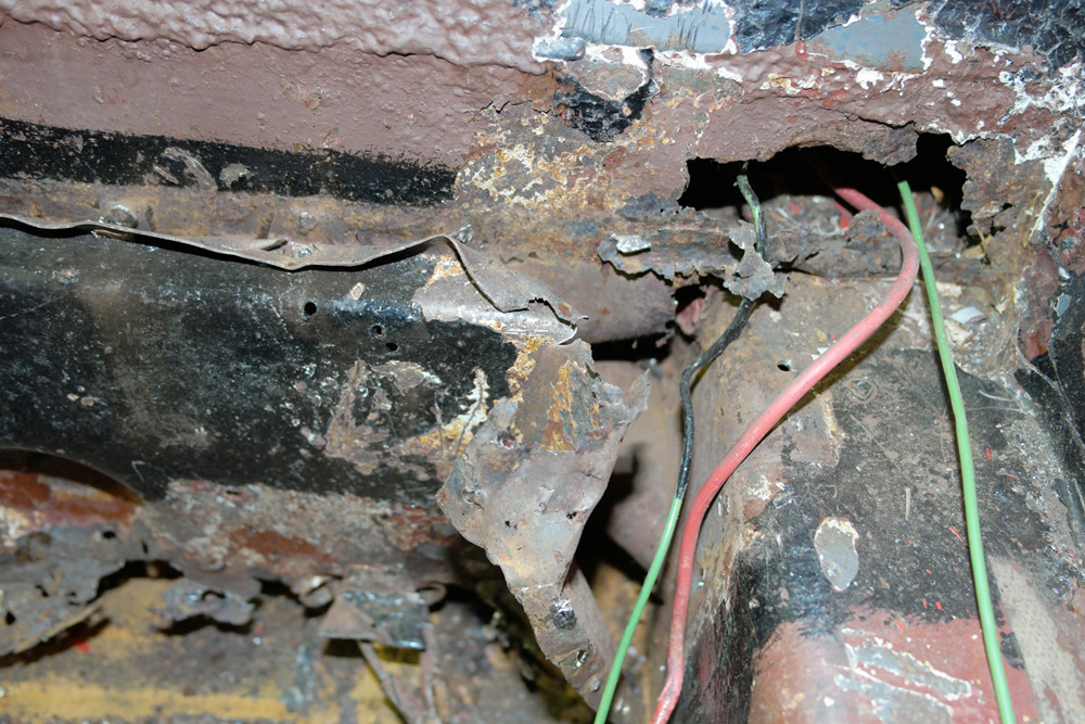

As mentioned before, the floor and rails had glass mat along the perimeter which pretty much only meant that it was covering something nasty. The question was how bad was it.... well, I know the answer to that now.
Before and after breaking away the glass. I'm fortunate that whomever did this did not prep the surface well so it came off in big chunks. It's luck that this didn't end with someones ass sliding along the road. One very poor weld was found in this repair which was a piece of angle iron tacked in one spot to bridge the gap between the inner firewall and floor. From what I can tell the rear pans are repro's (no tar, no access hole) The front are still original. Everything was buttoned together with a combination of... wait for it... rivets, tin, metal tape, duct tape and fiberglass. A petty good picture of this car's past life is coming into focus.

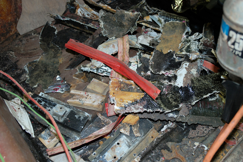

This picture of all the things that don't belong in the car is a perfect metaphor for what my brain feels like when I think of the huge hill that I am at the bottom of.
It's probably out of order but with a huge list of things to to I grabbed some low hanging fruit and got going on odd jobs that will need to be done at some point anyway. Cleaning up these parts is low risk, high reward and gives your spirits a bit of a boost after being neck deep in rust and fiberglass.
As she sits now.

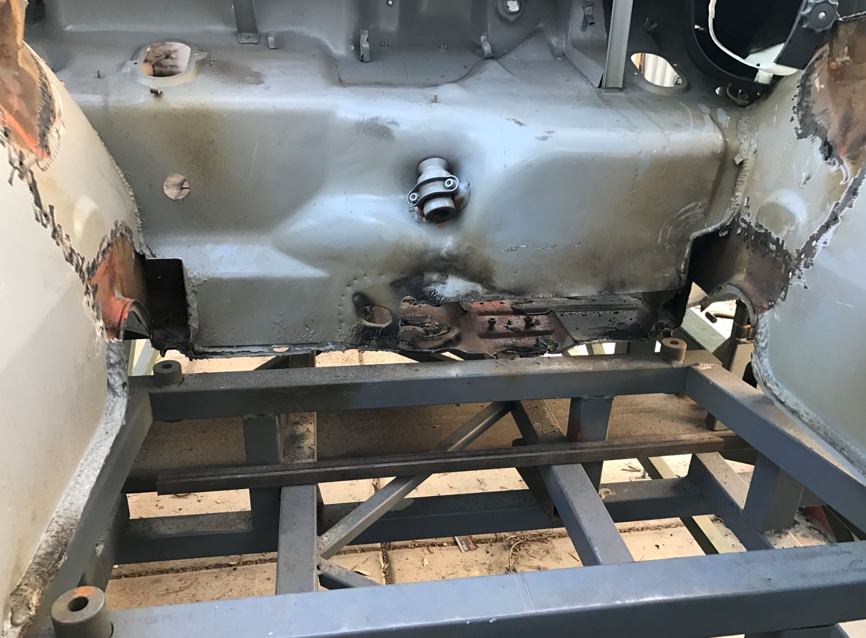

November 2016 Update:
Link to my build http://www.914world.com/bbs2/index.php?showtopic=206845
Accomplishments:

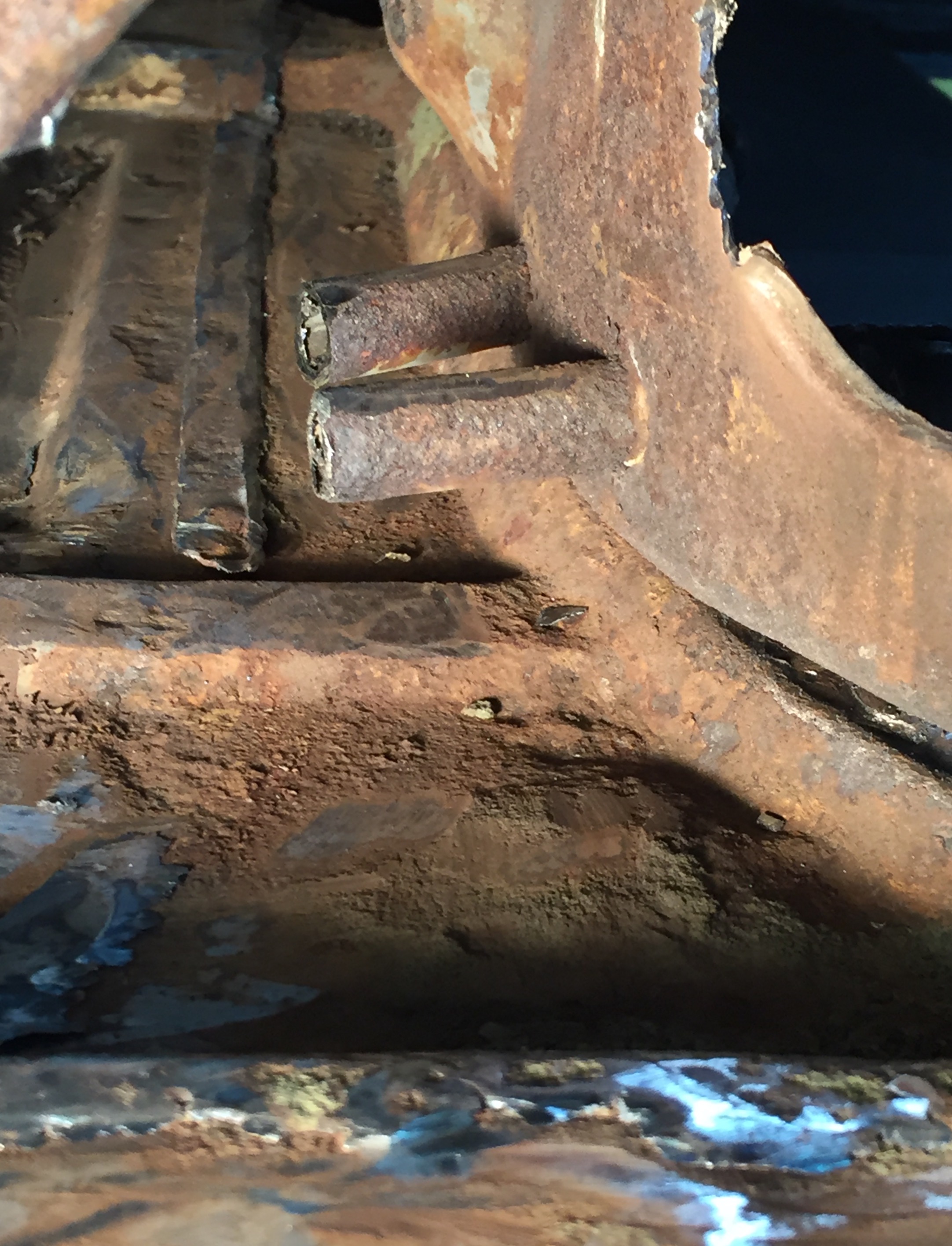

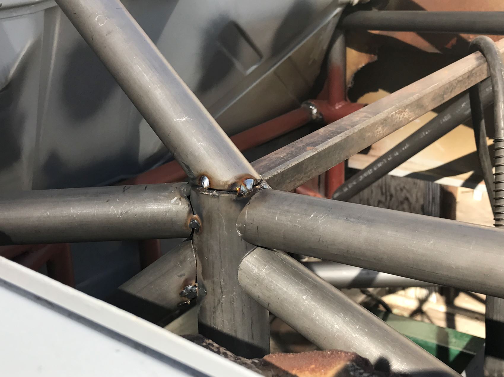

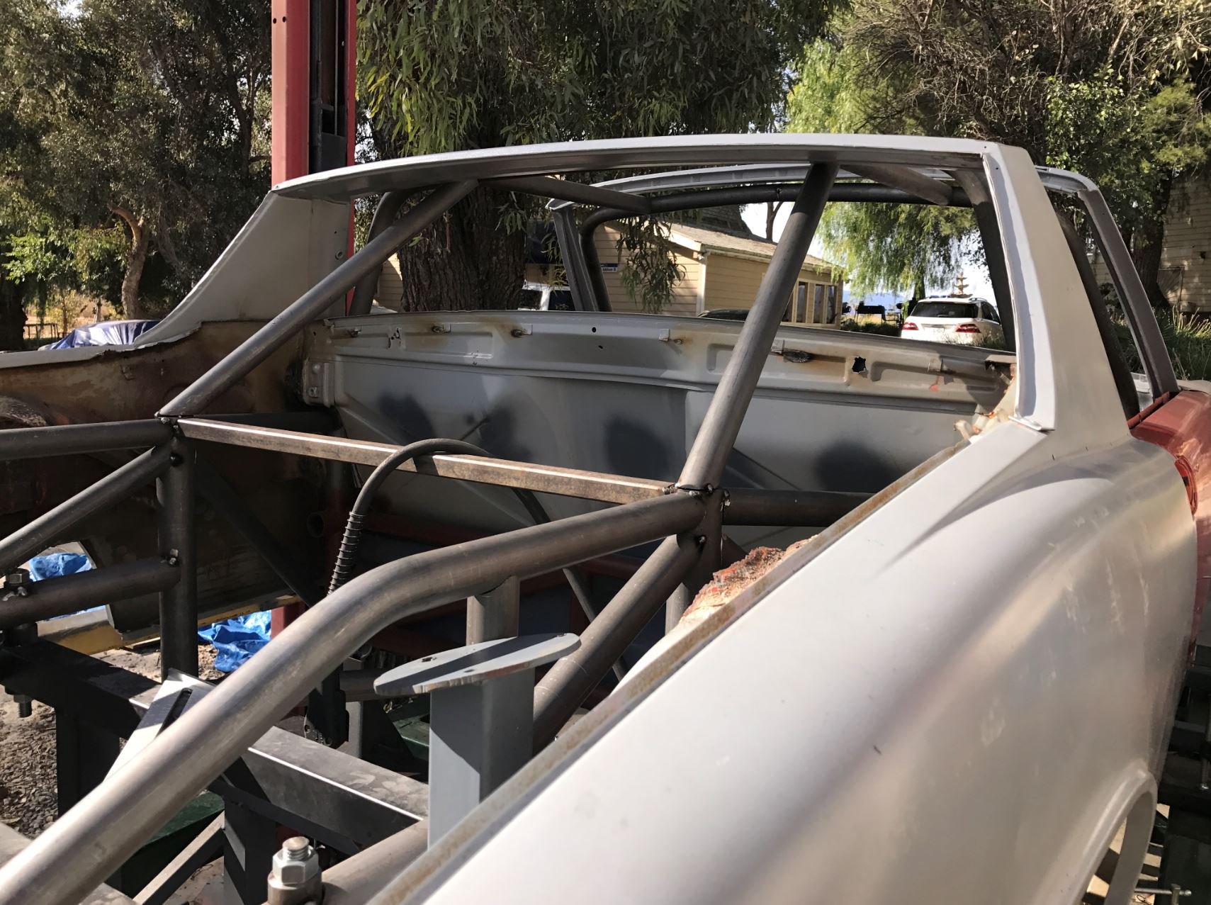

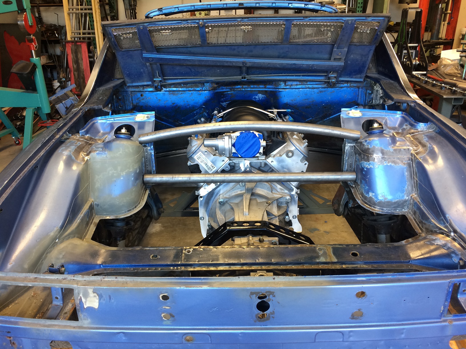

Completed tying in the rear tube frame to the suspension jig. Cut out about 160 lbs of steel, Started to complete the front end
Hurdles:
The front strut assembly stuck out above the front hood by about 3 inches. Had to do some research to be able to lower the front struts and not negatively affect the suspension geometer.
Goal for December:
Complete the front end tube frame and install suspension.

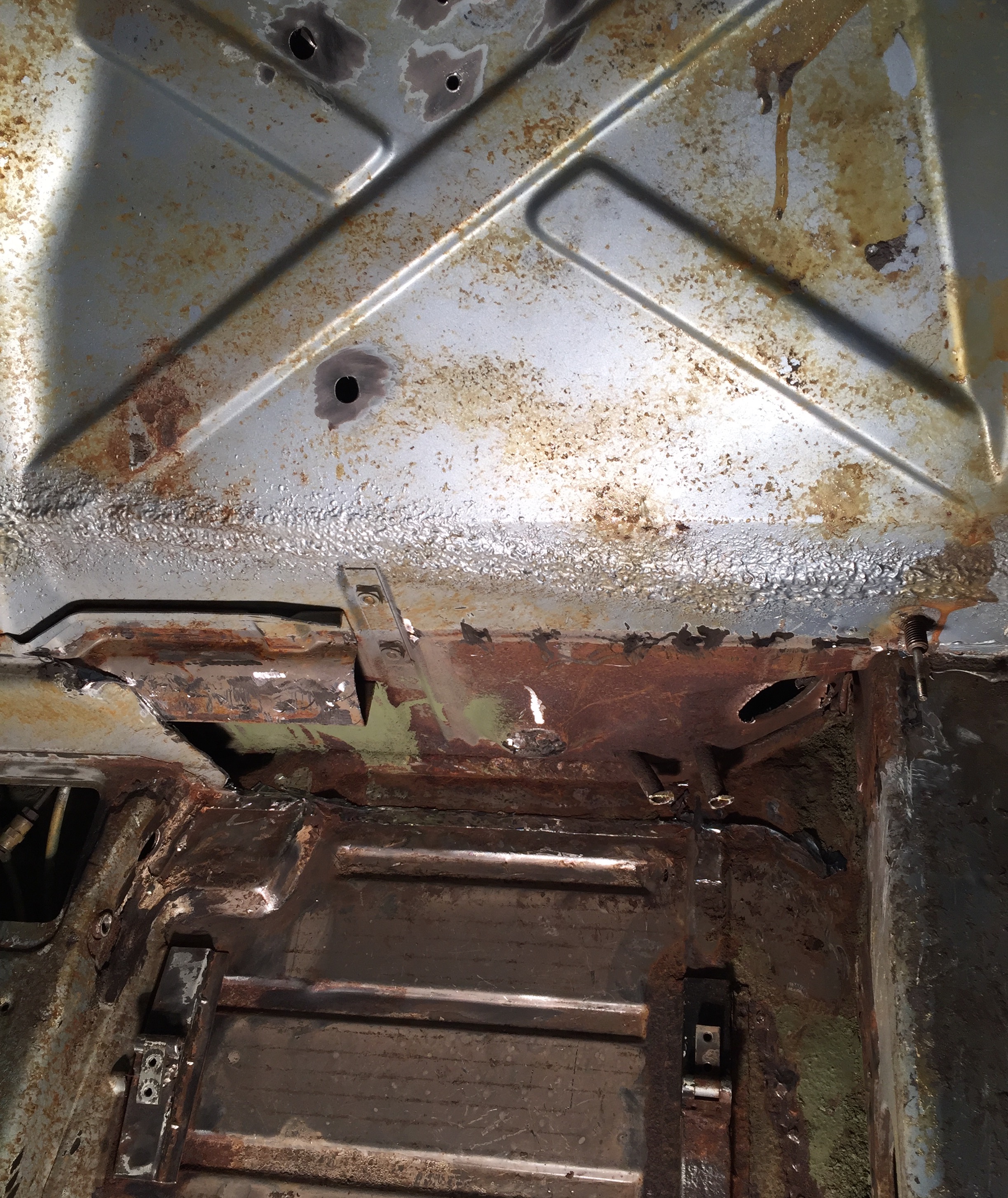

Removed lower inner left firewall.
Removed all of driver side sill.

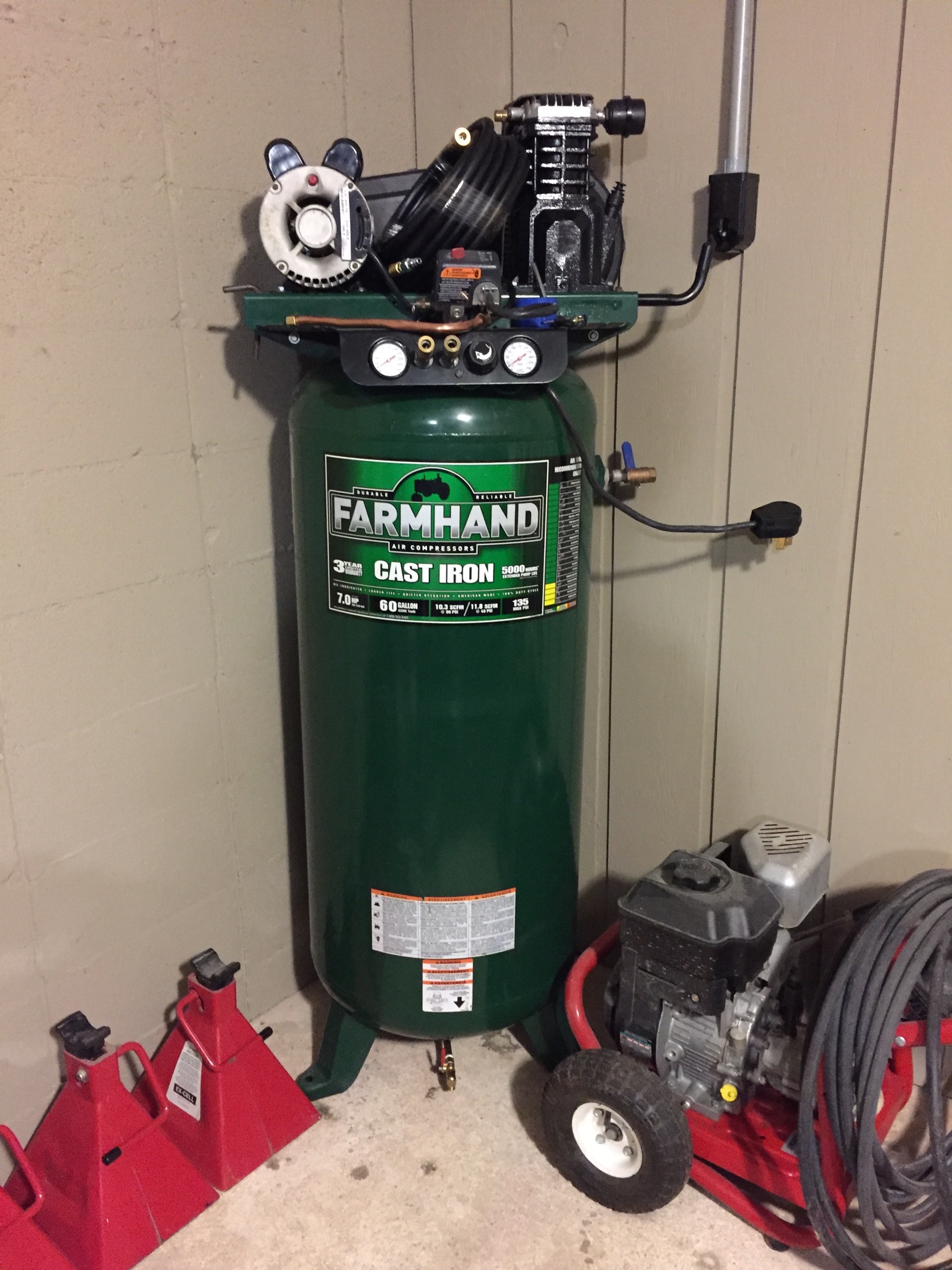

post Dec 1 2016, 08:49 PM
Post #51
Posts: 416
Joined: 26-October 15
From: SW Virginia
Member No.: 19,302

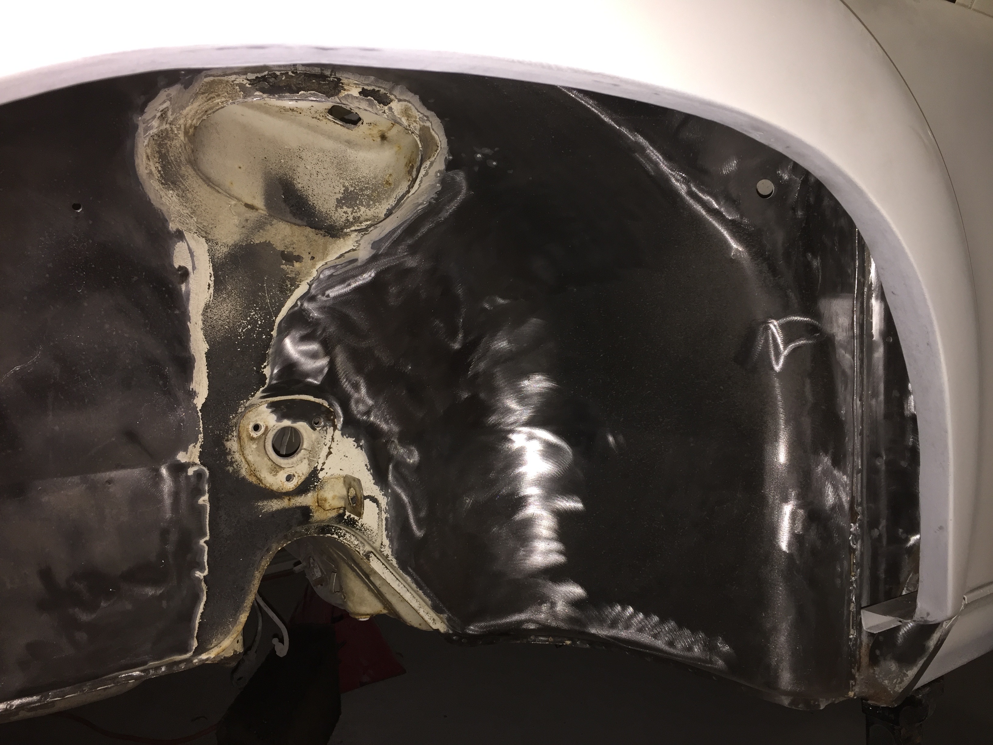

So, for my 1 day late November posting I am much further behind than desired, though the turn of events may be beneficial after all. I had planned to have the project body mods completed, and the body in my garage by the first week of November. Unfortunately, it is still a 3hour drive away.
Planning, preparation, anticipation, and more planning have consumed my free time this month. A couple weeks ago my wife asked how I would be able to work in the garage with all of the 914 parts lying around; I jokingly responded saying the parts would be stored in the spare room, to which she said "good idea". After I recovered from the initial shock, I made sure to not discuss the issue any longer and proceeded to comply with her wishes. All parts are now comfortably resting in the house.
My second project was to find an air compressor for free or as close to free as possible. With "free" as the goal, I wasn't extremely picky. I found a little used, one stage, 60 gallon unit for $100. With the 220V line and other accessories, I spent around $250, but that's still cheap.
I think I'll be able to go get my project's body soon. I need to find a welder now; I'm thinking about a Lincoln, but I don't know anything about welders.

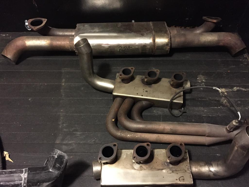

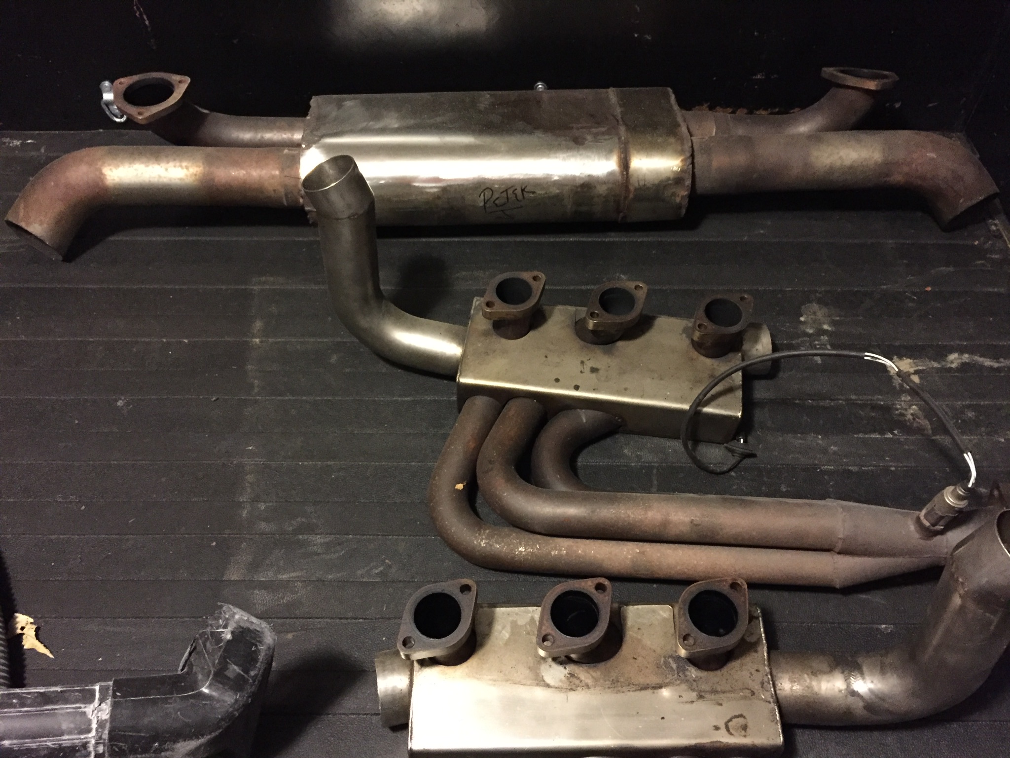

Oh yeah, I started cleaning up the BB exhaust that I removed from my 3.2 engine. I'll sell this soon.

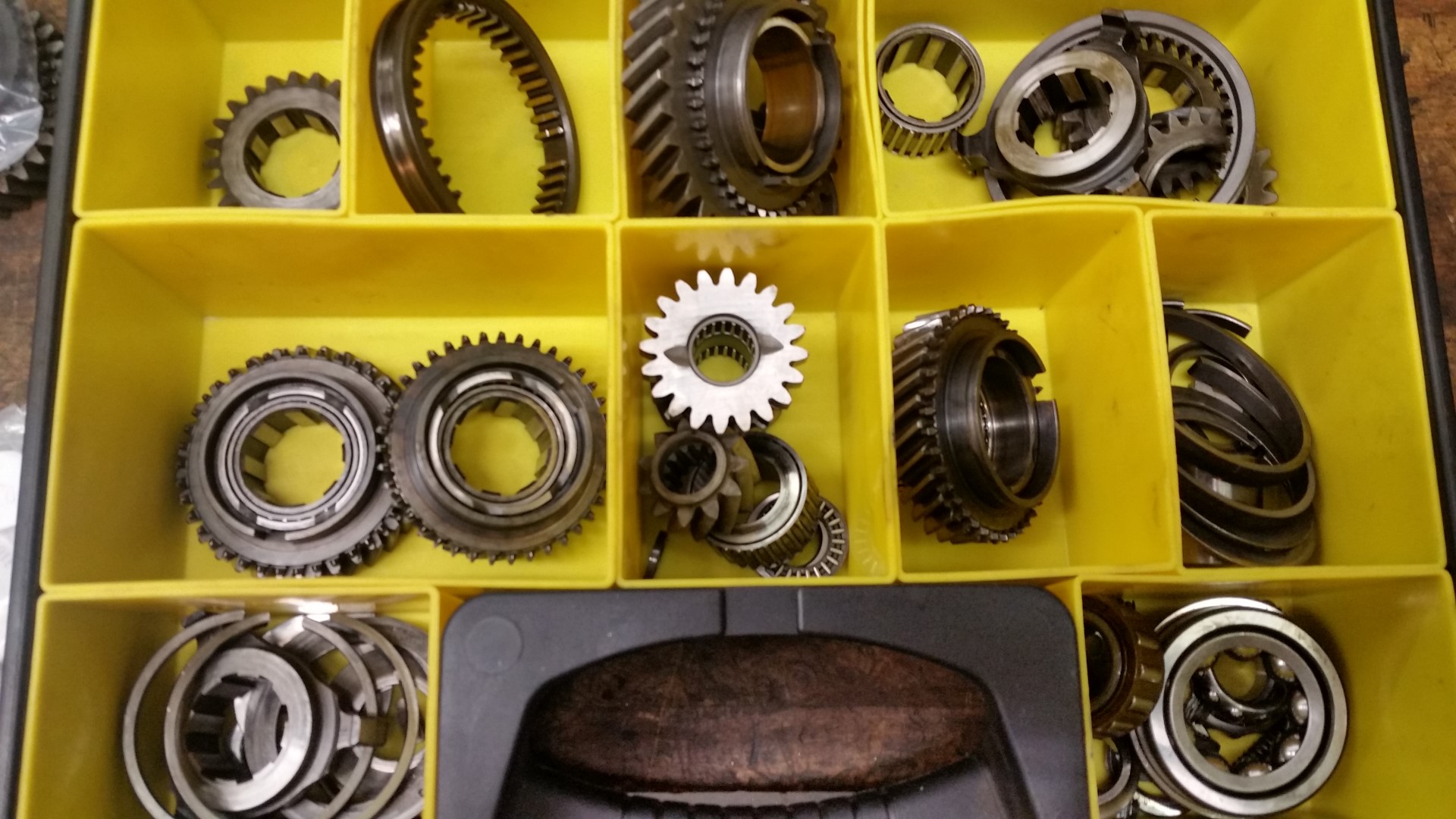

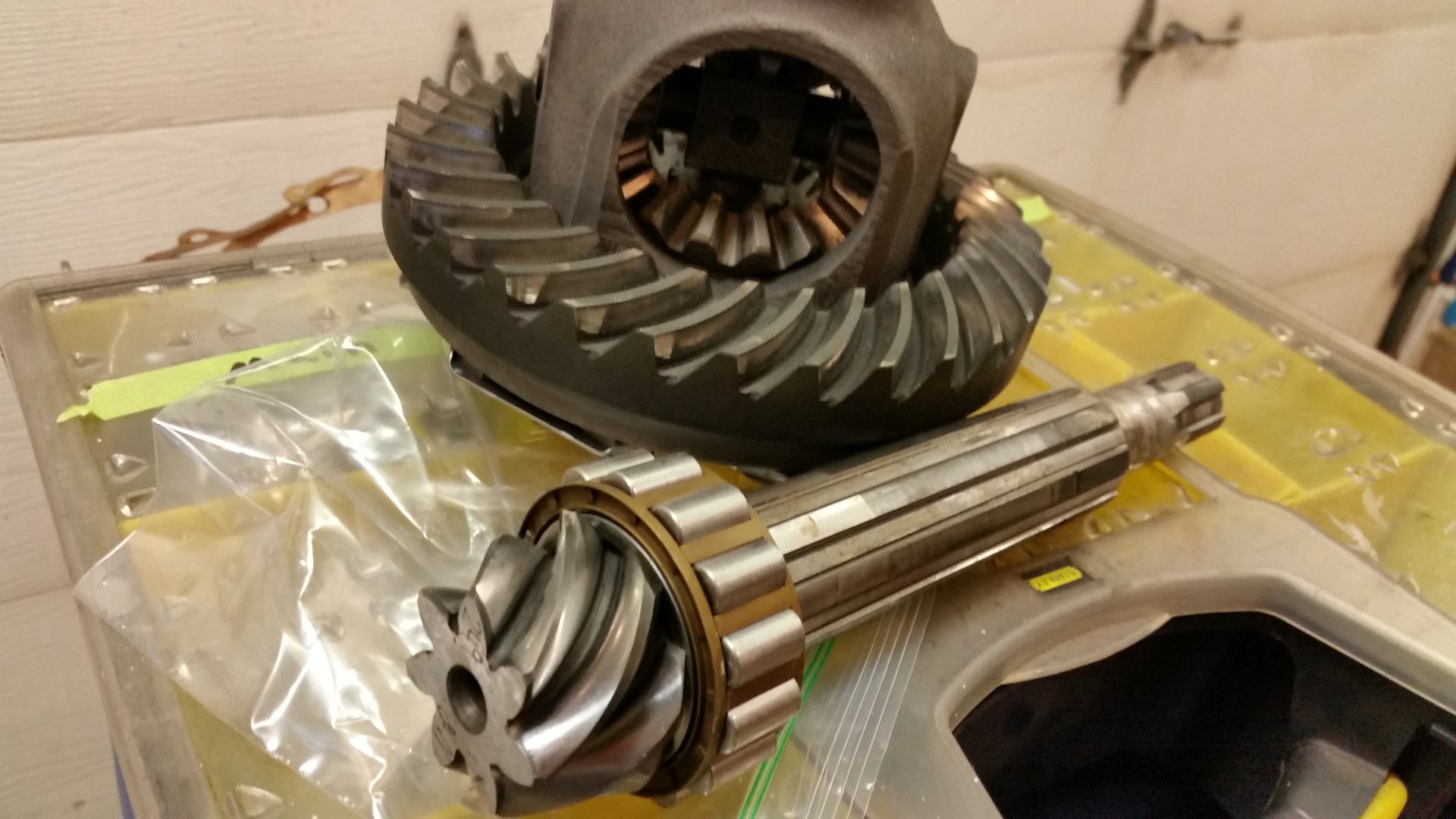

- I got good news from my engine/trans builder friend on the transmission. Said it's the best 901 transmission he's seen. But the previous builder used too much heat on the 2nd gear dog ring, so it wll only need the following to make it /6 stout:
o - new 2-5 gear synchro hub
o - billet intermediate plate
o - billit side cover
o - typical seals etc et
o - putting it back together
- The engine is still kind of a mystery, since it was sitting for so long. It was soaked in Marvel Mystery Oil for a week to see if we could get the leak-down test to look better. A bit better, but no dice.
o - ring sealing seems worse than valve sealing
o - will need new valve guides, could change sealing ability by tapping on the valves when under pressure
o - will have to pull the heads to see how the pistons and cylinders are.
Fingers crossed they aren't too bad and just need valve guides and rings...but we'll see You never really know what you have until you get in there, but we're going with an approach of tearing down only as much as needed. With these mag-case engines you don't want to rip it apart unless totally needed!

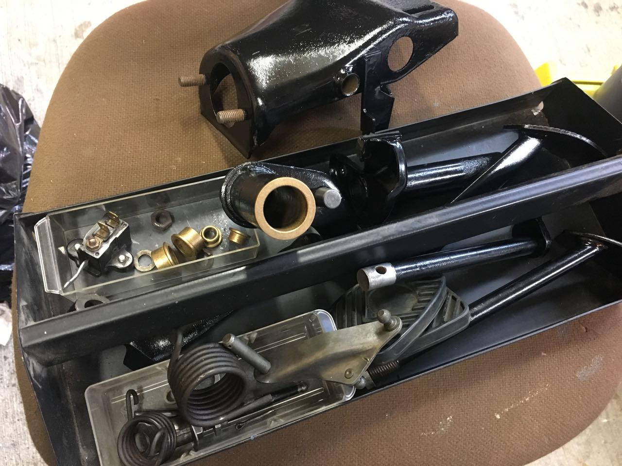

3d914
post Dec 2 2016, 04:32 PM
Post #53
Posts: 1,275
Joined: 24-September 03
From: Benson, AZ
Member No.: 1,191
3d914 - 914 SHO Build / November Update
Build Thread: Challenge 2017 starts on page 25
Great to see all the cool progress others are making. Keep it up guys.
Accomplishments:
Body Panels

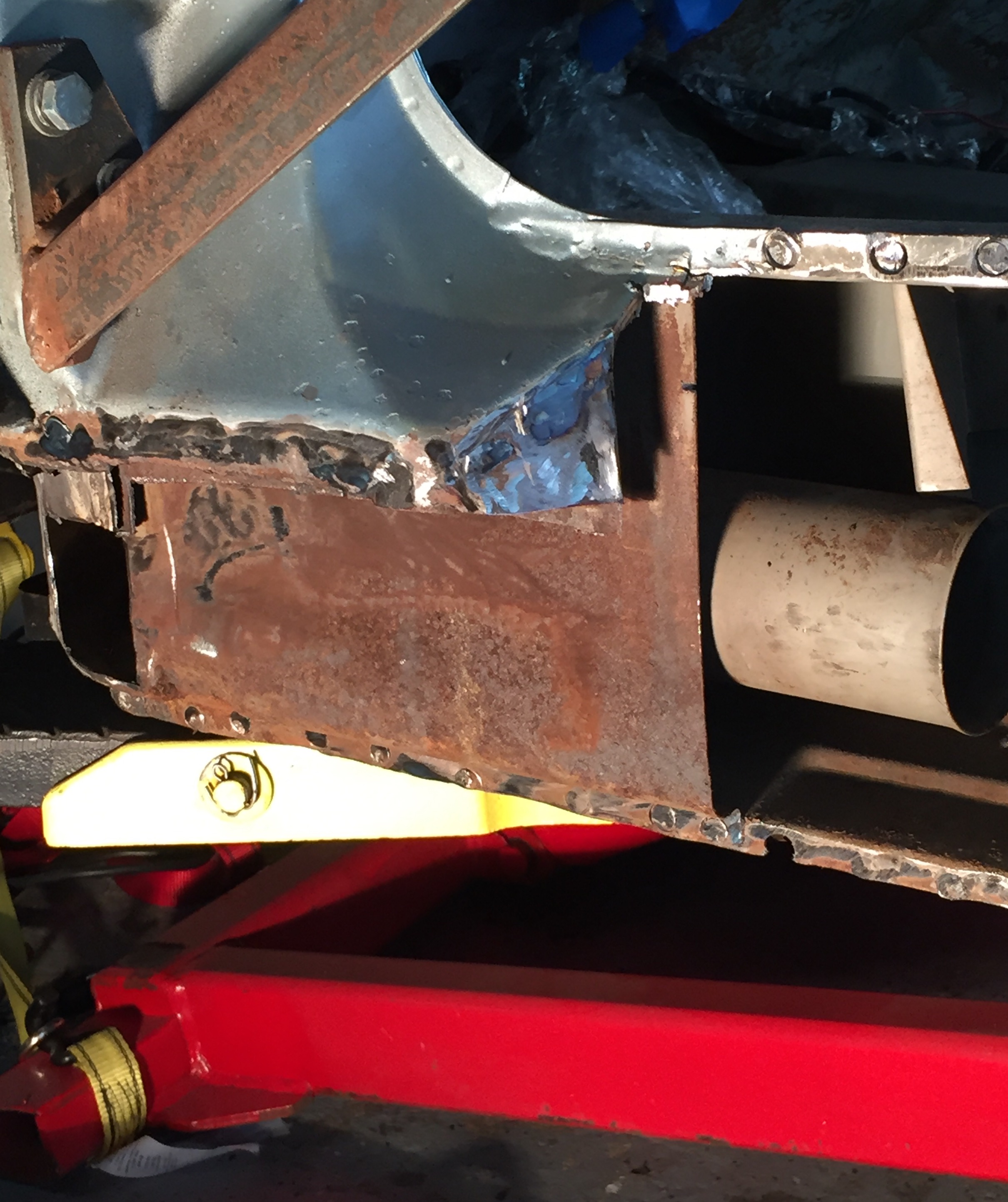

  • Fit and welded right panel cutout
  • Repaired left replacement panel
  • Fit and tacked left panel cutout

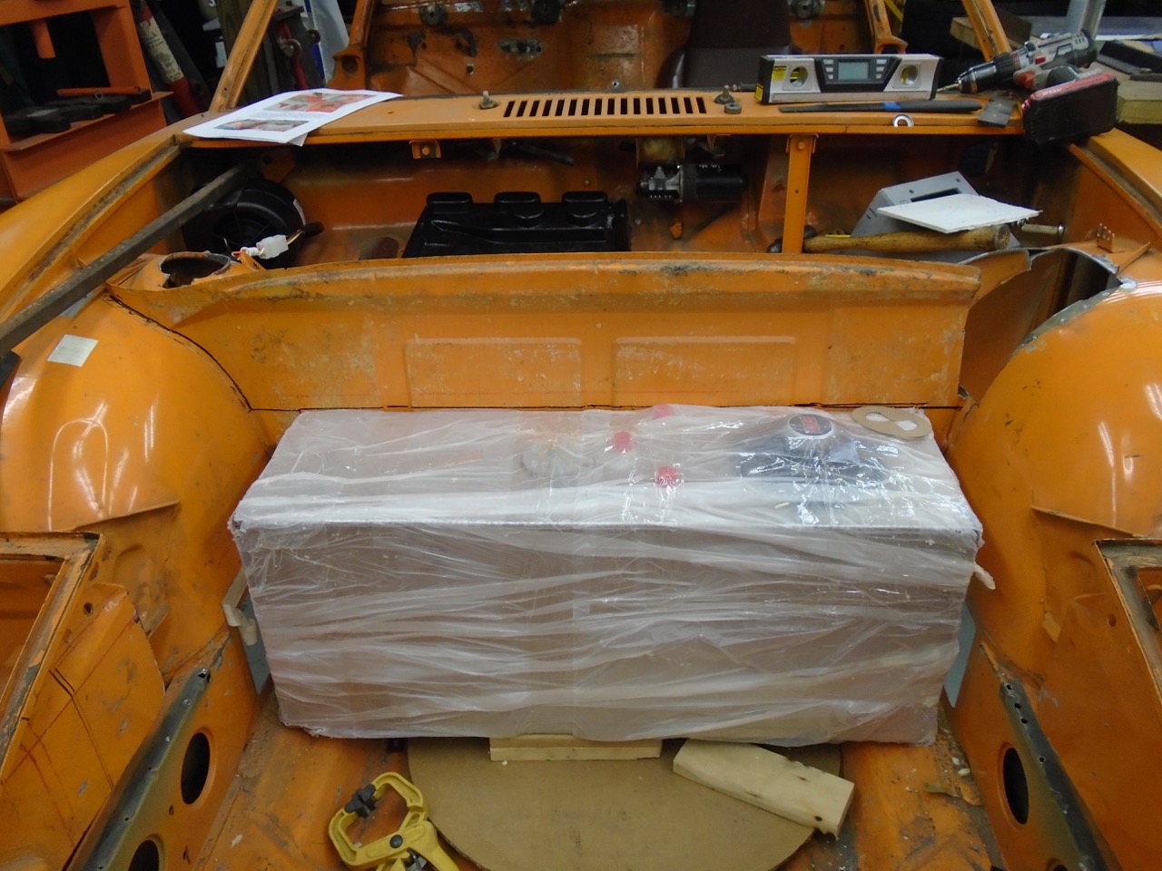

Rear Trunk
  • Designed, had cut, and flanged mounting brackets for rear trunk hinge
  • Built ABS air box for air intake
Challenges:
Mostly just life & short winter days. Need to finish back patio flagstone, and now my daughters car threw a rod and will get a replacement JDM motor. So next couple of weeks won't be very productive on the project.
Pictures:
Intake air box
(IMG:http://www.914world.com/bbs2/uploads/post-1191-1480016063.jpg)
Left panel fit and tacked
(IMG:http://www.914world.com/bbs2/uploads/post-1191-1479086426.jpg)
Mounting brackets cut & flanged
(IMG:http://www.914world.com/bbs2/uploads/post-1191-1480716866.jpg)

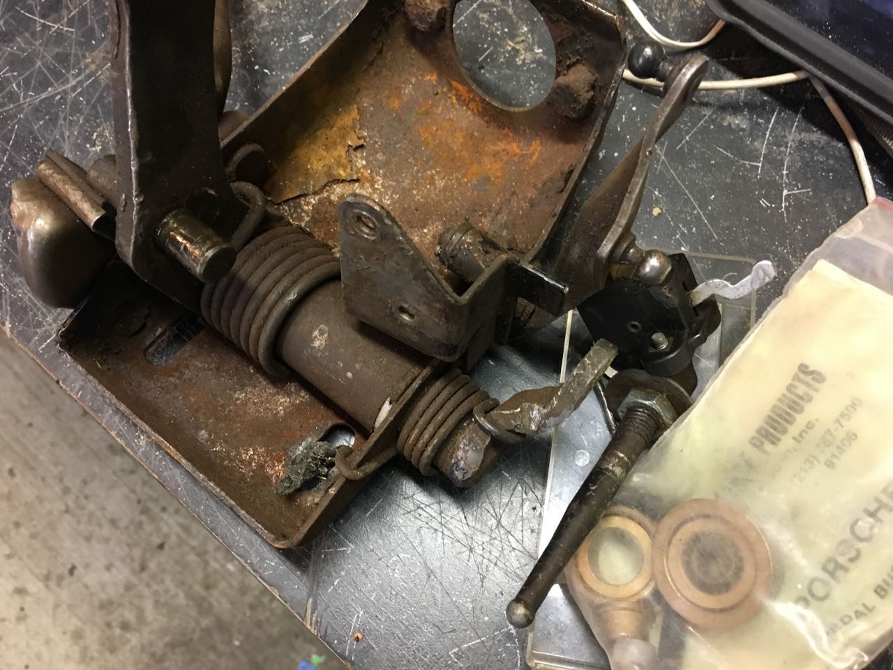

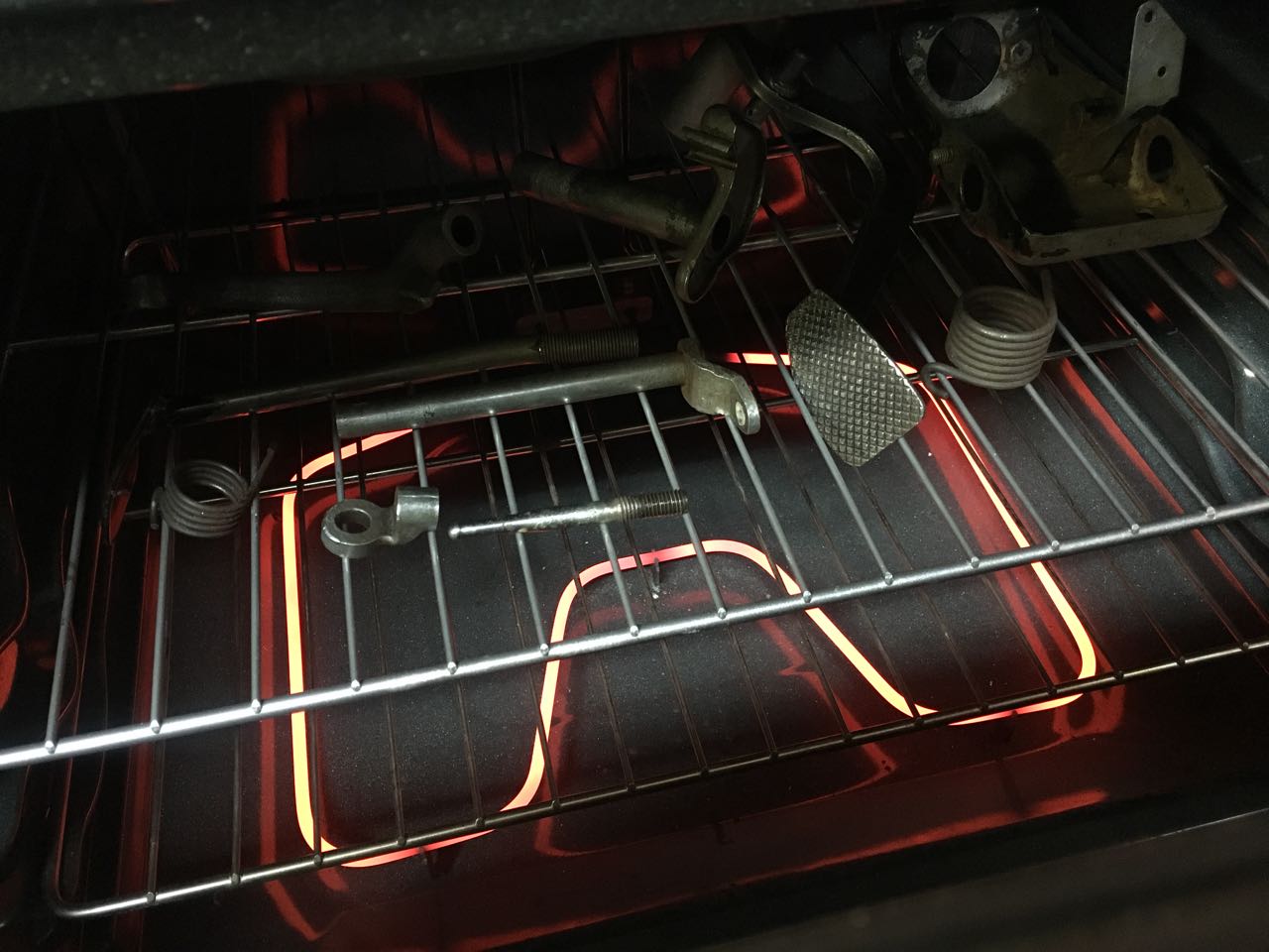

Refirbushed the pedal set.

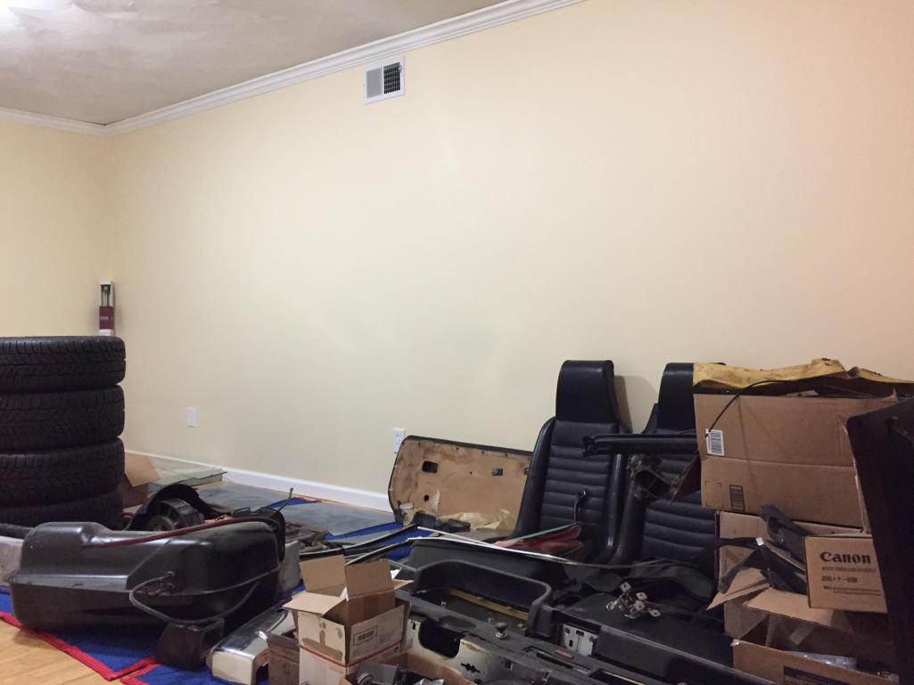

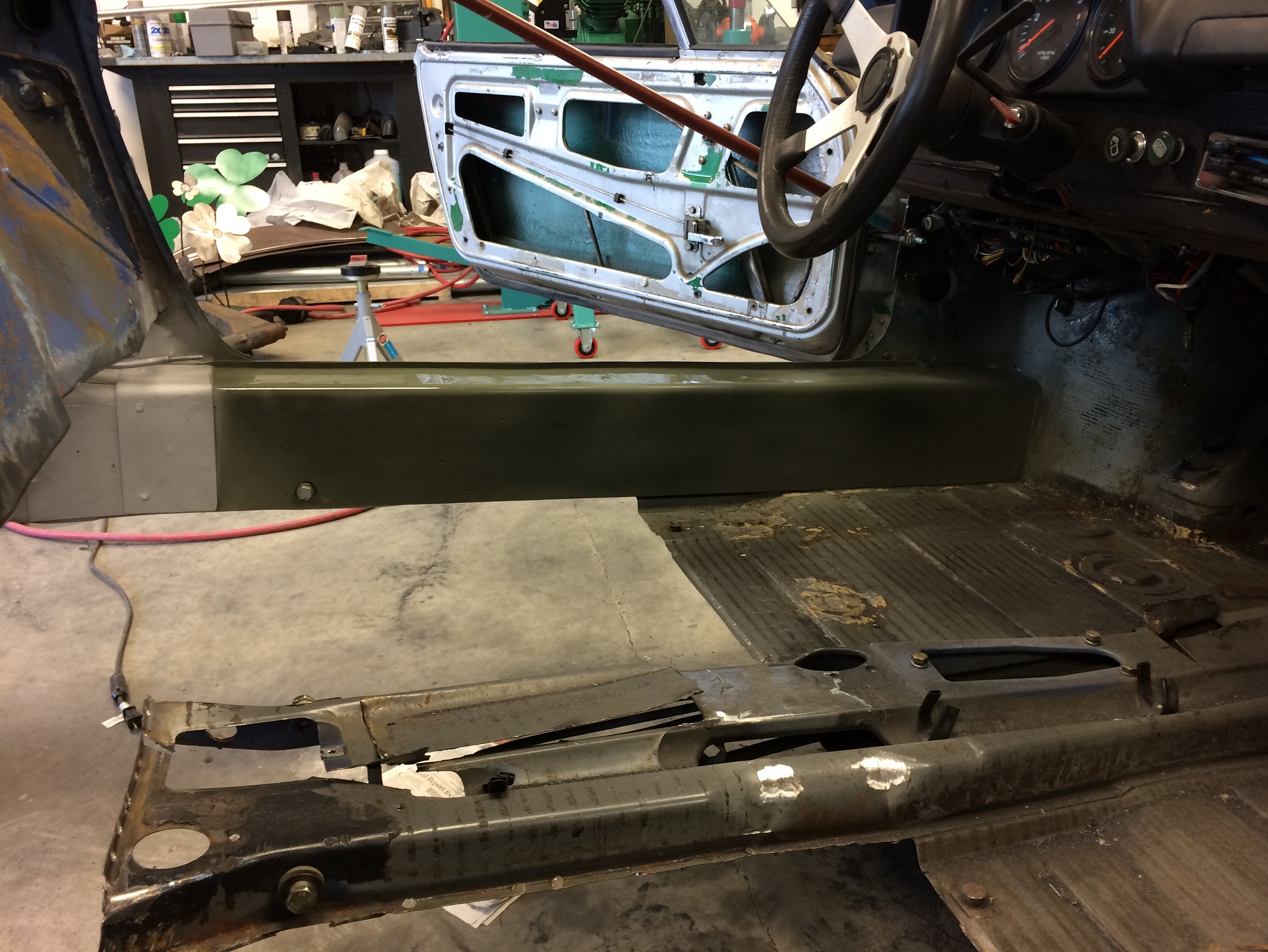

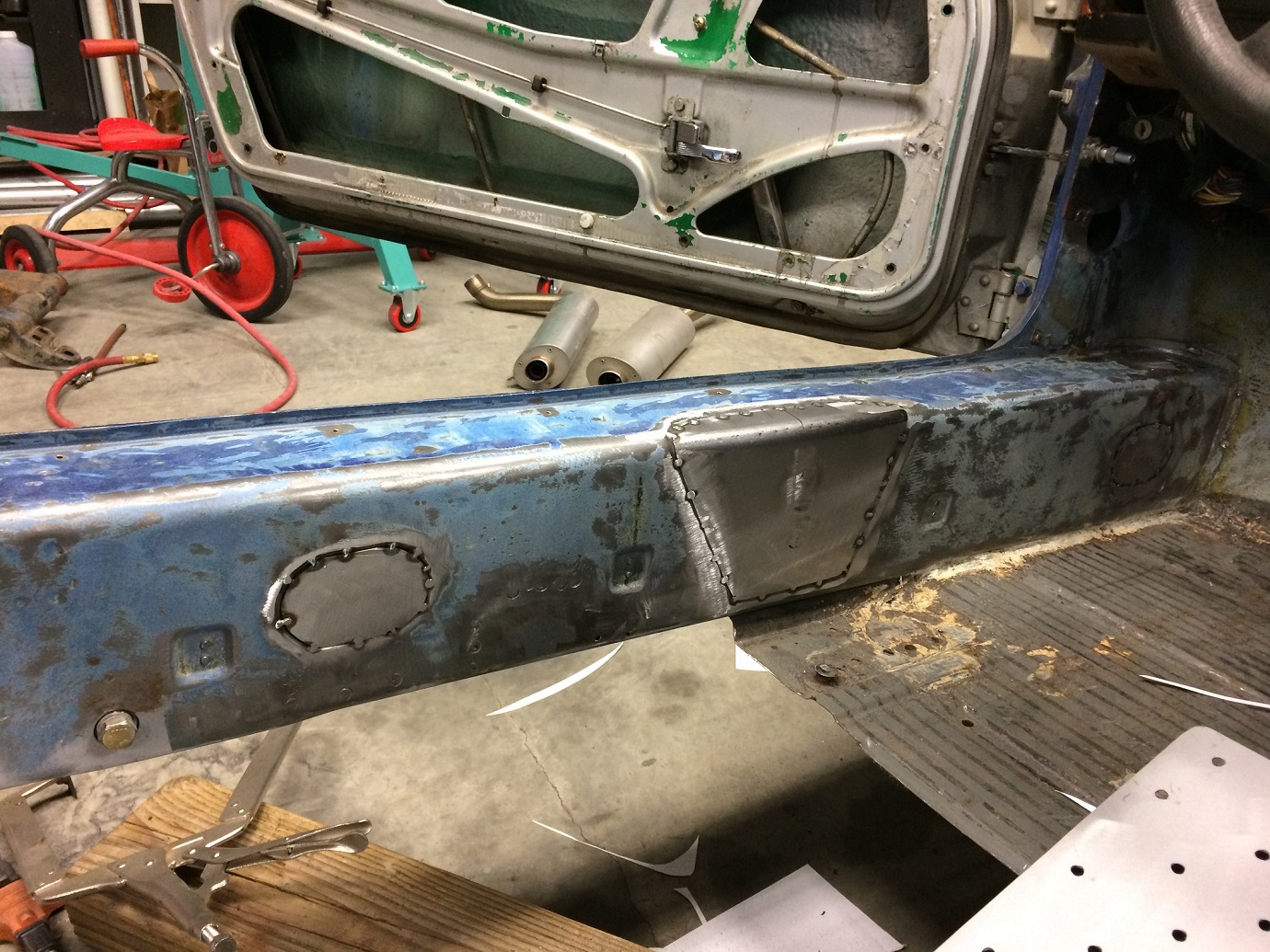

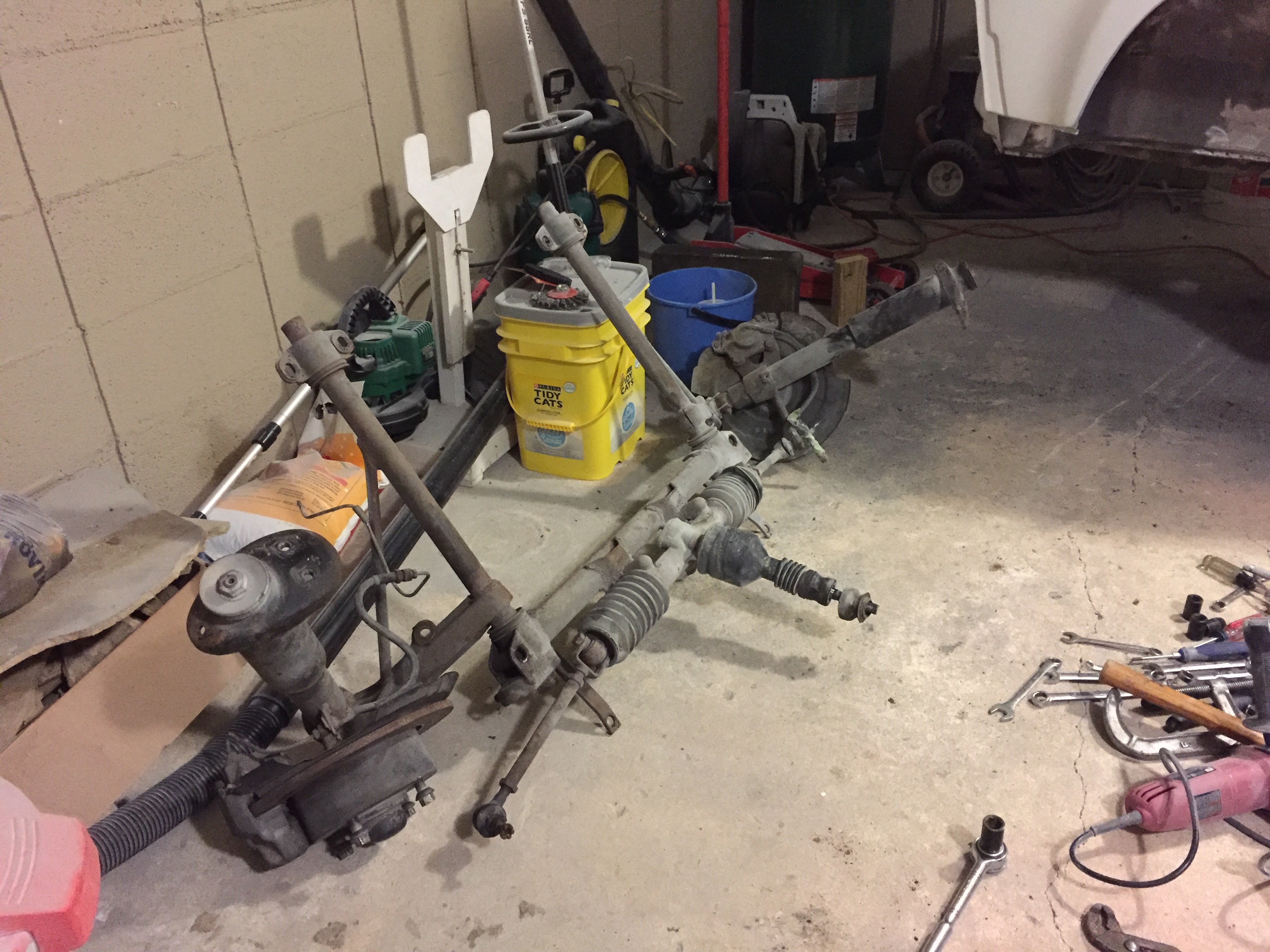

Now that I have an enclosed garage, I finally relocated the 914 where I can work on it at home.
Progress:
- Removed the front suspension
- Started stripping the bottom searching for shiny metall
Issues and Discoveries:
- Found up to a quarter inch of body filler in the passenger front wheel well. I've removed most of it, and so far haven't found why I was there.
