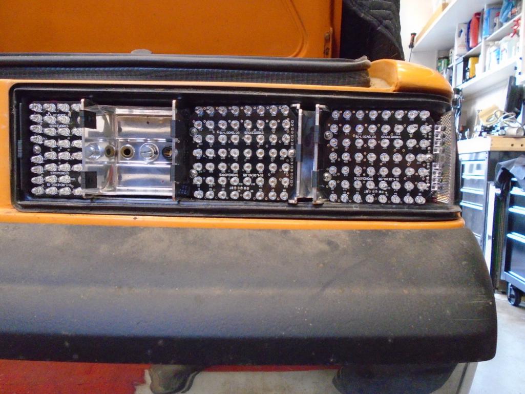

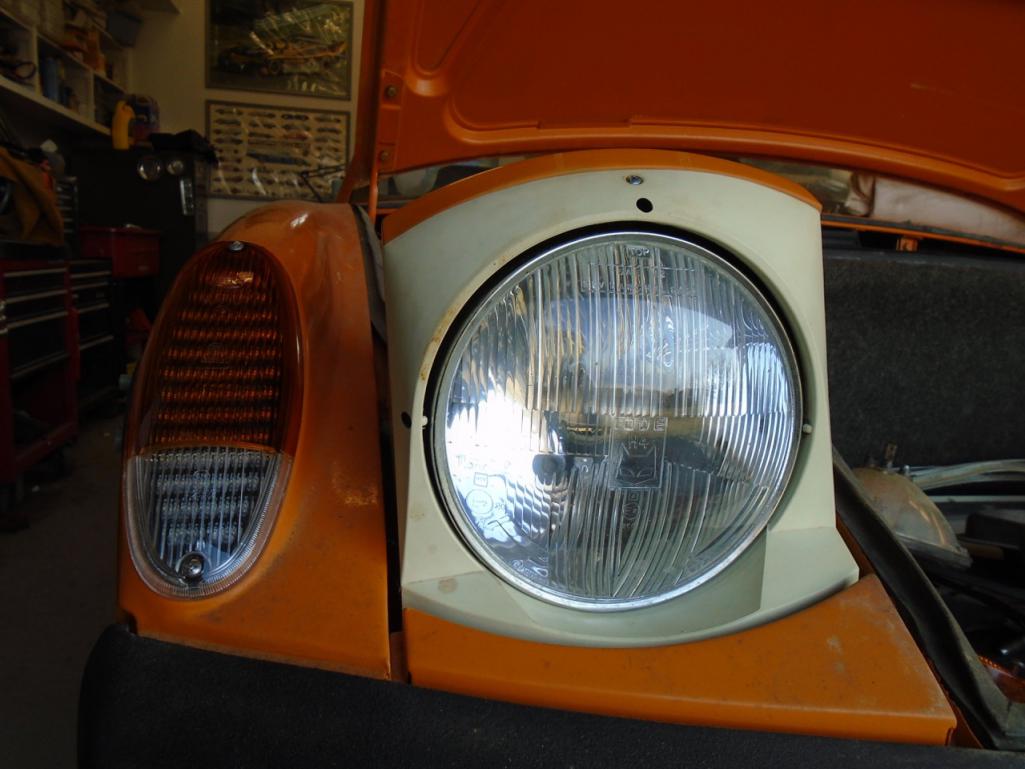

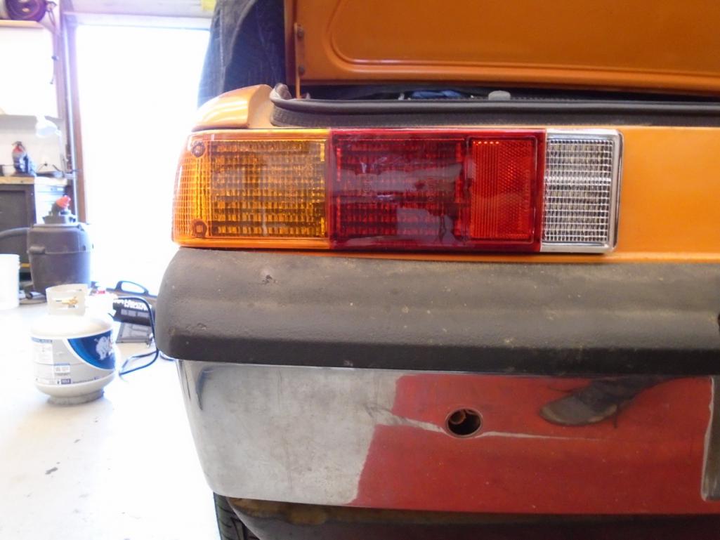

Installed a set of Spoke LEDs, and Cibie Z beams.
I then did the same on the rear, had to replace one of the Hella Rear lenses, thanks to Kelly white1975 I had a very nice unit to replace it with. (IMG:style_emoticons/default/beer.gif)

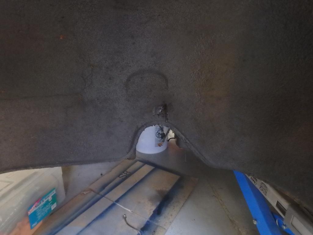

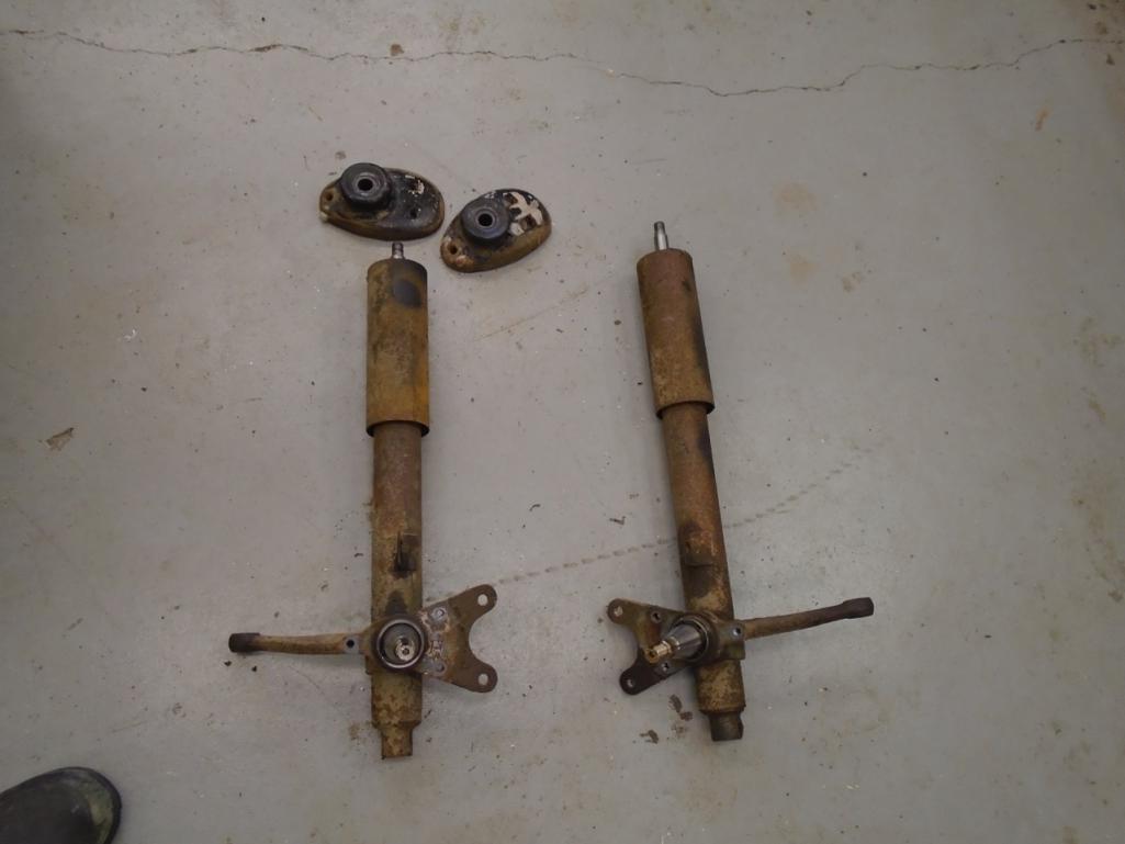

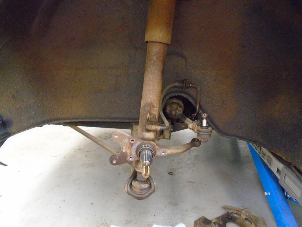

I then started working on the front suspension and have found out what happens to a car that sits around for 40 years. Everything rusts up, and all the fluids turn to a pungent nasty smelling fluid that makes gear oil smell good.

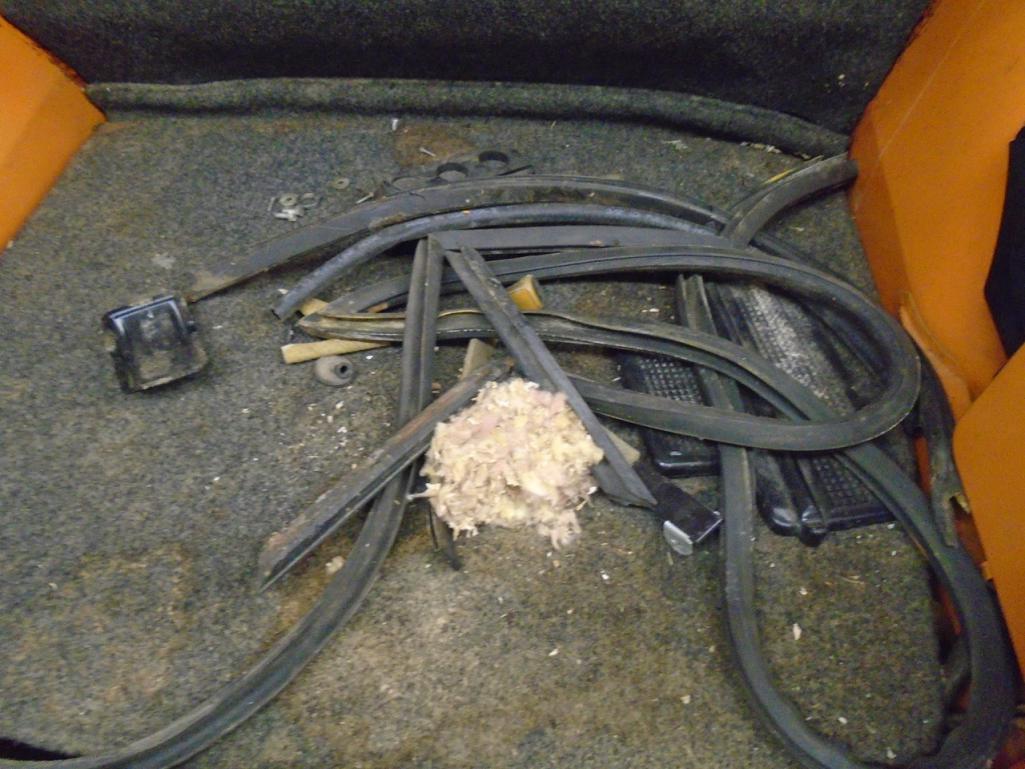

There where two trunk board in the front trunk (IMG:style_emoticons/default/confused24.gif) which made a perfect place to build a mouse condo.

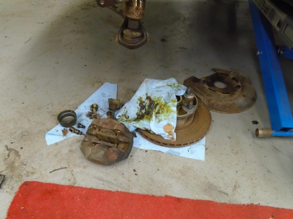

And then I found out why the brakes might not have worked as intended.
Somebody must have pretty strong leg to pull that off.
Looks like Eric is going to get a bunch of brake parts for his crew to rebuild.

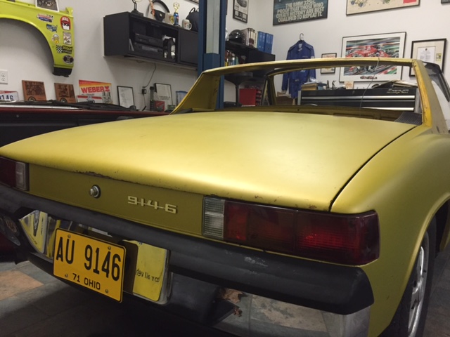

Great story! I too am in Dayton and just finished mechanical restoration of a long dormant -6. Please let me know if there is anything I can help you with. I am more of a vintage BMW guy (in fact, the Lowe's used to instruct for us at the BMW D/Es at mid ohio in the late 80's) but I have learned a lot going through the six.

Gcthielen - Is that a '71 Six in gold metallic? If so, if I can ask, what are the last 4 of the VIN?
Cheers, (IMG:style_emoticons/default/beerchug.gif) Michael
Yes sir! Just a bit before yours...0347!

Wow! Great car! Great Story! (IMG:style_emoticons/default/aktion035.gif)
And a second Great Car added to your thread! Gold is Cool and rare (IMG:style_emoticons/default/beerchug.gif)

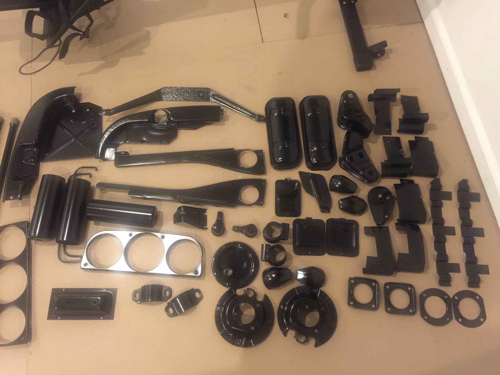

So to get you caught up with my progress.

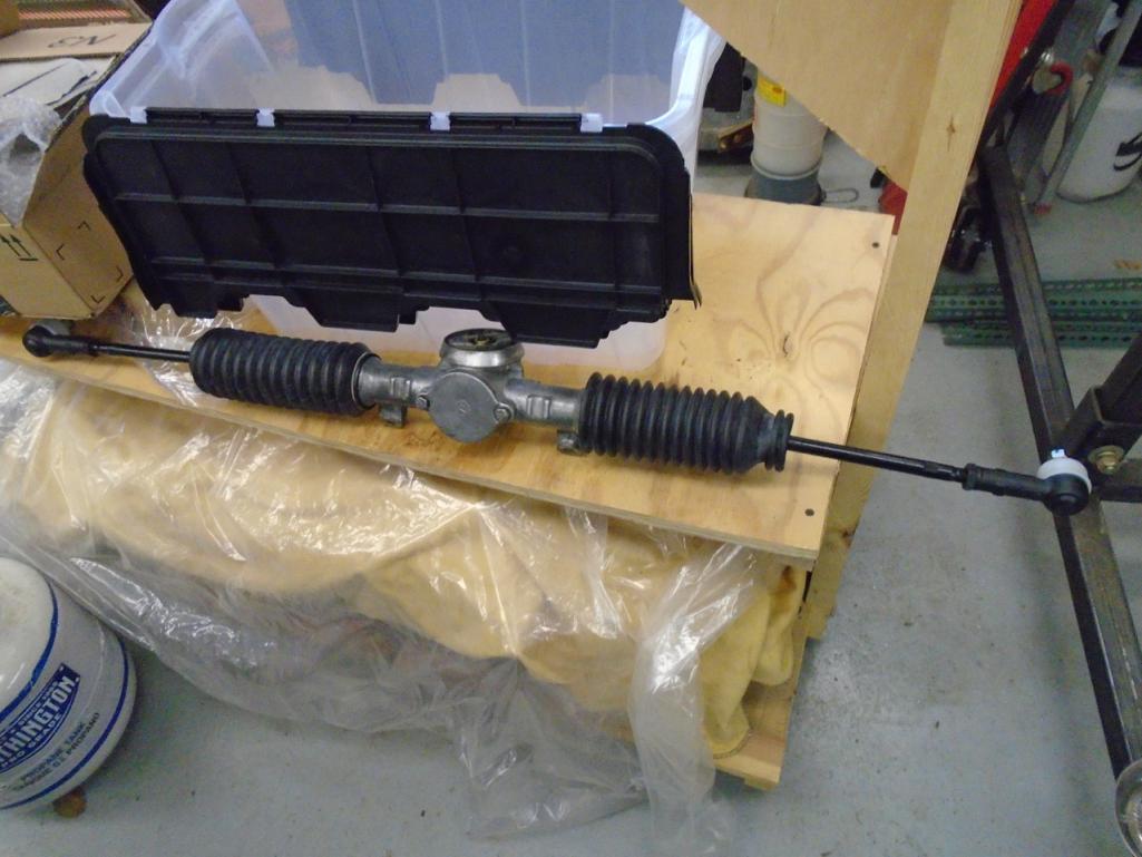

First up, rebuilt the steering rack, all cleaned up repacked, installed new turbo tie rods. All ready to go back into the car.

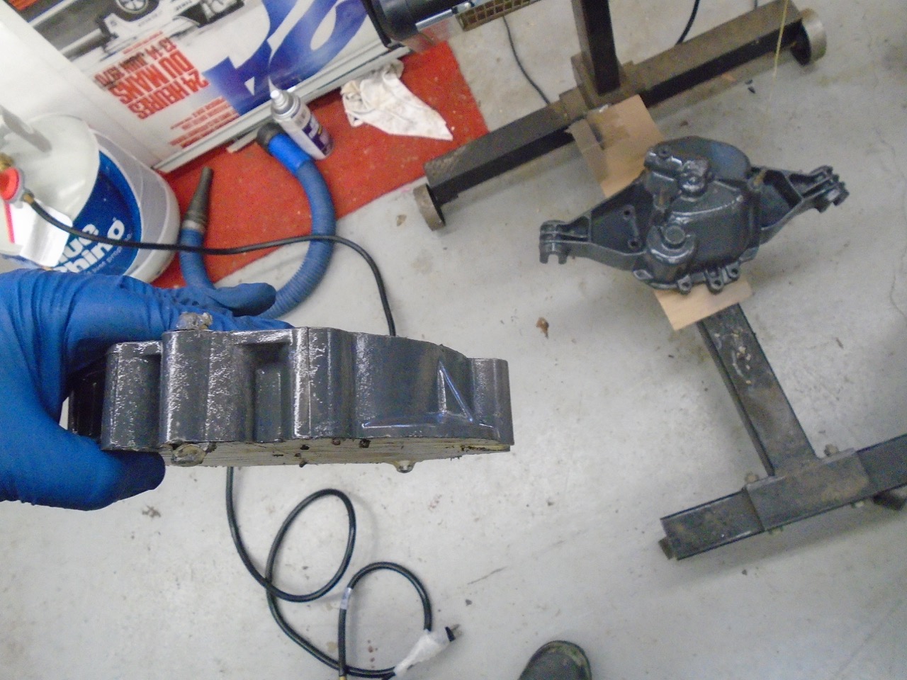

It was warm enough that I got some painting done to finish up the trans detailing Scott did.
Cleaned up the intermediate plate that I got form Carr914 - (IMG:style_emoticons/default/piratenanner.gif) This has the boss I need for the stock throttle linkage, to add to Scott's side shifter.
Next up will be installing new bearings and swapping it into the side shifter. Waiting on the LSD I picked up from sixaddict. I was going to put a ZF into the side shifter, but when a Guard TB came up, I had to jump on it.
Got all the front suspension off, and all the brake stuff off. All 4 calipers I got the bleeders out with out breaking them. (IMG:style_emoticons/default/piratenanner.gif) That just saved me a charge from Eric for EDM series, @ $80 a pop, it adds up.

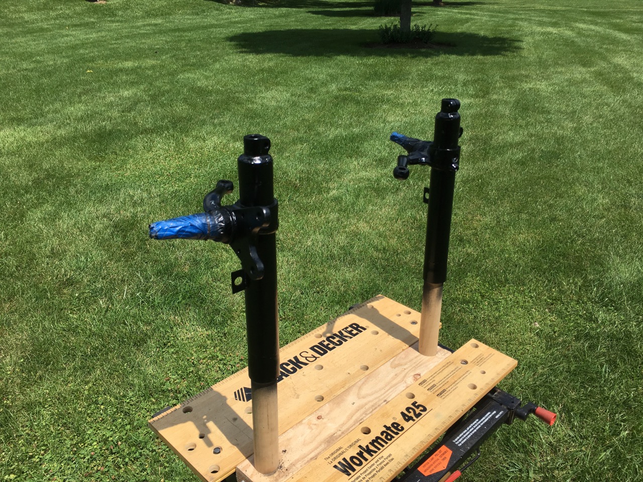

I also packed up the struts to send to Chris, for a minor spindle raise.

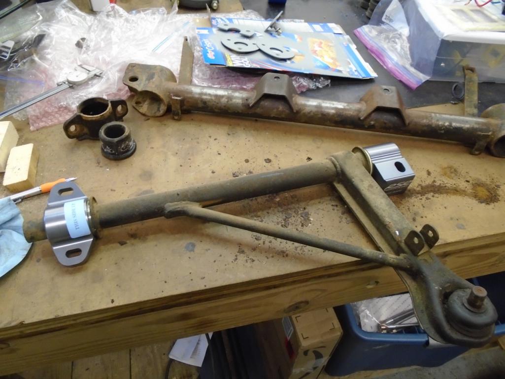

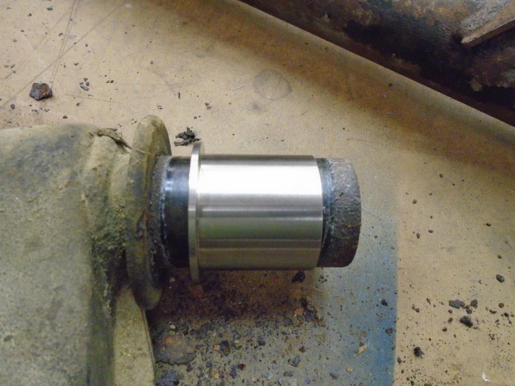

Got the bushings off the A-arms, my 20 ton press, and a bearing race puller made short work of this.
I then test cited the Rebel Racing front bushings.
The fit fine, now the question comes down to this sleeve. Are you supposed to JB Weld it to the arm, or Locktite? It is fairly tight, but turns freely.
I now have to get these cleaned up, and painted or powder coated, still trying to decide that one. Mind says powder coat, pocket book says paint.

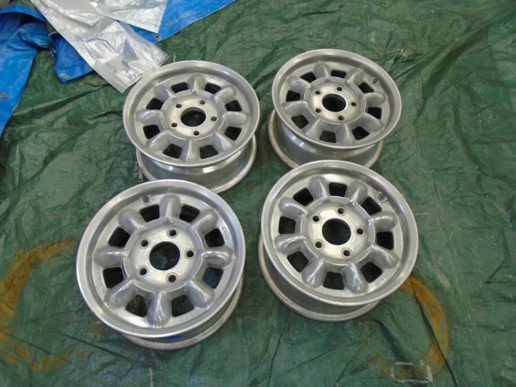

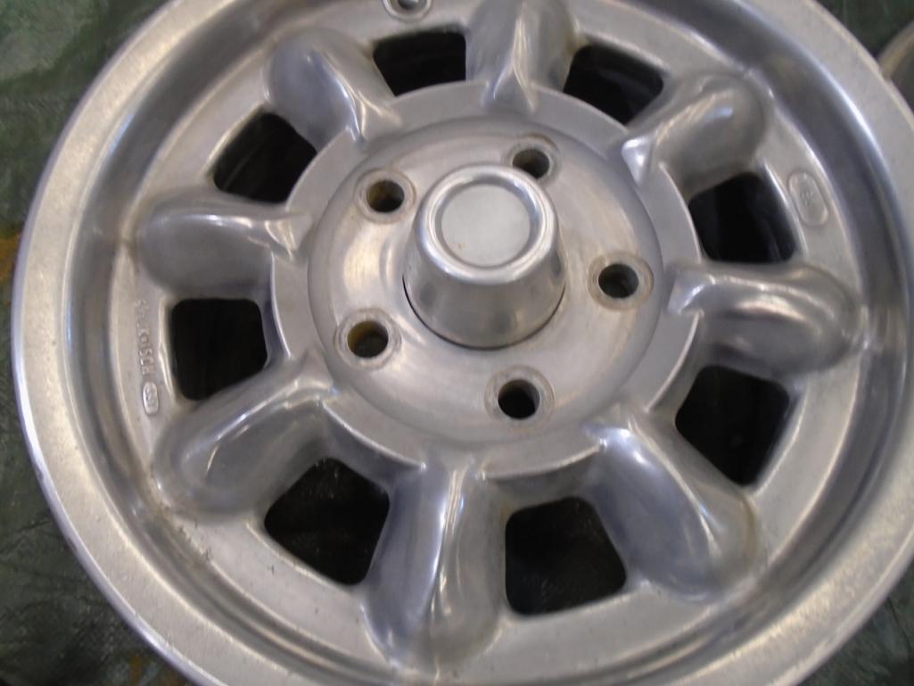

Oh and I got these in on Friday.
Never had a set with center caps, not sure if I like them. (IMG:style_emoticons/default/dry.gif)

I heard that paint my be preferable for the suspension arms as they can then be touched up. The powdercoating does get chipped I've been told. Either way, nice project and I love the Minilites.

Shop around on the powdercoating. Shops can really vary with pricing. Powdercoating can save so much time vs diy and when it's done right, it's super hard to scratch or chip.
I got all these parts including the 914-6 oil tank done for $275.

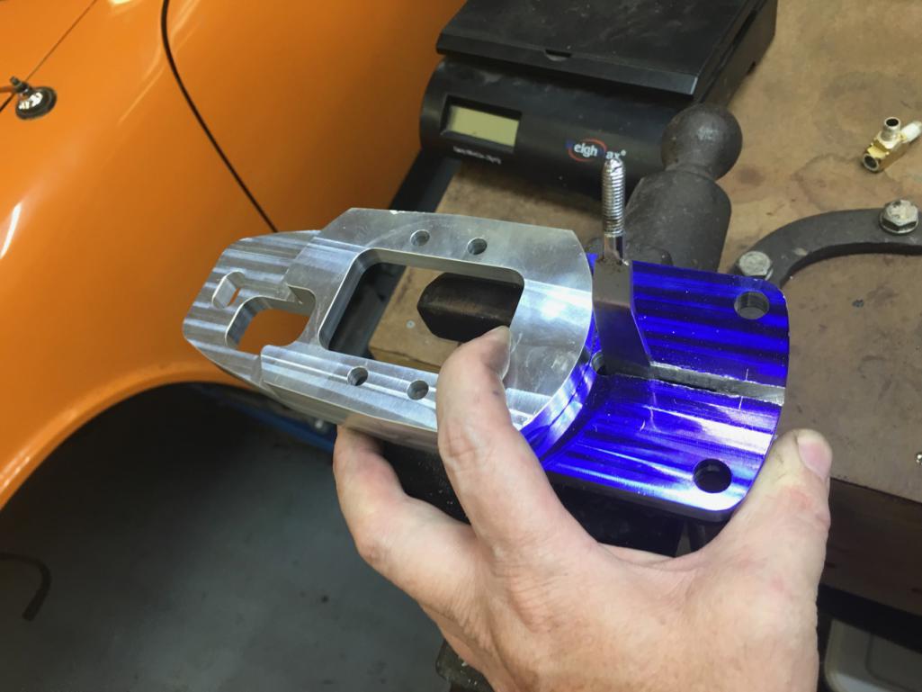

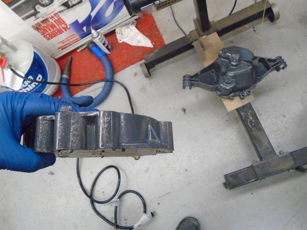

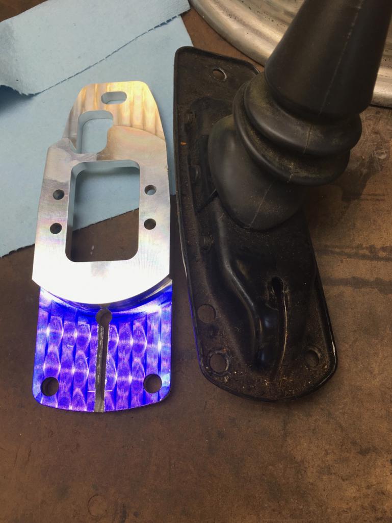

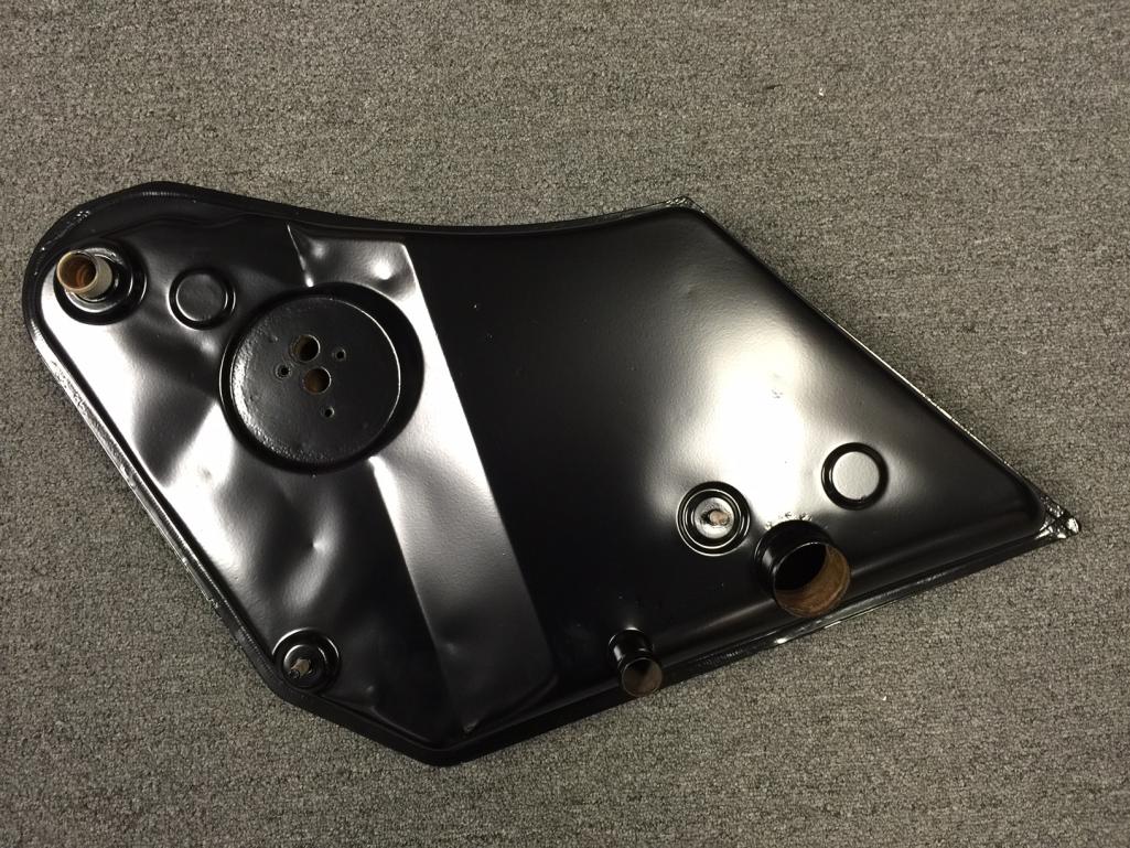

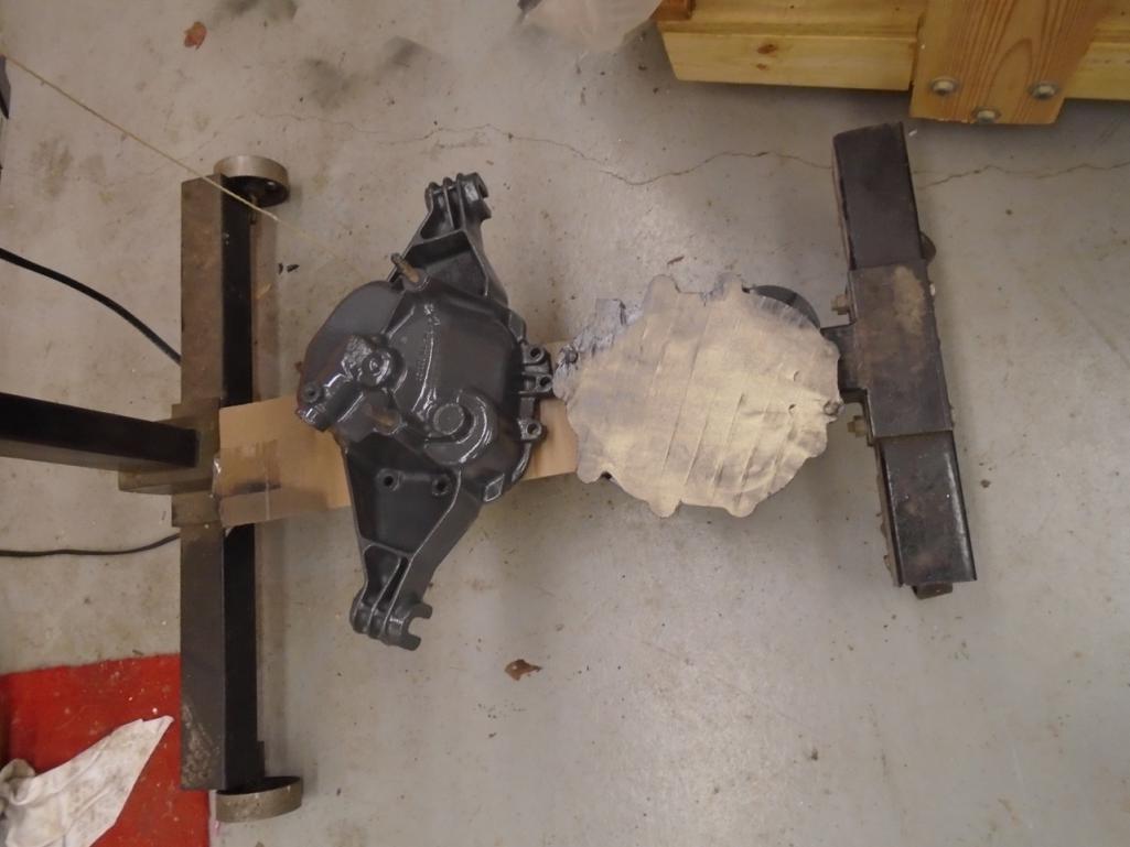

I am changing the trans out for a side shifter, TB LSD, 904 mainsheet, custom gearing, and Tangerine Racing shifter parts, and a Rennshifter. The one issue with the Rennshifter in the 914-6 is it does not have provision for a hand throttle. I thought about using one of Chris' hand throttles but in the end I have a mill so lets make some chips.
First Off I marked it all out with layout dye. Make it so easy to see with my old eyes.
And almost all done, don't have more time tonight to work on it.
Baby steps makes progress.

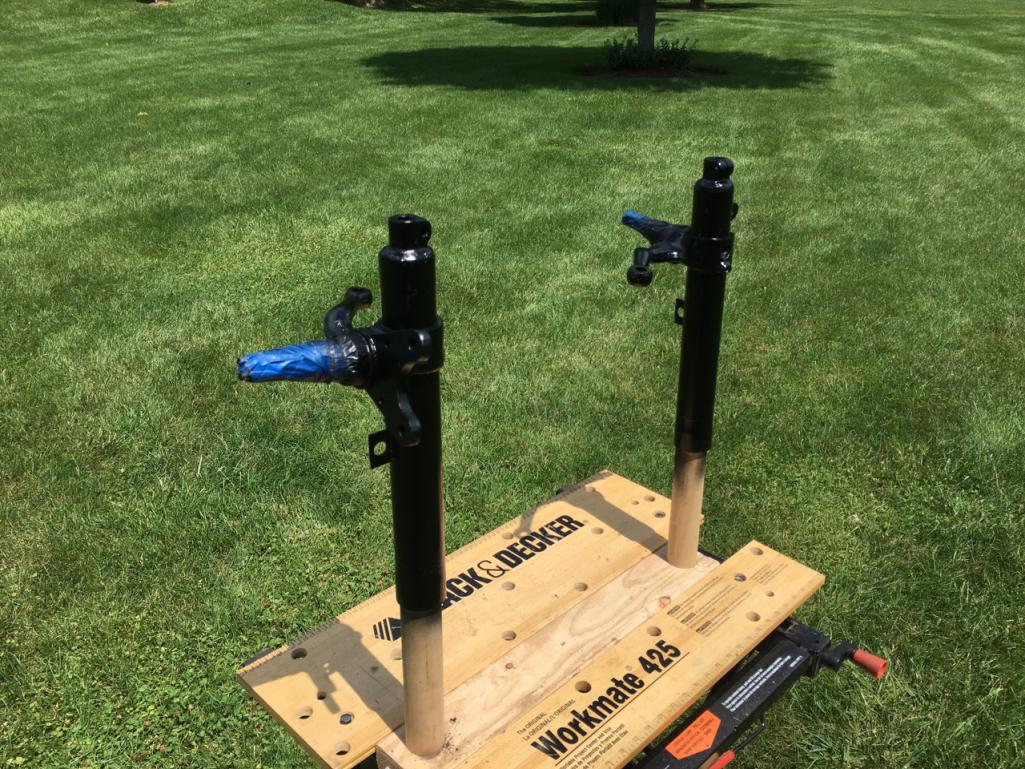

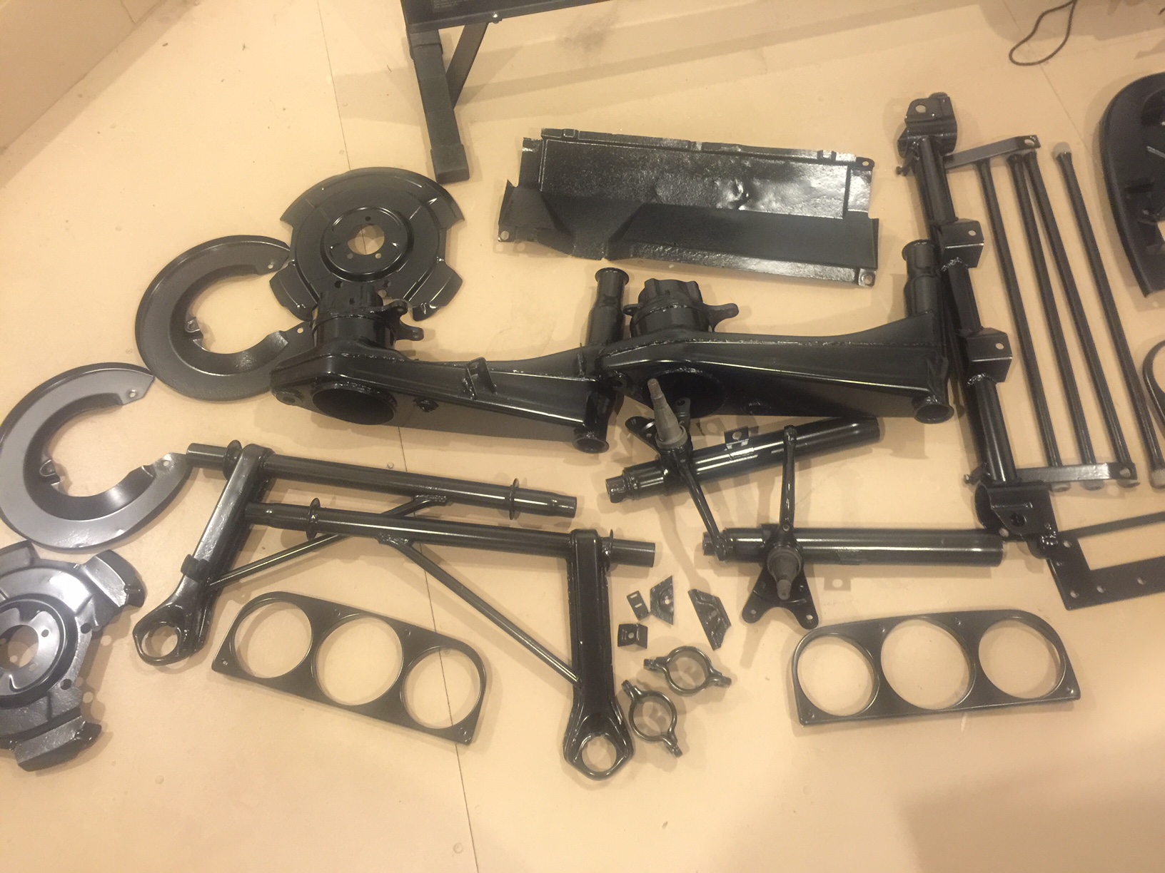

Well I have been called out as a slacker thread so here you go the update of what I got done on the -6

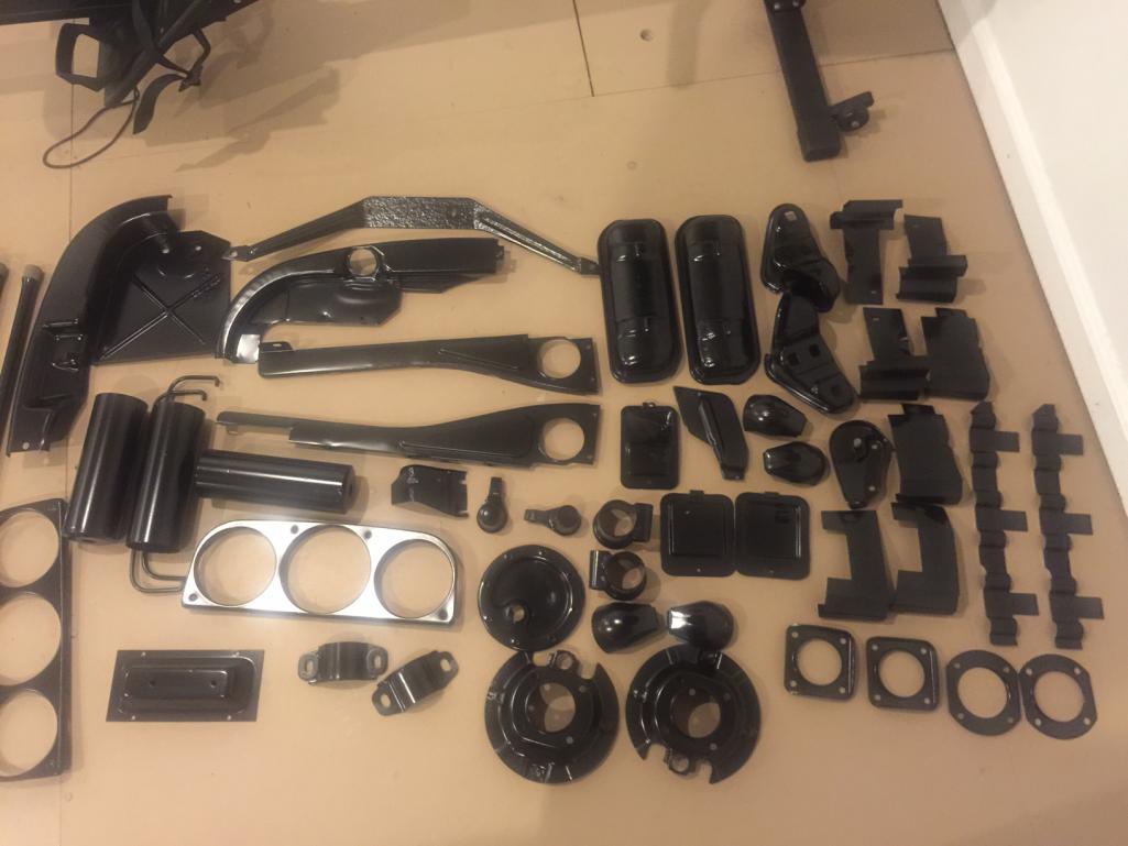

Painted just as dad would have done it. Spindles raised just as I like to do it.
Thats it, been working on a ton of other stuff, just not 914 related.

I like that shifter base. I need to place a slot in my JWest
plate as well for the hand throttle.
Staying tuned...

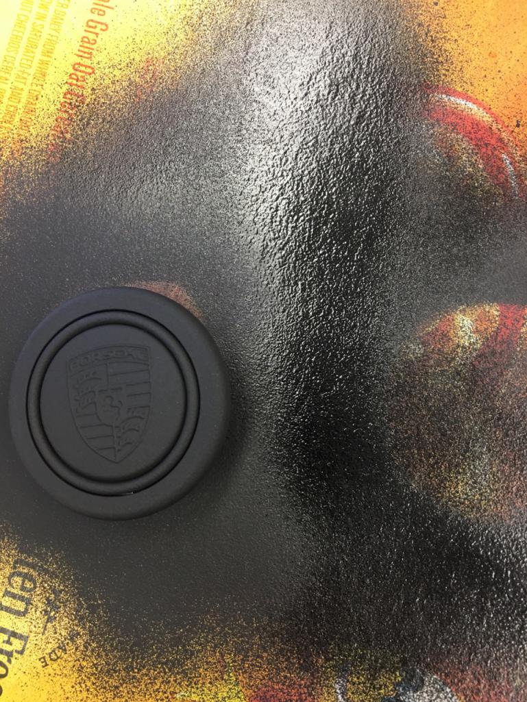

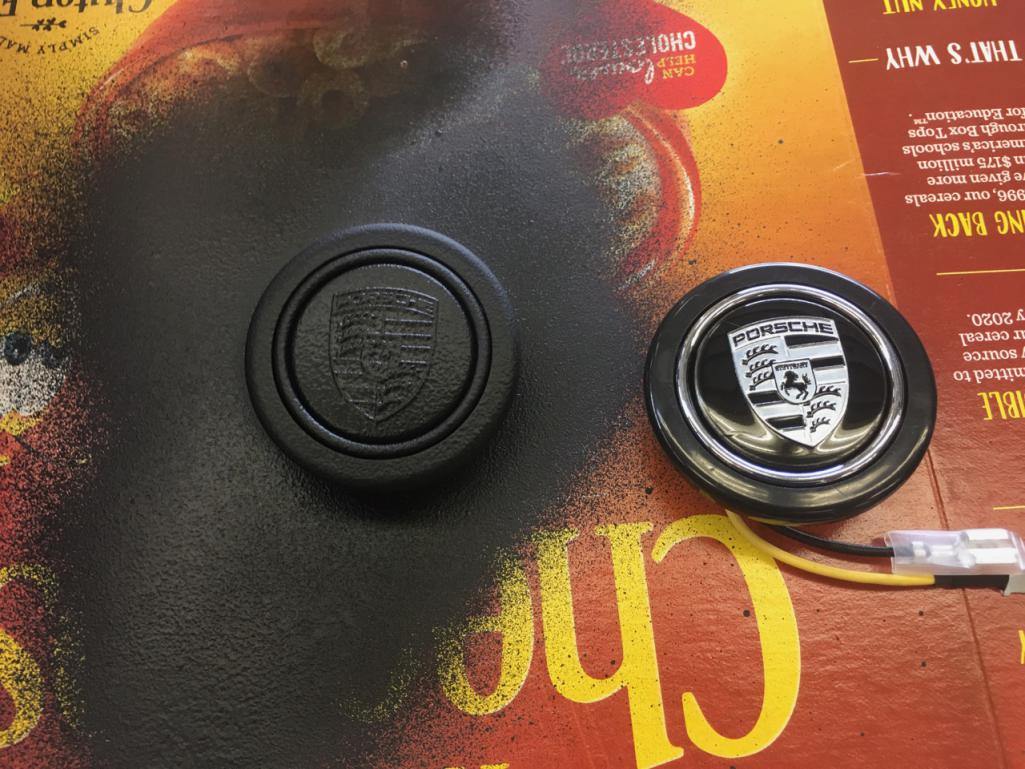

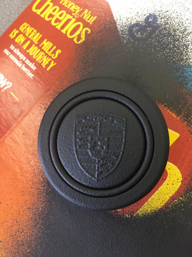

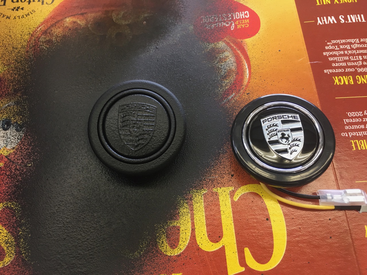

Well in the quest to get this done, I am working on incremental progress. In other word, if I have a few minutes, I'll do a little work.
So on todays agenda, I got these off Ebay, and really don't like shinny plastic, so out comes the textured paint.
Both done with the base coat.
I used this
Now weather I should clear it
The cleared section is on the right of the horn button.

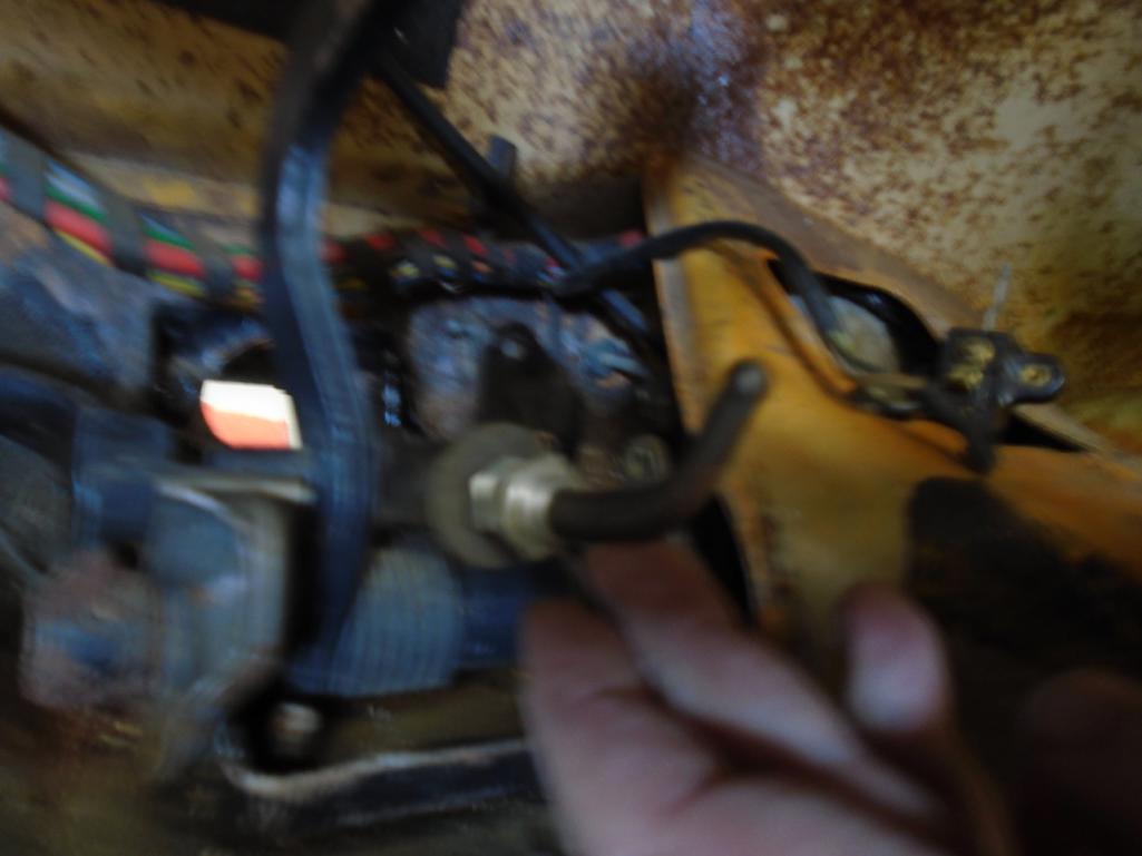

A bit of progress today as I finally got the front brake lines to bust loose. I bit of (IMG:style_emoticons/default/smash.gif) and lots of ATF mixed with Acetone, finally got them off both sides of the front.
That means I can start working on the front swaybar install now.

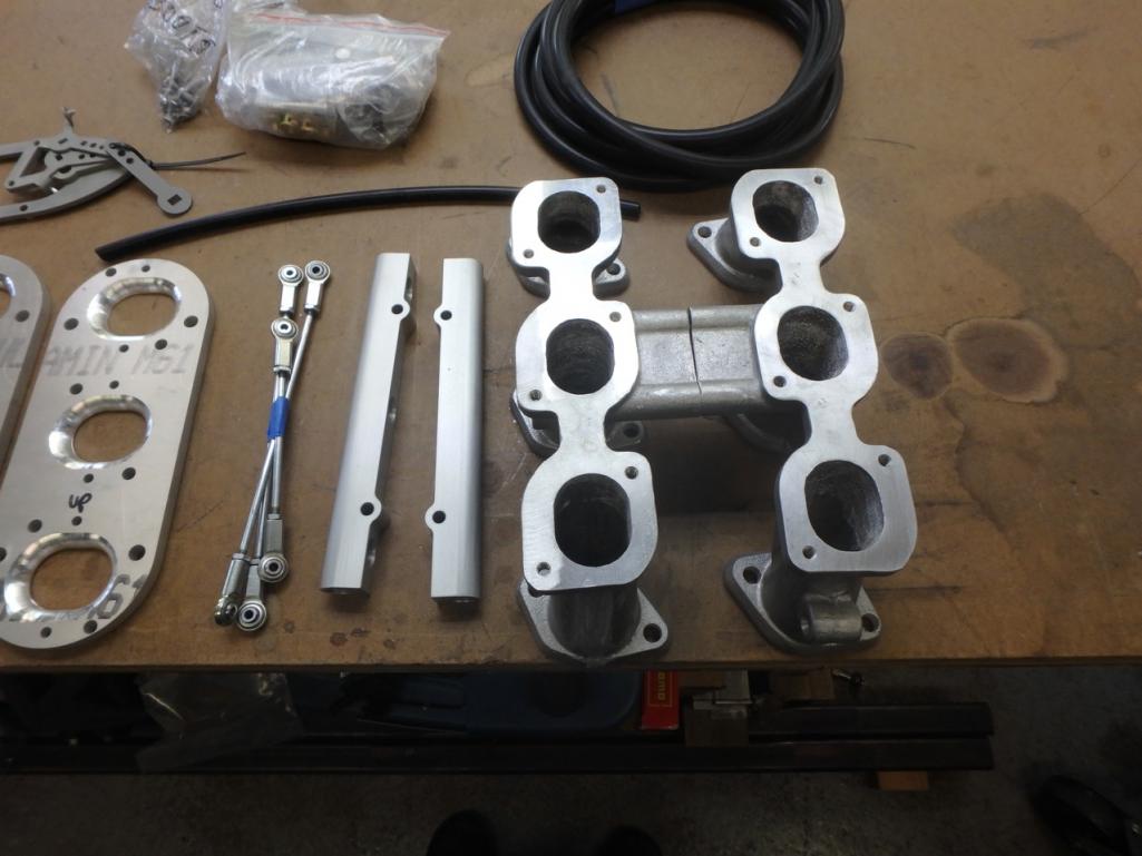

I have also decided that a none running 914-6 is a not fun 914-6. So I got a few parts in today, and will be picking up something to help move this along from Mark this week.

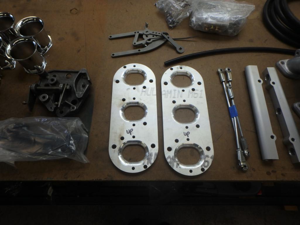

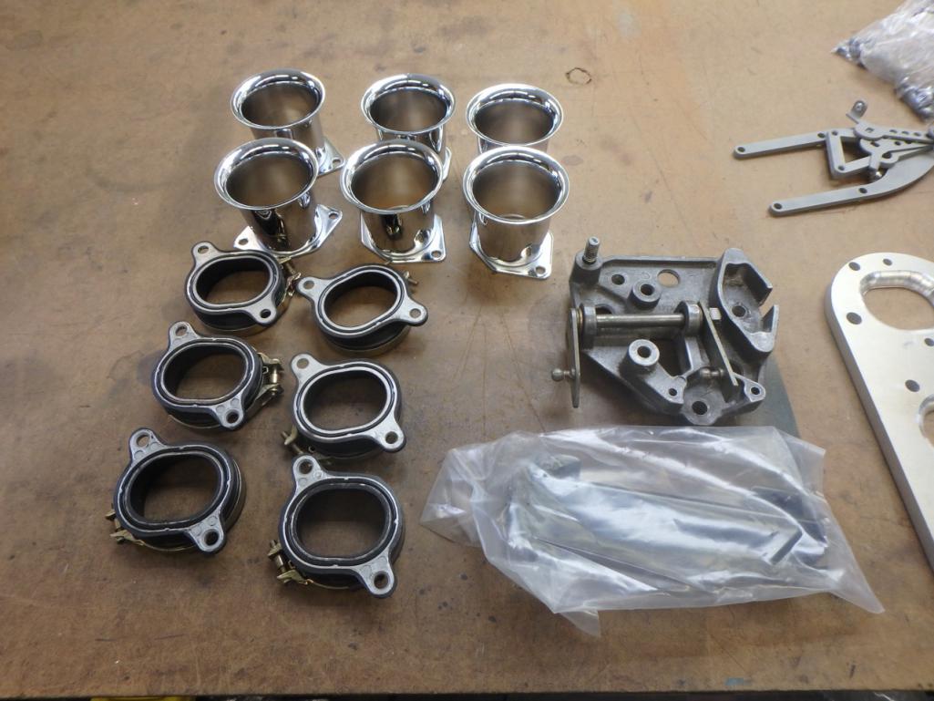

This might help you identify what I am about to do.
And these should help you a lot. Cats is out of the bag (IMG:style_emoticons/default/shades.gif)
Manifold and other parts to bust on a set of Triple Speeds to a 911 engine. EFI and modern spark in a 914-6. I really hate carbs and was going to stick with them, but now the stock carbs, will stick with the original engine and trans.
No reason to screw up original parts when you can add a bit more go while in the end spending less or the same dough (IMG:style_emoticons/default/happy11.gif)
That is it for the updates, hopefully I will get to getting the front swaybar installed and some other bits done tomorrow in-between painting another project.

Very interesting.. I am considering something like this.. I want to use a stock airfilter assembly and would go with fuel injection in trade of my webers if I could..

That looks like a nice piece of kit! My dad and I keep looking at if for his 911. Very jealous! Are you planning on using the AEM Infinity ecu a bunch of people on pelican have used with that setup?

Ben,
My stock Air filter as the I got a bit of fuel spray and got a bit to hot syndrome. So I picked up a metal housing off a 911, will have to do a bit of work on it to clean it up, I would love to use it thou, as it keeps a nice sleeper look.
If not I will go with filters and run 906ish Rain Shields , with a bit of a twist, I would like to have cones on the bottom side over the velocity stacks to divert the air pulses instead of blasting it back down the intake. I would have to have a huge runner to make intake pulse running work at the desired RPM. As this will be mainly a street car, I will say the RPMs will be limited except when I need to hear the Revs. Most likely every time I leave in 1st. Im getting older and lets face it, reaction times slow down.
Jim,
As far as fuel injection controller, it will be SDS, as I have one here sitting in the bin ready to go onto something. It might as well be this six. Which means the EG33 swap car will go with MS3 Pro. I will be able to rev it up on the start line, engine pumping and thumping in time. And use that launch control like the EVO and WRX guys do. Oh and any time I can work part of a Cake lyric into a post (IMG:style_emoticons/default/aktion035.gif)
