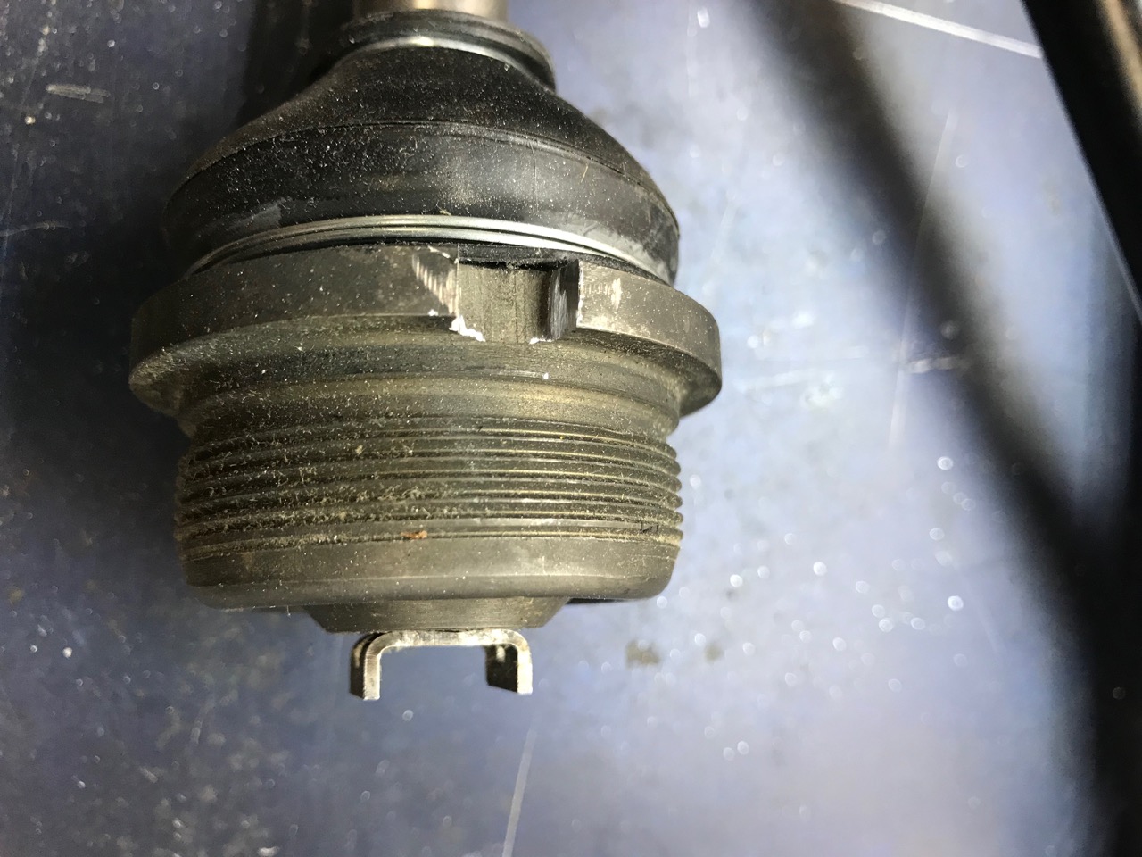

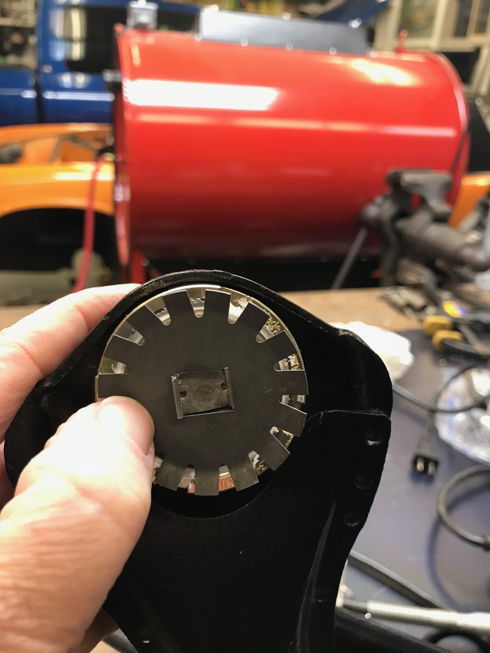

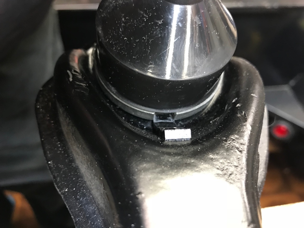

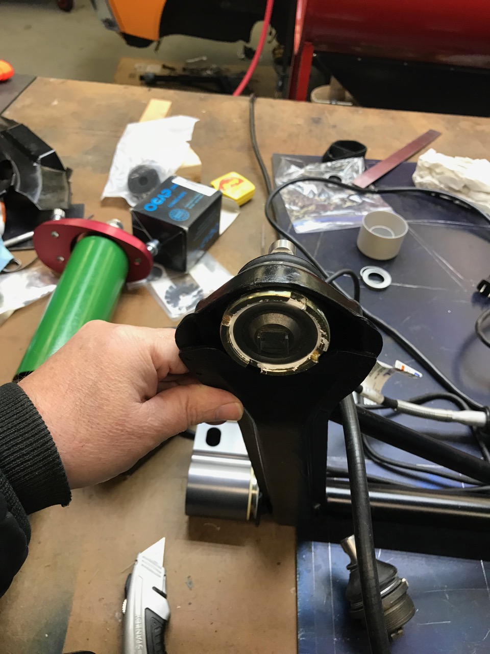

Tonight in this episode of parts that don't fit. (IMG:style_emoticons/default/confused24.gif)
You'll see a manufacturer that says they have ISO 9001 rating. (IMG:style_emoticons/default/confused24.gif)
You'll see a man void all waranties (IMG:style_emoticons/default/poke.gif)
And I invent some new words (IMG:style_emoticons/default/hissyfit.gif)
I could never get the ball joints in the arm to seat properly. Or at least to my likely. So out came the calipers.
So the opening of the ball joint needed to be opened up just a tad.
A diamond wheel and a bit of grinding latter with the Dremel and Ta Da!
Much Better (IMG:style_emoticons/default/w00t.gif)
Little ceramic anti-seize and more brand new parts. And this side is together.
(IMG:style_emoticons/default/WTF.gif)
The retainer clip that keeps the ball joint nut from backing off, does not fir the tabs on the ball joint. (IMG:style_emoticons/default/headbang.gif)
So which part to modify this time. The retainer or the ball joint. I'm pissed at the ball joint manufacturer so why not. And the both of the retainers fit the other ball joint. Crappy quality control. (IMG:style_emoticons/default/ar15.gif)
Took the big slip joint pliers and modified the retainer tabs. And one side all done.
Well, the other side I had to modify the tab area of the ball joint by the same amount. And rest of the assembly went much smoother. (IMG:style_emoticons/default/w00t.gif)
Called it a night.
