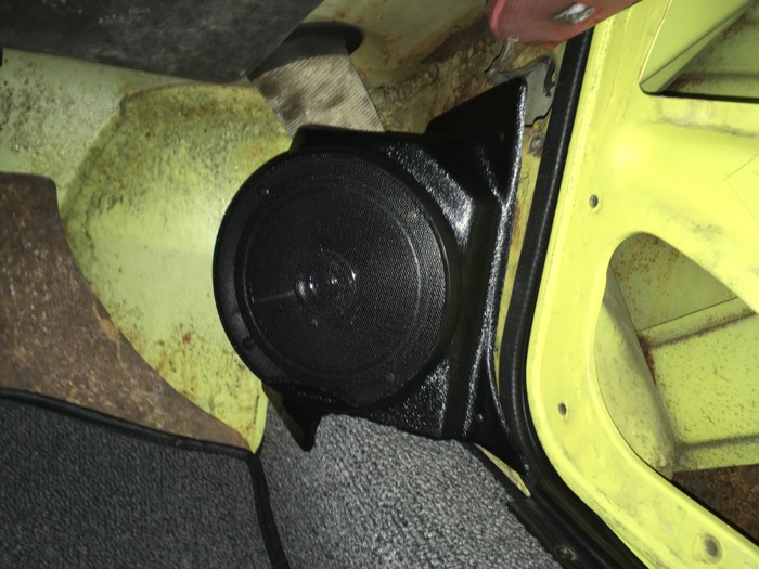

Picking away at tasks this weekend, as I try to stay cool and out of the smoke. Door seals (inner and outer), floor vinyl, starting with carpet, new speakers in the new speaker pods, and taking a stab at fixing the slipping grip on the steering wheel. All good so far, although the verdict on the steering wheel won't be in until tomorrow.
Not much to show in pictures yet, just the speakers.

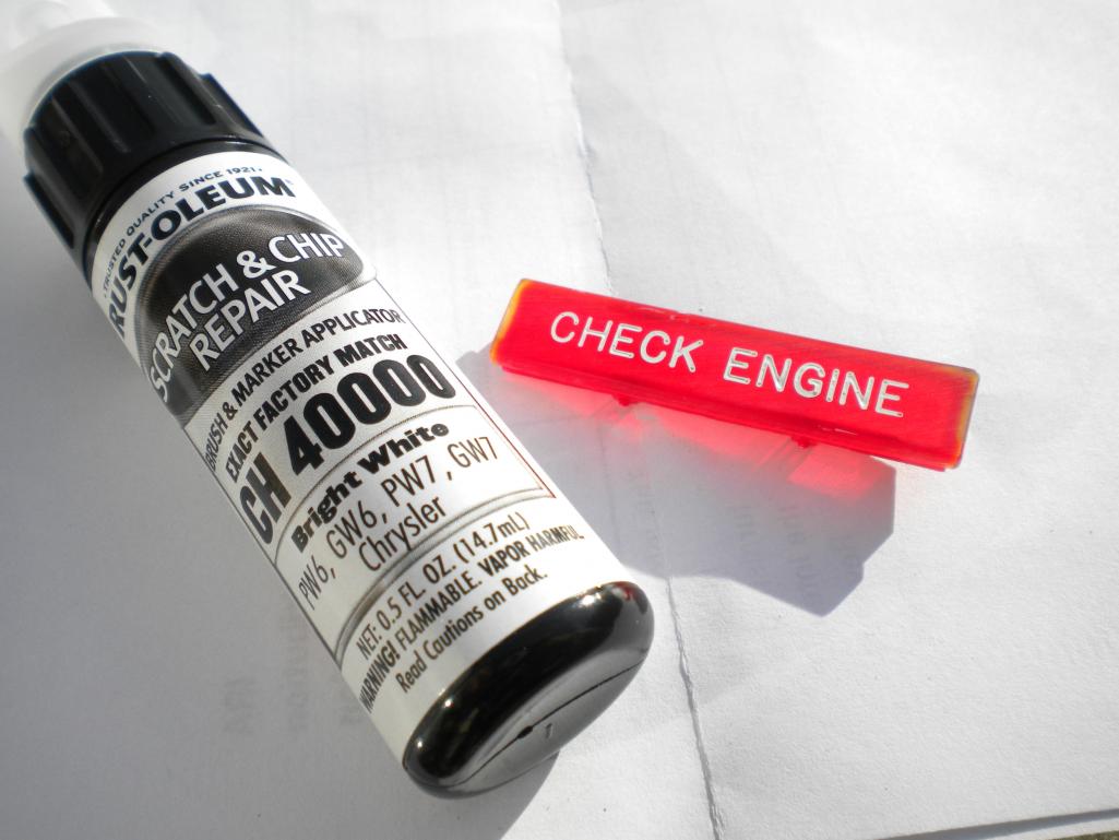

Seatbelt light delete. I dig. Always felt it was a bit VW 412.
QUOTE(cuddyk @ Sep 2 2017, 09:58 PM) *
did that on my 73. looks great!
Yup. I looked at that when I took it out and thought, "Now why would I want to put that back in?"
Send it to me. I want to make an "ejection seat" light! This one no longer functions with the DME.

Let me think on that, Rob. My thought was to leave it in the glovebox in case the next owner might be so silly as to want it.

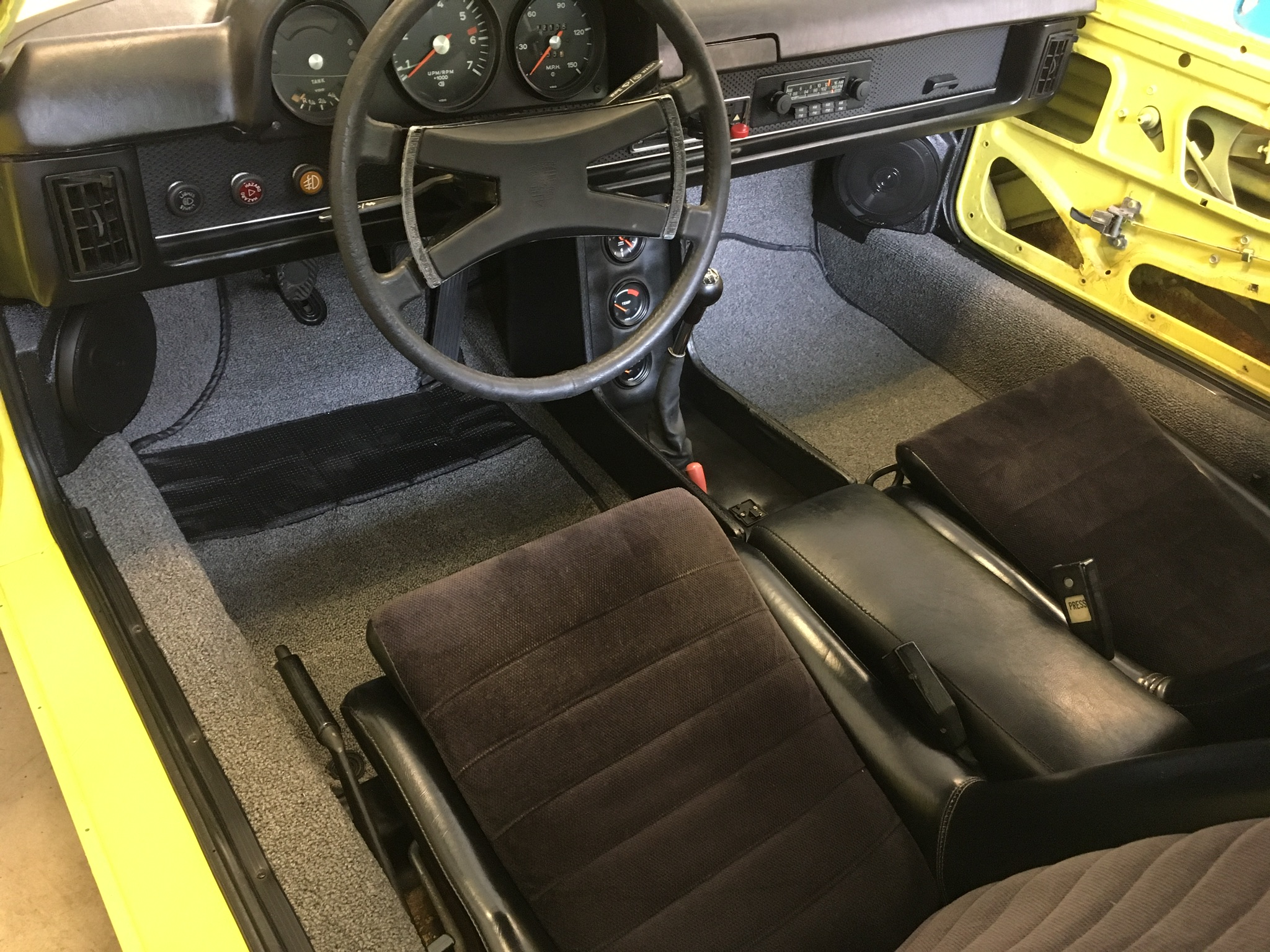

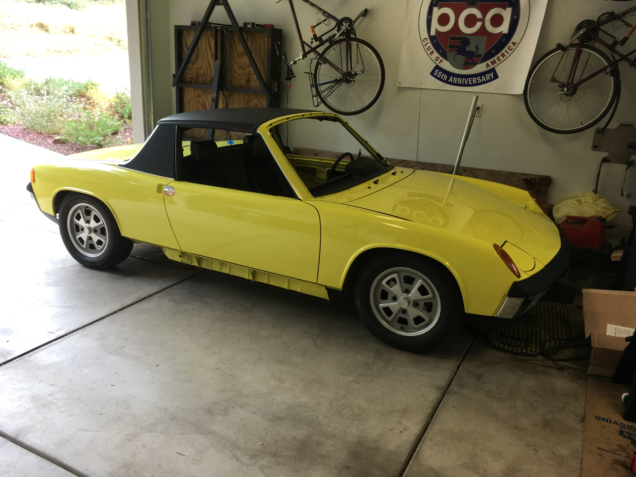

I have an appointment tomorrow for the new windshield. So I've been making sure that it's ready to drive, and that everything works. Put some gas in it yesterday. Here in Oregon, we still have gas pump jockeys (no self serve to speak of), and the car has not failed to baffle the young kids manning the pumps. Yesterday one asked me if it was a kit car I was building. (IMG:style_emoticons/default/confused24.gif)
I've got most of the interior together now. Waiting to put on the inside windshield trim until the glass is in place, of course. And I'm not going to put the backpad in until I figure out what to do about the interior light. (See Using a 911 dome light? )
Still need to get the glass into the doors, and then the door cards, then refinish and install the rocker covers. That should be it, appearance-wise.
Other bits will be getting all the heater ducting reinstalled, installing the billet taco plate, replacing the upper steering shaft bearing in the column, and anything I find wrong in the test driving phase. On track to wrap this up by the middle of October, I figure.

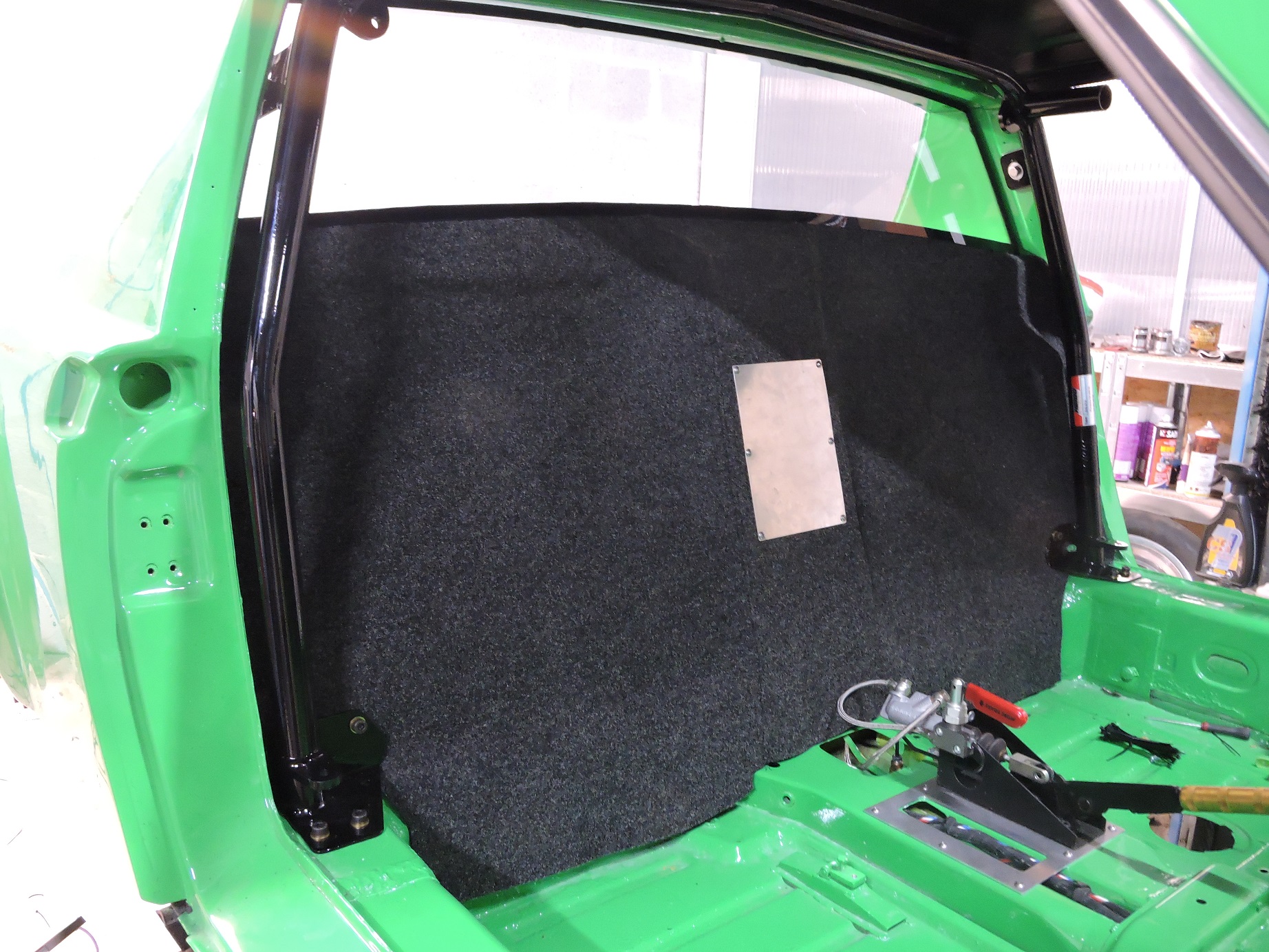

About your back pad, you might consider just doing like this. Borrowed pic from online. several members did this already. Looks clean and space for small items at your rear seat.

A few additional thoughts. The car's ride seems better than when I drove it prior to the paint job, but I think that's just because now that the rear window and other bits are all properly secured, the car doesn't rattle like a death trap over every little road irregularity. The ride is firm, but controlled and not harsh. Very appropriate.
One of the things I may leave for the next owner is tires. Tire choice can be rather personal, and what I might pick for the car may not be pleasing to a potential buyer, either for brand or performance level. I will just need to be upfront about the need for tires and price the car accordingly. I could even facilitate new tires of the buyer's choice if they want them on before delivery.
Speaking of tires, I took a good look at them recently, and that has given me reason to think the car was sitting unused for much longer than I had been led to believe. I was told the car drove into the storage unit under its own power 6-8 years ago.
Maybe. But the tires on the car are nearly new, wear wise. I doubt they have more than a few hundred miles on them. They are H rated Toyos, nice tires, no signs of rot. I figured they were installed shortly before the car went to storage, so 6-8 years ago.
Not so. I finally got around to hunting down one of the date codes on the back side of the tires. Turns out they were built in 1996!
So while the car may have been started and driven a bit now and then before the 6-8 year slumber in the storage unit, I figure it hasn't really been on the road in more like 20 years. So the rescue of the car is more significant than I had thought.

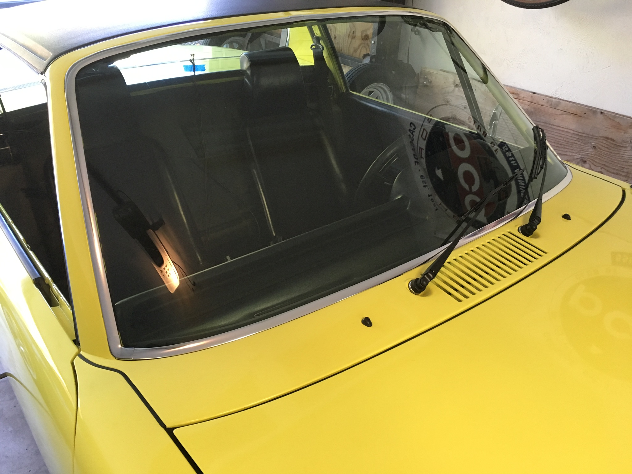

The new windshield was installed yesterday, along with the new trim. Today I got the glass, associated bits, and the door card and hardware installed on the driver's side. Should be able to do the same on the passenger side tomorrow.

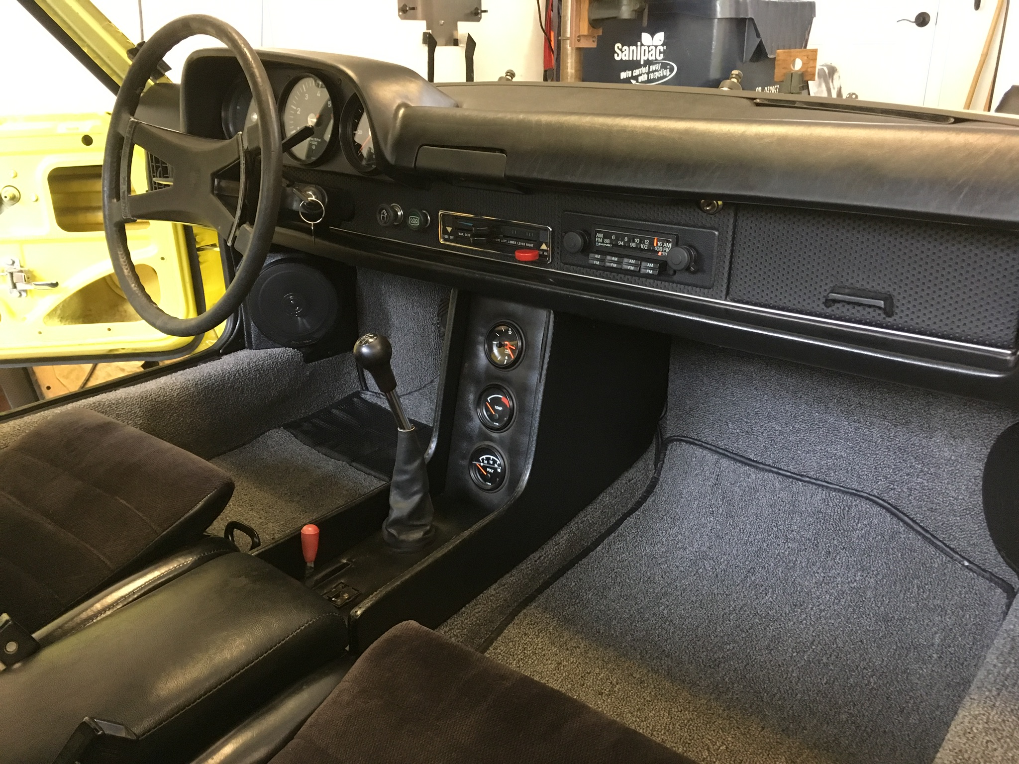

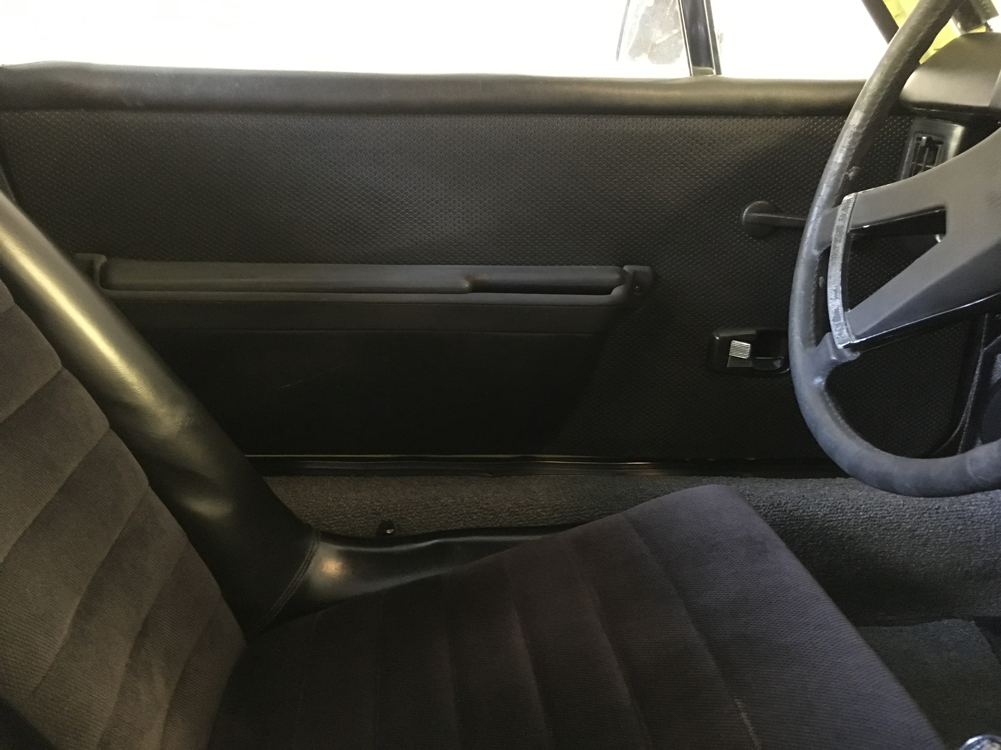

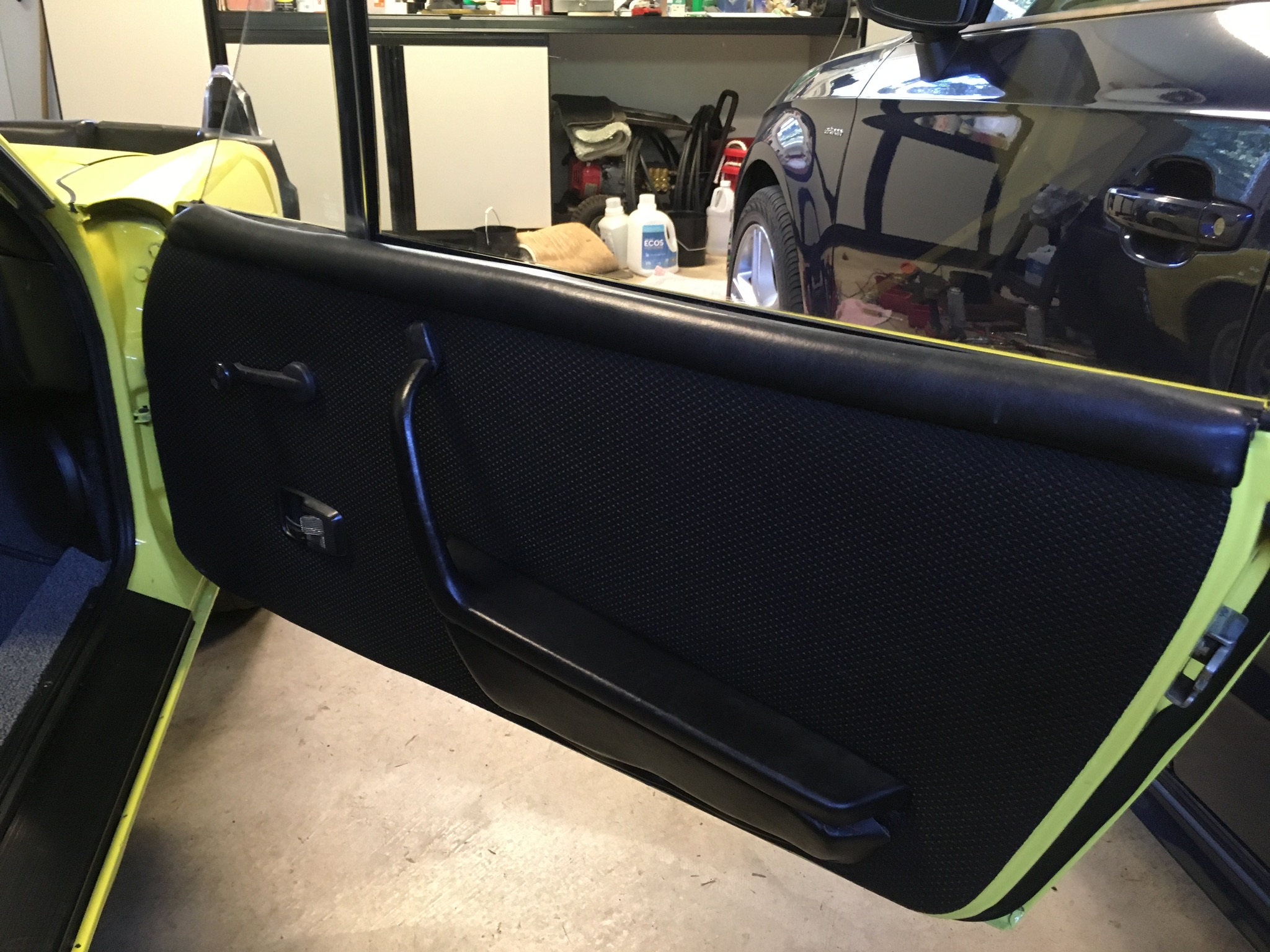

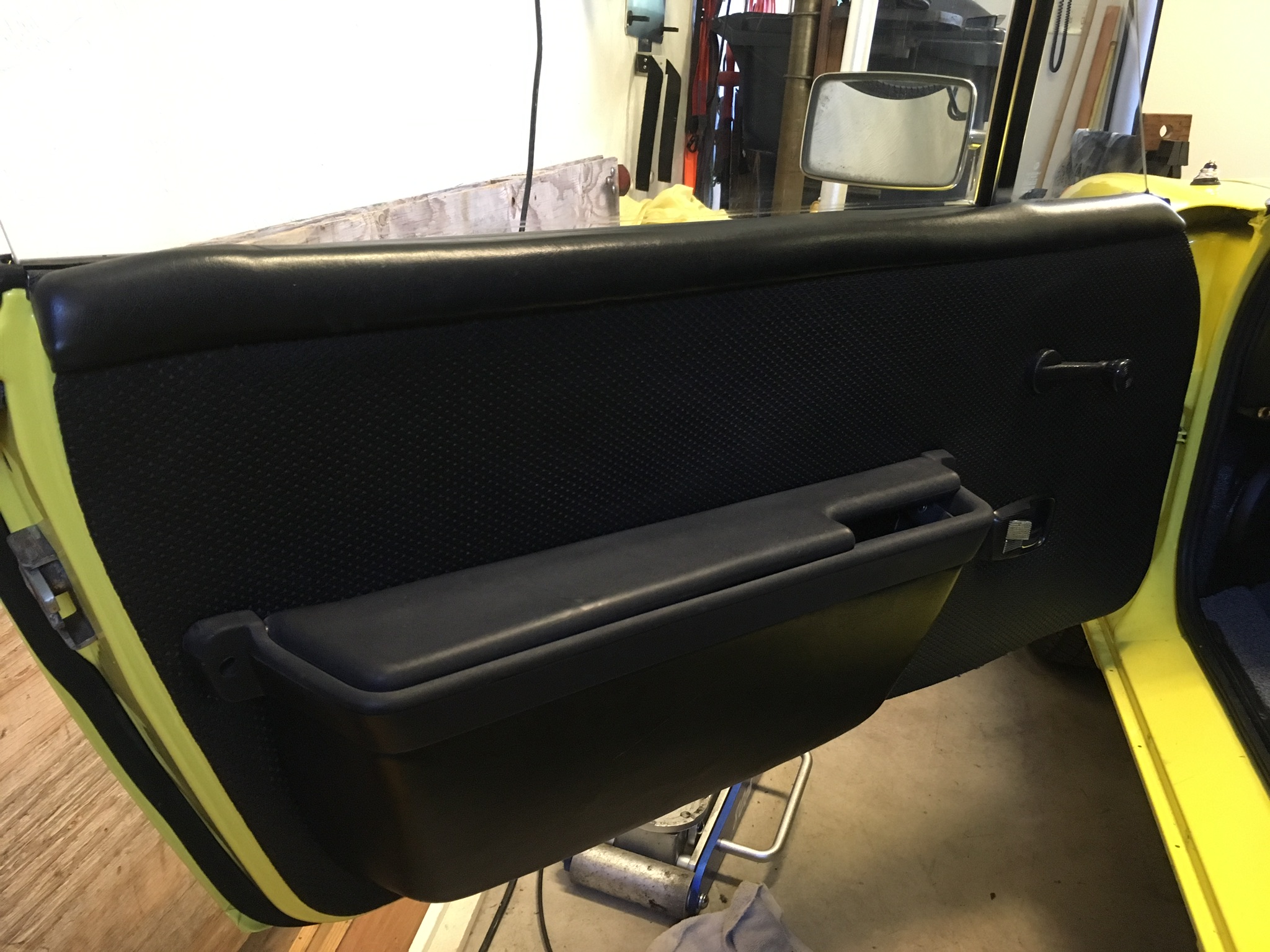

More progress today. The passenger door assembly is complete. Considering that the door cards and armrests/pockets/pulls are original, they came out looking pretty good. Not perfect, but totally in line with my vision for the car. Replace what is needed, but keep as much original as makes sense.

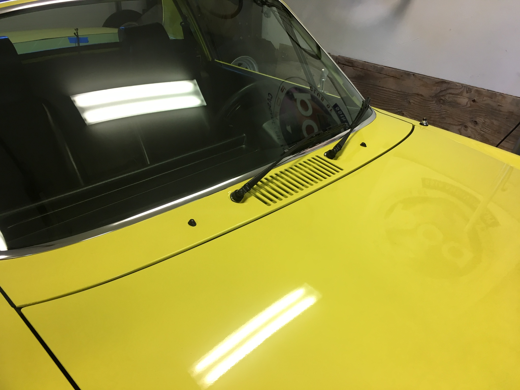

Also, I was talking about the car today with someone who noted that the wipers looked rather high when parked. I re-evaluated how I had them installed, and brought them down some. (If you are reading this, thanks, Andrew.)

Did you take the wiper rack out Arne? If not ignore the following advice.
If so, I'd recommend taking the wiper arms off and making some little pointers on the wiper shafts with masking tape. Turn on the wipers to make sure it's moving the correct direction.
It's possible to put it in wrong and have the wipers move the wrong way and gouge out two big chunks of paint out of your shiney new paint right there on the cowl for all to see. You can guess how I know this

That's a good tip. Perry. I have experienced similar issues on other cars, so I intentionally did not pull the wiper rack this time. And even so, I tested the rotation and proper park position prior to installing the wiper arms. Just to be certain, you know...
Just now finishing up installing the billet taco plate. Really nice part.
This makes the 3rd oil change since I got the car. Fresh oil prior to first start, 2 changes since. I think it should be clean and good to go inside now.

Ran some errands in the car after the oil/taco plate change, mostly to see how the oil temp gauge works with the new sender. (With the original sender the gauge was flakey, if it registered at all.) The gauge seems to work fine now, the readings look sane, and - as expected - not running hot.
Going to start on cleaning up and refinishing the rocker panel covers over the next few days.
