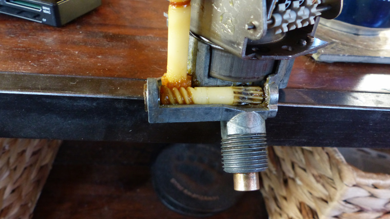

No to catch up. Saturday night I tore down the speedo/odo yet again to fix the slipping pot metal gear for a second time. What a PITA that job is. This time I used a tip I read to center punch the edges of the gear hub when deforms the metal inward to "stake" the gear to the shaft. For extra measure, I put a thin smear of JB weld inside the gear hub to convince it to stay put. While I was there, I got a drop of clock oil on a part of the needle spindle I couldn't reach before.
Put it back together and took it for a test drive. The lazy speedo needle seemed to be fixed and the odo was working properly. That felt like victory. (IMG:style_emoticons/default/piratenanner.gif)

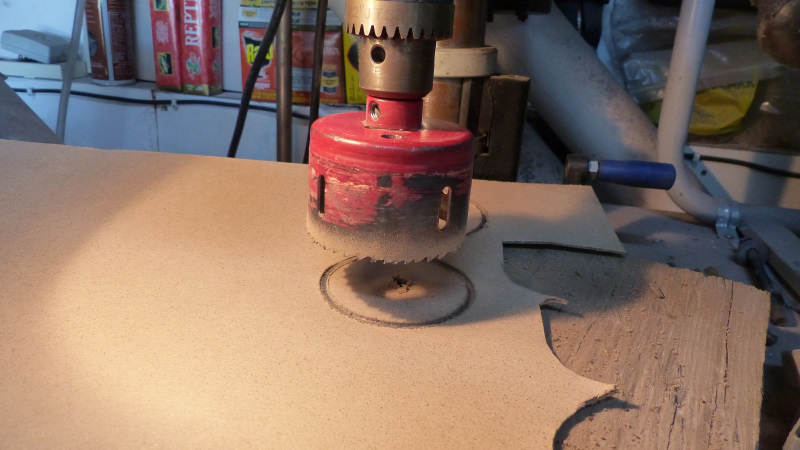

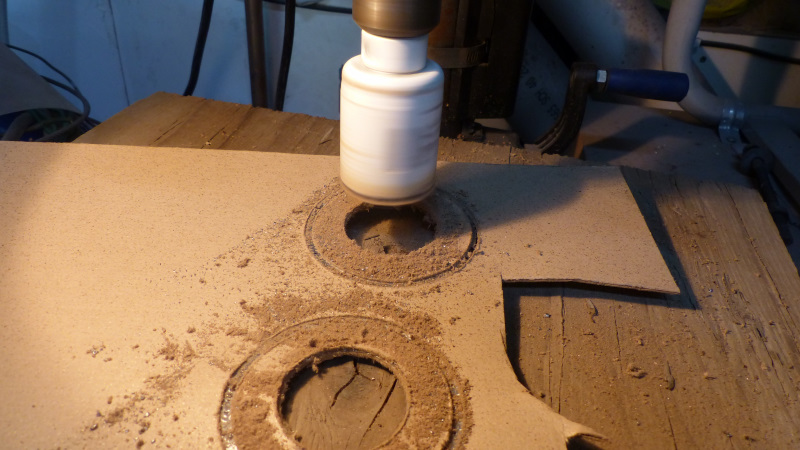

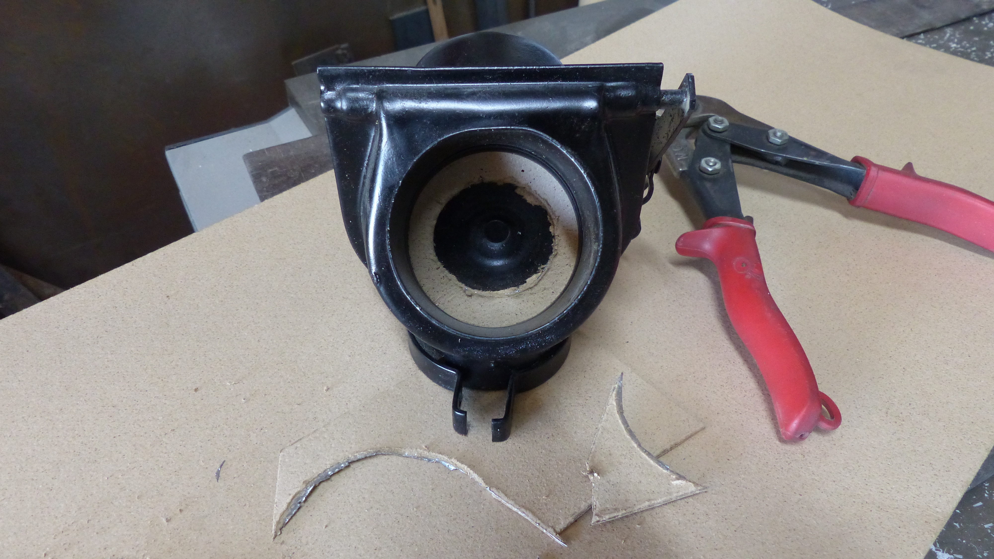

Next I spent an hour setting up to replate the hardware to mount the heater flapper boxes. Got a really nice yellow chromate finish on them and hung them in the sun to harden. Then I turned to one of the flapper boxes that was missing the gaskets on the valves. Yes, I realize they will work fine without those gaskets but... Do you really think I could do that? (IMG:style_emoticons/default/screwy.gif) I bought a sheet of exhaust gasket material and cut new gaskets with a couple hole saws. First one is 3" of OD. The 3" saw I have on hand is not a bimetal saw so it did not want to go through the metal mesh in the gasket material.
Other than dulling the saw, that was probably a good thing because it made it easier and safer to hold the material to cut the ID with a 1-5/8" bimetal saw.
Then I cut the metal mesh with snips and finished the edges on a grinder.

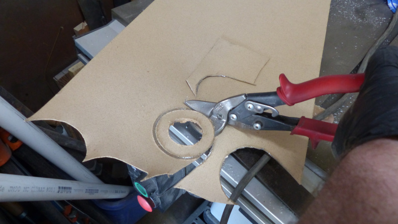

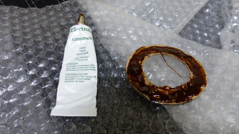

The original gaskets are crimped in to the valve plates. For the replacements, I had some high temp adhesive left over from installing new gaskets in our clothes dryer a few weeks ago.
And there we are. New gaskets.

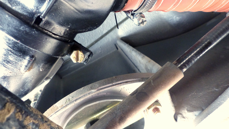

So far the day was going well and we ran into town to run some errands. When we got home, I retrieved the replated hardware that had been hanging to dry and the flapper that was sitting in the sun to help the adhesive cure and brought them into the garage to prepare to install in the car. I assembled a bolt in one barrel nut and the clamping bolt onto the flapper. Then turned to the other barrel nut and found it was missing. (IMG:style_emoticons/default/WTF.gif) I spent two full hours looking for that little f'er in the shitshow of my shop but no luck. Finally gave up and placed another Belmetric order.

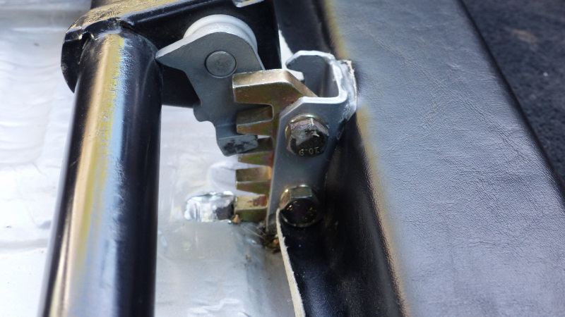

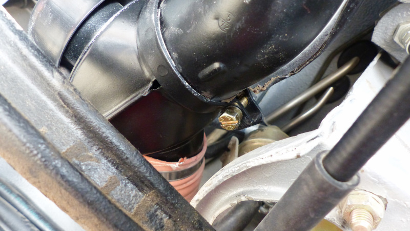

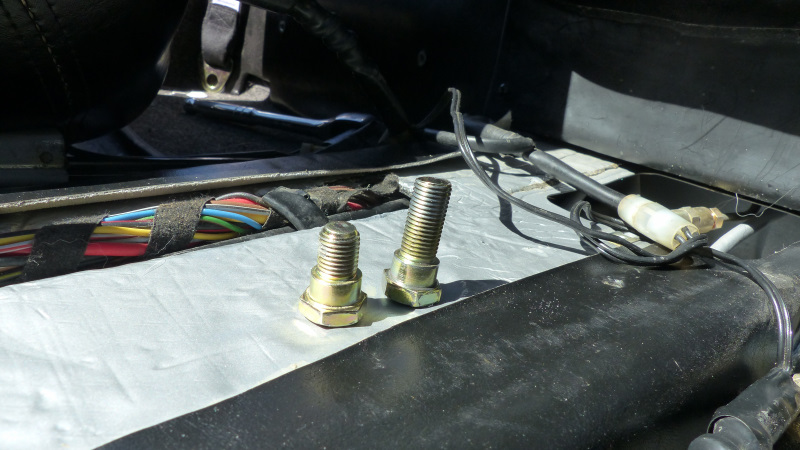

I decided to go ahead and install the flappers and at least get one side of the heaters hooked up. Mounting went okay. I did cut the high temp flexible hoses from flapper to heater tubes in the longs to length. Showing off some plating, this clamp bolt is NOS.
and this is the bolt donated by @brant after replating.
Here's where things really started to go to (IMG:style_emoticons/default/stromberg.gif) The heater cable did not reach to the passenger side and was long on the driver's side. I probably just installed the damn thing backwards but it didn't come with any instructions. You probably don't recall that I was concerned that the cables 914Rubber sells for hood, engine, and heater are made with soft wire instead of the hardened music wire of OEM. In fact, they are so soft the feel more like aluminum than steel. The heater wire was the only one I used and I thought I could adjust the lengths by repositioning the bend where it goes through the lever on the tunnel. That worked until it didn't. One bend and the cable broke in half (IMG:style_emoticons/default/headbang.gif) I now have an OEM cable on order from Sunset Porsche. The only good news is that the heater duct circuit is not closed so dust can migrate into the heater tubes and cockpit.

I forgot to post my Sunday update. Two somewhat small tasks. First was that seat tilt catch. I'm afraid it isn't great news. The proper fix would be to cut the seat hinges and more them forward so the adjustment dog fits completely in the adjustment teeth.
You might understand my reluctance to do that at this stage of the game. Lesson learned for those playing at home. Make sure you have your seat rails assembled and handy for proper placement when welding in those hinges. I'm about a 1/4" off. I opted to file out the adjustment where the rails bolt to the hinges a little more to let the seat move forward more, and maxed out the top tilt of the adjustment teeth to get more engagement with the dog. I can no longer pop the front of the seat out by pushing on the back, but need to do a little more filing for extra measure. Trying to decide how much of a safety issue this would be if the adjustment popped loose if I got rear ended and the seat suddenly rocked back the few inches before hitting the firewall.
I failed to mention another issue that cropped up which was that the shifter was really stiff. It was especially bad going into 4th and 5th and moving the shifter to the right felt more spring loaded than the spring gate on the left. It also felt like it was grinding moving the lever from 4th to 5th. I haven't owned a 914 with new shift bushings before so at first thought that was just part of the deal. It became obvious something was wrong so I went fishing for interference in the tunnel. I finally found it. The seat belt shoulder bolt to attach the receiver latch was too long. This is a bad pic but you can just see it poking out at the front of the tunnel opening there.
There are a couple lengths of the Repa shoulder bolts and I couldn't find good guidance on which went where so I guessed... wrongly as it turned out. After swapping bolt lengths, it shifts like butter.

The seatbelt bolt issue is a common one but at least you figured it out quickly.

QUOTE(bbrock @ Jun 2 2021, 07:17 PM) *
You might want to slightly slot the welded bracket and/or the comb to get a little more engagment. The combination of all three will probably get you there.
