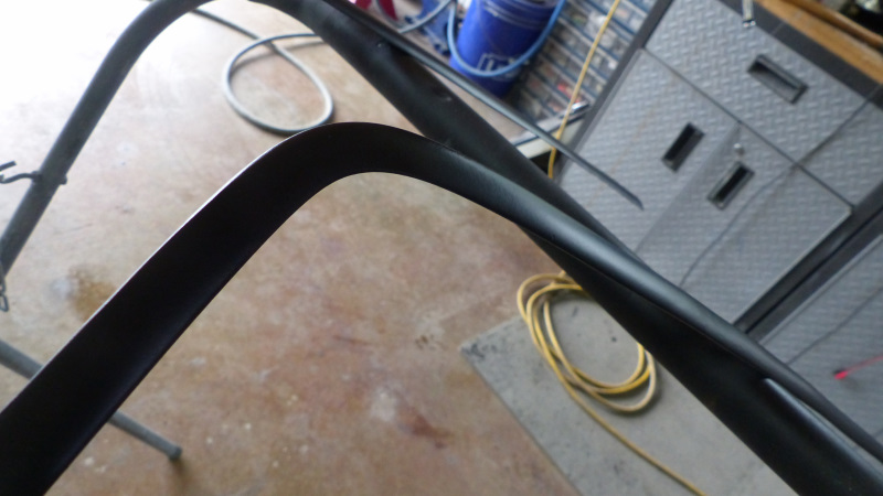

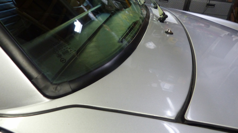

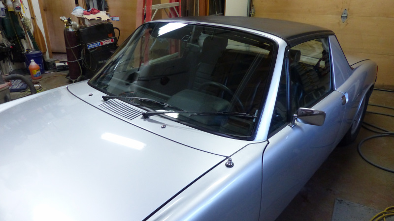

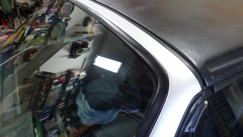

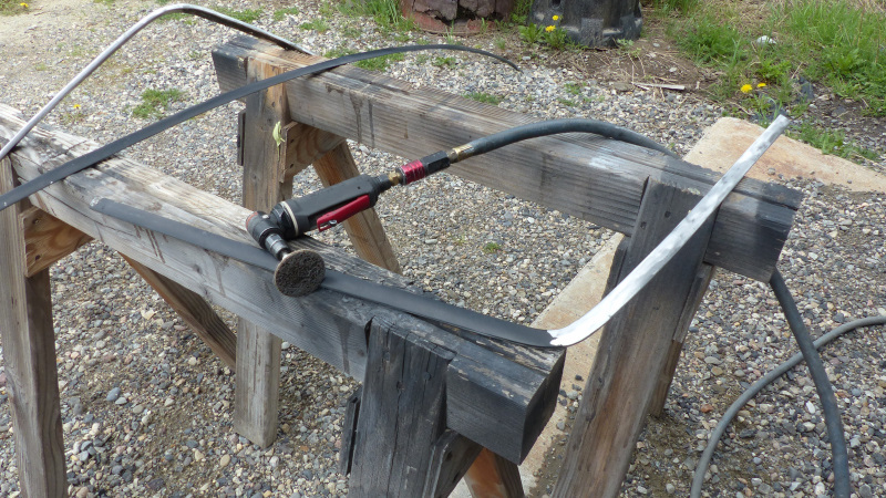

Now to the trim. To recap, I painted my trim satin black back in the 80s before I got all psycho about originality. Would I do it today? No. Do I think it looks better? Yes, especially on a silver car and with black bumpers and targa trim. The brightwork on this car always looked wrong to me. The chrome look fights with the metallic silver and looked mismatched with the black targa trim and bumpers. So yeah, not original, but I'm happier with the look. Another bonus is that it is a lot cheaper to repaint weathered trim than to re-anodize or buy replacements.
To strip the old paint and condition the metal for new, I used a conditioning pad on my 2" grinder. Only took about an hour.
Then I brought the trim inside for 3 coats of SEM Trim Black

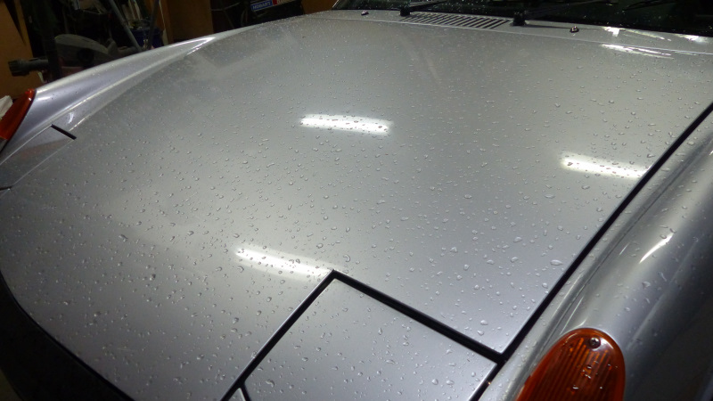

While that was drying, I backed the car out into the rain and tipped the valet to keep an eye on it while the soft clean rain washed the dust off from the gravel road y'all are so jealous of (IMG:style_emoticons/default/biggrin.gif) We have hard well water but do have a water softener. I need to figure out a system to get good water for washing the car when needed.
Later in the day, I drove the car into town in the rain (IMG:style_emoticons/default/yikes.gif) (IMG:style_emoticons/default/laugh.gif) Not just light rain either. Driving, toad-strangling, sheets of rain. It did great except those shitty 70s style wiper blades like to lift off the windshield at speed. Wish there was a way to mount modern blades. Speaking of speed, I can neither confirm nor deny that the car hit triple digits (IMG:style_emoticons/default/whistle[1].gif)
Here she is back safe in the garage.
The next morning, I popped on the trim. Took a bit of work to get it right. I wound up putting a microfiber cloth over the trim and VERY GENTLY went around several times tapping with a small rubber mallet to help the trim conform. That helped a lot.
It isn't factory perfect but I don't mind a few subtle reminders that this is a 50 year old car.

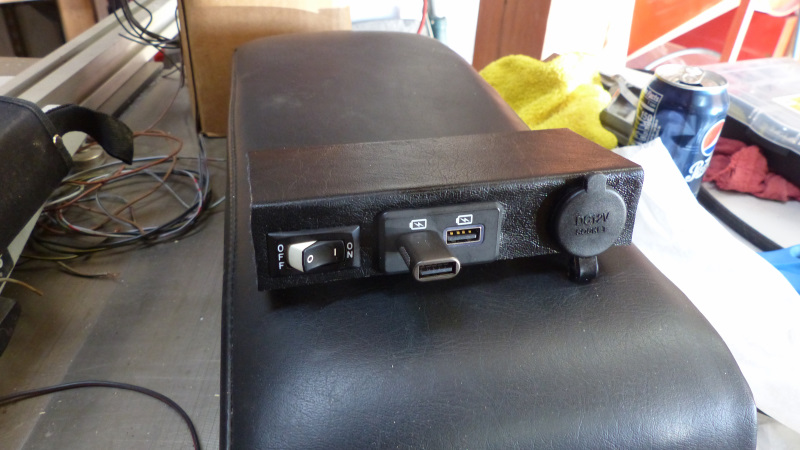

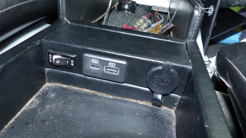

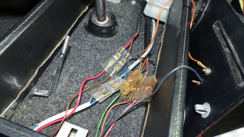

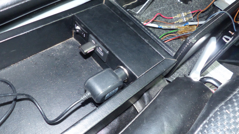

I mentioned that I needed to update my console update. I few weeks ago I had to remove the center tray and seat cushion and realized my error in not including disconnects for the usb charge and antenna switch wires. And while I was pondering things, I thought it would be nice to add another accessory outlet so I could charge a computer or power other gadgets without having cords dangling from the dash. And of course, we also know those old cig lighter sockets are too big for most modern 12v accessory plugs.
Starting from scratch, I made a new harness for the USB and 12v plug that now runs to the cig lighter and added proper disconnects for that and the antenna wiring.
Then I made a new outlet console. Clearances are really tight for the 12v plug and it took two tries to find a plug that would fit right. I was hopeful I could squeeze a shallow tray into the top somewhere, but couldn't find enough real estate to make it work. I think it turned out okay though.

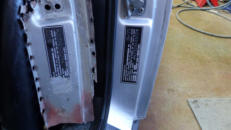

Overall happy with the car so far but something has been off. I couldn't quite put my finger on it and don't even know how to describe it. Just "off" like it was missing it's mojo somehow. It seemed to be emanating from this area.
Ah yes. There it is. Mr. Mo Jo Ris-ing. Ris-ing ris-ing! (IMG:style_emoticons/default/biggrin.gif)

you need a rainwater tank mate.
hook it up to one of your roof downpipes.
every aussie home has got one. you wash your car with it here so your jackass neighbour won't dob you into the authorities for washing your car with drought restricted mains water.
my childhood is my grandmother only making her tea out of water from the rainwater tank. she was fussy about her cup of tea.
your windscreen trim very tasteful and is impeccable german logic.
the chrome was indeed out of place on black trim cars.
porsche were a bit all over the place, bent over a chair, having to deal with VW management and karmann bottom line contracts?
whadya going to do about your "vent" window pillars on the door glass?
have you blacked them (IMG:style_emoticons/default/beer.gif)
mirror, door handles. (IMG:style_emoticons/default/stirthepot.gif)
thats a very nice fit around headlight buckets, front bonnet etc.
looking at my car i think you have over-restored it. (IMG:style_emoticons/default/pray.gif)

Hi Brent,
Where did you get the replacement vin sticker from?
I need one for my 6 and my brother for his 74 as well. (IMG:style_emoticons/default/beerchug.gif)

Hmm (IMG:style_emoticons/default/idea.gif) We already collect rain from the roof but the water is used for other purposes. I've been considering adding more storage capacity and when I do, will think of this so I can have enough to spare for washing the car.
The vent window pillars are already black. you can see it in earlier pics. Definitely nicer than the chrome. I'll leave the mirror and handles as they are. I don't think the stock mirrors would look right in black. Back in the 80s I bought a pair of Baby Tornados for this car but never used them. They were the first thing I sold when I restarted this resto a few years ago as plans had changed toward originality rather than modernization. Although I like the look of black door handles, I don't want to molest a good pair of handles and for some reason, they don't bother me as much as the bright trim did.
Now on that hood fit. The camera is kind. If you look carefully, you can see the left corner at the headlight to have the proper misalignment. Still need to work on that.
QUOTE(Luke M @ Jun 11 2021, 05:54 AM) *
Hi Brent,
Got it from Car-bone. They do fantastic work. If yours needs to be on the perforated background, make sure to add that in the instructions.

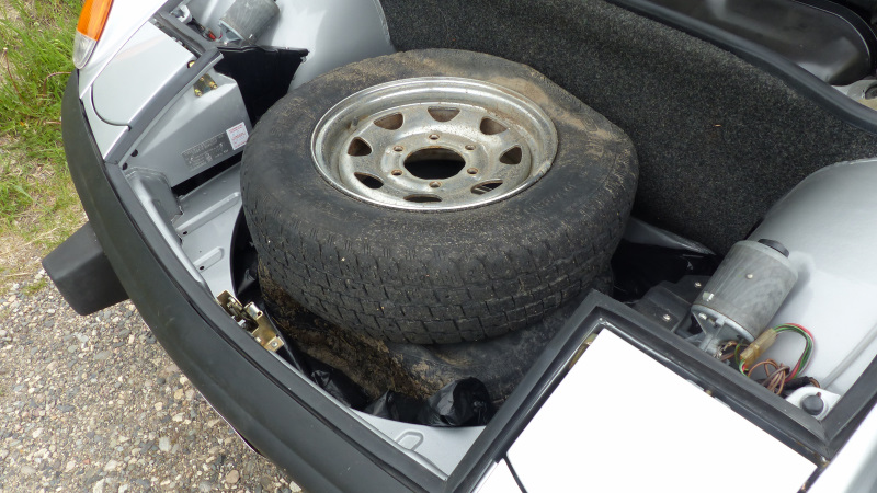

Had to drop off a set of rims from our little pickup this morning to get new tires mounted. Somehow this seemed like a more sensible deliver method than either of the two SUVs sitting in our driveway. (IMG:style_emoticons/default/rolleyes.gif)
Got my first Porsche wave from a 911 Carrera cabrio while I was in town. I'm pretty sure I saw a turbo spoiler on it but can't be certain. I'm not very up on the latest models though, so it could have been a Boxster but I don't think so. They all look alike to me anymore - except the Targa - those are cool. Whatever it was, THAT never used to happen in the old days. I'm not sure how I feel about being accepted.
Last night I got a honk and a wave from a Tin Lizzy putting down the road. Bozeman is weird.
After running my errands, I decided to take the long way home through the twisties of the Bridger Mountains. Wound up accidentally taking the REALLY long way home because some punks in a Honda Element started riding my ass and I was too worried about them doing something stupid to notice I had passed my turnoff. It was a nice day and the car was running great so I decided to keep going to a route through some stunning country but instead of 15 minutes extra to get home, took an extra 50 minutes. Oh well. The punks kept riding my ass and I got the feeling they wanted to show the Porsche they could keep up. I stuck to the speed limit (which is a fun enough 70 mph through some pretty gnarly pavement). They would fade back on the curves of course, but were back on my ass on the straights.
I turned off to make the long loop home where the road REALLY gets twisty and the punks followed. I got tired of their shenanigans and quickly made them get really small in my rear view mirror and then disappear. Turns out that I haven't outgrown being a jackass, but Mom, THEY started it!

QUOTE(bbrock @ Jun 10 2021, 09:56 PM) *
Brent, your sticker looks higher than others I have seen. I suppose the variability of factory sticker placement includes a range. Mine was almost as high as yours, maybe 1/8 inch lower. I have a replacement sticker to install, and checked a friend's car--his was 1-1/2 lower.

QUOTE(bkrantz @ Jun 12 2021, 07:32 PM) *
I've noticed that too. I was happy to have my original door pillar with the sticker on for reference so I could match whatever mood Helmut was in that day for sticker placement. Judging by the placement of my original, he was in an "I don't give a (IMG:style_emoticons/default/stromberg.gif) " mood (IMG:style_emoticons/default/biggrin.gif) Personally, I think they look better a bit lower but what can you do? (IMG:style_emoticons/default/confused24.gif) (IMG:style_emoticons/default/smile.gif)
My HO recall sticker in the frunk was in a different spot than most although I can see that being an alternate interpretation of the sticker placement instructions in the recall bulletin. I put my repro sticker back where it was on the car rather than where it was supposed to go.

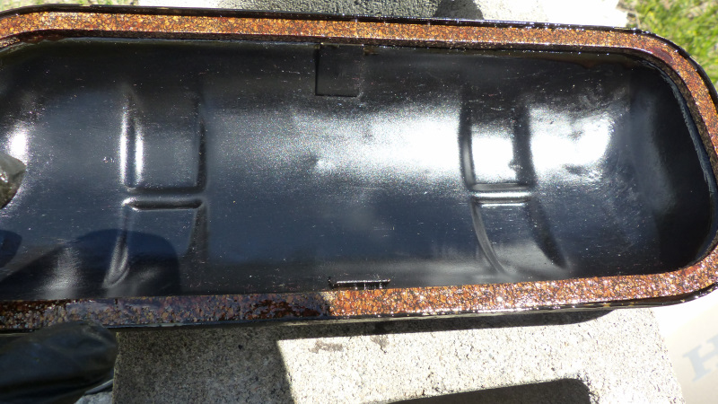

Looks like I am a month behind on updates so let's get caught up. I wracked up my 500 break-in miles in no time so drained the oil and changed the filter. I checked the valve adjustment. Everything was still spot on except two exhaust valves that were barely, barely loose. No really enough to even bother with, but since I was there. This was the time to fix the small oil leaks too. I had a couple push rod tubes seeping a little, but by the time the oil change came around, they had stopped and were sealed perfectly well. I'm assuming they must swell a little with the heat and oil.

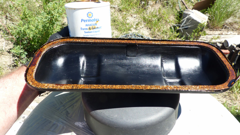

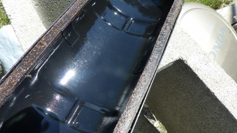

That just left the valve covers which were both dripping. You may recall my complaining about the narrow gaskets I got from 914Rubber. Well, they are off the hook because I ordered a bunch of Victor-Reinz gaskets from Pelican and they are the same. A good 1.5mm narrower than the valve cover flange or the old stock gaskets I had. Cheap ass bastards (IMG:style_emoticons/default/mad.gif)
Old stock gasket:
Cheap ass new narrow gasket:
Not wanting to fight constant drips, I decided to try a super thin film of aviation gasket maker on the outer side of the gasket that mates with the head. I chose that because it doesn't set up and can't clog an oil galley like a piece of silicone could.
It worked! No more drips since then, but we know they will be back. It's a 914 after all.

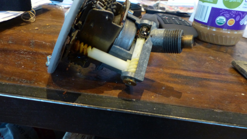

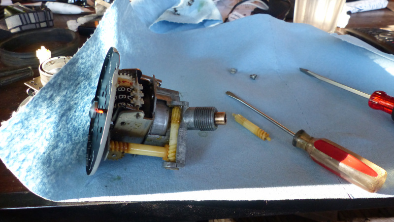

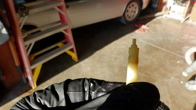

Next up was fixing the chewed up gear in my speedometer. @mepstein came to the rescue yet again by donating a core to extract a replacement gear from.
Here's the old gear with the divot out of the side cause by me accidentally gluing the odometer gear shaft to the housing in the last odometer repair.
And here is the replacement gear in place.
The speedometer is nice and smooth again. No more bouncing needle. The speedo still often sticks on the peg after a full stop which is a mystery. I can find nothing that is binding and have cleaned the mechanism with brake cleaner and relubricated with clock oil several times. It almost acts like the peg stop is magnetized or something. I find myself looking for pot holes after coming to a full stop to bump the needle off the peg so the needle swings free again. (IMG:style_emoticons/default/confused24.gif)

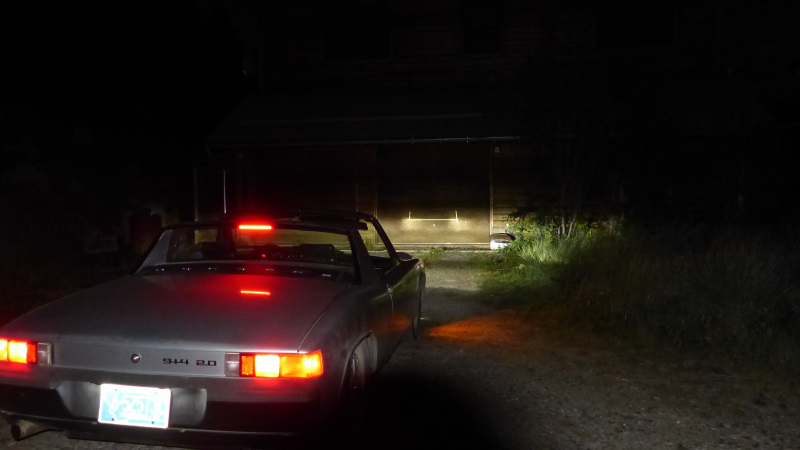

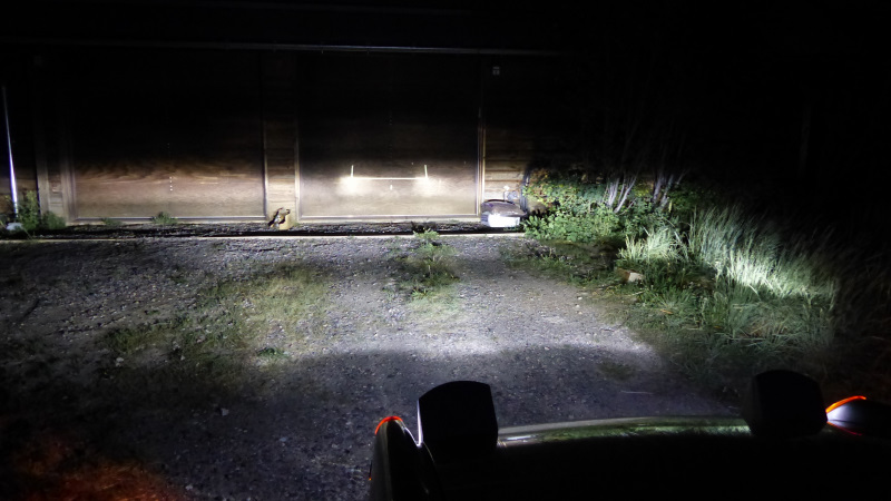

I had not been driving the car at night because I hadn't gotten round to aiming the headlights. I finally did that using these directions that were posted here on the World: https://www.danielsternlighting.com/tech/aim/aim.html
I like these LED Truck-Lites.

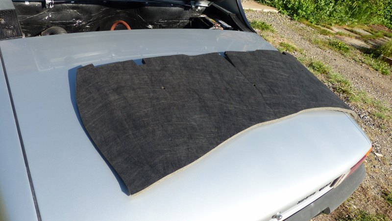

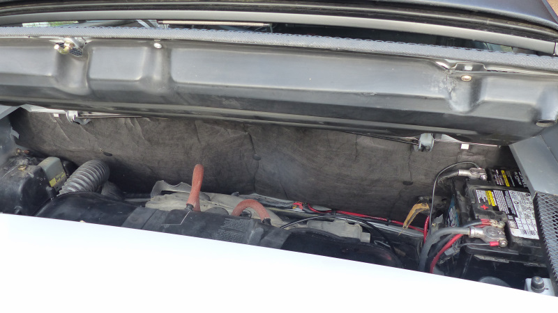

In pursuit of quiet, I followed a tip that @Dion posted and bought a different engine bay sound pad from RIX 914 parts https://www.rix914parts.com/store/p29/914_F...uction_Mat.html It is lightweight but denser than the closed cell foam pad I installed before.
Before removing the old pad, I took some sound measurements using the Decibal X app on my phone. I measured with the top on, windows rolled up and car outside in the driveway. Average measurements were:
82.1 dB @Idle (~1K rpm) 95.2 dB @3K rpm
Then I installed the new pad
81.0 dB @Idle 94.5 dB @3K rpm
Honestly, I was hoping for more than 1 dB sound reduction for my $185 investment, but I'll take every dB I can get. That doesn't tell the whole story either. Almost all of the sound reduction was at frequencies above 800 Hz which dropped the annoyance level more than the 1 dB would suggest. Also, most of the low frequency sound is coming from the muffler so I wouldn't expect the firewall pad to have much effect on that.
Her it is installed. I did not glue it in because the clips work just fine and I'd like to be able to pull it out if needed.

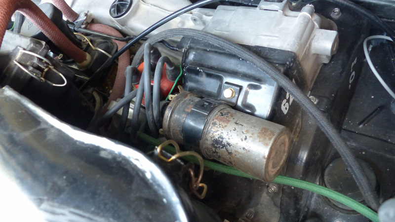

And now for some ignition news... Several weeks ago I replaced the copper spark plug wires to Pertronix wires for compatibility with the Ignitor III. Last weekend I decided to give the stocky and new SVDA dizzies another shot with the new wires. Unfortunately, I got the same result. The Pertronix worked fine when the engine was first started, but developed a progressively worse misfire as it warmed up. Watching with a timing light was startling. I'll bet #1 was only firing half the time and assume the same for all other plugs. In disgust, I put a set of points and condensor in the stock dizzy. Man do I hate points. What a PITA to adjust. I have always hated adjusting points but now it is worse knowing there is better technology available. PITA or not, they worked. The engine runs smooth and strong with the stock dizzy and vacuum advance AND retard connected. It might be my imagination, but the car seems to stink less of gas now too.
For now I have the stock dizzy installed with an old tired looking coil until I decide what to do.
No way will I stick with points. Fuch those things. However, after just a month I think I've learned I am not a carb guy. Don't get me wrong, the performance has been amazing even though they aren't properly tuned yet. I strongly suspect they are jetted a bit too rich which is expected given that I live at 6,000 feet. But they bring back nostalgia of the bad old days when every garage stank like gasoline from the fuel constantly evaporating out of carb fuel bowls and they are just a bit too fiddly for my liking.
I'm very strongly thinking of converting to microsquirt with ignition management. The more I read, the more I like. I may just run what I have for the summer and have a winter project to bring the fuel and ignition into the 21st century.
