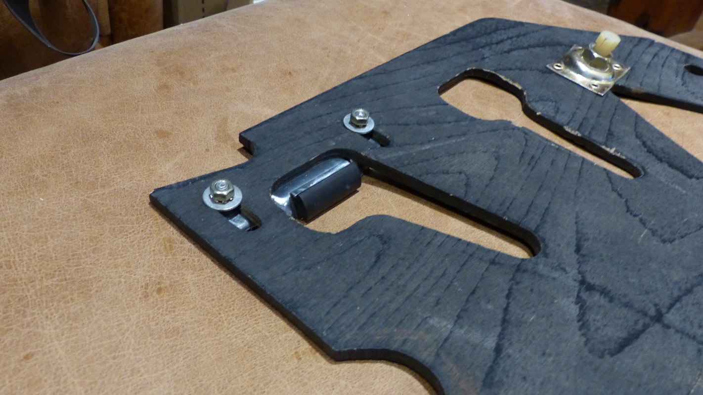

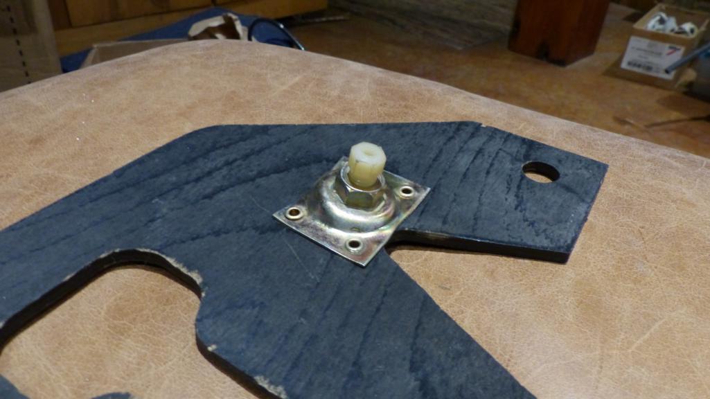

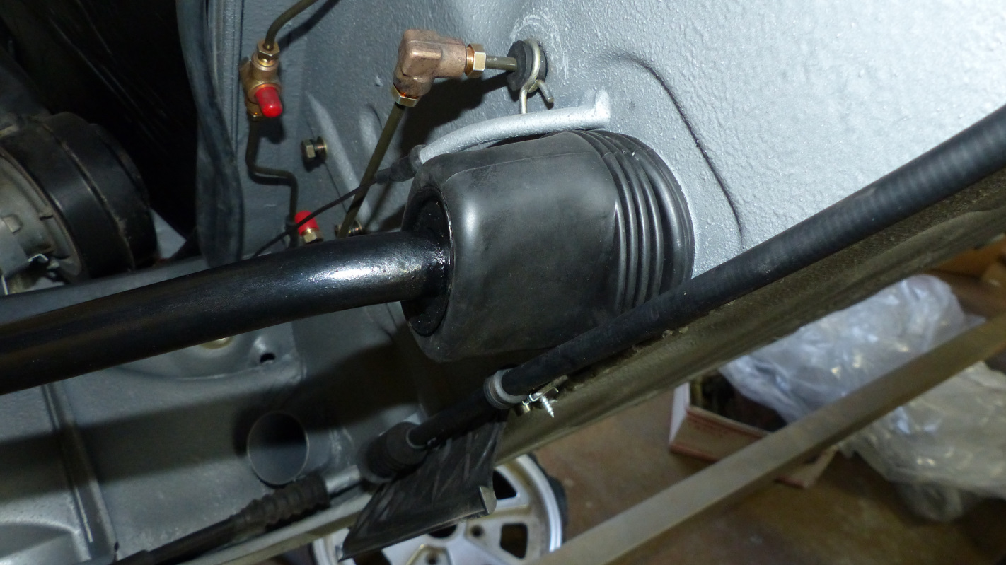

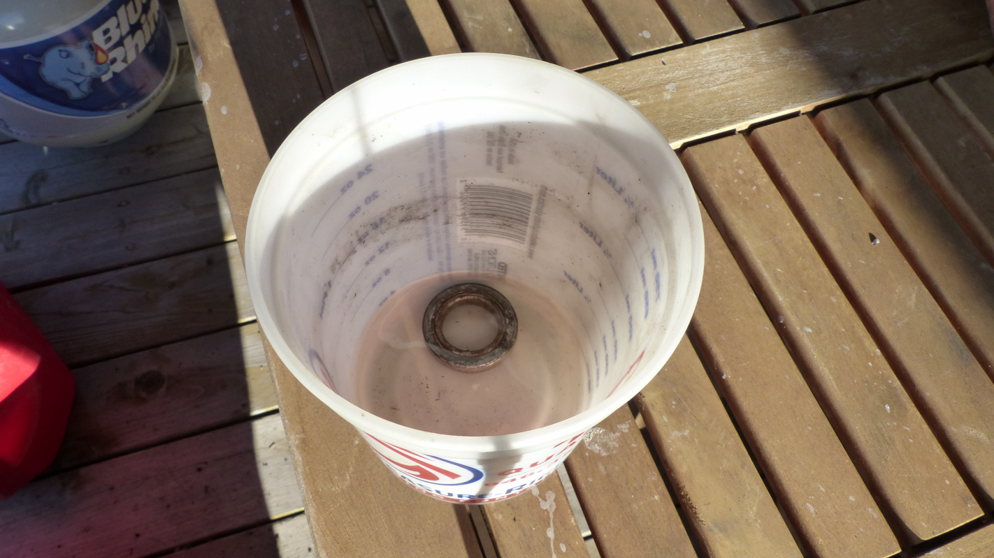

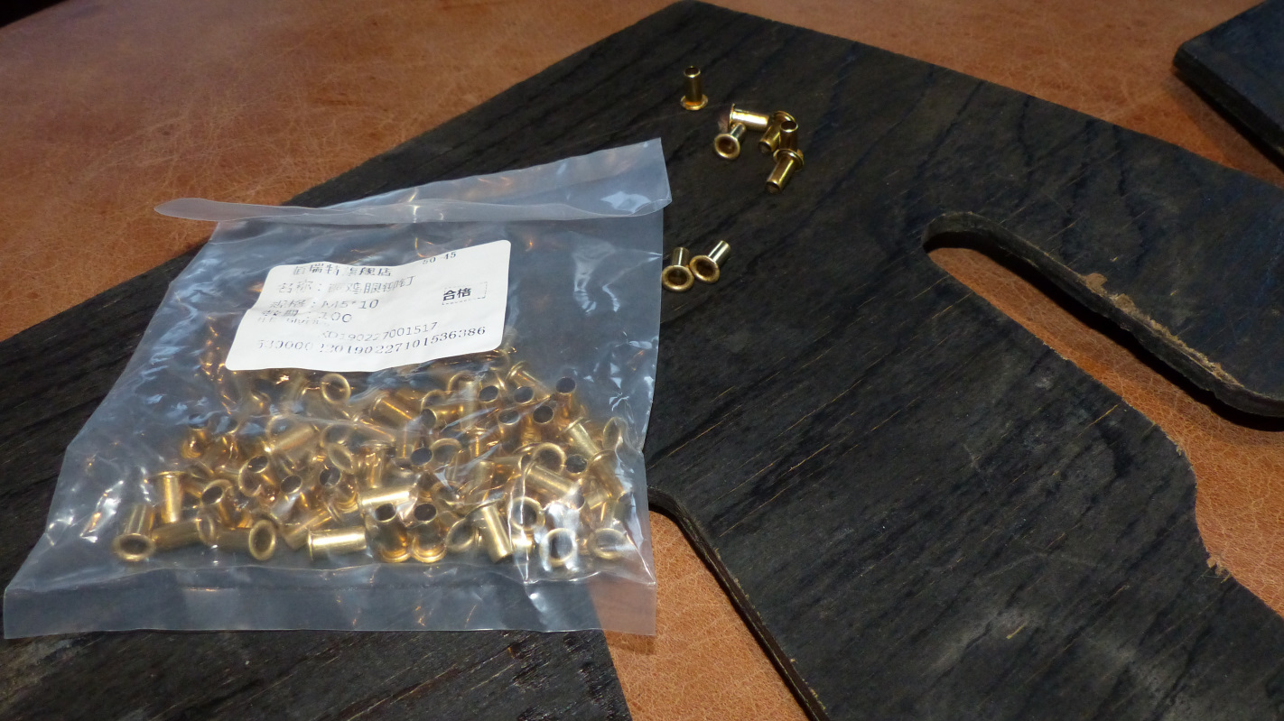

Here's another. Yesterday these tubular rivets arrived for the accelerator stop on the pedal board. A normal person would just pop rivet that back on, but do I have to say it? That's not what the Germans did (IMG:style_emoticons/default/smile.gif)
Here's a tip, don't be an idiot like me. When I removed the accelerator stop, I did my best to measure for replacement rivets that I found for a few buck on ebay. Then I waited a month for them to take the slow boat from China. Of course they were the wrong size. I adjusted and order again. A month later - closer but still not right. The third time I felt confident I had the size right but a couple days later, I was looking in the PET and noticed those goddam rivets have a part number and the size is listed clear as can be in the catalog. (IMG:style_emoticons/default/headbang.gif) Luckily, I had gotten it right on the third go so a mere 3 months later, I was ready to install. I really had no clue how to install rivet and I didn't want to spend $ on special tools. I had to destroy a few to figure it out, but used a large center punch and very light taps with a hammer to flare the opening. Not too far or it will split. The lowest one here is how it looked when finished with the punch. The others have already been set but gently driving them down with the ball end of a ball peen hammer.
It isn't absolutely perfect, but close to original but this isn't the money shot anyway. This is the important side. Looks just like stock.
Of course the clutch stop got a fresh coat of zinc. If I can figure out what stupid thing I did with the funky little washer on the right side of the board, it will be back in business.

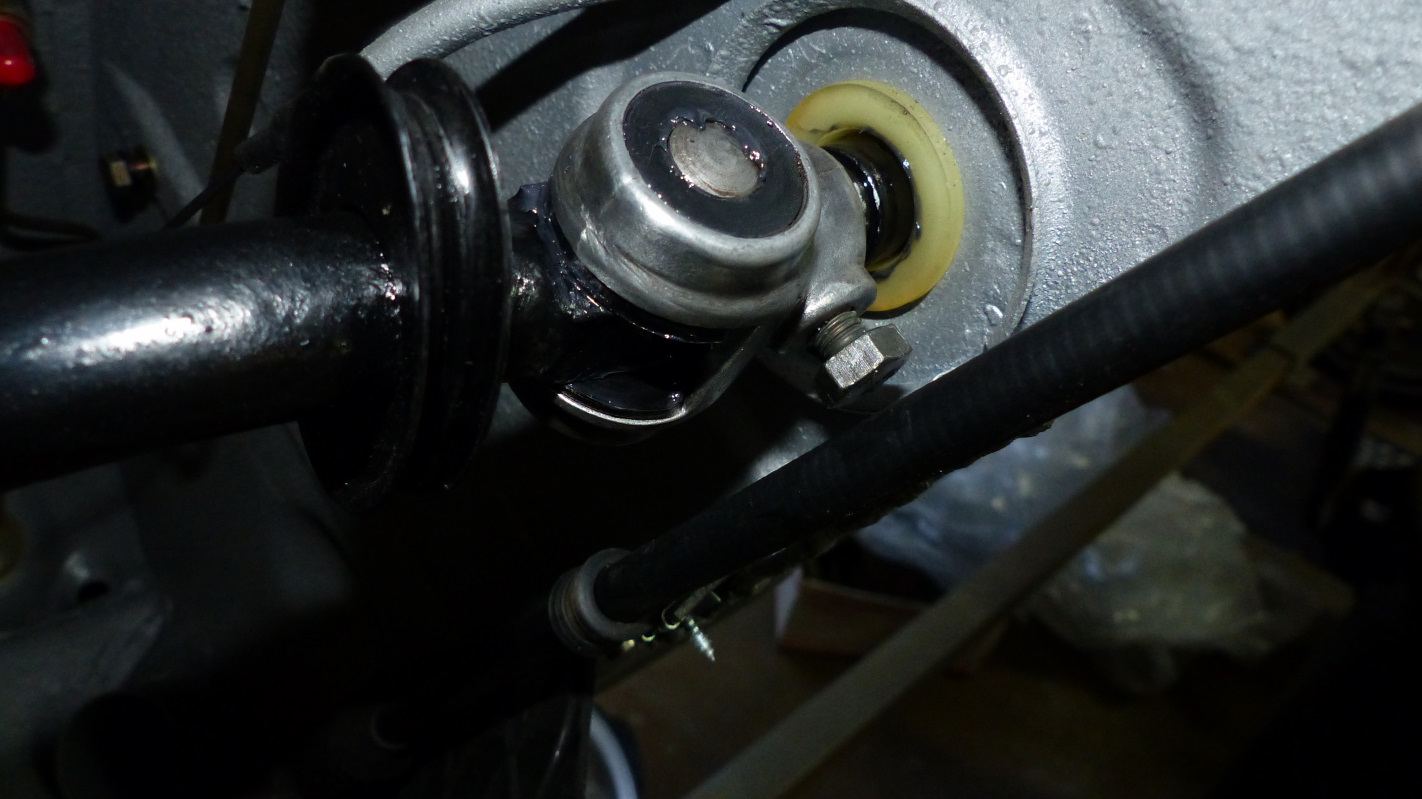

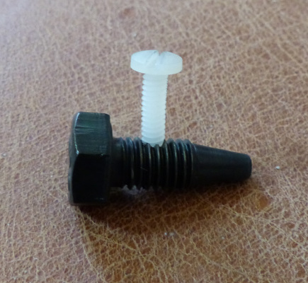

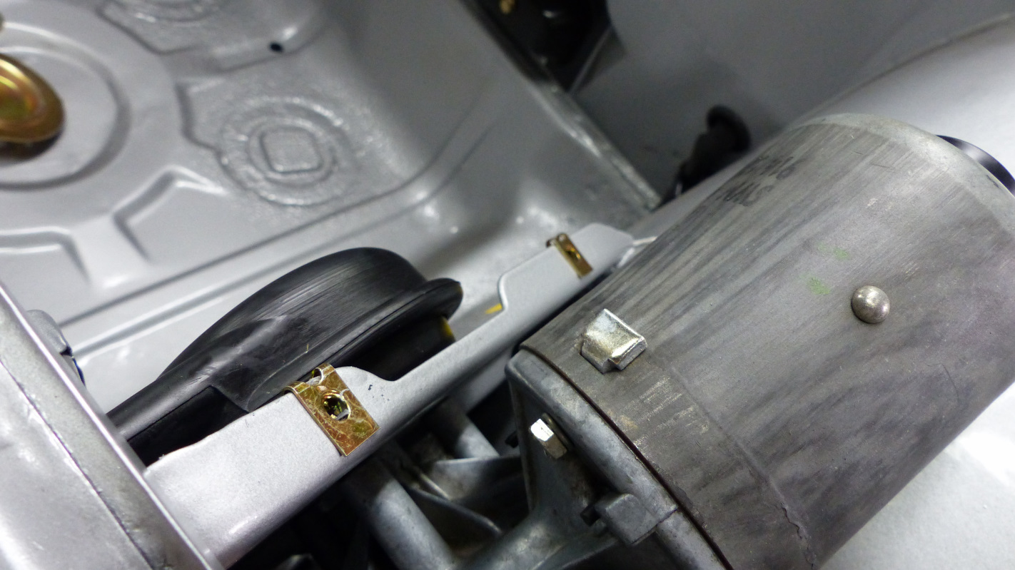

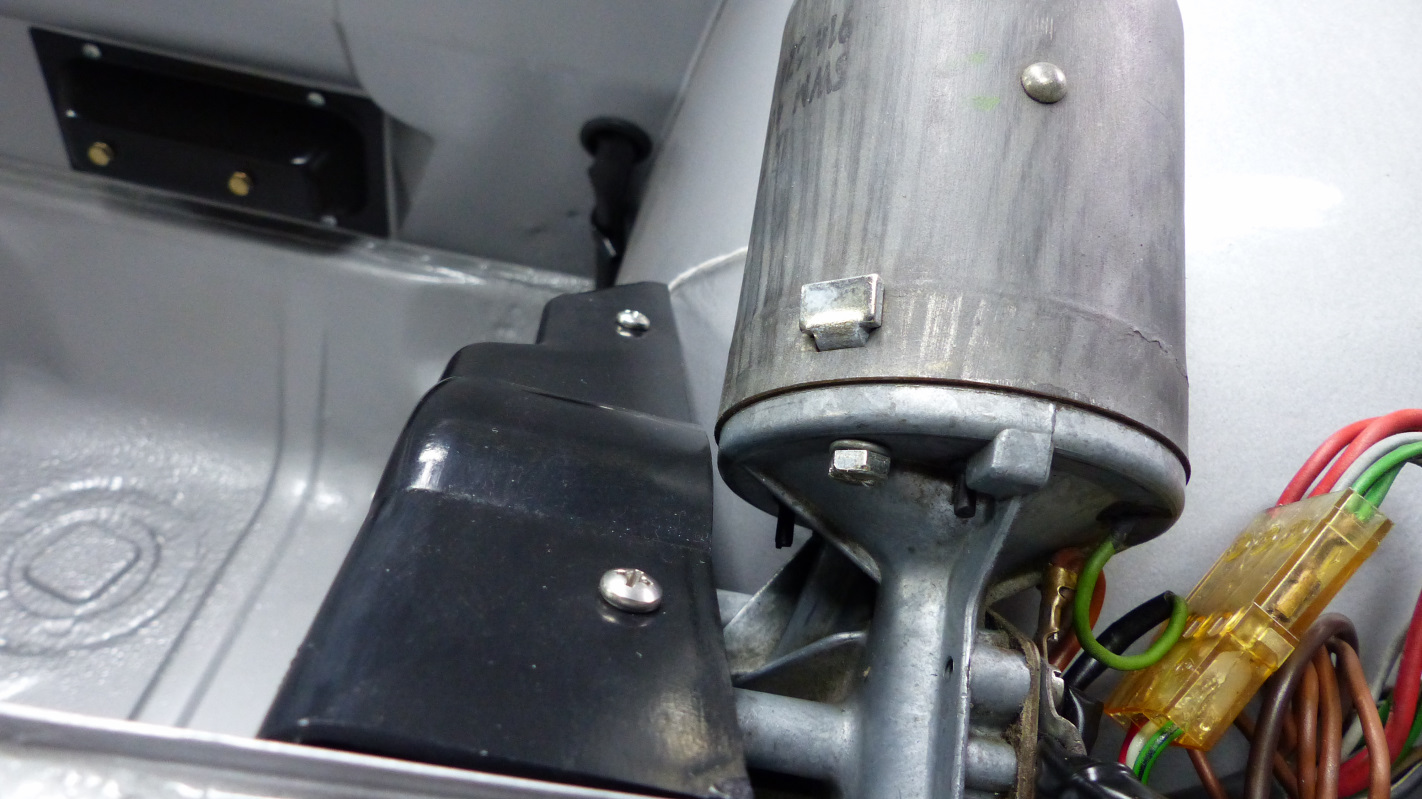

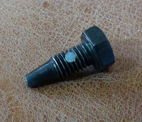

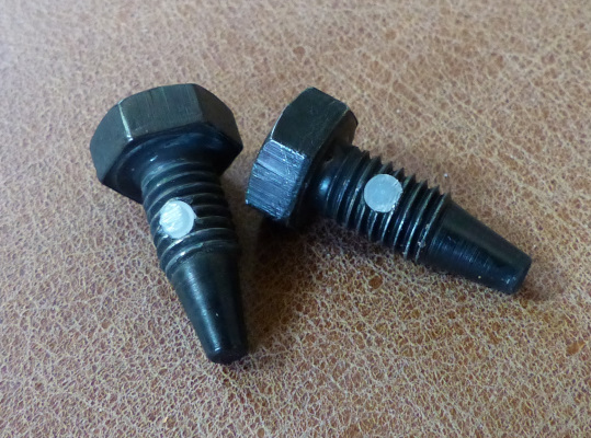

All the cool kids have these (IMG:style_emoticons/default/shades.gif)
The day after I bought my first car (a 70 914), I had to take the shift linkage apart for my very first repair. After fighting those f-ing cone screws for a couple hours, I was convinced they were about the dumbest thing Porsche could do so I had a local machinist make these for me for about 5 bucks. They've served me well through 3 914s but it was time for an update. @Dave_Darling recently pointed out on another thread that I should use locktite on them since the originals had nylon inserts so they don't vibrate out. As you can see, I did one better and added nylon inserts. Pretty simple. Just cross-drill with 1/8" bore, drive in a nylon screw, and trim it off. (IMG:style_emoticons/default/shades.gif)

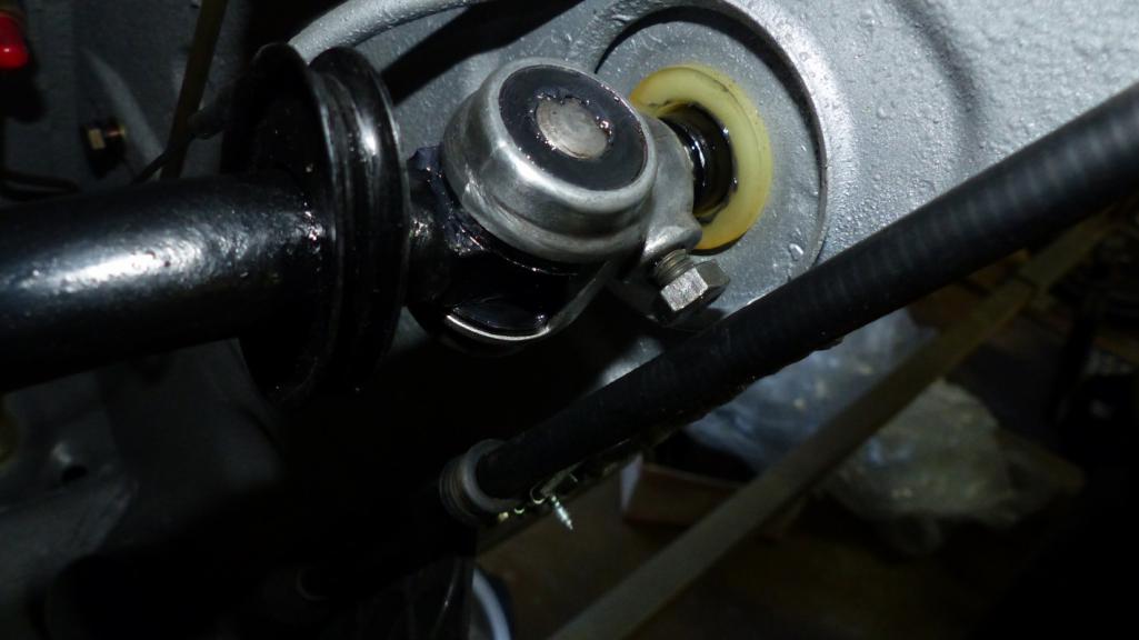

Here's one in the shift coupler.
Pull the boot over it and the CW will never know, but they'll come out without all the drilling and cussing. (IMG:style_emoticons/default/wavey.gif)

It's a good thing those ugly hex heads won't show that would be unacceptable to the date coders and the Germans.
If you don't tell, I won't.
(IMG:style_emoticons/default/stirthepot.gif)

Cool idea on the cone screws. Your attention to detail is inspirational!

I'll take these in order.
QUOTE(Superhawk996 @ Mar 21 2019, 04:50 PM) *
Absolutely looking great. I'll start gathering up all my rusty bits to be shipped your way for the Montana Hot Springs Chromate Spa treatment.
(IMG:style_emoticons/default/av-943.gif)
Ha! This being able to plate yourself is a bit like a crack habit. Every time, you convince yourself you are going to quit but.... just this once more won't hurt. (IMG:style_emoticons/default/wacko.gif)

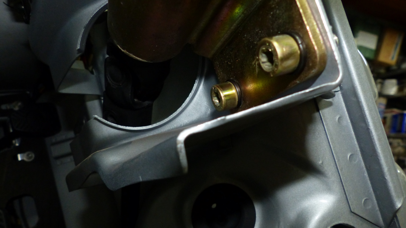

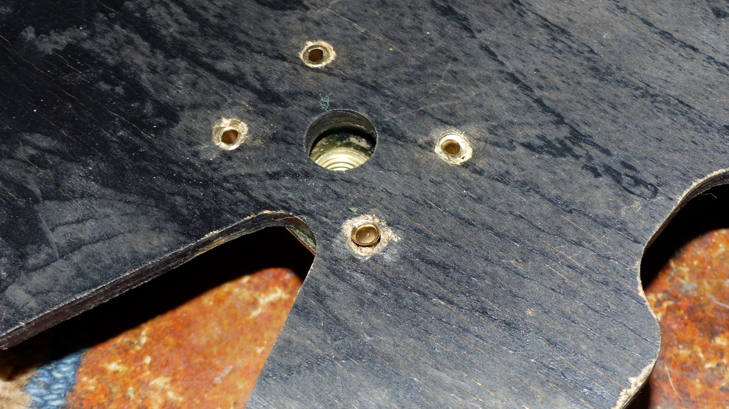

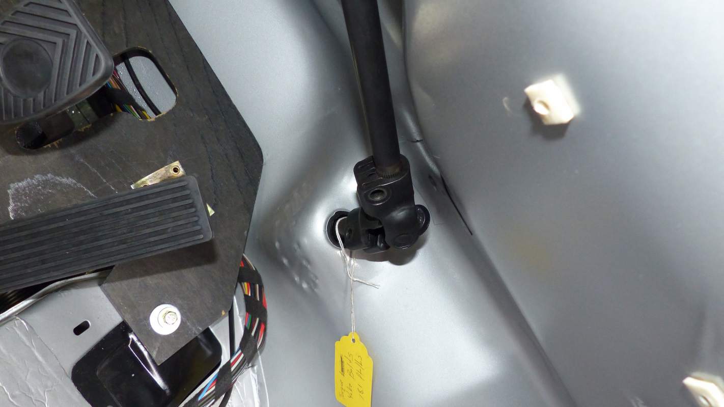

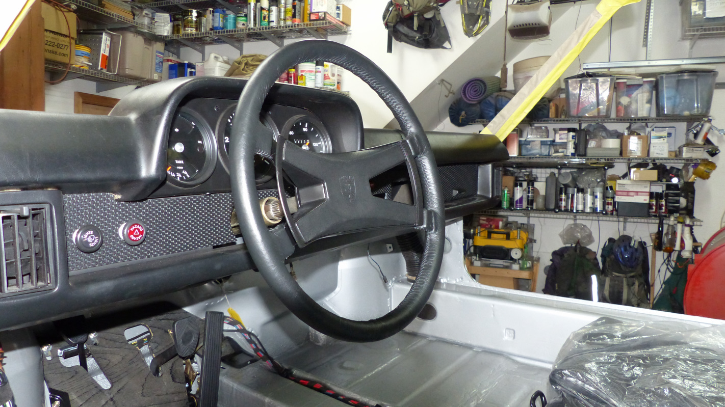

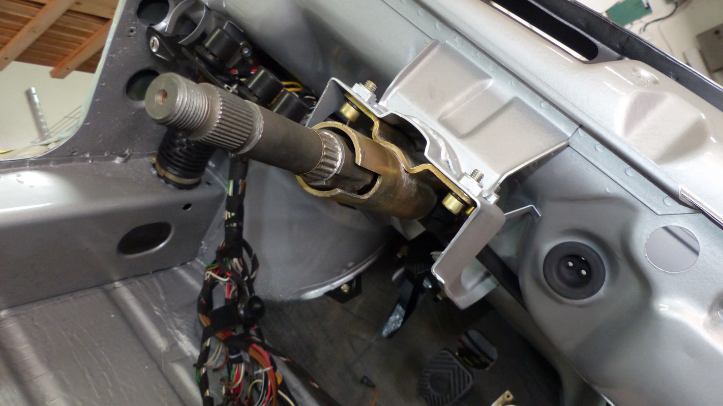

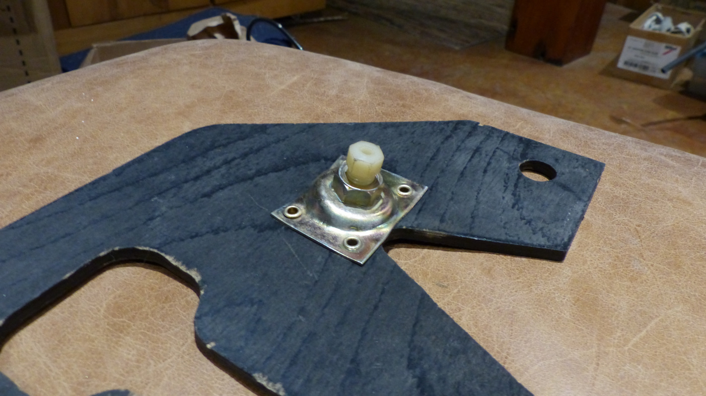

Moving on. I realized that when this thing becomes a roller, I'm going to need a way to steer it so I dusted off the old steering column. The tear down was a quick lunch break thing and I forgot to take pics. The steering action was horrible. It felt like the bearings had turned to gravel. I was convinced the rear bearing was so far gone that I placed a quick ebay order for an SKF sealed replacement before I even tried to clean it. To my surprise, after a soak in gasoline and getting all the old waxy greasy out, both bearings were silky smooth.
The only part I really need to install right now is the steering tube. This may be a surprise, but I chose not to replate it. It's in pretty good shape and the size and shape made me doubt I could do a good job with my setup. It looks just fine.
I did replate the cap screws and replace the lock washers. Note: yellow cap screws and black lock washers. That's the way mine came anyway. You can put your own together however you like, but don't blame me when your steering wheel fall off because you used the wrong color washers. (IMG:style_emoticons/default/rolleyes.gif)
Slippery slope warning: I had decided to not replate the steering shaft bolts and Fuji nuts because they were also in good shape... except for one (IMG:style_emoticons/default/mad.gif) If you are going to plate one, might as well plate them all. So the steering shaft is naked right now.

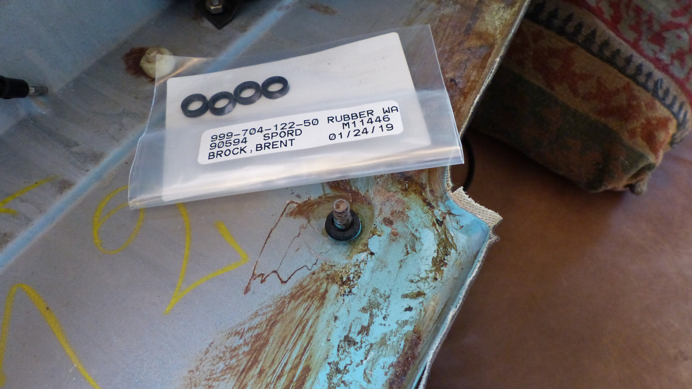

While the dash was out, I installed new rubber washers on the mounting bolts. Porsche sent me an extra set, so if anyone wants a set, PM me.
And WA-la! We have a steering wheel. Oh look at that, Gomer got the pedal board installed.

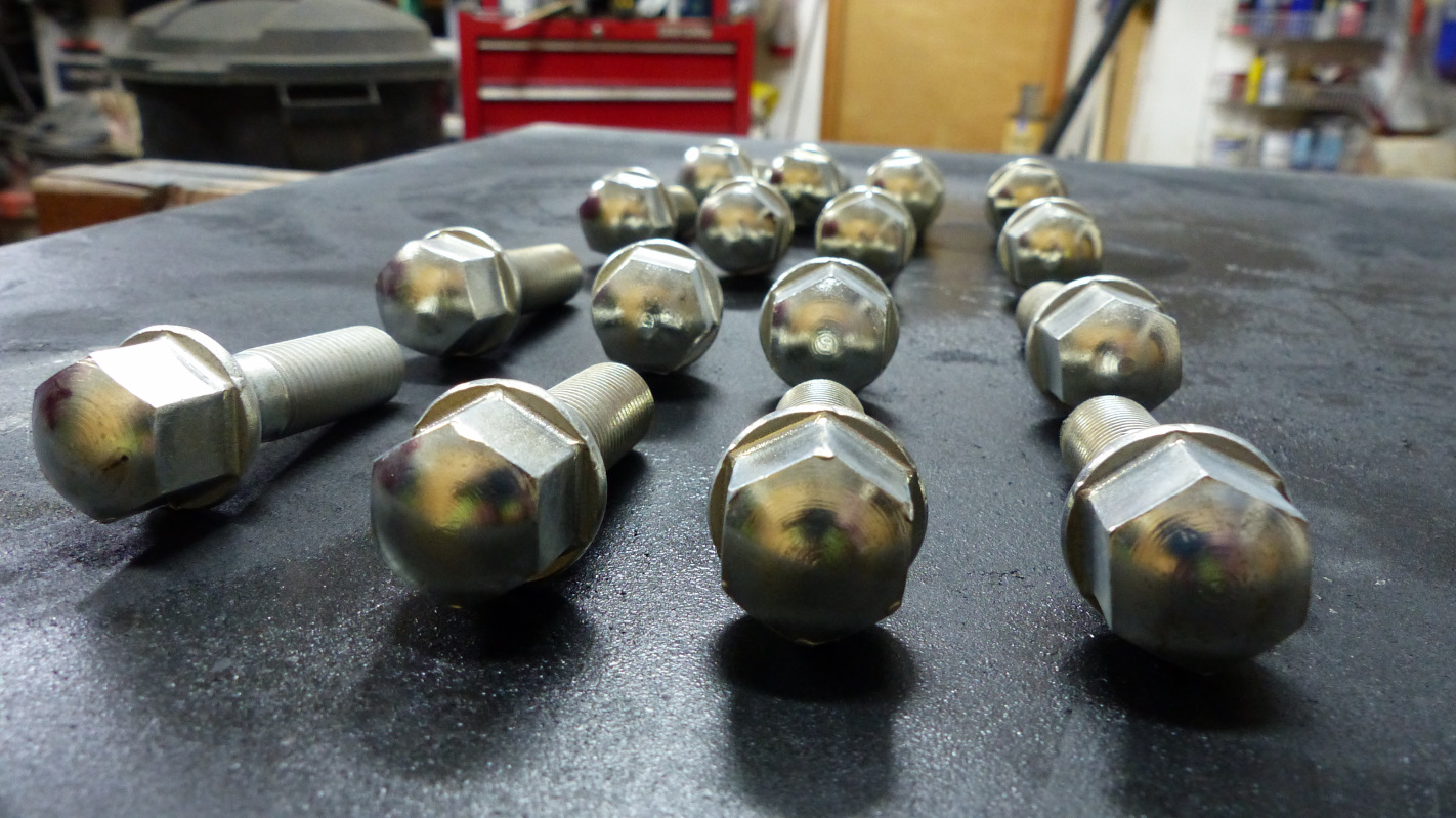

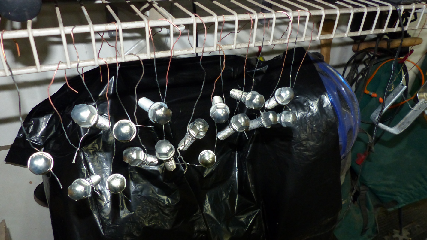

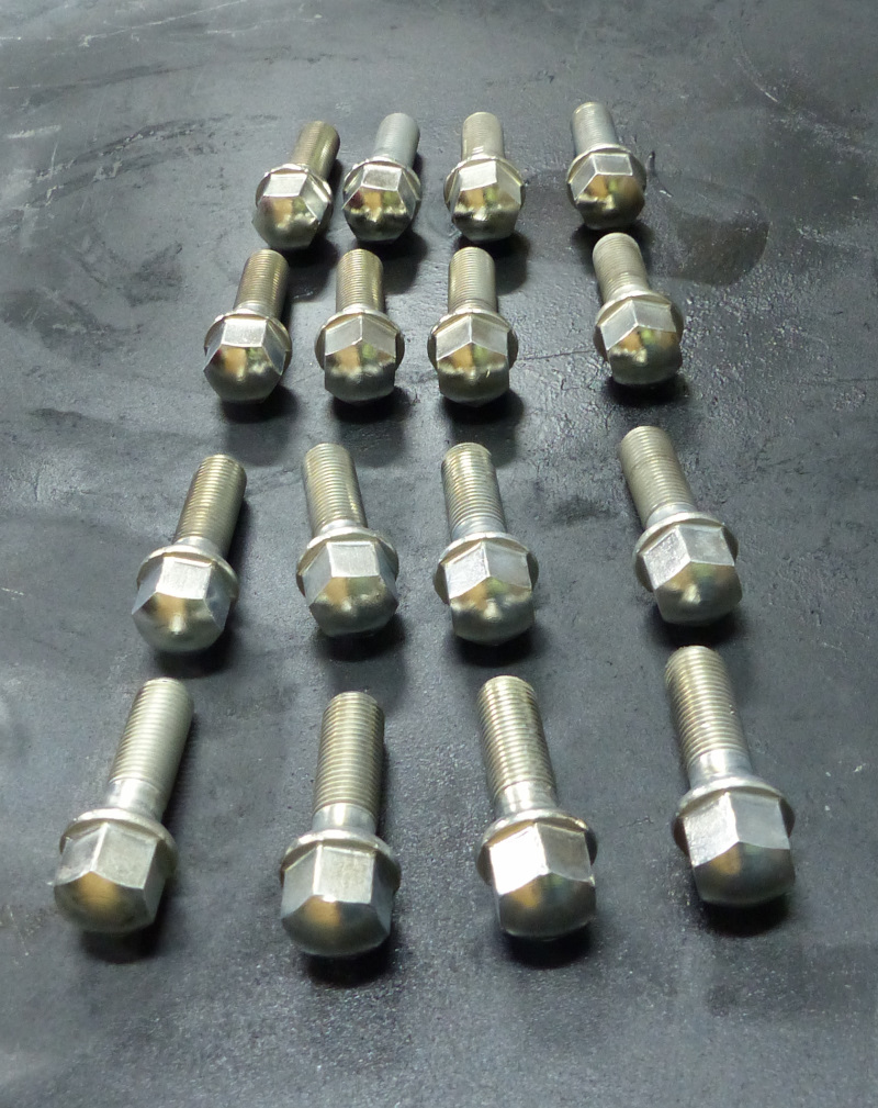

Sweet Sixteen
Got the wheel bolts plated. I think these look pretty good straight from plating. Difference between these and my test is that they have a much thicker coat of zinc and I flash dried them with compressed air after rinsing. Plating time was about 7X what I did for the test. I don't know if that equals 7X the thickness of zinc but there should be plenty on these for protection. Flash drying is key for a uniform sheen. I'm really happy with both the sheen and uniformity. I don't think I'll bother with polishing as I don't want them overly shiny. What do y'all think?
