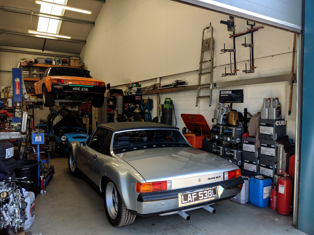

It turned out there was actually more wrong with the car than initially thought although nothing too serious.
After the carbs were rebuilt again the car went to the rolling road but things didn't go to plan and it was discovered the distributor wasn't at all well.
With what we're all facing now the car, with it's now functioning distributor, won't be heading back to the rolling road for a while. So as it was running well enough to drive, earlier in the week I collected it.
Huge thanks to Simon Rudge for his assistance in getting the car up and running.
Once again sharing the same garage as 23e Heure's GT
(IMG:http://www.914world.com/bbs2/uploads_offsite/i.postimg.cc-6621-1585478311.1.png)

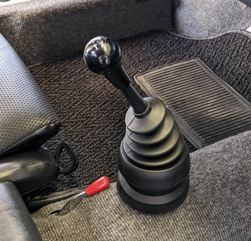

Whilst the car was with Simon I also got him to install a Rennshift performance shifter. Such an improvement and one I'd thoroughly recommend to any 914 owner.
(IMG:http://www.914world.com/bbs2/uploads_offsite/i.postimg.cc-6621-1585478312.3.png)

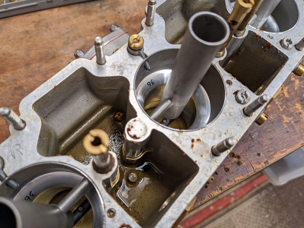

QUOTE(defianty @ Nov 26 2019, 01:30 PM) *
Another month of tinkering and I'm no further sadly. In fact right now I'm further away than I've been in a while.
So far I've managed about 40 miles in the car and none of them have been very enjoyable. Getting the engine to start initially wasn't too difficult but since then it continued to run worse and worse and starting got more and more difficult to the point where it wouldn't start.
The first thing I changed out was the starter motor. I was using my original 0.7Kw unit from the four cylinder and as you can imagine it struggled. I swapped that out for a 2.0Kw High Torque unit and that was a huge help. But each time I went for a quick drive the engine performed different to the previous drive.
I knew the timing was correct, or at least close enough, tappets were perfect and the spark was good, so that just really left fuel.
Last night I pulled the tops of the carbs off and on one bank one of the pump jets was blocked and the other bank two were blocked!
This afternoon I did this...
(IMG:http://www.914world.com/bbs2/uploads_offsite/i.postimg.cc-6621-1574789405.1.jpg)
As you can see they're a bit dirty.
(IMG:http://www.914world.com/bbs2/uploads_offsite/i.postimg.cc-6621-1574789406.2.jpg)
I guess sitting in a box for three years with remnants of fuel in hasn't done them any favours. (IMG:style_emoticons/default/blink.gif)
On the bright side I get to learn how to clean a rebuild a set of PMO's (IMG:style_emoticons/default/laugh.gif)
If anyone's got an good sources of information on how to do this please let me know.
This is a a good pic of PMO's which use IDF floats instead of the IDA floats.
If you're going to run carbs you need to know how to do this chore.
