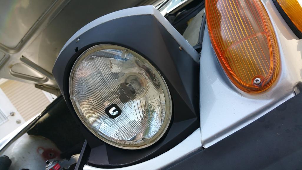

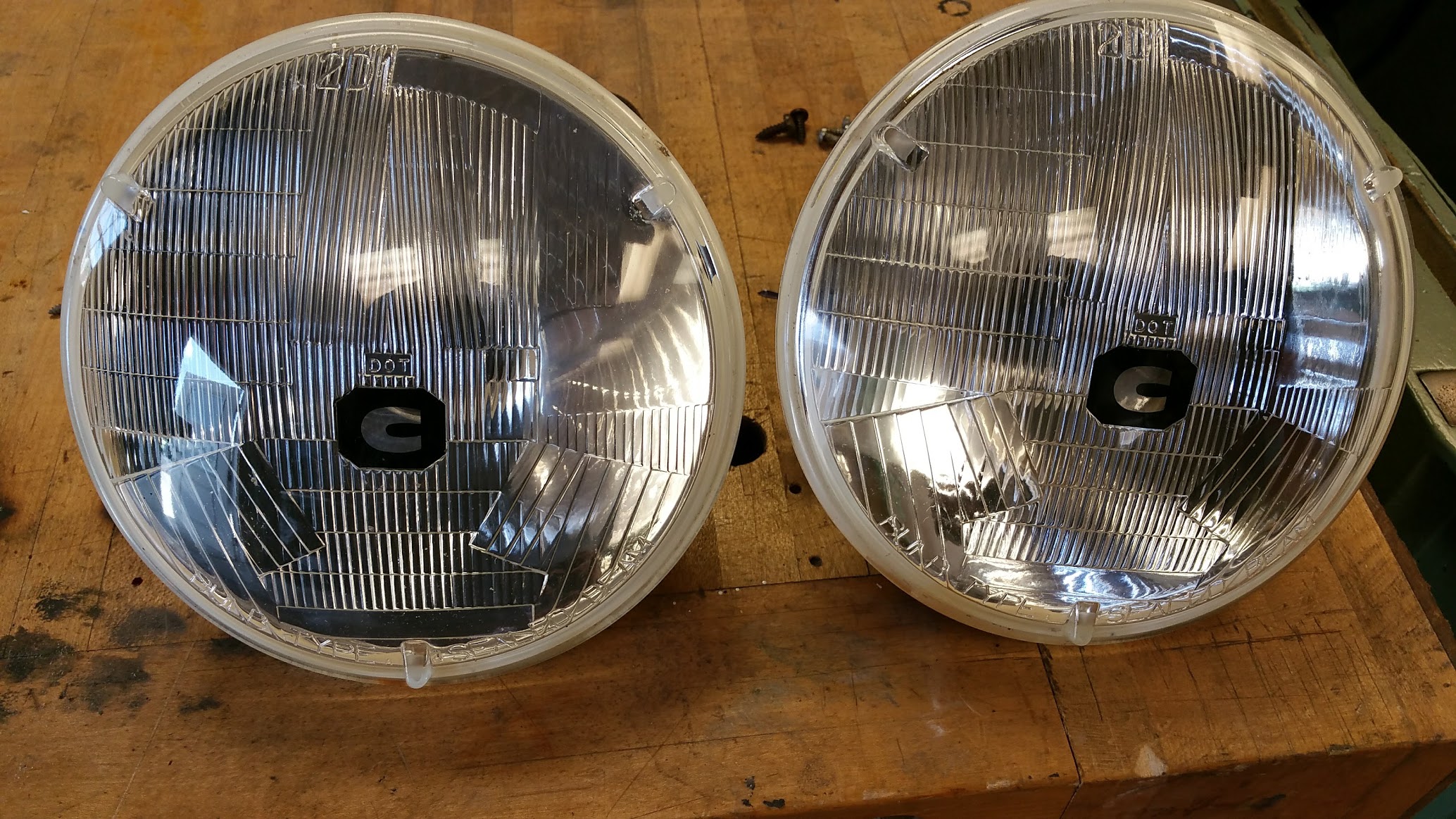

My headlights are pretty dim. I try not to drive at night. So I'm thinking of ordering a set of H4s. But I noticed that current lights look like Cibie's with replacable bulbs. I'm going to pop them open today to get a close look. Does anyone recognize what I've got here?Attached Image

Those are good headlights.Are they sealed beam? Issue may be not enough electrical current or a bad bulb. Check the voltage. Get new bulbs...

CibiƩ BOBI. A semi-sealed H4 headlight, made specially for the US. DOT legal as it had a glass balloon inside to seal the lens and reflector assembly while still allowing use of normal, replaceable H4 bulbs. Actually pretty good lights. I ran a pair in a Chevy pickup back in the 80s.
So I doubt your dimness is bad lights. Perhaps bad ground, too low voltage (too much voltage drop in the wiring), or perhaps too high of expectations.
Thing is, even decent H4s are not going to be equal to modern headlights. A relay set may help, by getting more volts to the lights.

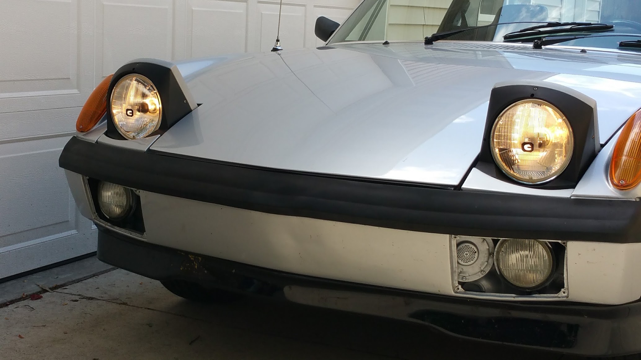

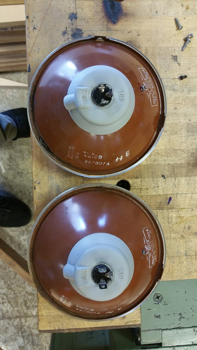

These headlights ended up being in great shape. Took them out, cleaned them, popped into FLAPS for a fresh pair of 55W H4 bulbs, tested voltage at 11.7 at the connector with engine idling, even gave the black trim pieces a fresh coat of paint. The rubber boots at the back were soft and pliable, like new. It isn't dark yet, so can't test for brightness and aim, but they've got to be better than they were. Now I can't wait to mount my Cibie Iode fog lights. A matched set it will make.
That's a great loooking car! i have a new set of those Cibie headlights but the Euro version without the glass bubble around the bulb. Hopefylly they'll work well with 914 Rubber's LED bulbs I just received.

So....headlights are dreadfully dim. And I couldnt adjust them high enough before the top adjustment screw bottomed out against the inside of the headlight housing. So the fix for that is easy, just cut the screw a little shorter. I can't really adjust that via the position of the headlight's movement since it will then be too high in the rest position, right?
The dimness problem I'll need to track down. First I'll try my grounds. If those are good, then it's a bad switch or tired wires?

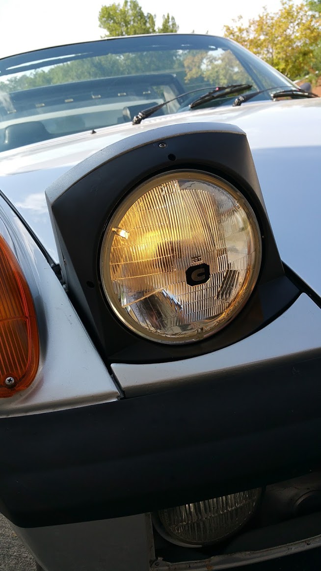

I ended up buying a new voltage regulator. Now I'm getting 14V at the batt with the engine running. So that's good. Cleaned the grounds up front and now I'm getting 12.5v at the headlight plug. Lights are way better than before, but not exactly confidence inspiring. 55w h4's, brand new bulbs. It's totally drivable, but brighter would be nice.
