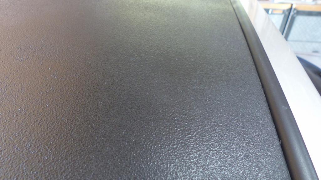

bbrock
post Sep 8 2020, 10:13 AM
Posts: 5,269
Joined: 17-February 17
From: Montana
Member No.: 20,845
QUOTE(horizontally-opposed @ Sep 8 2020, 08:56 AM) *
Some of these are really close, and would be just fine by me as my car isn't concours. Mark's looks really good, and some of the other techniques described make me curious to see photos.
However, I have yet to see a really accurate replication of the original finish—which is a random mix of blobs big and small that was certainly hard and certainly durable. Has anyone managed to actually replicate it—or determine how it was done in the first place? If so, pics?
I think Mark's technique is the correct replica of original but there is technique involved in getting the splatter pattern correct. After attempting this myself, I'm pretty sure the original was applied with a gelcoat gun at low pressure to splatter the gelcoat on. The resulting surfaces is hard, exactly like the orginal. I couldn't justify buying an expensive gelcoat gun for a one-off project so drilled out an old spray gun. I didn't get it quite right but with enough experimentation of getting the gelcoat thinned just right and setting the pressure correctly, I think you could match it perfectly. Even though not a perfect match of the original, I think mine came reasonably close. BTW, I didn't use any flattener like Mark did. If I had more gelcoat to experiment with, I would have tried thinning it just a little more to try to make larger blobs puke out.
(IMG:http://www.914world.com/bbs2/uploads/post-20845-1594870061_thumb.jpg)
