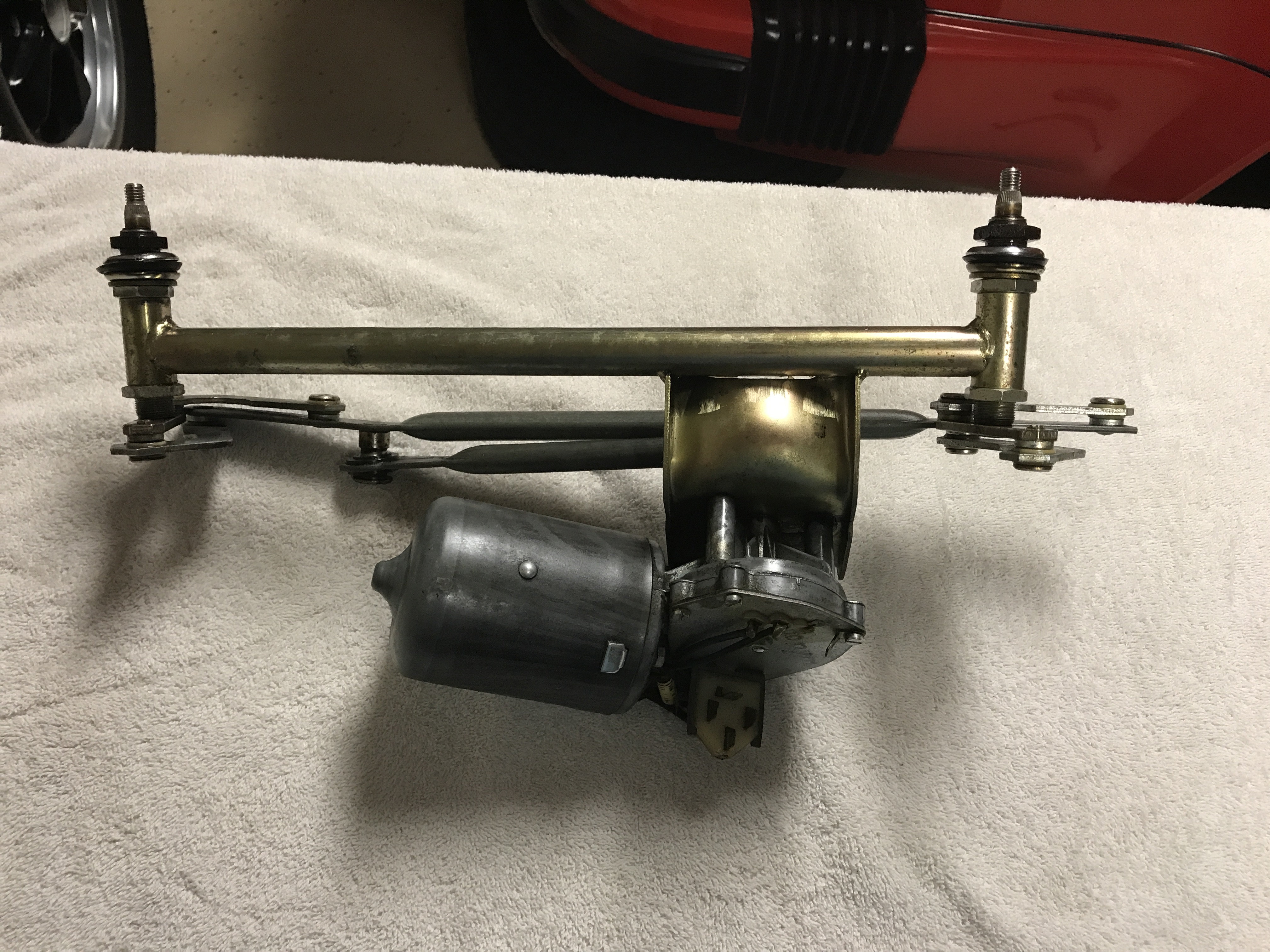

On places that I can't or won't paint I use this. I used it in the rear section of the tunnel from the gear shift to back. On the front part I was able to clean and paint. I used it in the bottom of the floor pan. The wiper assembly was cleaned using it.

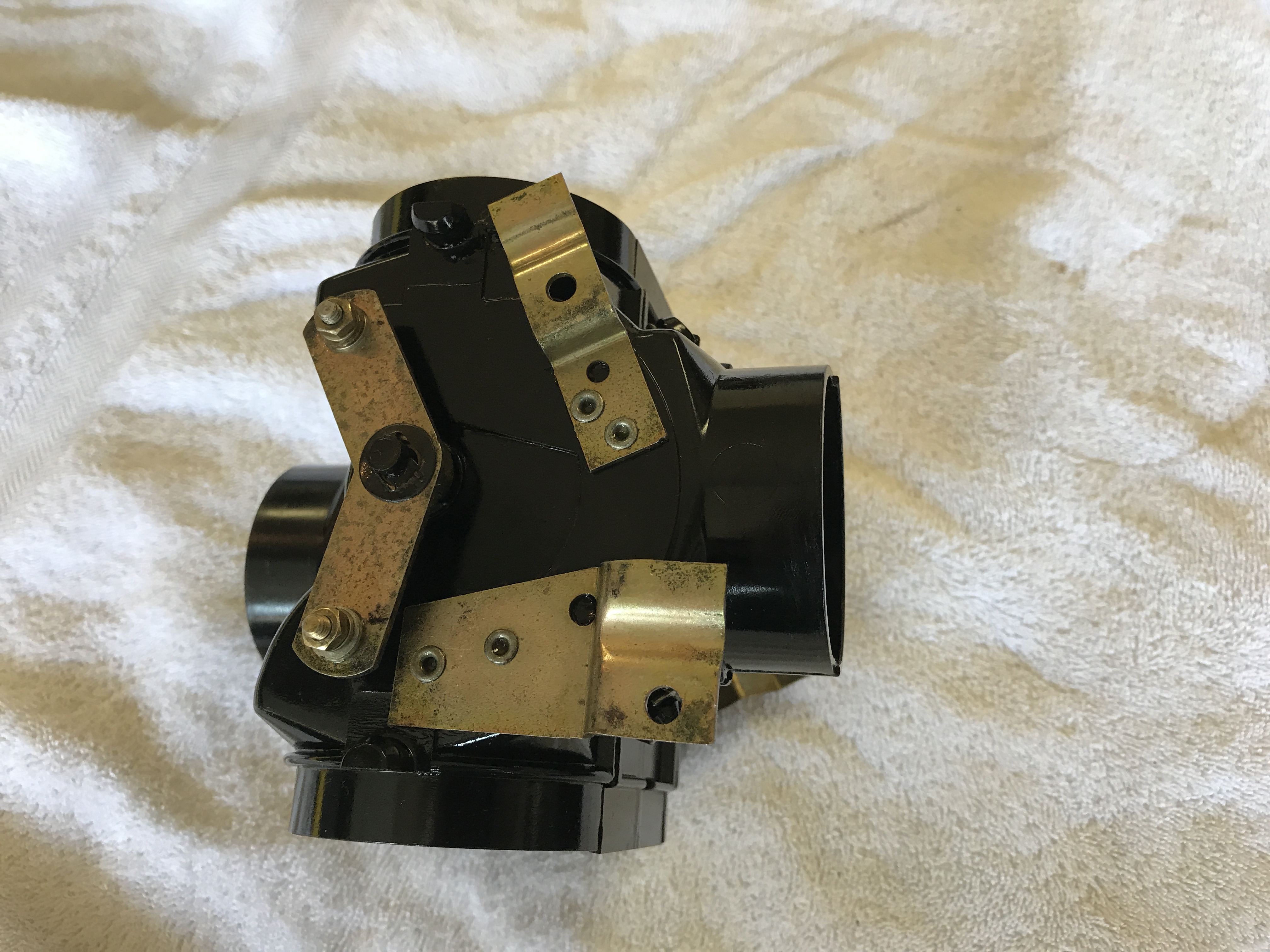

I was putting a little on the metal parts of the valve assembly for the fresh air and defrroster and was surprised to see how it seemed to blacken and clean the plastic. It seemed to work better than back to black and really made the parts look new. The label say it will not harm plastic and I have had it on the air valve for over a week and it seems to stay the same. As of now, unless I hear something else I plan to use it on the air box.. I would like to know if anyone has had experience with this product.

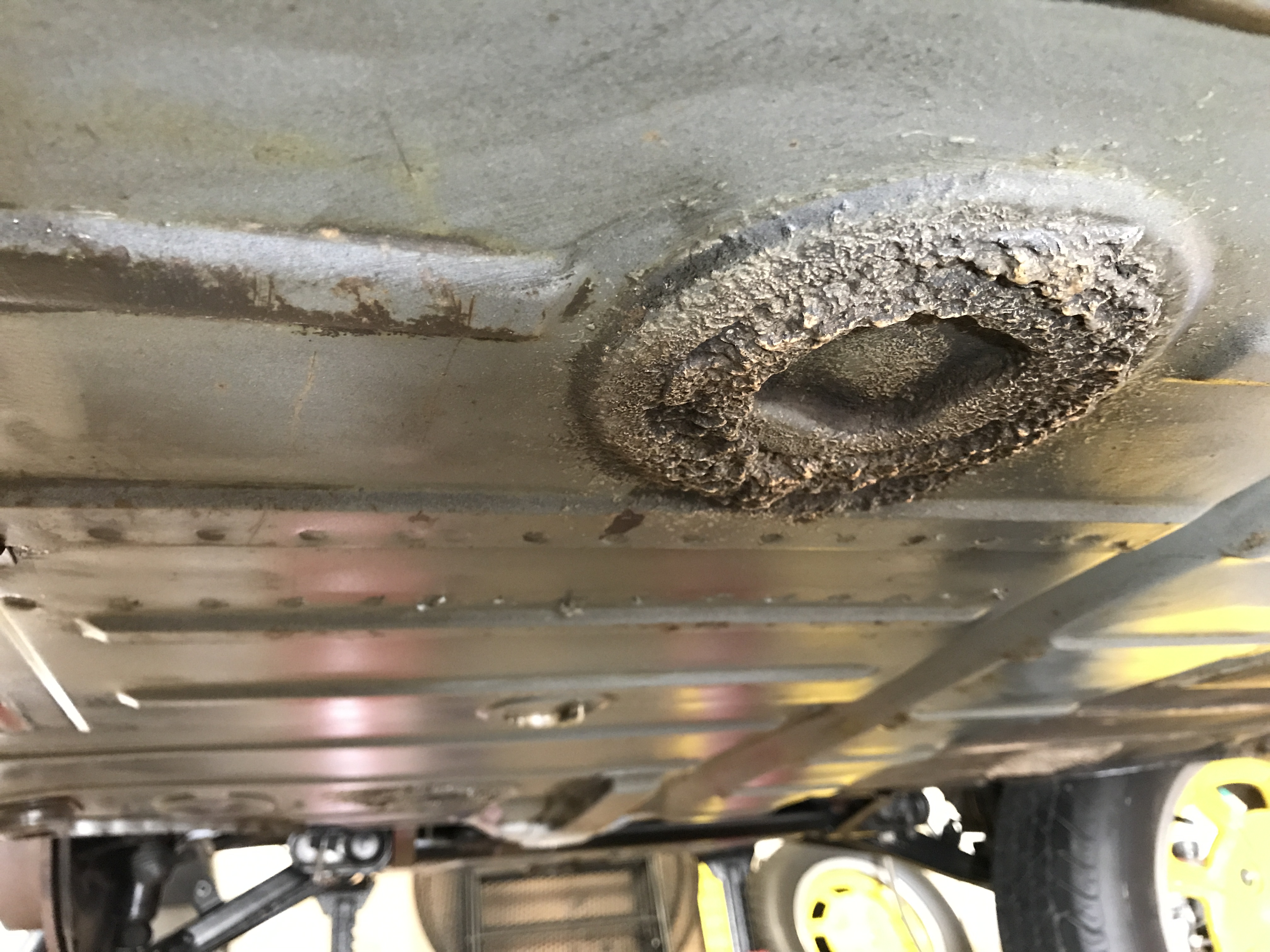

Floor Pan

I try not to use in places or parts that will be painted in the future. After thinking about what to do with the underside of the floor pan for a long time I started cleaning it with paint thinner. It had a coating of a oily type of material on it that came off quite easily There was some surface rust in some areas, but otherwise it was in very good shape. I have decided to leave it as it is with its bumps and warts for the forseeable future. The pan was treated with fluid film which I have read is used in some places as a undercoating.

As mentioned before I used it to clean the wiper unit.
I spray it on, let it sit for awhile and then wipe it off. This has been gone at least 3 times over the last couple of months.

One of my motivations for restarting this is how it seems to clean the plastic parts of the air box and would like to know if anyone has had any experence using this on plastic. It has worked better and easier than any other product that I have tried.

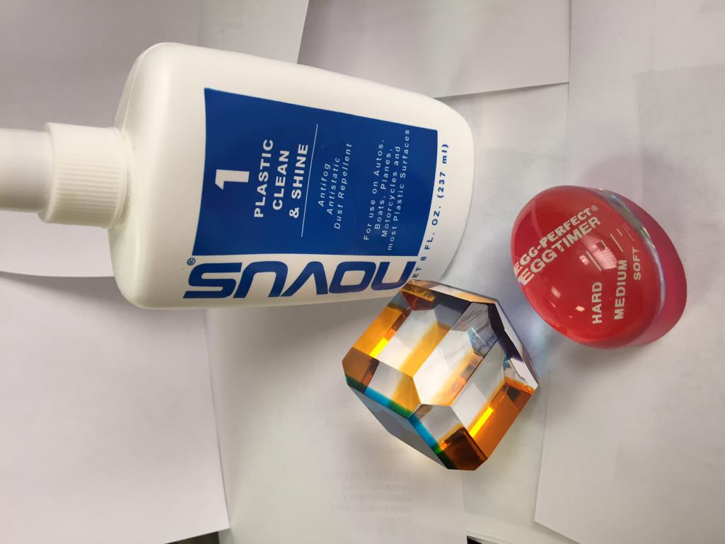

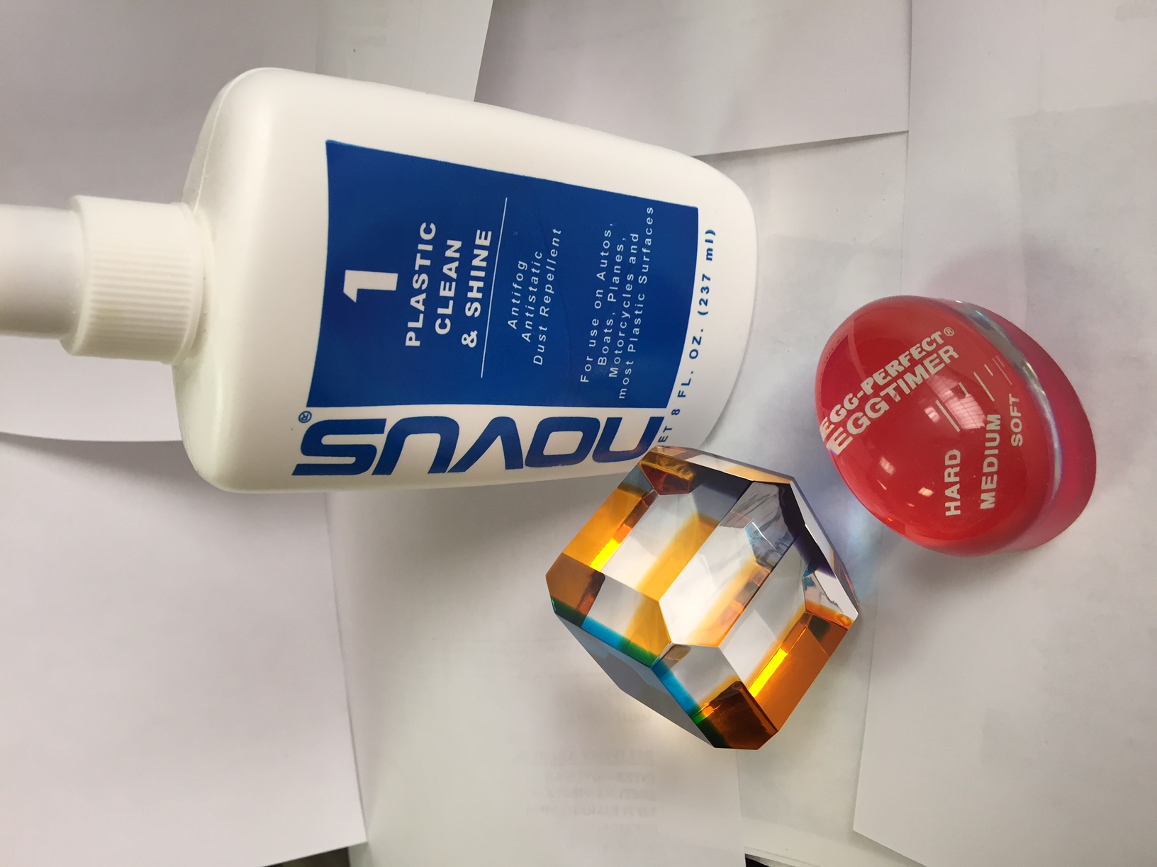

I have been in the plastics biz for 43 years. Finishing and polishing plastic castings. What I have found to be the very best to clean and give the plastic a dust repellent is Novis 1, 2, 3
If you need to remove scratches start at 3 and go to 2 then 1. One looks like watered down milk. Dust really bounces off of a part that has been treated. Warning! If you use Novis the part will not want to be masking taped after treatment. This works great on plastic lenses. I am not a paid spokesperson for Novis. Just a customer that is very happy.
A story. I was bending acrylic sheet over forms after heating the sheet in my pizza oven and after forming the parts, I found little mark off from dust. Someone suggested that I use Novus to make sure that the dust would not be attracted to the plastic. It worked like magic.
