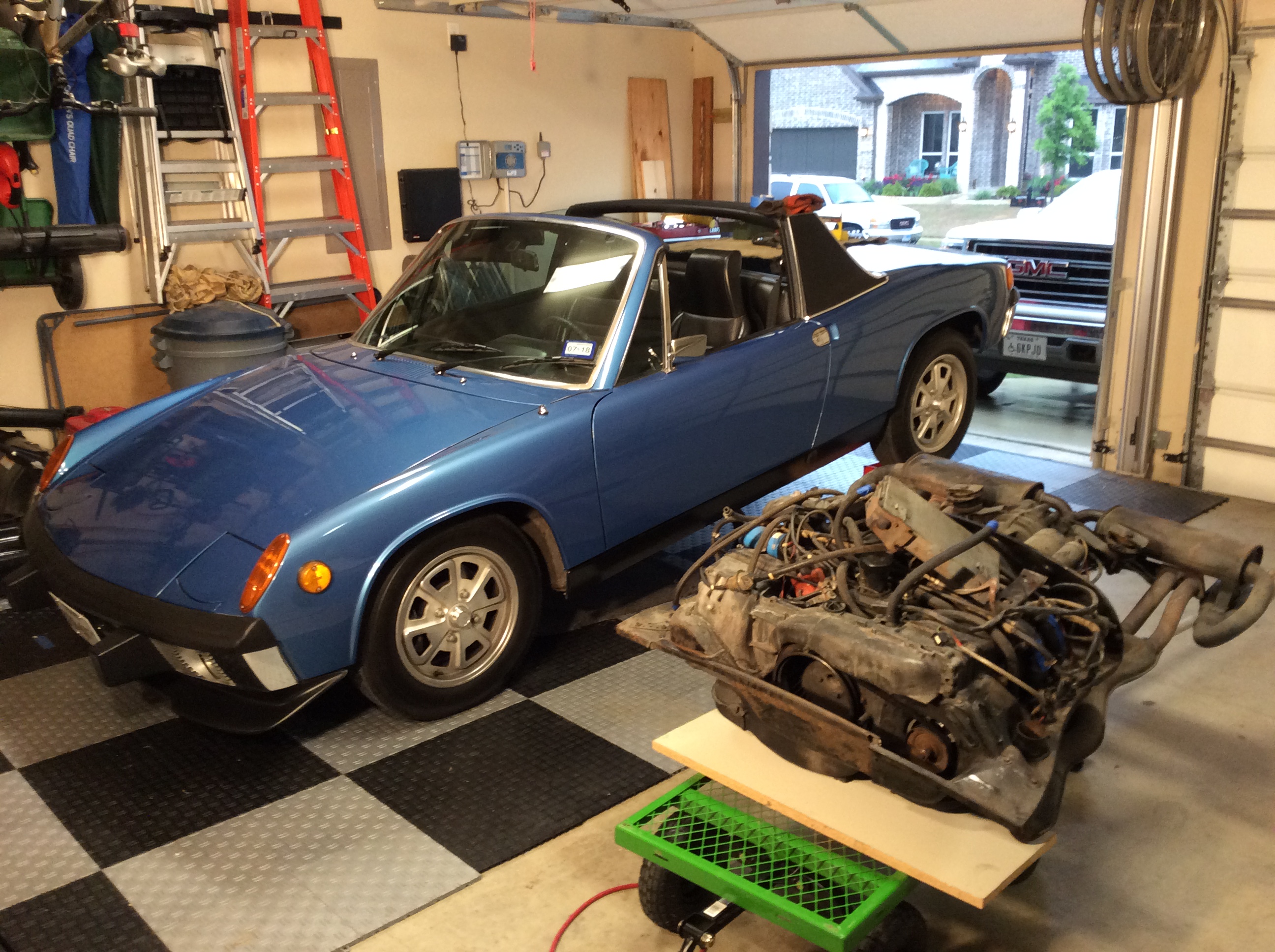

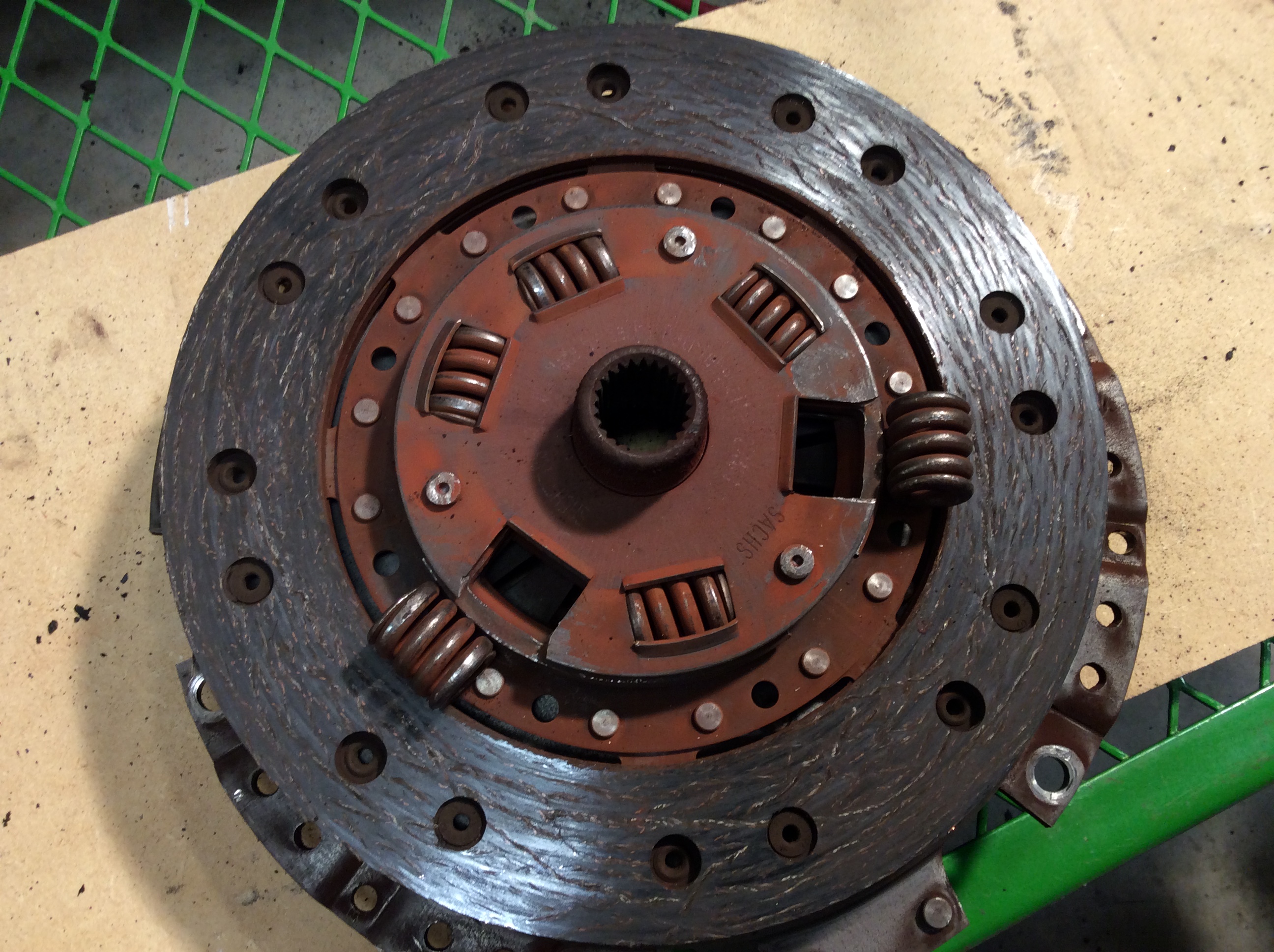

First engine/tranny drop was successful.

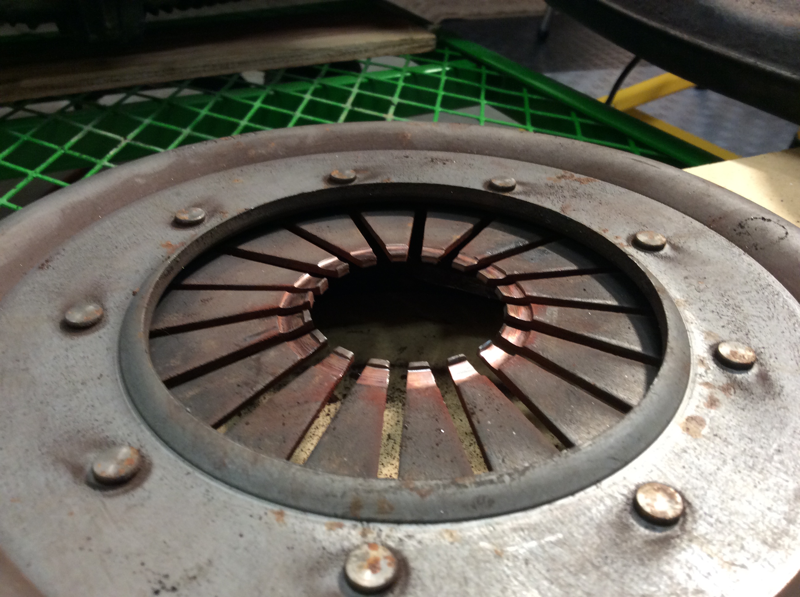

Pulled the clutch and found this...
The adventure begins...

I think you got your money’s worth out of those parts as the pressure plate definitely is worn out and the springs gave up in the clutch plate. Don’t forget to take the chance to clean the engine compartment and engine while it’s out as it’s a lot easier than when it’s installed.

That's messy,don't often see a disk do that,have found weak loose springs before takes a bit for them to break away like that,any damage to the inside of the flywheel?.
Judging by the wear on the pressure plate I would say its on its second (and last) life,make sure you carefully inspect/measure flywheel to make sure it is suitable for resurfacing,post a pic of it that would help,good luck.

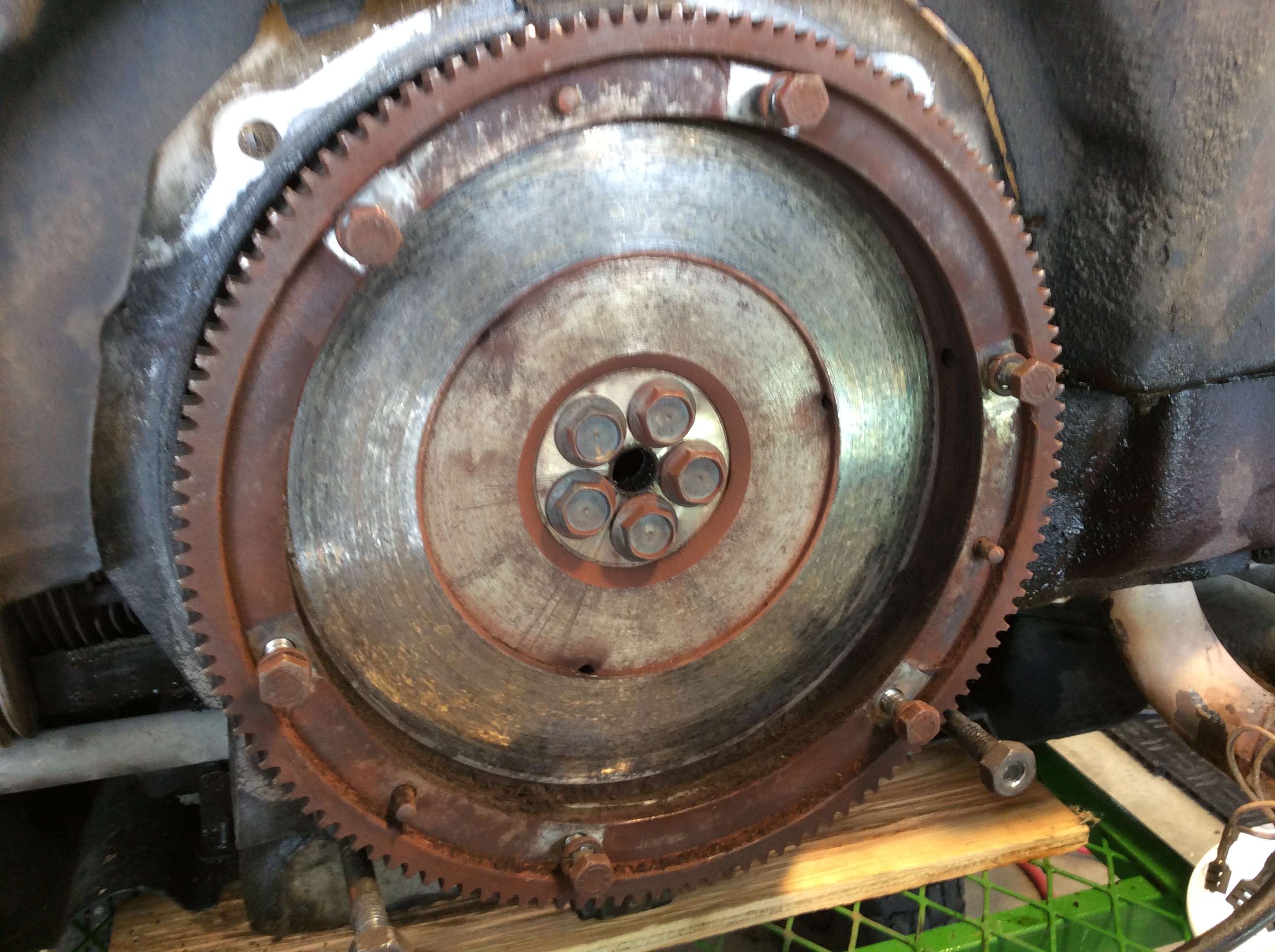

Here’s the flywheel. Plan to remove and have it checked out.

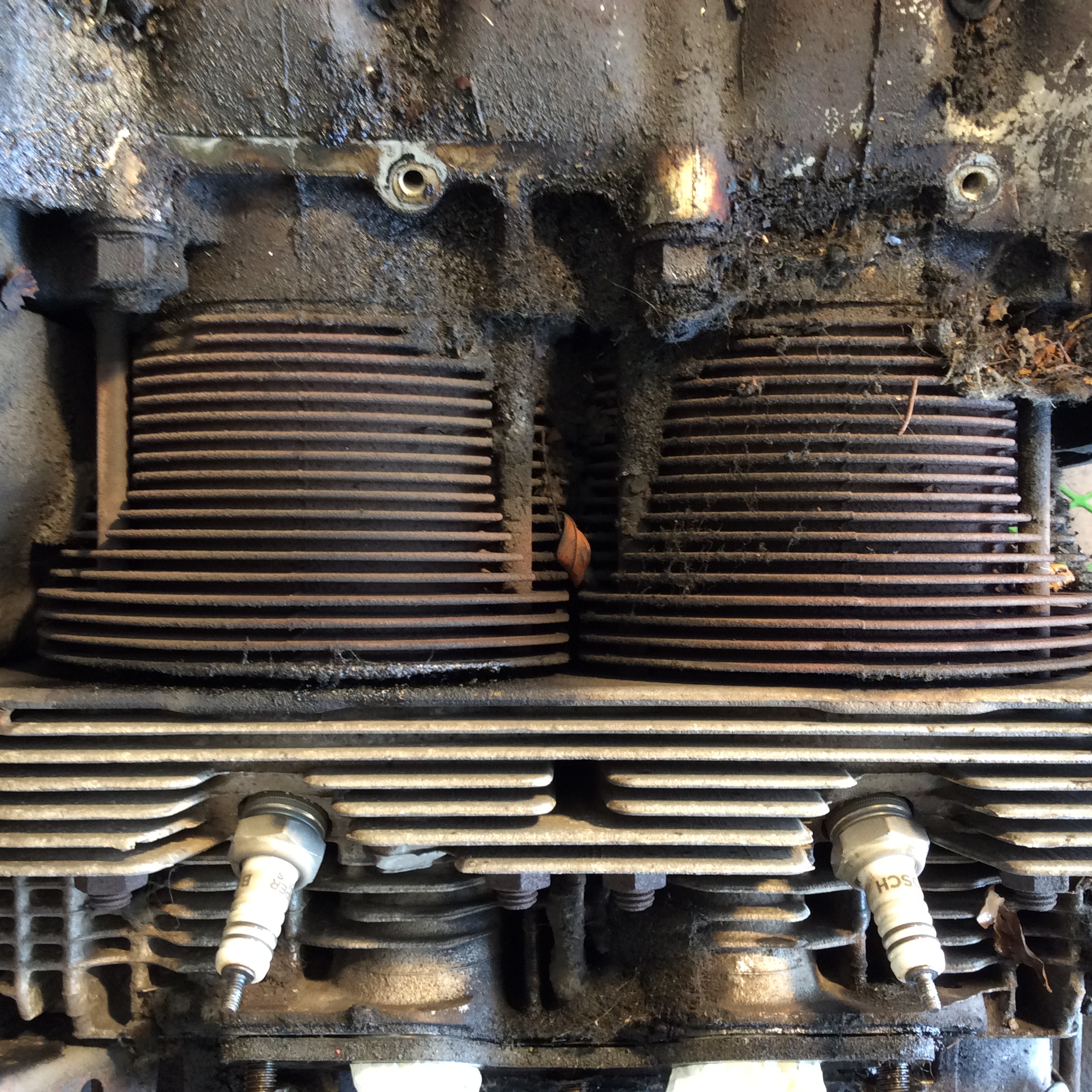

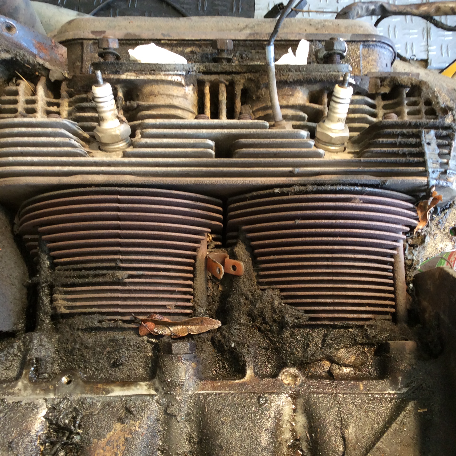

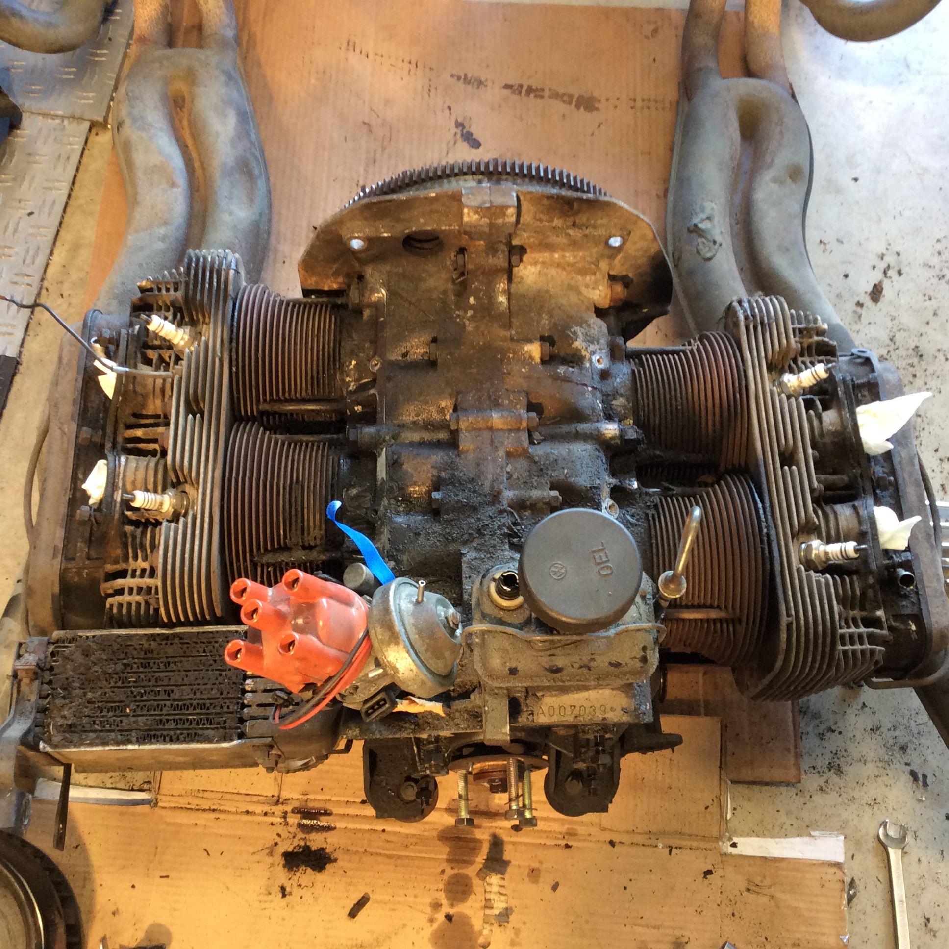

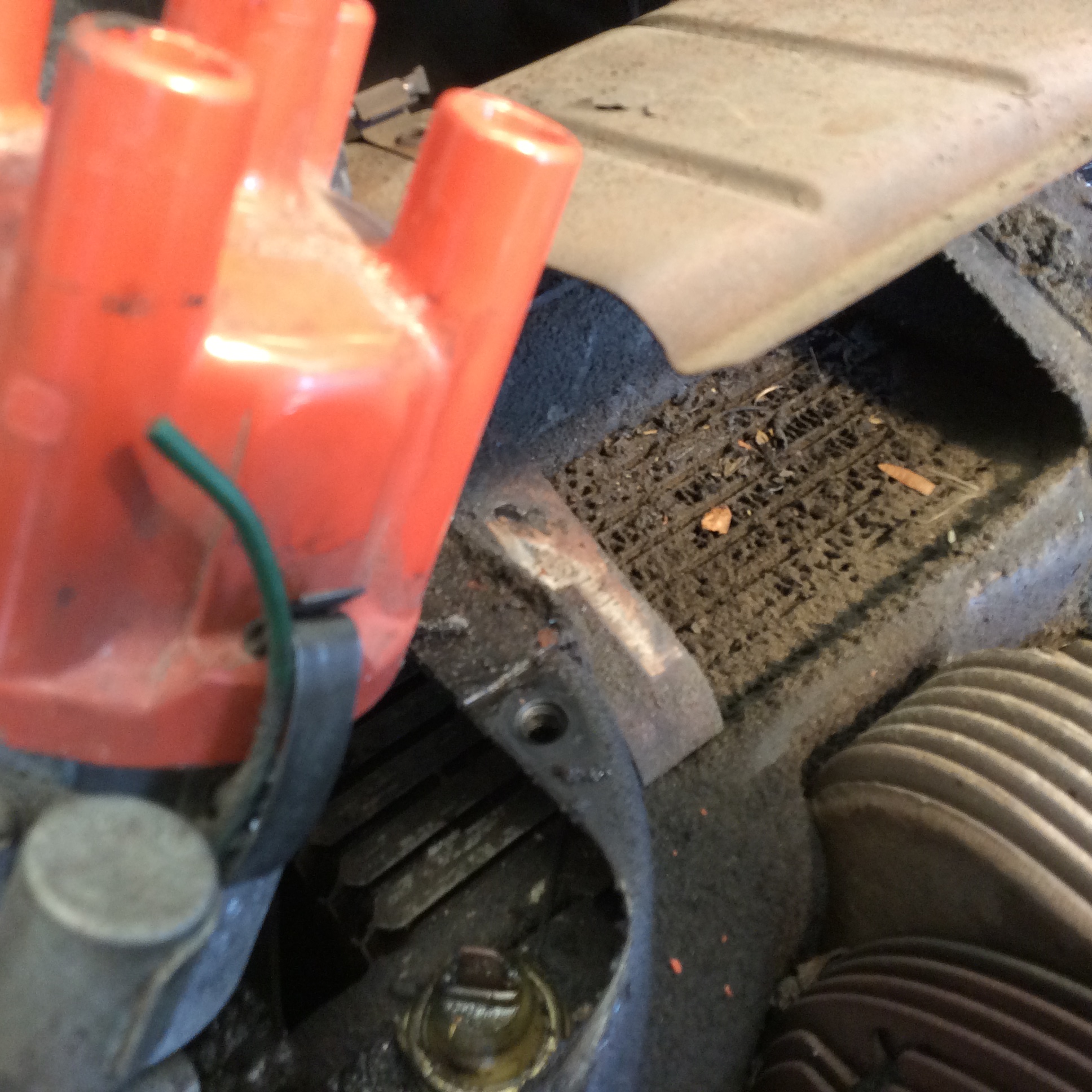

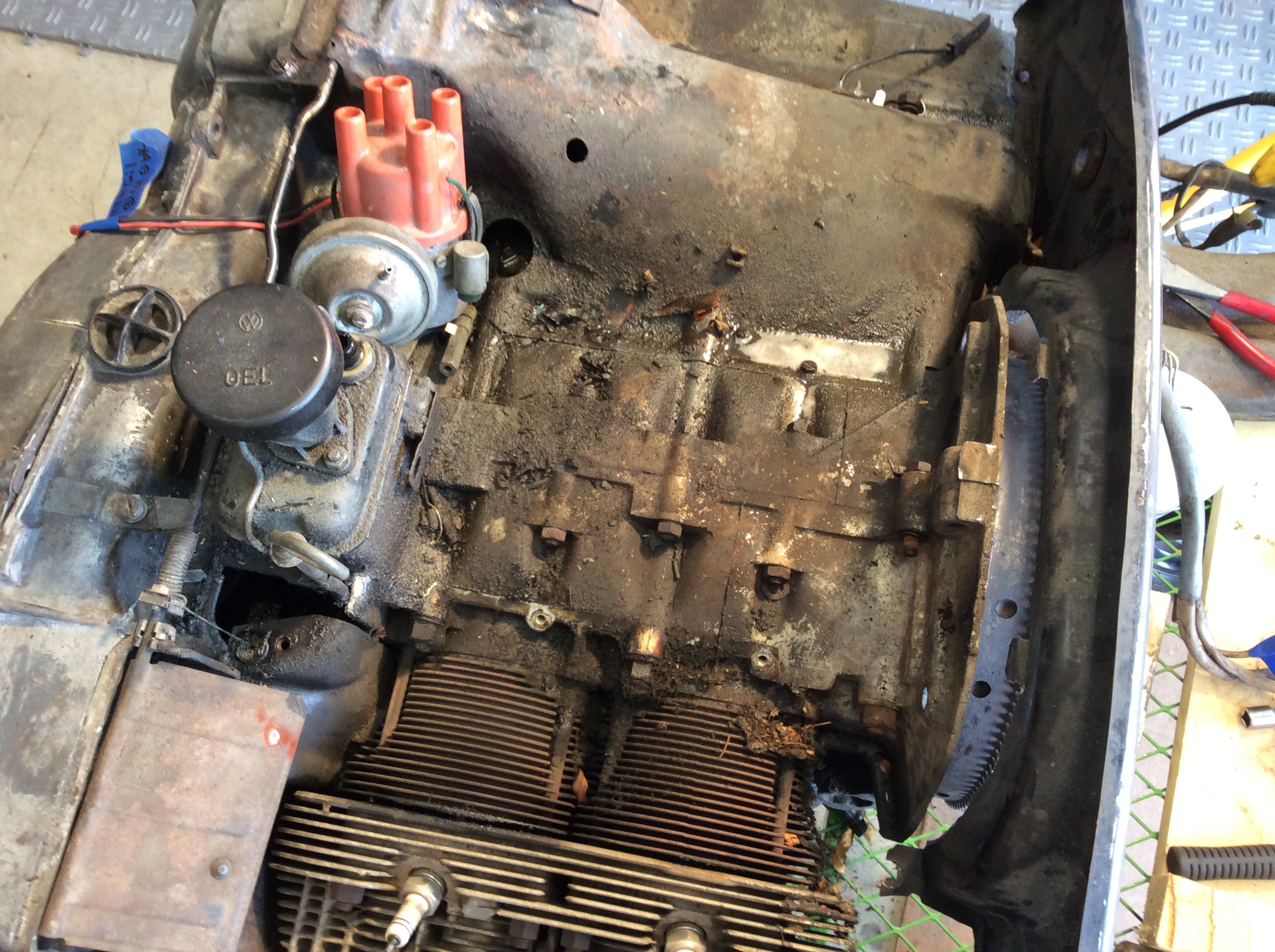

Ok. This is hopefully as far as I will go.
Having trouble confirming the source of all the oil on top as it is literally everywhere. Possibly coming from loose vacuum connections?
Leak on the bottom is from my arch nemesis the taco plate. Pushrod tubes seem to be holding their own.
Looking for thoughts on how best to clean all the crap off and out of the fins??
Can the oil cooler be cleaned or is it a lost cause?
Thanks.

QUOTE(loco914 @ Apr 22 2018, 07:04 PM) *
Thanks.
Some oil is over the tin, some under.
I'd do OP switch, every seal on the oil filler tower and check the seals on the
cooler.
Make sure your crankcase is vented properly.
Get the cheapest piece of 4' x 8' plywood and a gallon of mineral spirits
and get busy with any brush you can find. The filth will transfer from the engine
onto you.
Find some plugs for the cooler and wash it with mineral spirits, it will come clean.

QUOTE(loco914 @ Apr 23 2018, 06:12 AM) *
Learning that engine tin screws can be quite stubborn (IMG:style_emoticons/default/headbang.gif)
Ok flywheel appears ok,any ridges you can feel on the surface with your fingernail generally means it will need to be refaced if still in spec.
You can hit on the top the engine tin screws with a hammer and punch then use an impact tool on them ,if the slots are chewed out use some visegrips on them as a final solution.
To clean the long block completely seal off the inlet/exhaust ports ,etc,buy lots of decreaser and brush it on with a wash brush,let it soak it then hose or waterblast off.
If it was my engine I would take the cooler off after you have cleaned the block and have it ultrasonically cleaned,they get really dirty inside also.
Do all seals on the engine "while in there" you will thank yourself later (IMG:style_emoticons/default/beer.gif) .

You are going to run much cooler with all the motor smeg cleaned off.
If you pull the flywheel make sure you use a Sabo seal. Don't score the seal bore or you can make an oil leak.
You want a full flywheel package and replace the pilot bearing and felt washer too.
The plate under the flywheel bolts is a one and done, so make sure you get one of those too.

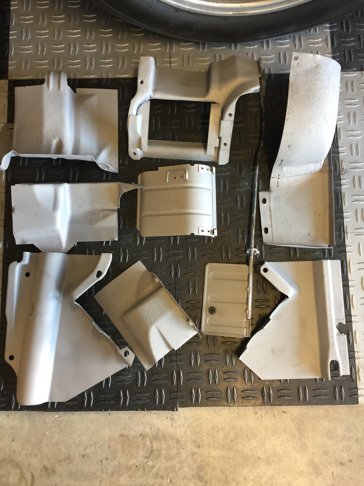

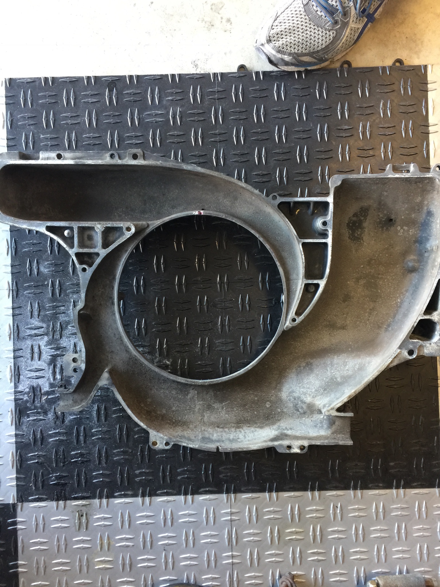

A little progress last night and today. Got the muck off all the engine tin and got some pieces blasted. Using medium glass beads and it seems to work well.
Thinking about painting the impeller housing any thoughts? Still a ways away as it doesn’t want to let go of 44 years of crap. Could blast as well, but figure it is too soft for glass. Would walnut shell media be good for this? (IMG:style_emoticons/default/confused24.gif)

A good clean on the housing you will be good,if you really prefer paint you have to clean more,total clean after prep with paint pre cleaner,heat it up a bit then apply etch primer let that dry for while (slow to dry) and apply few coats of Plasticote high temp wheel silver,its kind off a a mid gloss and looks great.

There are 1-tins that sit right against cylinders. Use high temp paint on those as powder coat could melt.

Regarding oil cooler. They are not expensive. I got new one at busdepot.com (I went with genuine be part, they also sell aftermarket).
Here is my housing cleaned up and painted with Eastwood alumablast.
