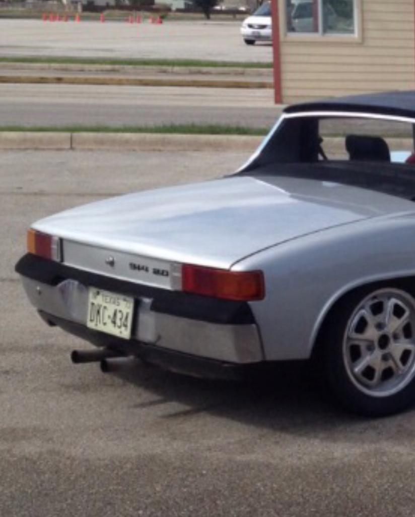

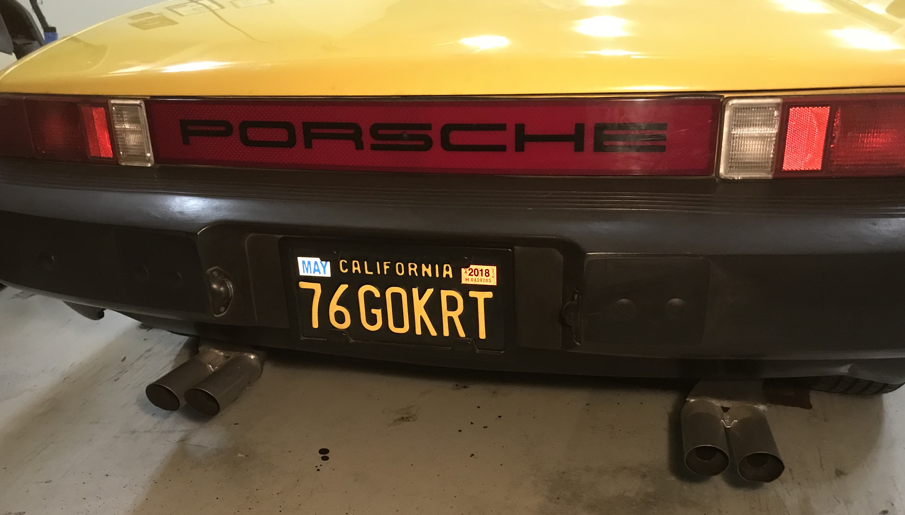

Hey Doug, I have a 76 2.0, is this the look you wanted? It came to me this way long ago, but I think it's a Monza exhaust. Performance is great, love the look too. (IMG:style_emoticons/default/piratenanner.gif)

Not that I don't like the above set up, but it's a little more Italian looking than I'm after for my 2.0/4, I actually have a very similar unit currently in my spares parts stash from a 1.7 car I recently purchased.

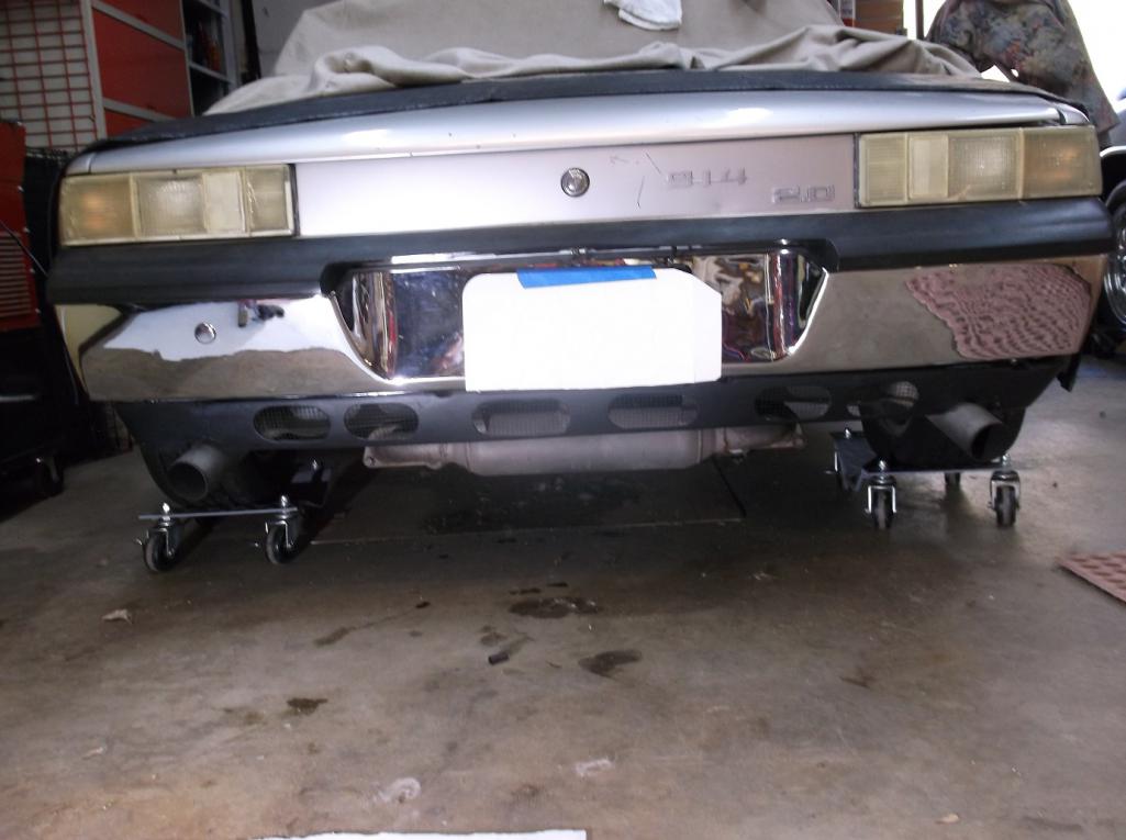

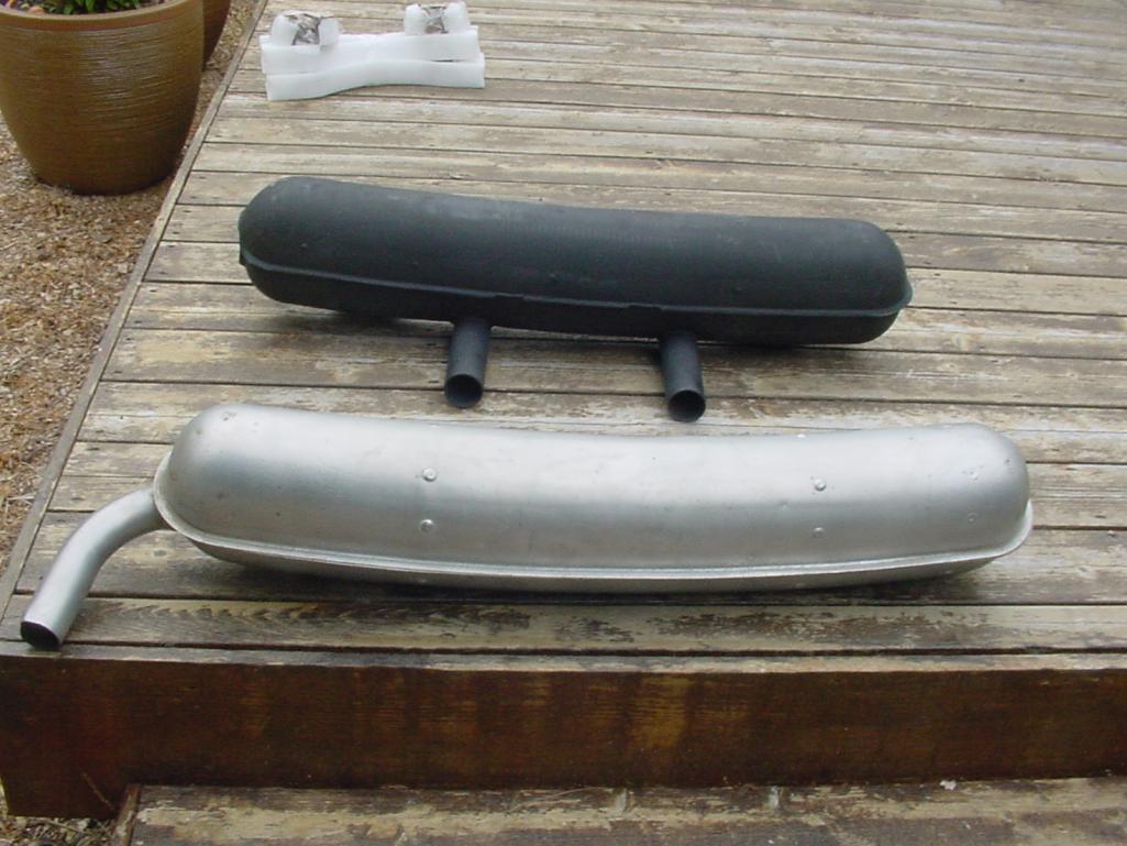

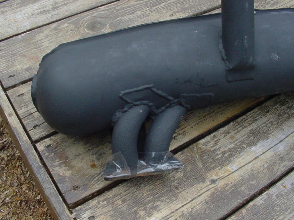

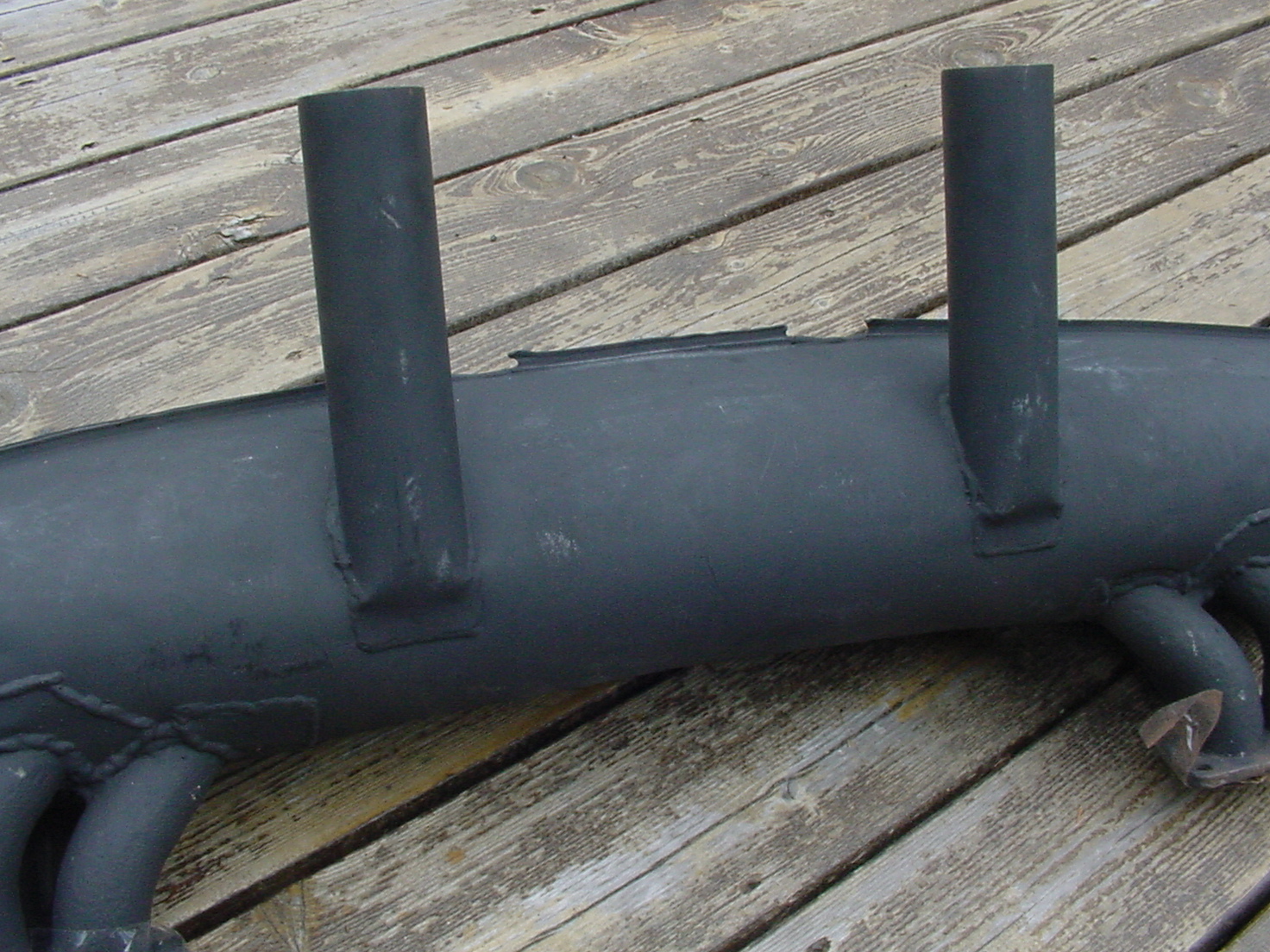

Just make one out of a stock 2.0 muffler. Here’s one I made maybe 20 yrs ago that is still on my car.

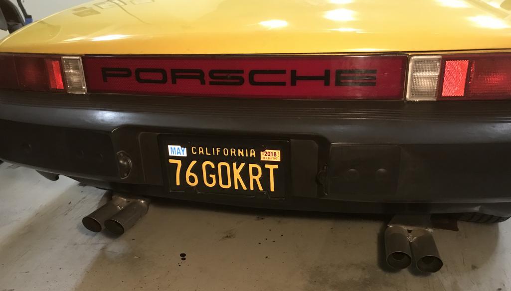

I did a special one similar to your search, for Tom Roth(troth). He might have posted a pic or two, not sure.

QUOTE(CMONNETT @ May 23 2018, 02:59 PM) *
I like this, got any details on what exactly you did to it ? (IMG:style_emoticons/default/smilie_pokal.gif)

troth
post May 24 2018, 05:09 AM
Posts: 160
Joined: 17-August 16
From: CT/WA
Member No.: 20,305
QUOTE(Racer Chris @ May 23 2018, 04:25 PM) *
QUOTE(Dougster @ May 23 2018, 12:52 PM) *
The tangerine unit is an option I guess but the pipes curve and exit out the sides, from what I can tell.
I’ll post pics and dimensions after work today. Looks good, but more importantly sounds great. (IMG:style_emoticons/default/wub.gif)

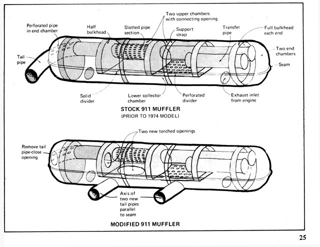

This picture has been floating around sport muffler threads in the past.

QUOTE(maf914 @ May 24 2018, 05:08 AM) *
This is the 911 muffler and earlier in the thread someone asked if there was a reason it could not be installed on a 4 cylinder 914. I know the inlet pipe flanges are different from 6cyl to 4cyl.
