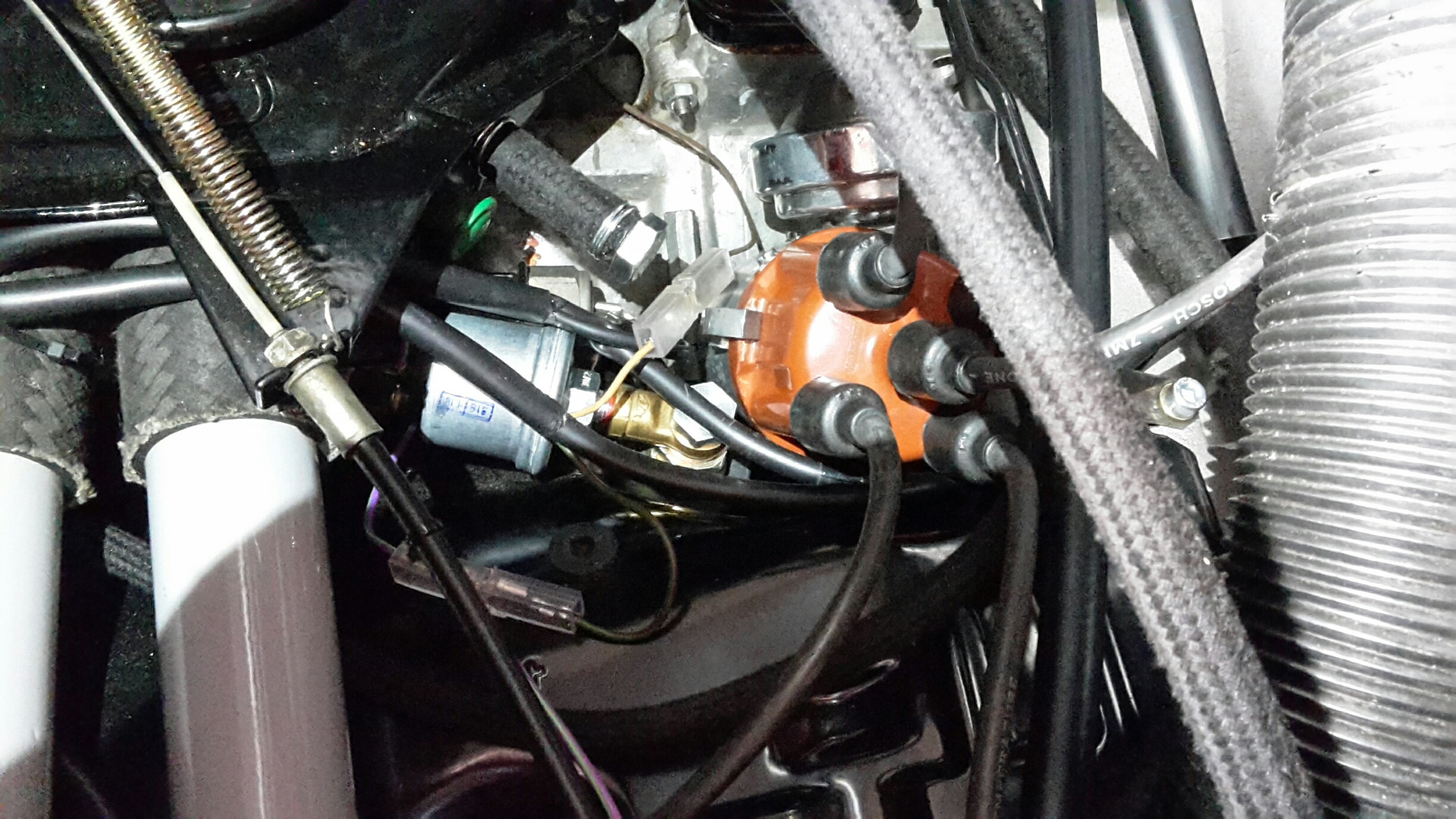

Here's the sensor mounting.
I took the tuna can off but I cant see anything wrong really. (I've got the Jonesy version)
With the bolt that holds the can in place...
The heads are vented to a catch can along with the vent on the oil filler tower.

As you have asked how others have mounted the pressure sender, here a pic of how I did it:
Cheers,
Frank

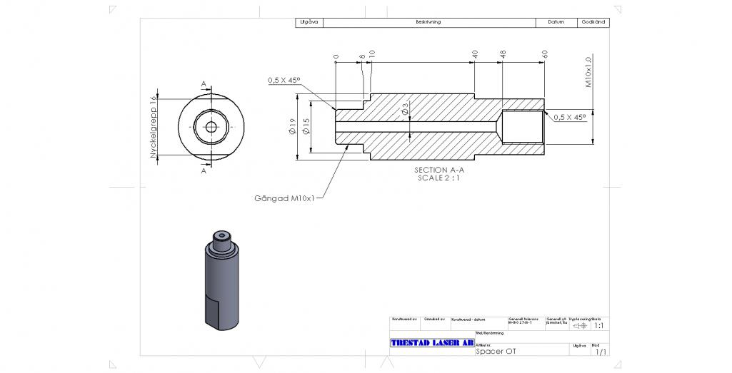

Thanks Frank. I'm toying with the idea of having the CNC guys at work make me an adapter on the lathe that will raise the sender up out of the engine tin hole.
falcor75
post Jun 12 2018, 10:46 PM
Posts: 1,579
Joined: 22-November 12
From: Sweden
Member No.: 15,176
Heres what I'm thinking of having made. (IMG:style_emoticons/default/smile.gif)
