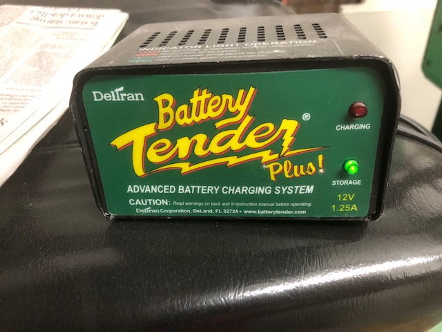

I solved the problem!
I tried using a jump box. Nothing. Tried jumper cables. Nothing. It occurred to me that it must be a connection somewhere, since when I connected the battery cables, the CD player cycled and I could cycle the fuel pump when I turned the ignition. It was just the starter that wasn't engaging at all.
1. Battery cables were not connected tightly.
2. Loose connection on hot start relay.
Car fired right up when I corrected these issues.
I did buy a battery tender to keep the battery charged while the car is sitting.
Thanks to all for your input!
