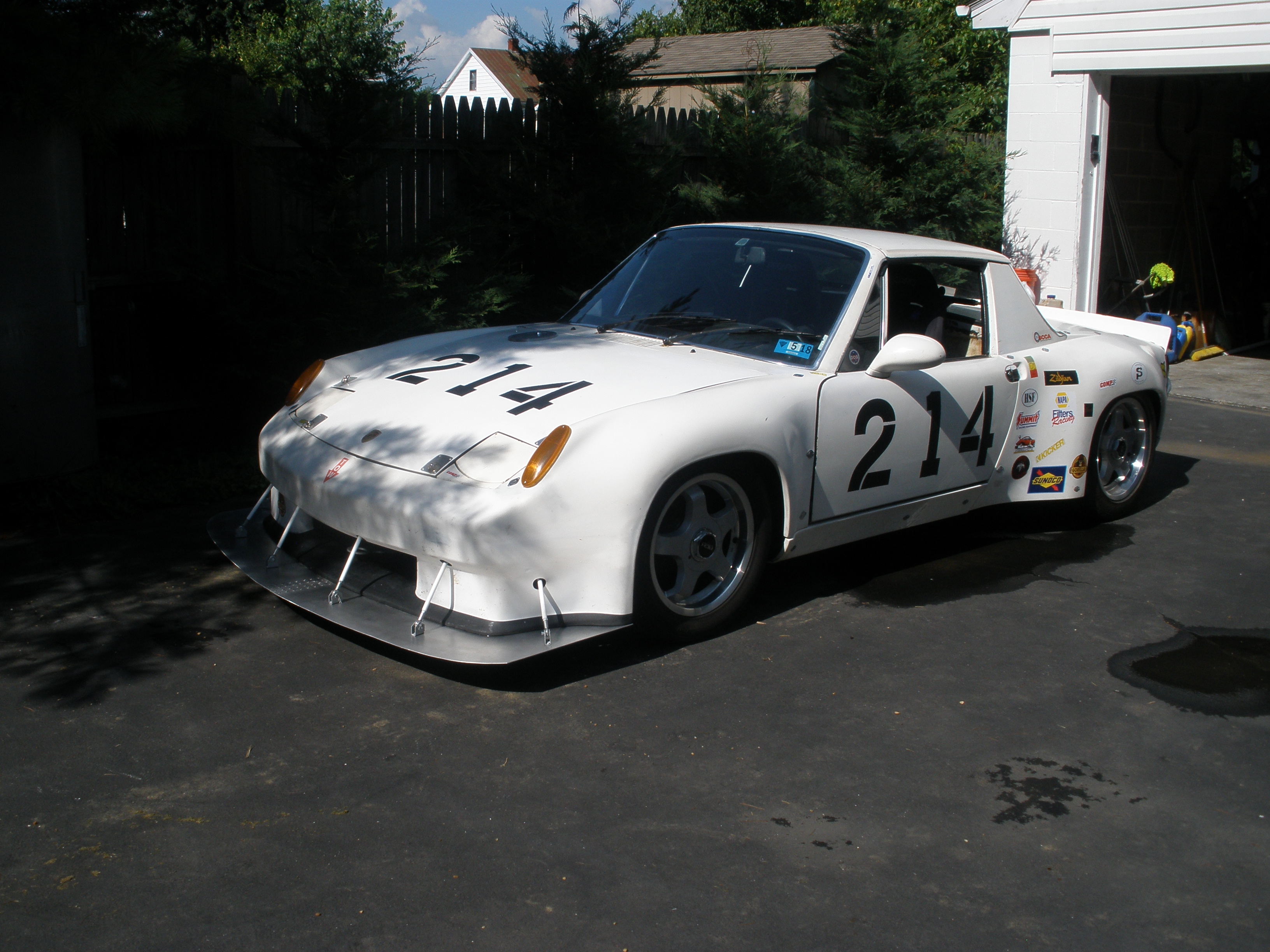

Negative 3 for my sbc Sheridan Standard Wide body for Summit Point bracket class
