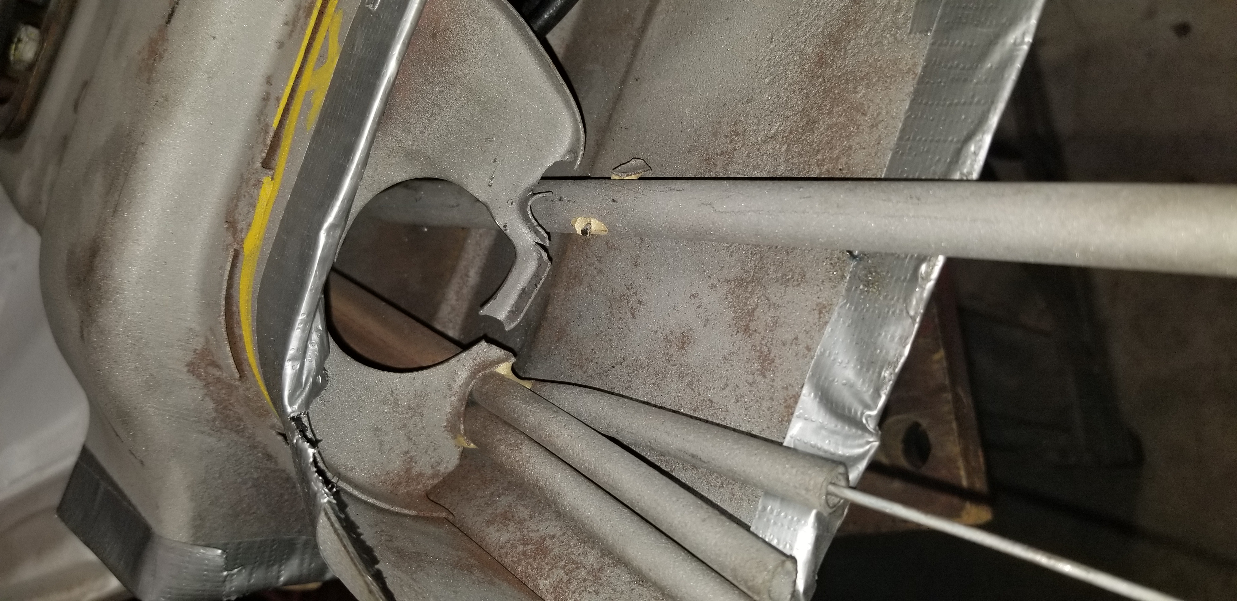

I woul have guessed it was a broken clutch tube. Can you see if the middle clutch tube support is in tact? A small mirror should let you see. Here is a cut -a - way of the tunnel showing the middle attachment.

Thanks Bruce ,guess this should be rechecked as it was a while ago ,it could have broken away since then ?.
My cable is a Gemo brand I got from Pelican,will report back when I get time to do it, (IMG:style_emoticons/default/beerchug.gif) .
