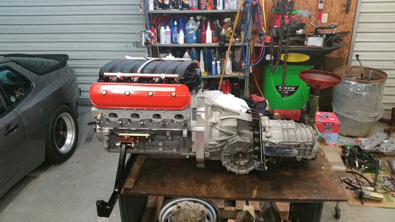

I have a 2006 Cayman S G86-21 trans in my car. It shifts great, once you get the cables adjusted properly.
I don't like the trans mount in the last picture. That cantilevers the transmission mounting points, so eventually it is going to break. The mounts bend up under hard acceleration, and down under engine braking. That puts metal fatigue into them. If you are using a Boxster shifter, everything should hook up with the cables. Mine are custom so I can keep what looks like a factory shifter.
Here are some pictures of the mount in my car.

Any pictures of what trans mount Renegade Hybrids is using??
Joemo5
post Oct 5 2019, 10:33 PM
Posts: 54
Joined: 1-April 18
From: Charlotte, North Carolina
Member No.: 22,011
QUOTE(partwerks @ Oct 5 2019, 11:50 PM) *
I'm pretty sure it's the one that Cracker is using, shown in the pics above.

1) If there IS one downside of the Renegade mount it is the weight (50 lbs!!!)...it is waaaay overbuilt. I've attached another pic installed...breaking off and fatique. LMAO (IMG:style_emoticons/default/lol-2.gif)

I'd bet that Tony has the market cornered on stress testing the Renegade mount. Between the LS3 and now the LS7, and the serious pace he runs on track, his mount has seen stresses that exceed what a typical street car will see.
Also, there are any number of LS-powered Renegade-based cars out there and I don't believe there are reported failures. I could be wrong, but I haven't heard of any.
Could other designs be "better"? There's always room to improve and Clay's is very nice. If one is a skilled fabricator, or has access to one, then sure, go for it.
But so far, so good on the Renegade design. I'll report back if I have any problems with mine - which has a 1.5" spacer added to it. So I'm likely the best test case for the "too much cantilever" study.

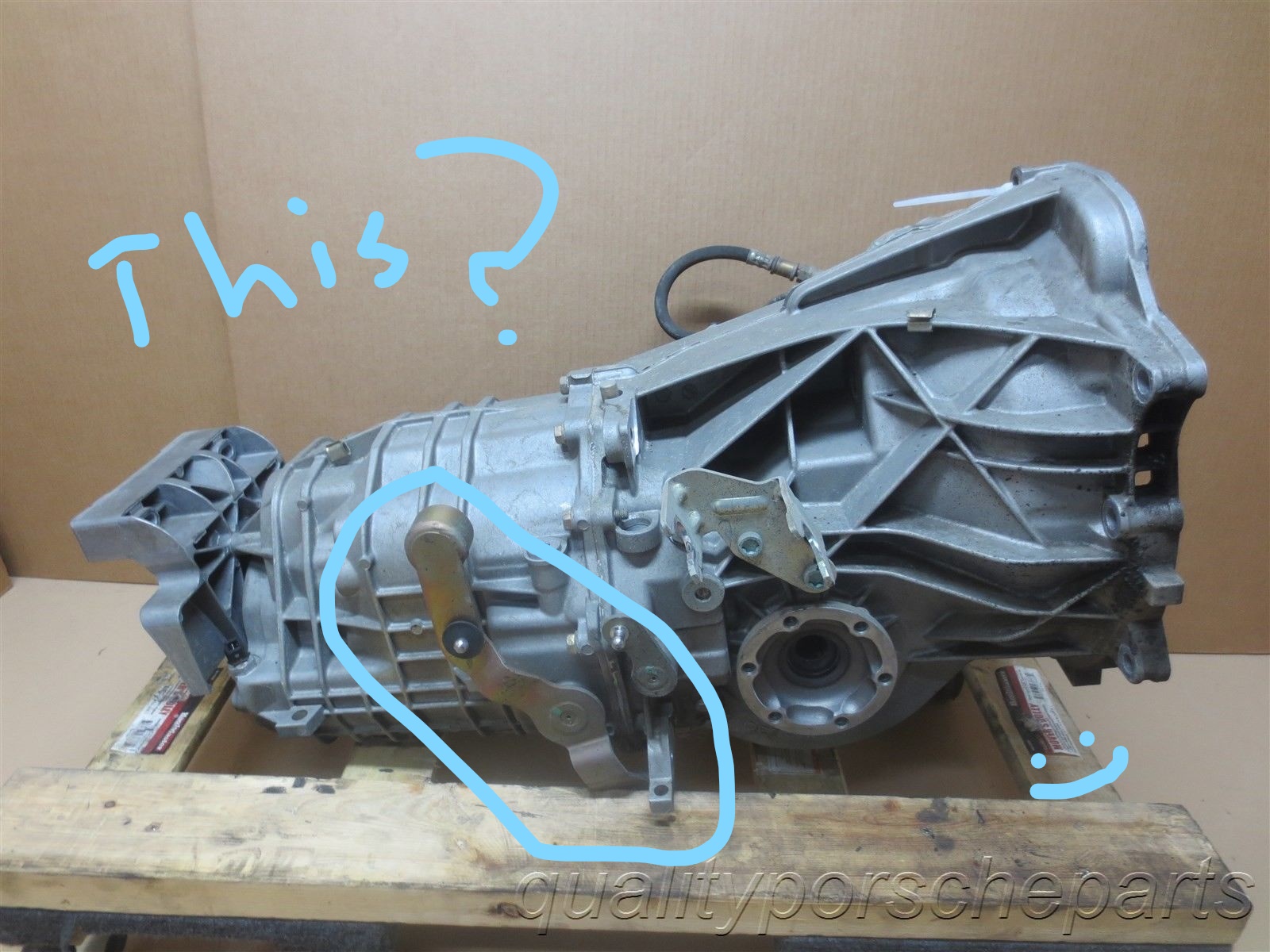

What did each of you do to address the shifter linkage that is attached to this transaxle?
Most transaxles when purchased have the linkage missing, such as mine, and to replace with new factory parts is over $500.
Finding those parts used appears difficult, and there appears to be no after market solutions available. If you can provide a solution or resource it would be a big help.
I'm contemplating building a engine transaxle cradle to simplify installation and removal of an LS/G86 20 combo, but need to resolve the linkage issue.

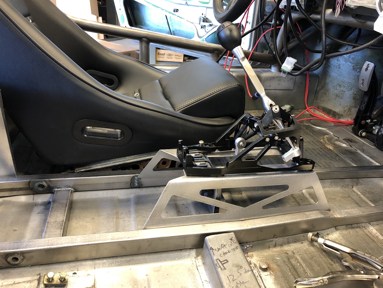

Lyle - If you mean the shifter and associated cables, you can get a stock Boxster S shifter and cables on ebay for under $150. Here's one that's available now.
I splurged and got a Numeric shifter and cable set up. Not cheap, but super neat-o!

What is the numberic shifter?

Tony and Clay,
The parts that I'm referring to are in this diagram, minus the cables -Attached Image

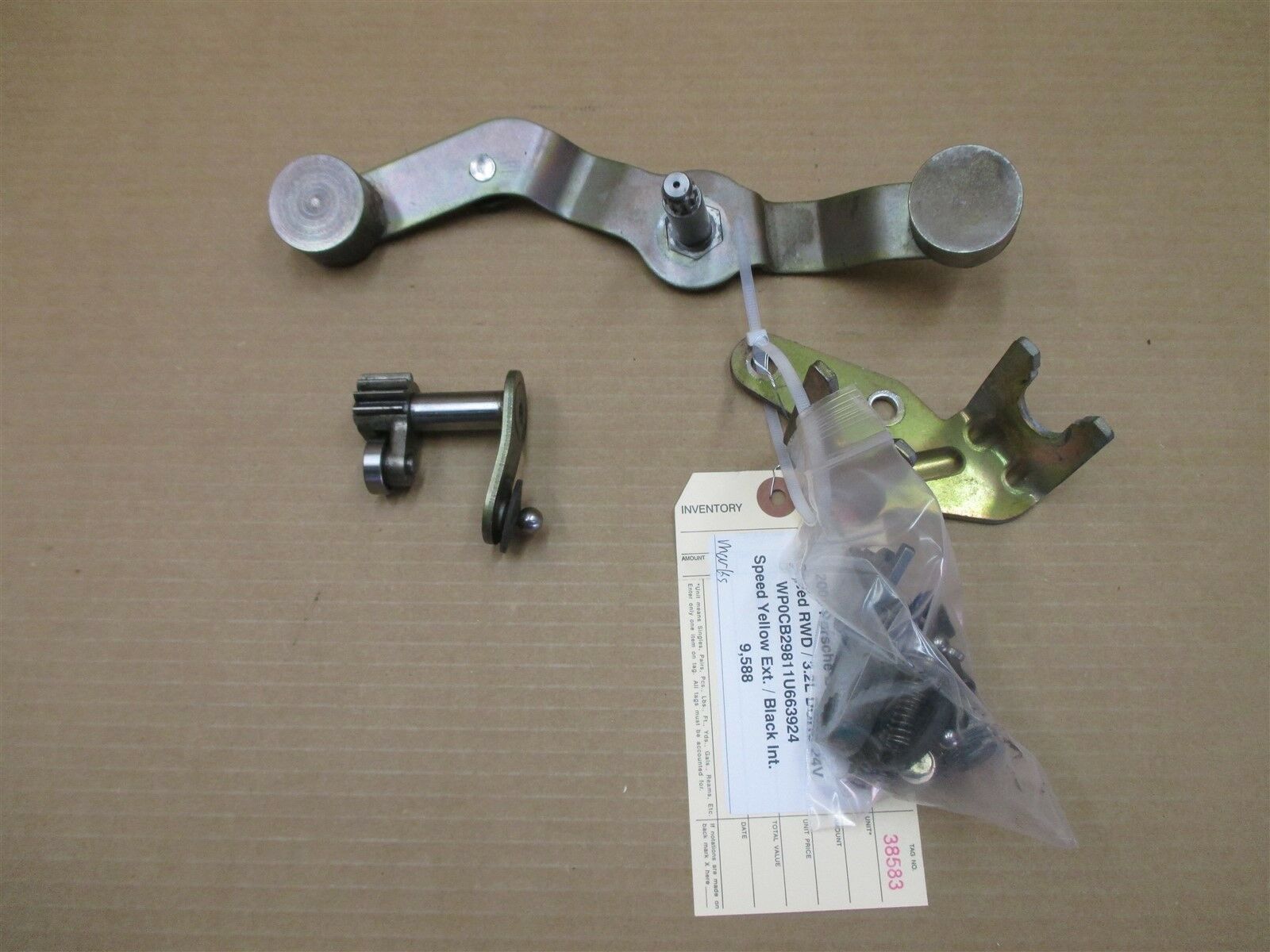

Member No.: 897
Tony,
I have the shift linkage indicated in the second photo minus the cable bracket, which can be bought new for about $40.
What I don't have is in the first photo, which is needed per the PET, from what I can see.
Am I wrong?

The G86-21 transmission has different cable attachments. And they all came with the transmission, so I didn't have to buy anything extra.
I had to alter the cable attachment points because they interfered with the starter. From the factory the cable pulls the bellcrank which works the left/right gate selection. That cable now runs across the top and pulls directly on the arm without any bell cranks.
(IMG:http://www.914world.com/bbs2/uploads/post-1143-1566359350.jpg)
(IMG:http://www.914world.com/bbs2/uploads/post-1143-1566697652.jpg)
Doing that prevents using the stock boxster/cayman shifter.
For a V-8 car, you wouldn't have to do this, so the stock shifter would work.

This is the Numeric shifter.
