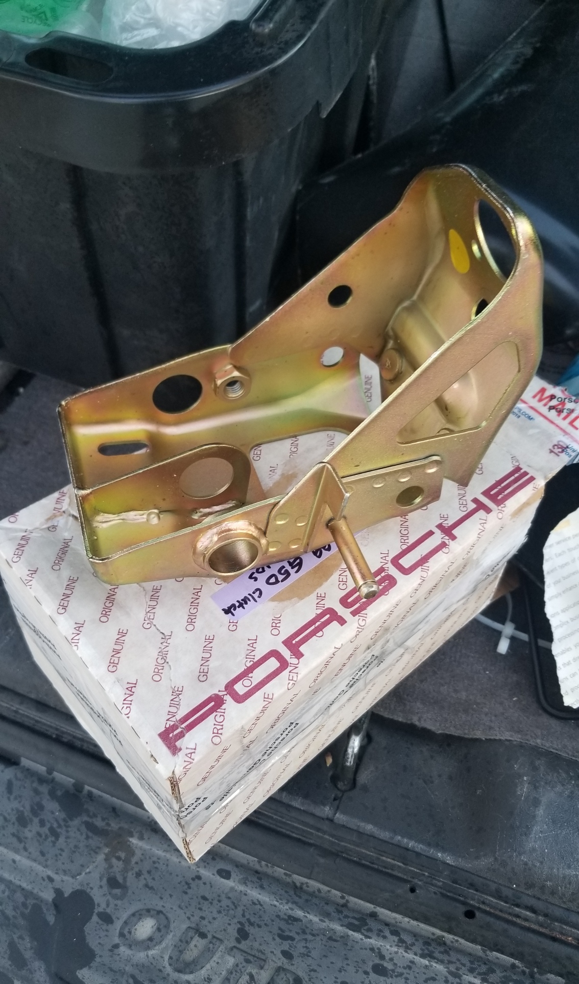

G50 PEDAL HOUSING

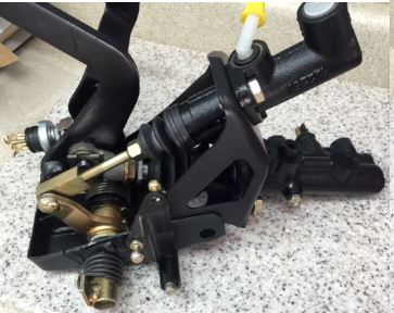

Another dozen parts and some extra fabrication and you can have a factory hydraulic clutch set-up with non power brakes for 914-6

QUOTE(76-914 @ Oct 8 2019, 08:03 AM) *
And your plans are....................................................... (IMG:style_emoticons/default/confused24.gif)
Belongs to a customer for rebuilding his rusty pedal set.

QUOTE(aturboman @ Oct 8 2019, 10:06 AM) *
And it won't fit into a 914 pedal box. Not enough room for the clutch master to clear the front wall.
Been there, done that.
Plus, the clutch master won't work with anything but a G-50 trans. It's too small for a Boxster/Cayman trans. Done that one too....

QUOTE(76-914 @ Oct 9 2019, 07:02 AM) *
Offhand, what is the diameter of the slave cylinder?
Small. I estimate 15mm. I have one at the shop I can measure. The size of the master is related to the slave that can be used. If you are thinking about a hydrogen. Clutch got Summit Racing and look at components.

@76-914 date='Oct 9 2019, 07:02 AM' post='2753391']
[/quote]
The G50 master is 19mm
