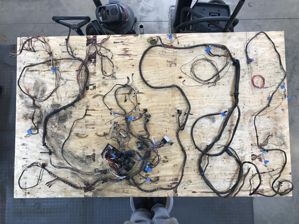

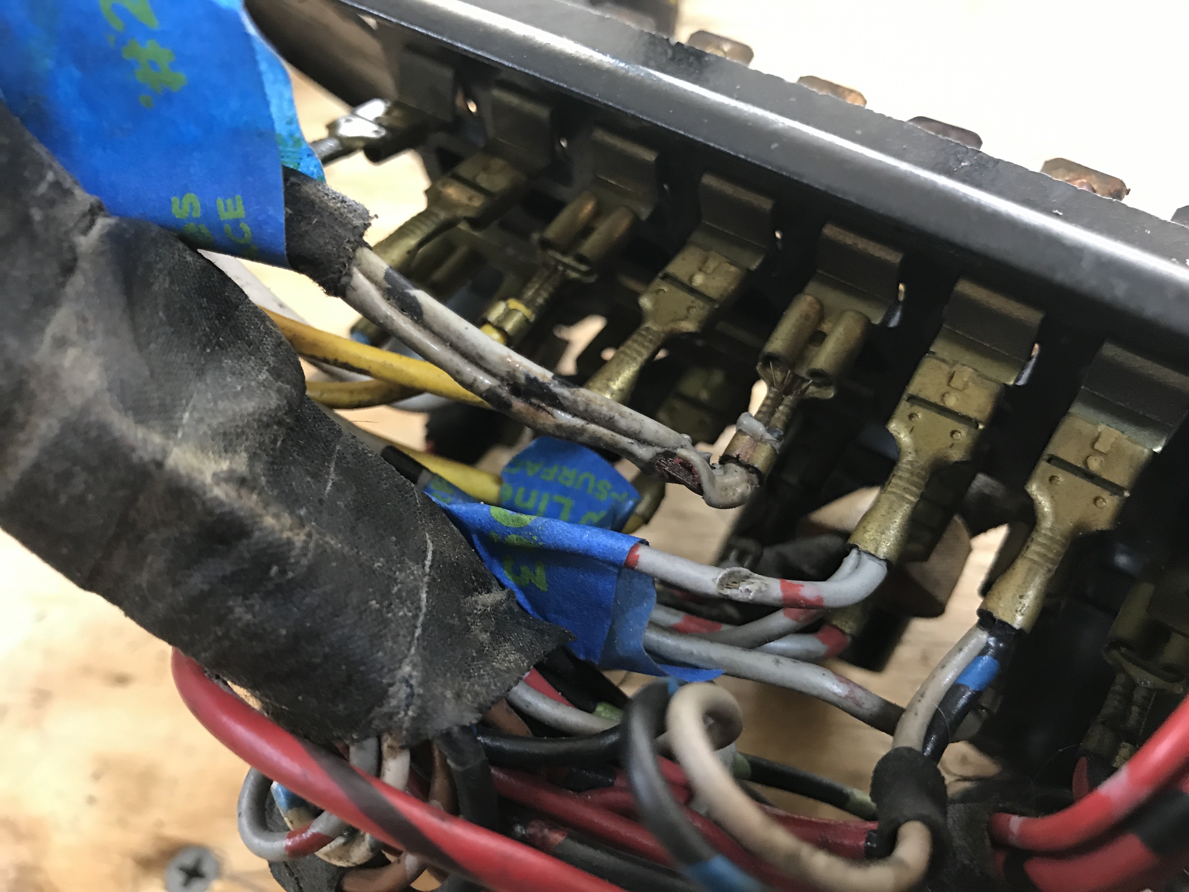

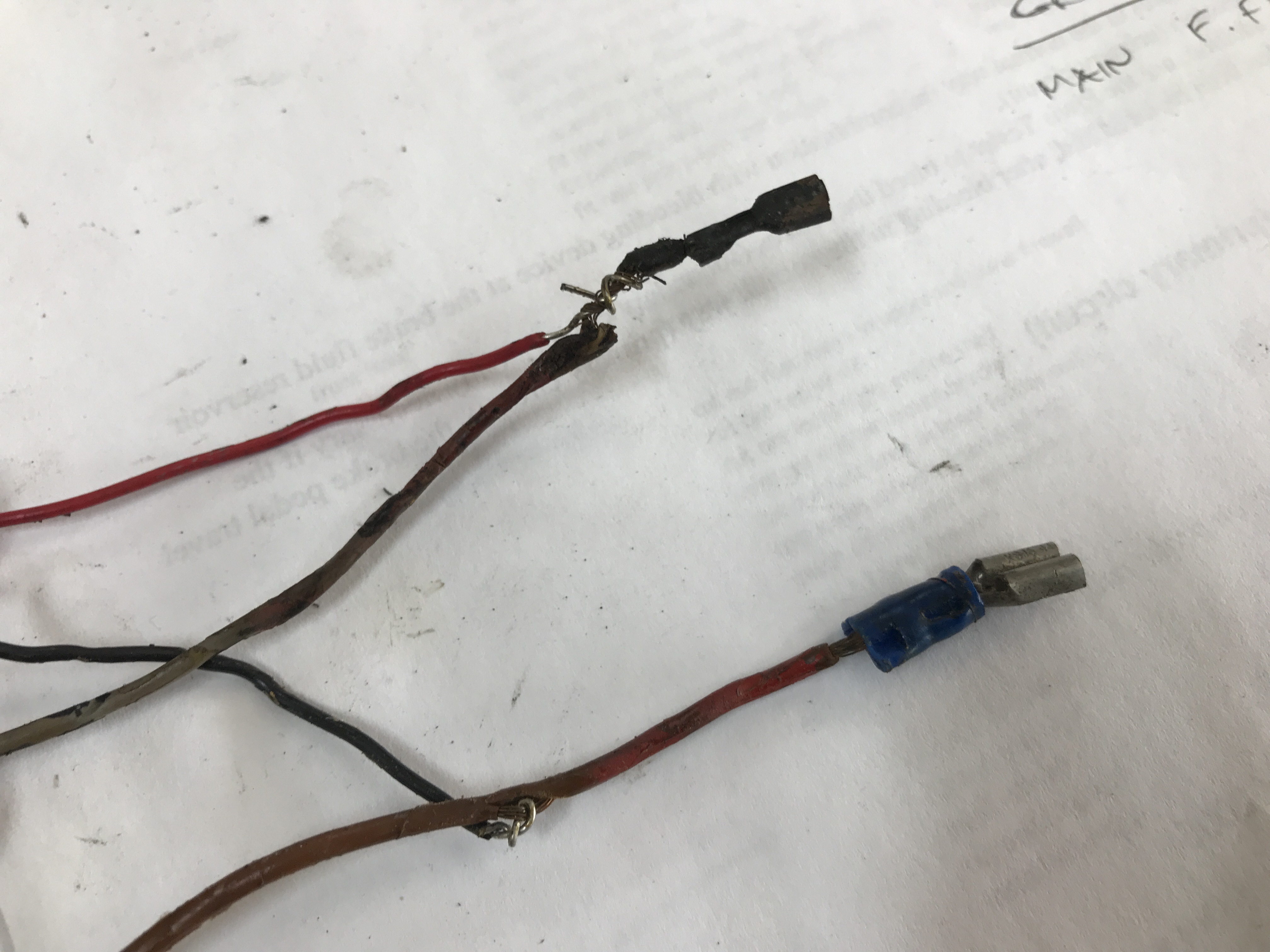

I finished my main harness survey today, and found more "minor" problems.
Here's some evidence of a short circuit and some melting insulation.
post Aug 1 2020, 08:05 PM
Post #1042
Posts: 8,342
And, hiding under some old tape, evidence of high quality PO mods.
post Aug 1 2020, 08:06 PM
Post #1043
Posts: 8,342

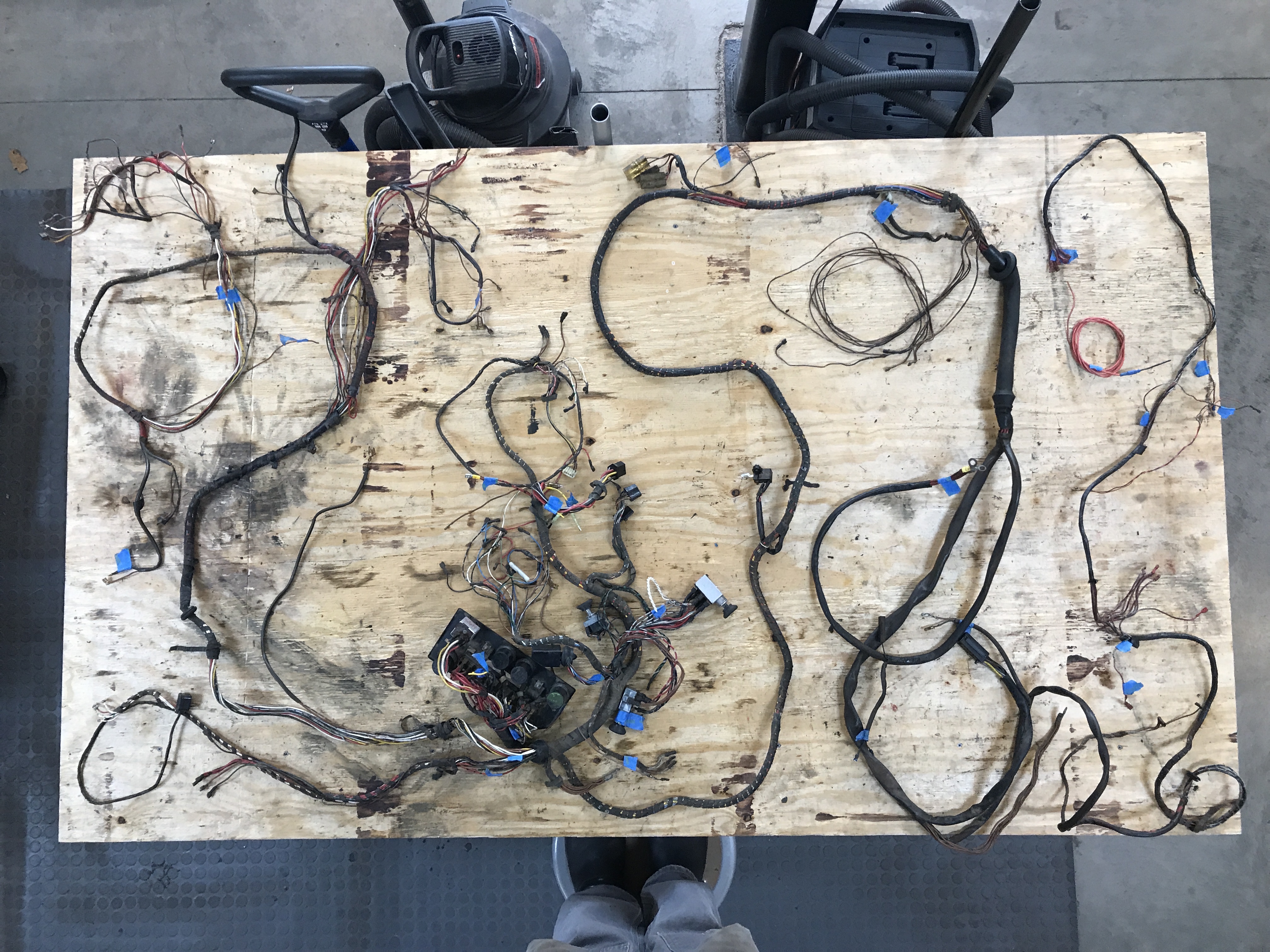

Altogether, I found 30 problems to repair (so far). Look for the blue tape.
djway
post Aug 1 2020, 11:33 PM
Post #1044
Posts: 787
Joined: 16-October 15
From: Riverside
Member No.: 19,266
QUOTE(bkrantz @ Aug 1 2020, 07:03 PM) *
These are the areas I like to use the 3 to 1 marine grade shrink tube.

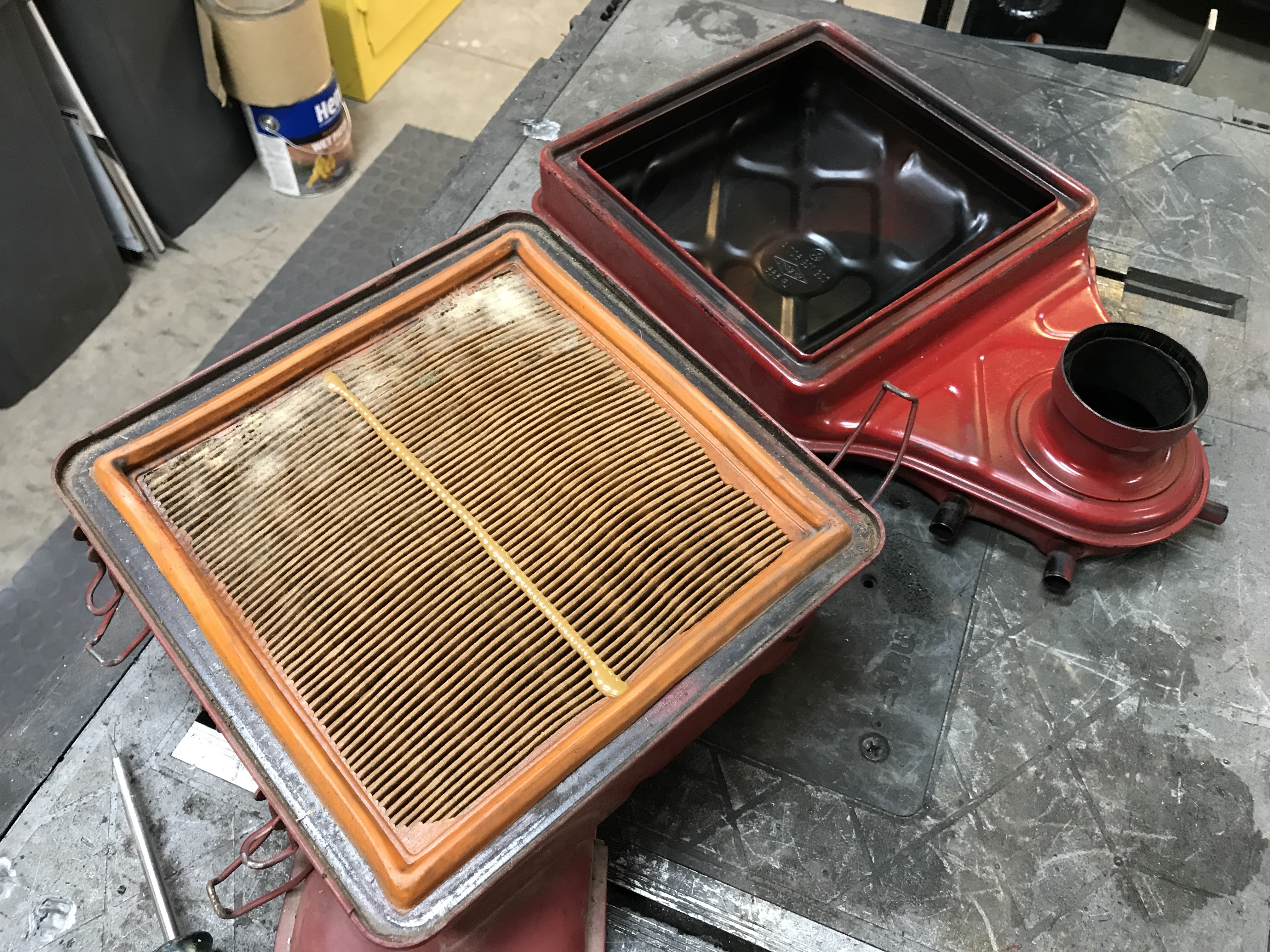

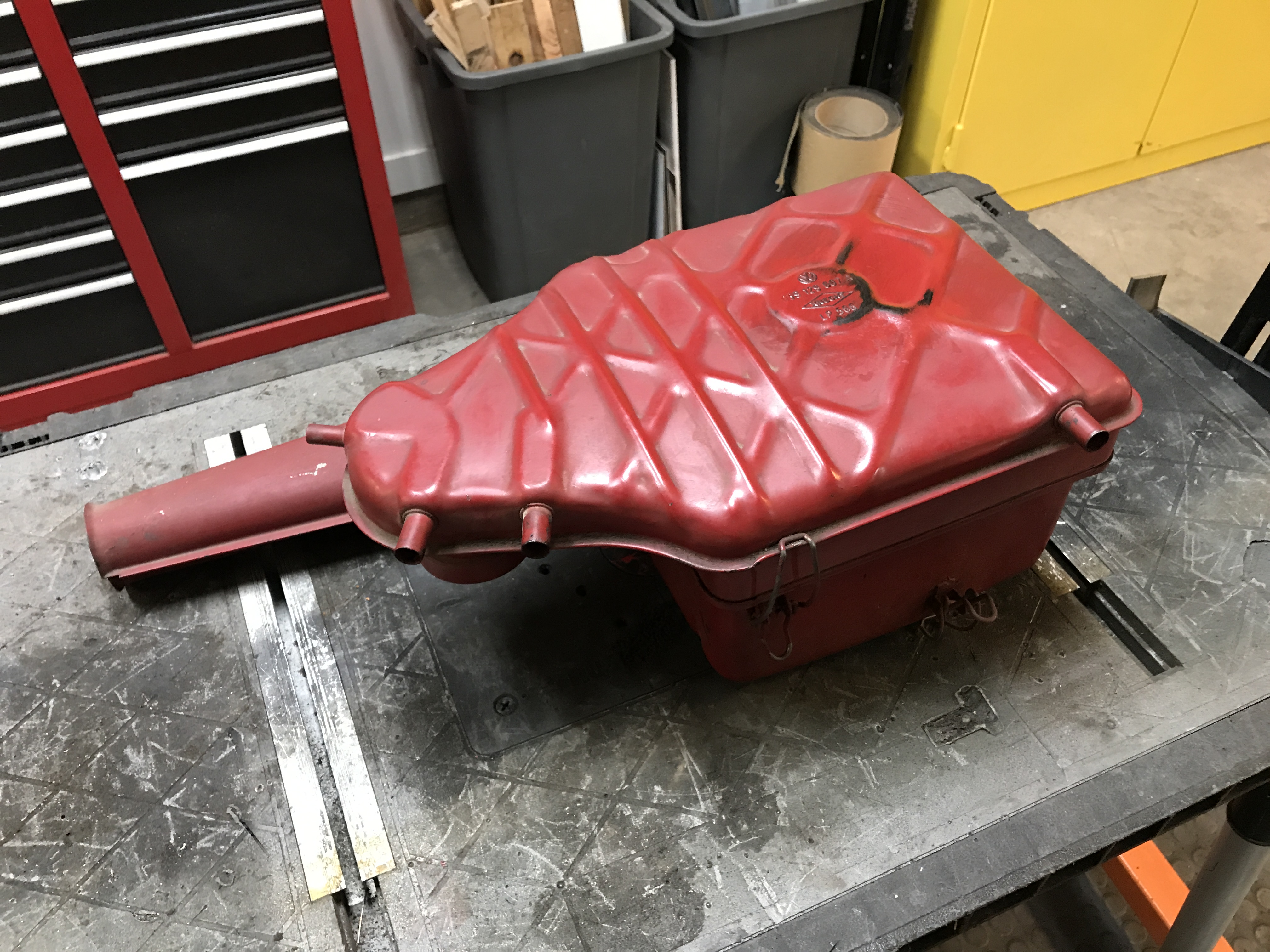

post Aug 2 2020, 08:39 PM
Post #1046
Posts: 8,342
Complete with moldy air filter.

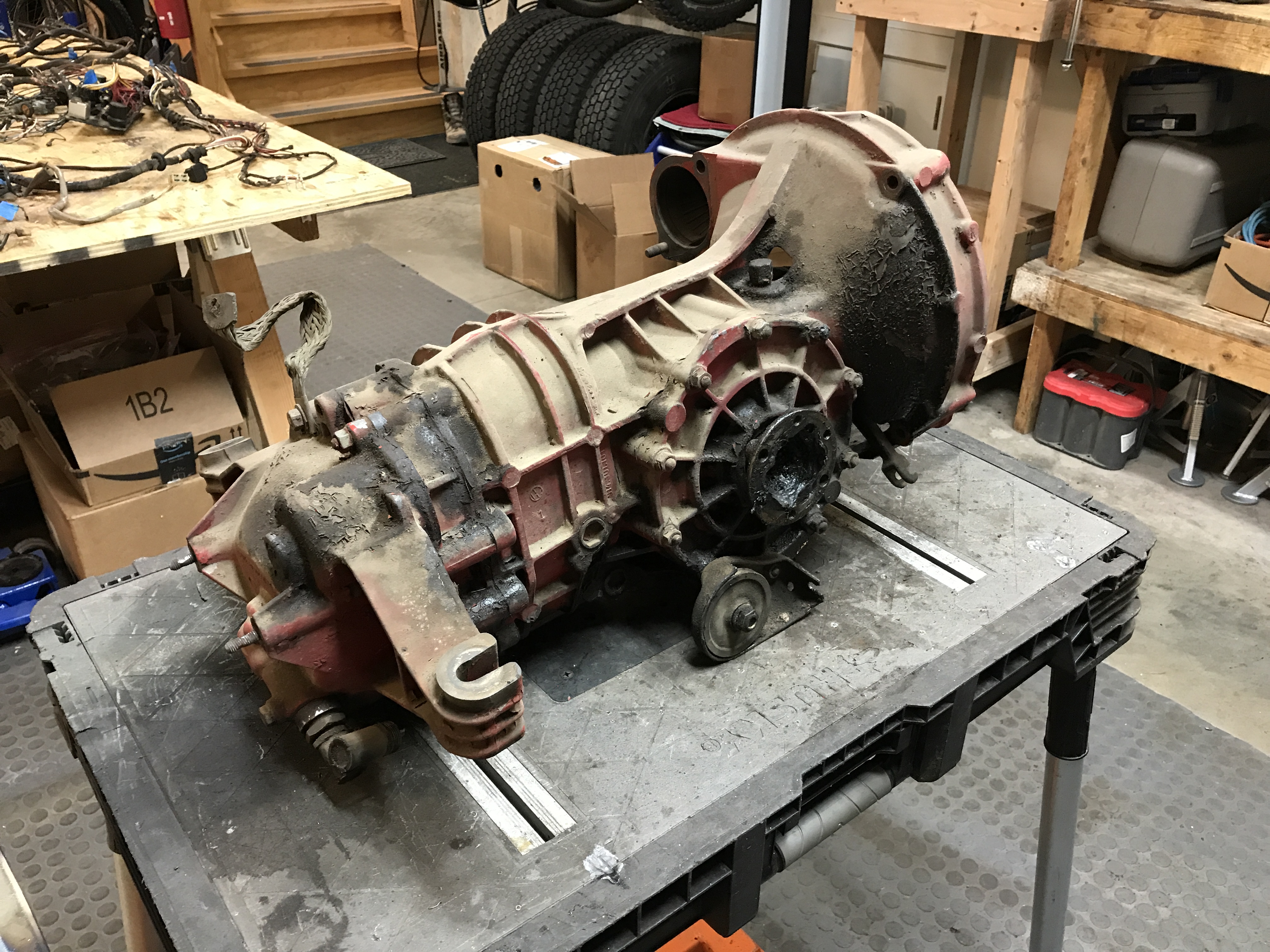

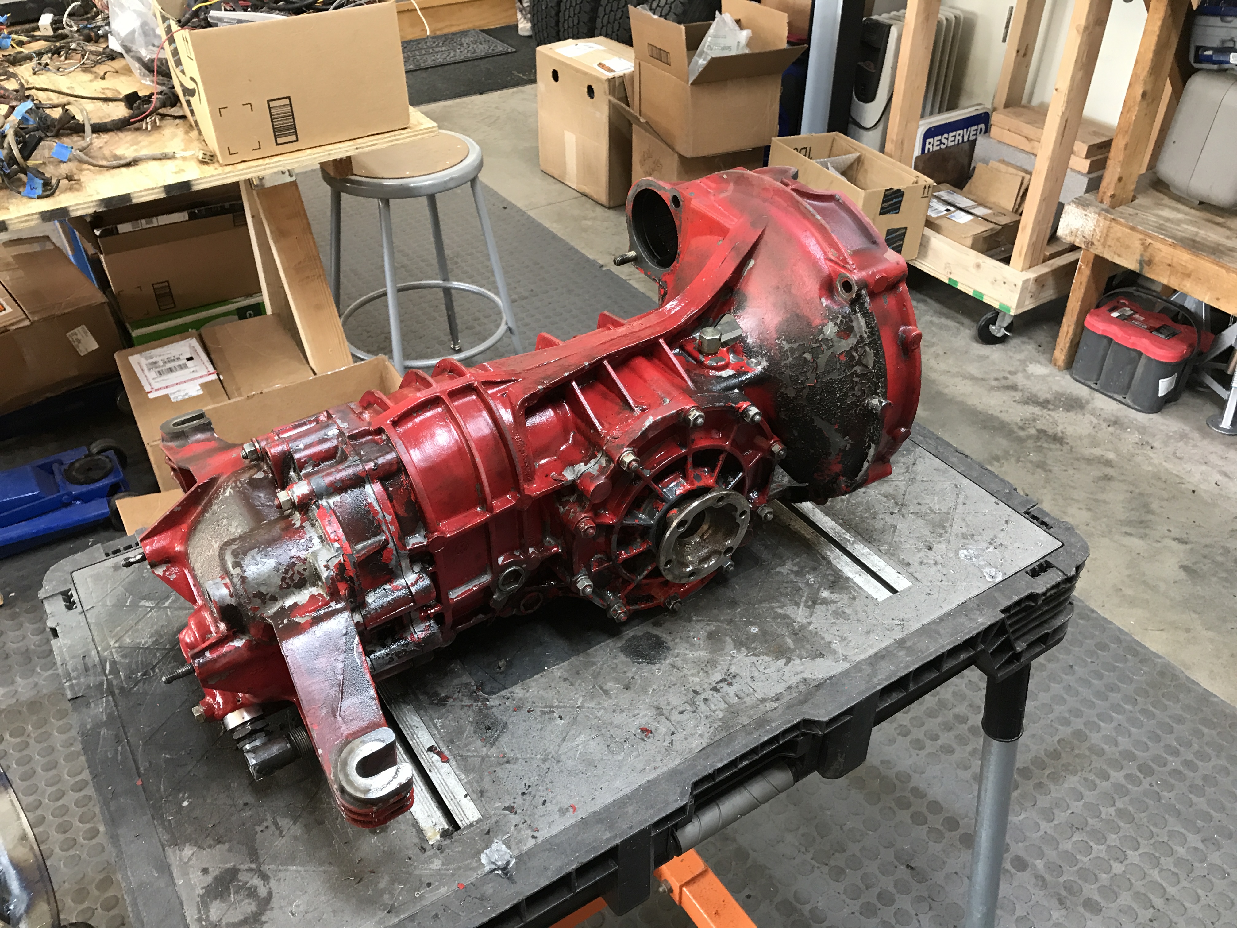

While in a red mood, I pulled out the transaxle. I need to figure out how to clean this (and remove the red paint).
post Aug 3 2020, 07:35 PM
Post #1048
Posts: 8,342
After muscling the trans into and around the parts cleaner, here is the red glory revealed.

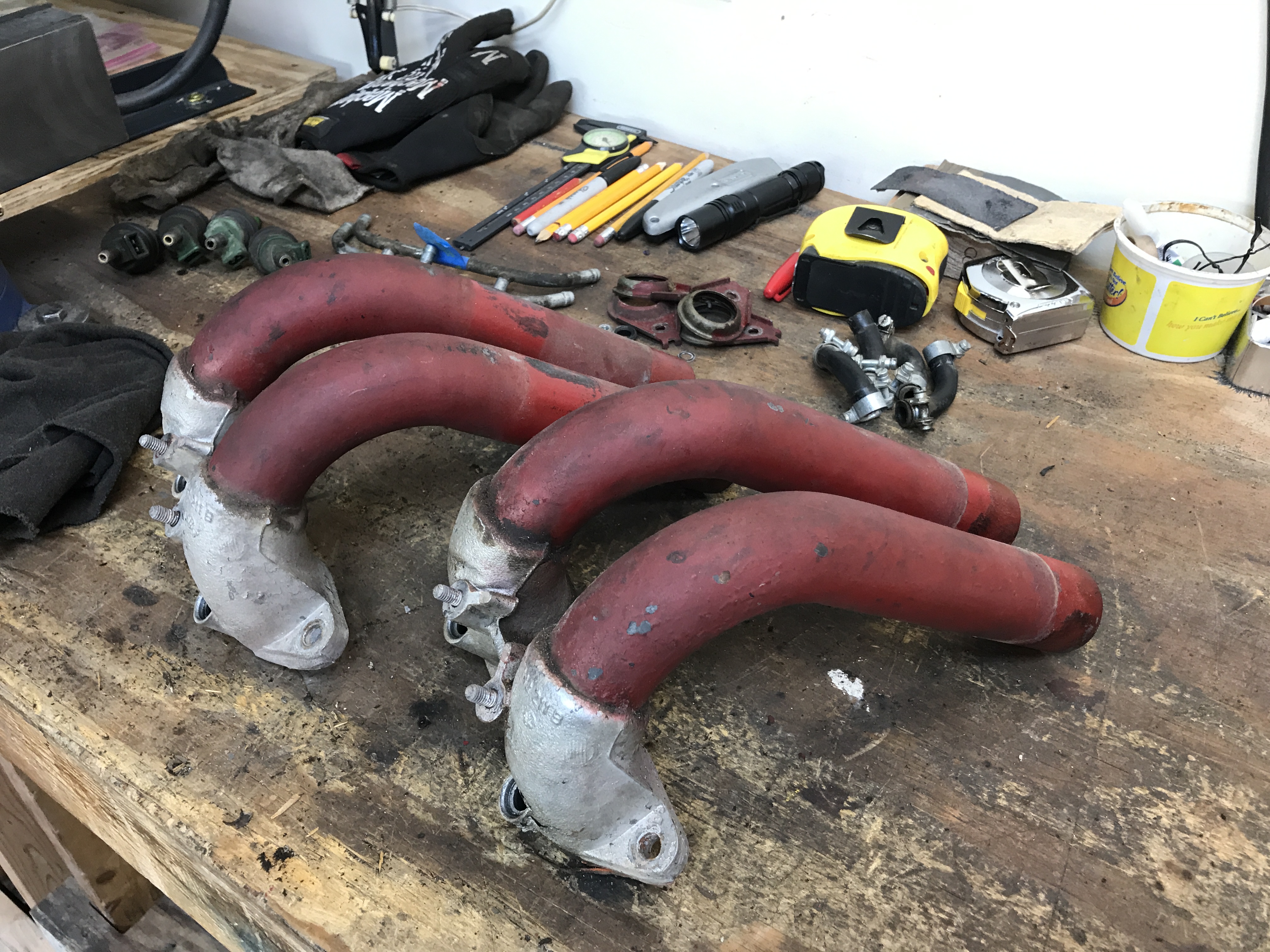

Posts: 8,342
One more item in the Red Collection: the intake runners.

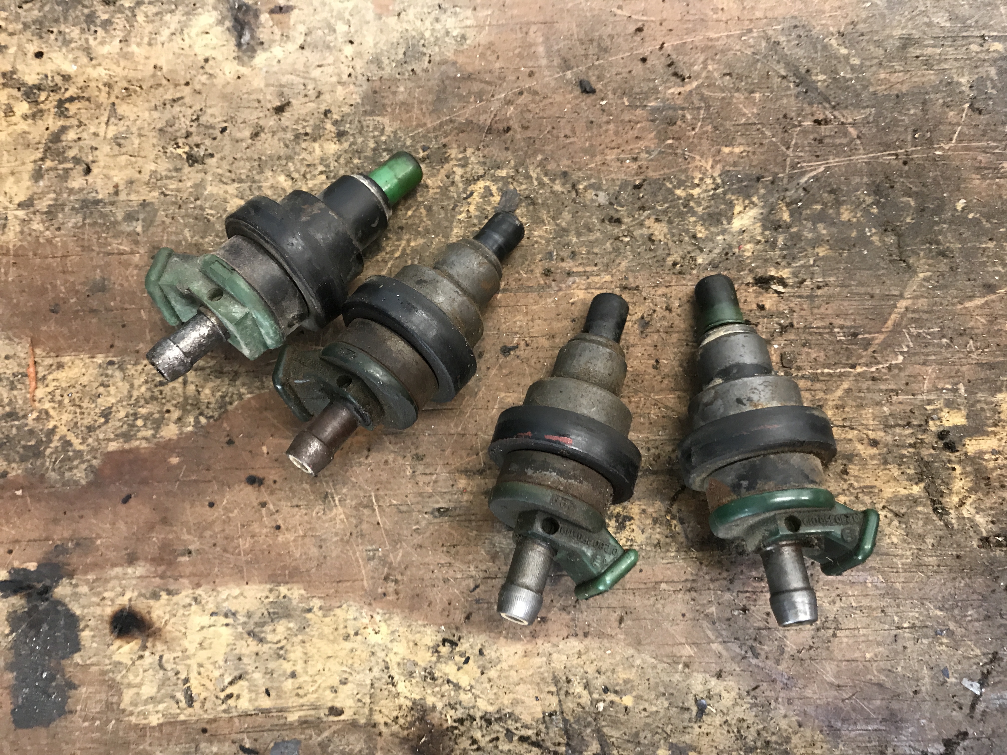

Posts: 8,342
At least the injectors are all green. Time to send these off for servicing.

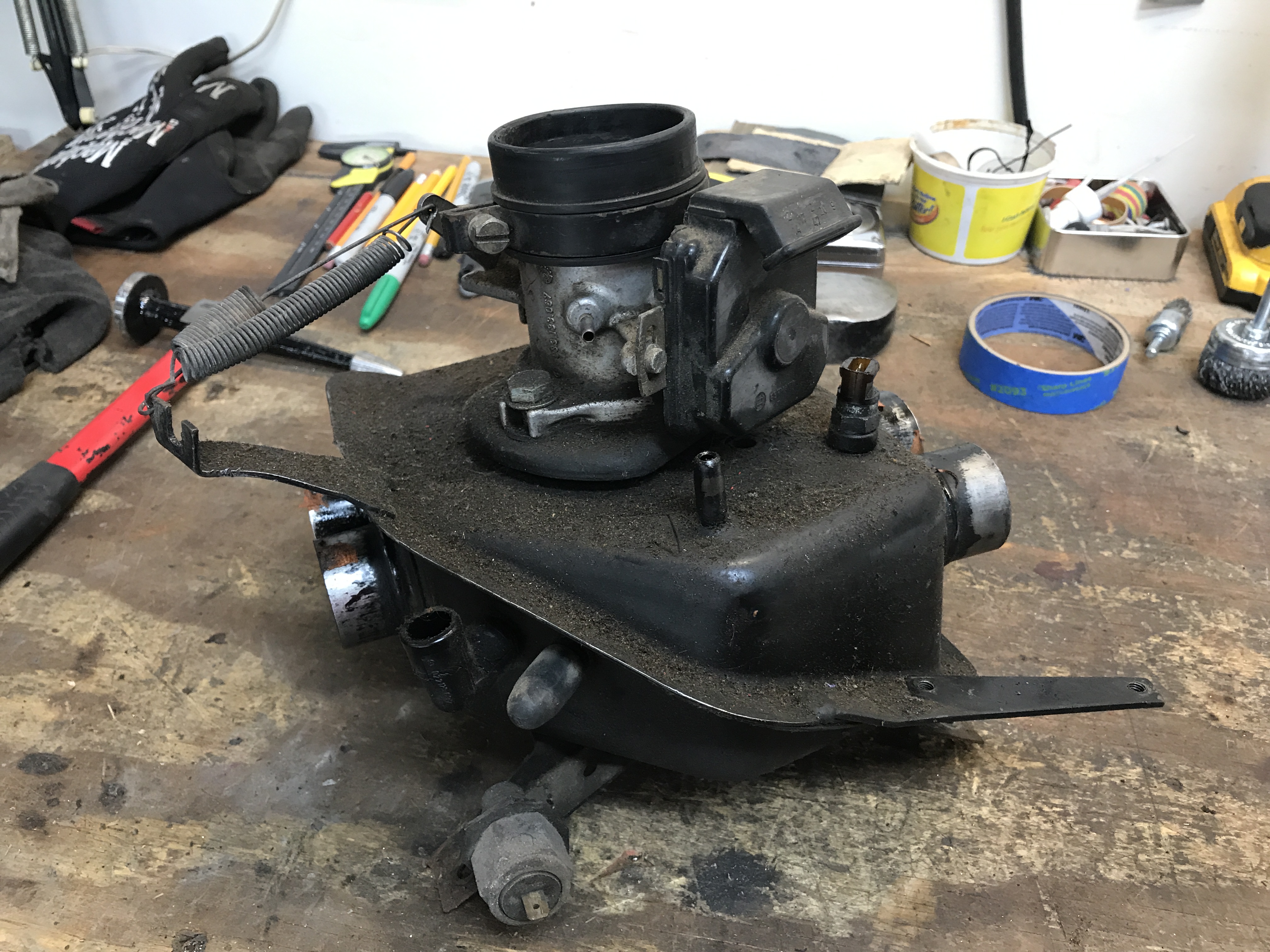

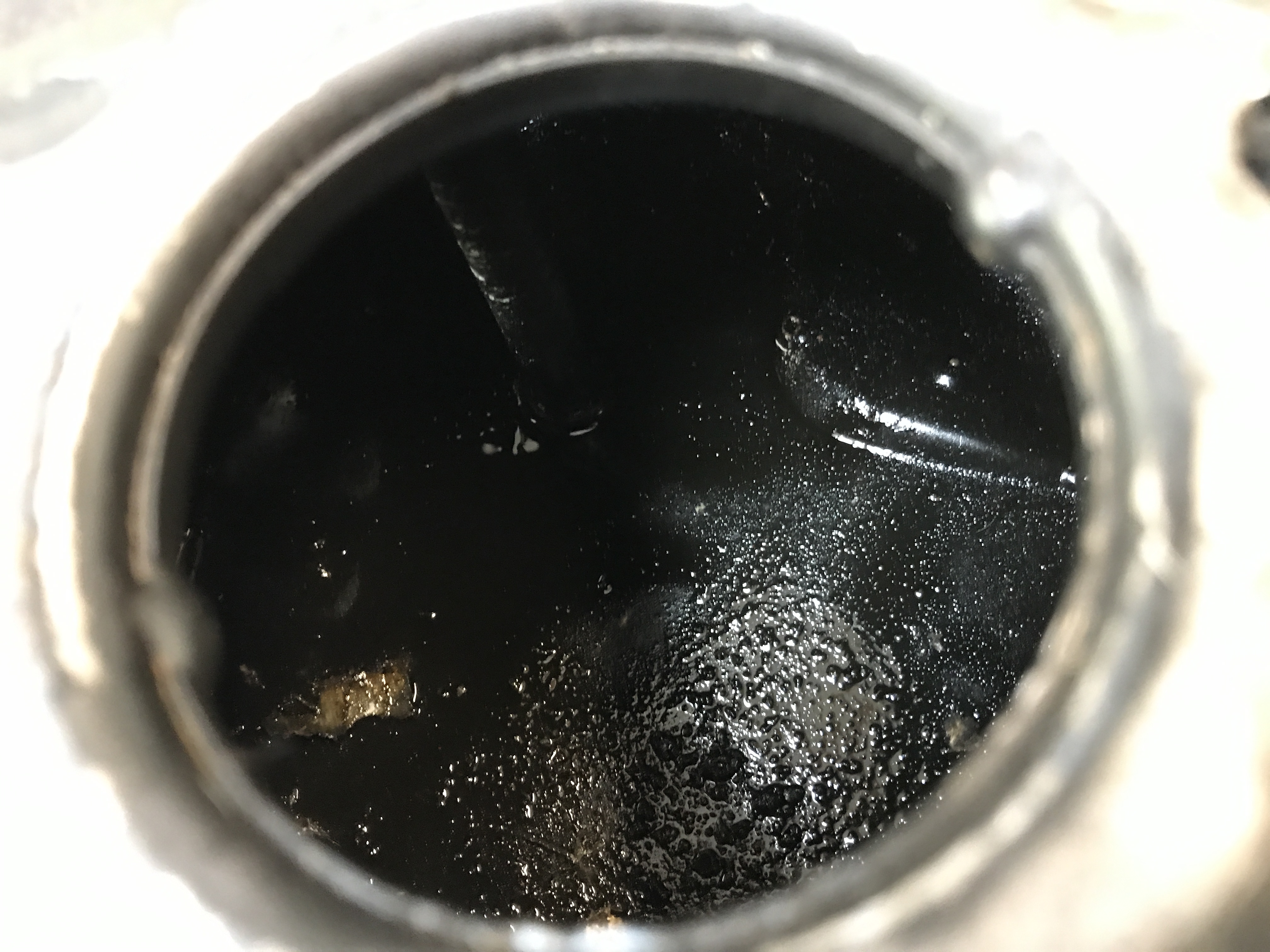

I also took apart the intake plenum and throttle body.
post Aug 3 2020, 07:40 PM
Post #1052
Posts: 8,342
Inside the plenum: oily sludge!

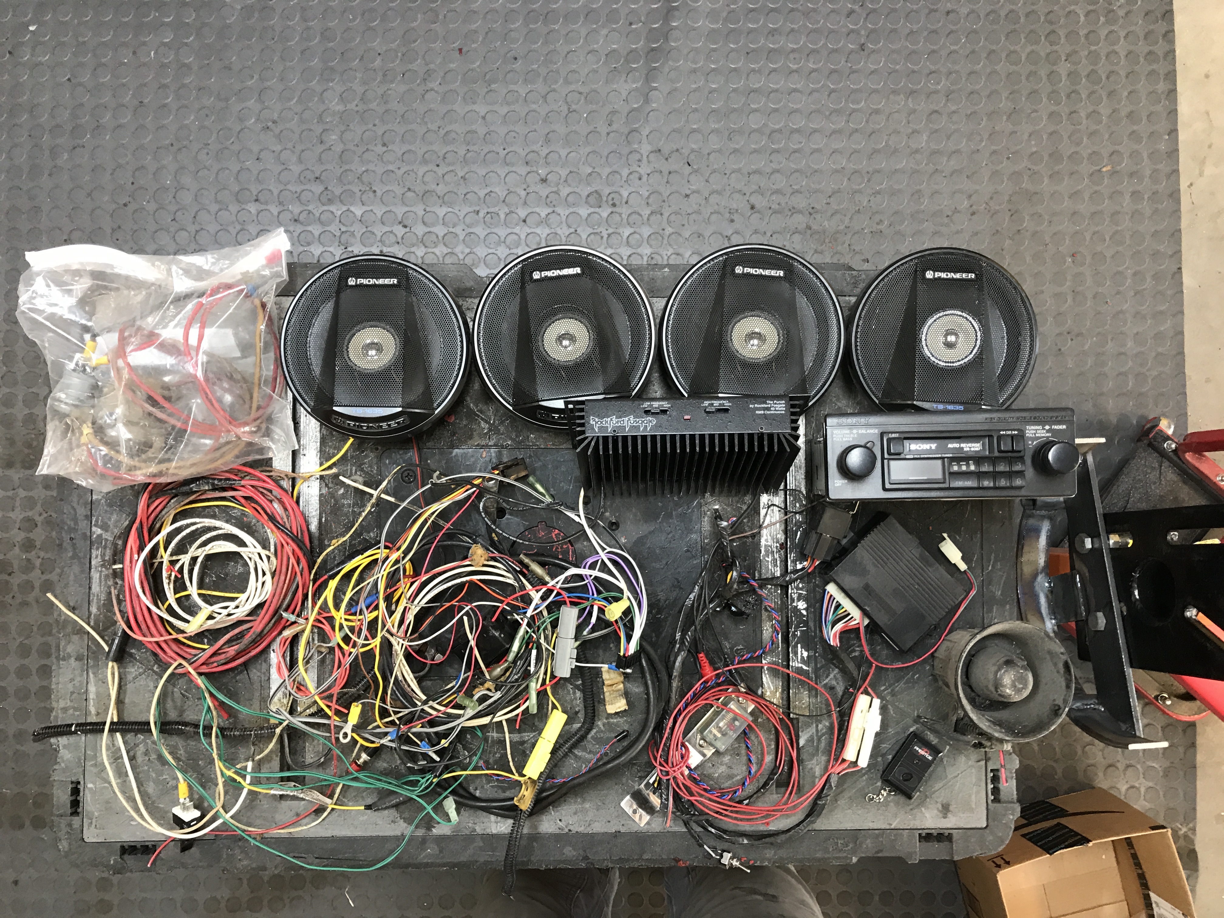

Still sorting through boxes from the disassembly last fall. This is all the "extra" electrical stuff: an awesome audio system with cassette deck, amp, and 4 speakers; an alarm system that was wired in to about 10 places, at least 2 hidden start disable switches, an ignition start bypass with solenoid, and about 10 miles of wire.
Anybody want some?

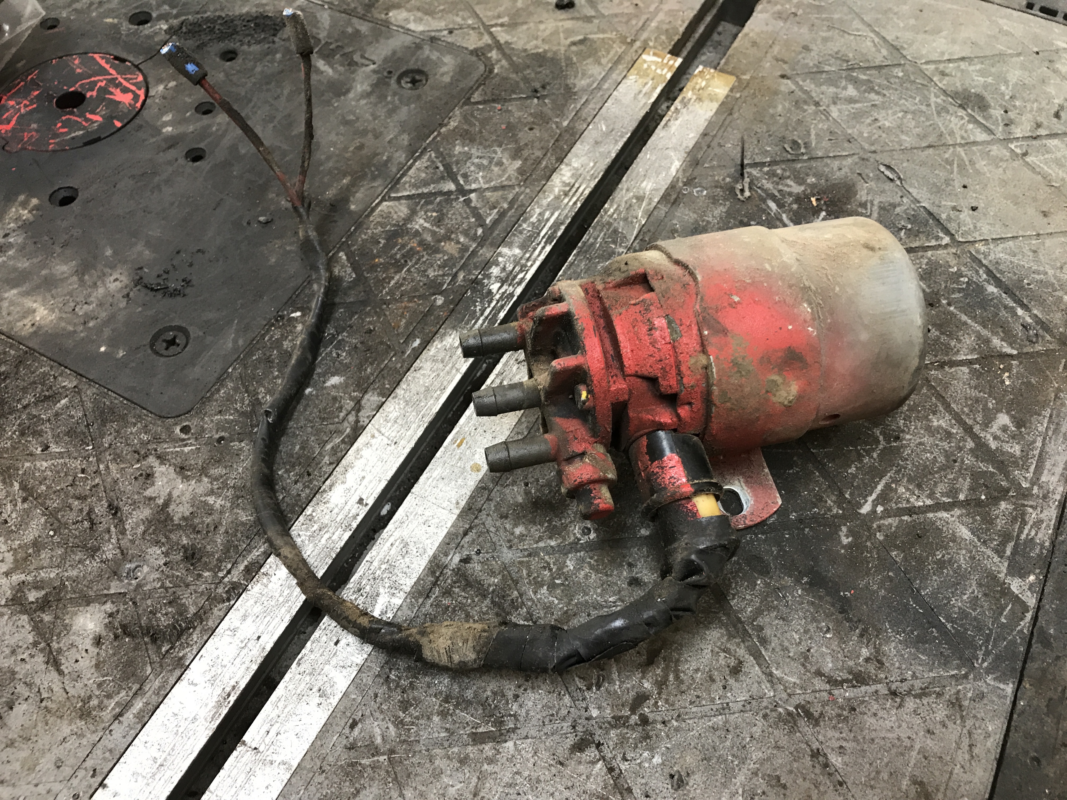

Posts: 8,342
Here's the fuel pump, with some red--but not the real RED. The PO did relocate the pump--to inside the right rear fender! It runs with power (or at least makes noise).

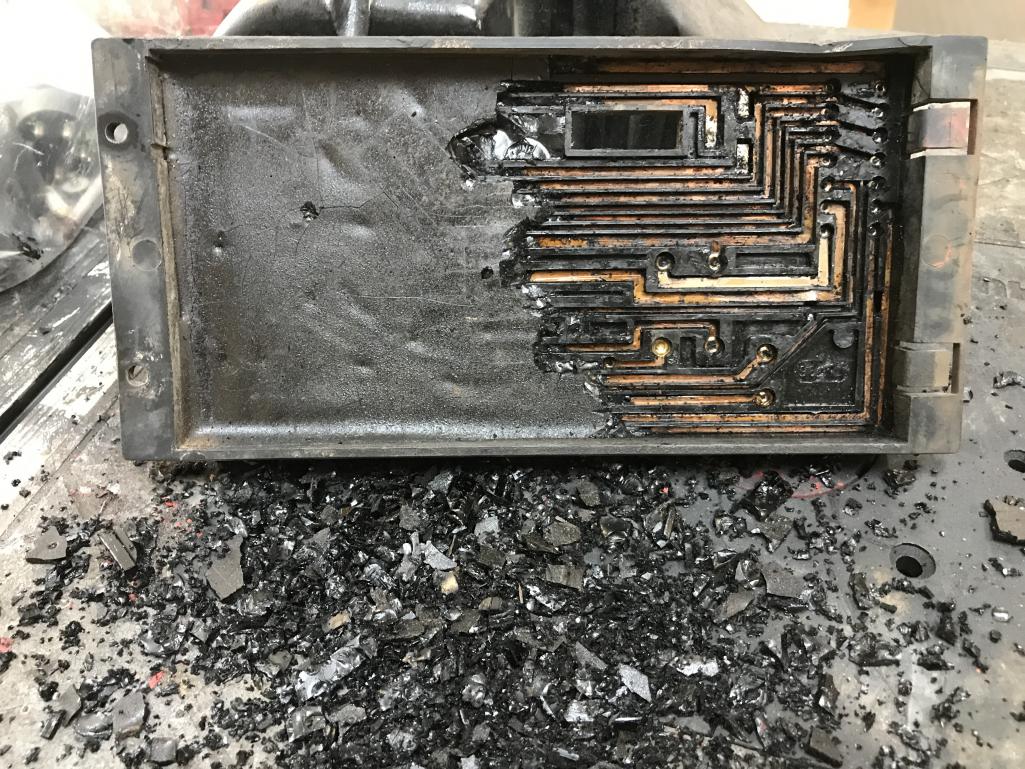

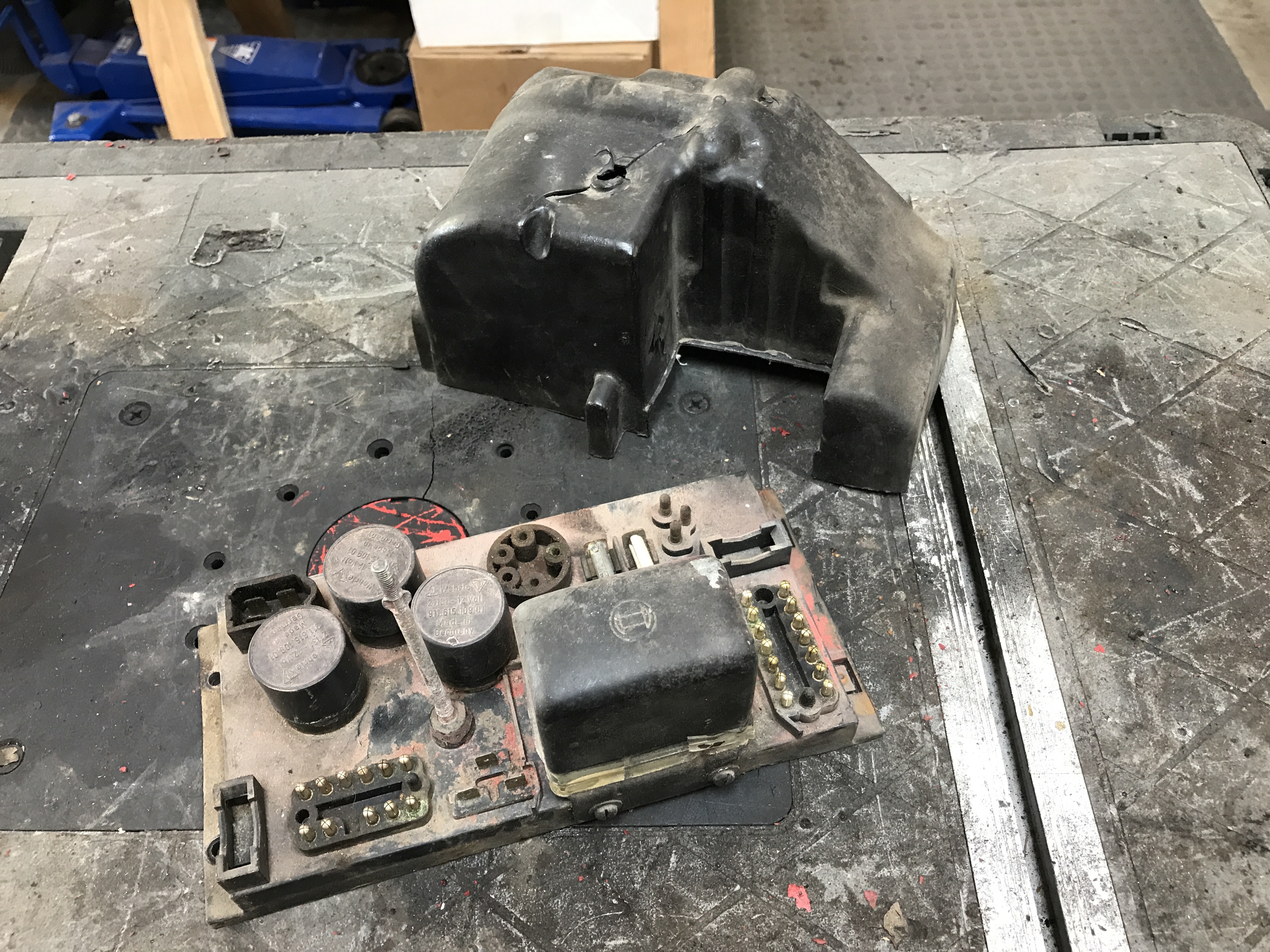

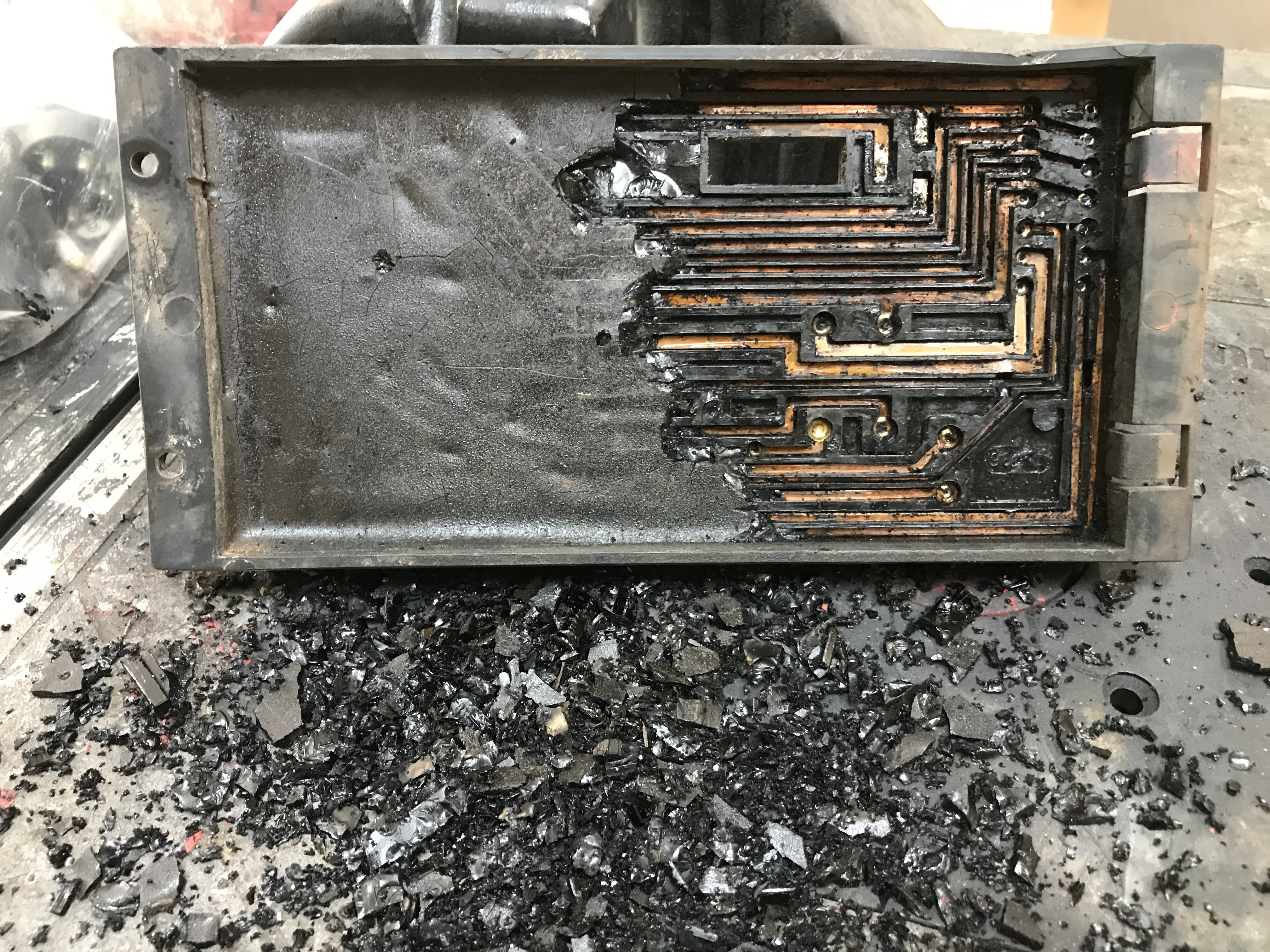

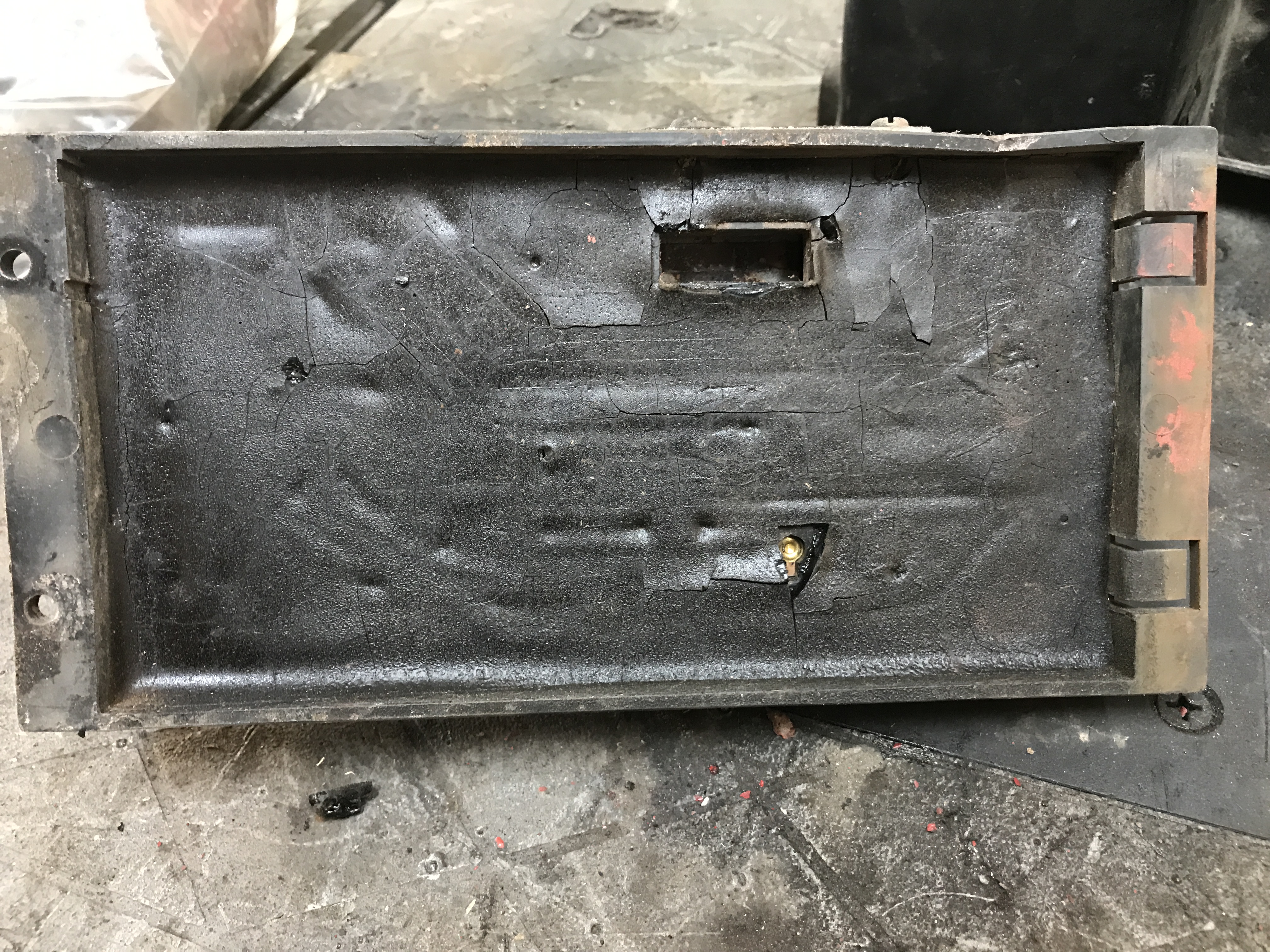

Another project: the relay board. Ugly.
post Aug 4 2020, 08:08 PM
Post #1057
Posts: 8,342
The underside is even uglier, and the dielectric material is loose and spontaneously falling out.
post Aug 4 2020, 08:10 PM
Post #1058
Posts: 8,342
A little persuasion, and the stuff comes off. I need to clean this up, check all the leads, and refill with dielectric epxoy.

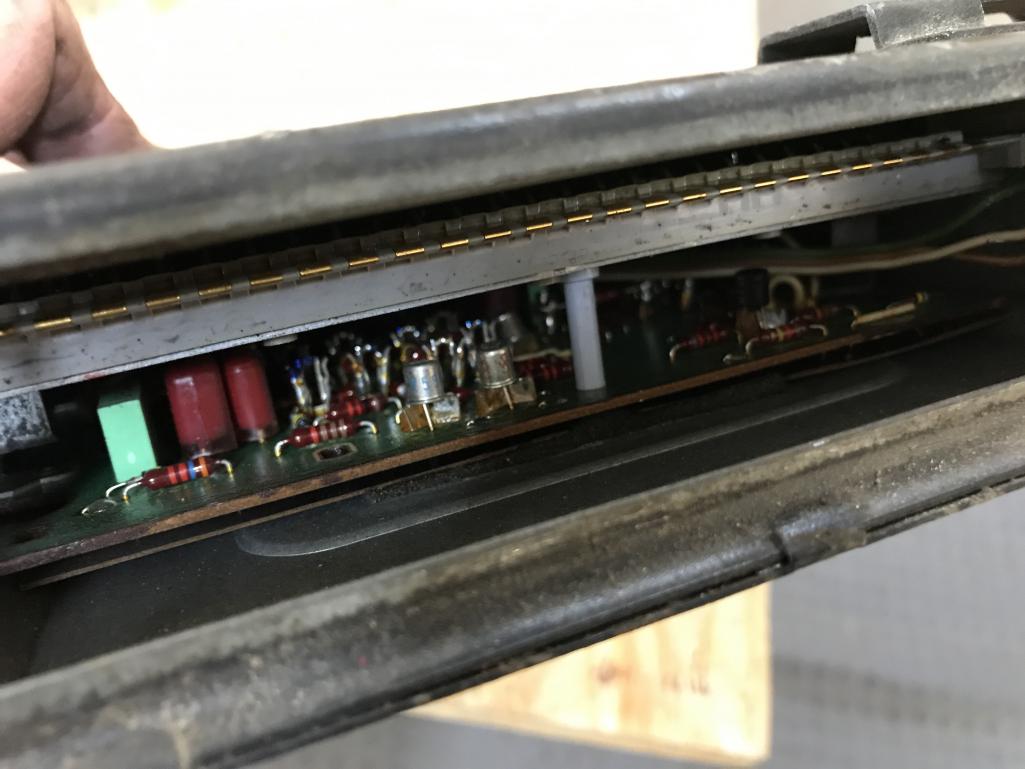

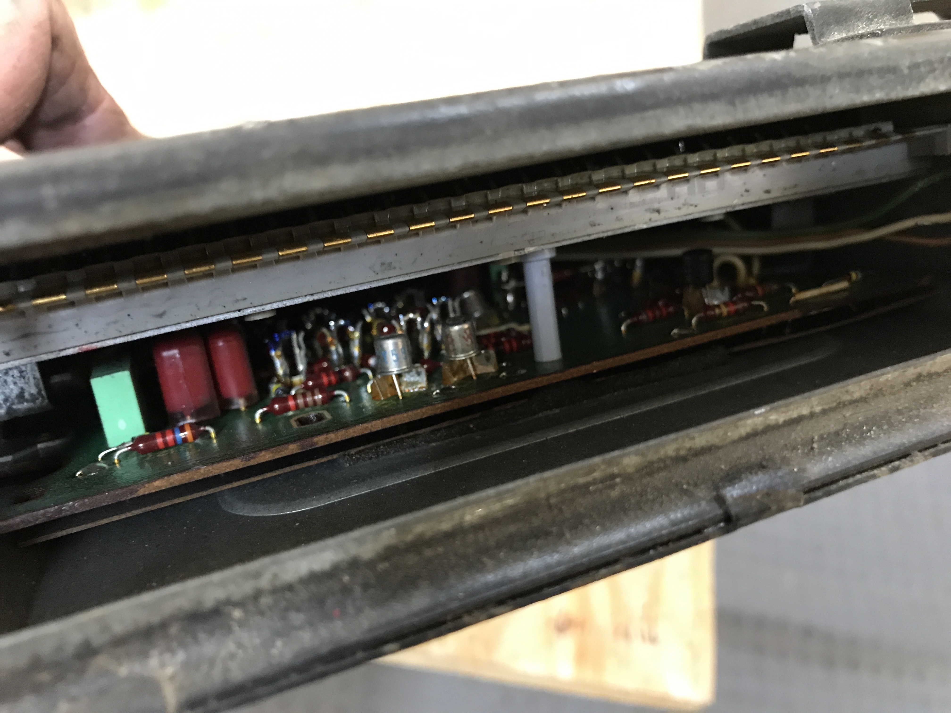

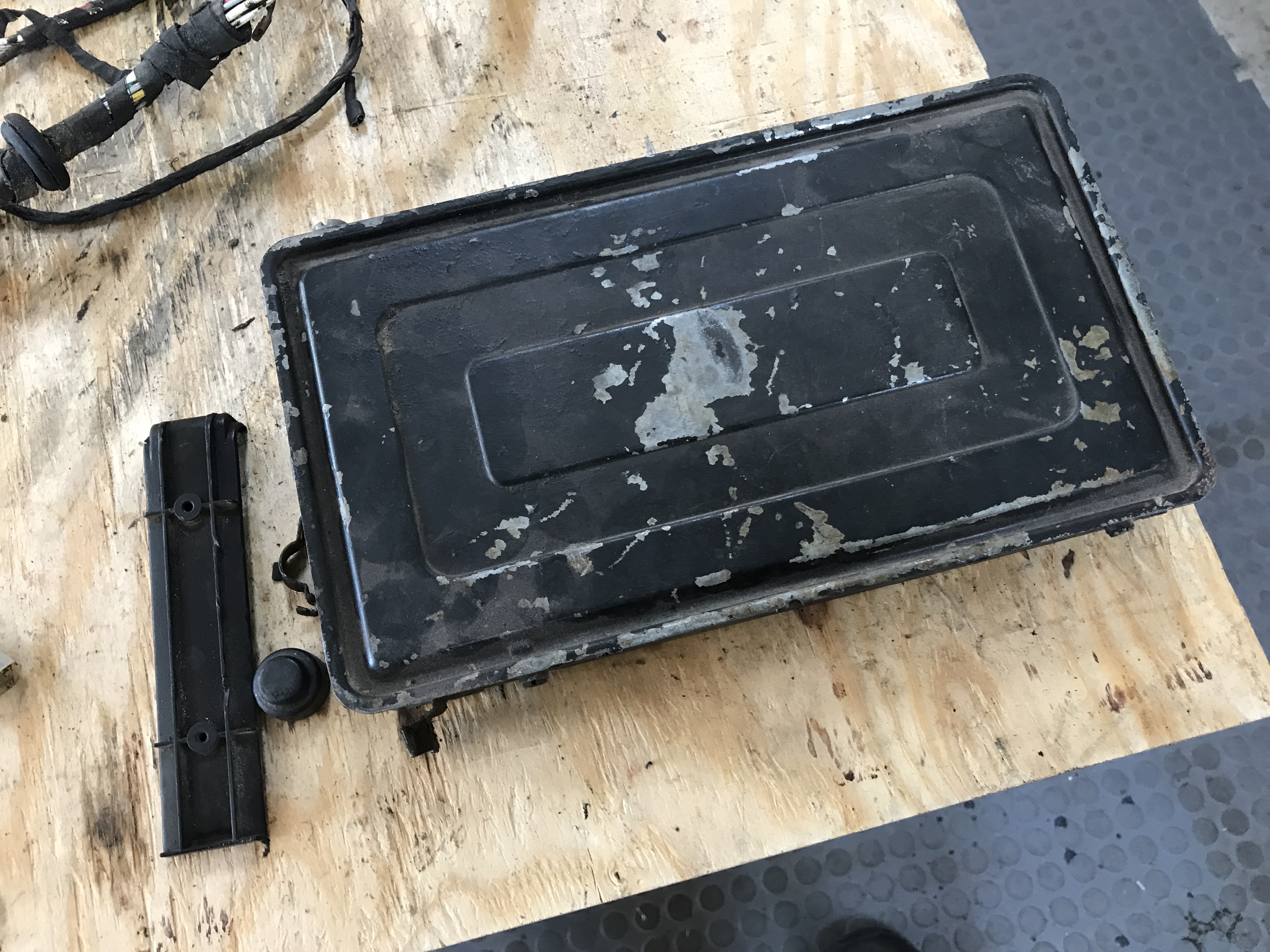

Next up: the brain box. Another great OP idea, painting it black.
post Aug 4 2020, 08:14 PM
Post #1060
Posts: 8,342
At least the inside looks clean.
