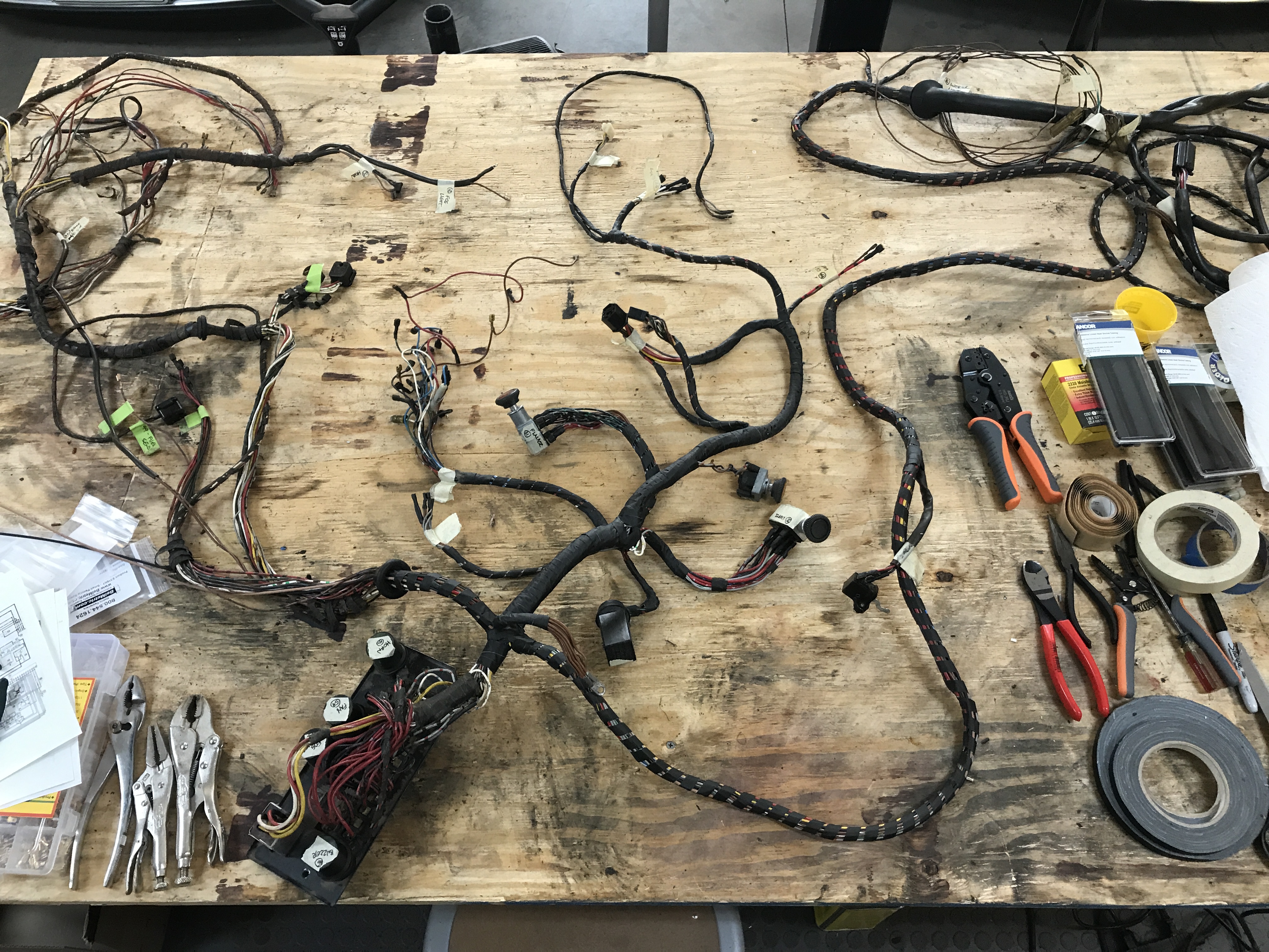

More repairs.

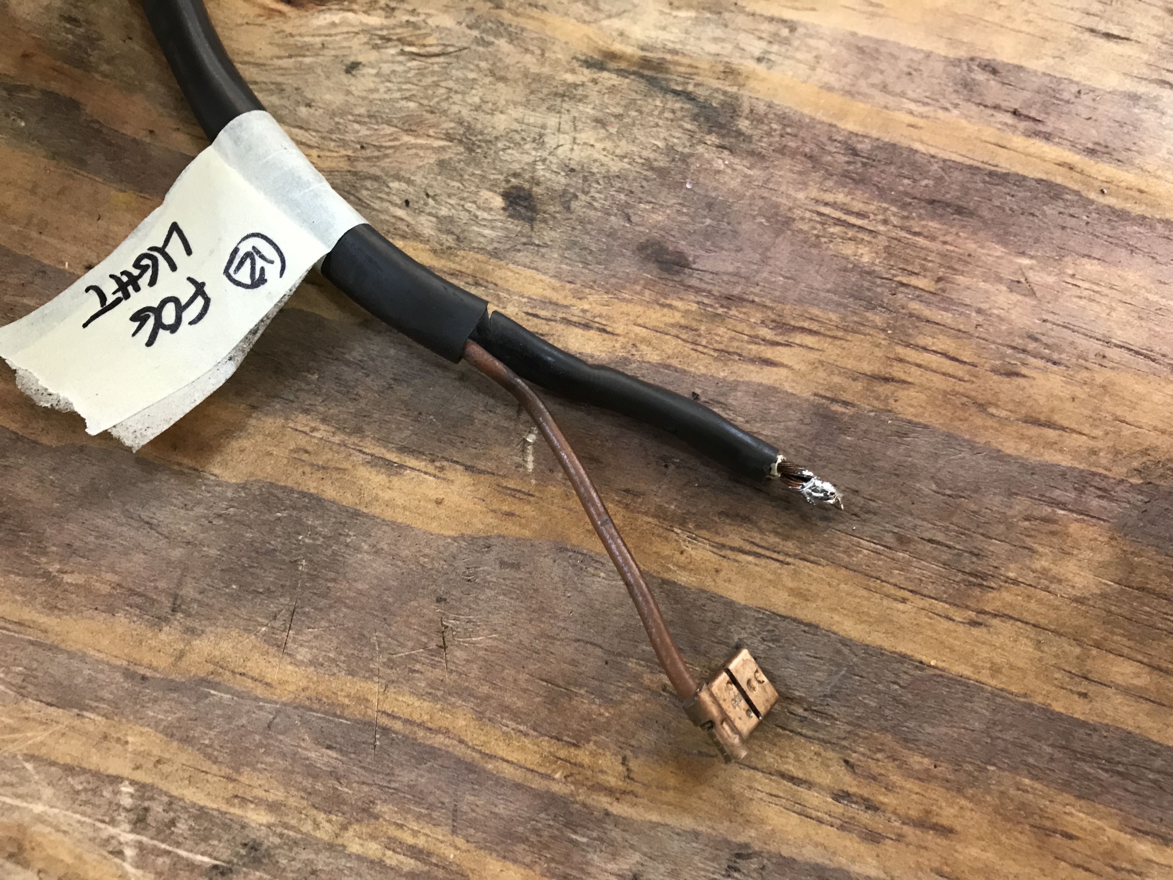

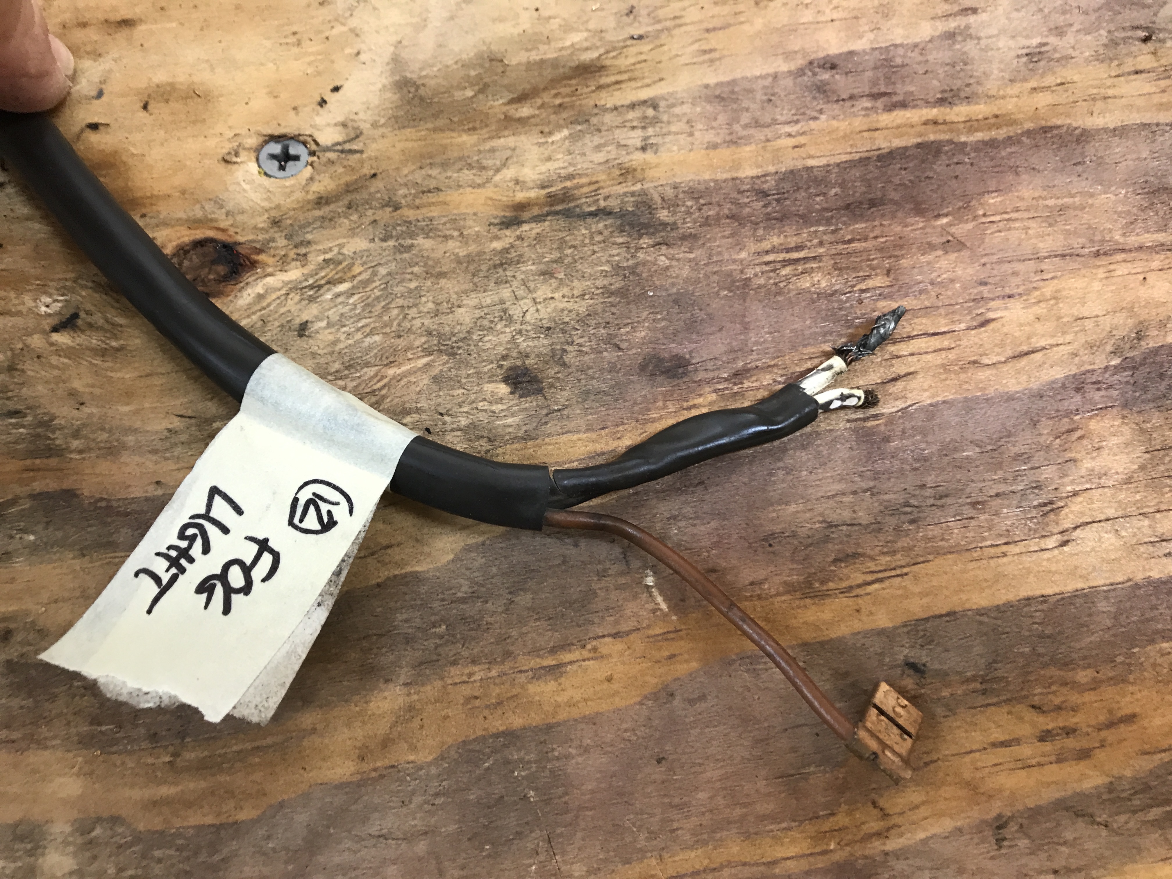

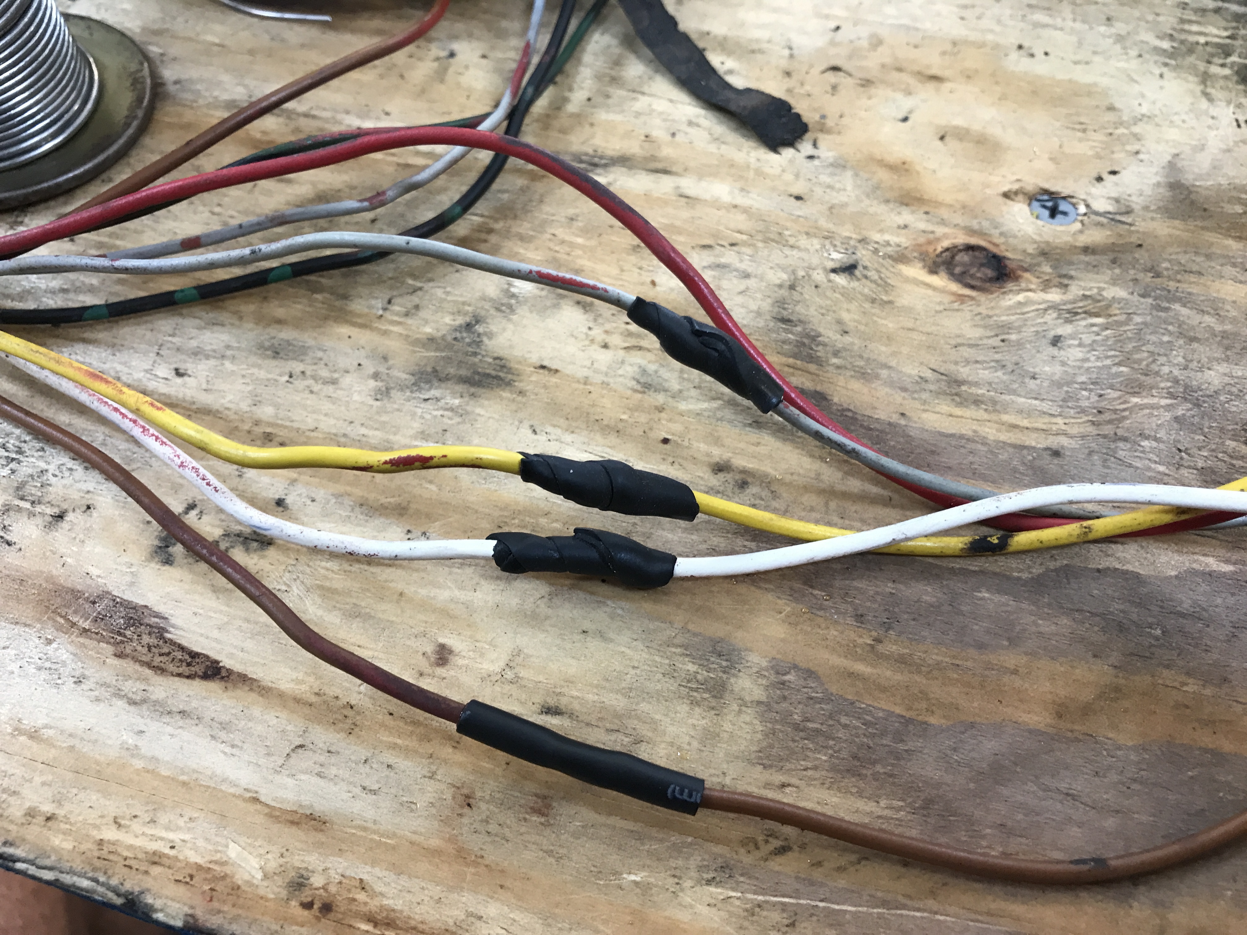

A different kind of repair on the power lead to the left fog light. These are bare wire with some solder tinning, that get clamped in a screw connection.
bkrantz
post Aug 18 2020, 08:53 PM
Post #1143
Posts: 8,343
Joined: 3-August 19
From: SW Colorado
Member No.: 23,343
After

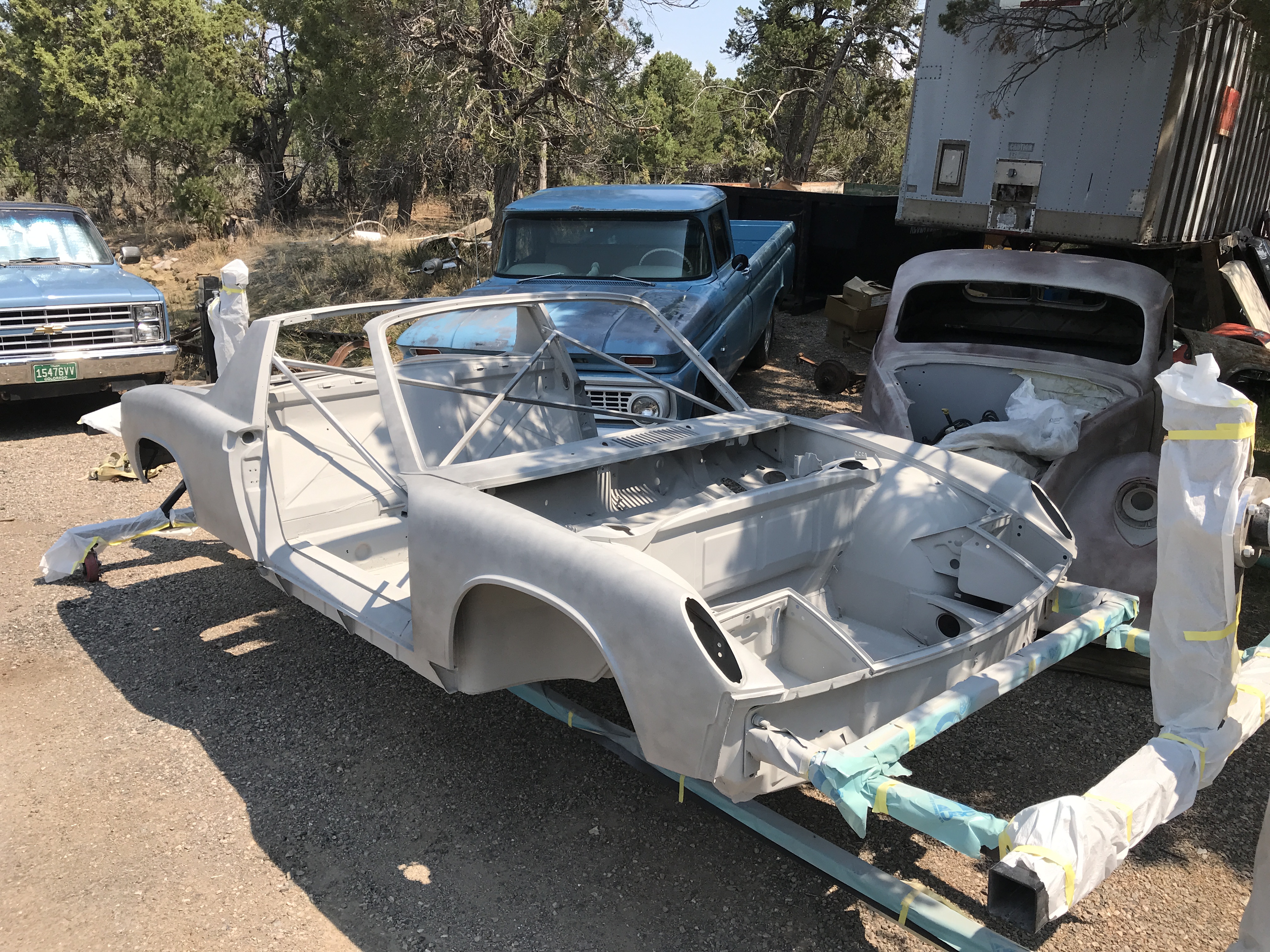

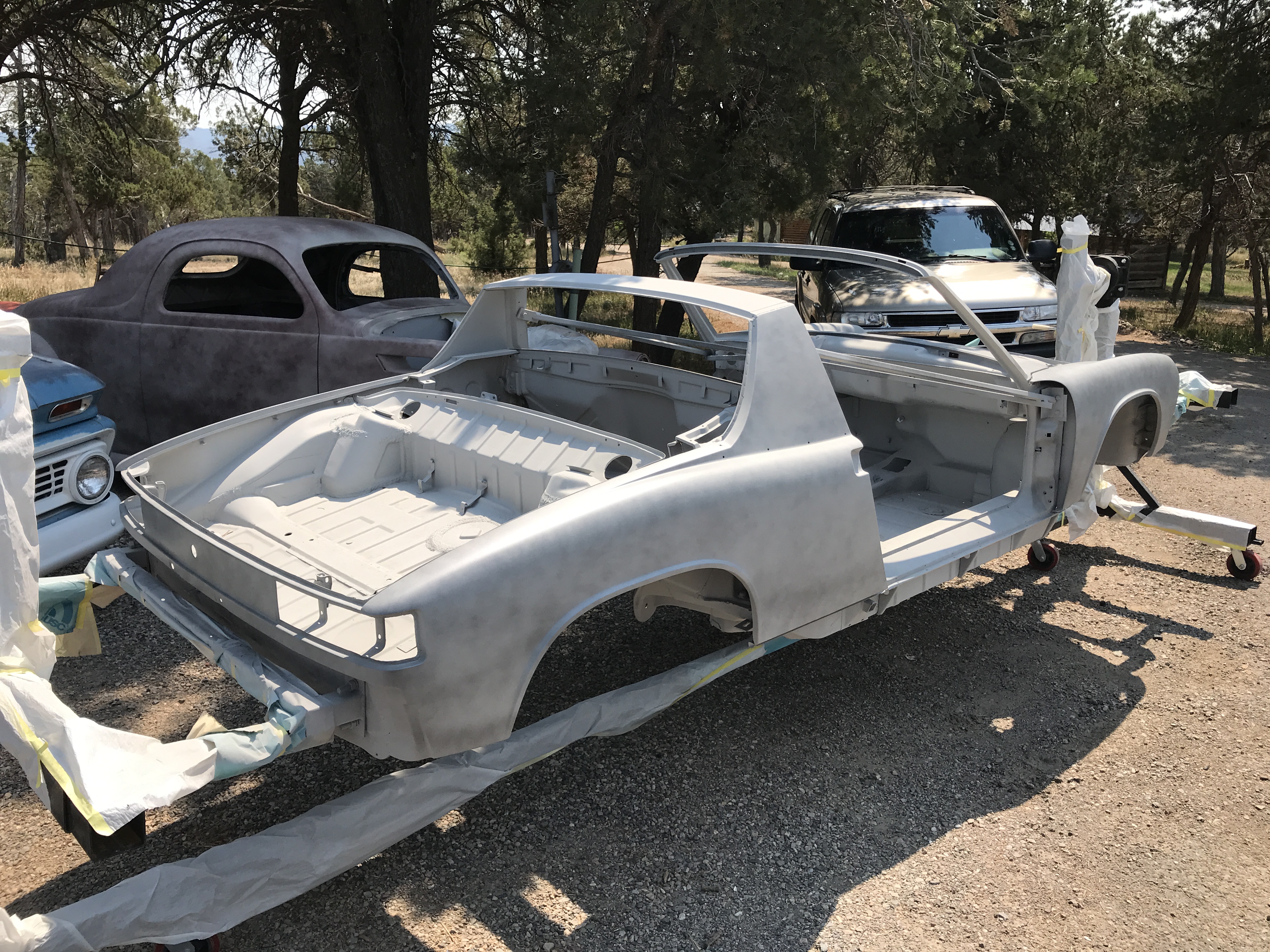

I also stopped by the body shop today, and saw some good progress.
bkrantz
post Aug 18 2020, 08:55 PM
Post #1145
Posts: 8,343
Joined: 3-August 19
From: SW Colorado
Member No.: 23,343
Priming is all done, and spending a day or two for the paint to cure.
bkrantz
post Aug 18 2020, 08:56 PM
Post #1146
Posts: 8,343
Joined: 3-August 19
From: SW Colorado
Member No.: 23,343

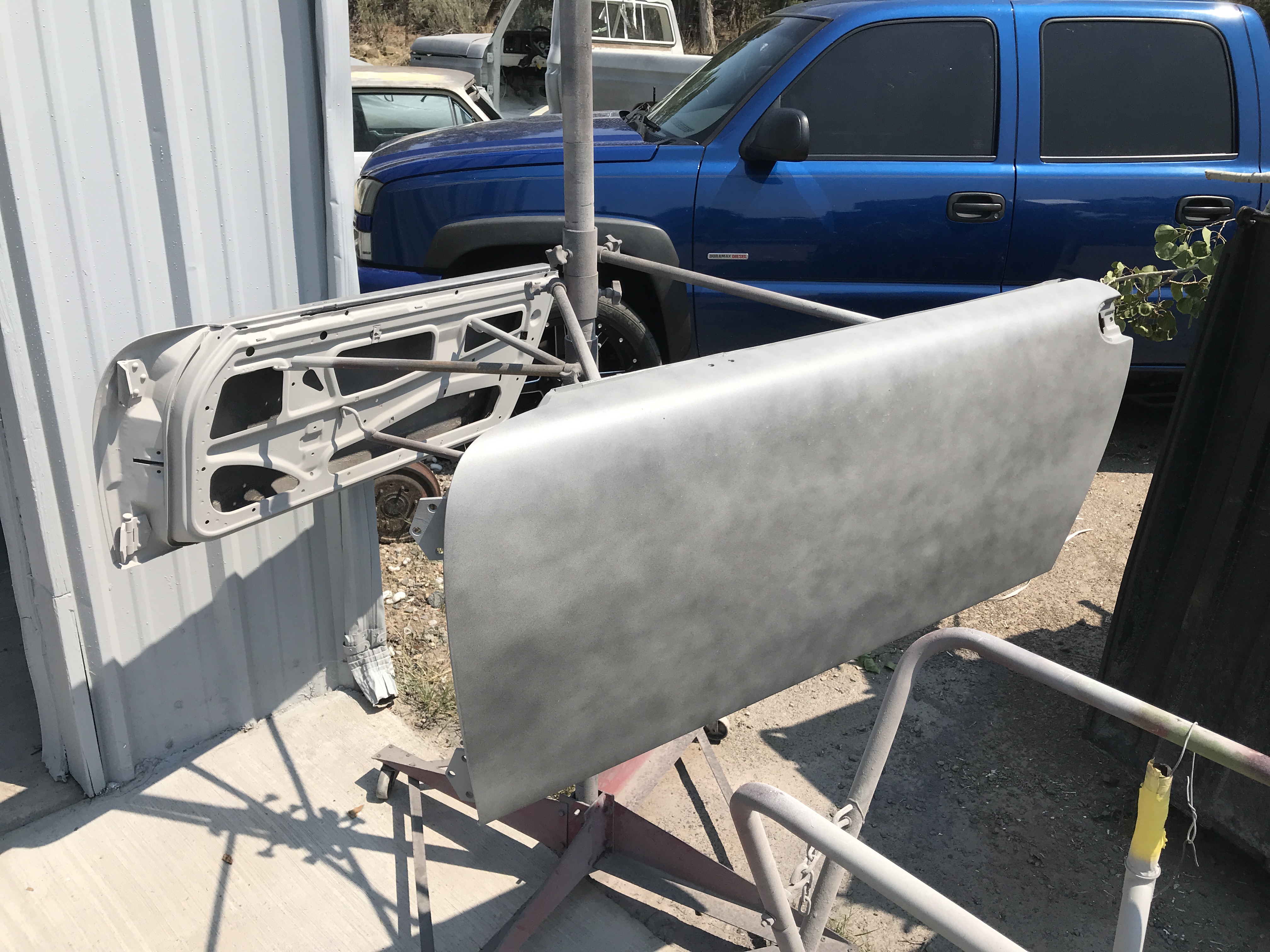

Then block sanding can start.

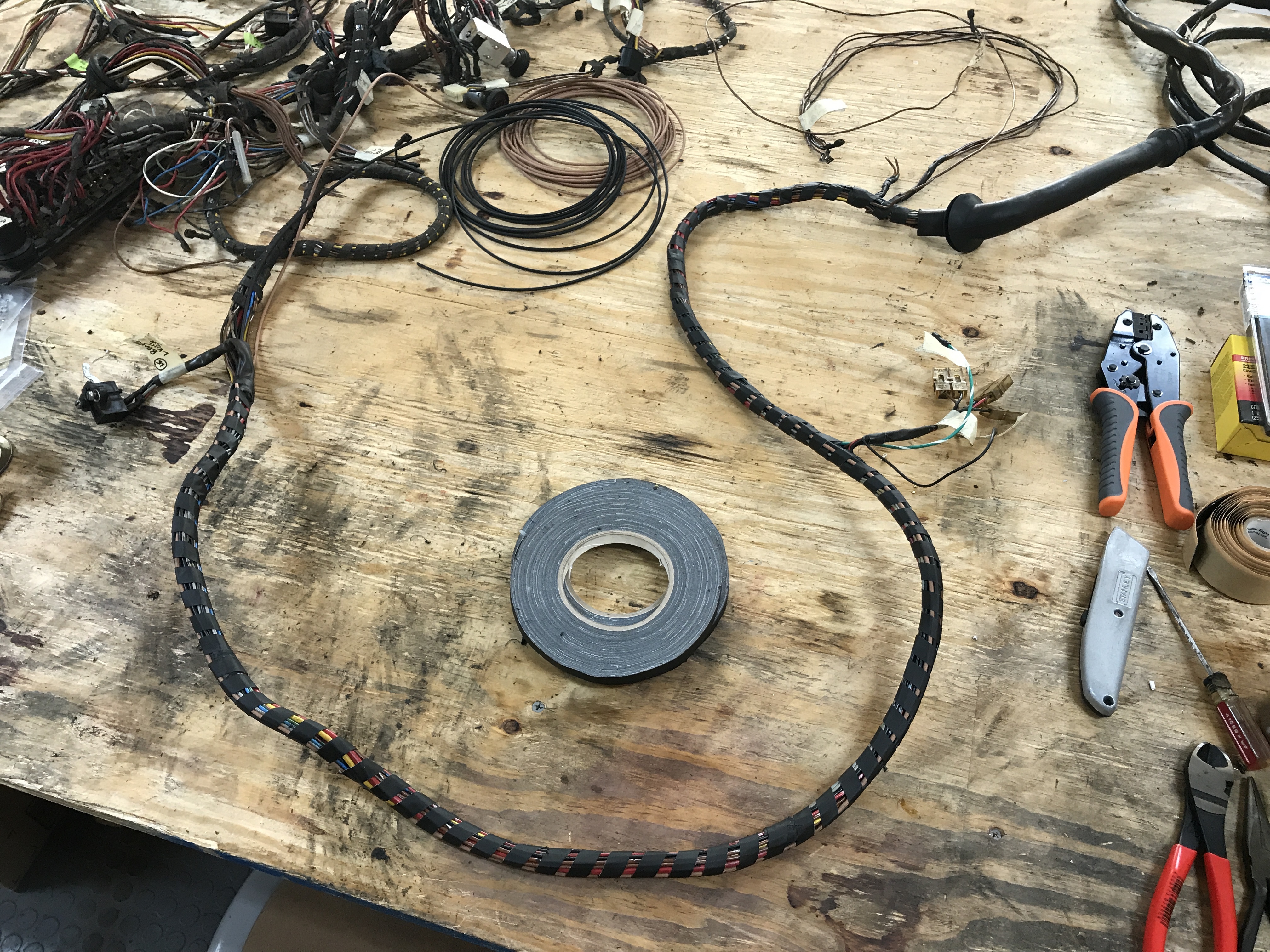

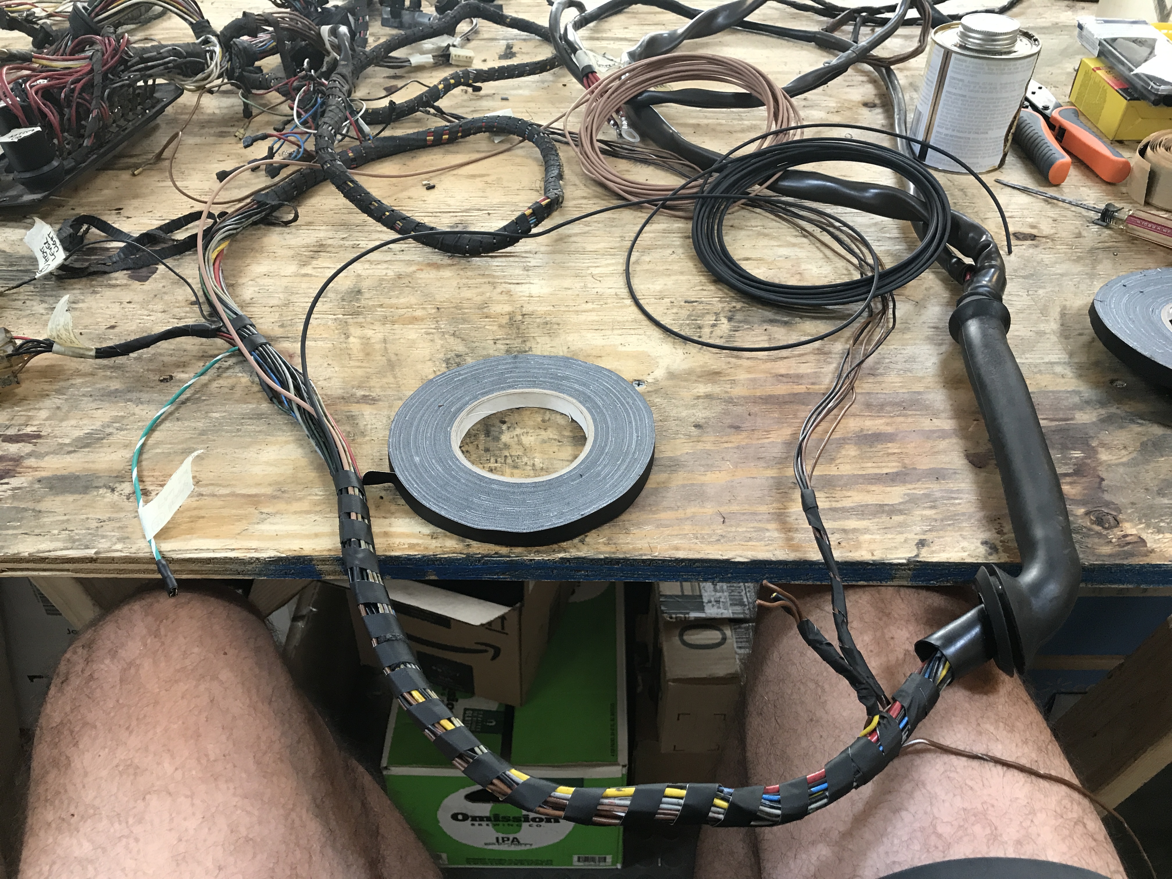

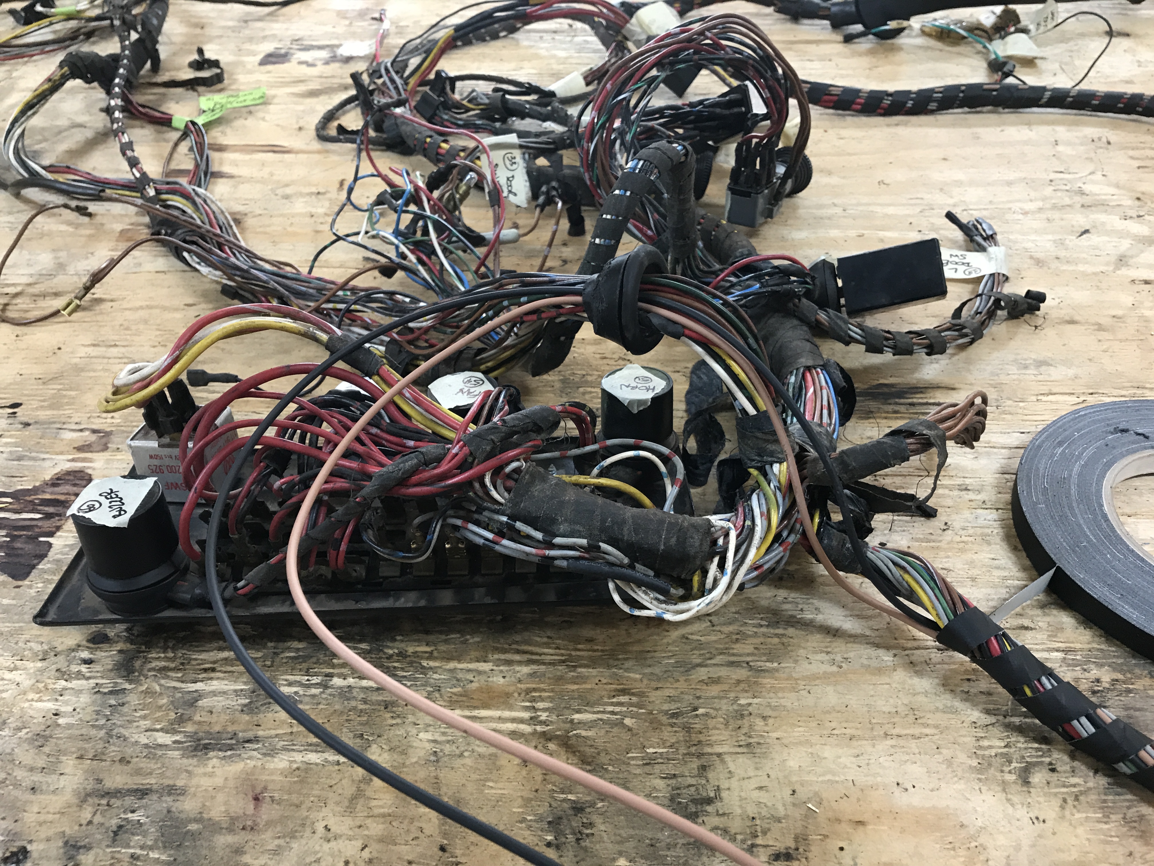

Back to wire work today. I started wrapping the harness with new tape, working forward from the rear firewall.
bkrantz
post Aug 19 2020, 08:38 PM
Post #1152
Posts: 8,343
Joined: 3-August 19
From: SW Colorado
Member No.: 23,343

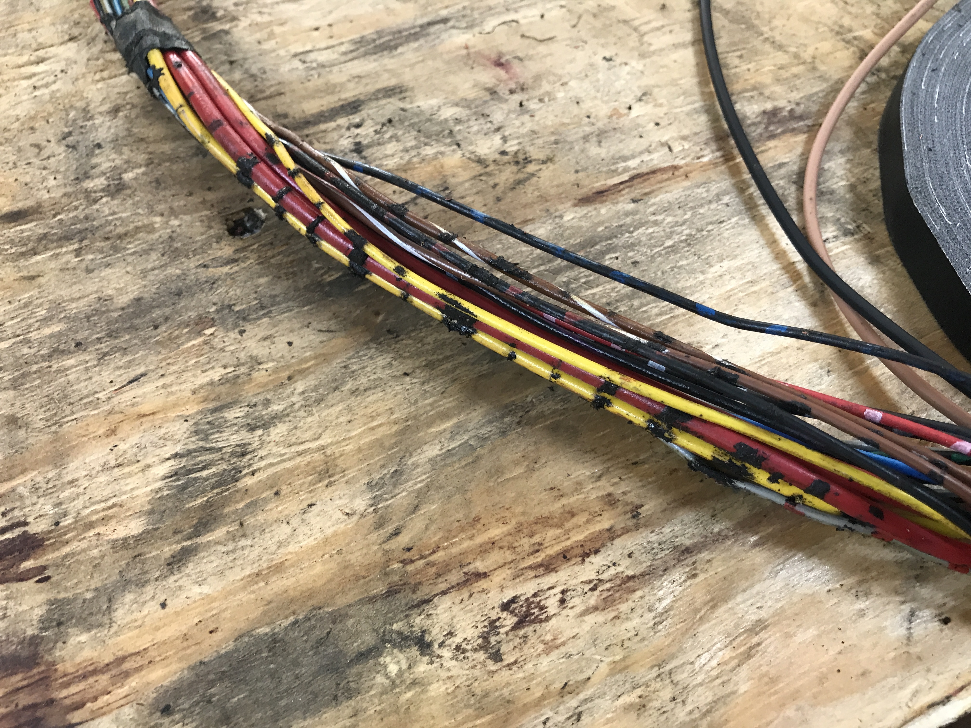

But working forward, I encountered segments that still have the genius PO undercoating, plus remnants of carpet glue and foam padding.
bkrantz
post Aug 19 2020, 08:39 PM
Post #1153
Posts: 8,343
Joined: 3-August 19
From: SW Colorado
Member No.: 23,343

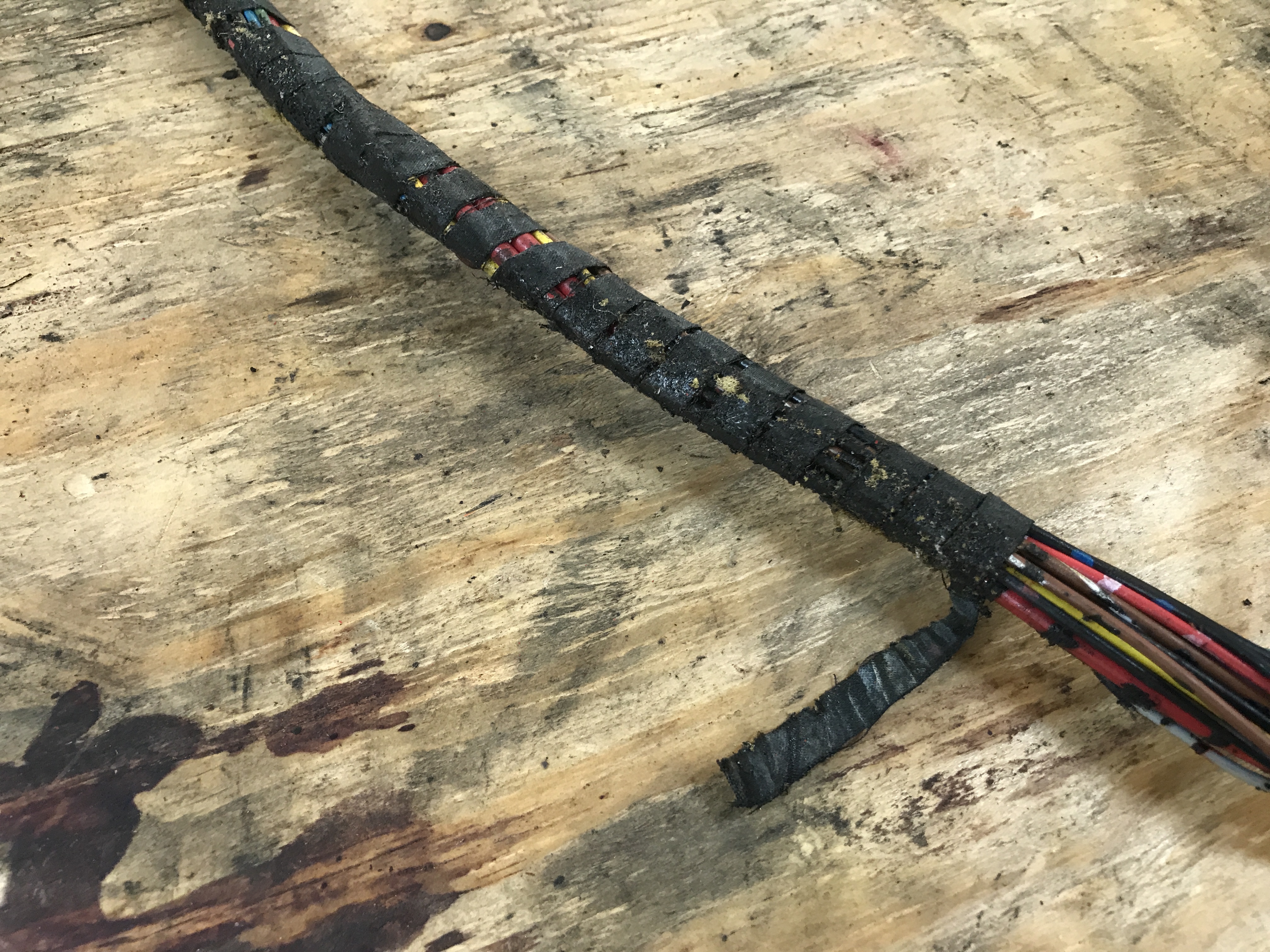

Unwrapping the original tape leaves spots of undercoat crud. Time for more GoofOff.

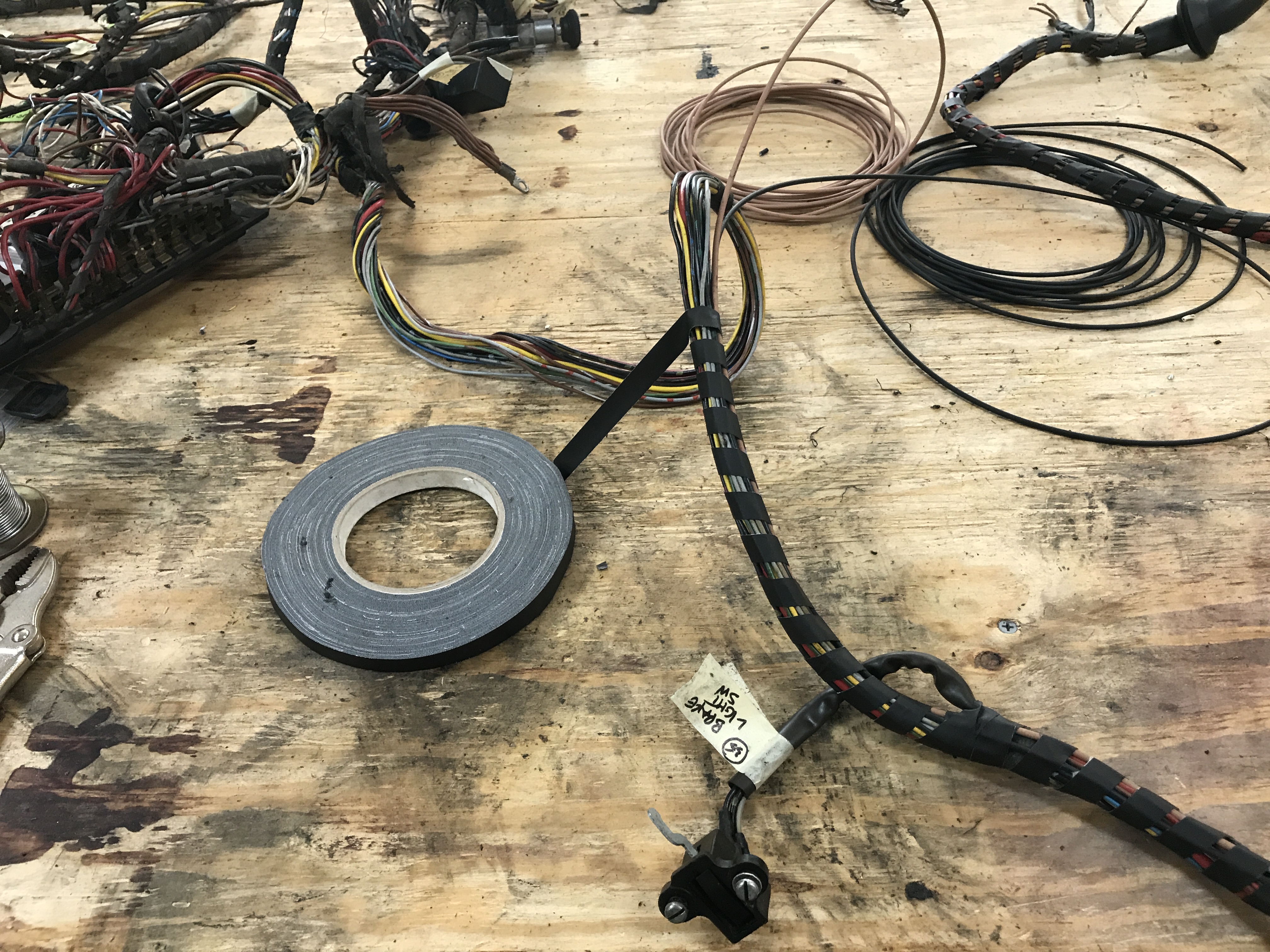

I got as far forward as the brake pedal switch. More fun tomorrow!

Back to work today, cleaning and wrapping "forward" from the brake pedal switch. I am still carrying the leads for the relocated fuel pump forward.
bkrantz
post Aug 20 2020, 08:11 PM
Post #1158
Posts: 8,343
Joined: 3-August 19
From: SW Colorado
Member No.: 23,343

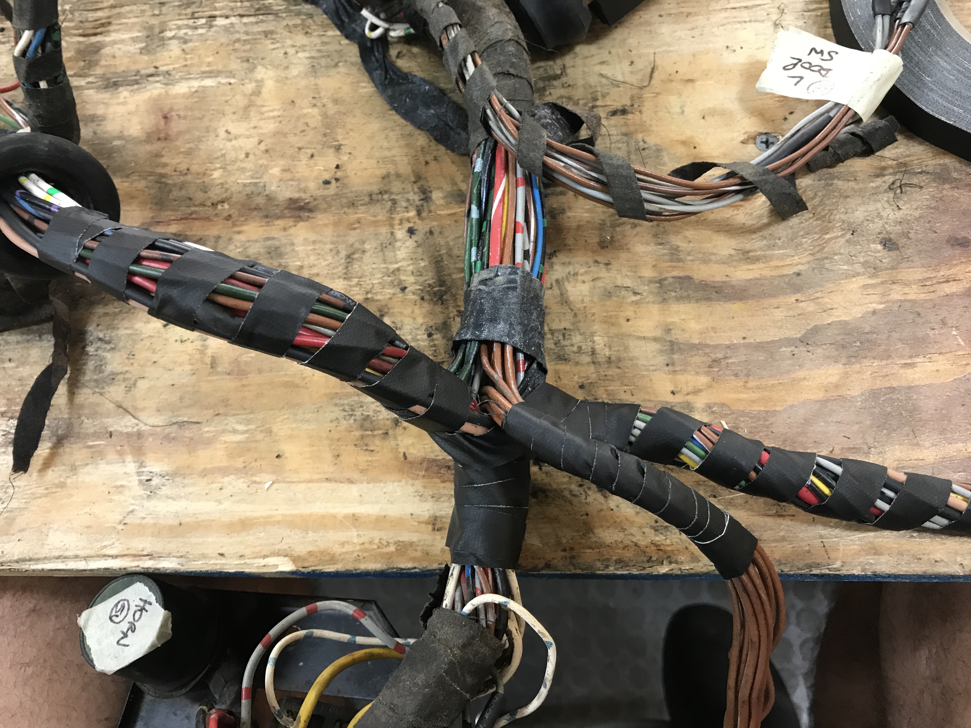

Coming to the "big junction" near the fuse-relay panel. The wires for the fuel pump continue forward, through the big rubber grommet.
bkrantz
post Aug 20 2020, 08:12 PM
Post #1159
Posts: 8,343
Joined: 3-August 19
From: SW Colorado
Member No.: 23,343
Wrapping all the branches at the junction.
