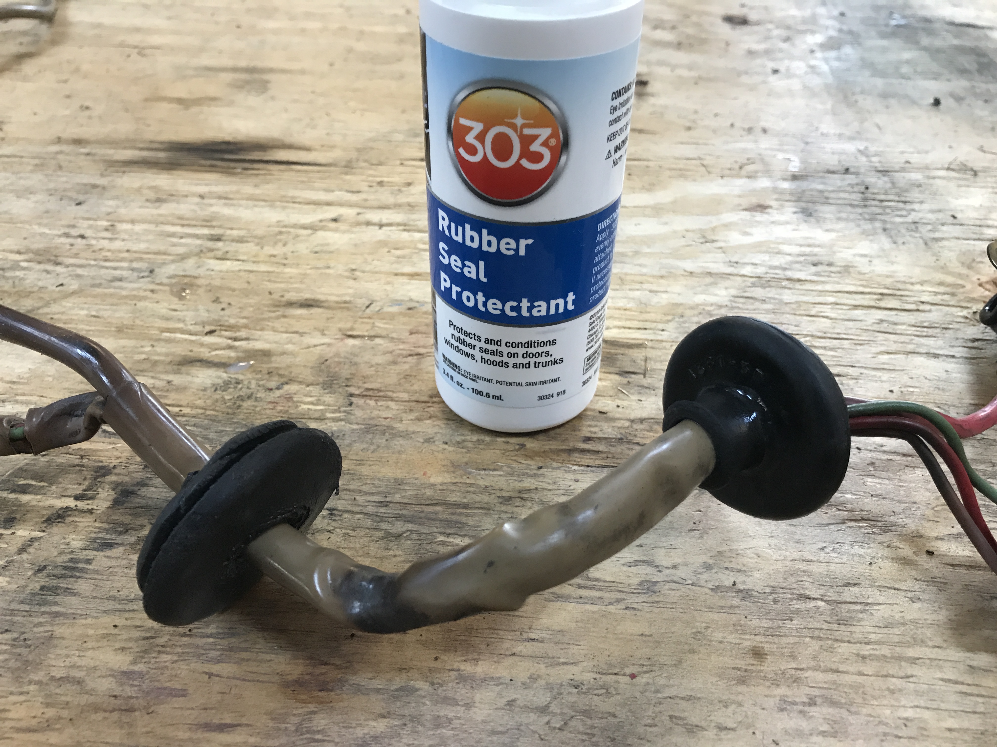

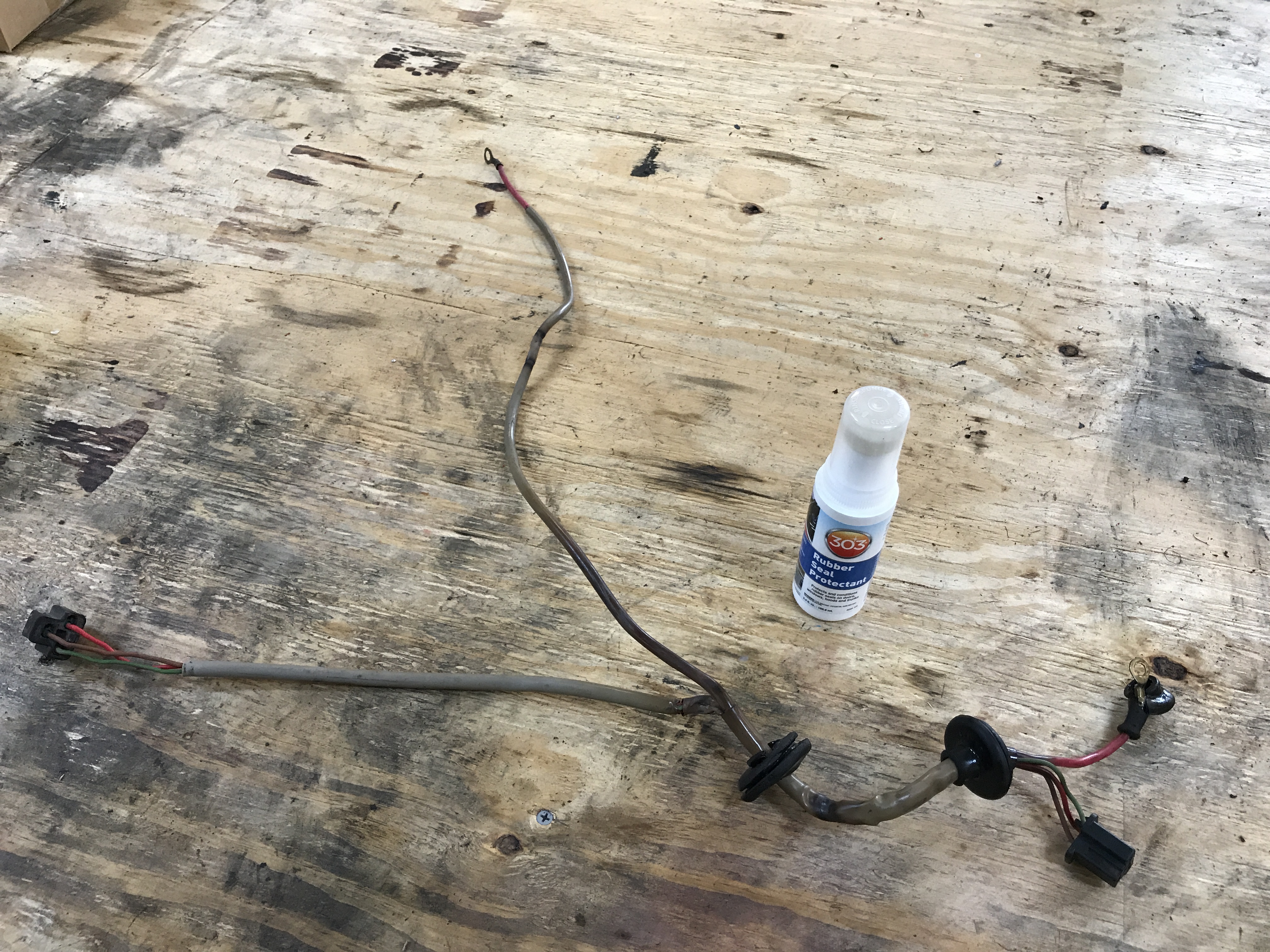

Another day another harness, this time for the alternator. The wires look very good, but the grommets are a bit crusty, and the sleeving is hard and stiff in placement.

I soaked the rubber with 303. I will see if things improve. And I ordered some new sleeve material, and may rebuild this entire harness.
bkrantz

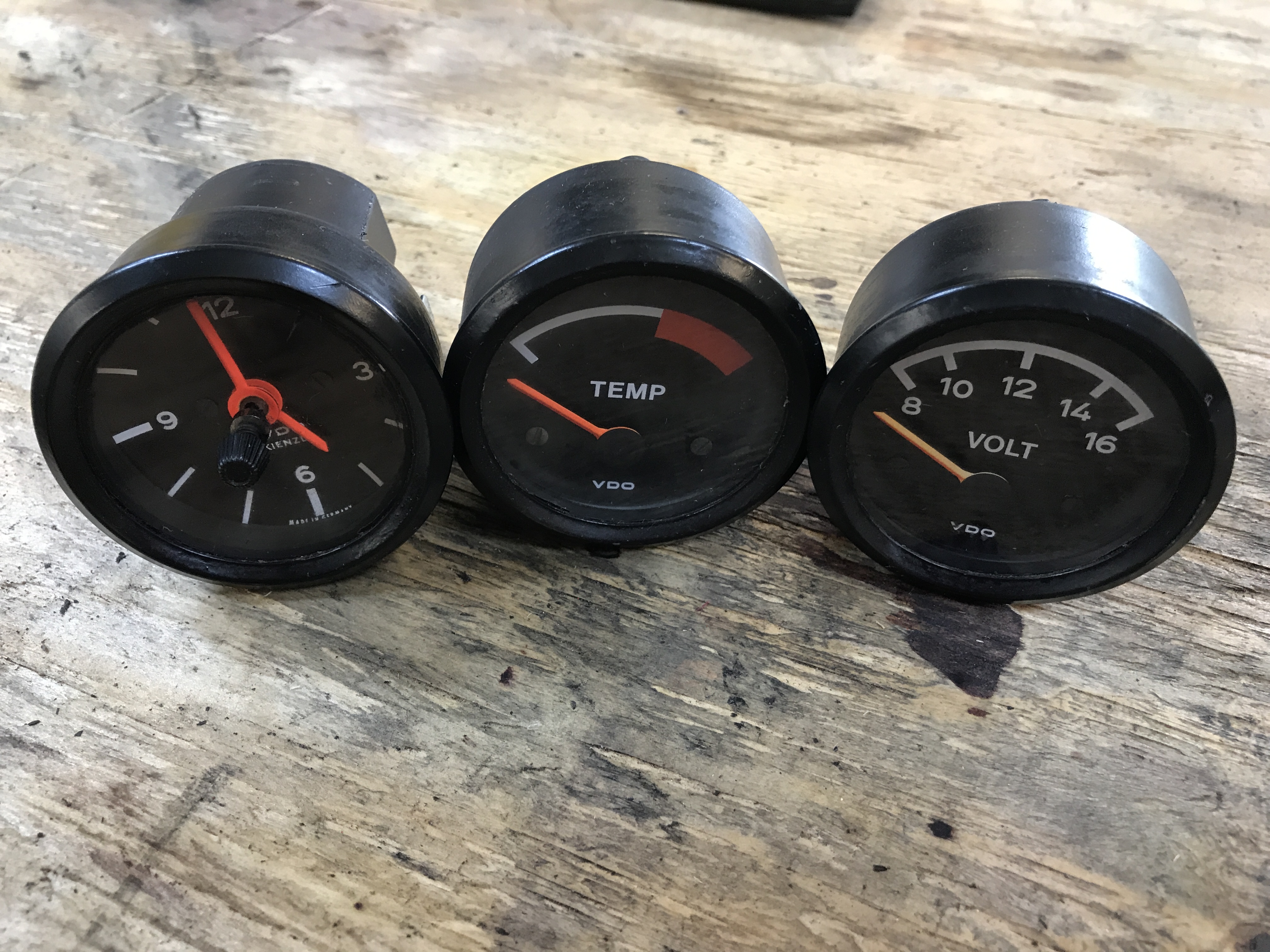

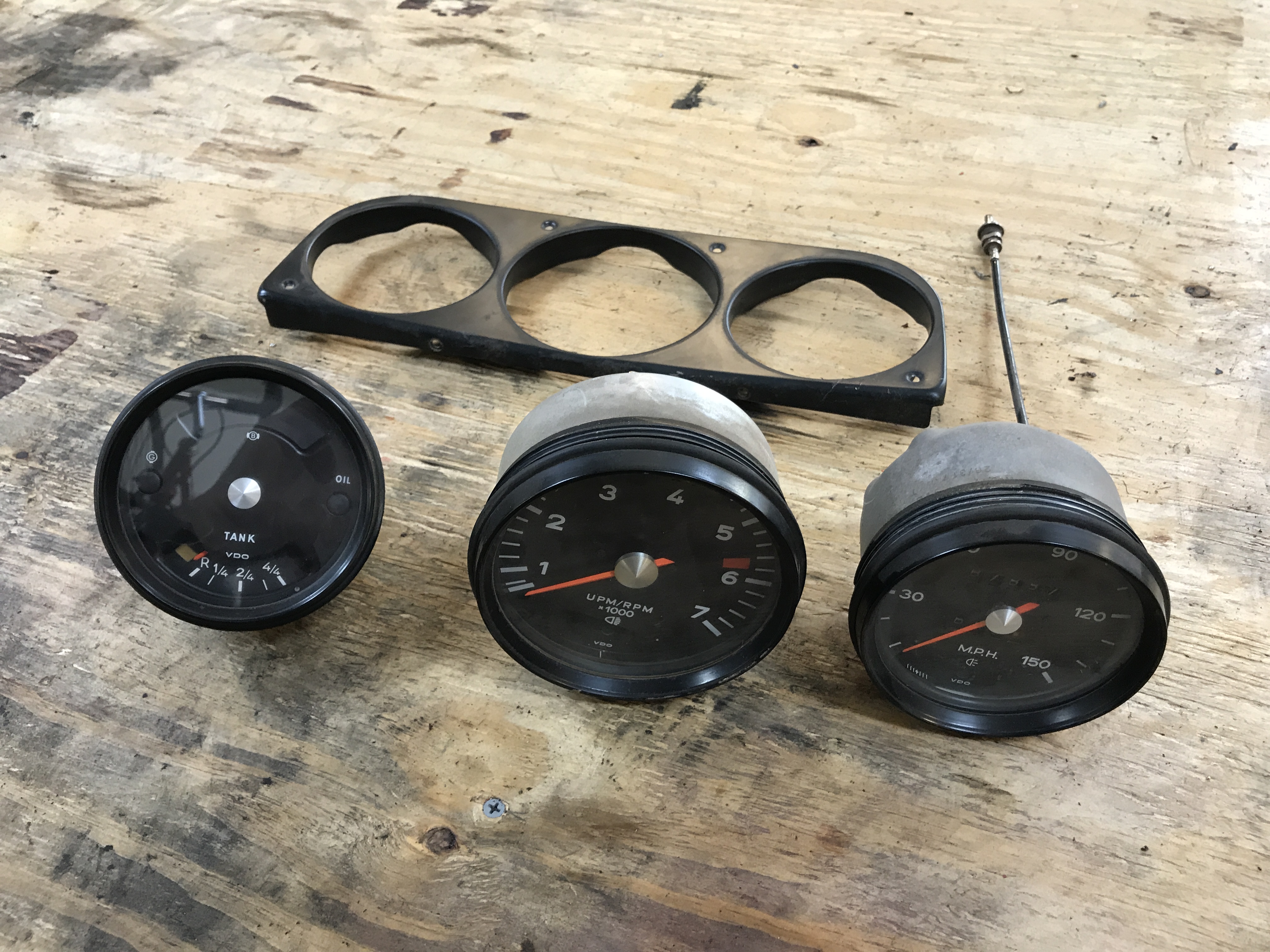

I also started poking around the gauges, and popped them out of the panel.

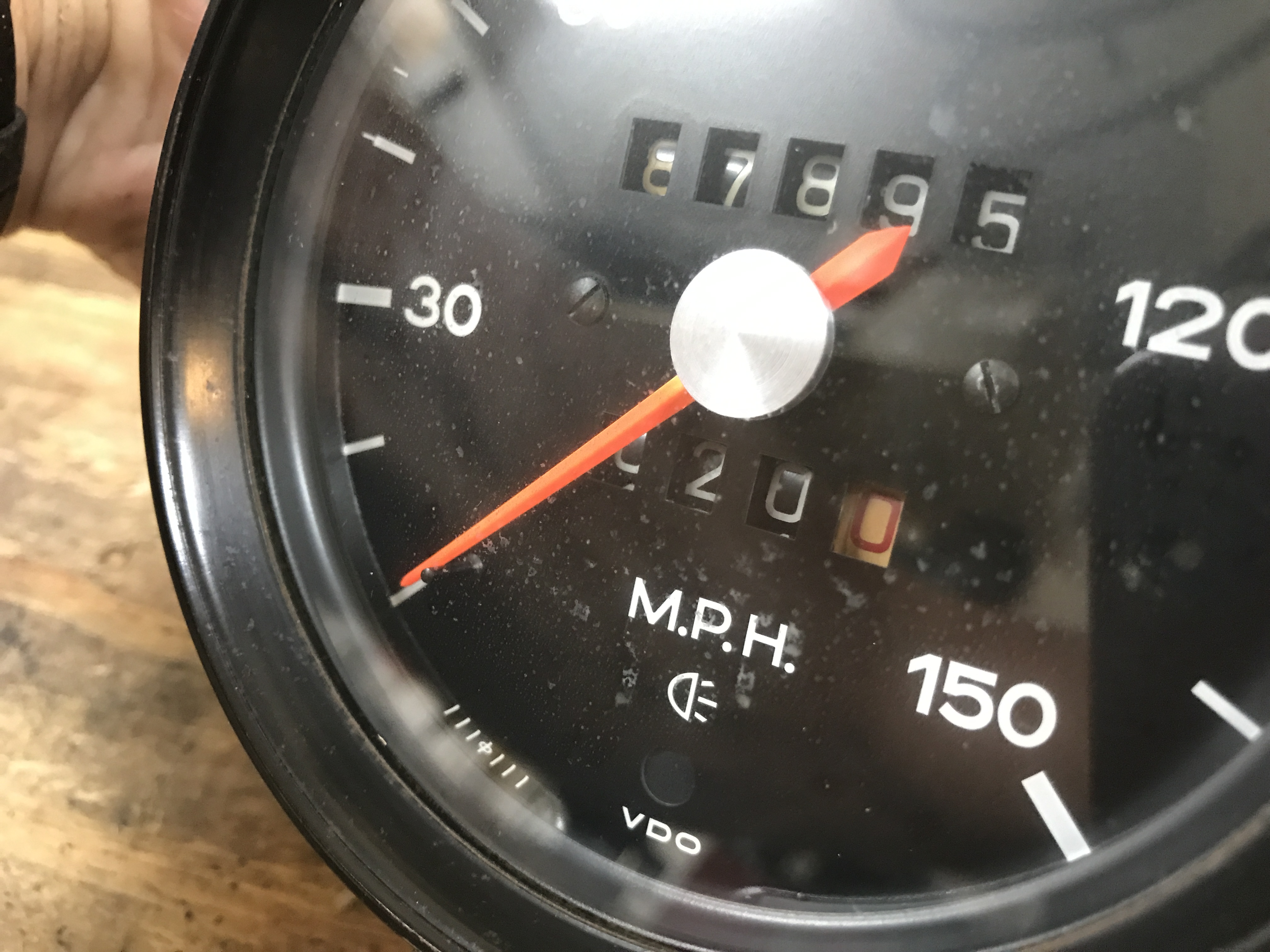

The speedometer has some spots on the inside of the glass.

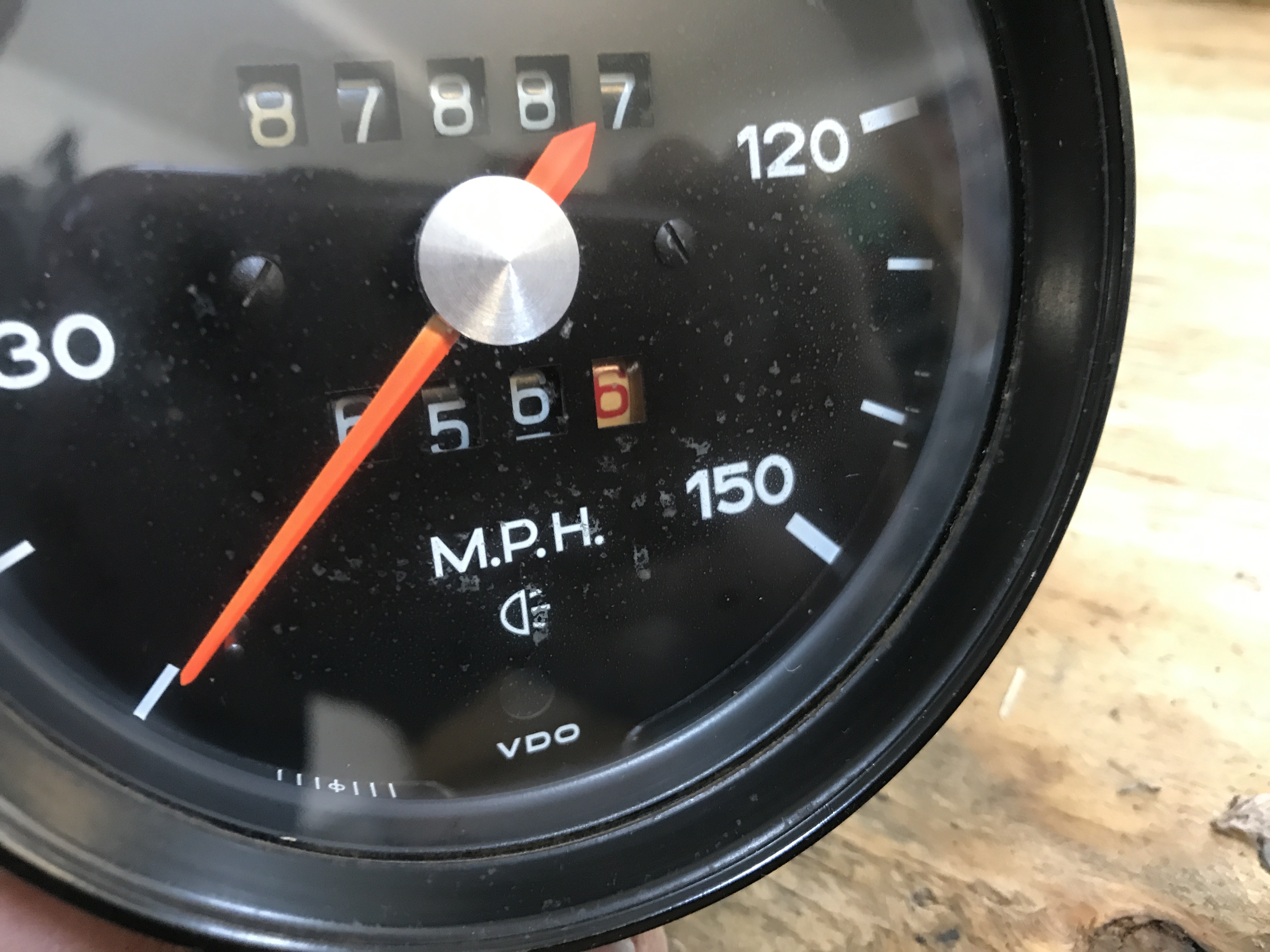

bkrantz

And the trip odometer reset does work, but the center digit does not roll consistently with the others. The bezel shows some evidence of prior opening. I may open it up again.
bkrantz

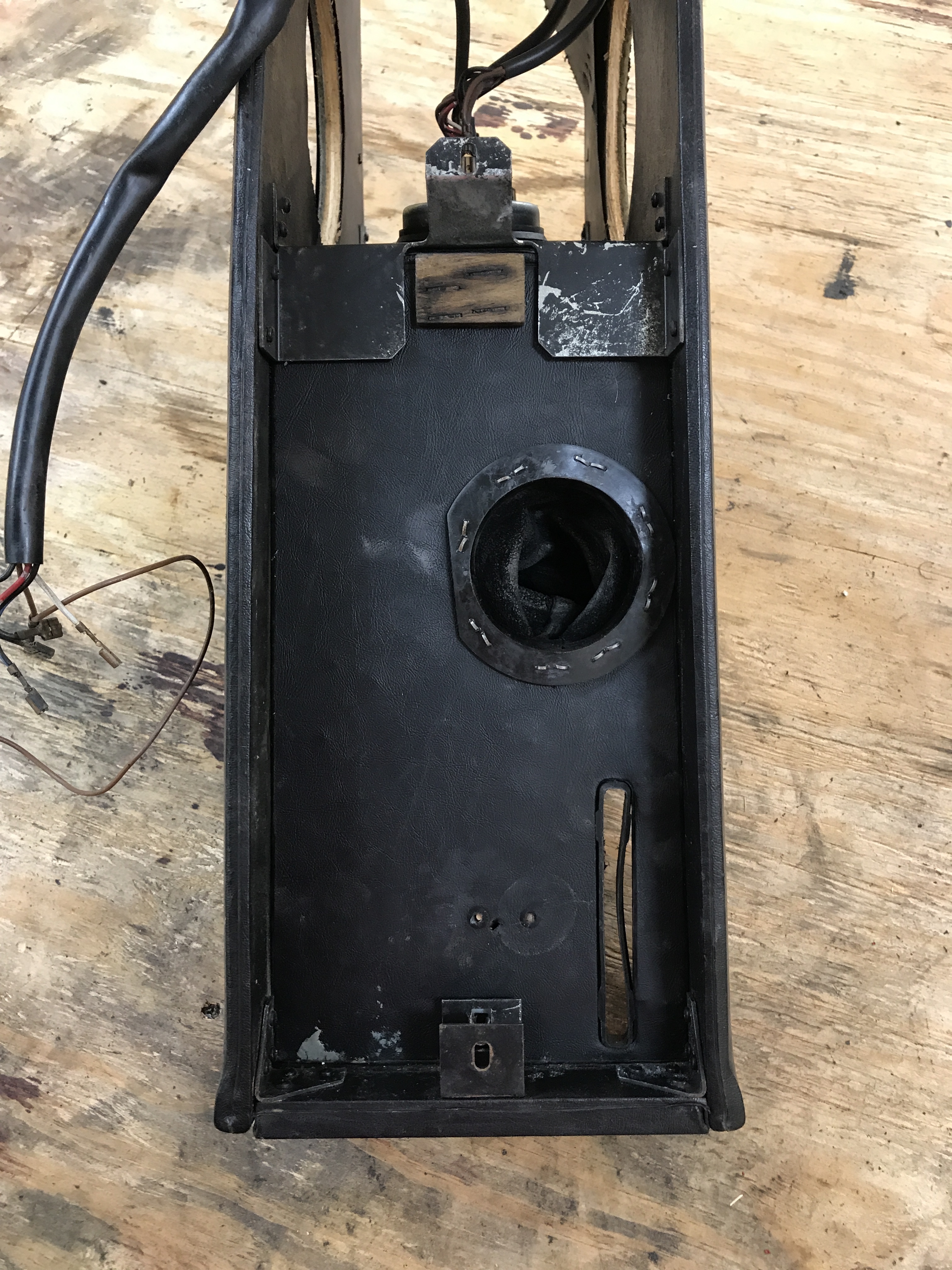

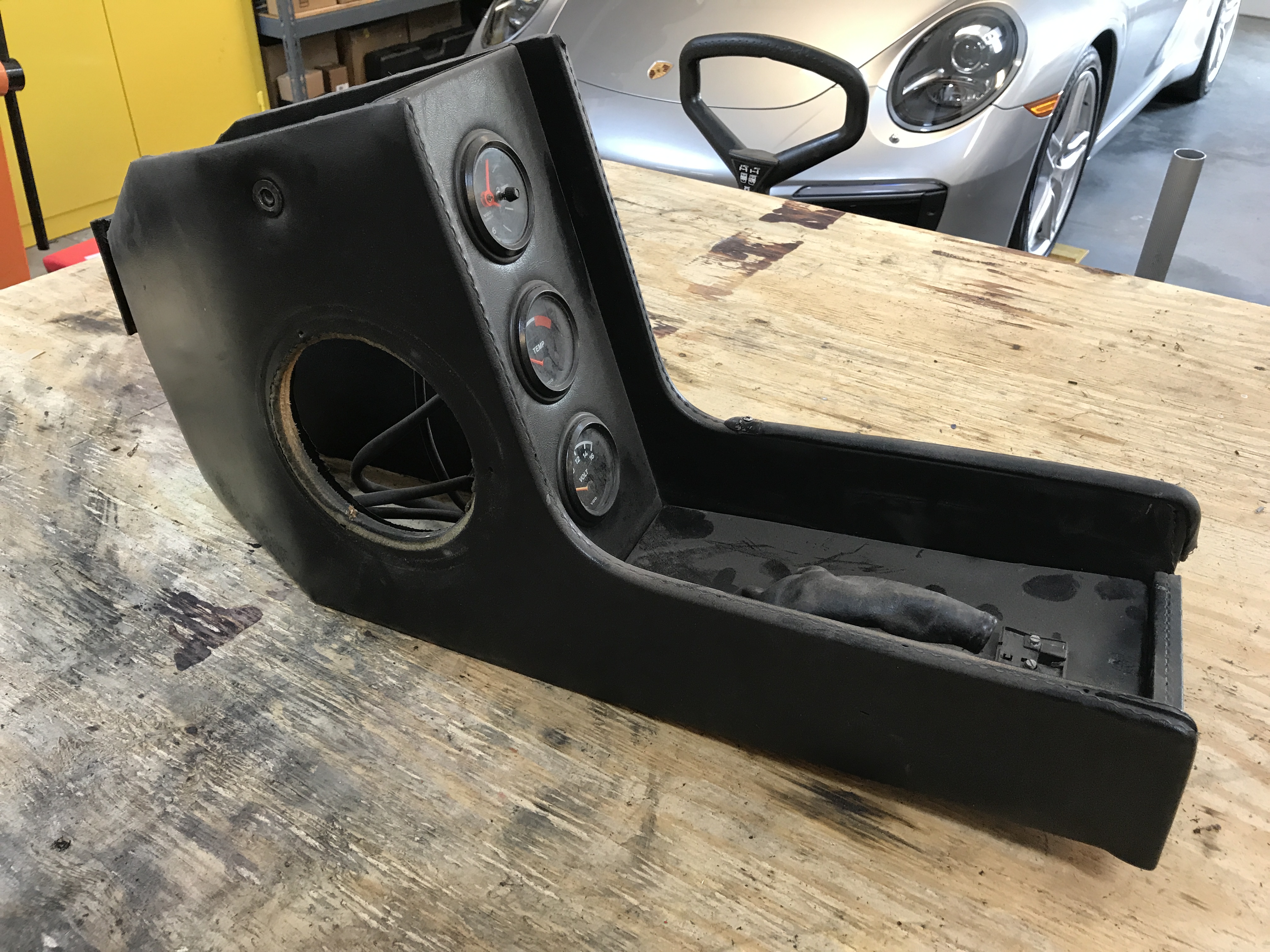

I took a close look (and more) at the center console today. It is basically solid, but needs some work. Check out the PO speaker holes. How else can you get 4 speakers in a 914?

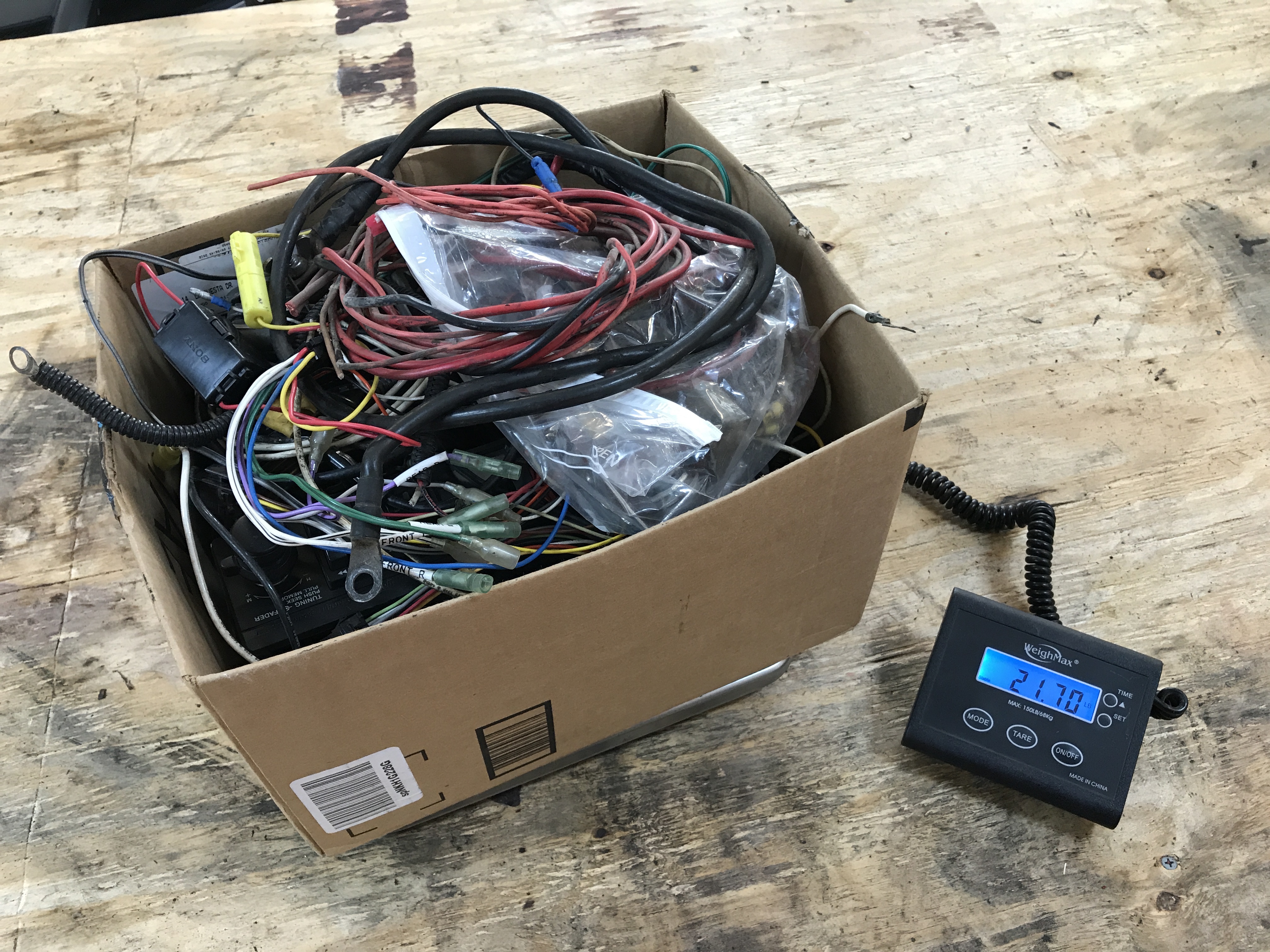

BTW, if anyone wants some vintage electronics, just let me know. Installation not included!

Back to the console. All the original hardware is there.

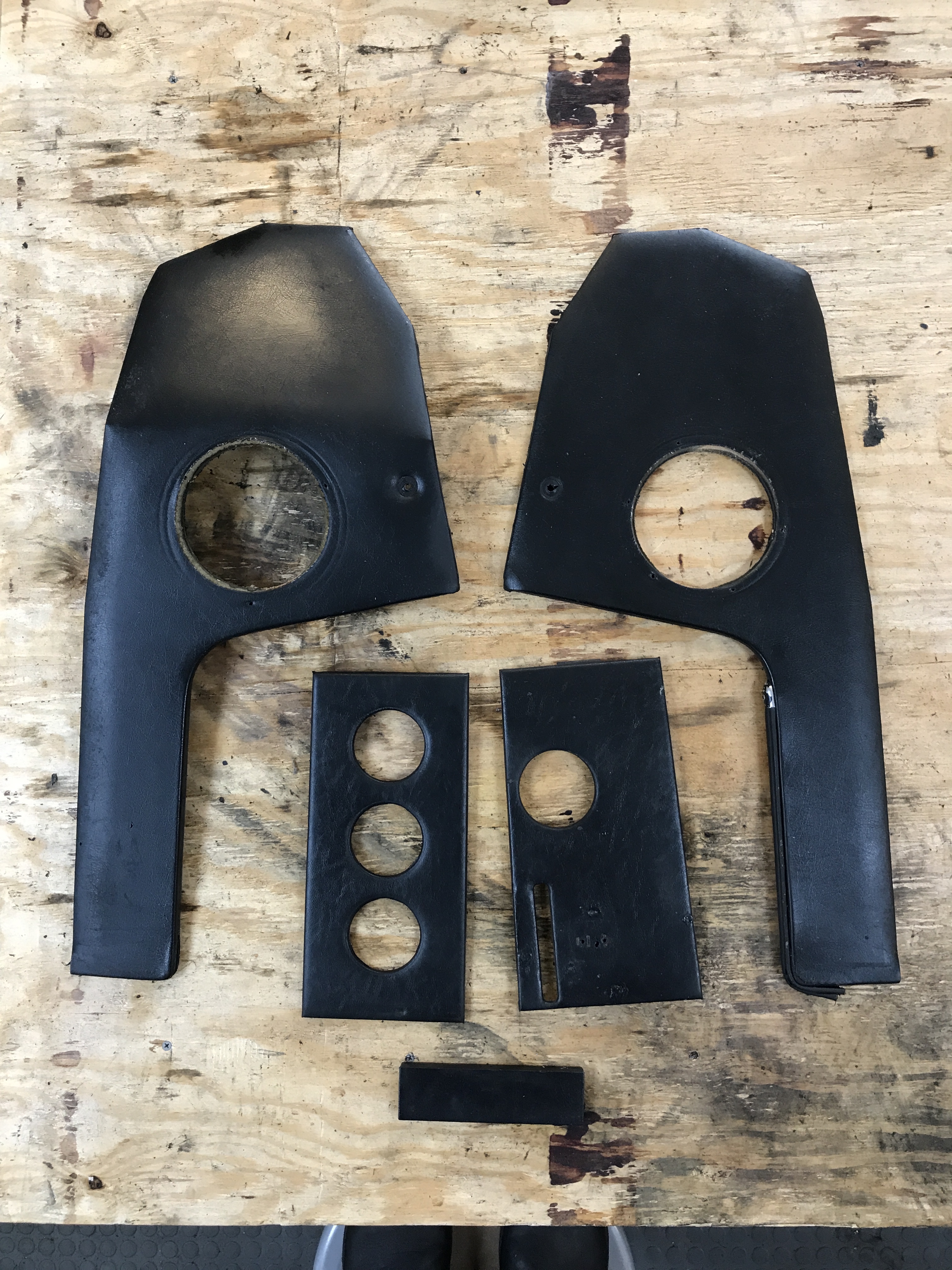

Here are all the pieces, ready for repair and recovering.

The gauges look OK from the outside, and the bezel rings have never been opened. But the temp gauge has something loose inside rattling around. Oops.

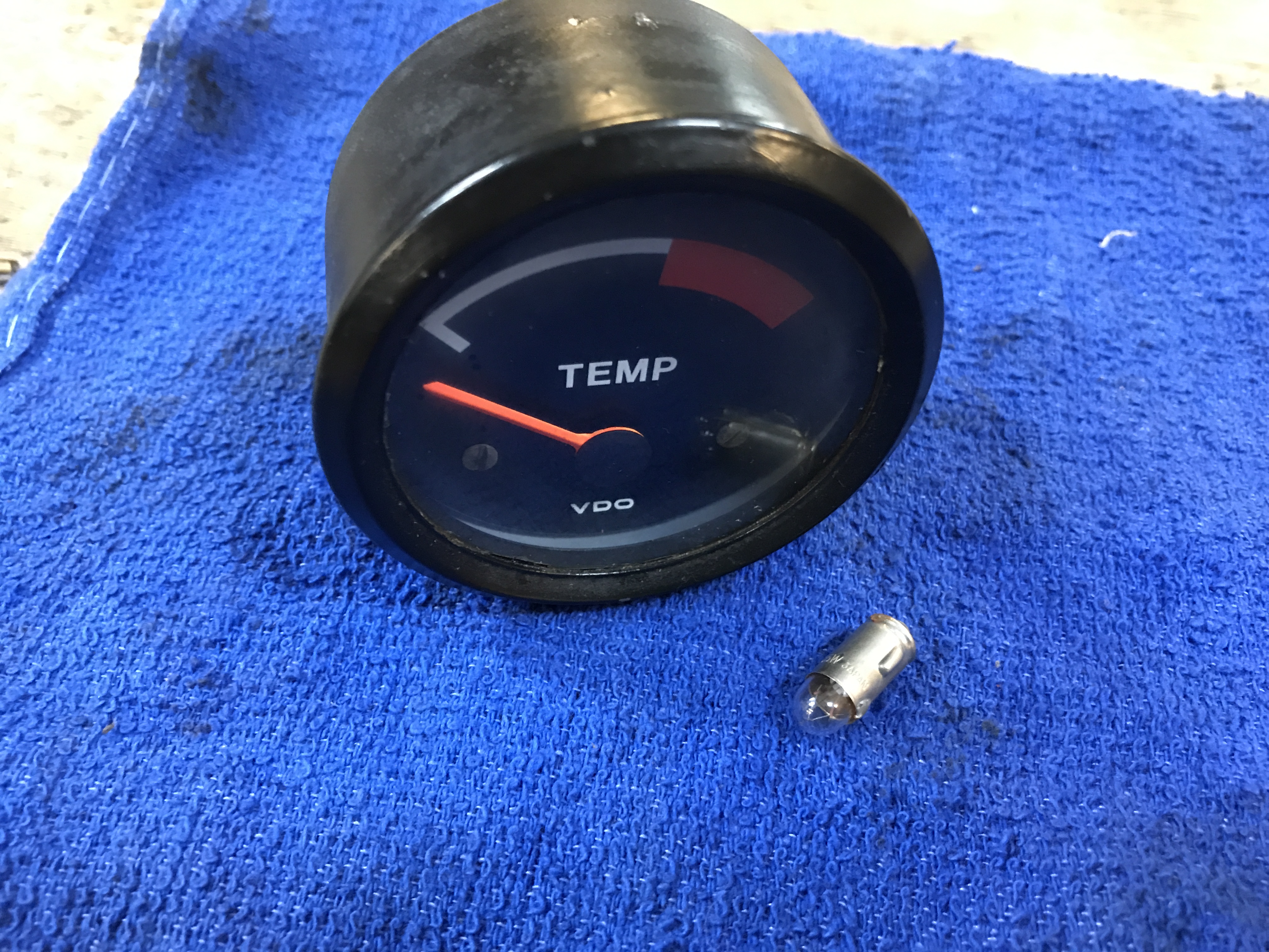

I had some good luck today (I think). Before opening the temp gauge I rotated and tilted it, and a light bulb fell out of the lamp hole. The holder did have another bulb, so this happened some time in the past.
And when I applied some current to the gauge, it responded.

But less luck with the clock. I applied 12 volts but got nothing.

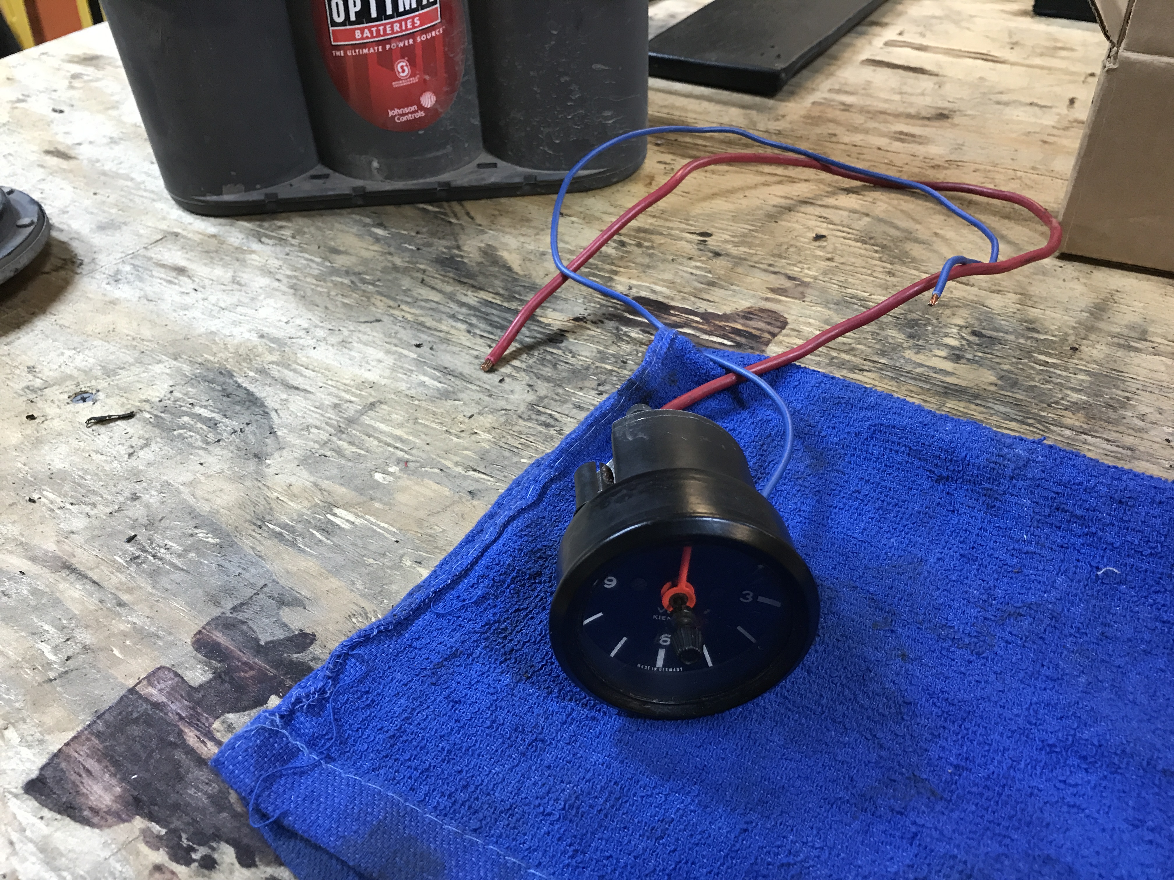

bkrantz

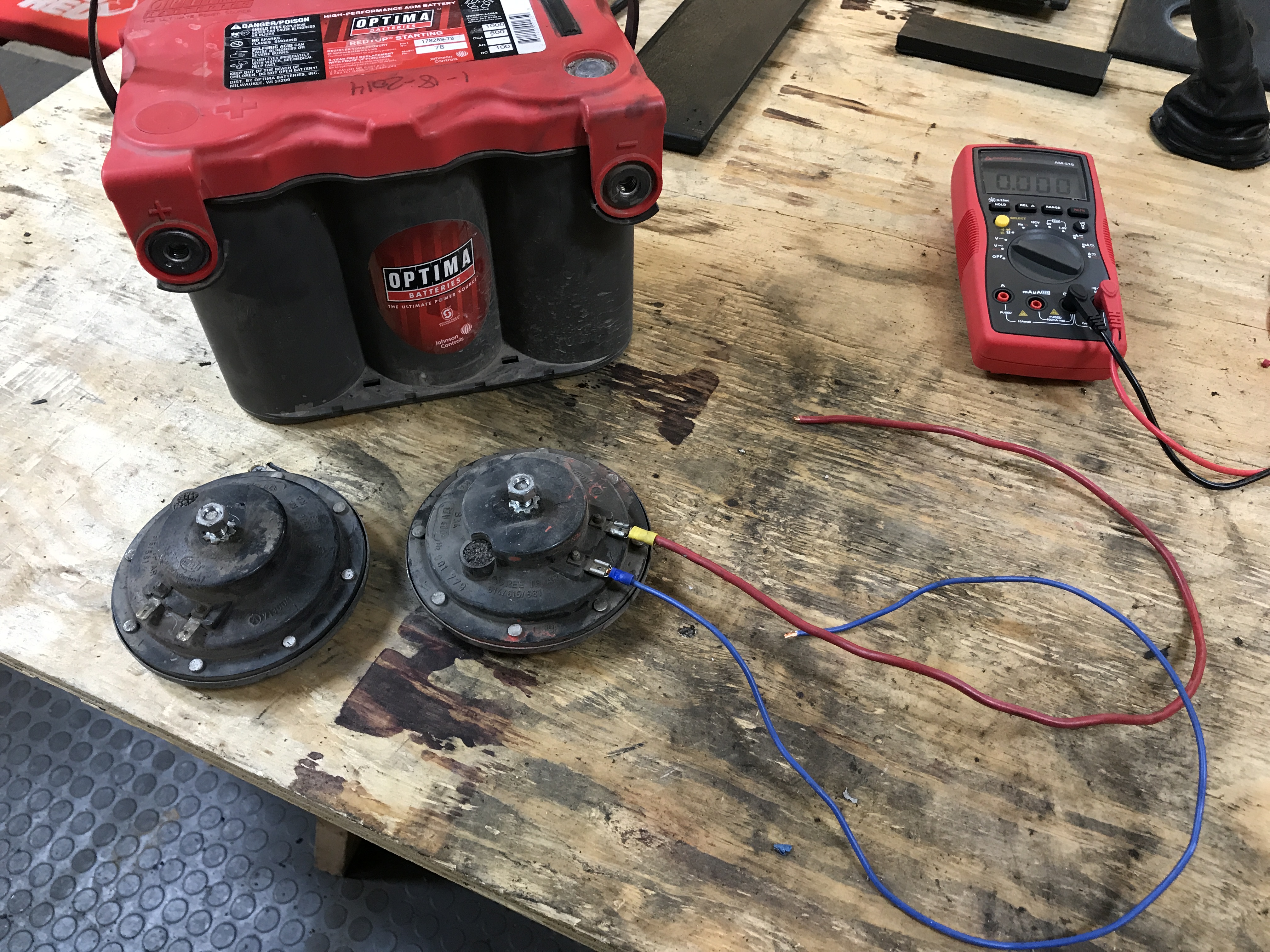

While I was testing my luck, I grabbed the horns. One makes good noise, the other is silent. So, .500 overall.

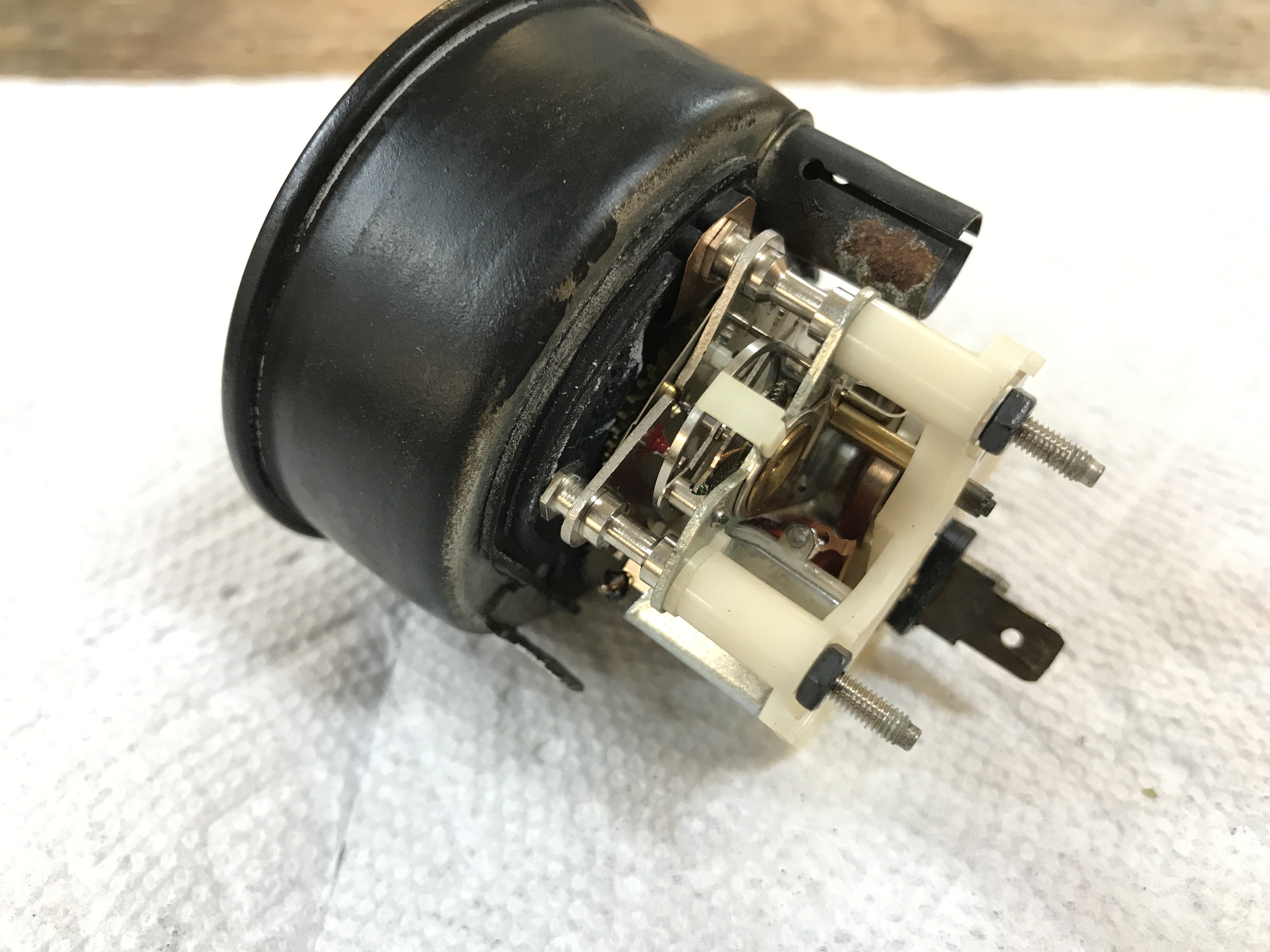

QUOTE(bkrantz @ Aug 26 2020, 07:53 PM) *
There are some good articles on repairing the clocks. Looks like yours is the early, self-winding version. There is a low temperature solder joint inside the clock that acts as a fuse which is where they usually fail. On my clock, I just had to remelt the existing solder to reconnect the fuse. After that, a good clean and re-lubricating with clock oil and she has been ticking along just fine. (IMG:style_emoticons/default/beerchug.gif)
bkrantz
post Aug 27 2020, 07:20 PM
Post #1198
Posts: 8,343
Joined: 3-August 19
From: SW Colorado
Member No.: 23,343

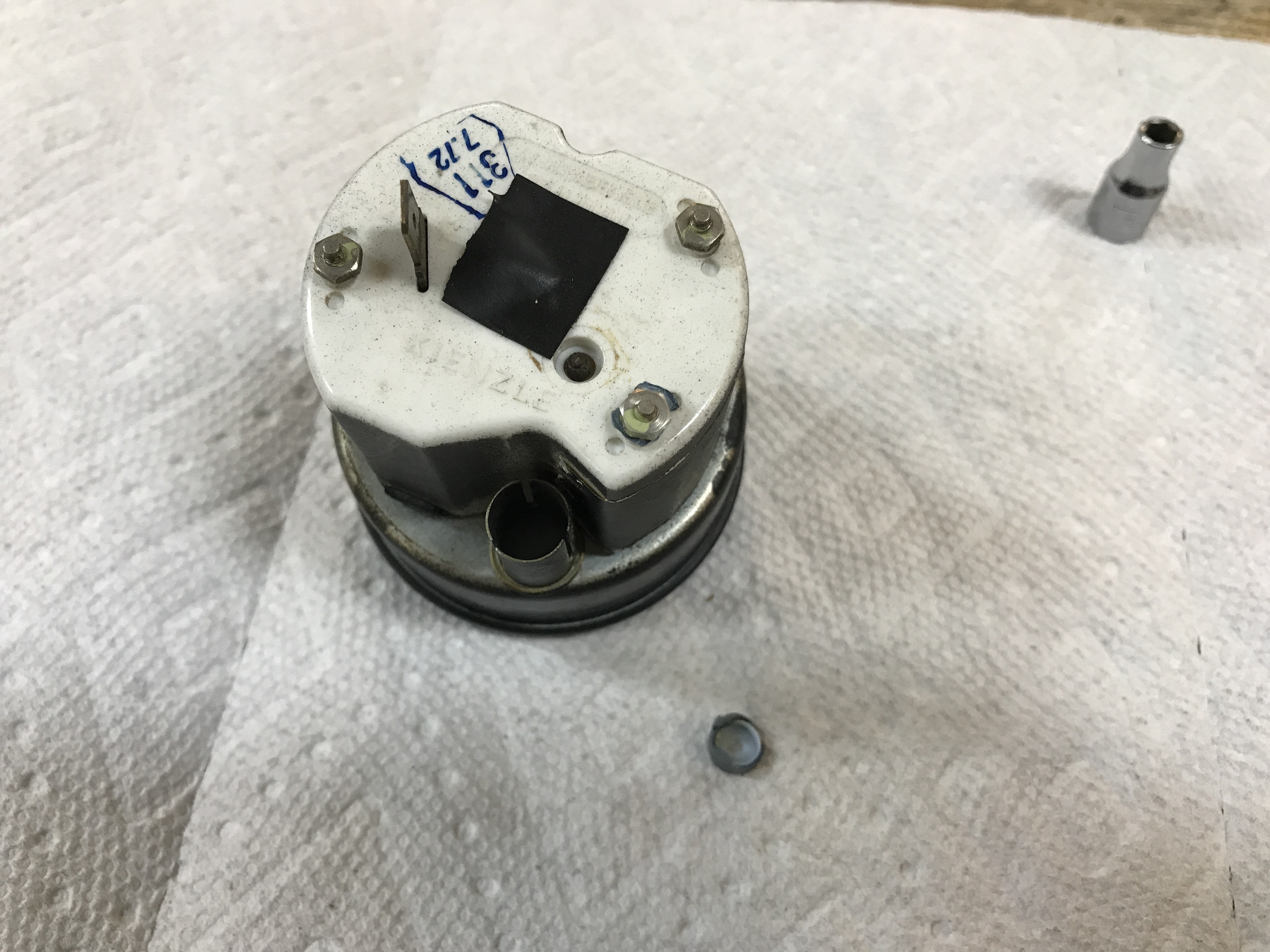

Thanks, Brent. I was looking at the info online this morning. Yes, I have the early version, with the access cover on the back attached with 3 nuts (one covered with a tamper-resistant cover).

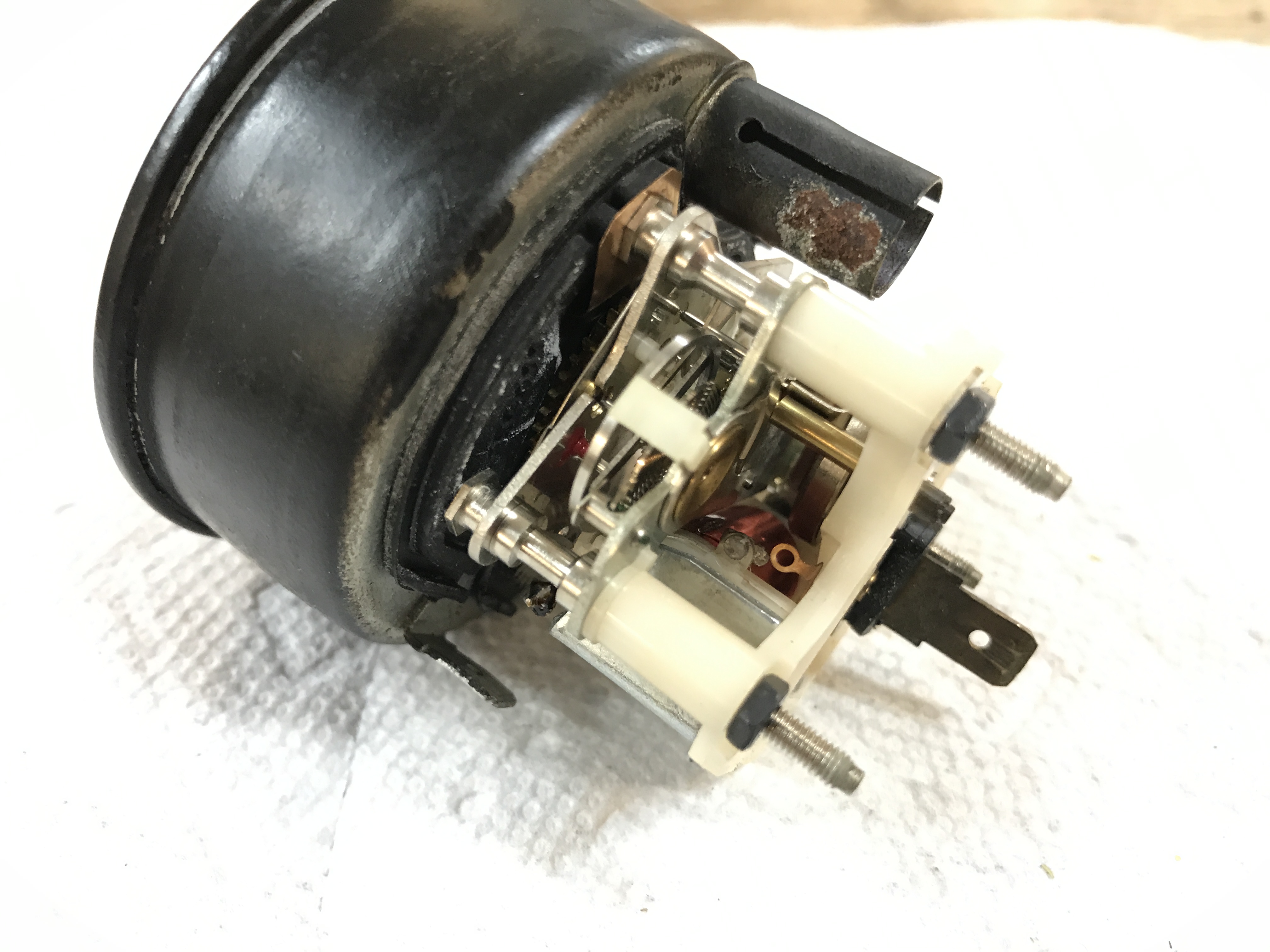

bkrantz
post Aug 27 2020, 07:23 PM
Post #1199
Posts: 8,343
Joined: 3-August 19
From: SW Colorado
Member No.: 23,343
Opened up, and with the classic "blown fuse". The small ring is part of a spring-loaded lever, and has pulled away from the soldered connection, presumably when it over-loaded and heated up.
bkrantz
post Aug 27 2020, 07:25 PM
Post #1200
Posts: 8,343
Joined: 3-August 19
From: SW Colorado
Member No.: 23,343
Like Brent did, I re-attached the ring with the existing blob of low-temp solder.
