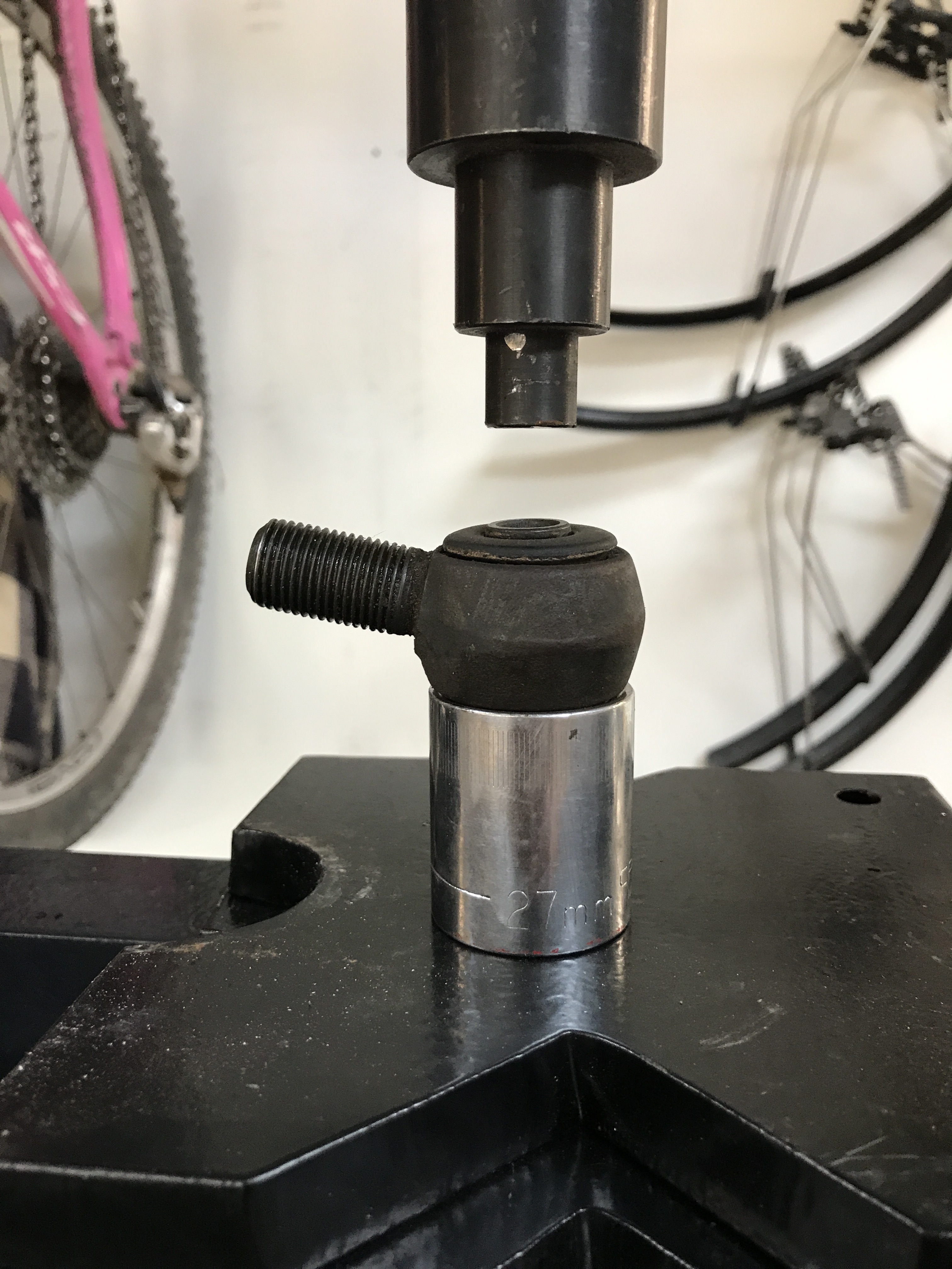

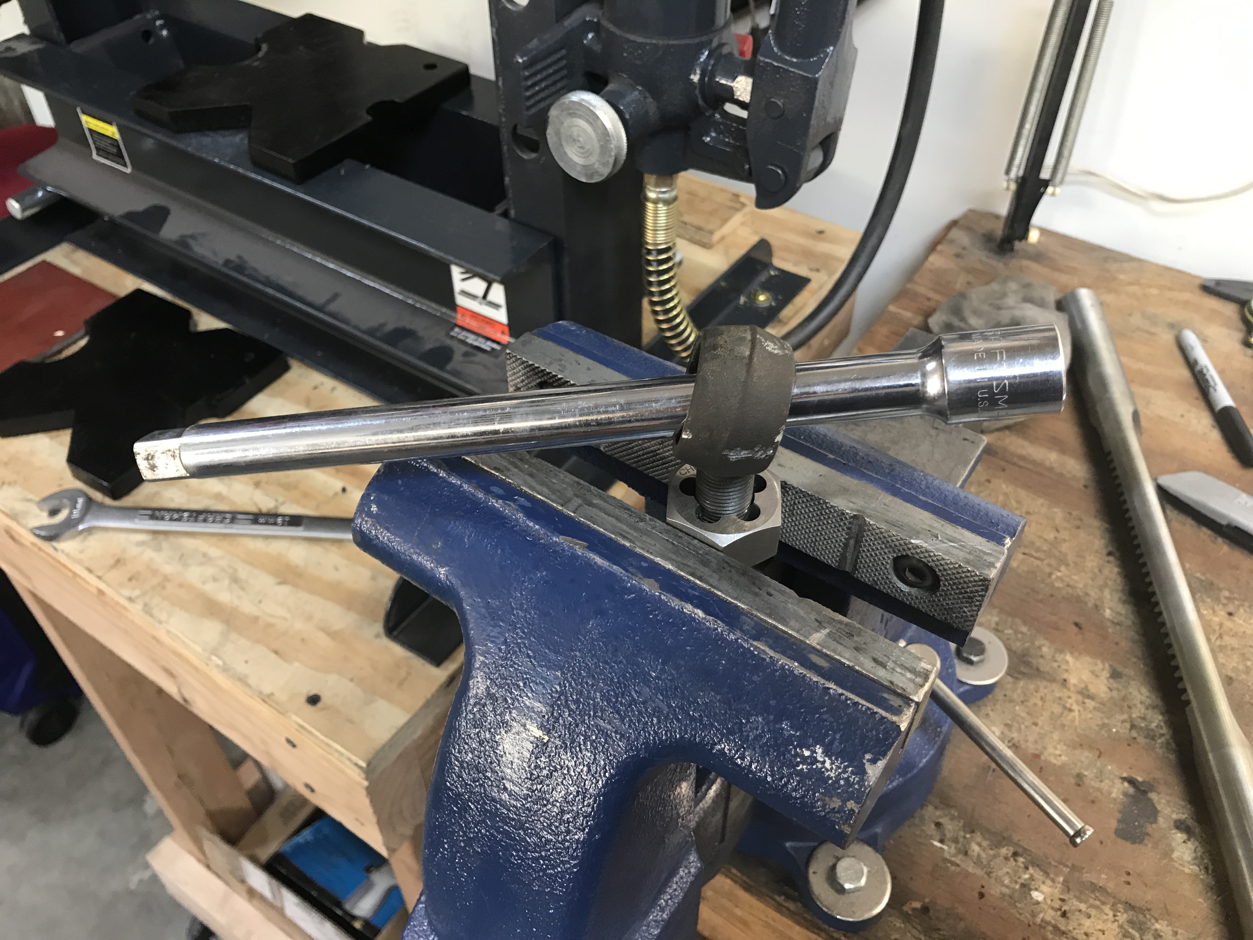

I also pressed the old bushings out of the eye bolts.
bkrantz
post Aug 30 2020, 07:41 PM
Post #1222
Posts: 8,343
Joined: 3-August 19
From: SW Colorado
Member No.: 23,343
Easy-peasy with the press. Ready for the replacement bushing kit!

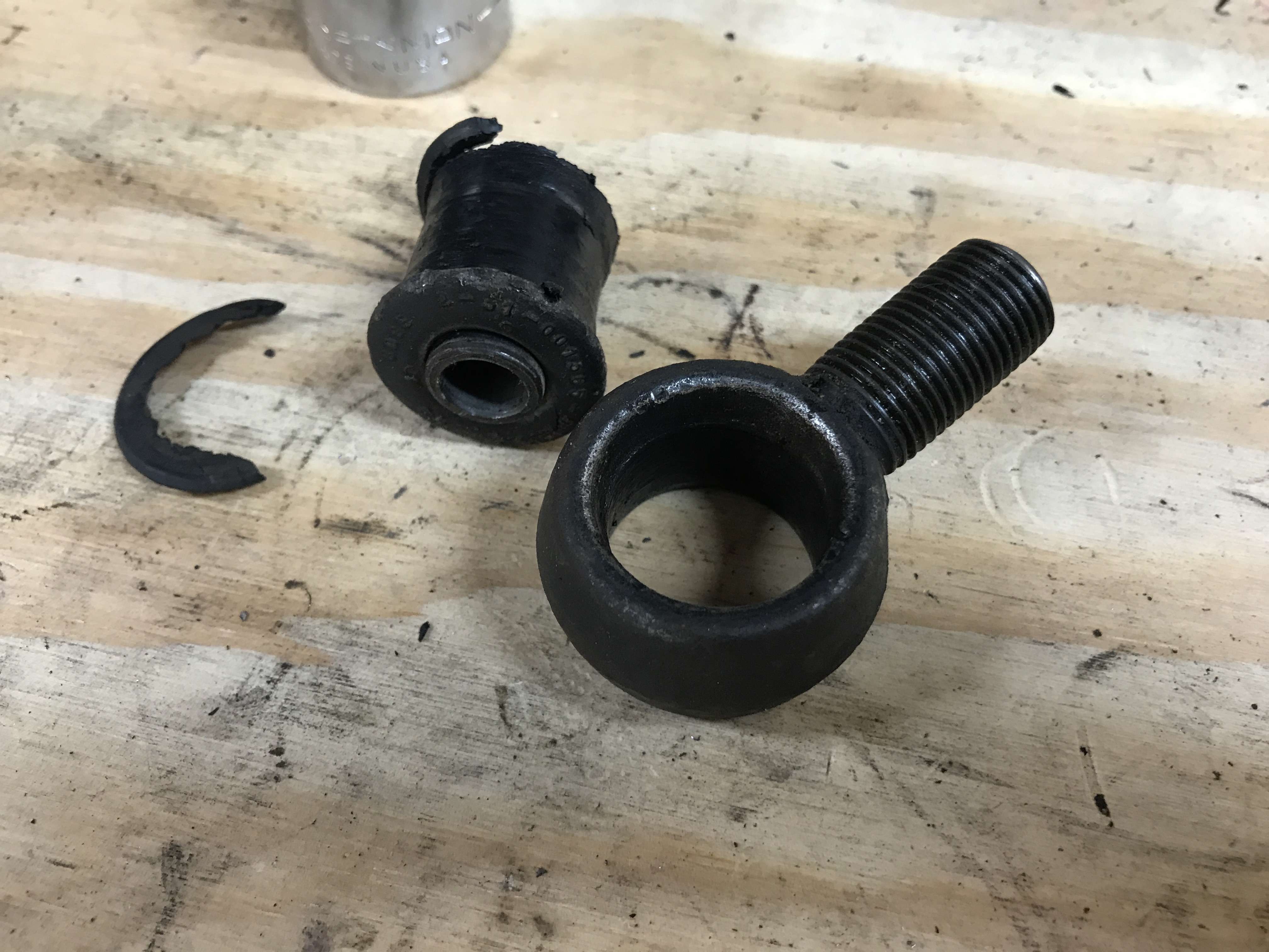

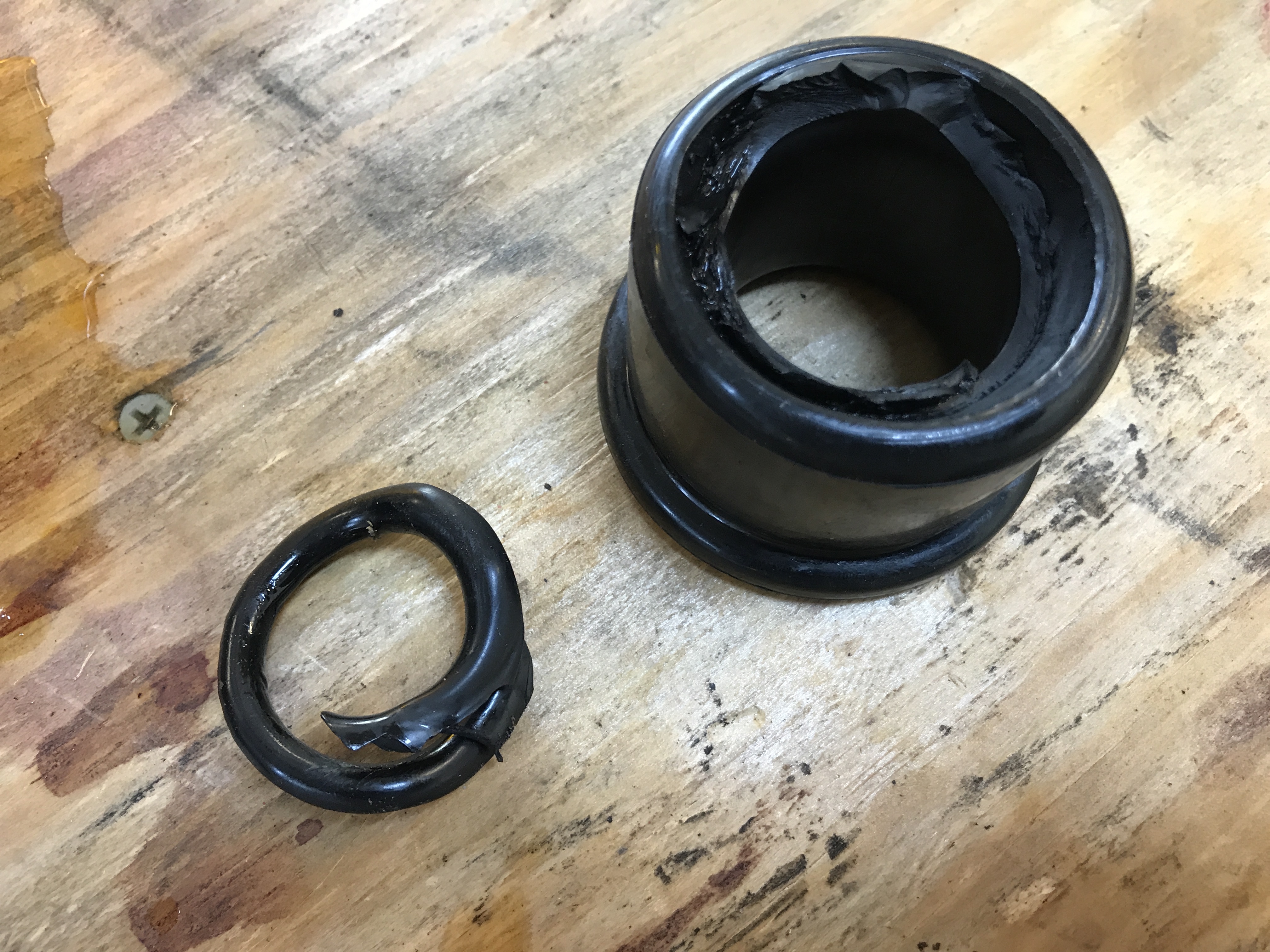

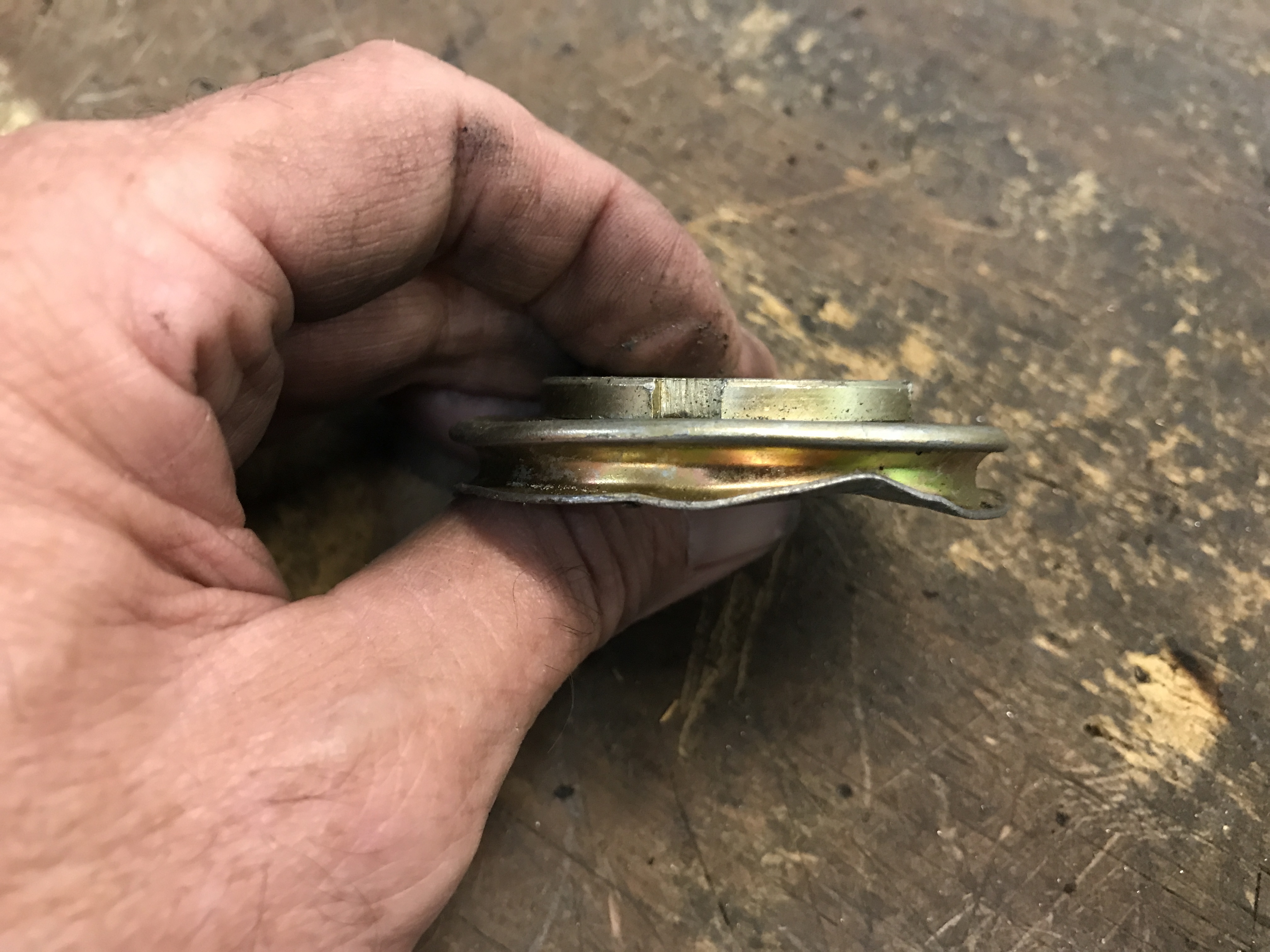

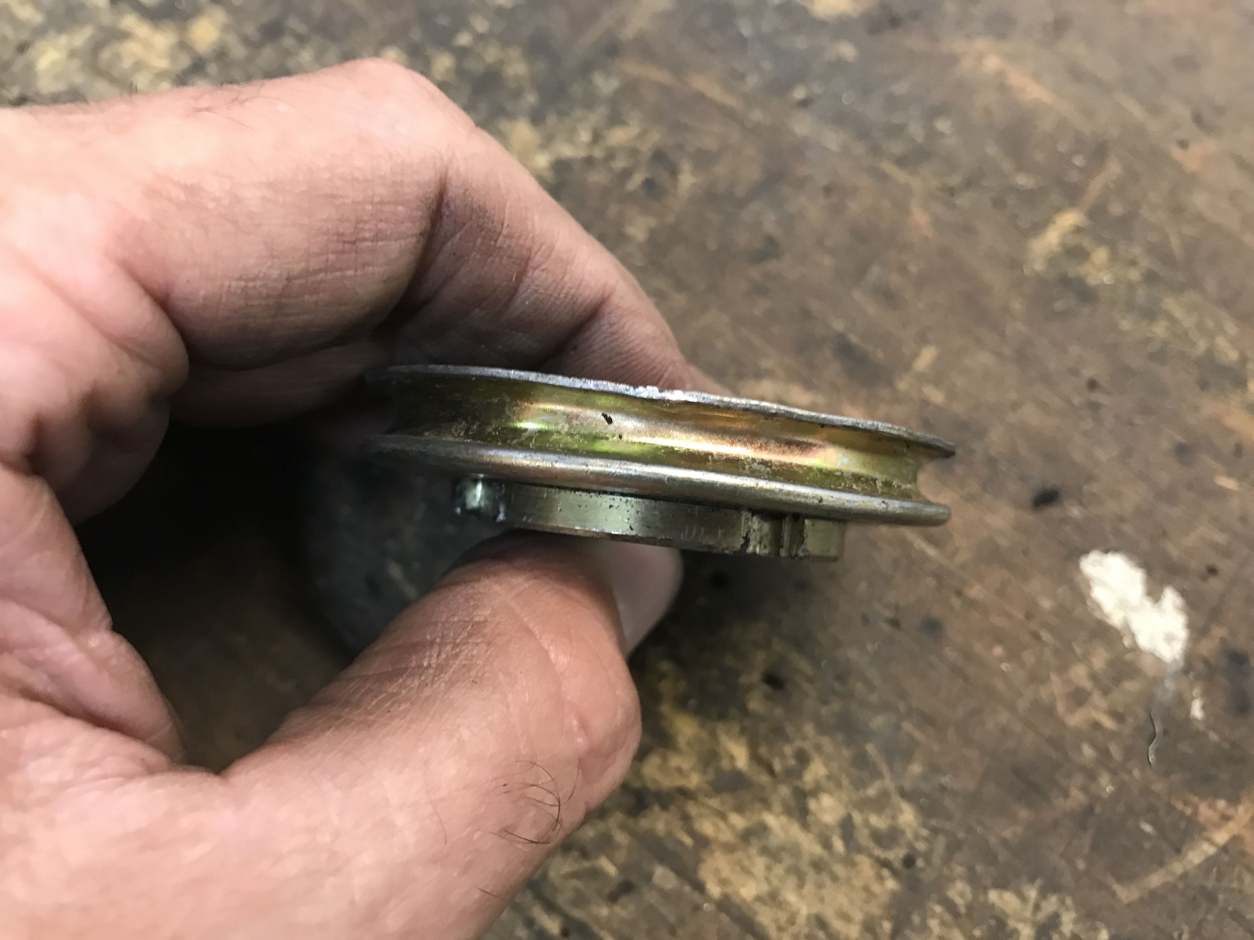

I also took on the mangled retaining ring/bellows support. Not sure how the PO did this.
bkrantz
post Aug 30 2020, 07:43 PM
Post #1224
Posts: 8,343
Joined: 3-August 19
From: SW Colorado
Member No.: 23,343
Anyway, 5 minutes later.

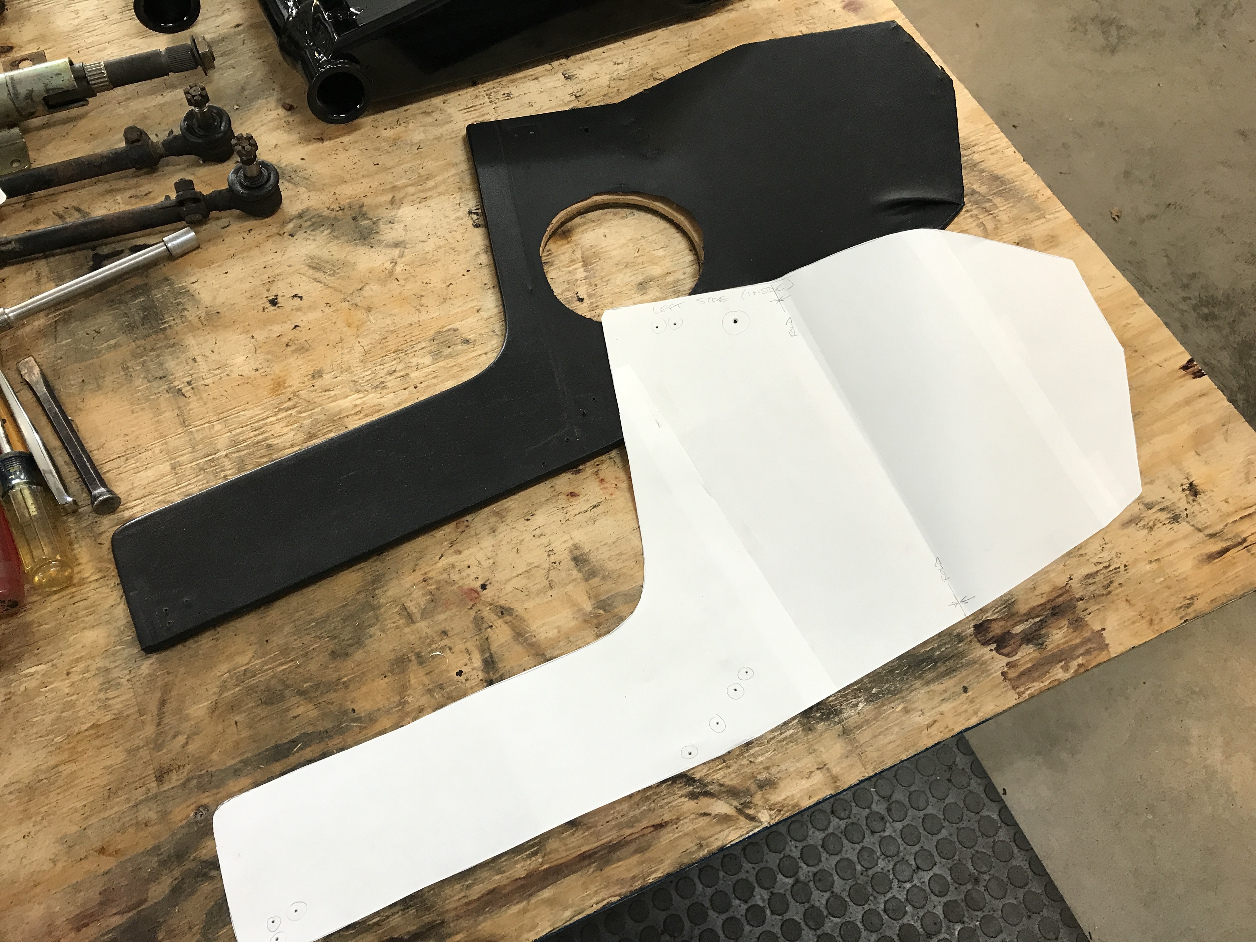

The last thing I did was make some paper templates for the center console pieces. I will probably have these recovered (after I repair the PO speaker holes), and I want to know where the screw holes are.

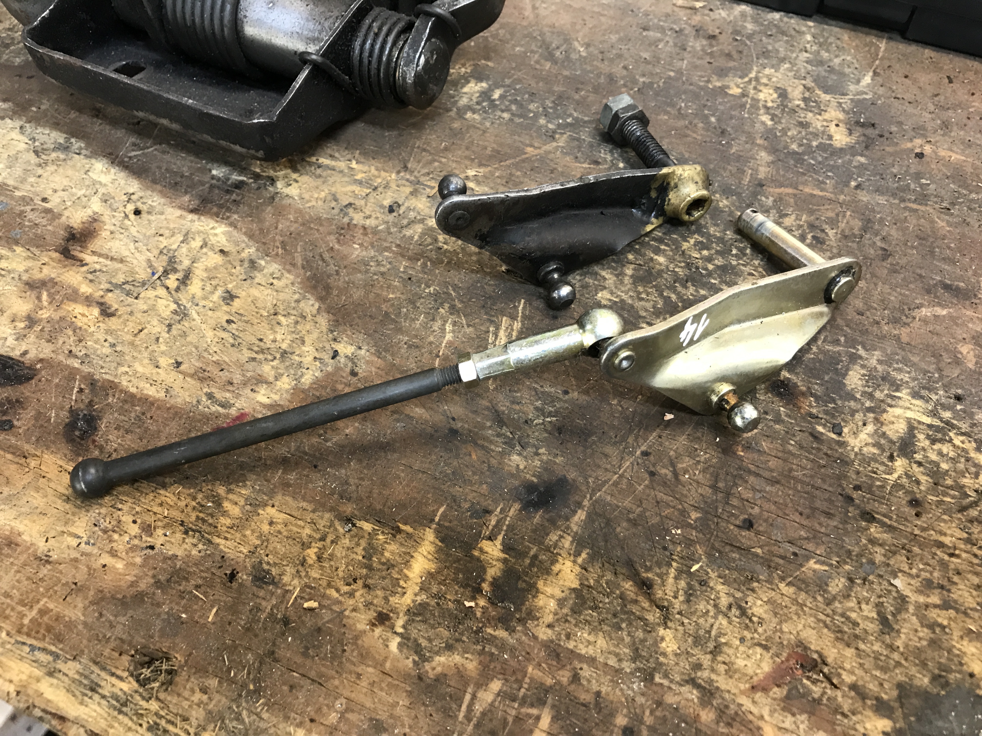

Besides all the garage work, and sending things out for various services, I am also deep into the hunt for replacement parts, both new and used.
Here's a replacement for the throttle crank arm, and the push-rod that was bent on my car.

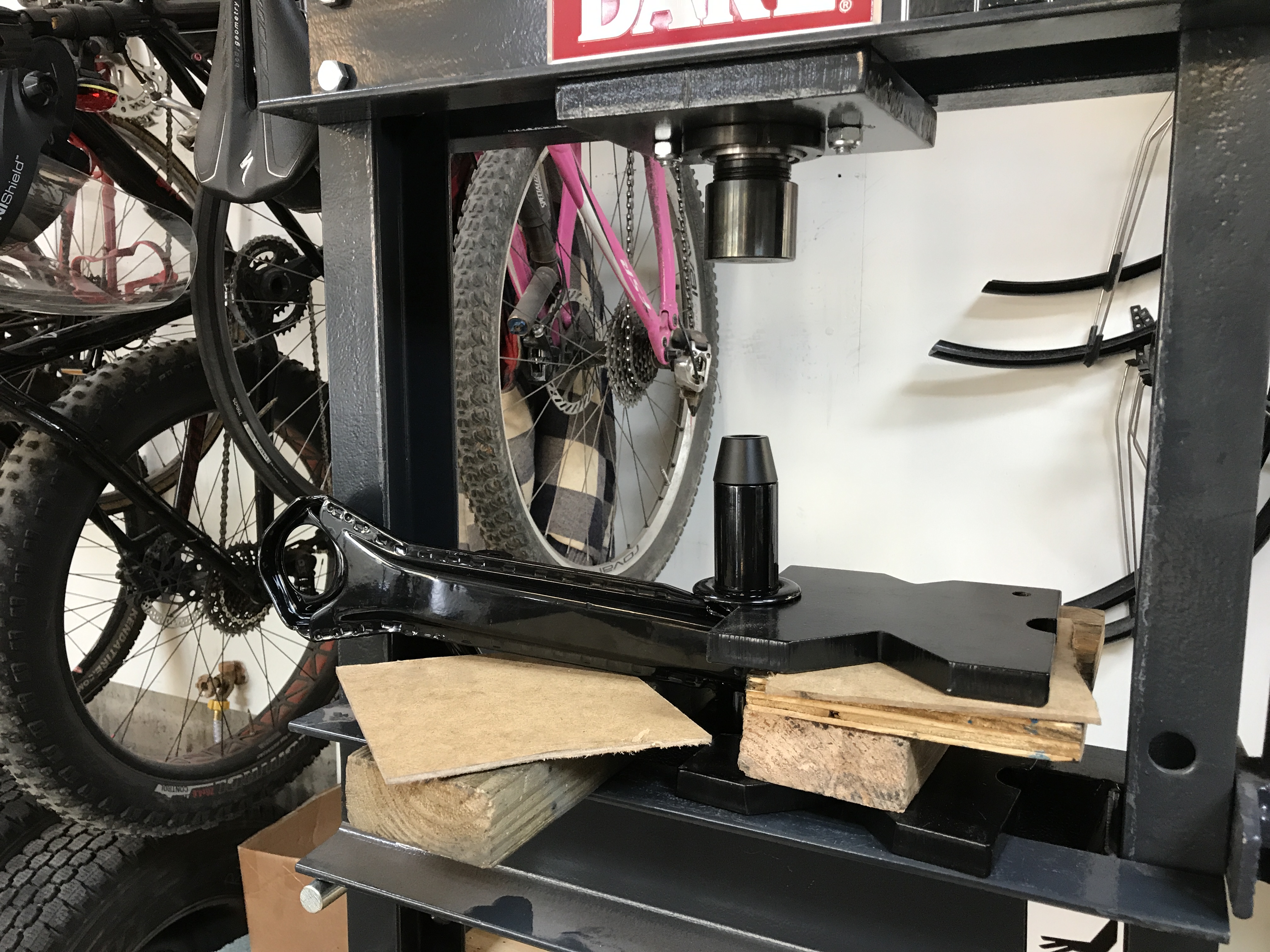

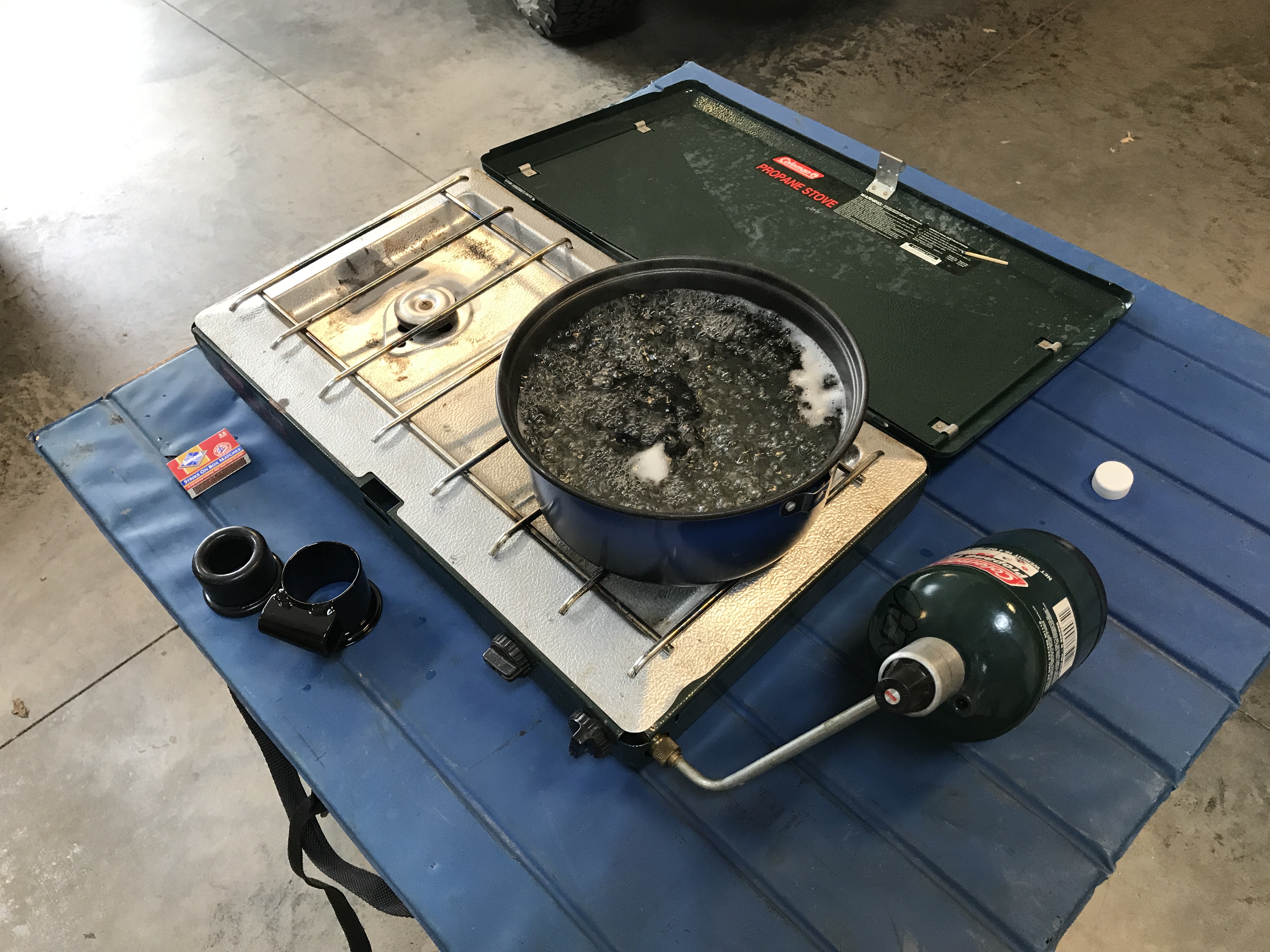

I tried mounting some bushings today, starting with the A-arms. My first attempt involved my bench-top press, and supporting the rear end of the arm with a sketchy arrangement of blocks.
bkrantz
post Aug 31 2020, 06:40 PM
Post #1228
Posts: 8,343
Joined: 3-August 19
From: SW Colorado
Member No.: 23,343
Then a bit of garage cooking to soften up the bushings (and heat up the metal parts). Note to married guys: using the camping gear avoids any evil looks in the kitchen.
bkrantz
post Aug 31 2020, 06:43 PM
Post #1229
Posts: 8,343
Joined: 3-August 19
From: SW Colorado
Member No.: 23,343
Unfortunately, my first attempt failed. I ripped the inner edge of the bushing (I think the installation tools closed on each other). And my sketchy press support started to bend the flange on the A-arm. Time to think about plan B.

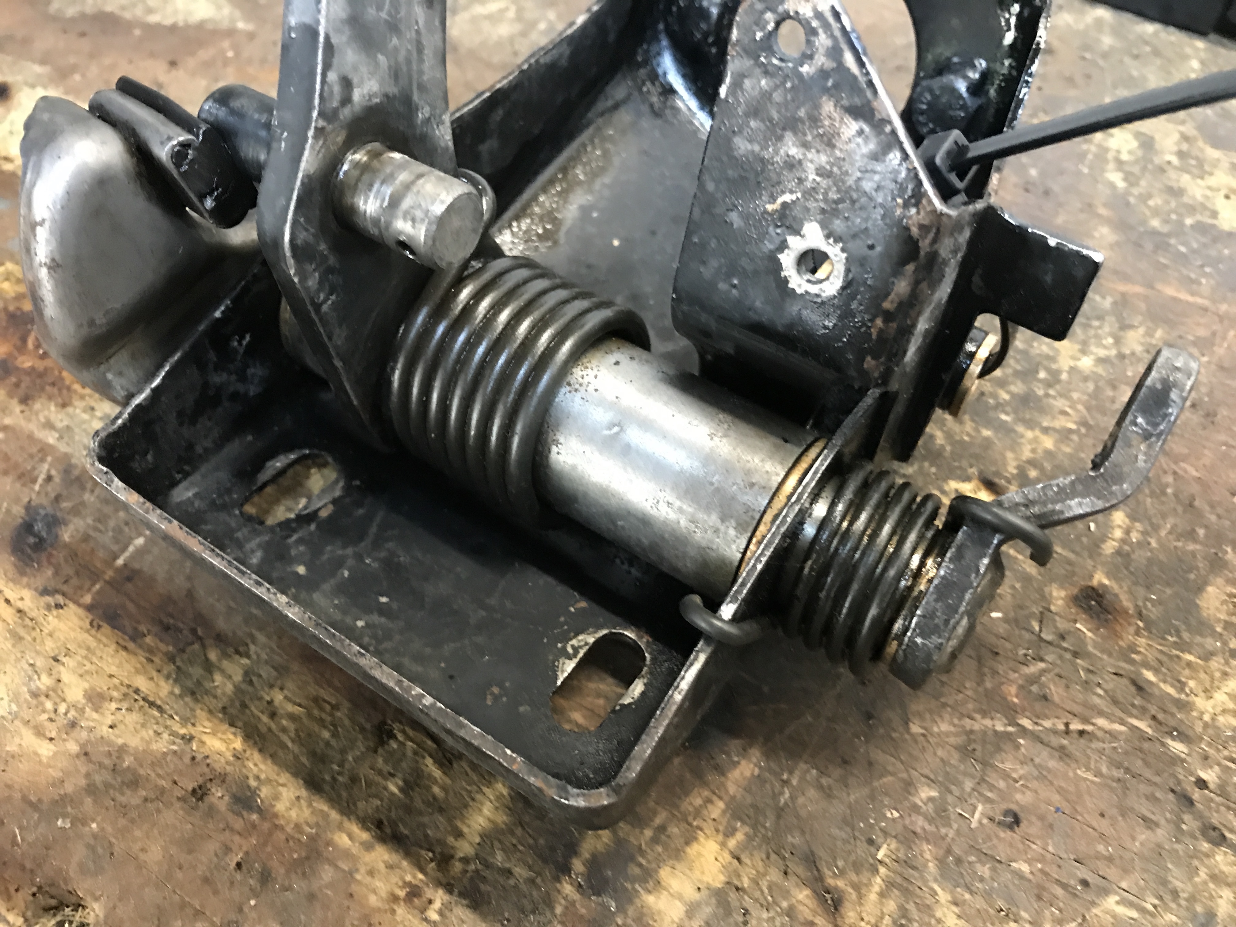

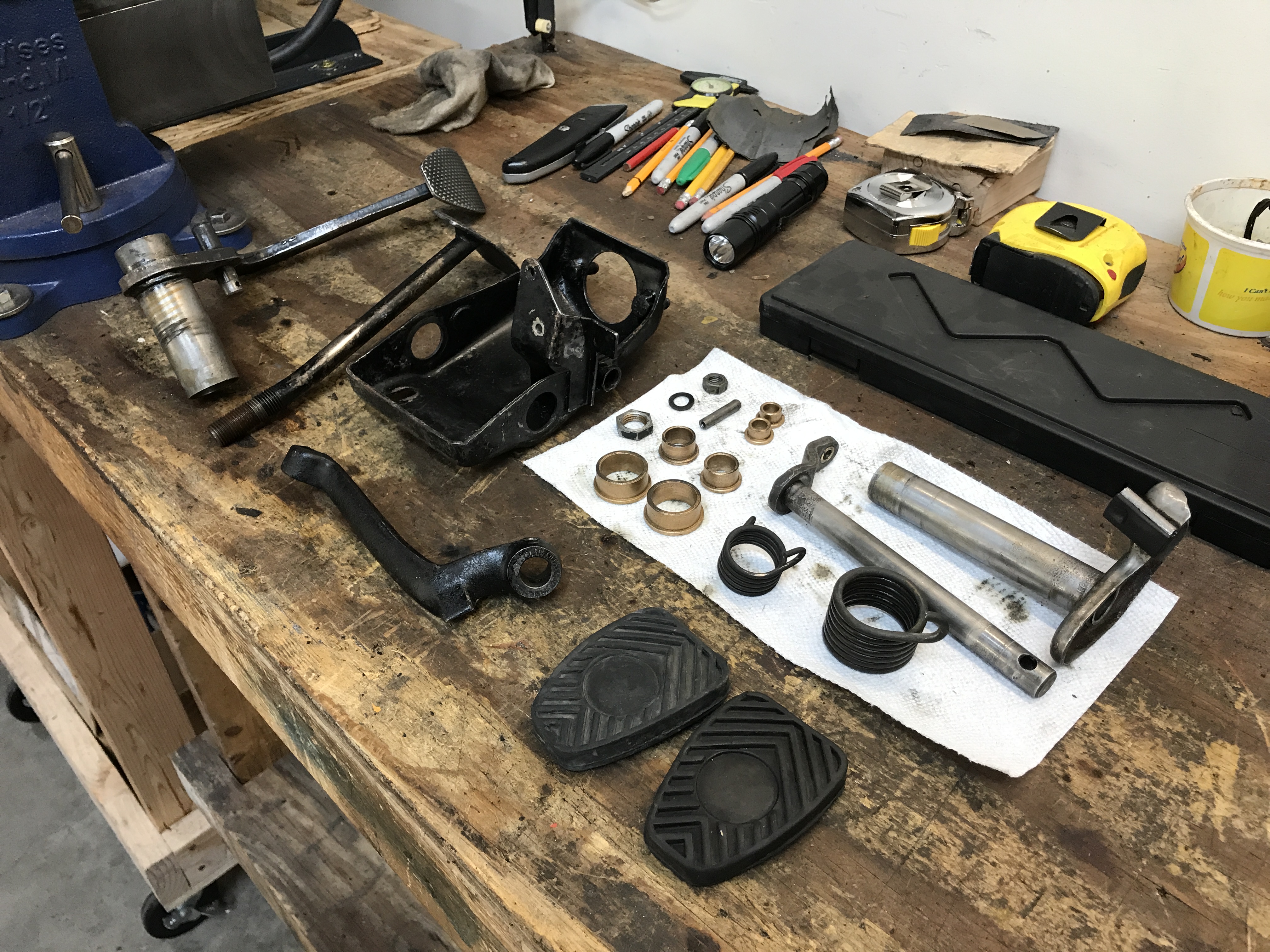

Waiting for more stuff before playing with bushings, so I cleaned up the pedal cluster. Happily, almost no corrosion.
bkrantz
post Sep 1 2020, 07:36 PM
Post #1231
Posts: 8,343
Joined: 3-August 19
From: SW Colorado
Member No.: 23,343
And some PO already installed bronze bushings.
bkrantz
post Sep 1 2020, 07:39 PM
Post #1232
Posts: 8,343
Joined: 3-August 19
From: SW Colorado
Member No.: 23,343
I pondered using the pedals as they are, but..nah, more stuff for powder coating.

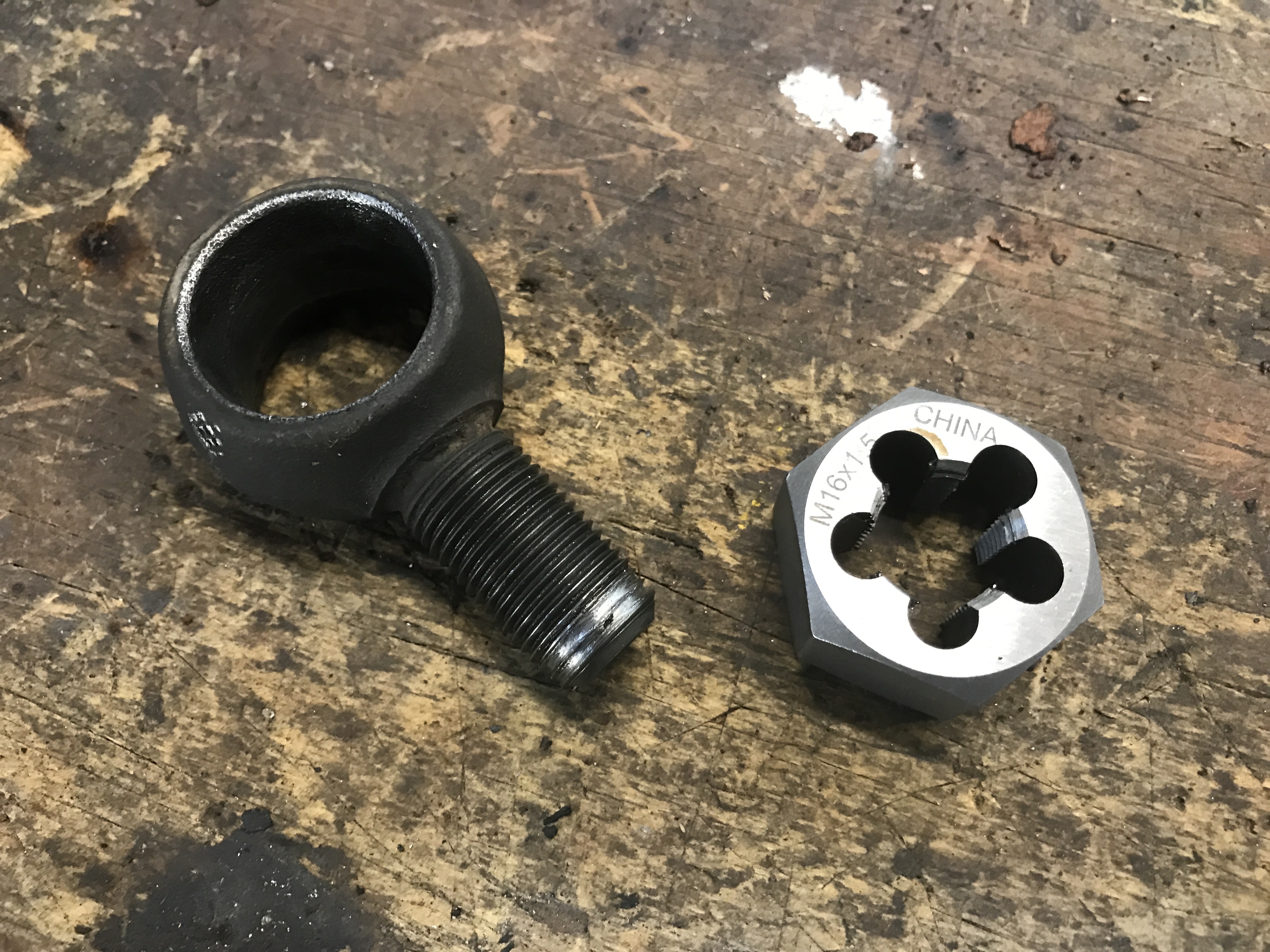

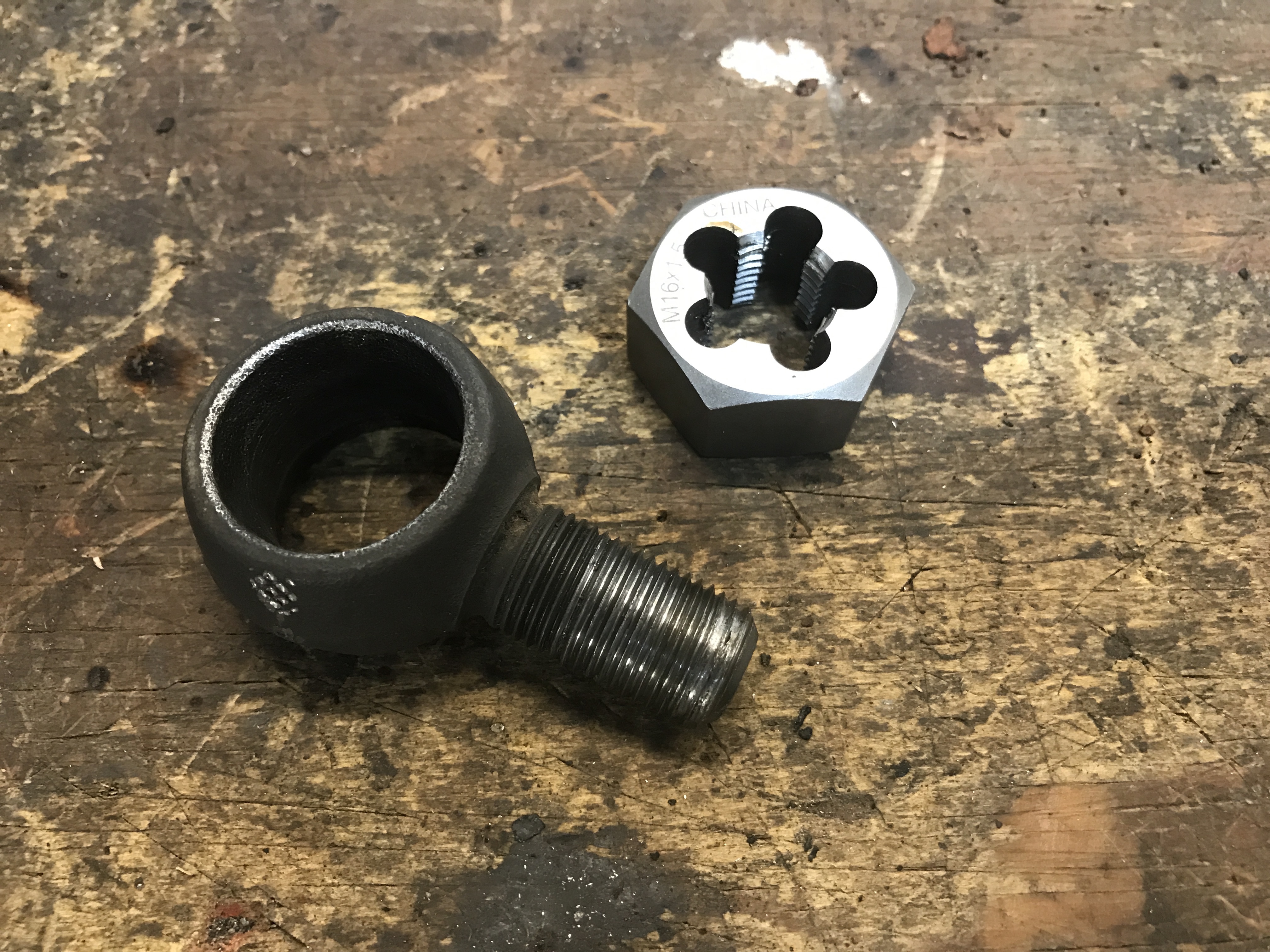

Back in town, and a bit of time to kill--and new toys to try out. To repair threads on one eye bolt, I ordered a 16 x 1.5 metric die. Fortunately, only the first two rounds of threads are messed up at all.
bkrantz
post Sep 4 2020, 08:09 PM
Post #1234
Posts: 8,343
Joined: 3-August 19
From: SW Colorado
Member No.: 23,343
Very quick and easy to cut out any distortion that was binding.
bkrantz
post Sep 4 2020, 08:10 PM
Post #1235
Posts: 8,343
Joined: 3-August 19
From: SW Colorado
Member No.: 23,343
Fixed (enough).

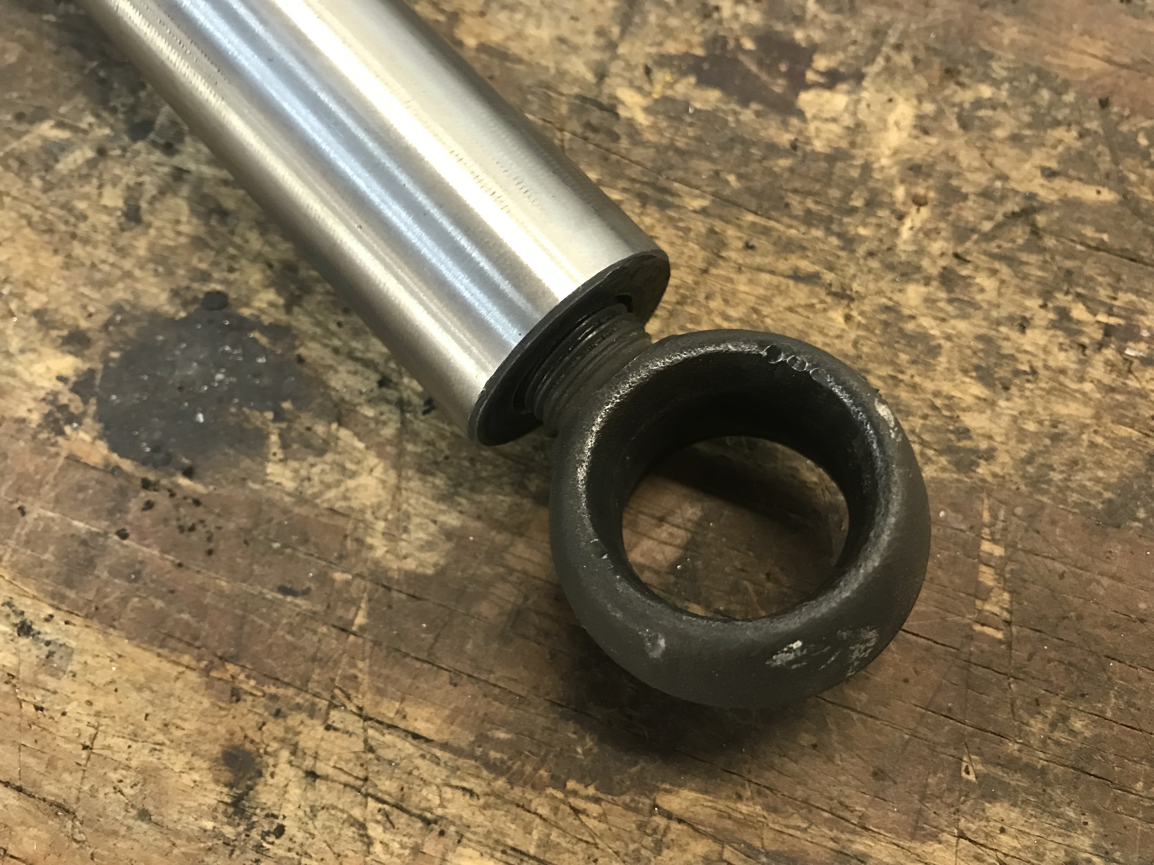

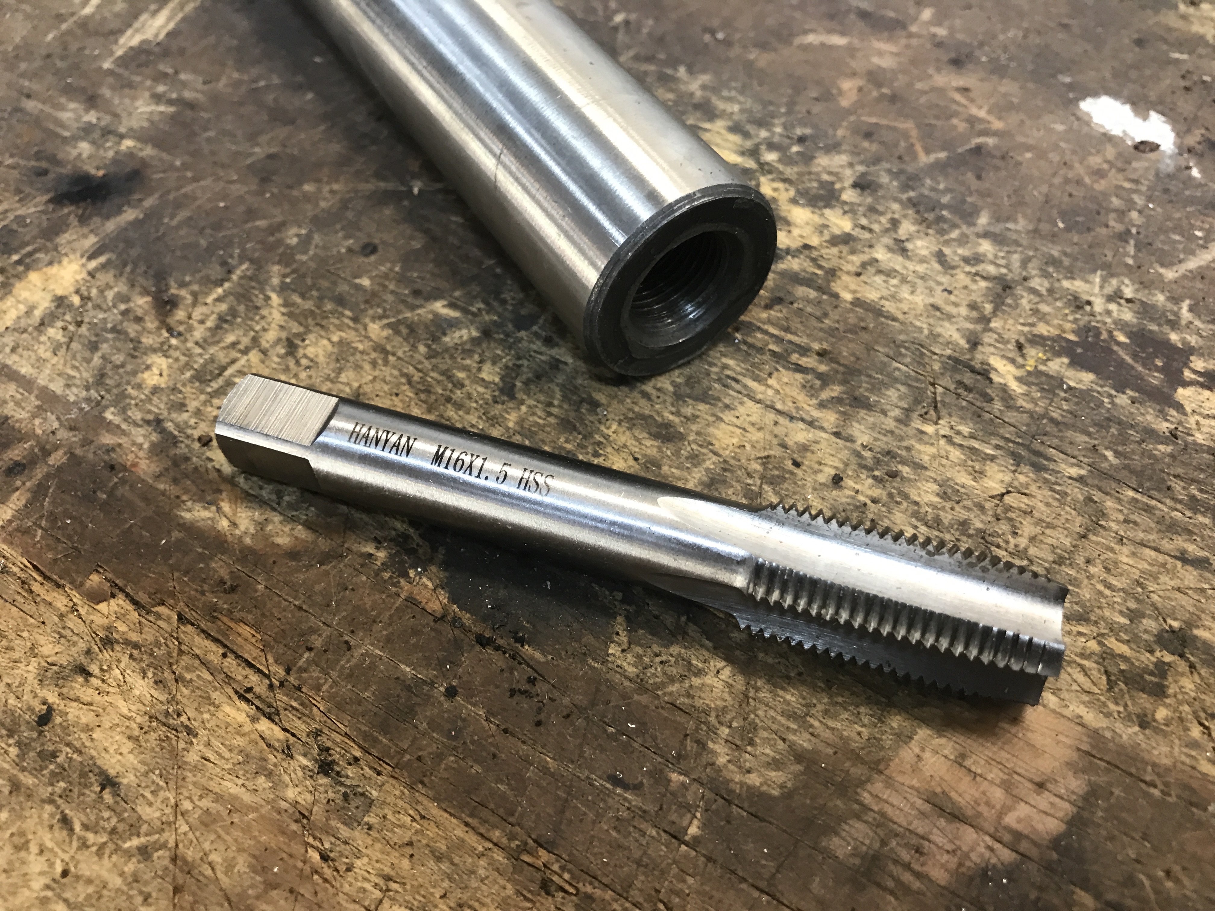

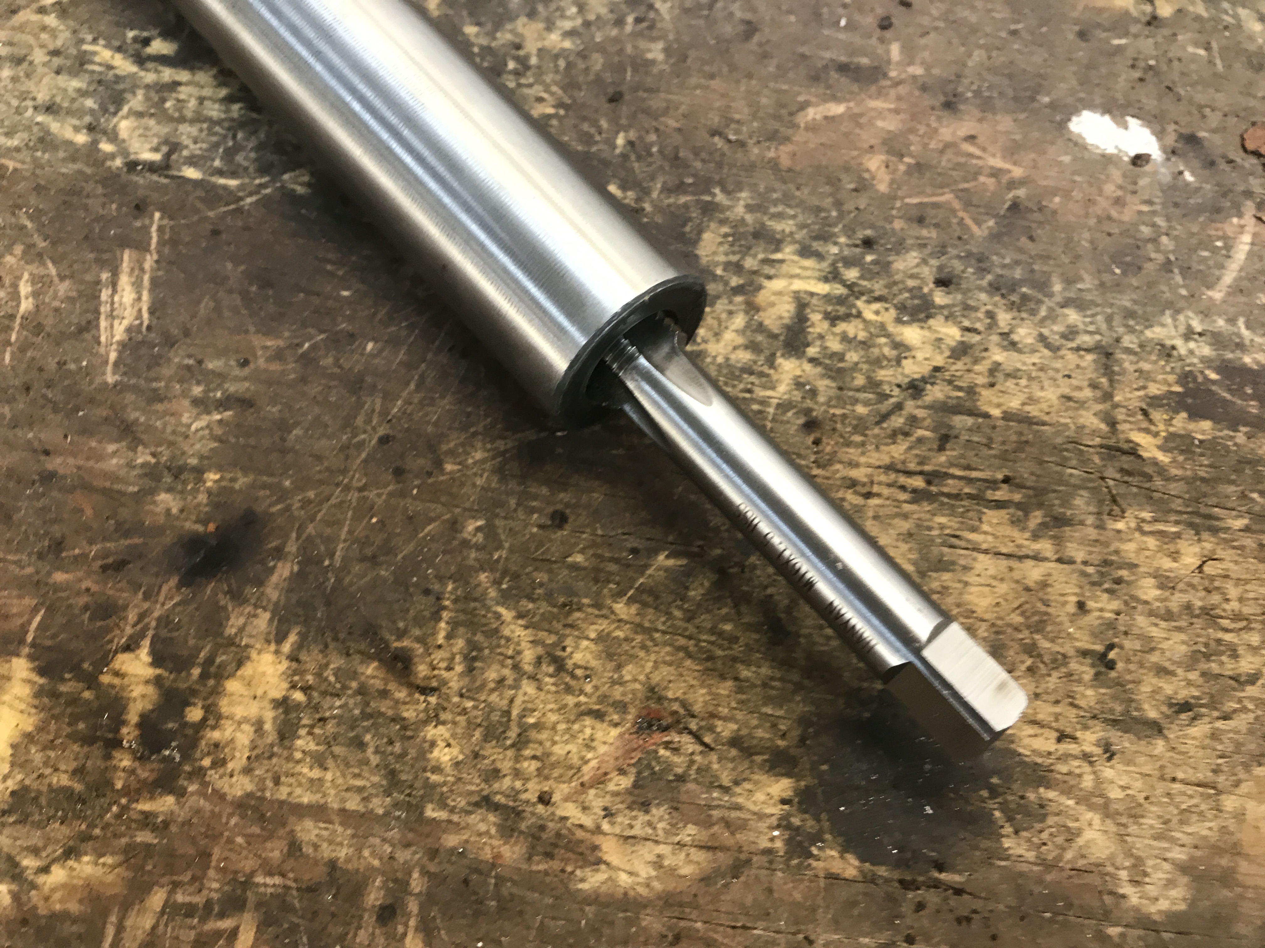

Then I used my new 16 x 1.5 tap, to dress the threaded hole in the rack.
bkrantz
post Sep 4 2020, 08:12 PM
Post #1237
Posts: 8,343
Joined: 3-August 19
From: SW Colorado
Member No.: 23,343
Again, very easy with only very minor torque necessary to bottom out the tap.
bkrantz
Post #1238
Posts: 8,343
Joined: 3-August 19
From: SW Colorado
Member No.: 23,343
Mission accomplished. The eye bolt now threads smoothly into the rack.

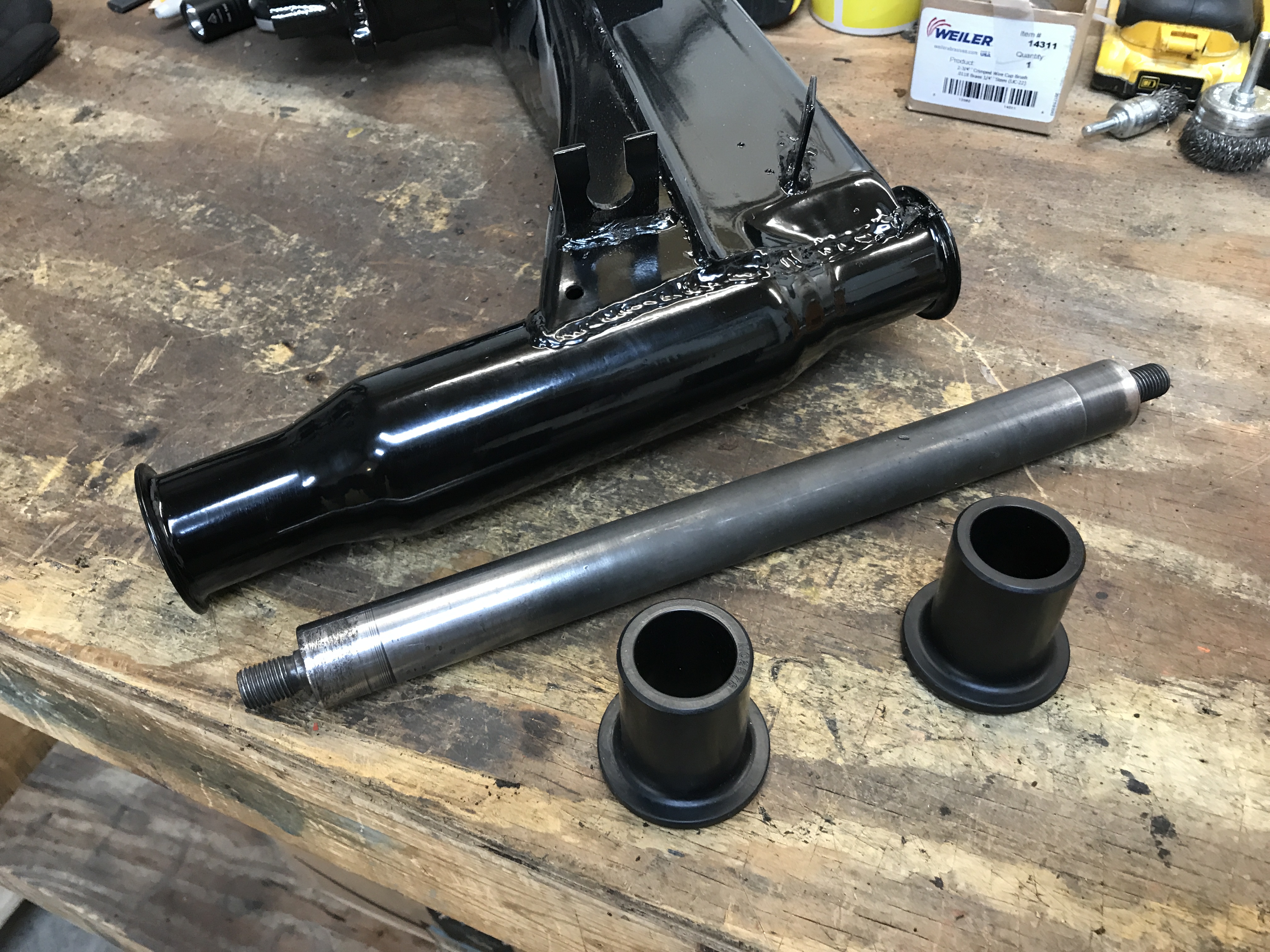

I started working on the trailing arms today, with the pivot bushings.

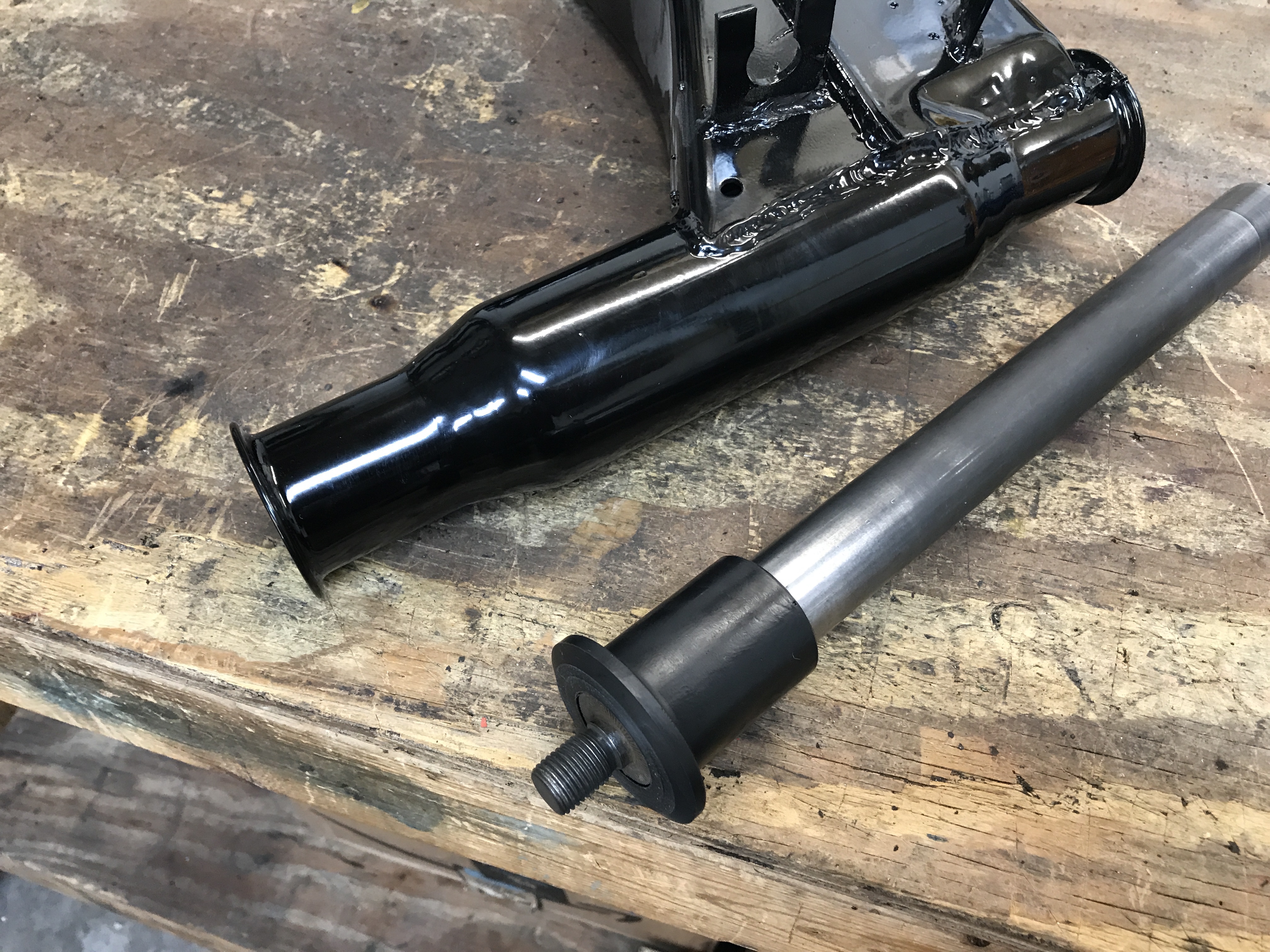

I pushed a bushing onto one end of the pivot.
