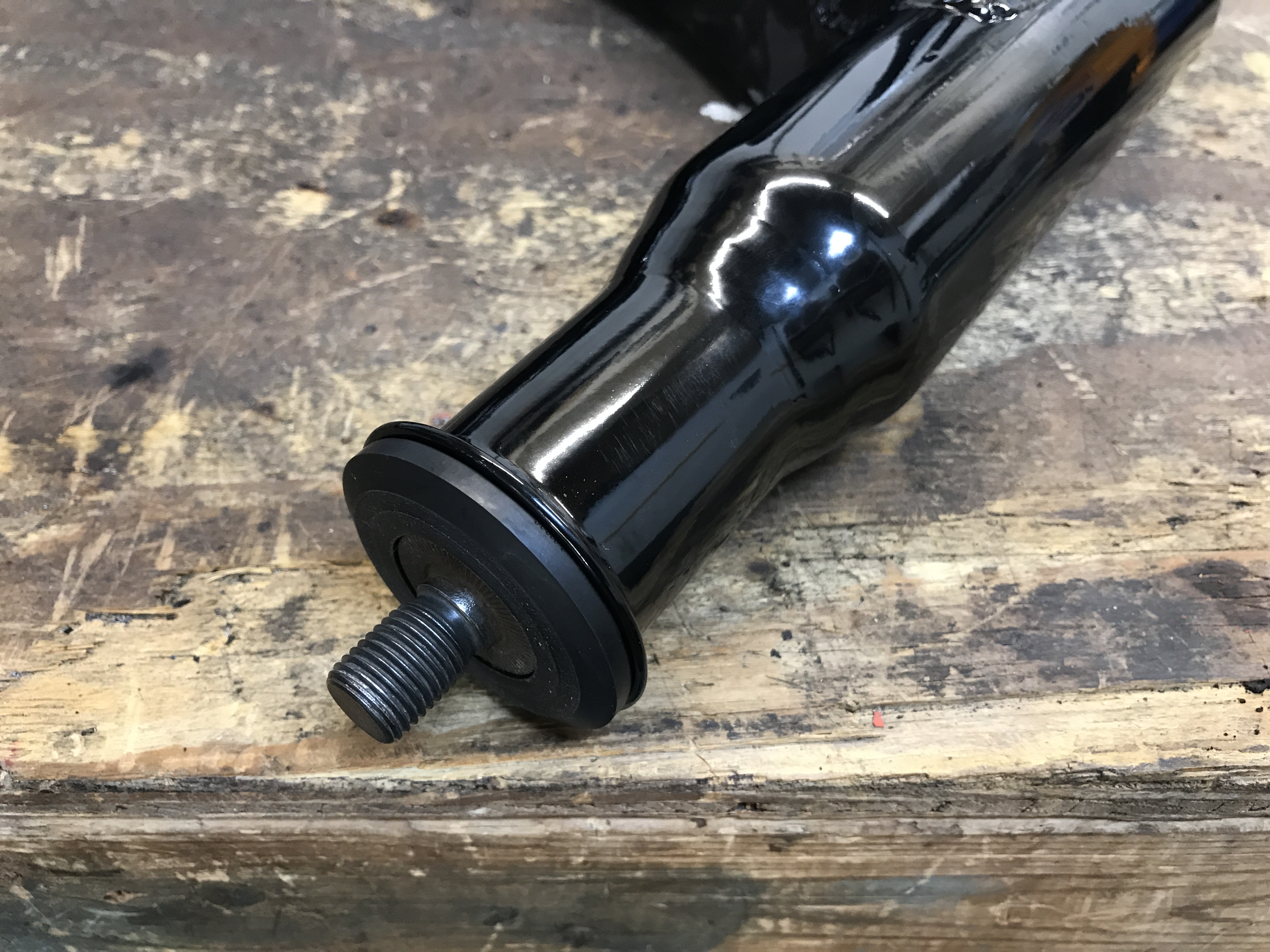

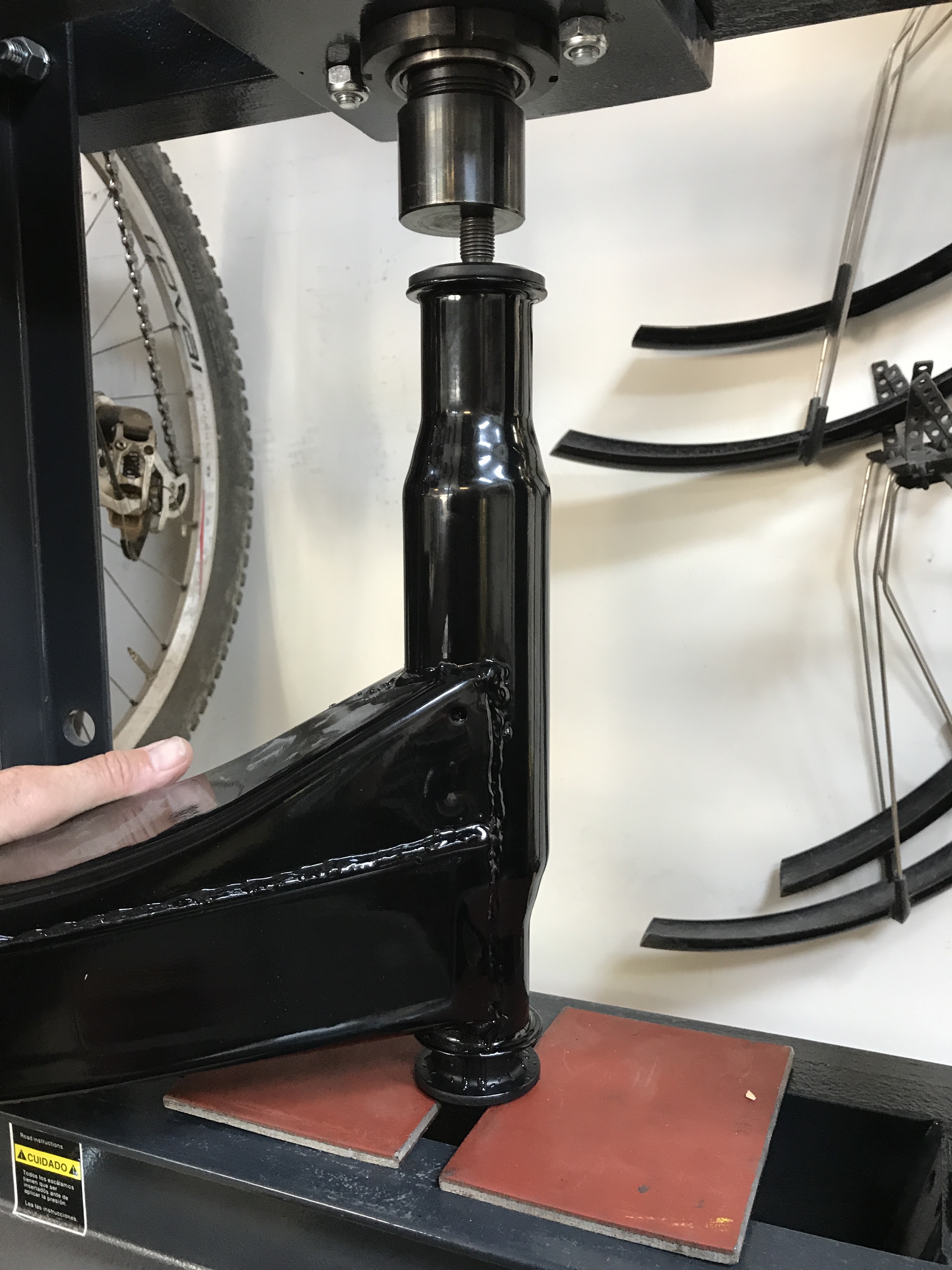

And then pushed both into the trailing arm.

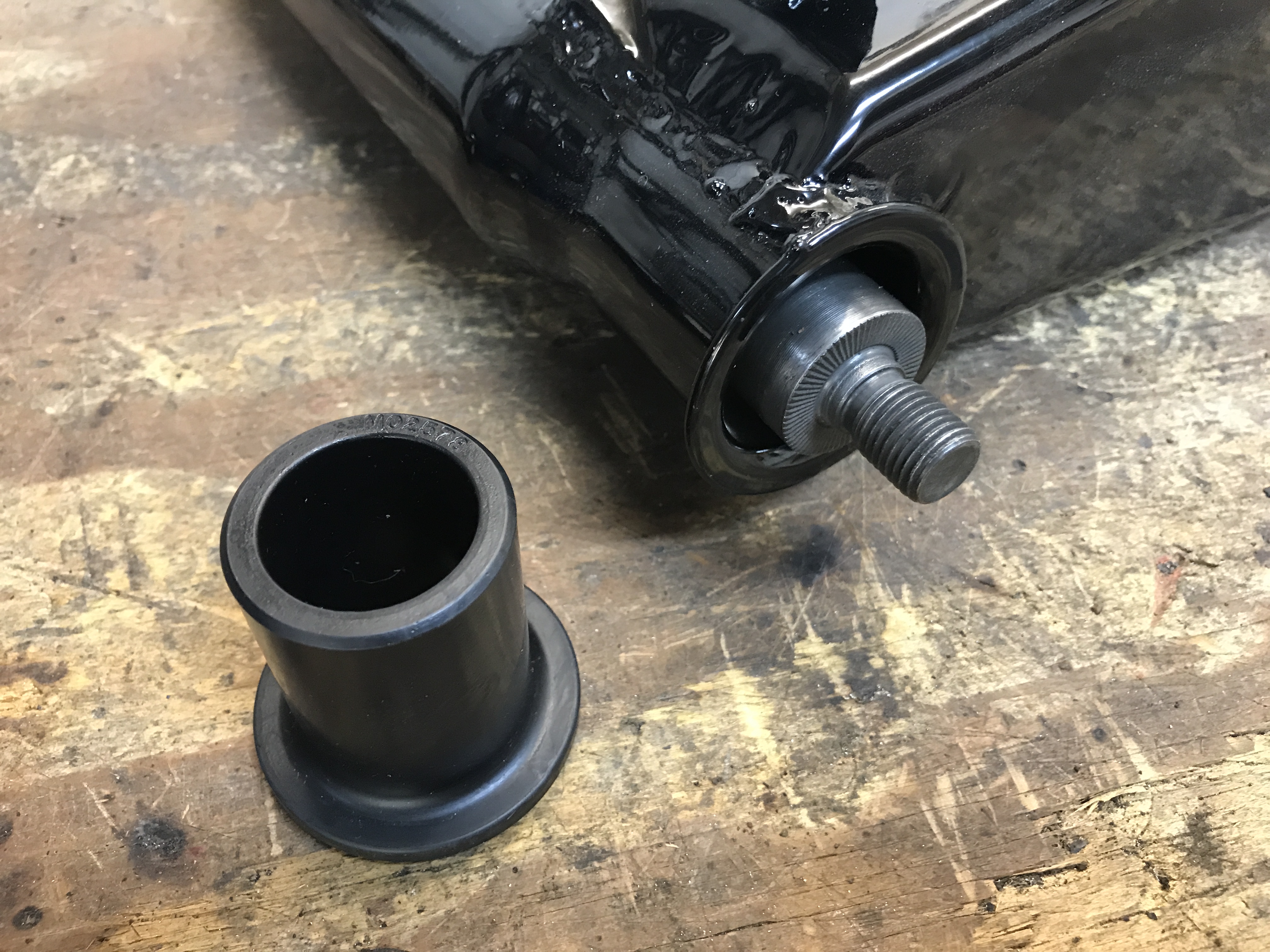

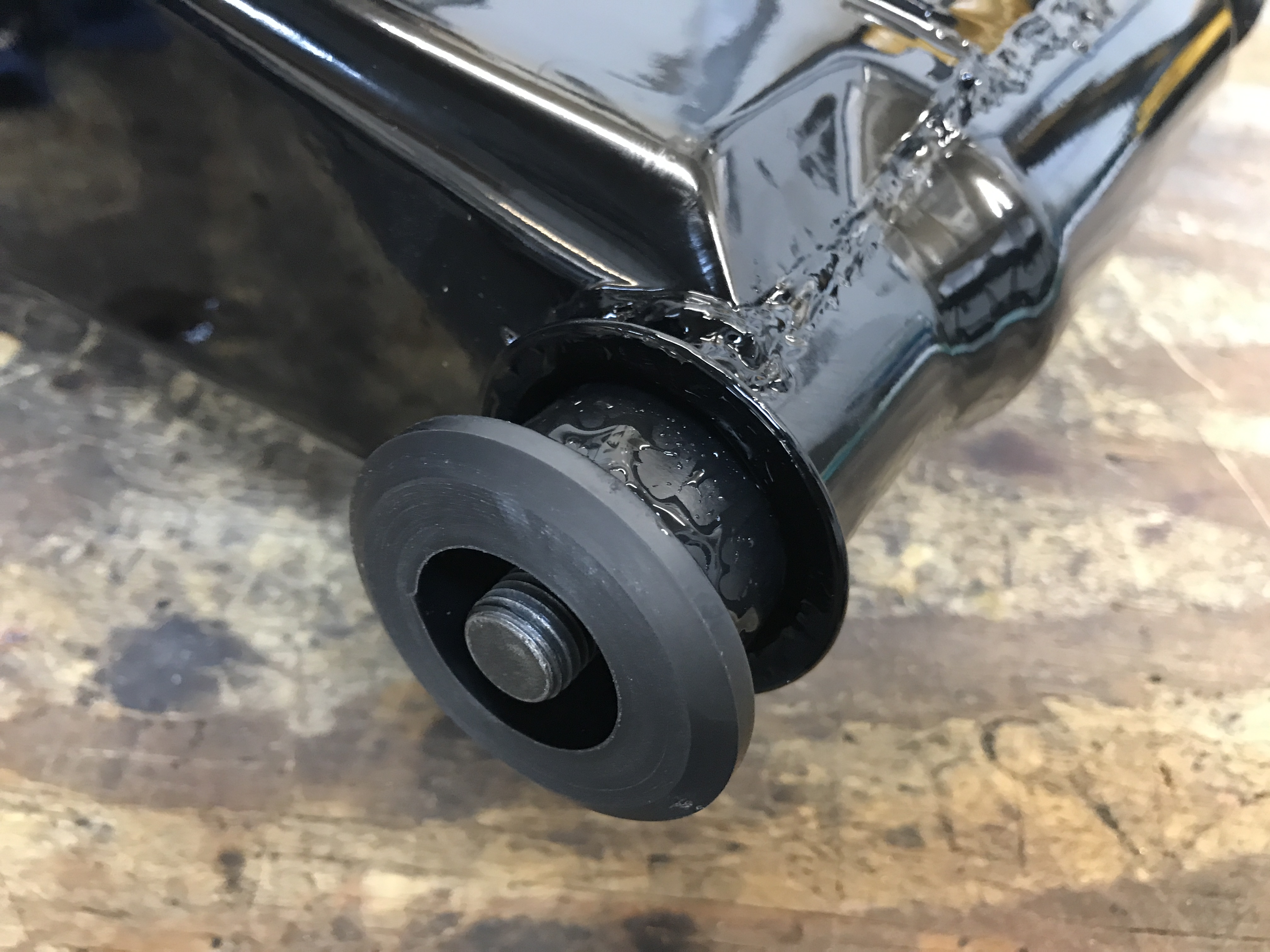

That left the other end needing a bushing.
bkrantz
post Sep 5 2020, 07:41 PM
Post #1243
Posts: 8,343
Joined: 3-August 19
From: SW Colorado
Member No.: 23,343

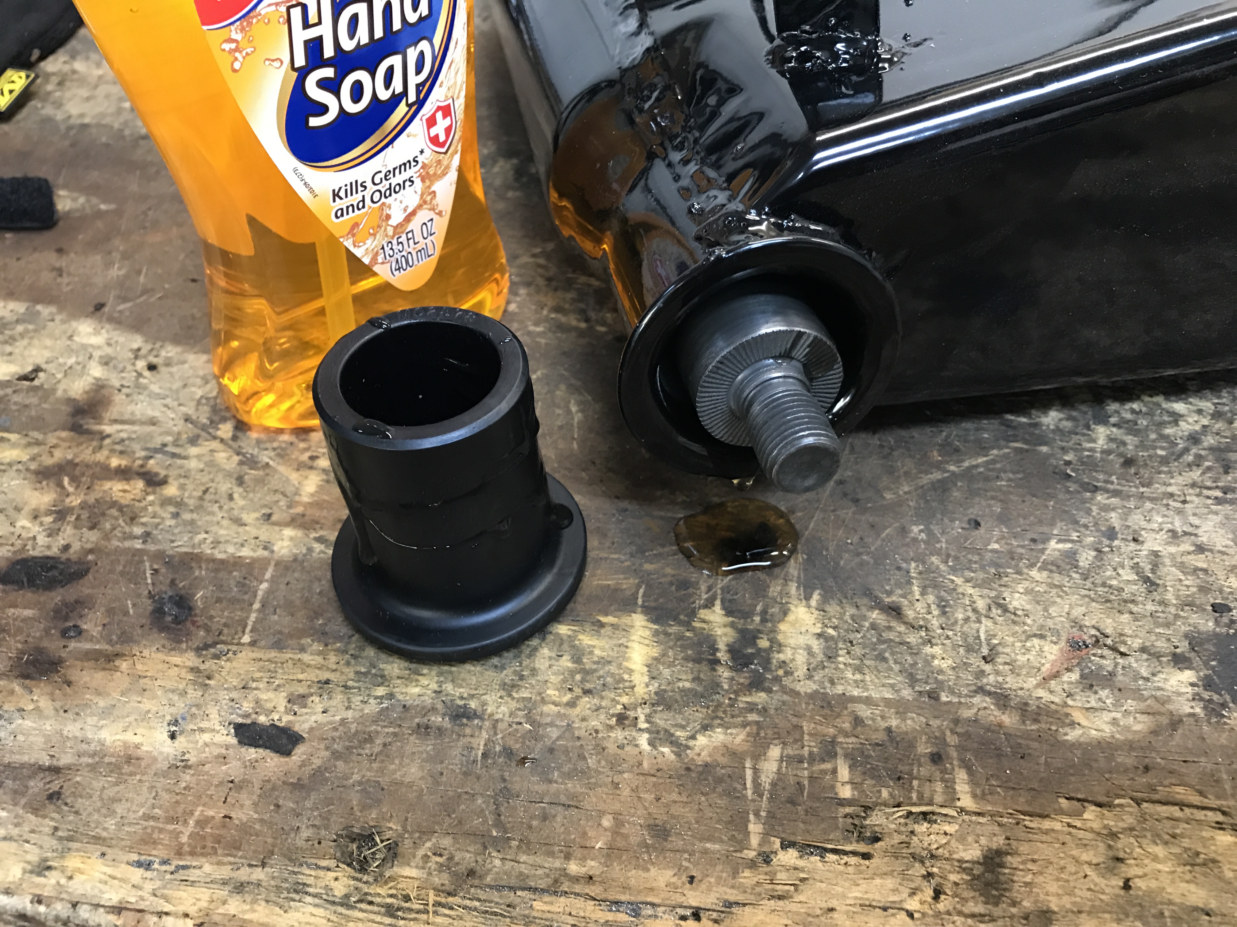

So, add some liquid soap...
bkrantz
post Sep 5 2020, 07:42 PM
Post #1244
Posts: 8,343
Joined: 3-August 19
From: SW Colorado
Member No.: 23,343
...and shove the bushing in by hand as far as possible...
bkrantz
post Sep 5 2020, 07:43 PM
Post #1245
Posts: 8,343
Joined: 3-August 19
From: SW Colorado
Member No.: 23,343
...and finish with the press.
bkrantz
post Sep 5 2020, 07:44 PM
Post #1246
Posts: 8,343
Joined: 3-August 19
From: SW Colorado
Member No.: 23,343

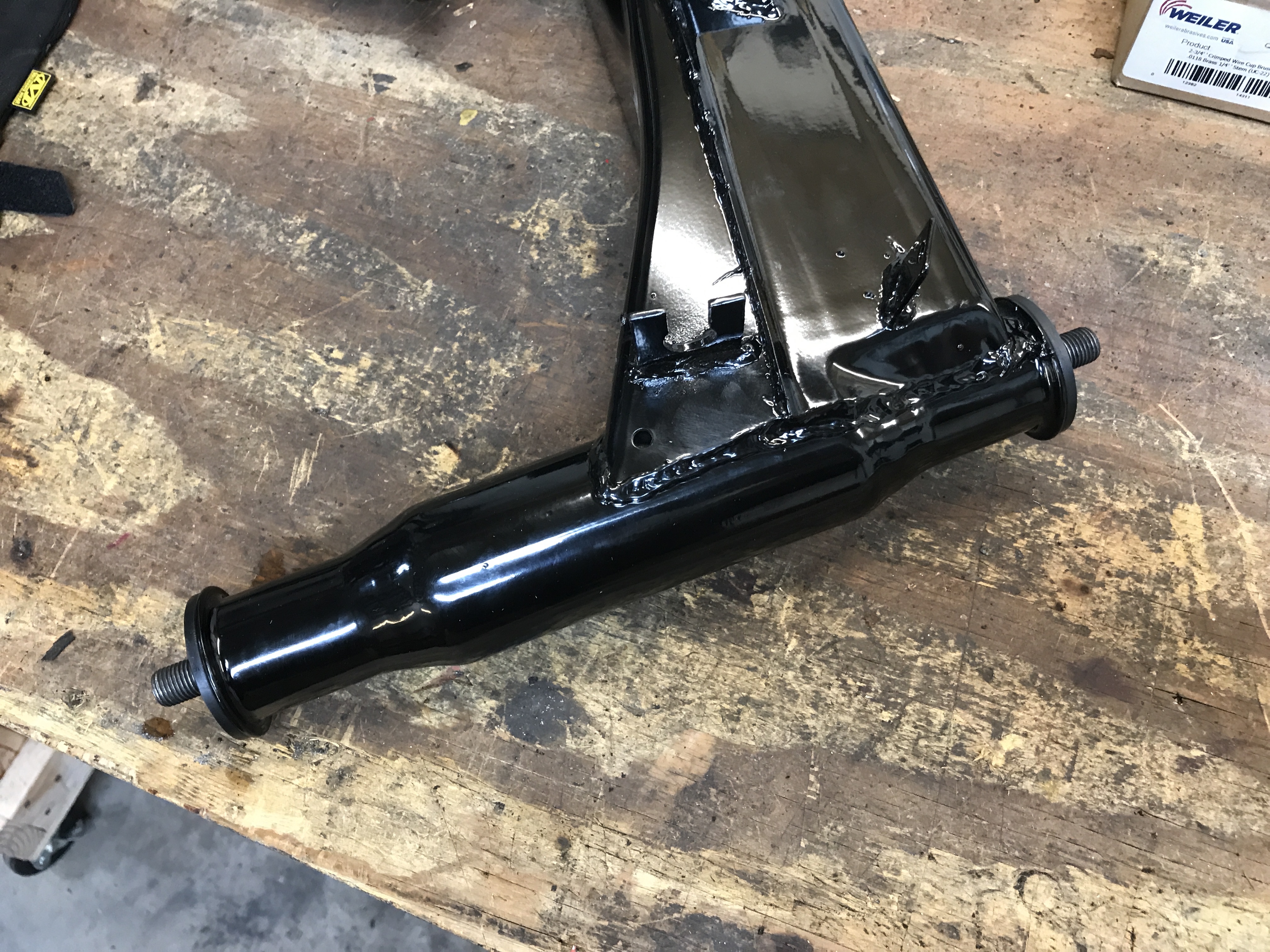

All done.

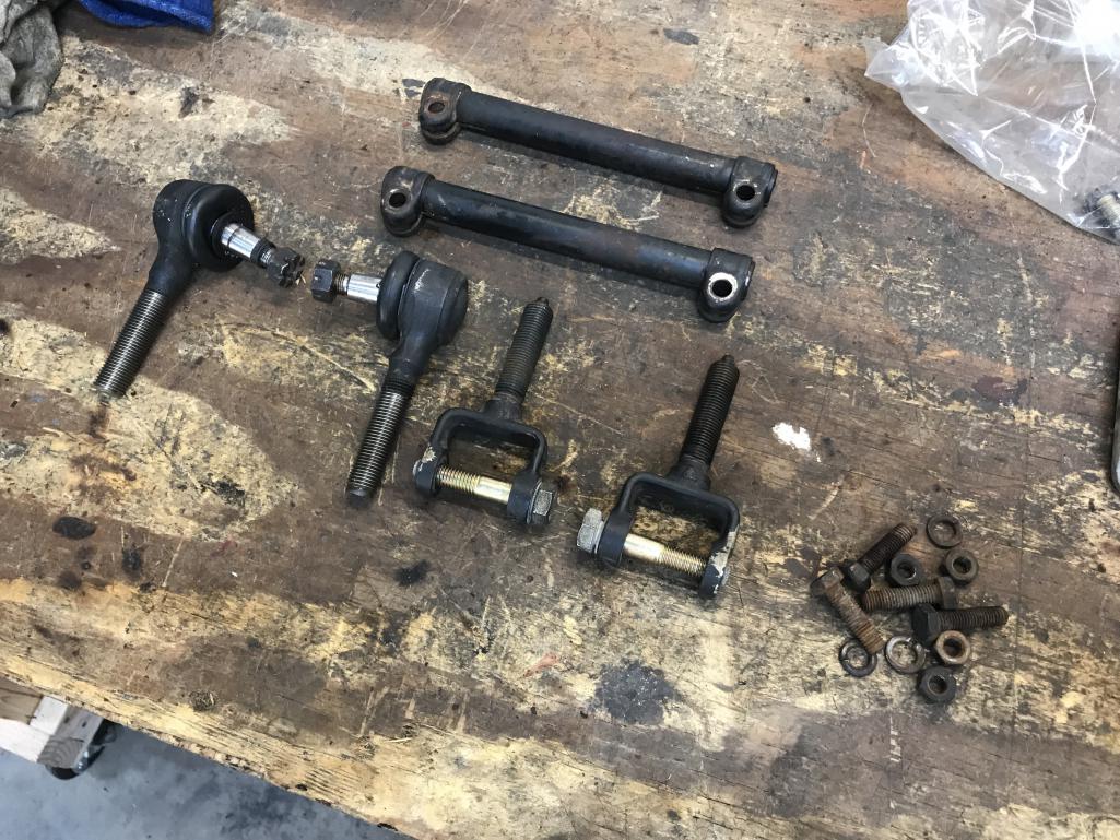

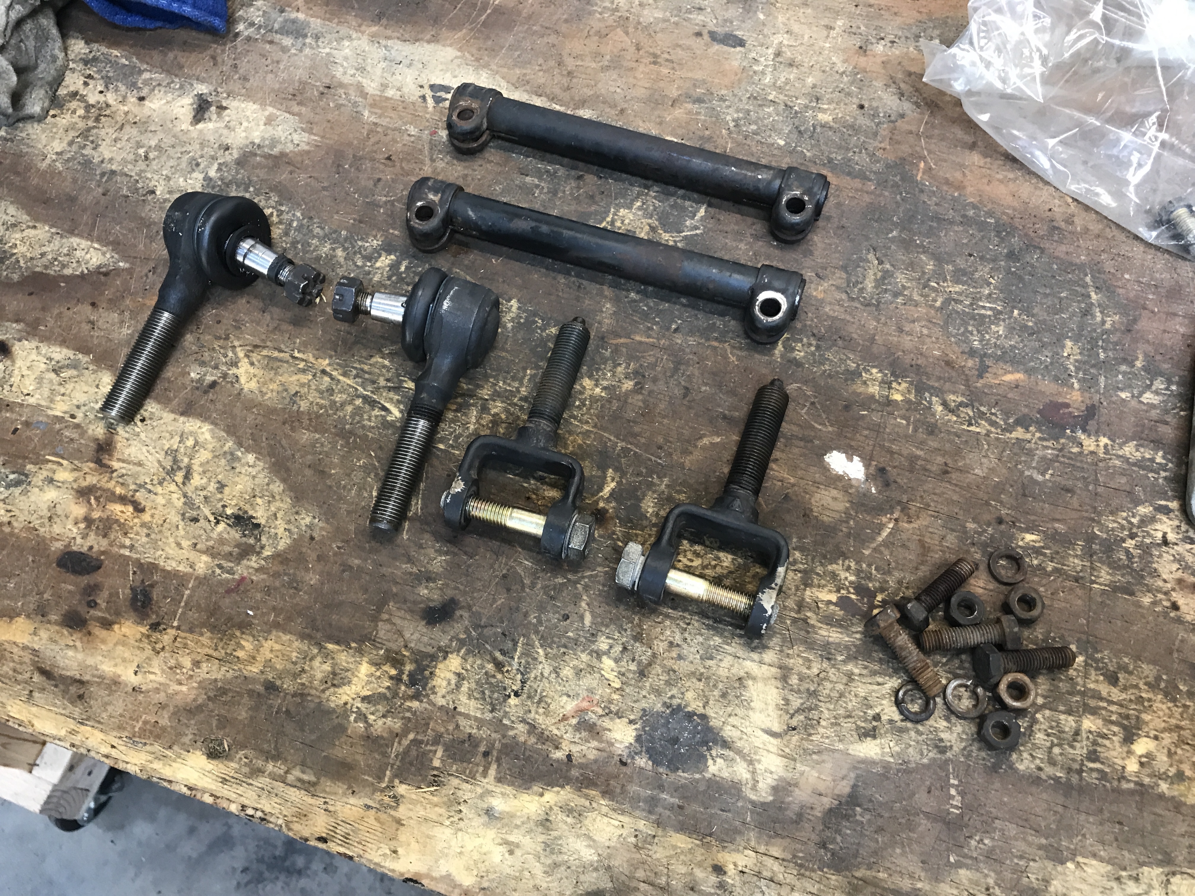

I also took apart the tie rods. More to do on these.

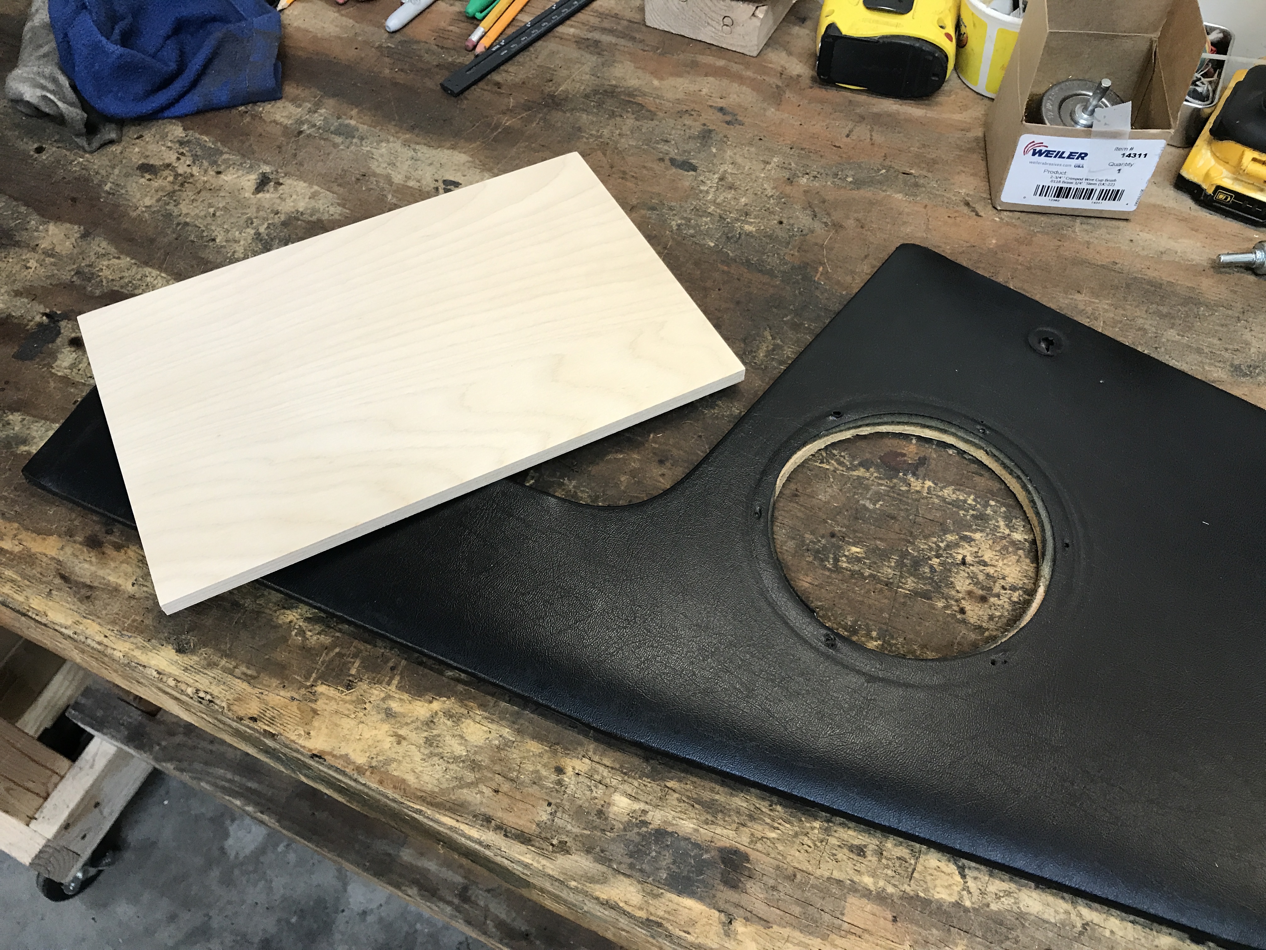

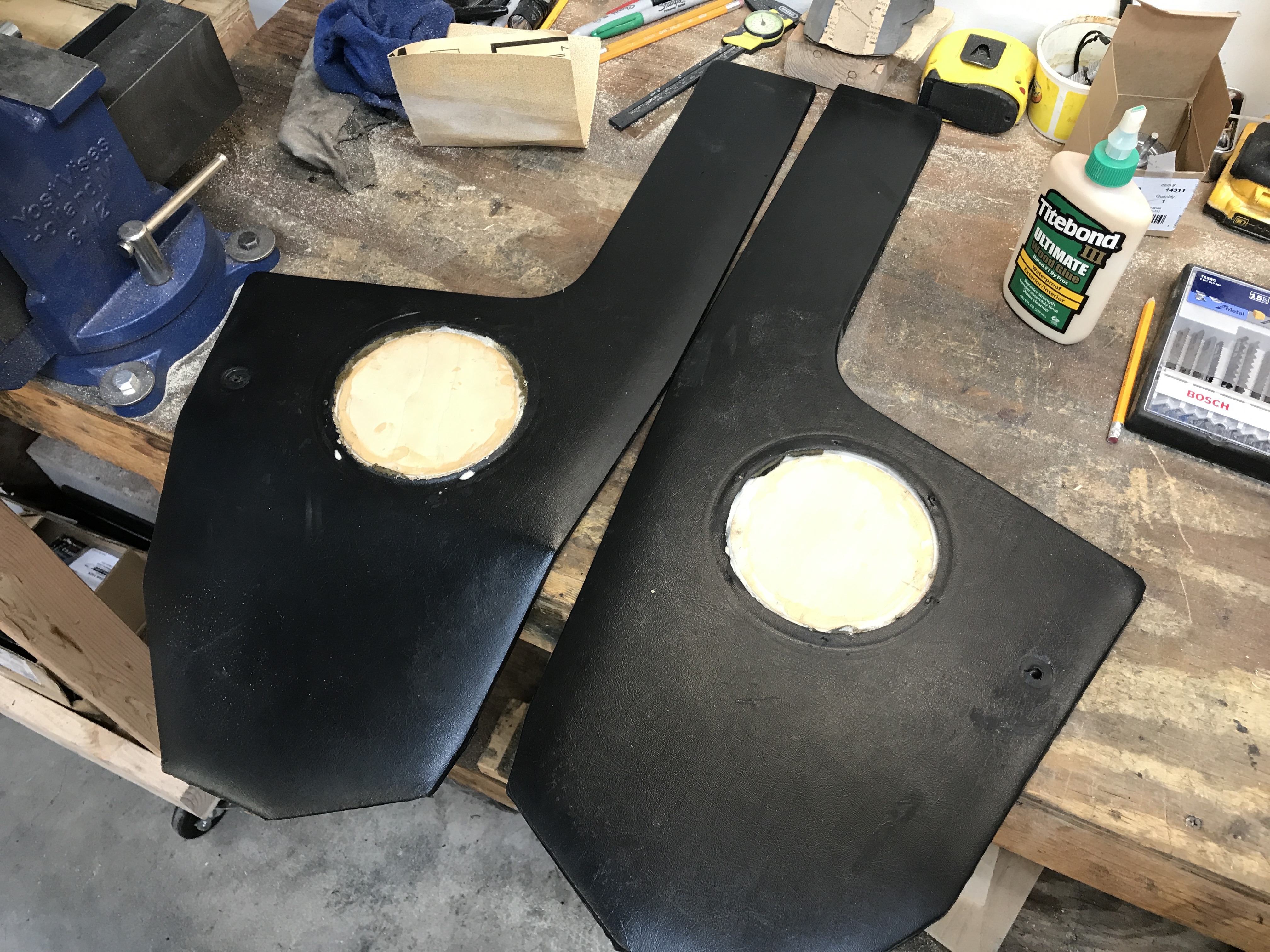

Time for some 914 wood working today.
Some audiophile PO cut holes in the center console for extra speakers. Because.
Anyway, I want to rescue the console, and started today by filling the holes. I ordered some 9mm plywood. It almost matches the console ply, just a little bit thicker.

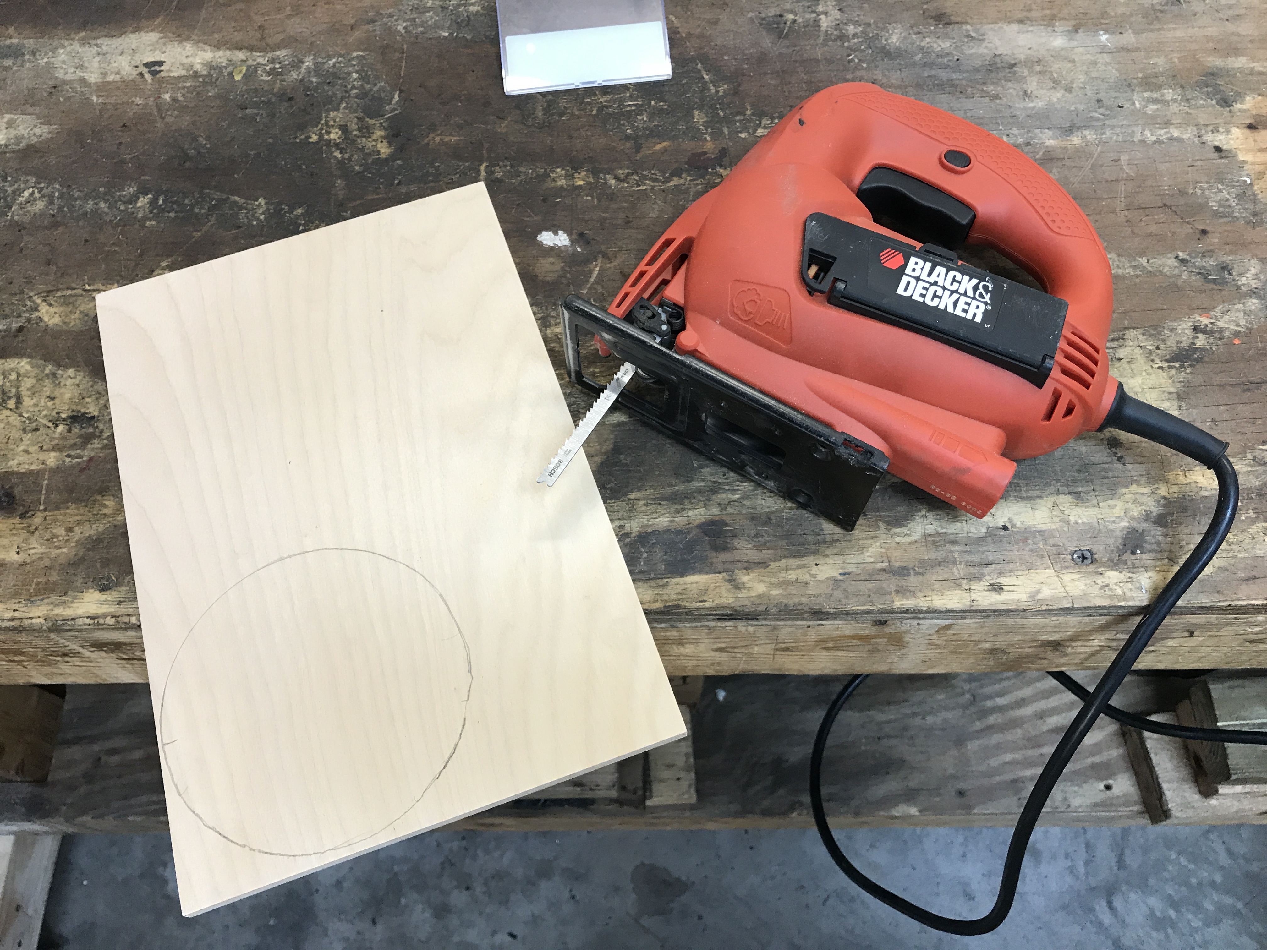

I traced the openings individually, and got out my trusty jig saw.

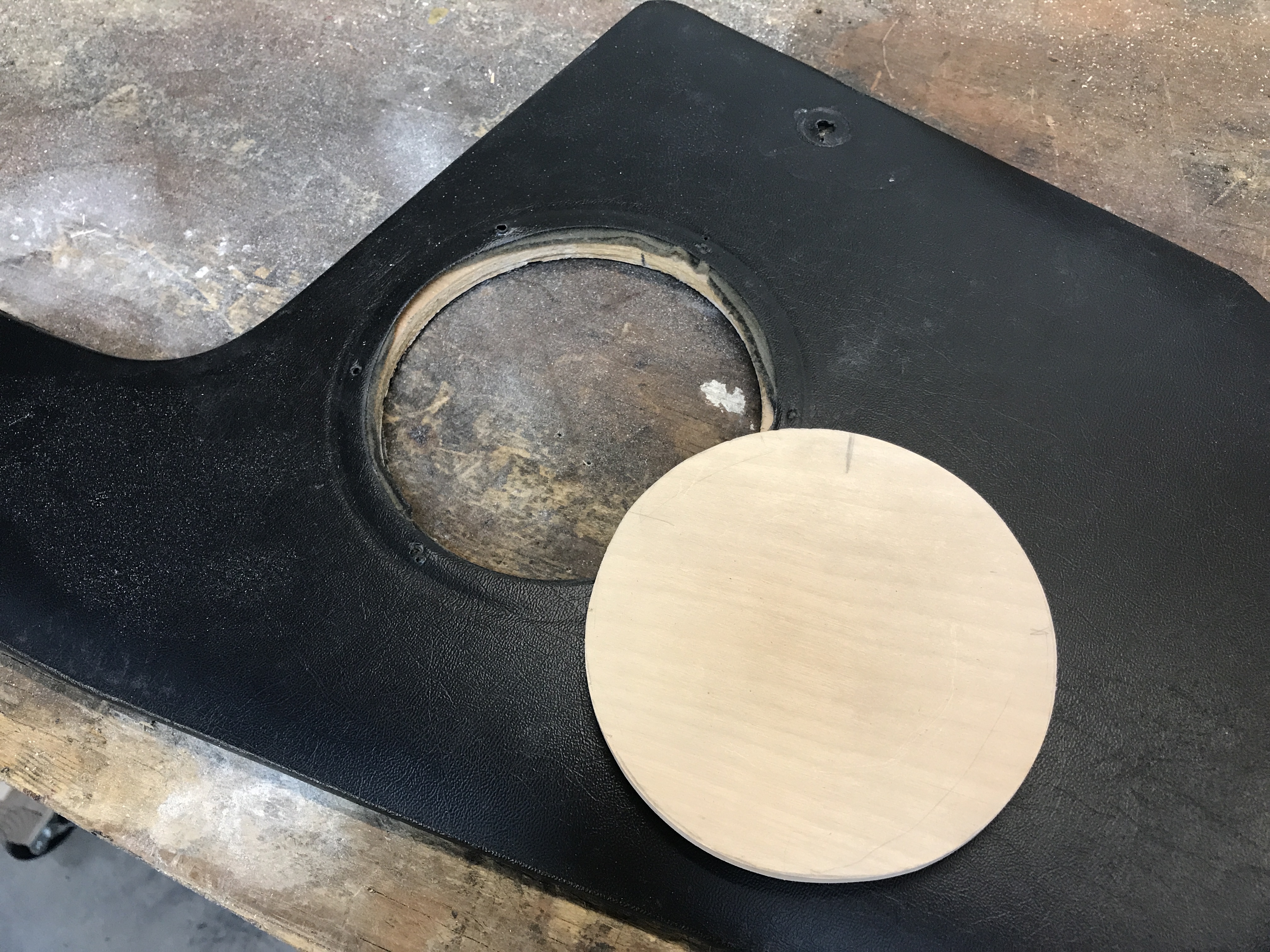

Then some sanding to get a precise fit.

Glued in place. I will test the bond tomorrow. And then search for a good custom upholstery shop.

QUOTE(bkrantz @ Sep 5 2020, 07:44 PM) *
All done.
Thanks for posting the trailing arm procedure. I have a set of rubber bushings waiting to be swapped in for the unused polygraphite bushings in there now. Good to have this reference. (IMG:style_emoticons/default/beerchug.gif)
bkrantz
post Sep 7 2020, 06:56 PM
Post #1255
Posts: 8,343
Joined: 3-August 19
From: SW Colorado
Member No.: 23,343
Brent, it really did not take much force to install the bushings. I probably could have done it with just hand tools.

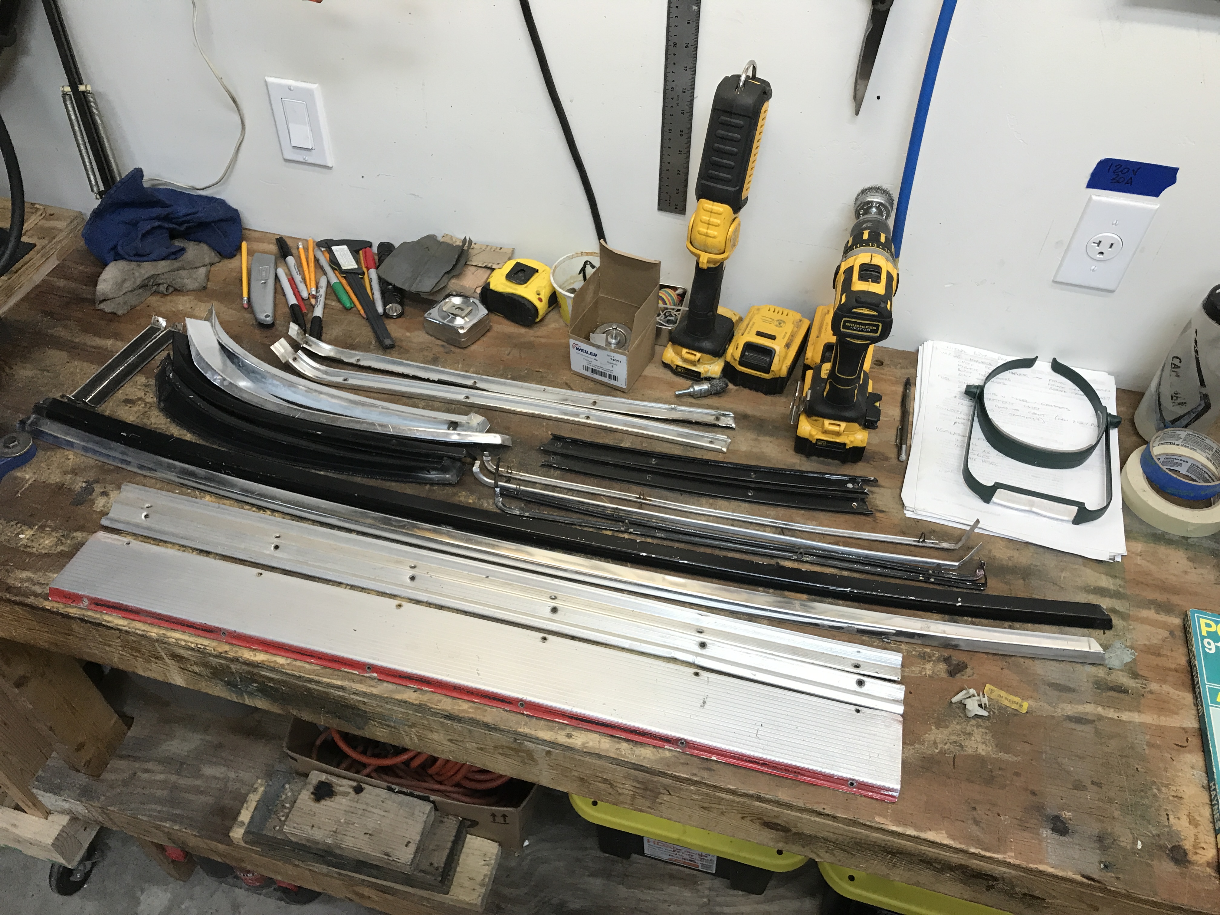

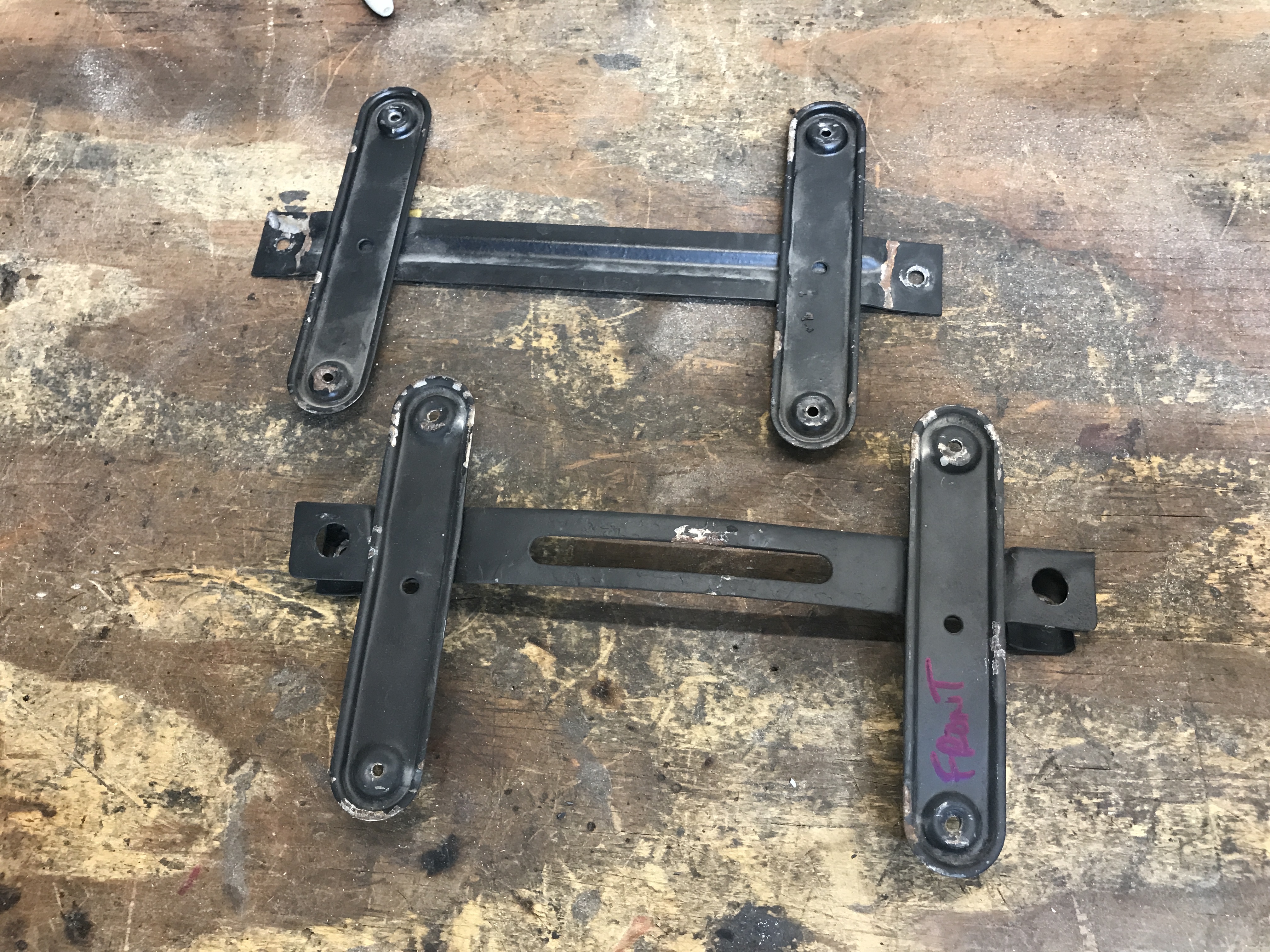

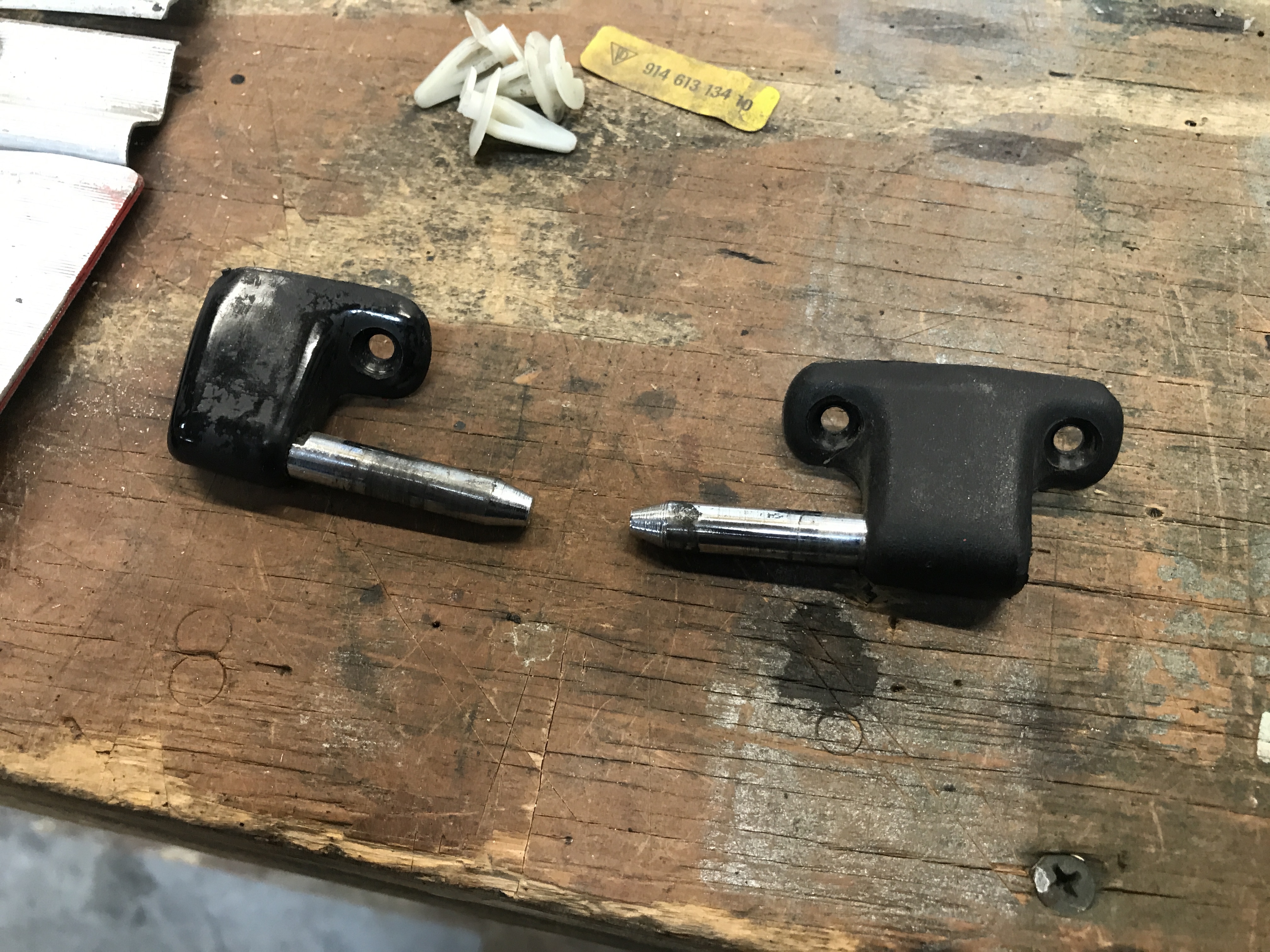

Still in a holding pattern, and so taking a chance to sort through parts.
Here's all of the trim pieces (besides the windshield). This includes stuff I took off my car, the the PO had painted black, and a few pieces I have acquired as replacements.
bkrantz
post Sep 9 2020, 07:01 PM
Post #1260
Posts: 8,343
Joined: 3-August 19
From: SW Colorado
Member No.: 23,343
And I have just half of the sun visor hardware.
