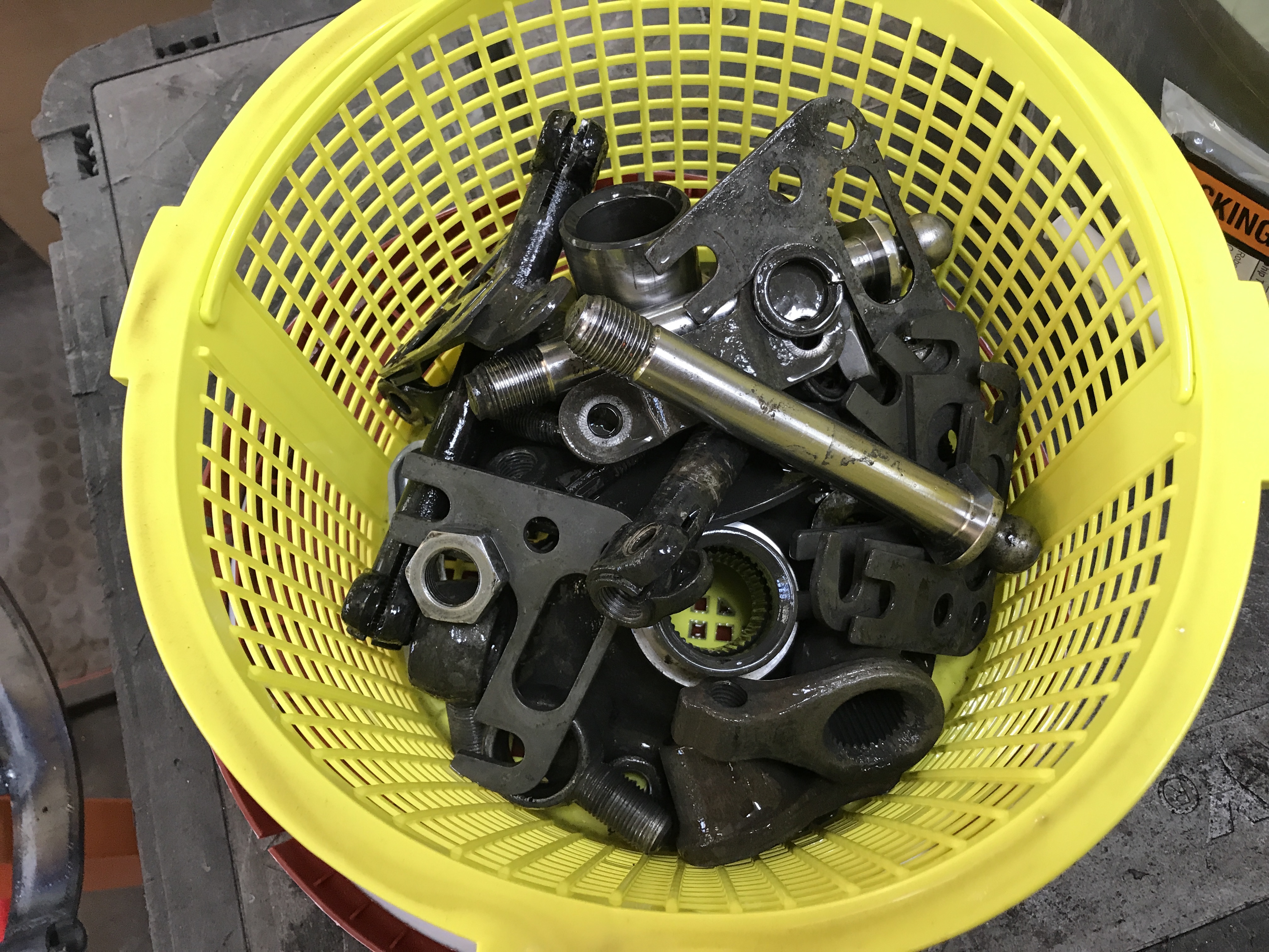

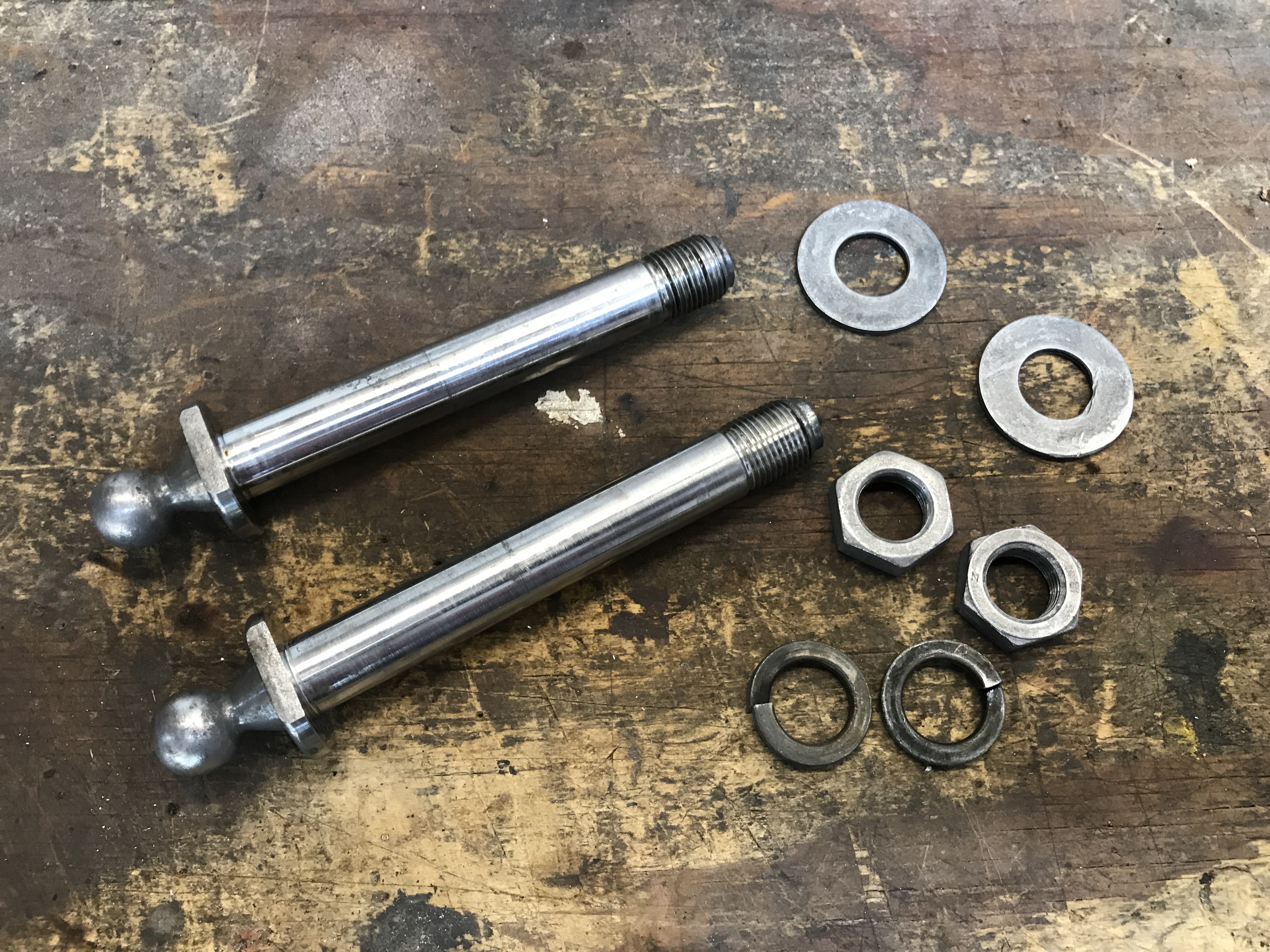

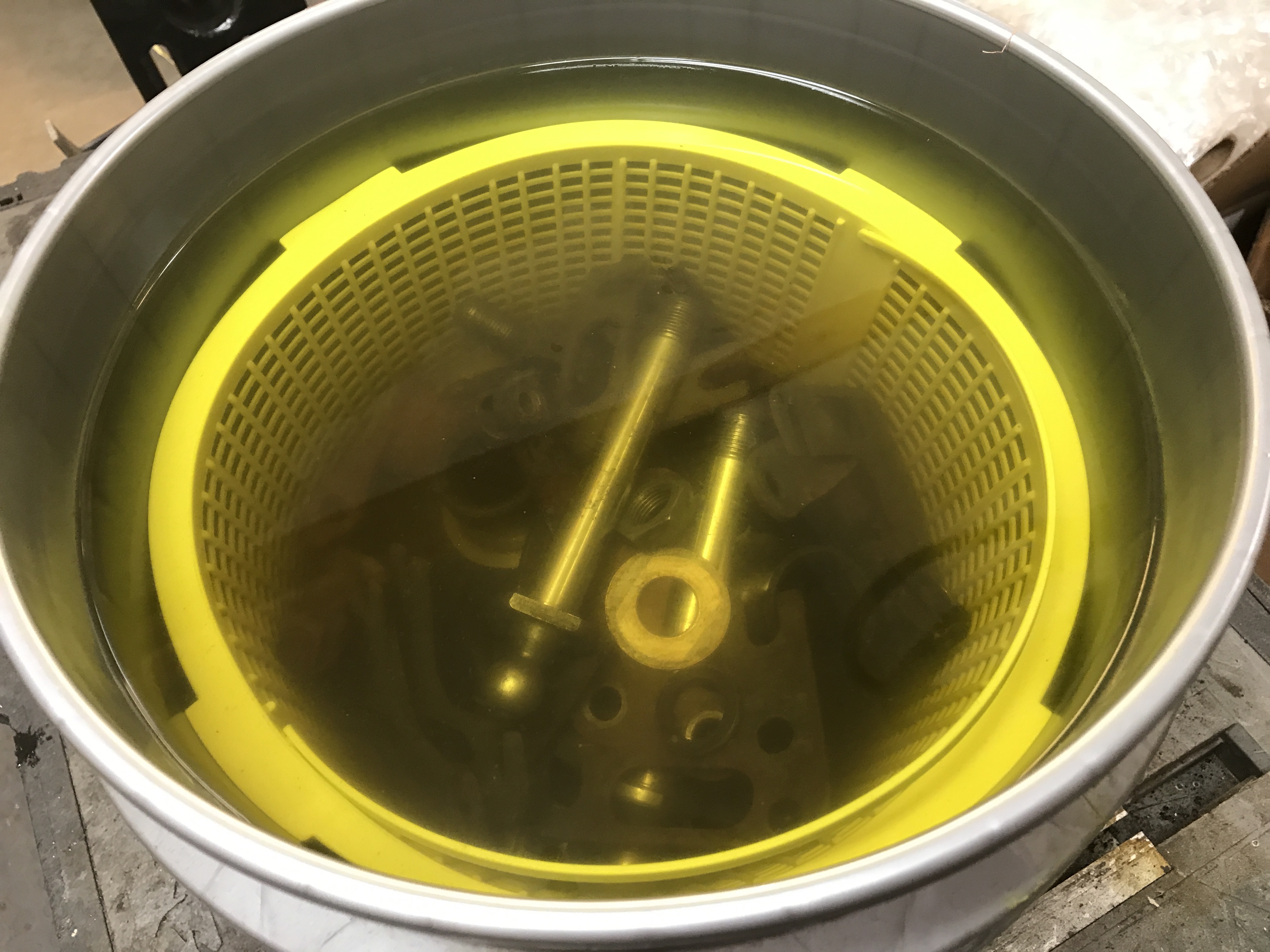

All these and more went into the Evaporators-rust bucket to soak overnight.

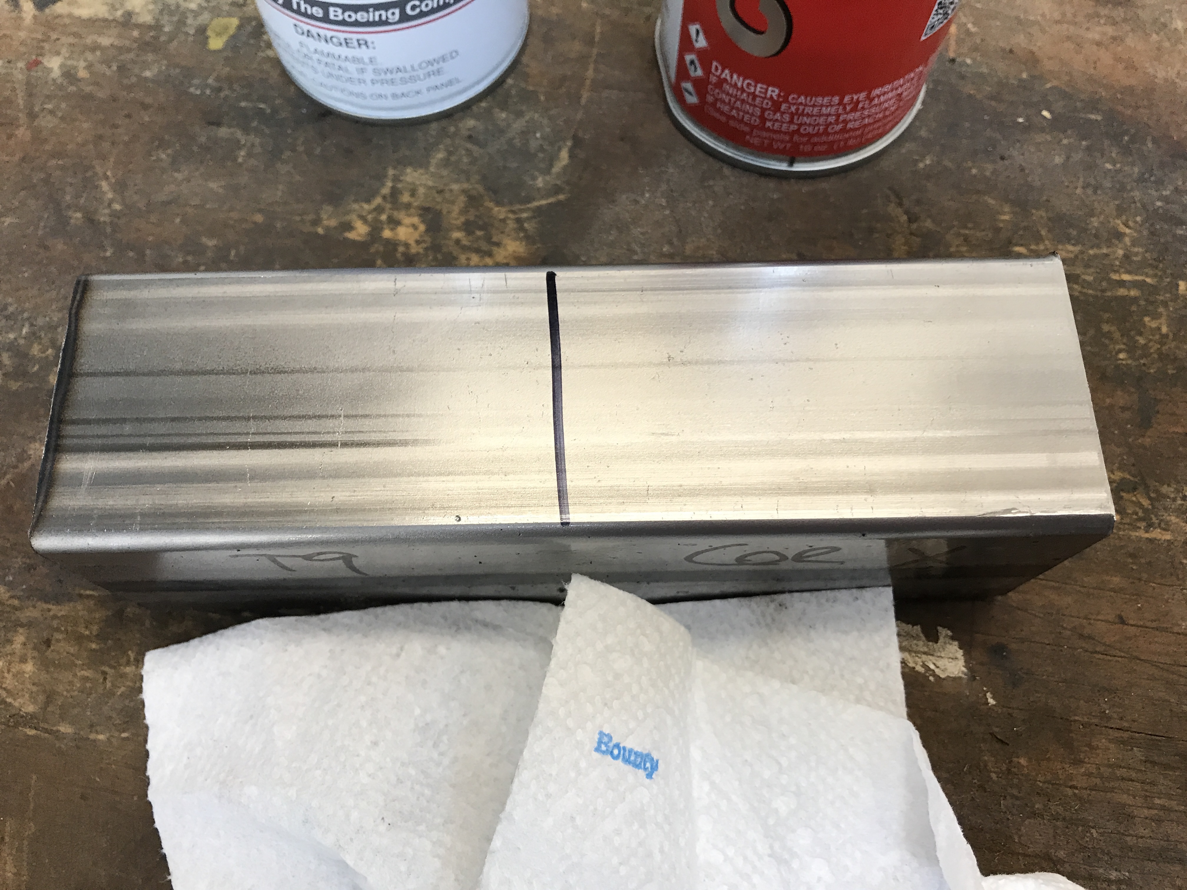

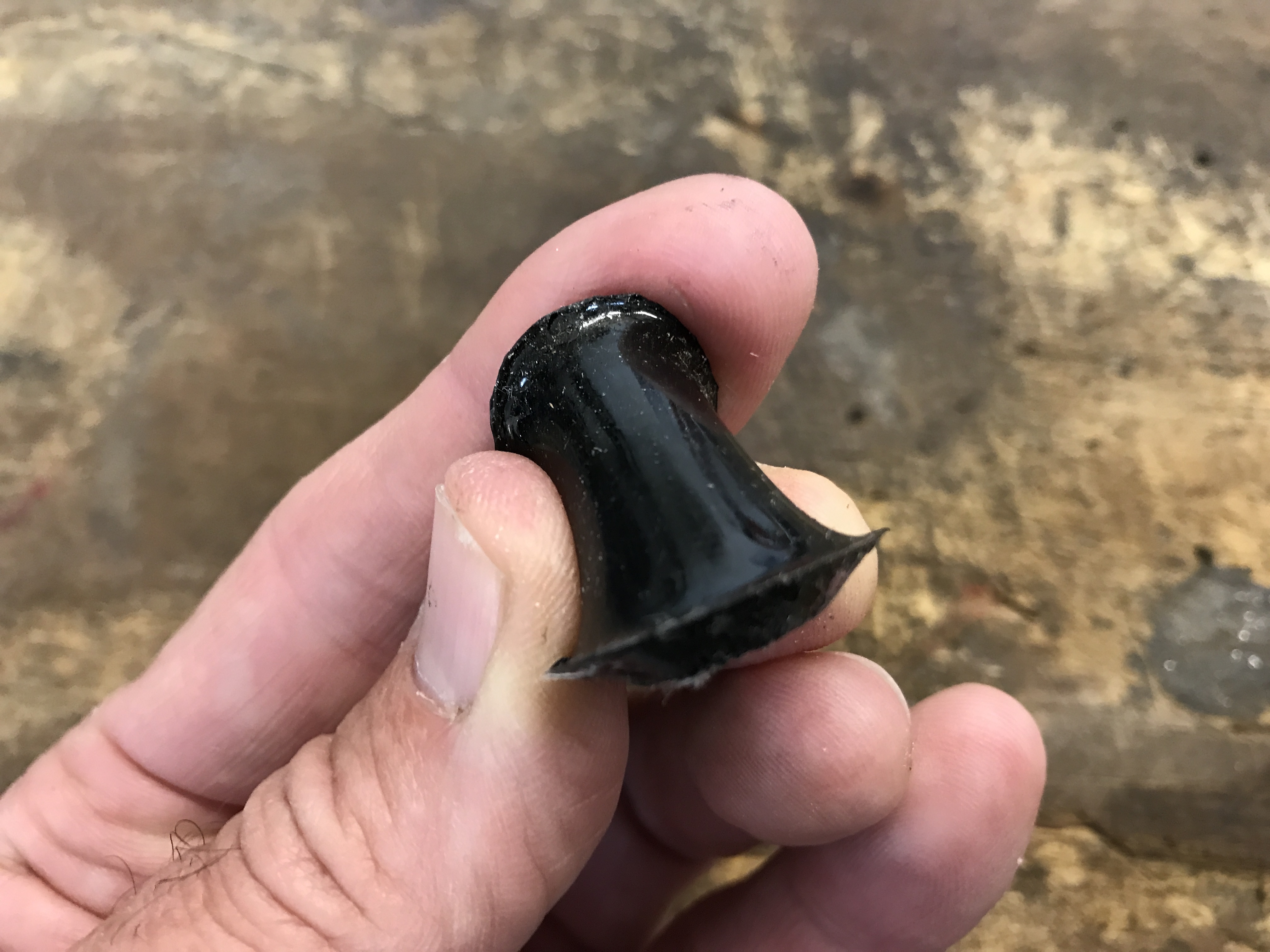

Chemistry lab follow up. First the epoxy seems a bit stiffer but still flexible.

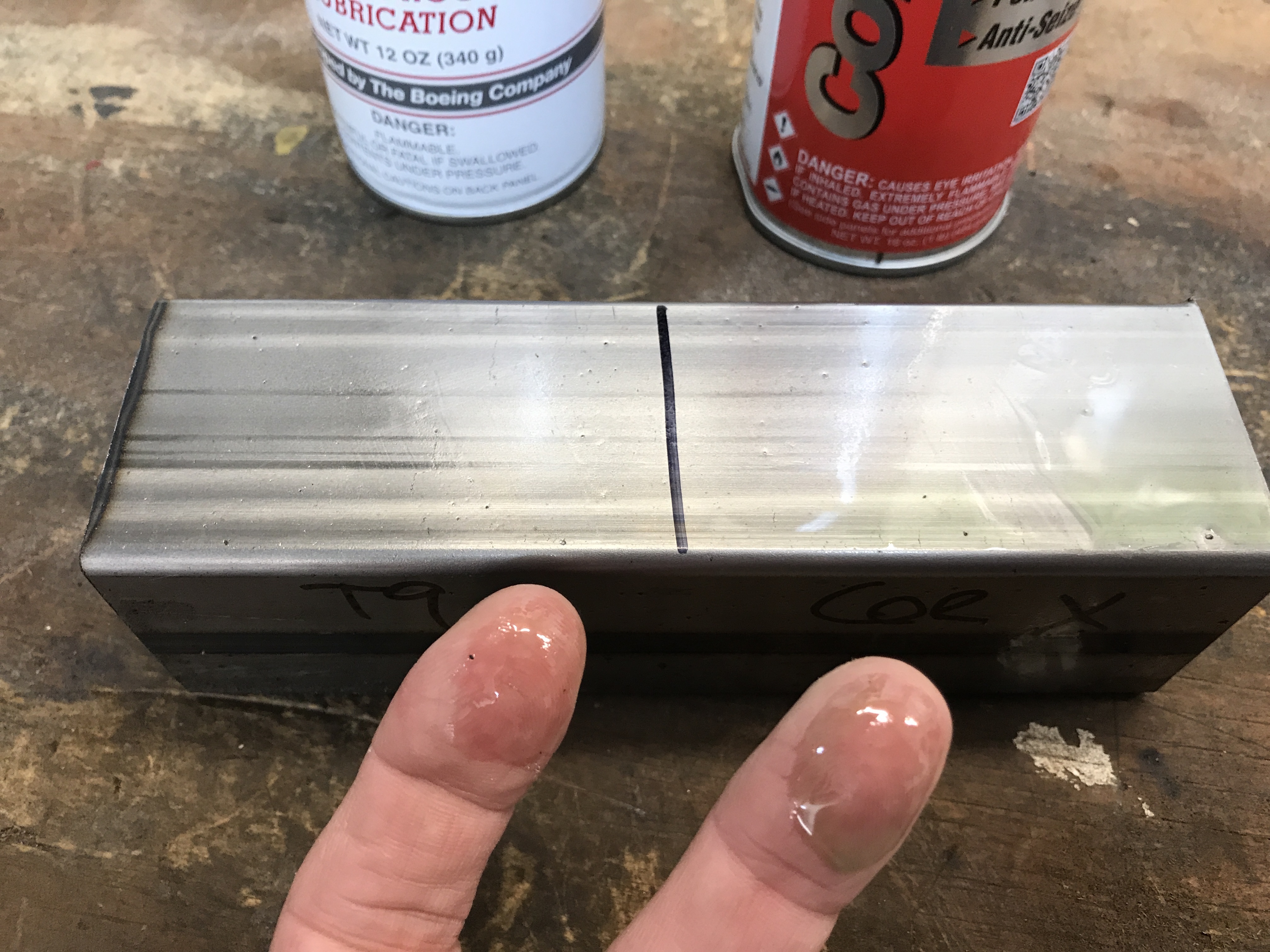

Next, the corrosion inhibitors. These were both very wet after sitting overnight.
bkrantz
post Sep 12 2020, 07:48 PM
Post #1285
Posts: 8,343
Joined: 3-August 19
From: SW Colorado
Member No.: 23,343
I patted them mostly dry with a paper towel--check back tomorrow.

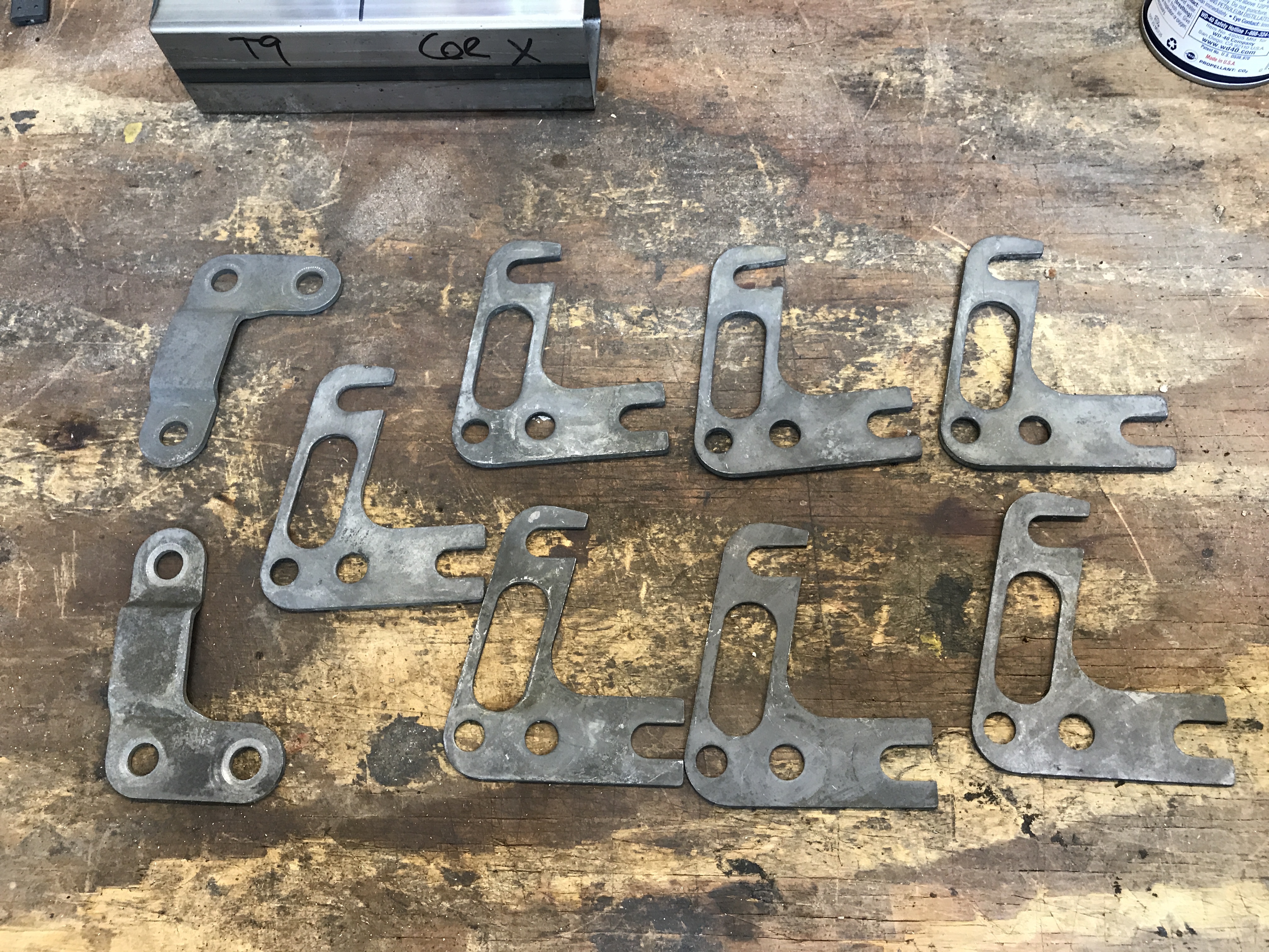

Now for the Evaporators-rust. Pulling out the basket, and the parts look great.
bkrantz
post Sep 12 2020, 07:51 PM
Post #1287
Posts: 8,343
Joined: 3-August 19
From: SW Colorado
Member No.: 23,343
The small fasteners are almost rust free.
bkrantz
Post #1288
Posts: 8,343
Joined: 3-August 19
From: SW Colorado
Member No.: 23,343
The bearing retainers look almost new.
bkrantz
post Sep 12 2020, 07:52 PM
Post #1289
Posts: 8,343
Joined: 3-August 19
From: SW Colorado
Member No.: 23,343

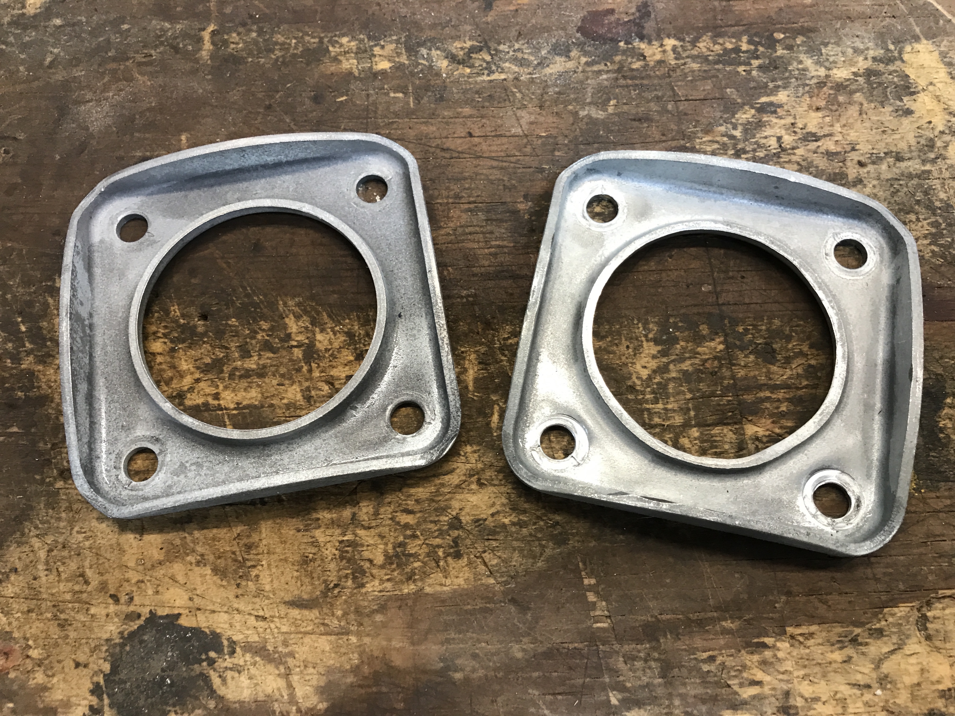

Flanges have no rust.
bkrantz
post Sep 12 2020, 07:53 PM
Post #1290
Posts: 8,343
Joined: 3-August 19
From: SW Colorado
Member No.: 23,343
Neither do the trailing arm alignment spacers.

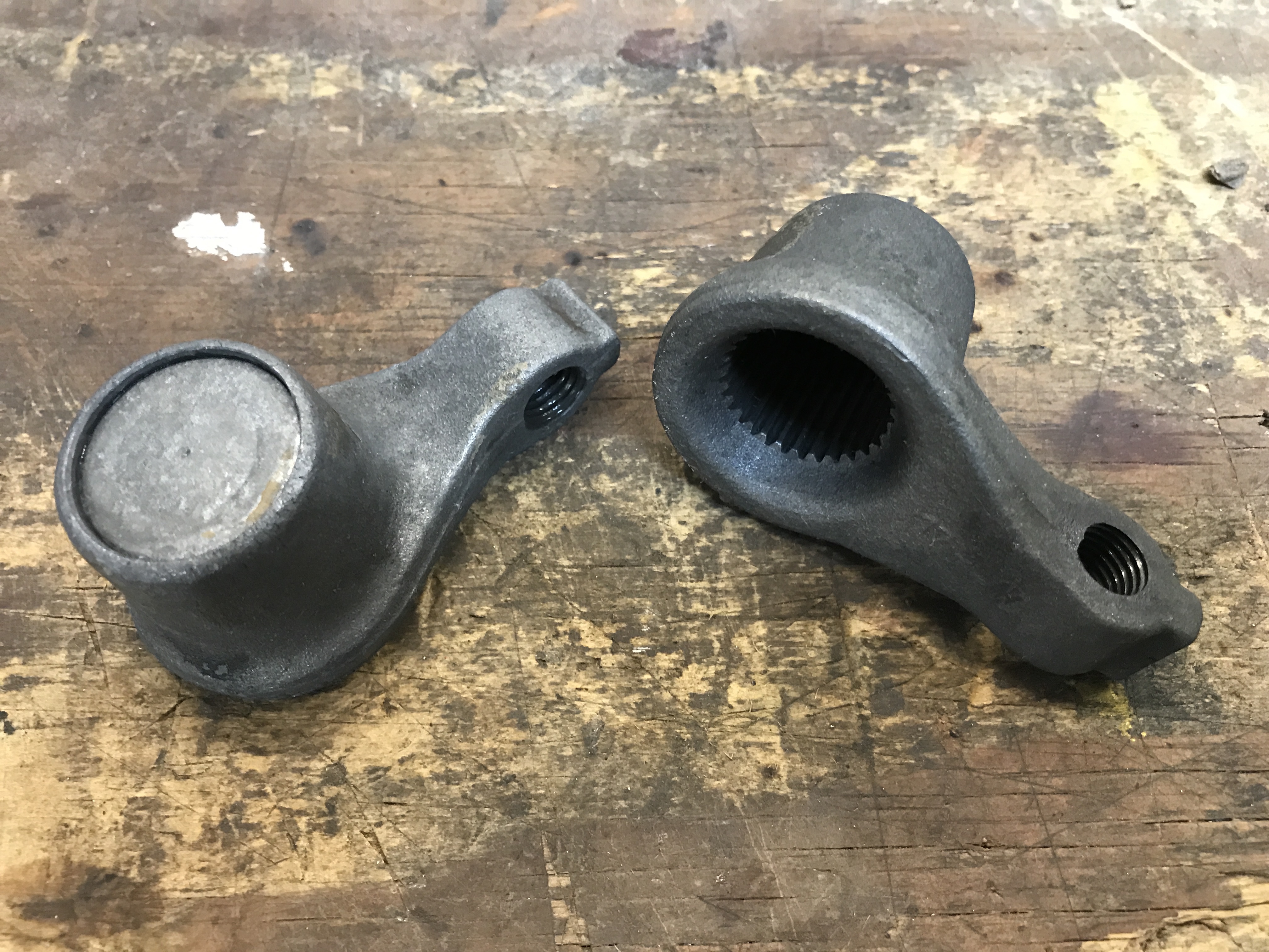

Most improved: the front torsion bar adjusters. These were covered with rust.

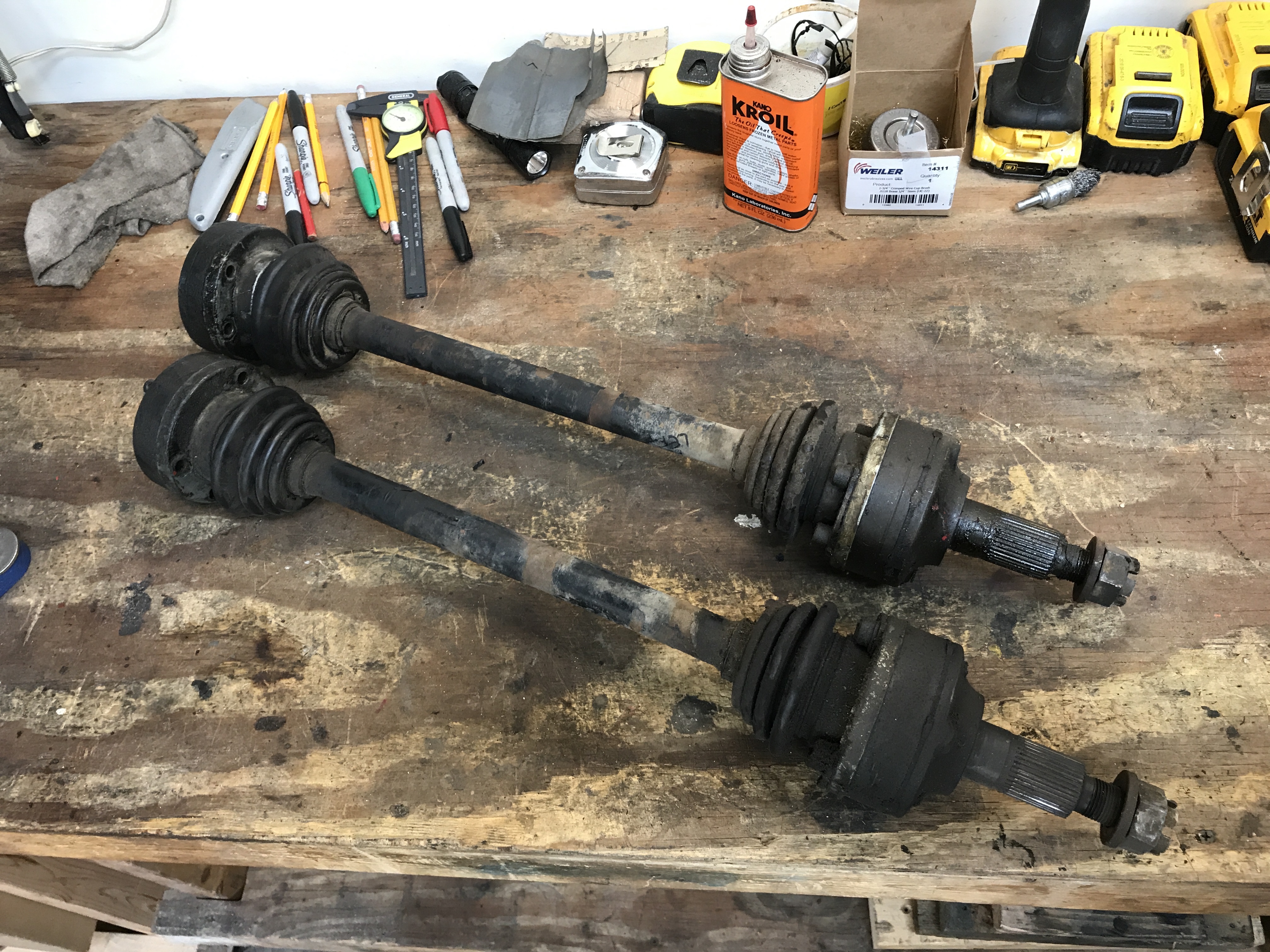

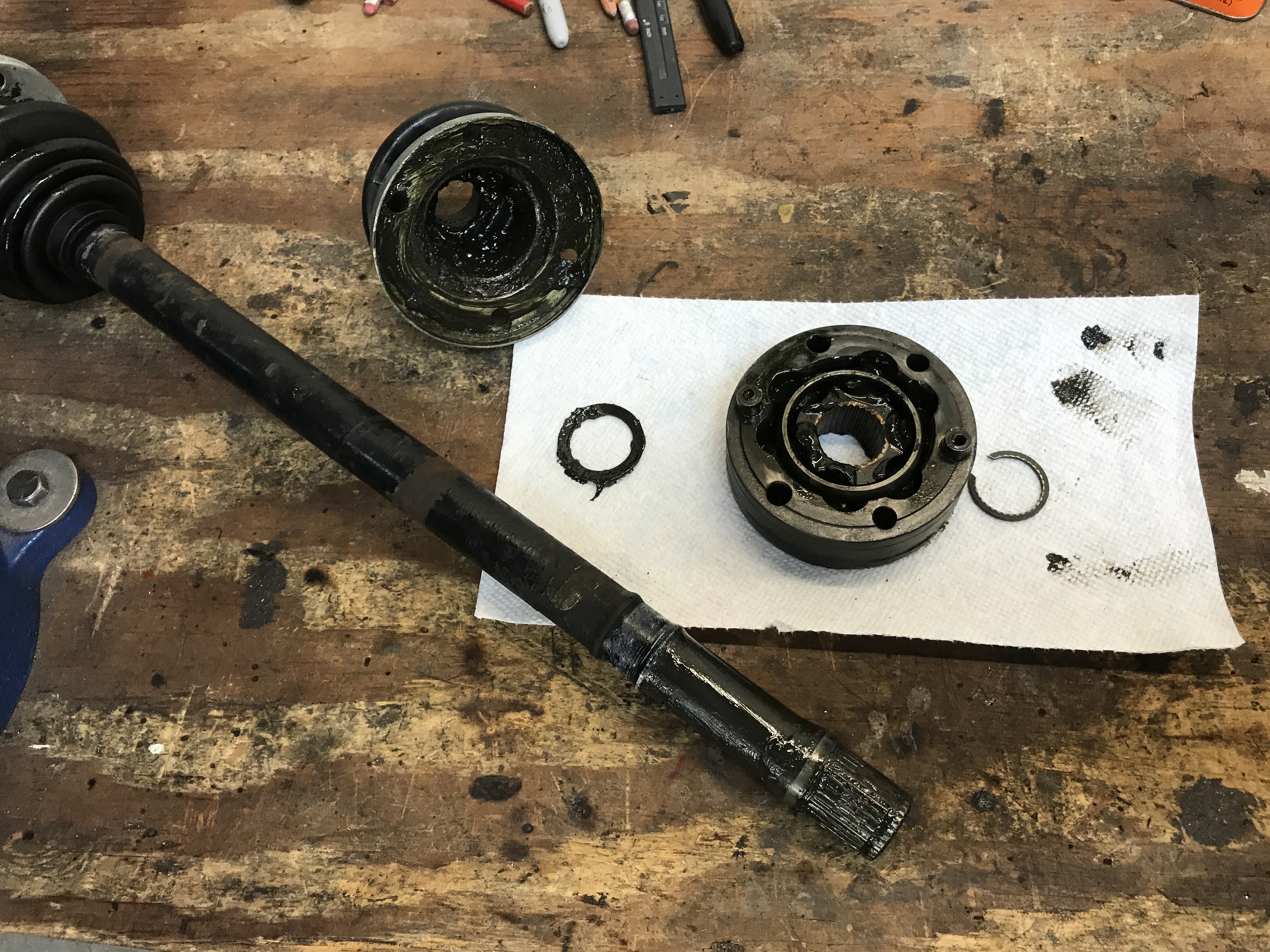

OK, now for some real work. Time to disassemble the half shafts.

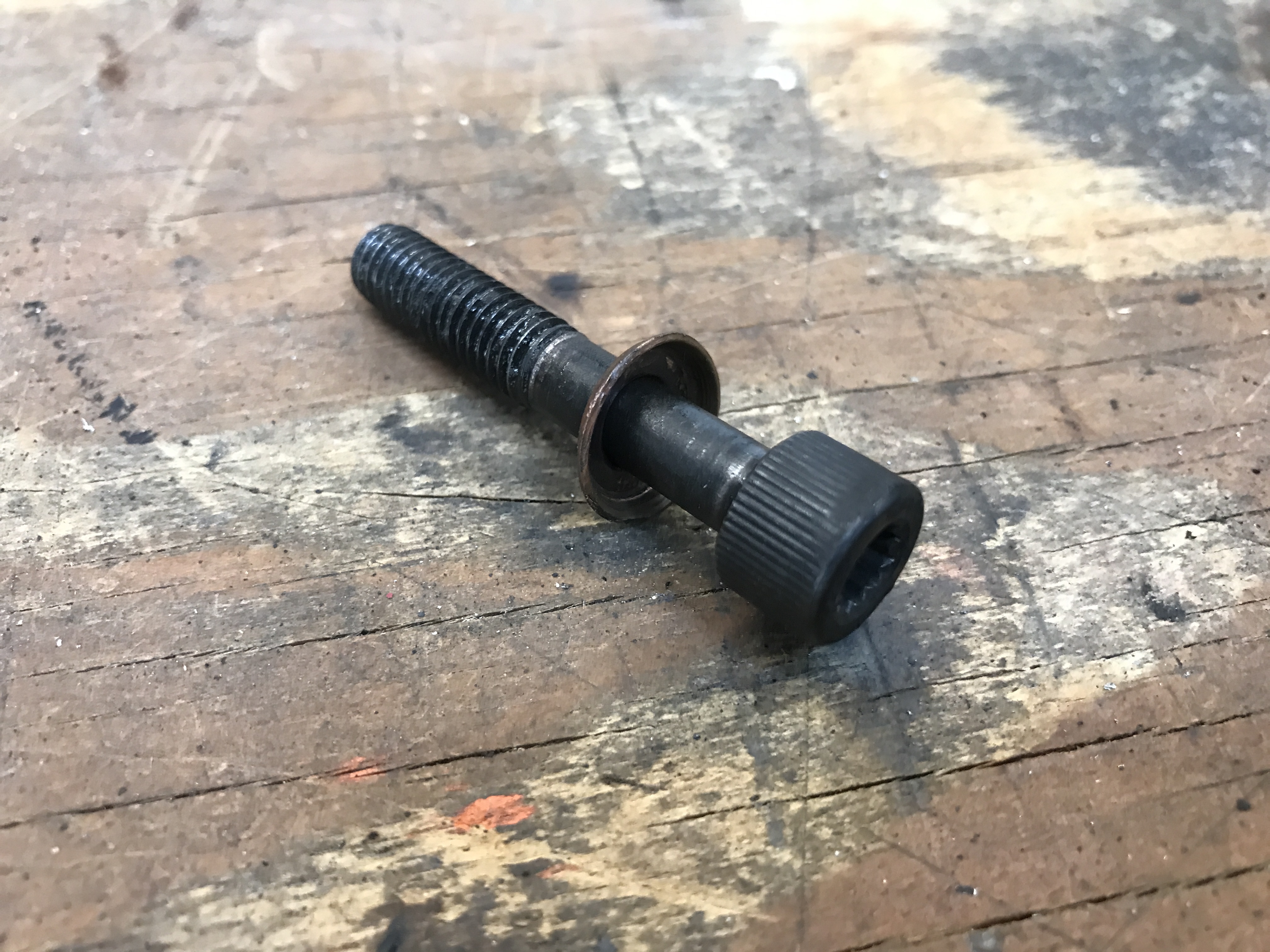

Creative washer on one flange bolt. Copper?

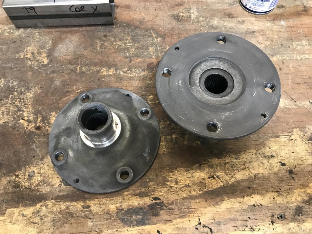

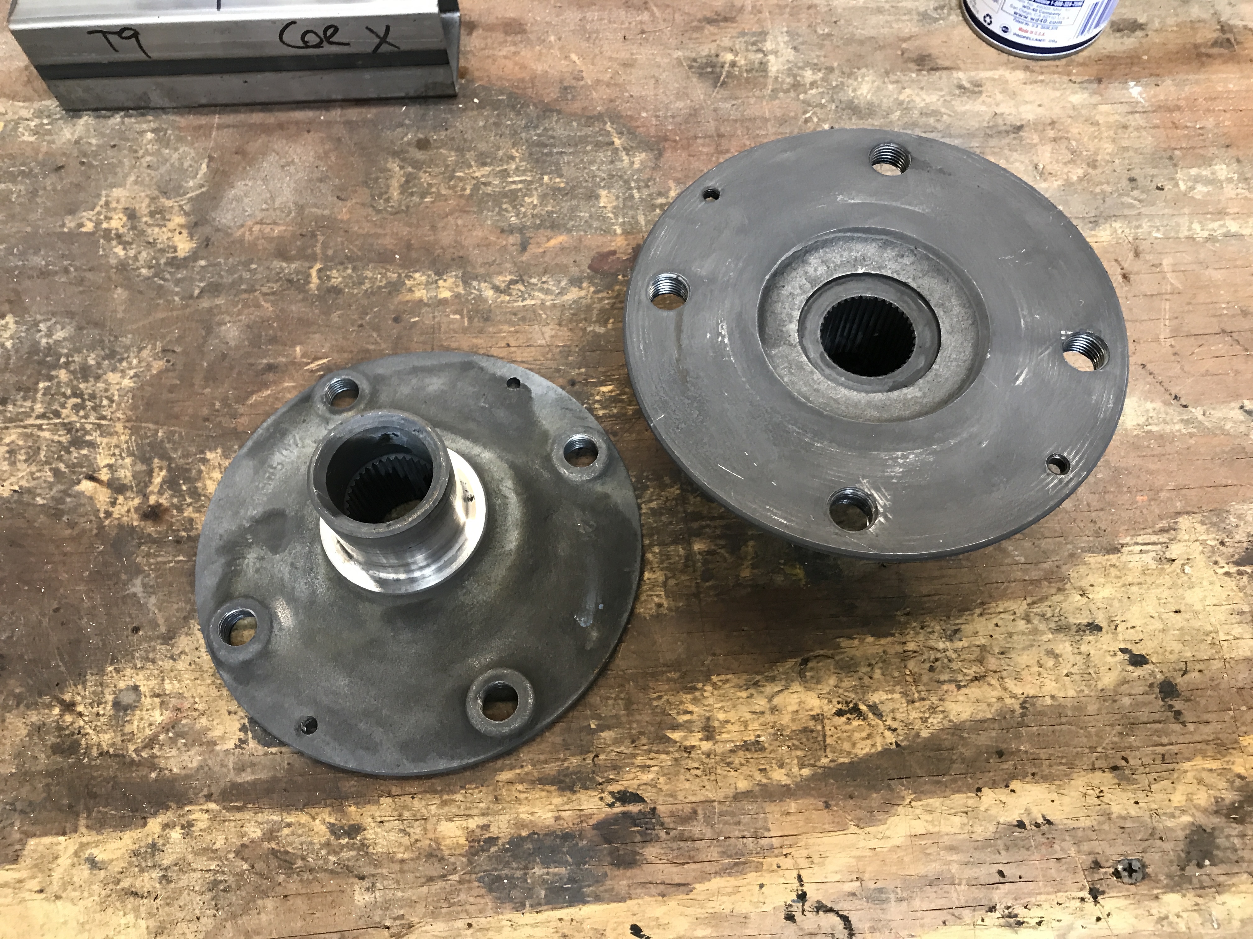

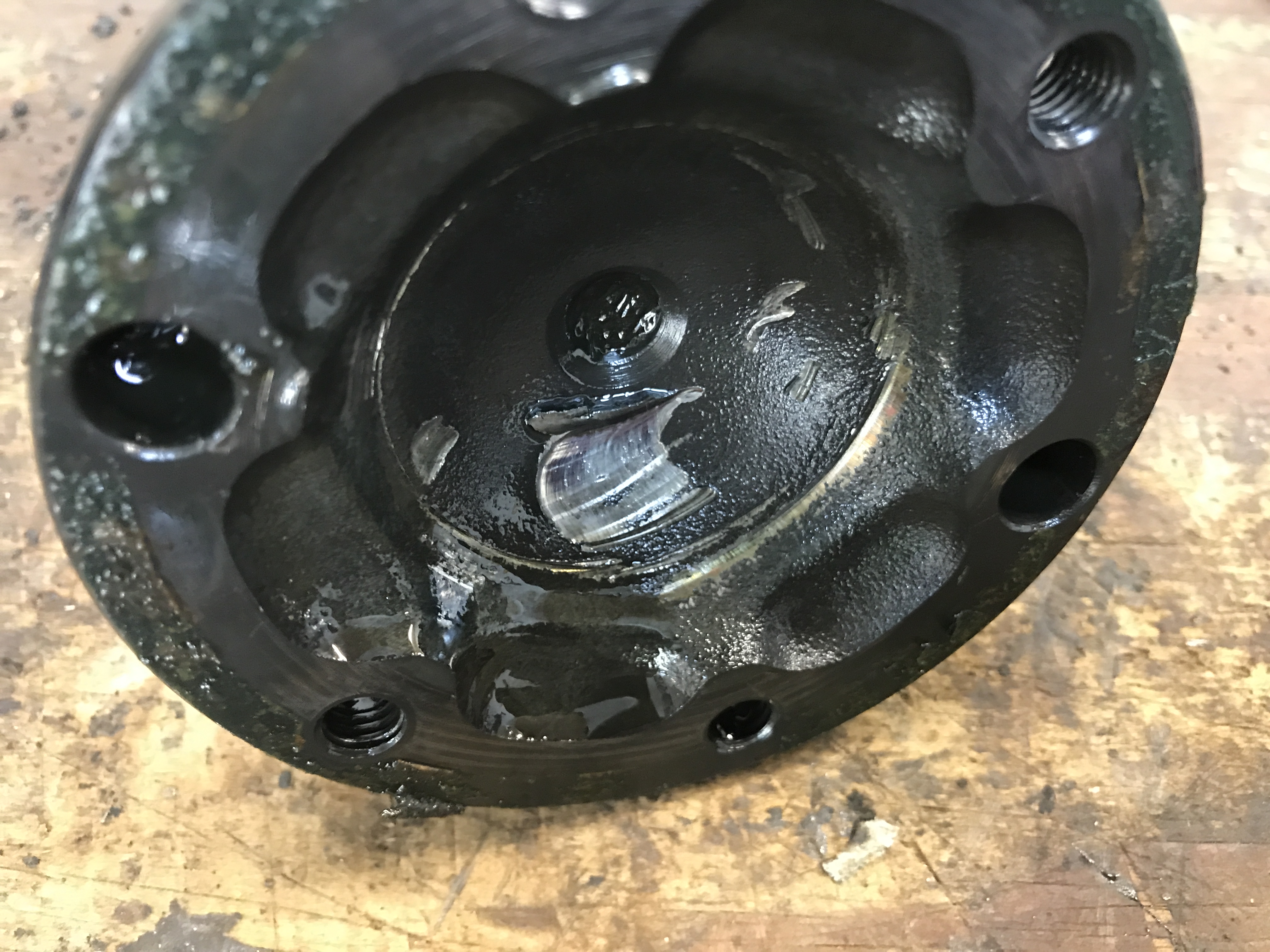

Interesting gouge inside one flange.

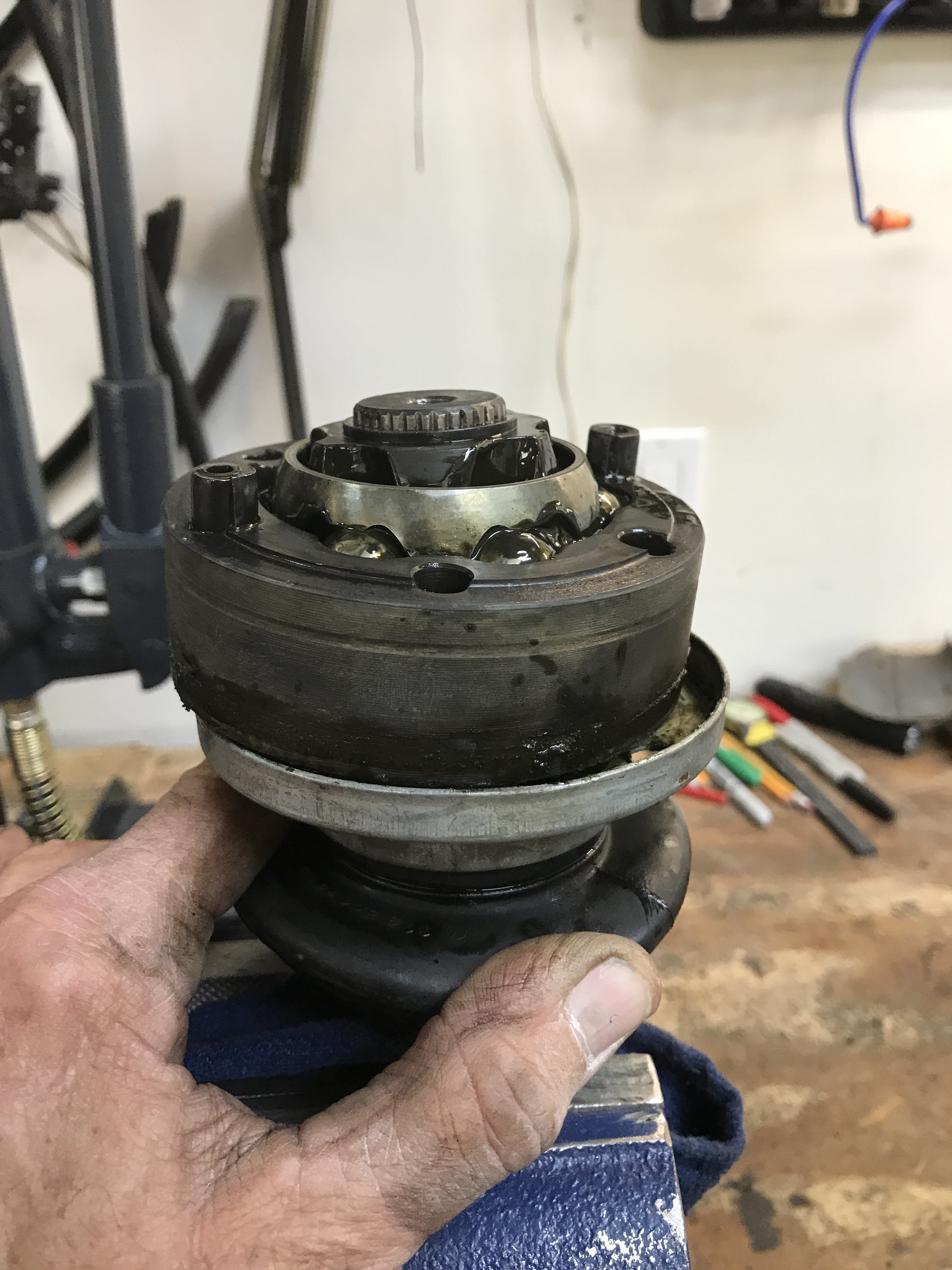

Now onto the standard procedure. Remove the cir-clip and loosen the boot flange.
bkrantz
post Sep 12 2020, 08:01 PM
Post #1297
Posts: 8,343
Joined: 3-August 19
From: SW Colorado
Member No.: 23,343
Pop off the CV joint and boot.
bkrantz
post Sep 12 2020, 08:02 PM
Post #1298
Posts: 8,343
Joined: 3-August 19
From: SW Colorado
Member No.: 23,343

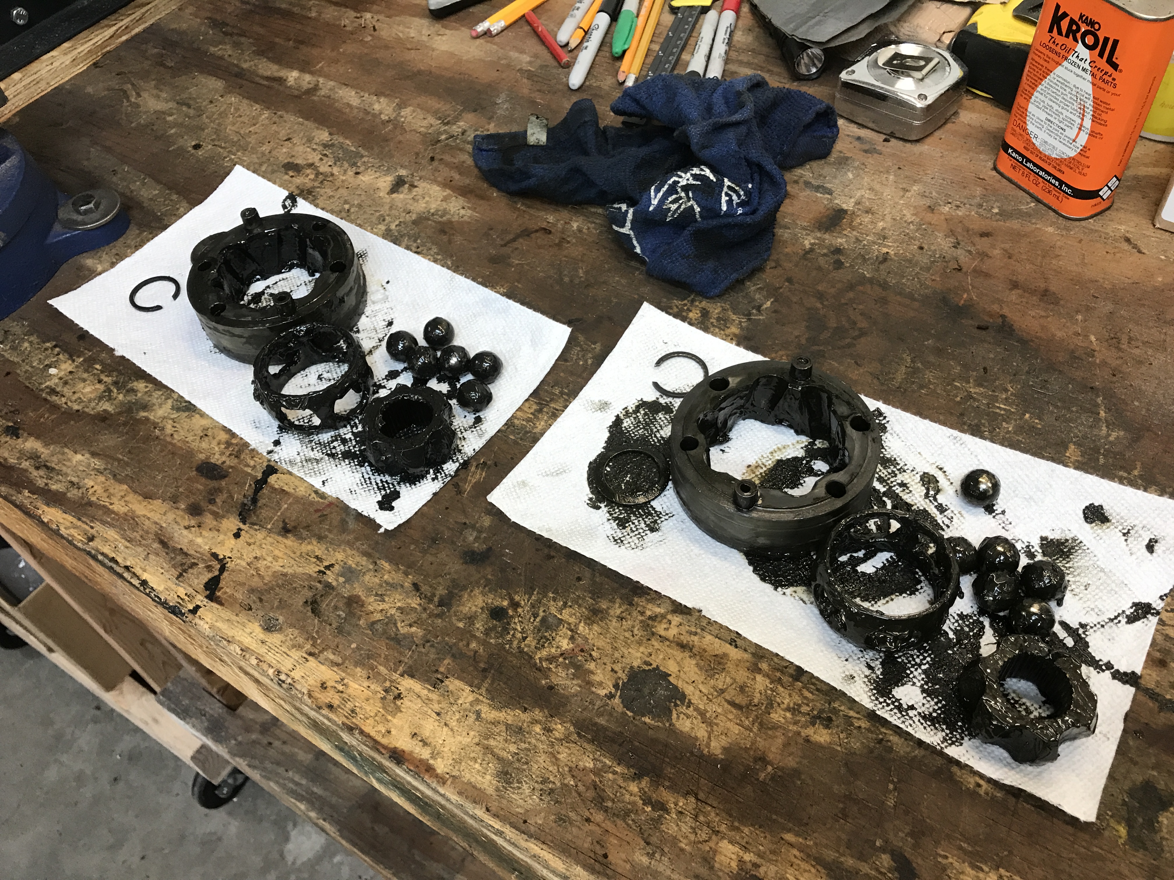

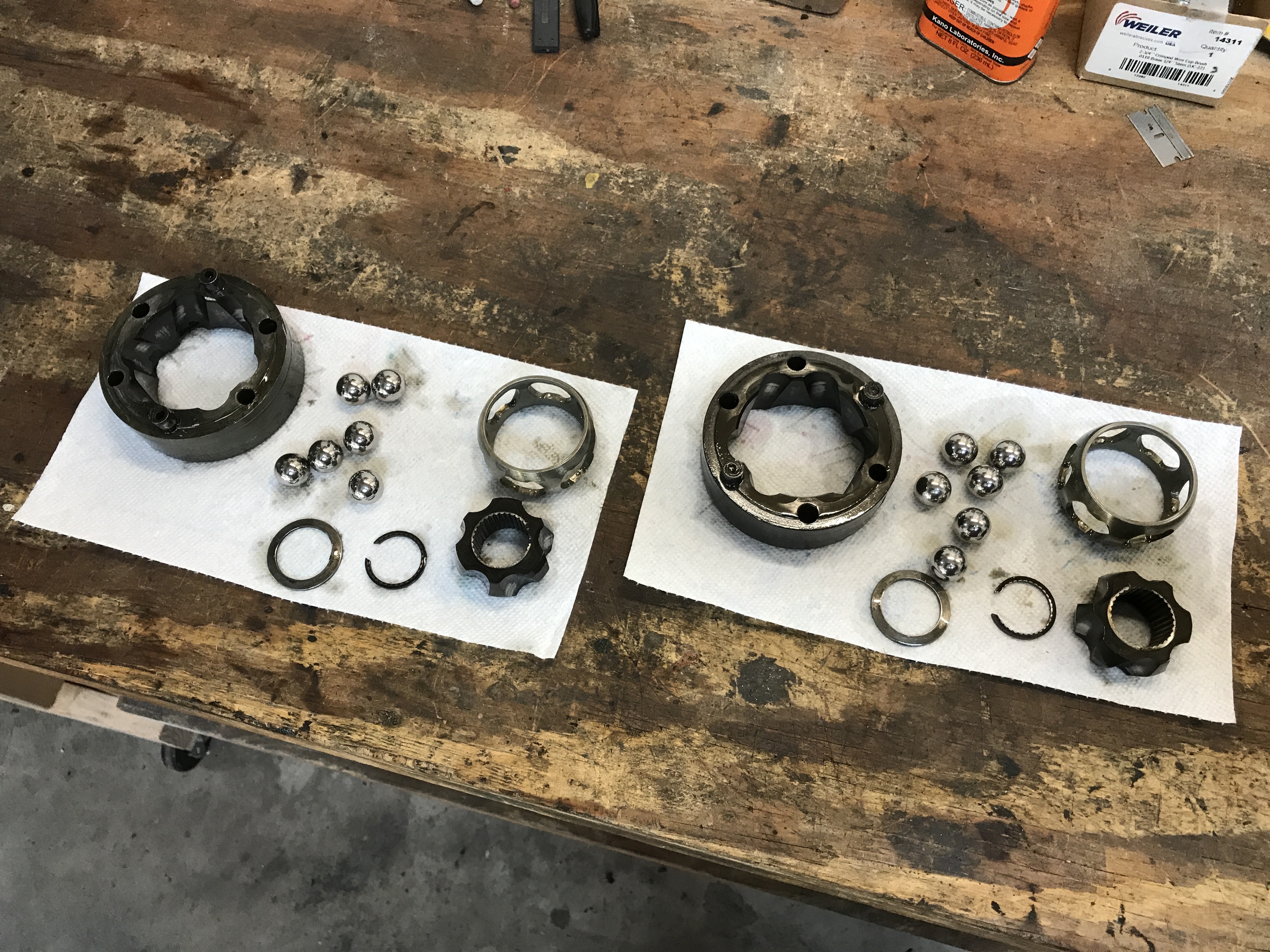

Repeat on the other end, and then break down the CV joints (keep the parts for each one together).
bkrantz
post Sep 12 2020, 08:03 PM
Post #1299
Posts: 8,343
Joined: 3-August 19
From: SW Colorado
Member No.: 23,343
And after some quality time in the parts washer.
