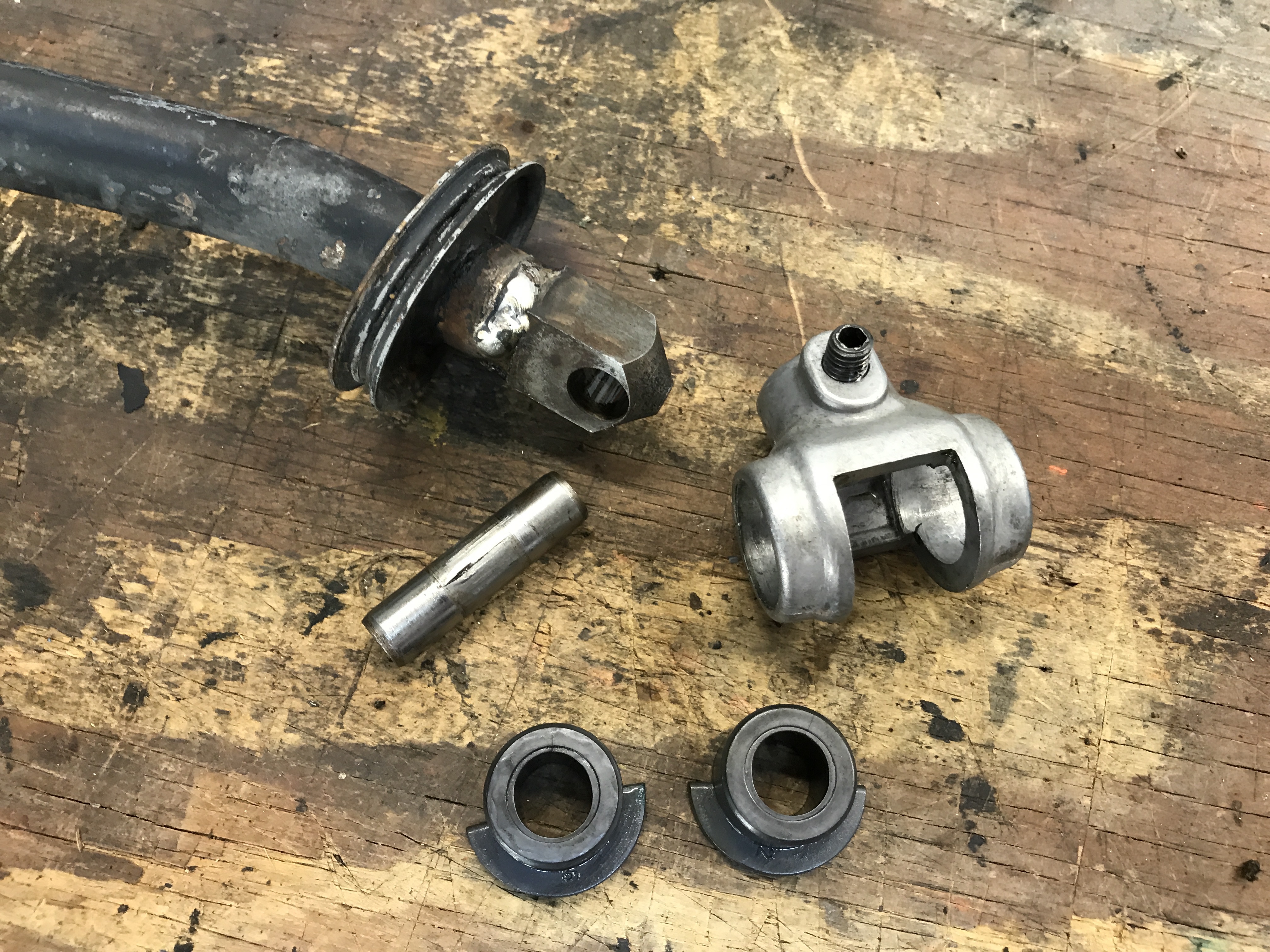

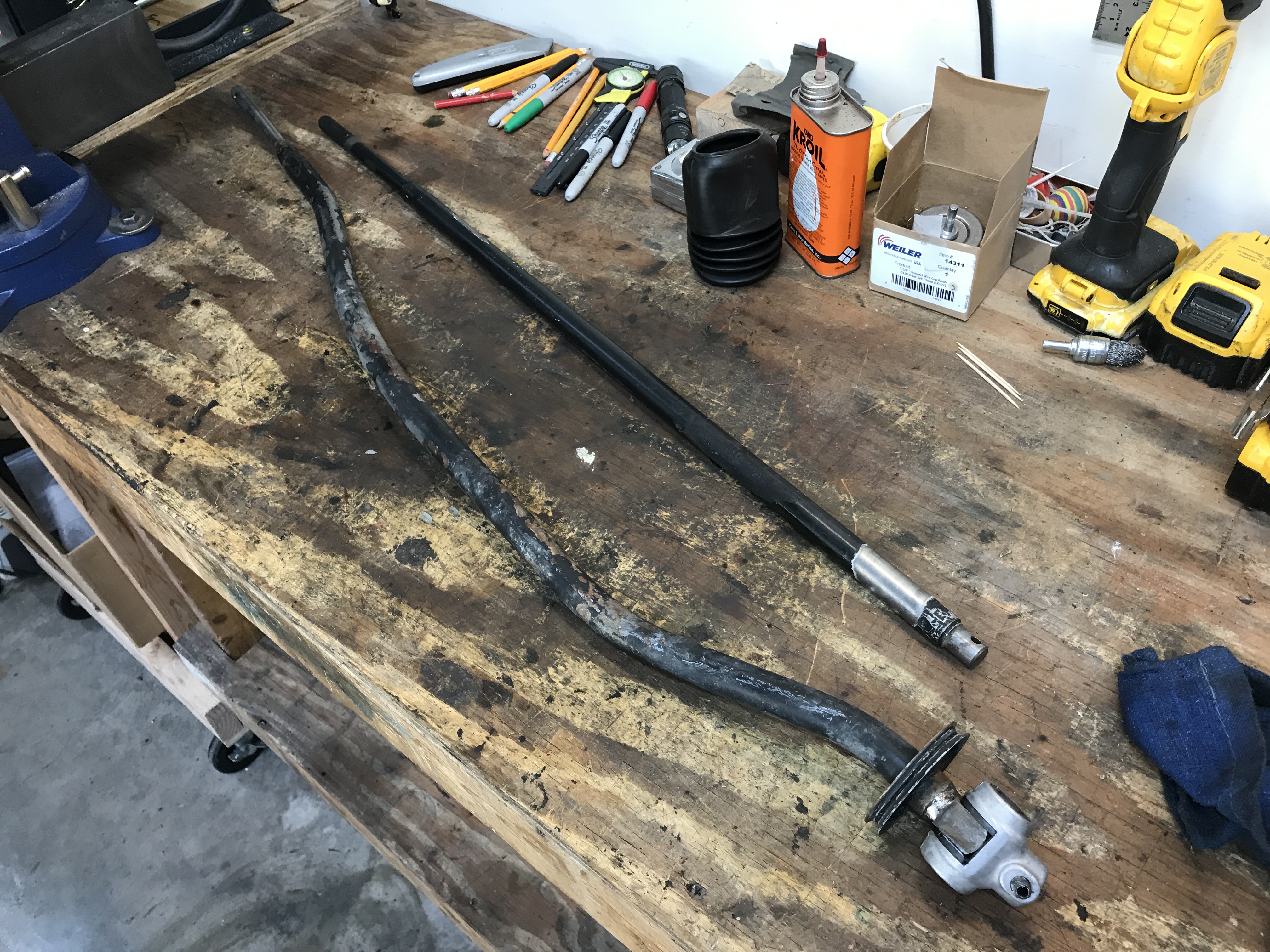

I inspected the shift rods today. The both look fine, just in need of paint (or powder-coat).
post Sep 13 2020, 06:56 PM
Post #1303
Posts: 8,343

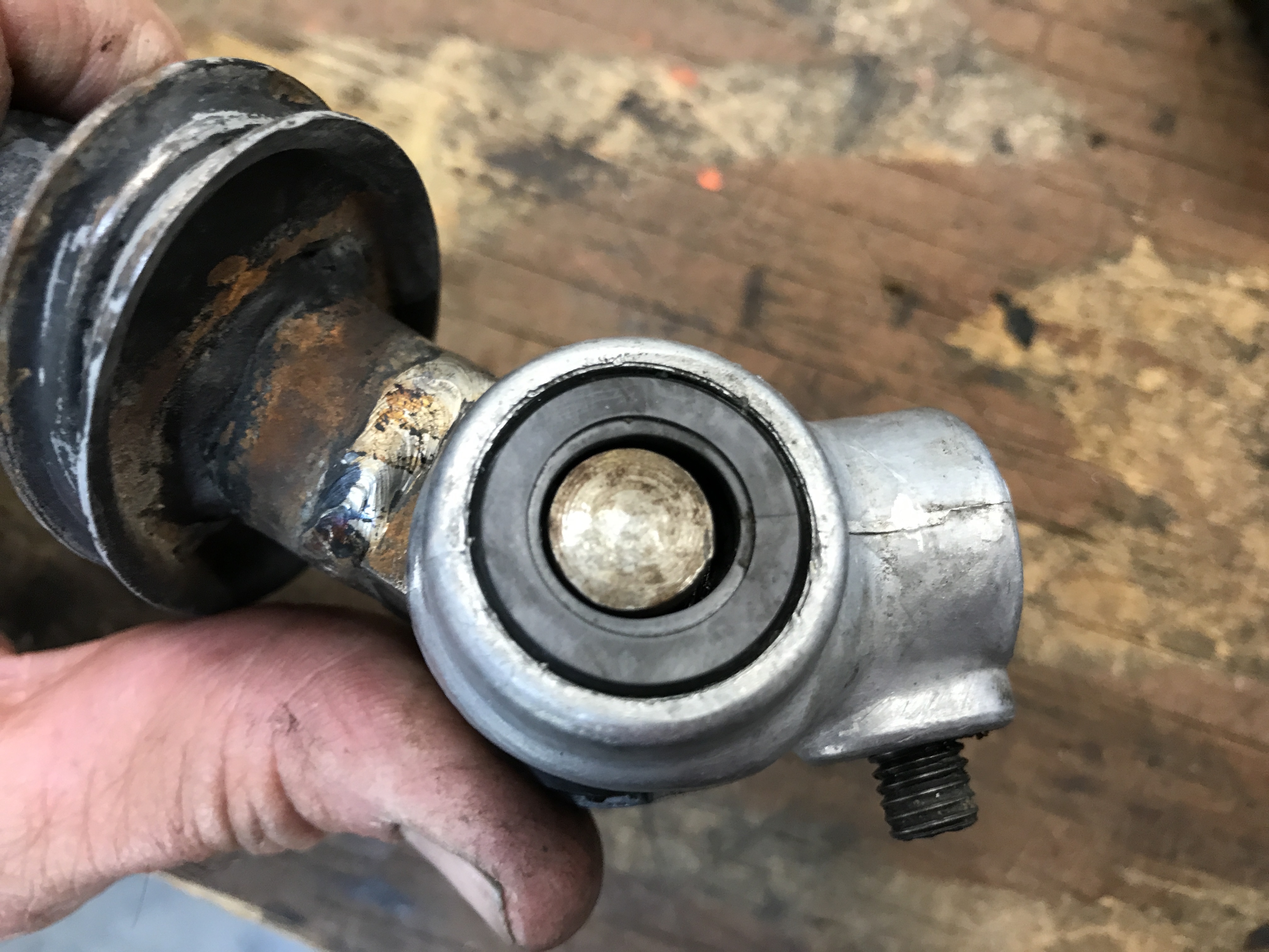

The linkage, though, looks a bit (or more) loose. The plastic bushings might be worn. (IMG:style_emoticons/default/biggrin.gif)
post Sep 13 2020, 06:58 PM
Post #1304
Posts: 8,343
It took about 30 seconds to remove the pivot shaft with my press. The bushings are definitely done.

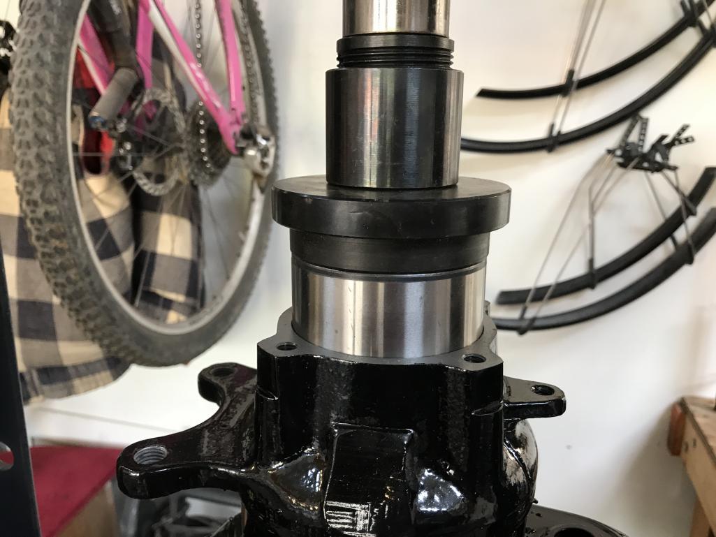

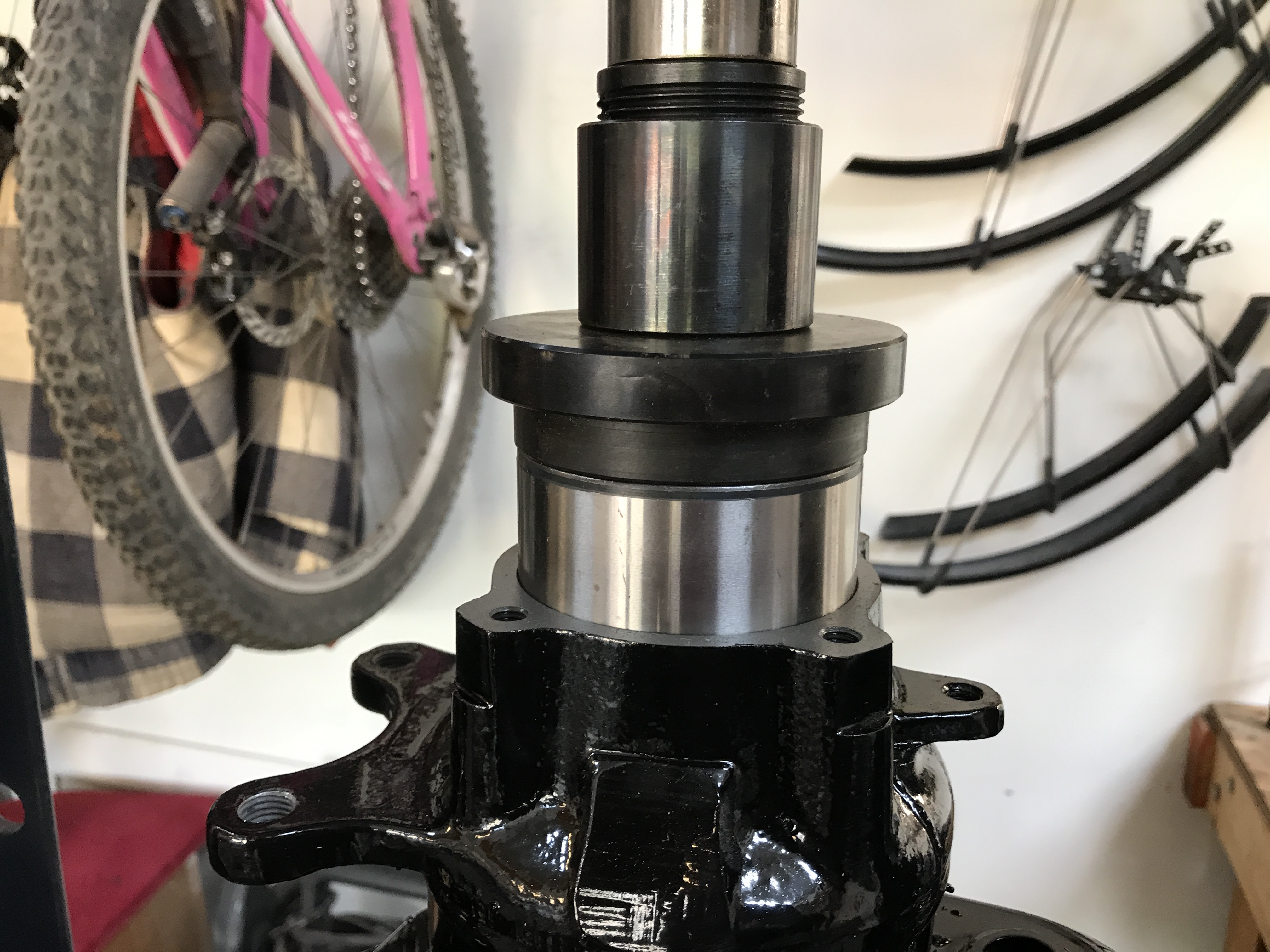

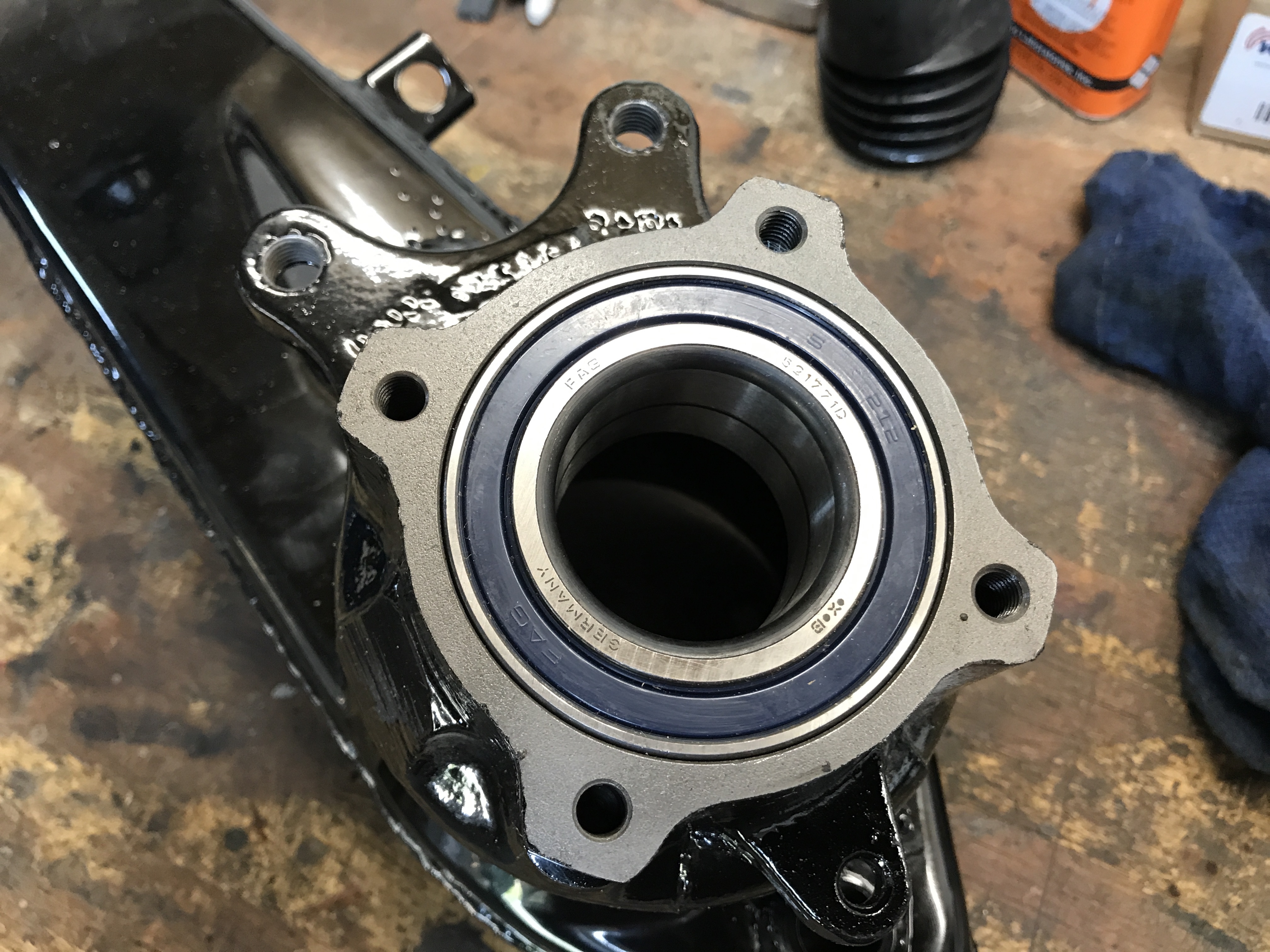

Speaking of the press, I installed the rear wheel bearings in the trailing arms today. Based on my bench testing, I decided to coat the bearing cavity in the arm, which was blasted to bare metal, with Boeshield T-9.
Very easy to press the bearing, with little force required.
post Sep 13 2020, 07:02 PM
Post #1306
Posts: 8,343

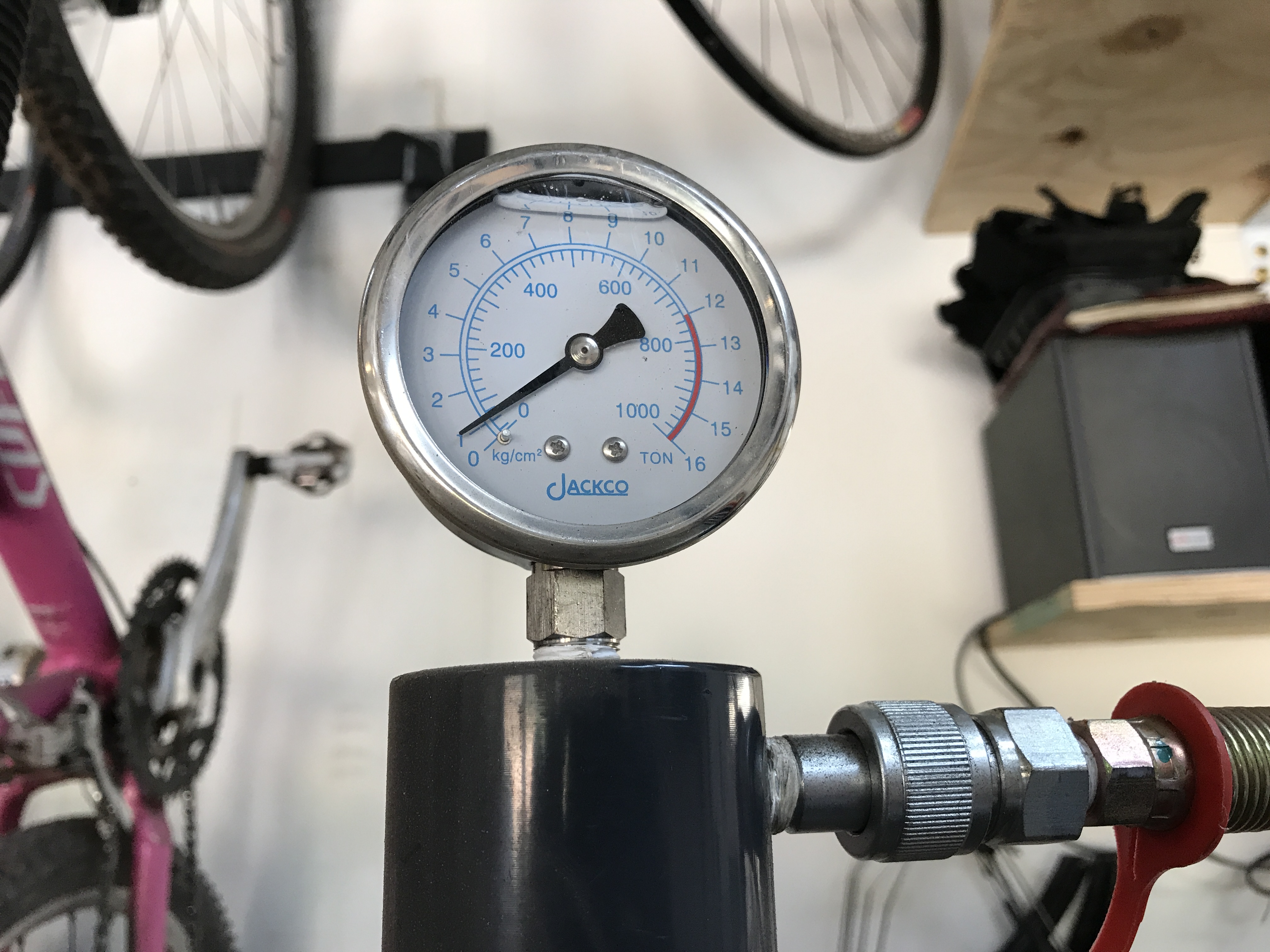

I like using a press with a pressure gauge, so that when the bearing is seated, I can see the pressure ramp up.
post Sep 13 2020, 07:04 PM
Post #1307
Posts: 8,343
Bearing in place.

Posts: 8,343

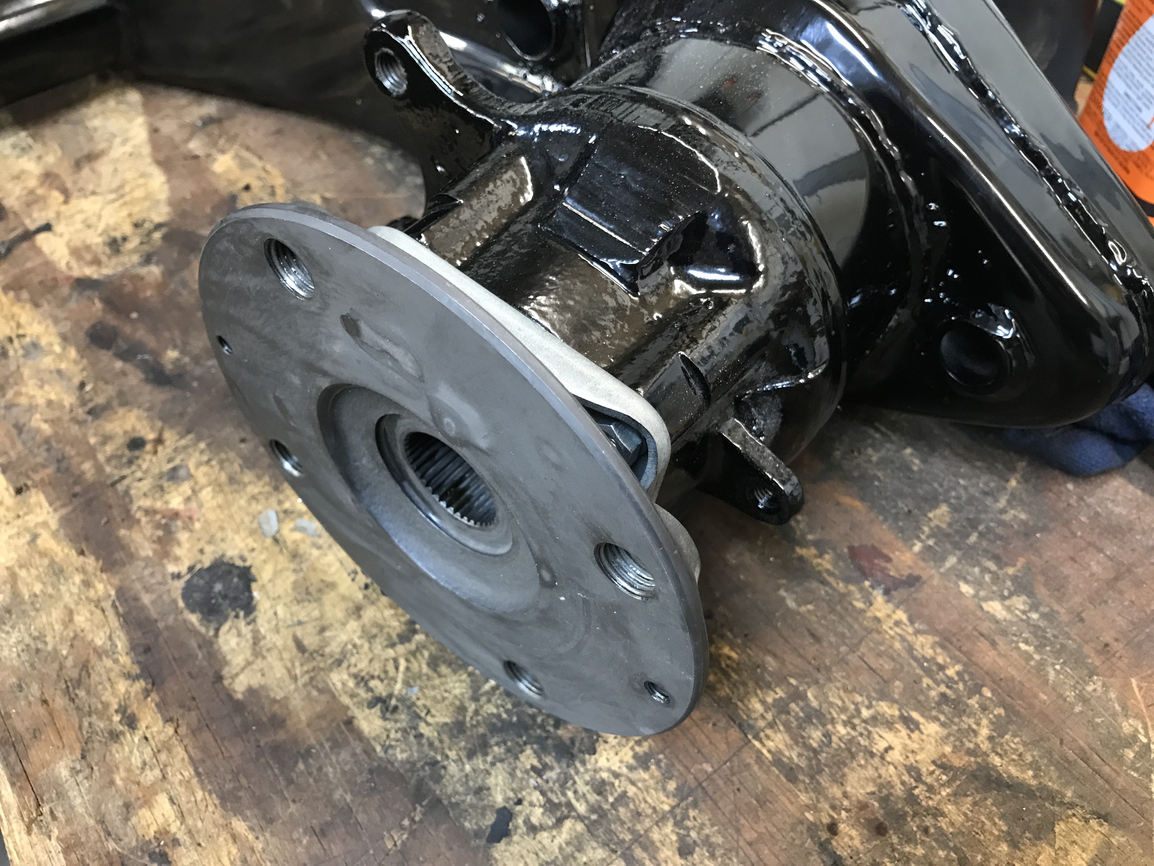

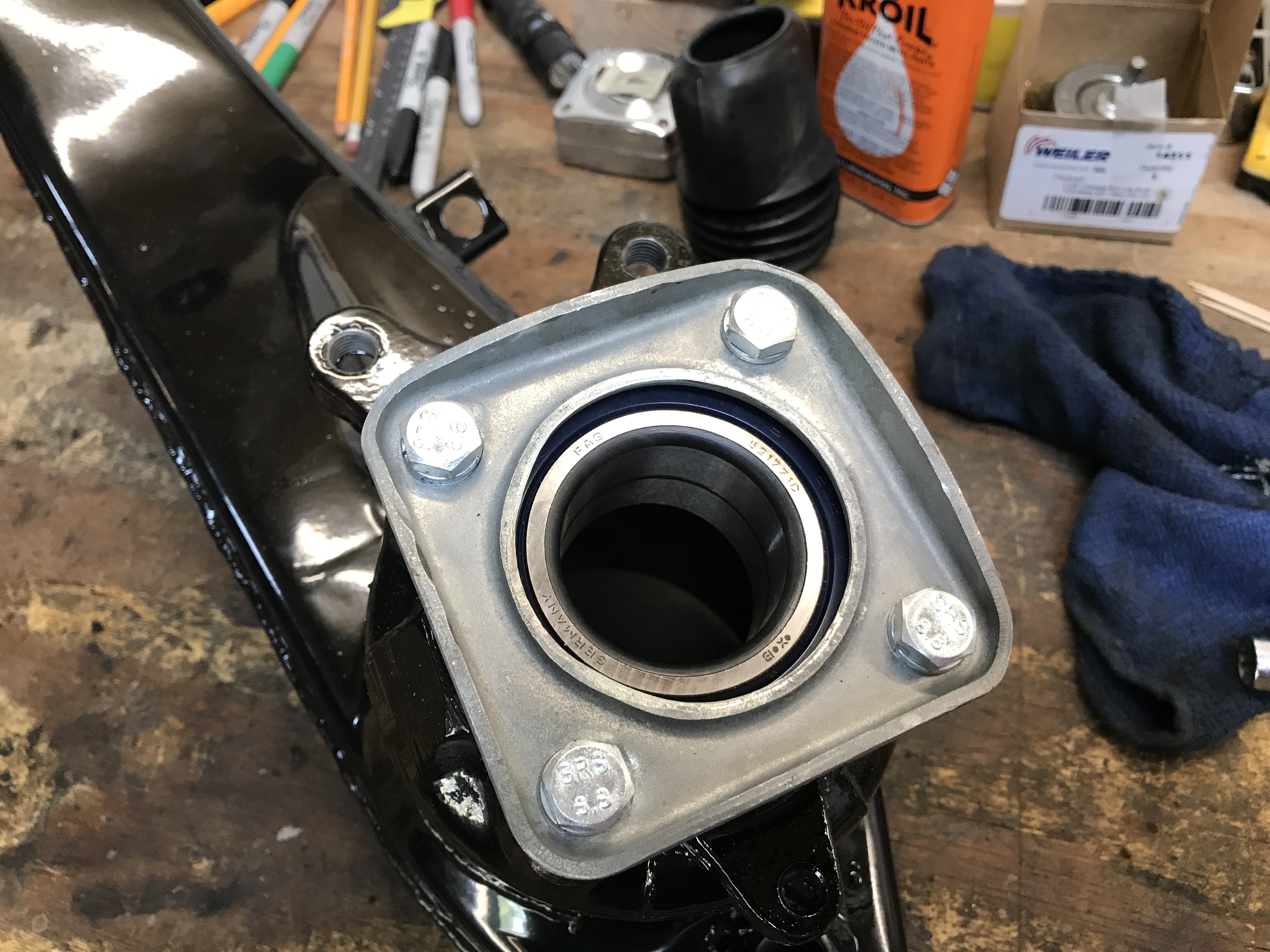

And retainer with shiny new hardware. Mmmm.
post Sep 13 2020, 07:06 PM
Post #1309
Posts: 8,343

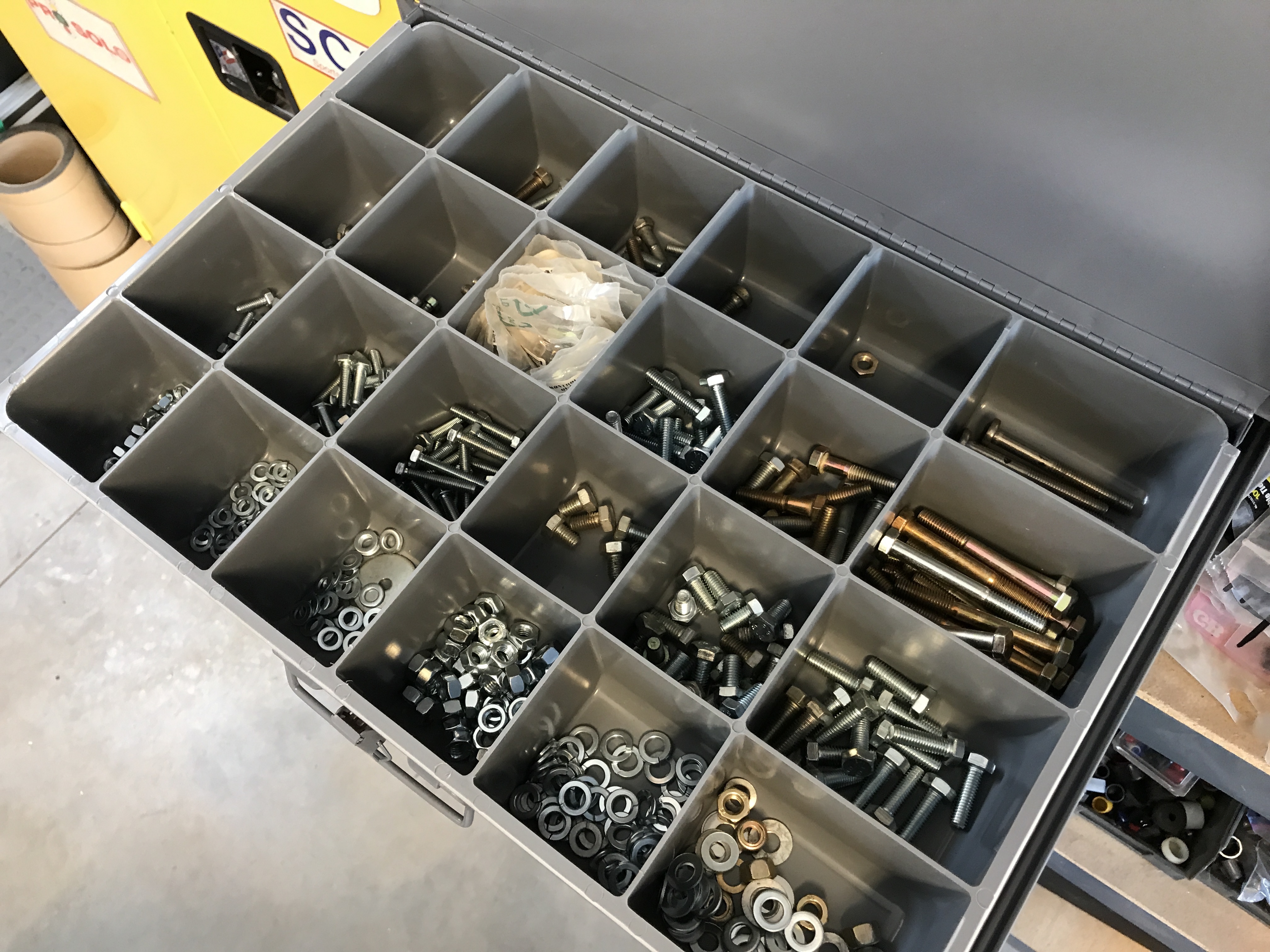

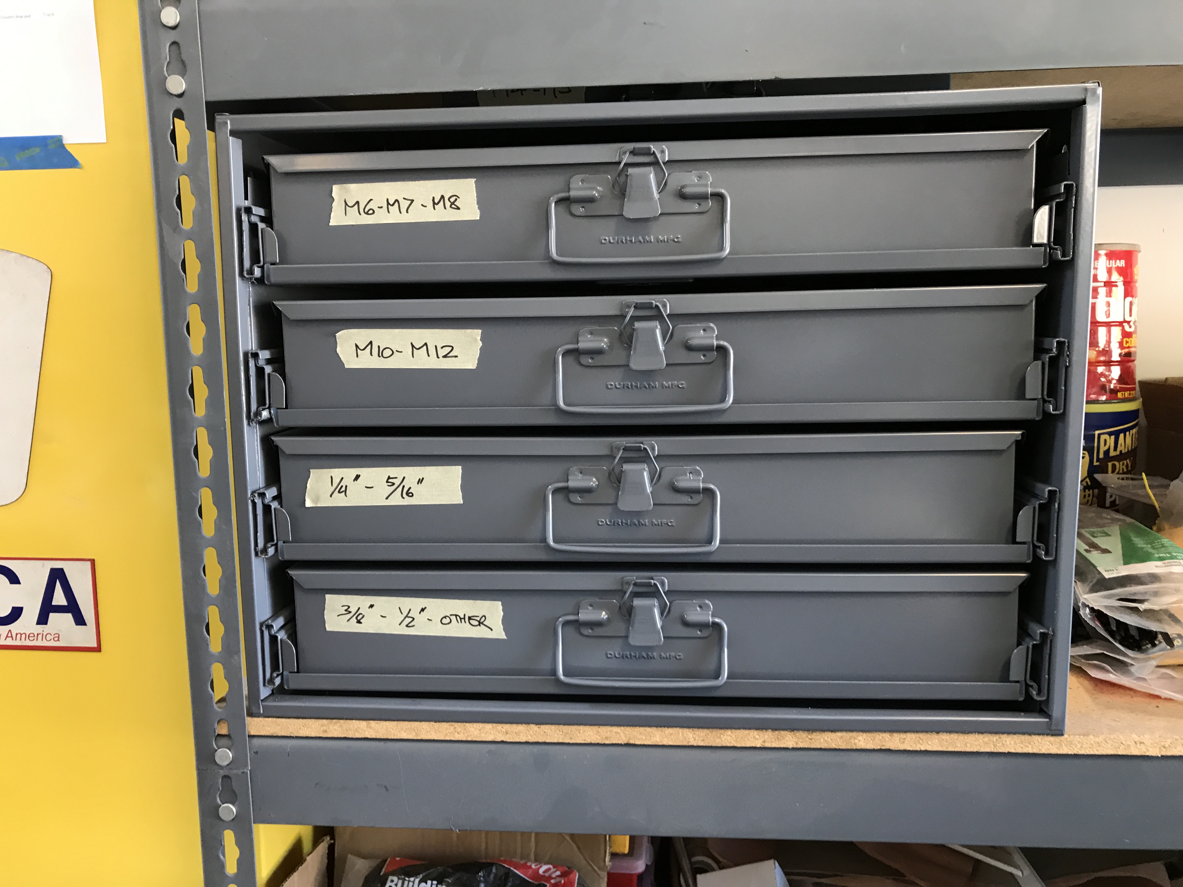

Good reason to tap into my newly created home hardware supply, sourced from McMaster-Carr.
Post #1310
Posts: 8,343
Lots of shiny stuff!

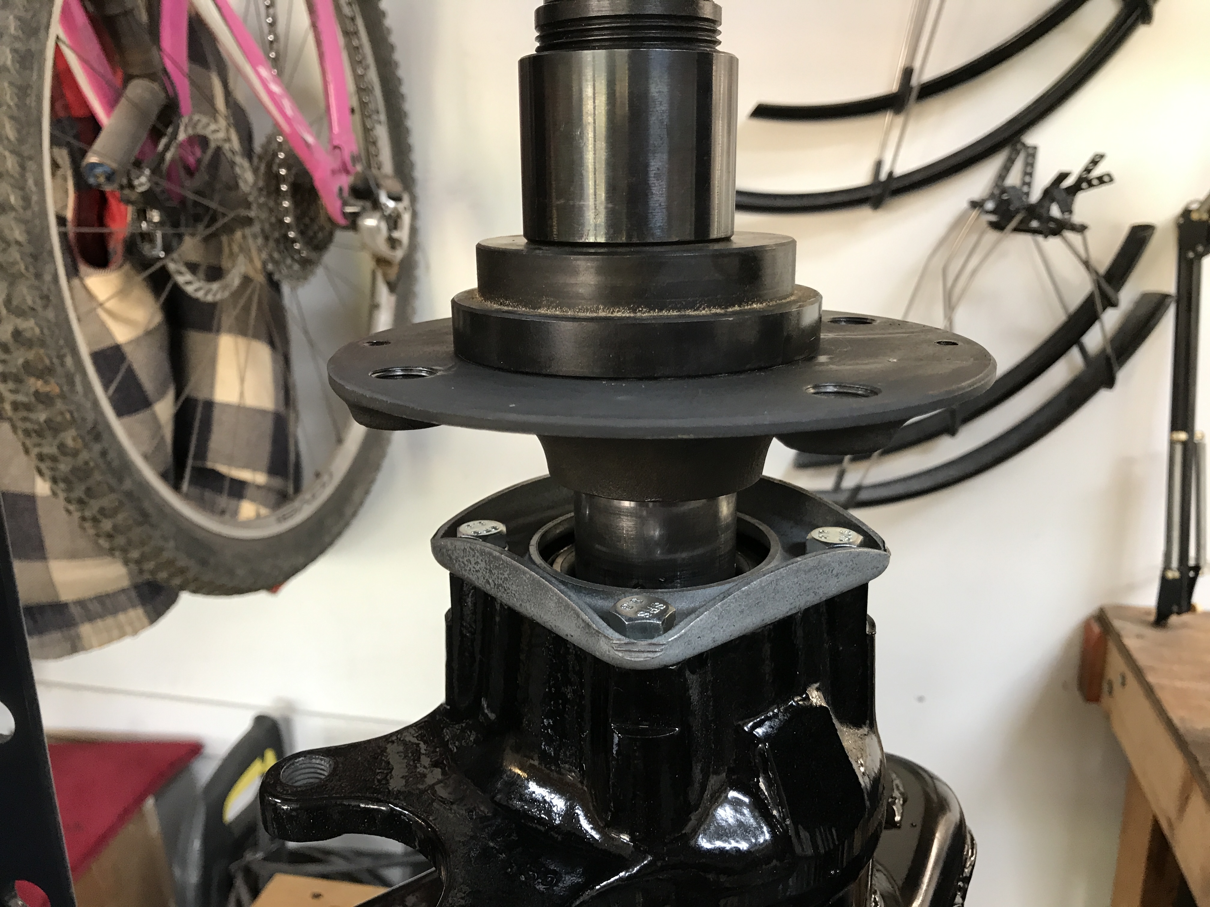

Then time to press in the wheel flanges. Note: inner races of the bearing supported from below.
post Sep 13 2020, 07:09 PM
Post #1312
Posts: 8,343
Flange in place.
post Sep 13 2020, 07:10 PM
Post #1313
Posts: 8,343

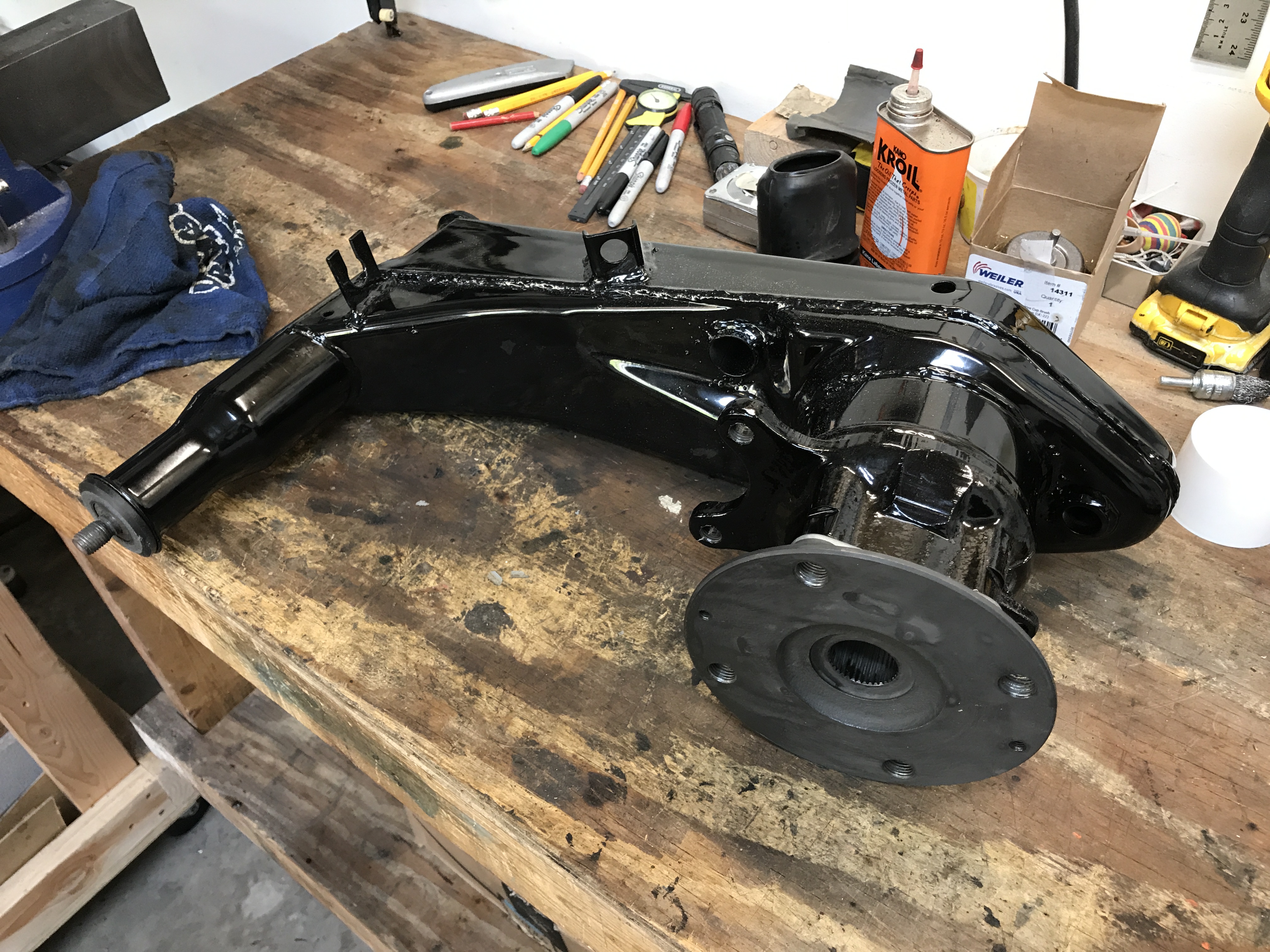

Trailing arms done!

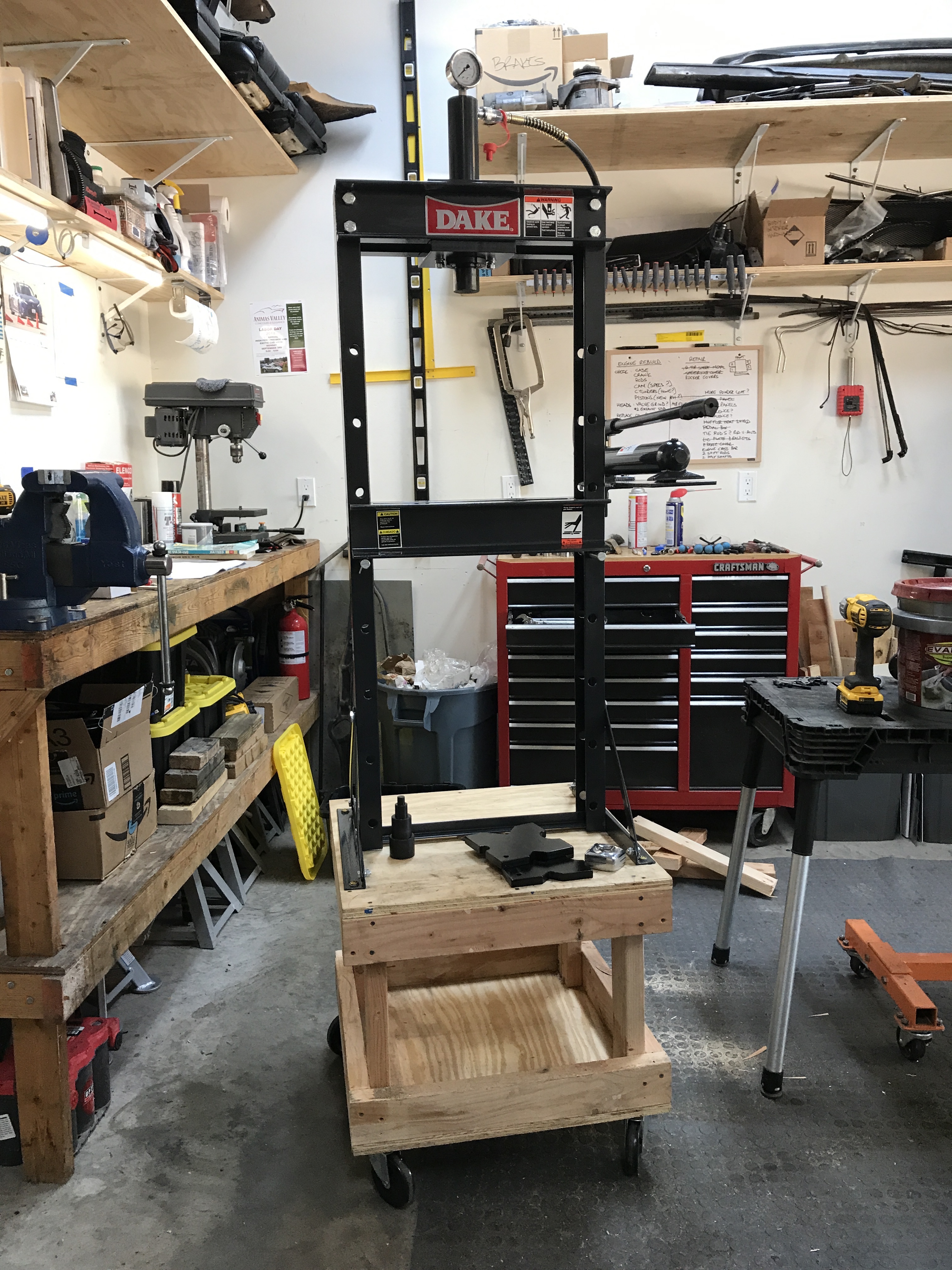

Agreed. Here's my latest that I picked up from the local freight delivery company today. I was stupid when I bought the Dake bench top model since the working height is only about 16 inches. My excuse is that I replaced an older bench top press.
But I need something with more reach, so I got the Dake floor model. This has a 38 inch working height.
My son will inherit the bench model.

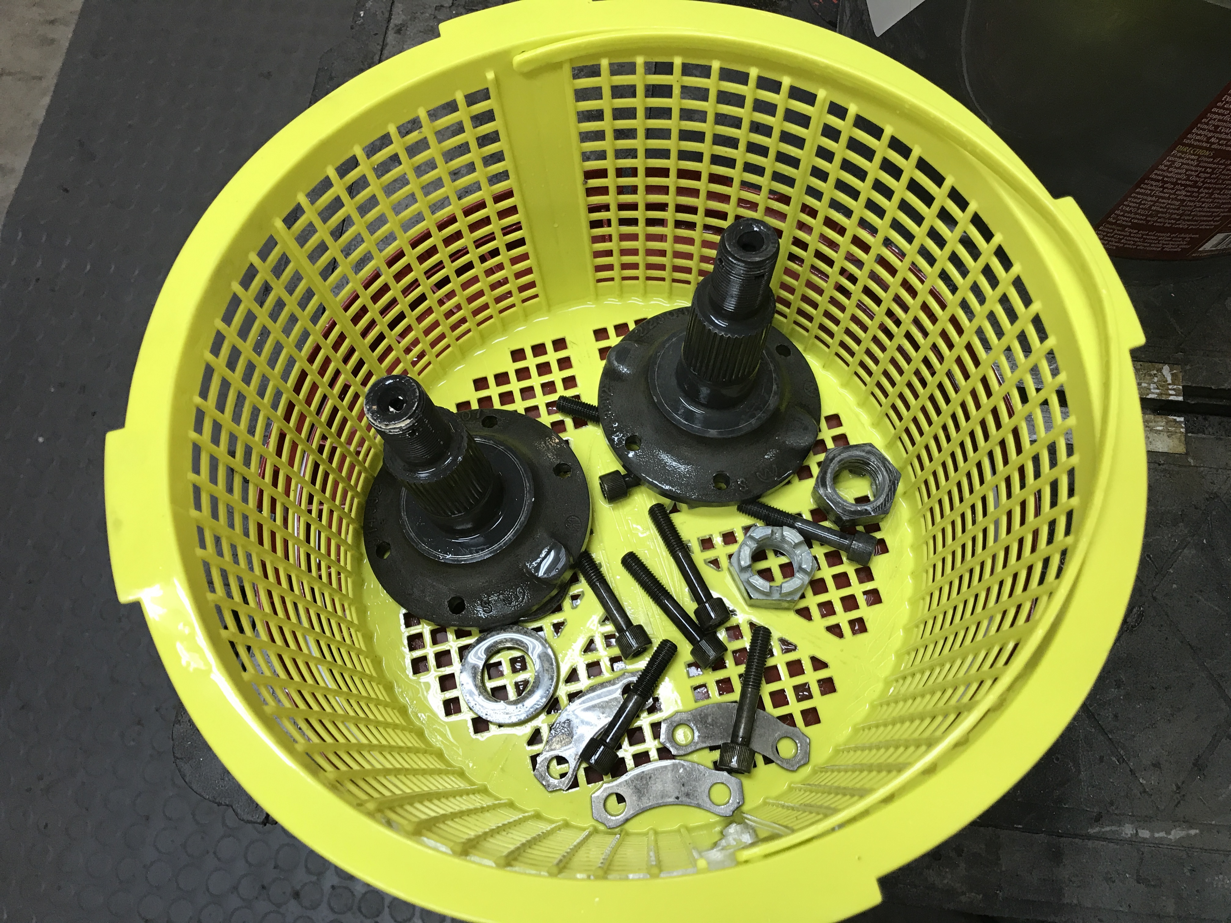

Another batch of parts after Evaporators-rust treatment.

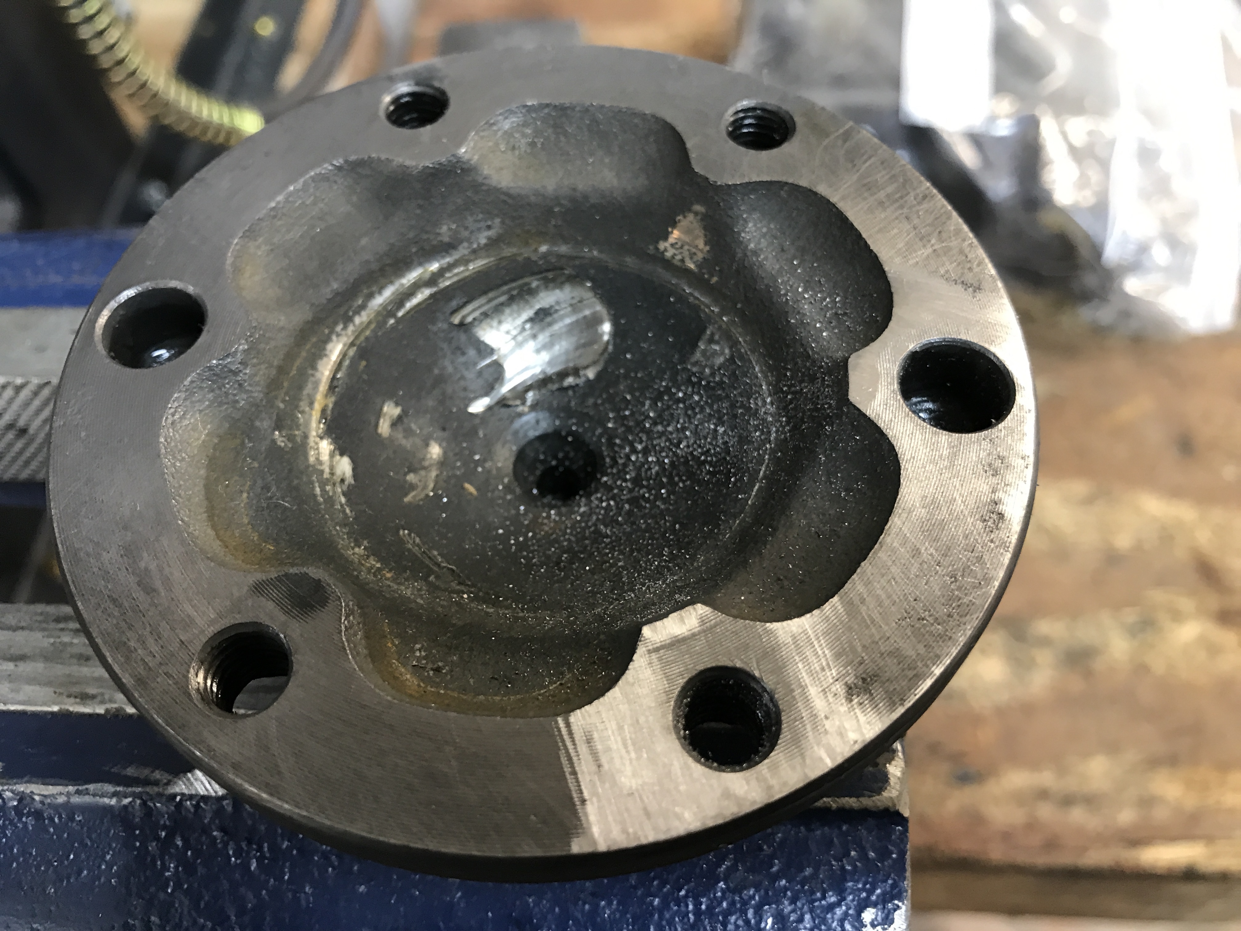

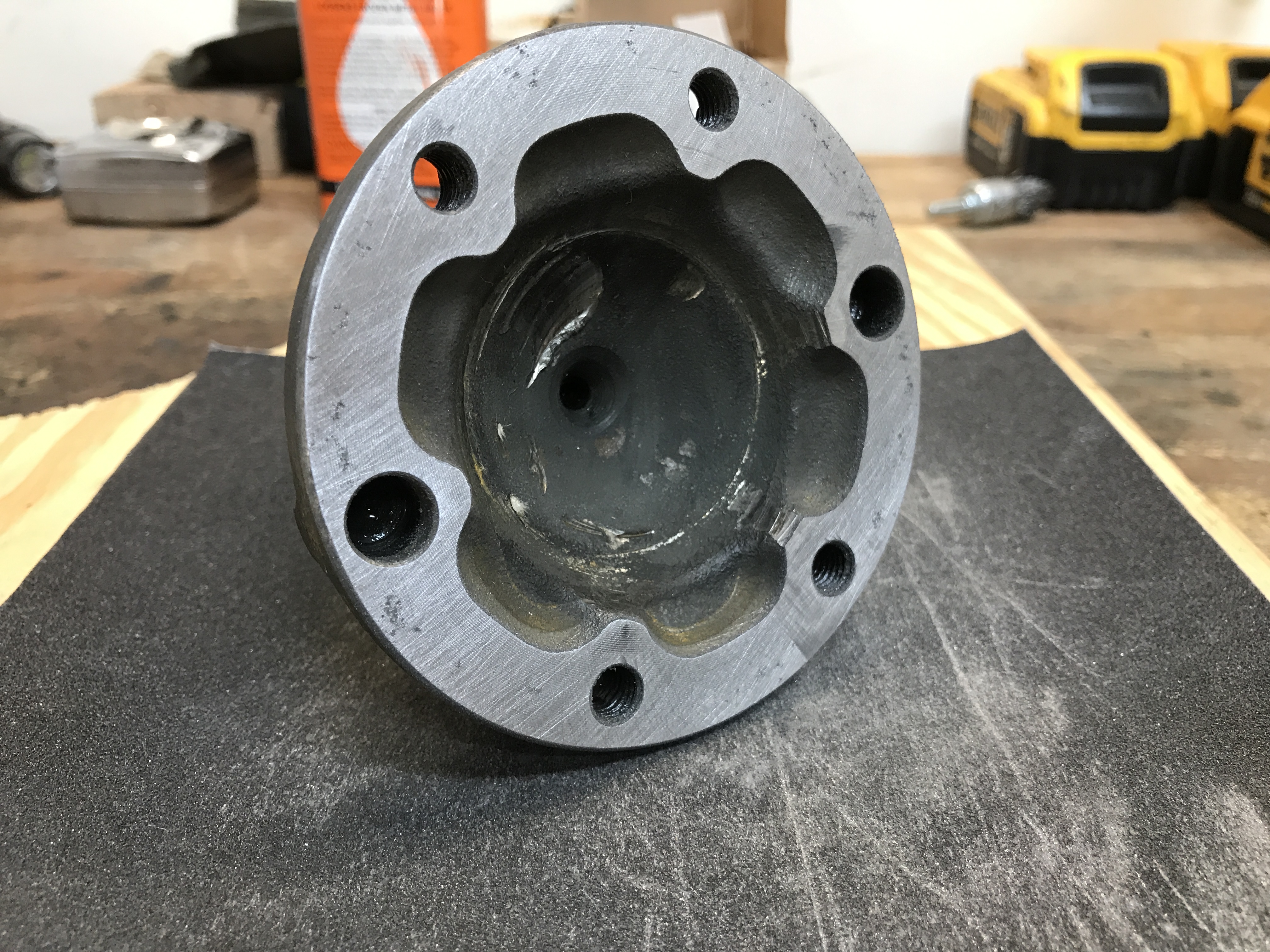

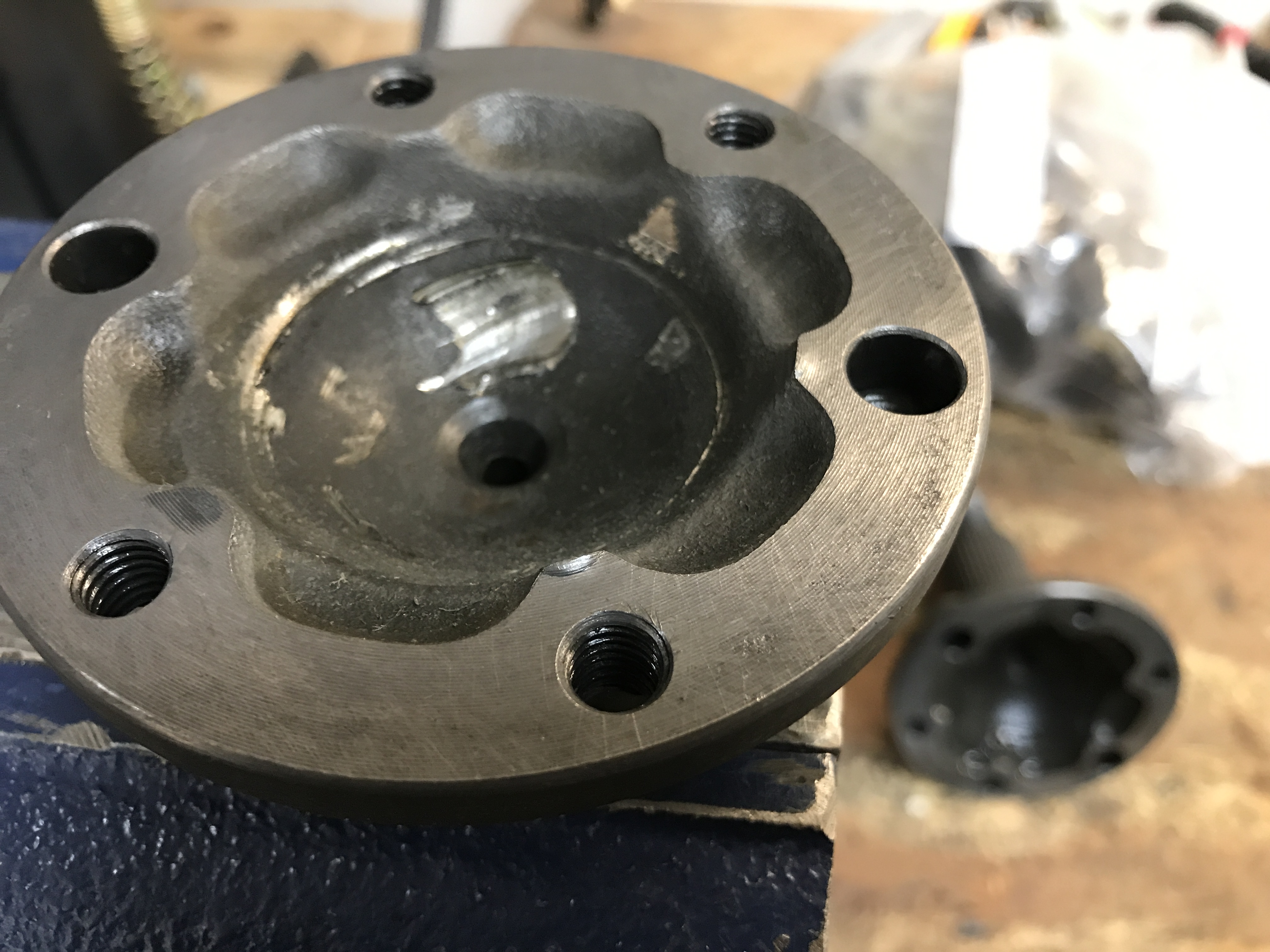

One of the half-shaft flanges has some upturned edges on the inside.
post Sep 14 2020, 07:37 PM
Post #1319
Posts: 8,343
Took care of those with a flat file.
post Sep 14 2020, 07:40 PM
Post #1320
Posts: 8,343
To test the flange flatness, as was discussed in another thread, I scuffed the mounting faces on some emery paper. Looks good.
